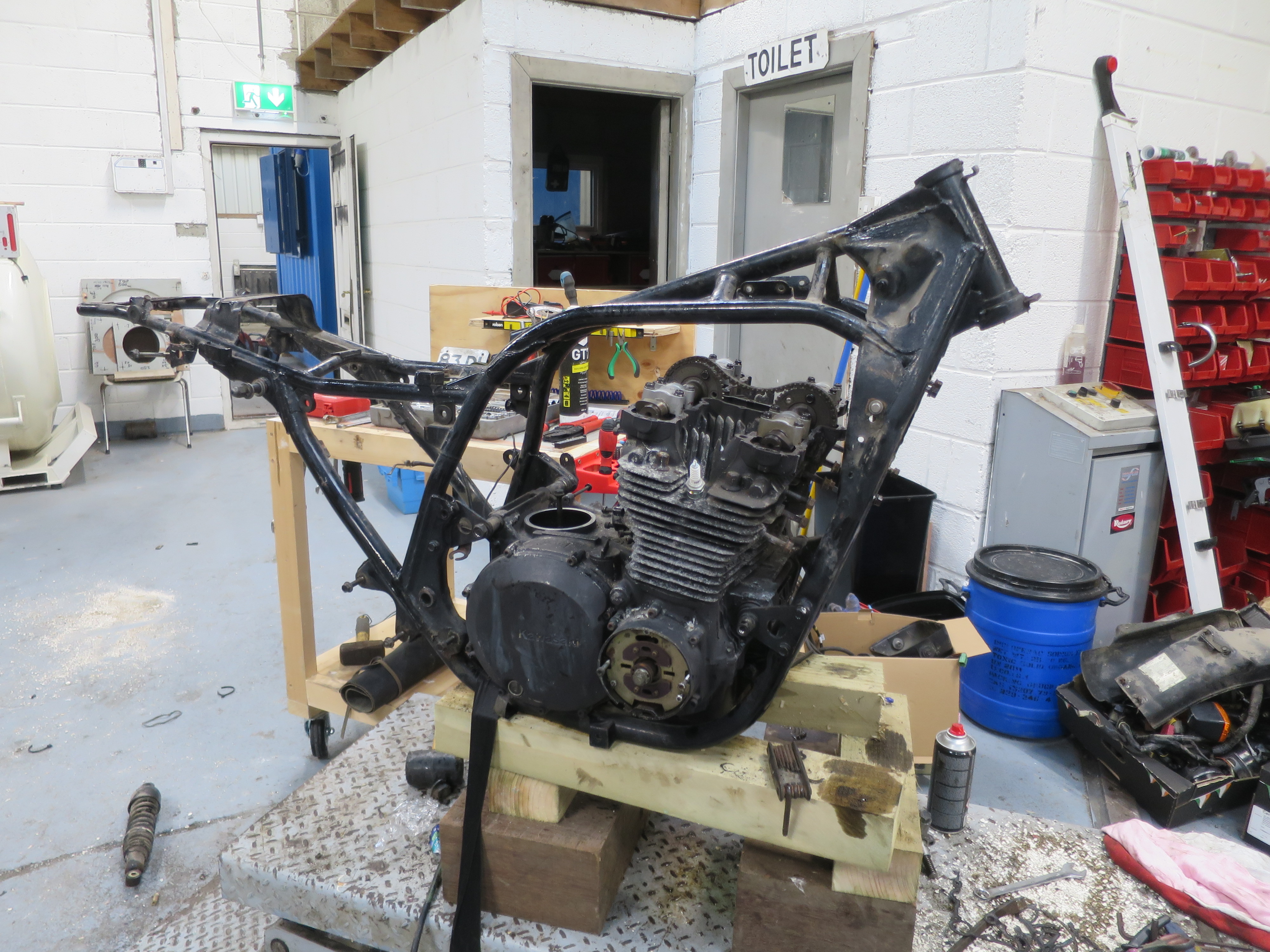

Well, the easy bit is almost done. Almost all stripped down !
I managed to get the head stock and the loom off today. I have no idea how I'll get it back all in one piece!
I'll start looking into getting the frame powder coated once I get the engine out and the casings split. Any advice on the finishes/RALs for the different components? Such as the different brackets etc. I presume these should be Black Gloss like the frame?
The Engine casings carbs and the peg brackets( most of the Aluminium) is satin Black?? and of course the Wheels, mine were white since before I owned her the first time, but I think they should be Gold with diamond cuts.
Any advice welcome.
Any advice welcome.

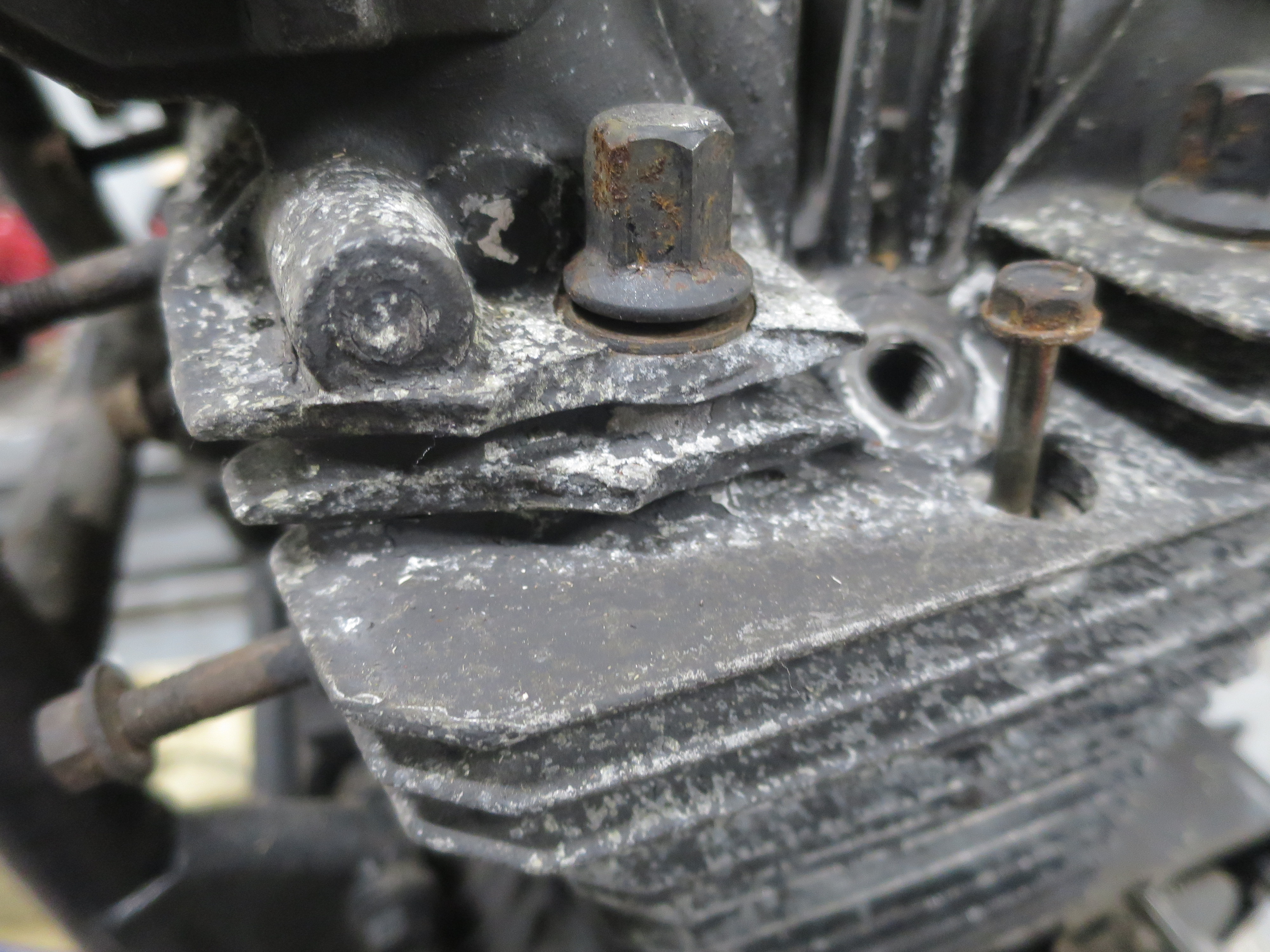

Any idea what can be done with this,is it beyond repair?
Phil
Phil
Re: Z1000r
If it’s good apart from that it could be fixed...
Re: Z1000r
when I had my Z1100r I repaired damaged fins by buying the correct thickness aluminium shaping the missing part and then getting a local fab shop to weld it on,I then dressed it up.
Re: Z1000r
weaver wrote:when I had my Z1100r I repaired damaged fins by buying the correct thickness aluminium shaping the missing part and then getting a local fab shop to weld it on,I then dressed it up.
Yeah there's a bit of work in it that's why I said if the rest is good - if there are loose guides odd other damage it might be worth investing in another or at least weighing up the costs
Re: Z1000r
I think the head is good but I will be stripping it shortly and will go through all that. If so I will give it a go!
I presume I would get it welded and dress it before vapour blasting? I know I will need to clean were the weld will be, but would it make more sense do the heavy work before the blasting and priming, or should I get it vapour blasted and then repaired before I prime?
While on the subject, if the paint needs to be High temp, will the etching primer need to be also?
P
P
Re: Z1000r
I'd get it fixed first.
Not going to offer an opinion on paint I'm not going to paint mine, just rocker cover and block...
Re: Z1000r
Fin damage can be repaired. It’s harder to find a decent cylinder head.
