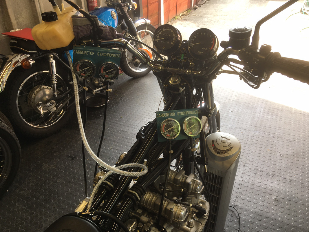

Test riding showed the tickover to be 'chuggy', with a lot of noise from the clutch in neutral. Time for a tune up.
I had a go at strobe timing and synching the carbs yesterday. My cheapo Gunson neon timing light proved to be utterly useless, I couldn't see any marks at all, even after I painted them yellow! My mate Mark says you can use these, but only looking close up in near darkness. A year or two back, an old chap I know who used to be a rally mechanic gave me a bunch of his old tools, as he was moving into a flat, he wanted them to go to someone he knew would use them. A root around in the garage revealed an old Crypton Powerflash he'd given me, with 12v leads to a battery and an inductive pickup. Once I had it all worked out, what a difference! It turns out my static setting was a touch advanced, we'll see what the difference is like when I go out next.
Mark lent me a big fan, and a set of vacuum gauges. Here we are set up, with the chain oiler tank pressed into service again.
I got the 4 carbs about equal at a steady throttle, however I seem to have adjusted all 4 off their stops, as the idle adjustment screw had a gap that it didn't have before. The adjuster screw on #1 carb is a bit broken, I'm going to order a new one, but it may have to come from the USA. I've got them as near as I can for now, I'll have to do it again when I change the adjuster.
