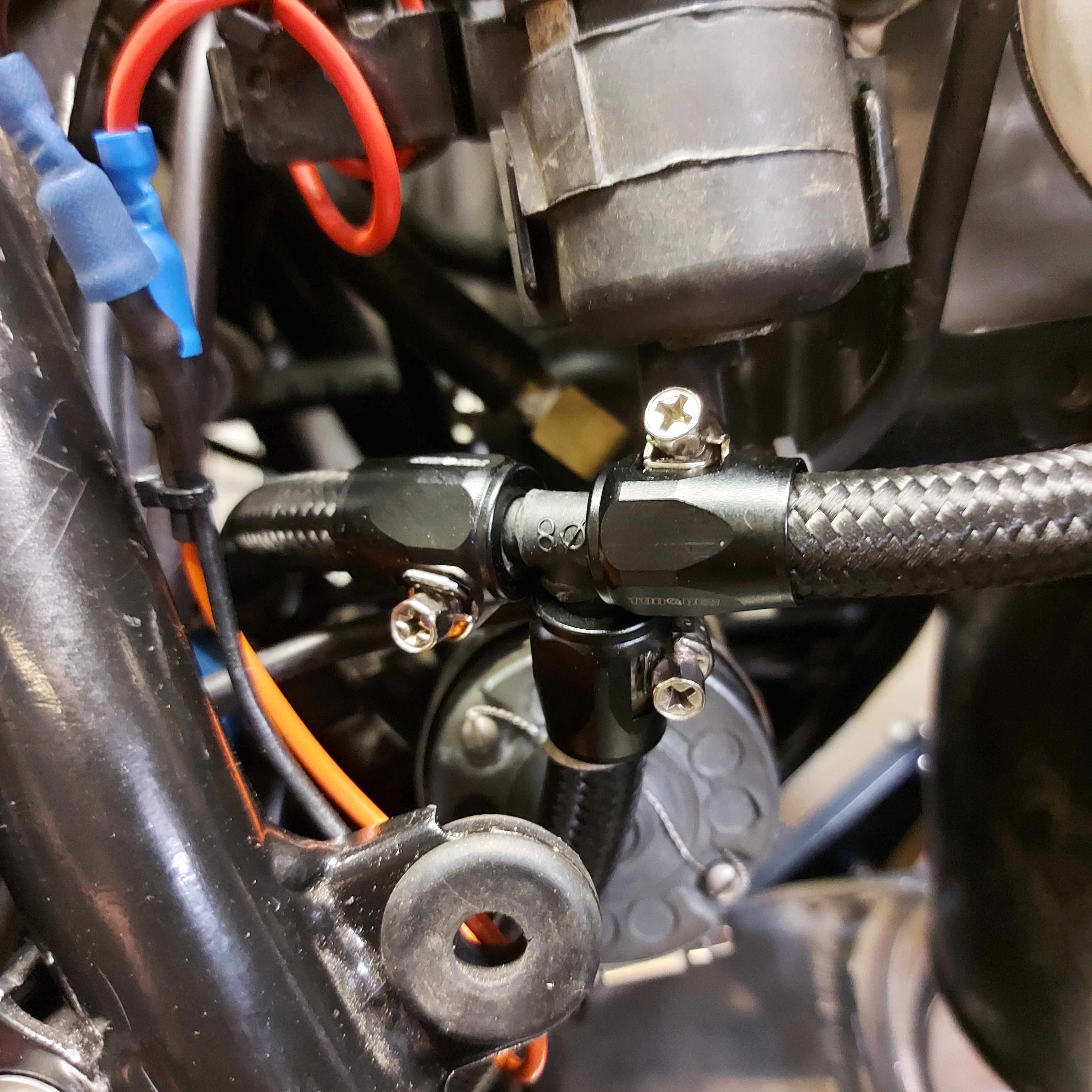

#241 PostAuthor: MDM » Mon Jan 03, 2022 11:10 am
With a tee piece to connect the turbo oil tank and crankcase top breather lines.

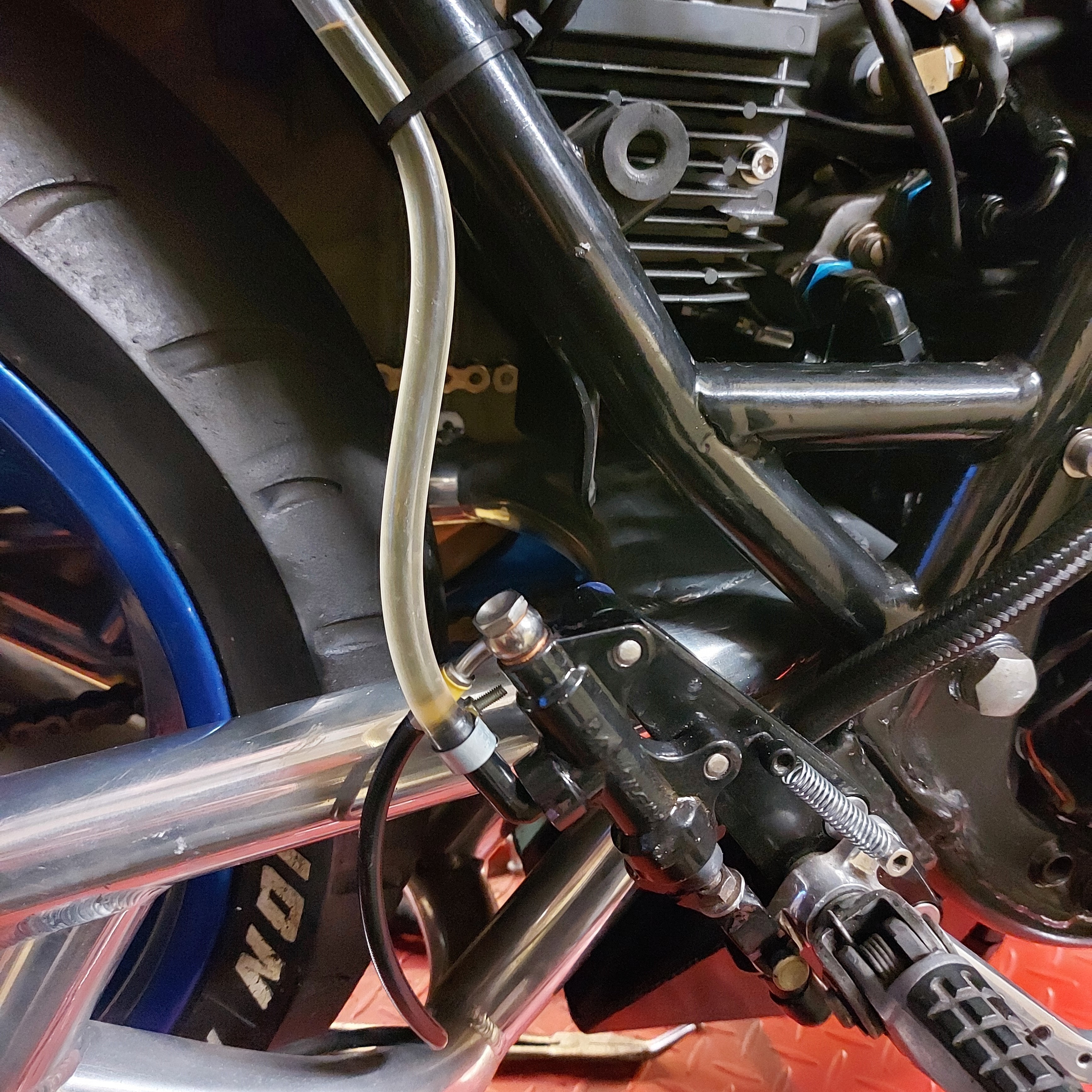

#242 PostAuthor: MDM » Mon Feb 28, 2022 8:24 pm
The rear brake's clear brake line hose had gone really manky, despite it apparently being pukka Hodna HRC stuff, and it's leaked some fluid out onto the master cylinder, so it was all taken off, cleaned up, repainted and fitted with some properly pukka 2375 Tygon that is allegedly impervious to brake fluid. We'll see about that eh.

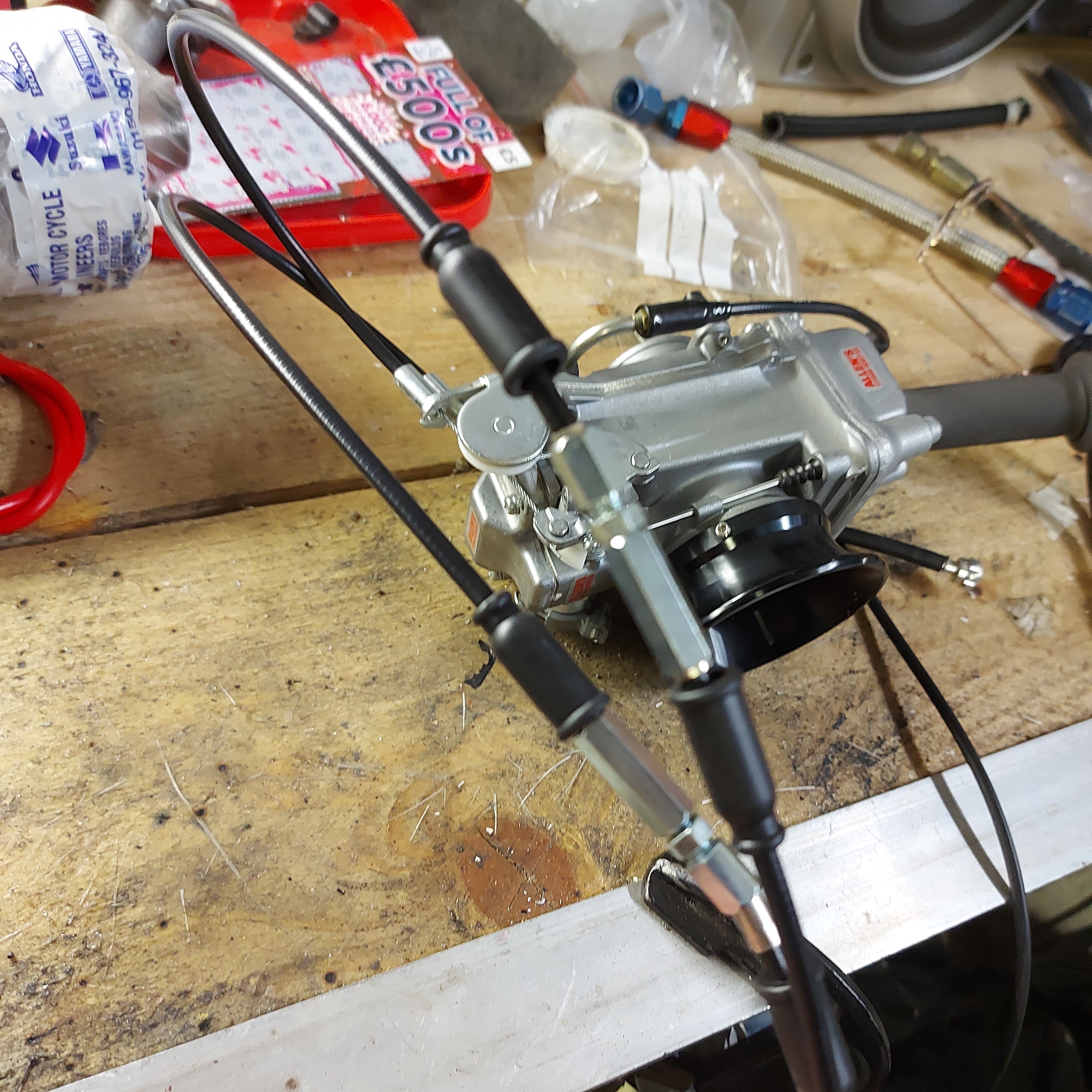

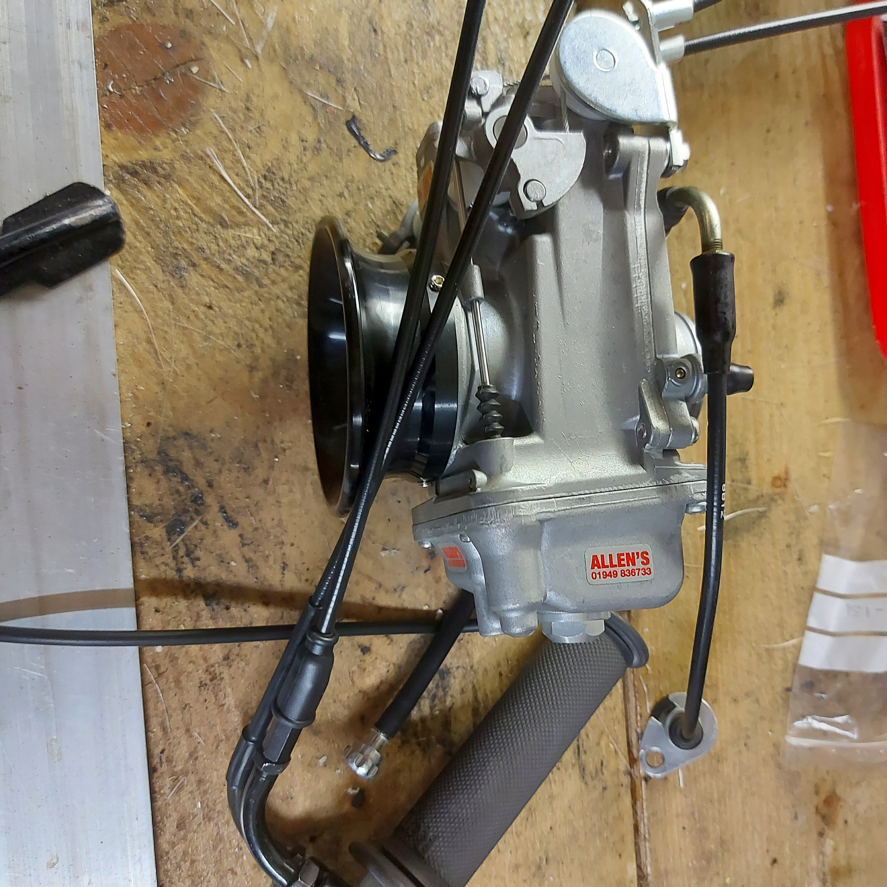

#243 PostAuthor: MDM » Mon Apr 04, 2022 2:28 pm
Finally got sorted with a pair of cables to suit the throttle assembly and Mikuni carb, thanks to Carrot Cycles in Lincoln.
