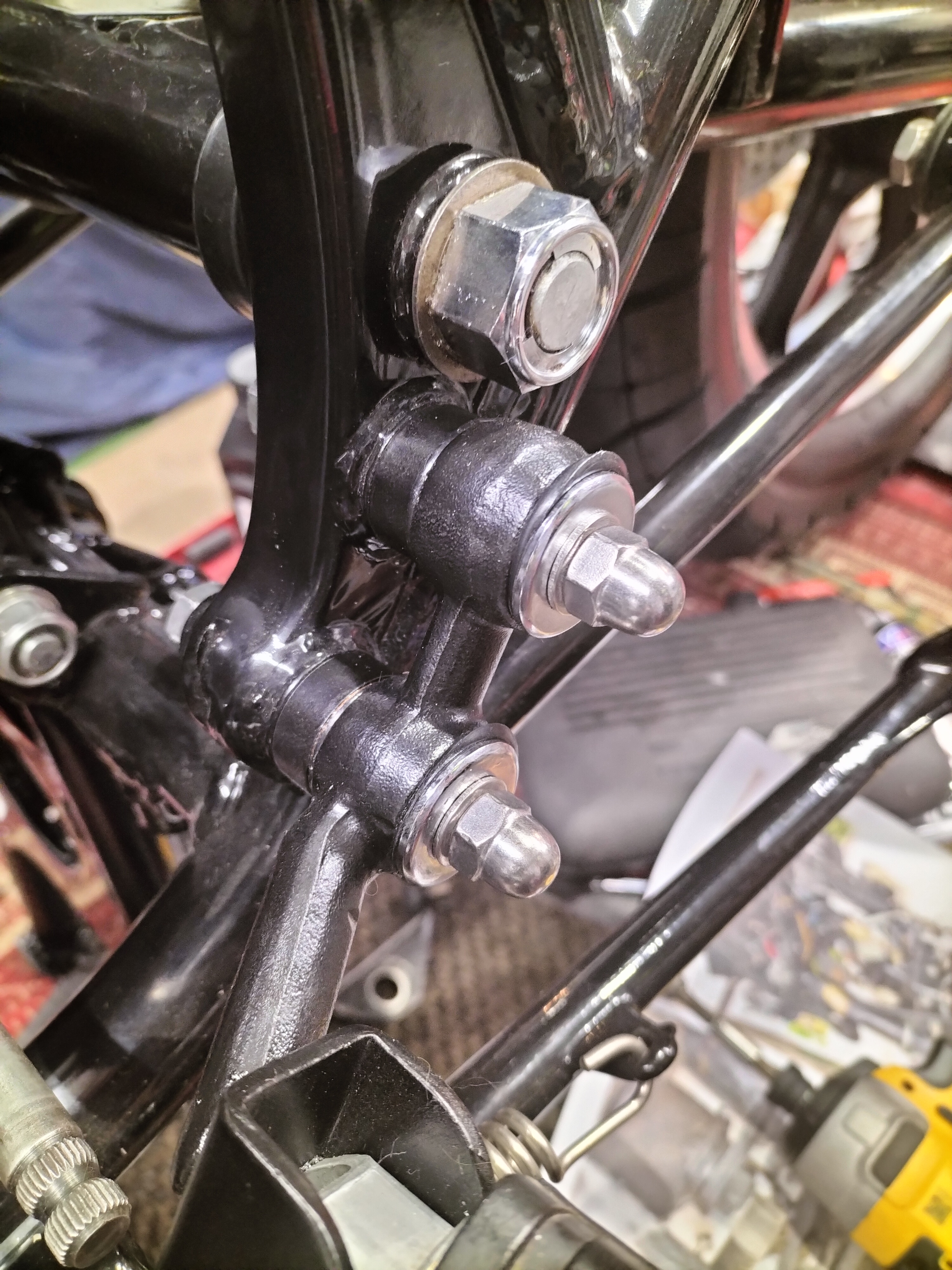

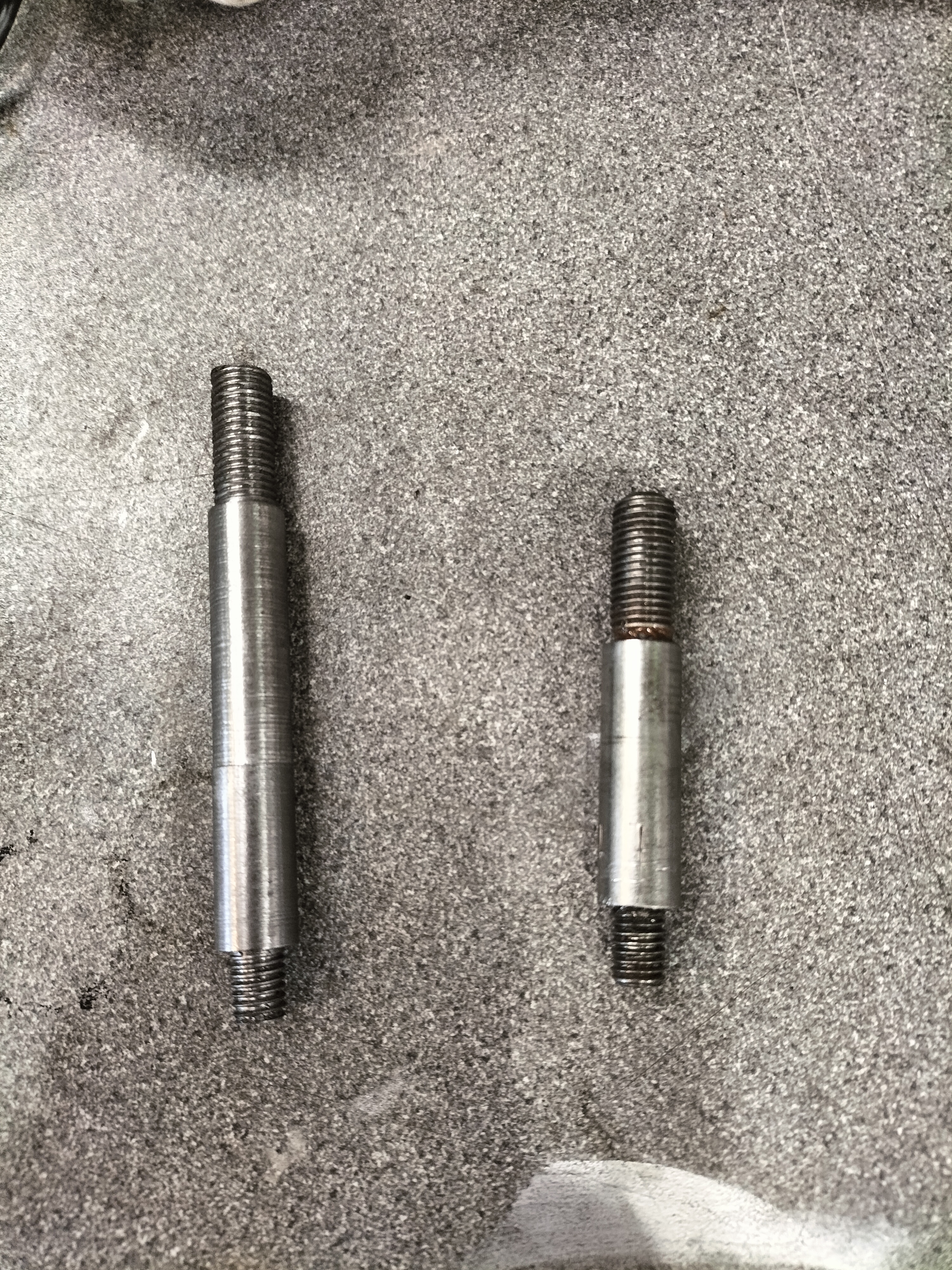

Hey Will, do you have to bend out the brake pedal a bit to use that clutch cover extension???
Rob
paid up member
Big Fluff
Posts: 2619
Joined: 1st Mar 2007
Location: Marbury, Shropshire
Re: Stardust TC
#17 PostAuthor: Big Fluff » Fri Mar 10, 2023 8:39 am
rpeters wrote:Hey Will, do you have to bend out the brake pedal a bit to use that clutch cover extension???
Rob
Yes Rob, I reprofiles a bit to clear. You also have to bring out the RH rider peg a little which I didn't mind as the LH rider peg also needs bringing out a little to help with the typical TC sidestand/exhaust/pegs issue.
I made new support pins and spacers to keep it looking as stock as possible.

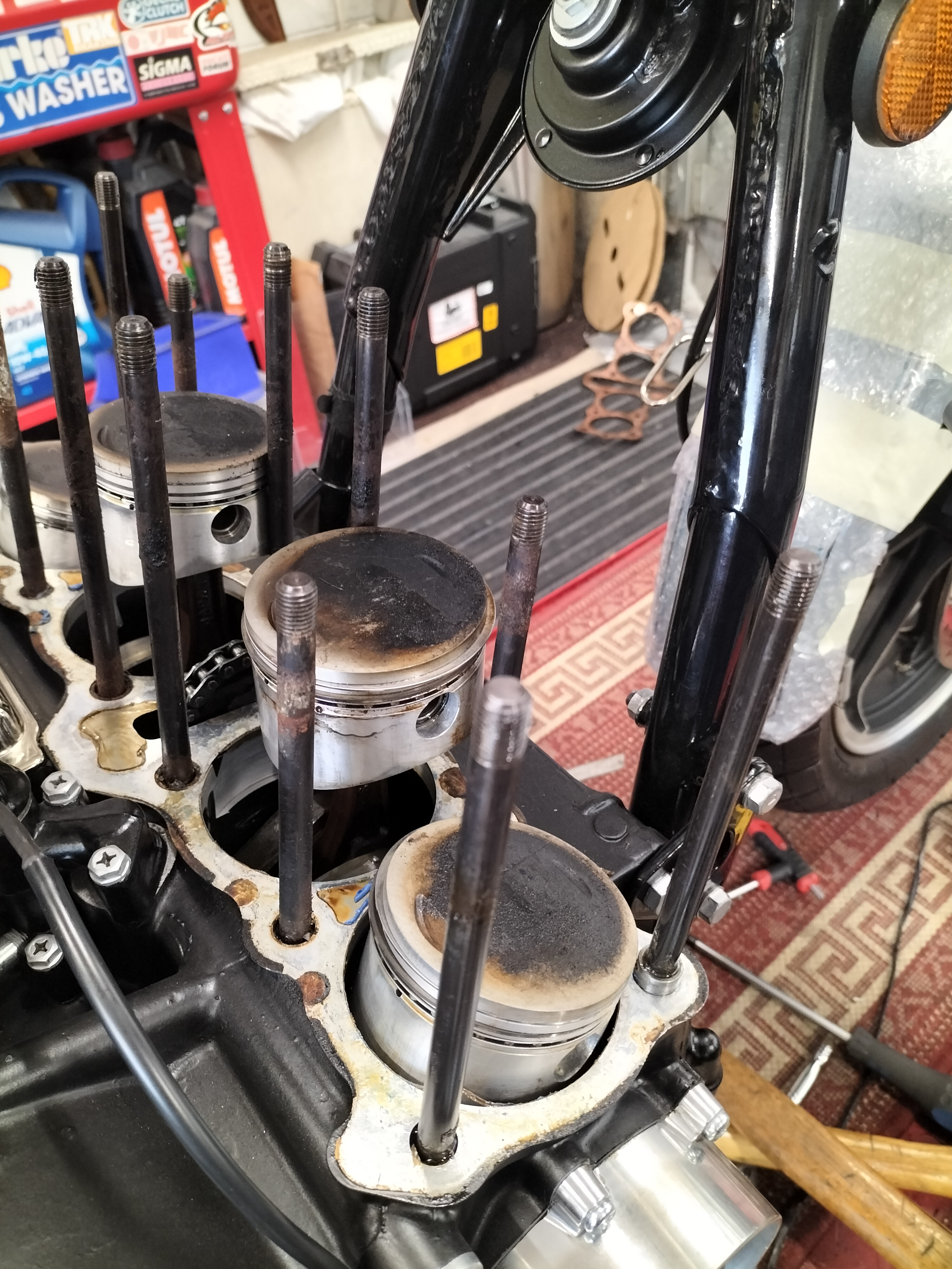

Now pretty much all done apart from the top end refresh.
77mm bore (1230cc), Megacycle turbo cams, ported & flowed head. All in most excellent condition so It's just getting a valve lap job, new viton stem seals, APE valve springs and vernier dialled in cams. Composite base gasket and MLS head gasket.
A few coats os satin black then it's time to bolt the turbo system back on.

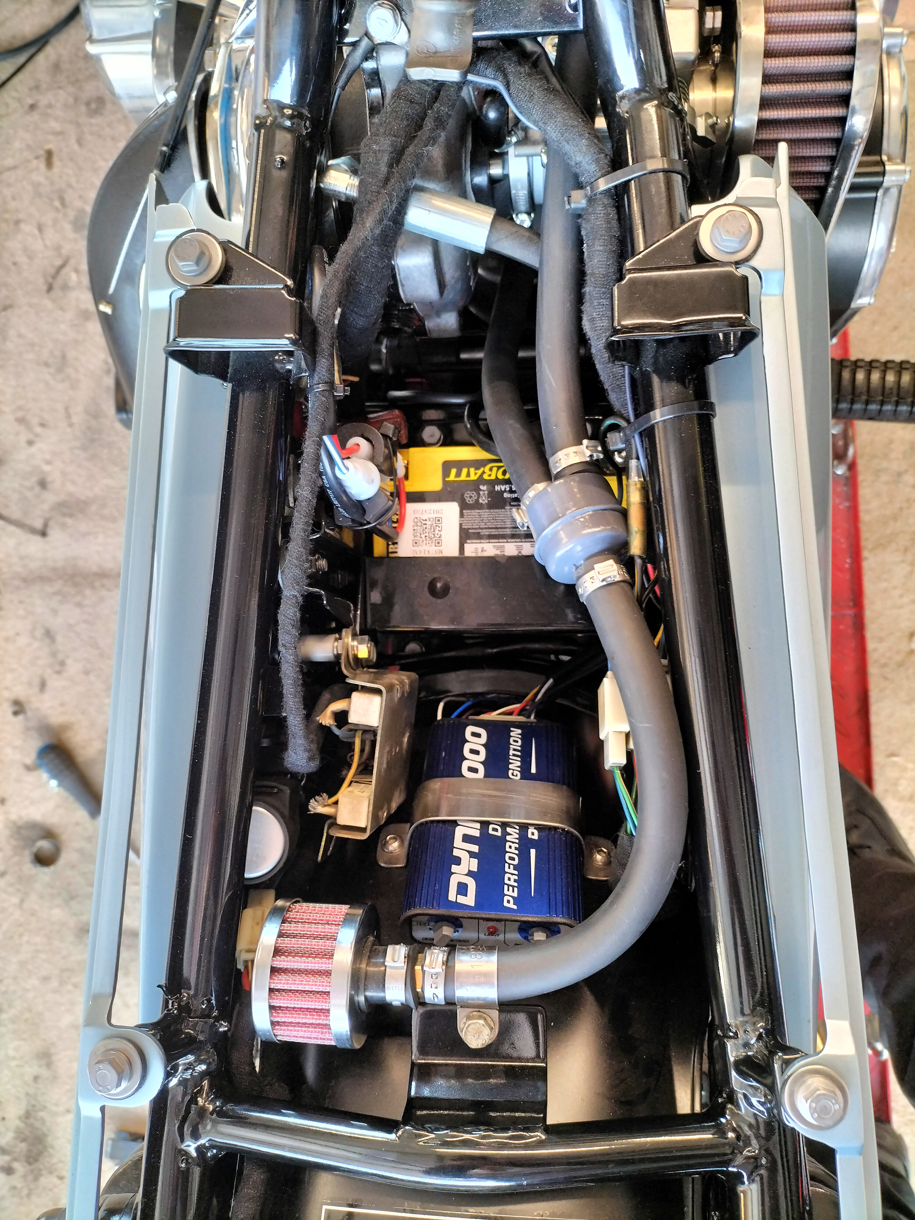

#26 PostAuthor: Big Fluff » Sat Apr 08, 2023 8:43 pm

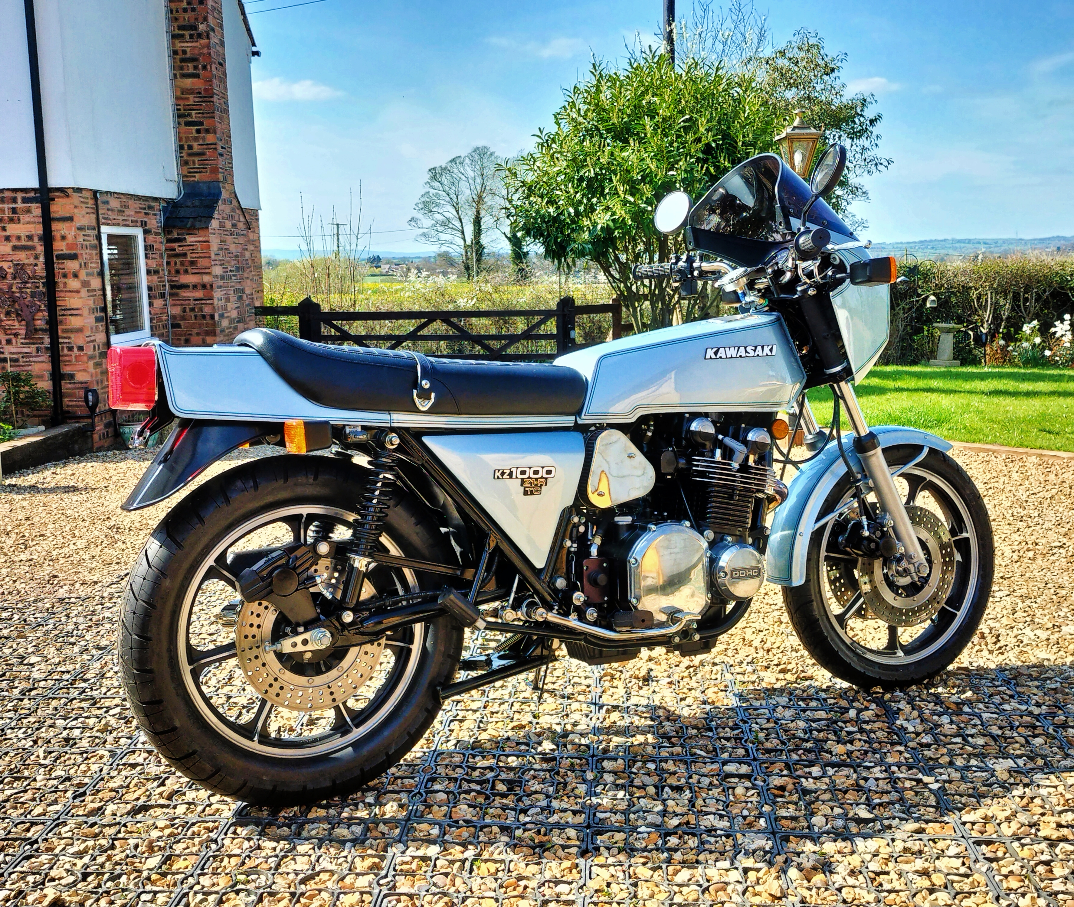

All done
Re: Stardust TC
#27 PostAuthor: Philippe » Sun Apr 09, 2023 3:50 am
Hi Big Fluff
congratulations! She's a beauty!
Be careful when riding her. I heard that the TC is a monster when it comes to accelerations.
Enjoy!

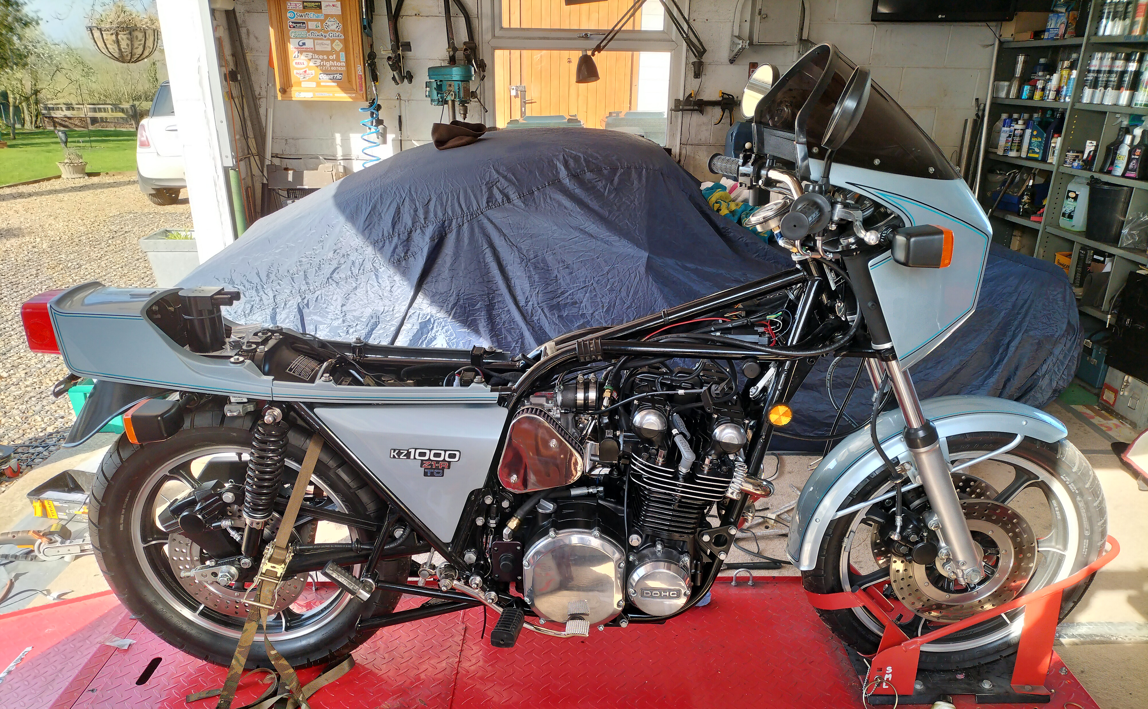

#29 PostAuthor: relisysxx » Sun Apr 09, 2023 6:46 am
Looks lovely, what's under the cover ( 911 or 356 maybe)?
Big Fluff
Posts: 2619
Re: Stardust TC
#30 PostAuthor: Big Fluff » Sun Apr 09, 2023 7:14 am
relisysxx wrote:Looks lovely, what's under the cover ( 911 or 356 maybe)?
GT6 :D
