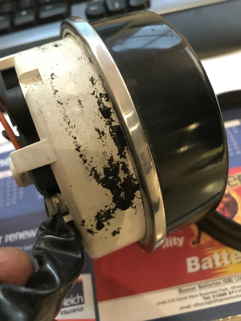

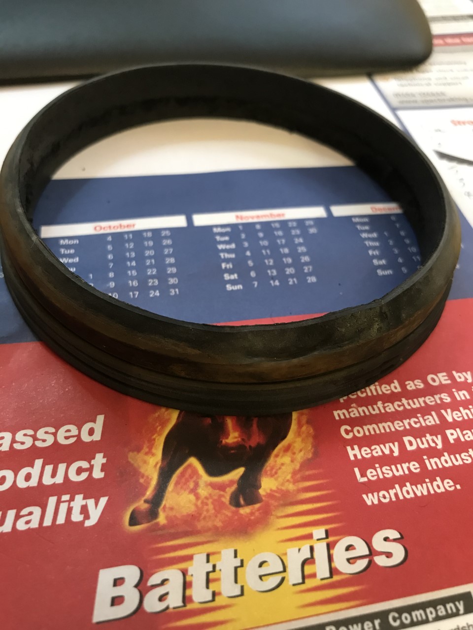

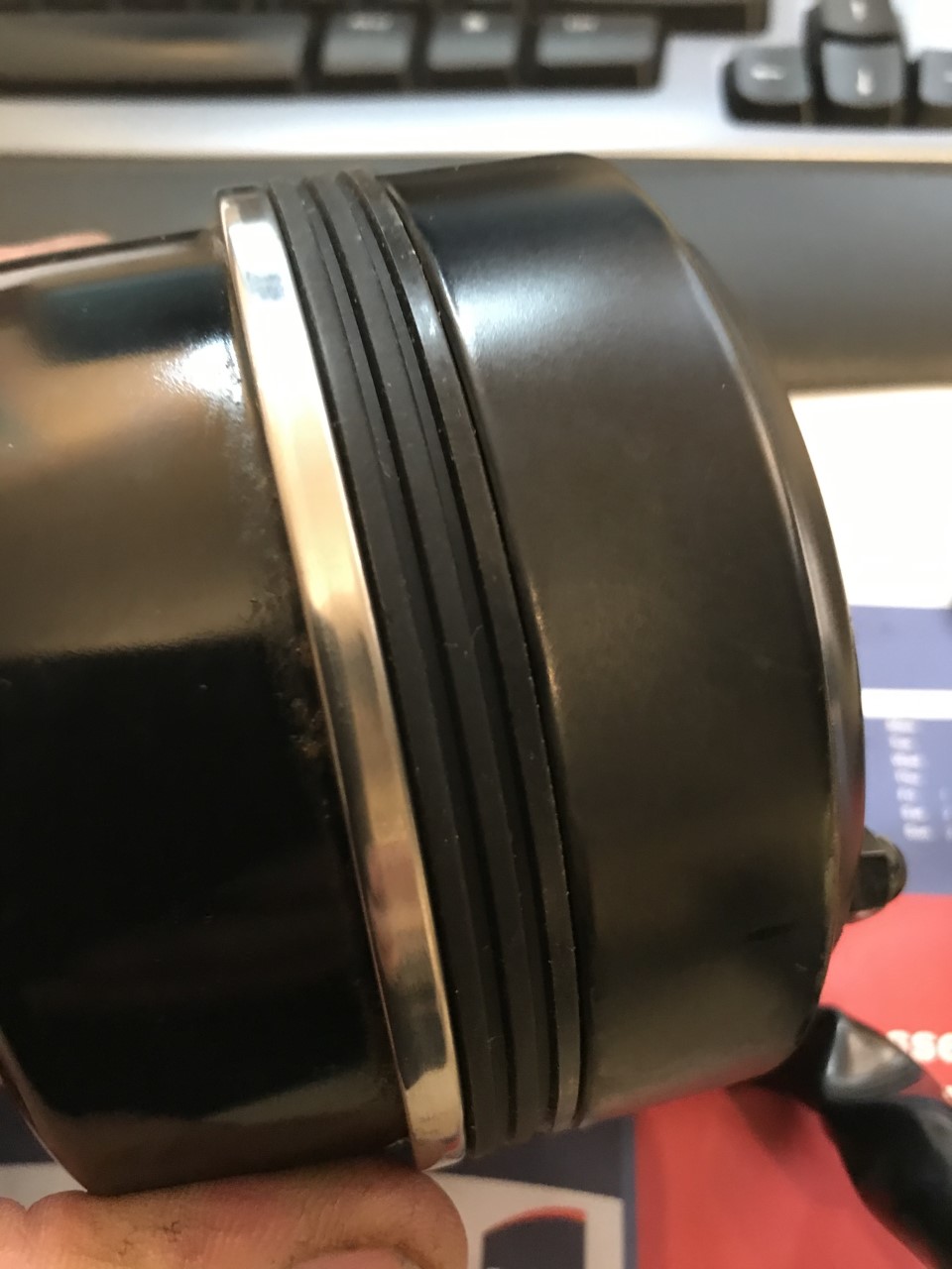

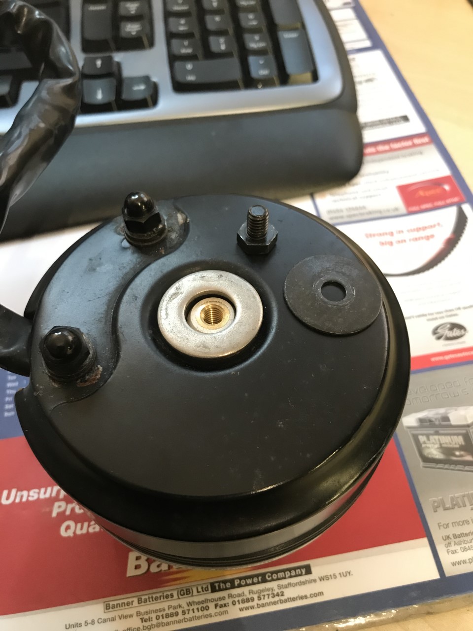

I have though started to look at some components and solutions. One such problem is the clocks. A recent advert made me aware of some new mounting rubbers for the clock pods. From Australia they have good reviews so I bought a pair.
The originals seem to be made from foam ?
When removed from the pod you can see how they have degraded over time.
To overcome the loose fit in the past I packed it out with a washer.
Whilst okay as a temporary fix it never really stopped the vibration getting through.
Compare the old with the new.
They really are very good quality and an exact replica of the original.
A happy bunny

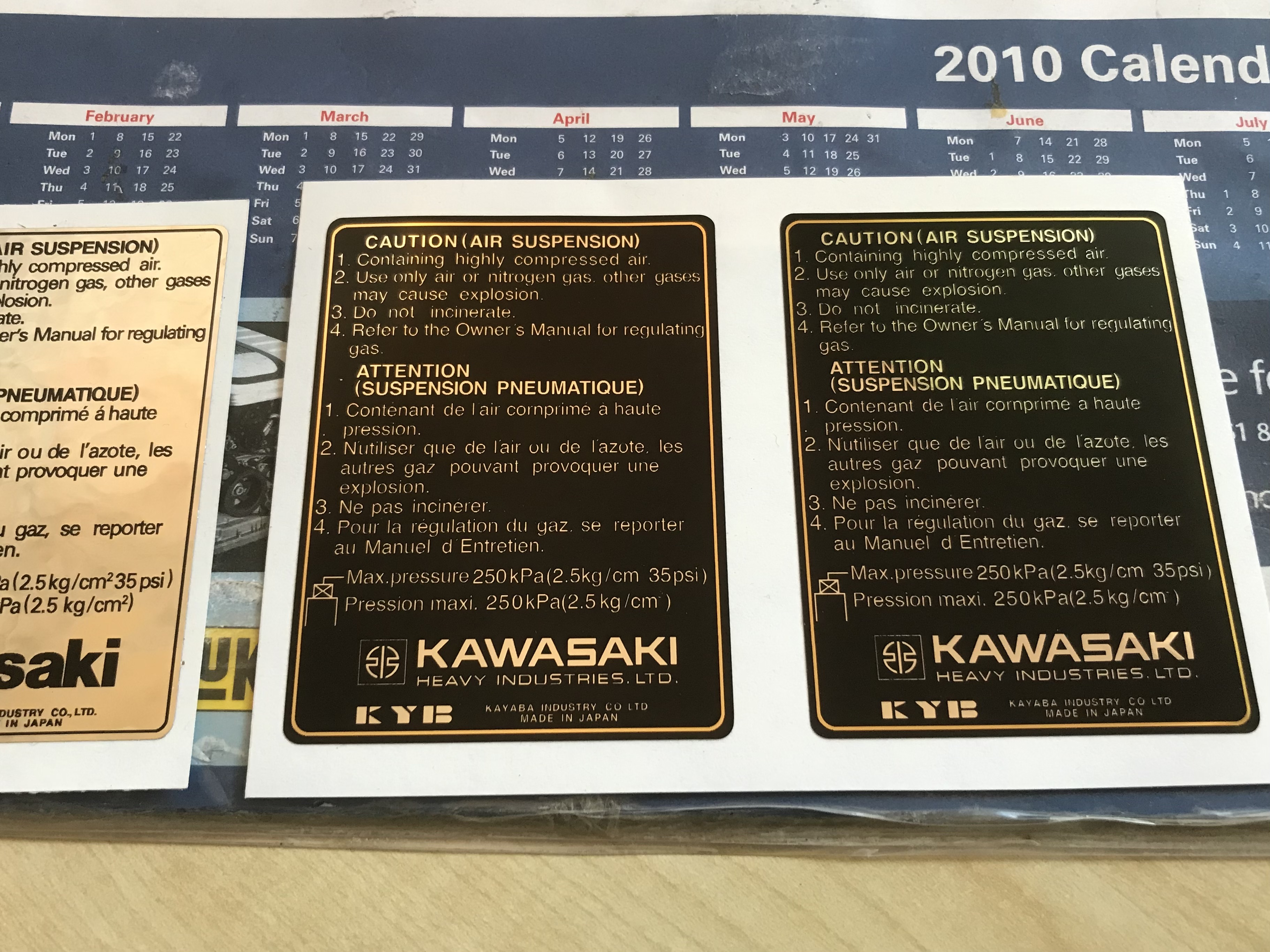

I have decided that I don't need any kind of performance upgrade, just for the bike to sit properly without the need to constantly monitor the air pressure. Whoever thought unbalanced forks needing 7 psi in each leg was a good idea?
I spoke to PDQ today and upon re reading Al's thread for the umpteenth time have opted for Racetech 0.85kg/mm springs only. What a nice helpful guy. They are in stock apparently so I can collect whenever I am next down there.
Paint is ready, I have space, at least until the engine is finished, and I have the correct decals. (Correct on the right)

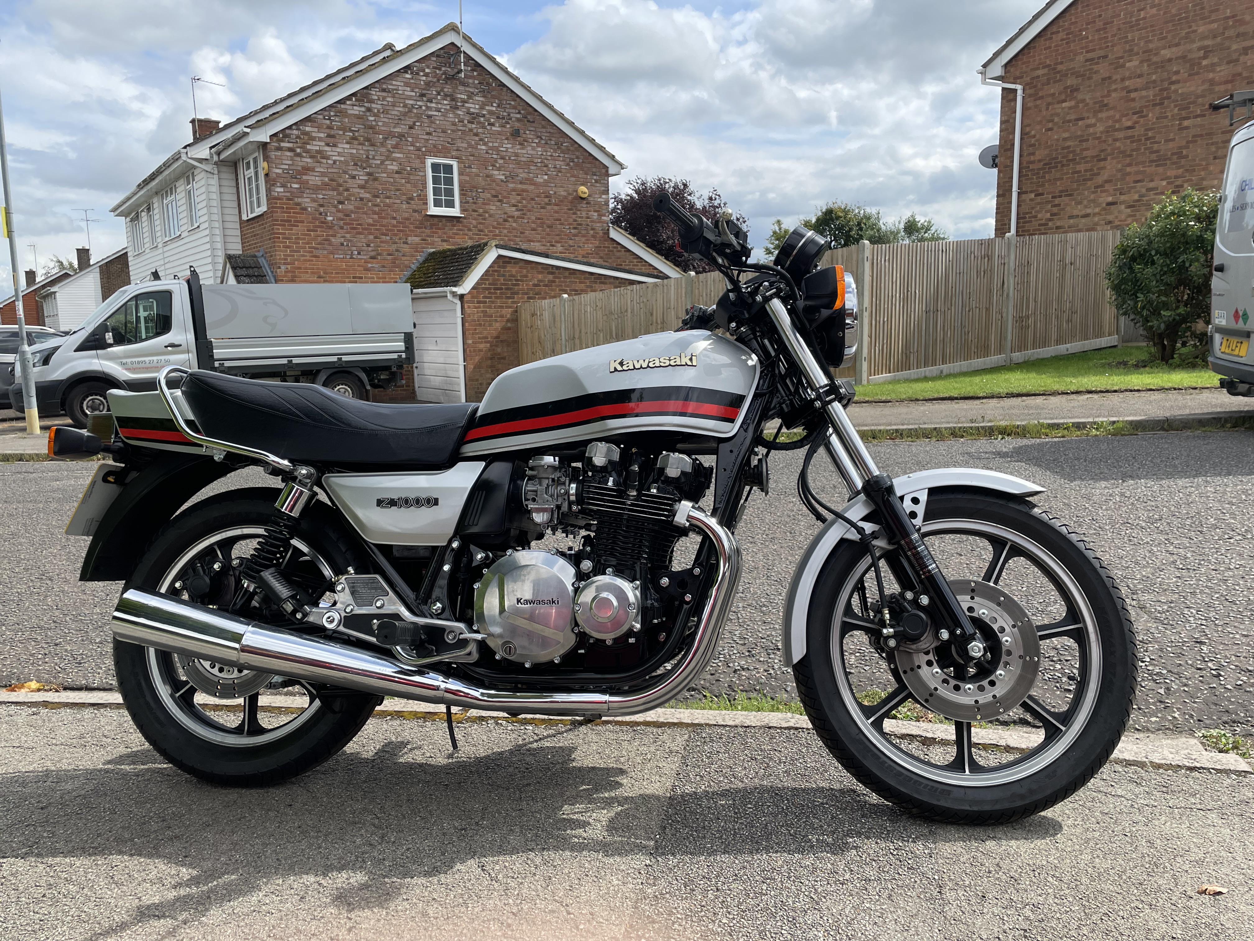

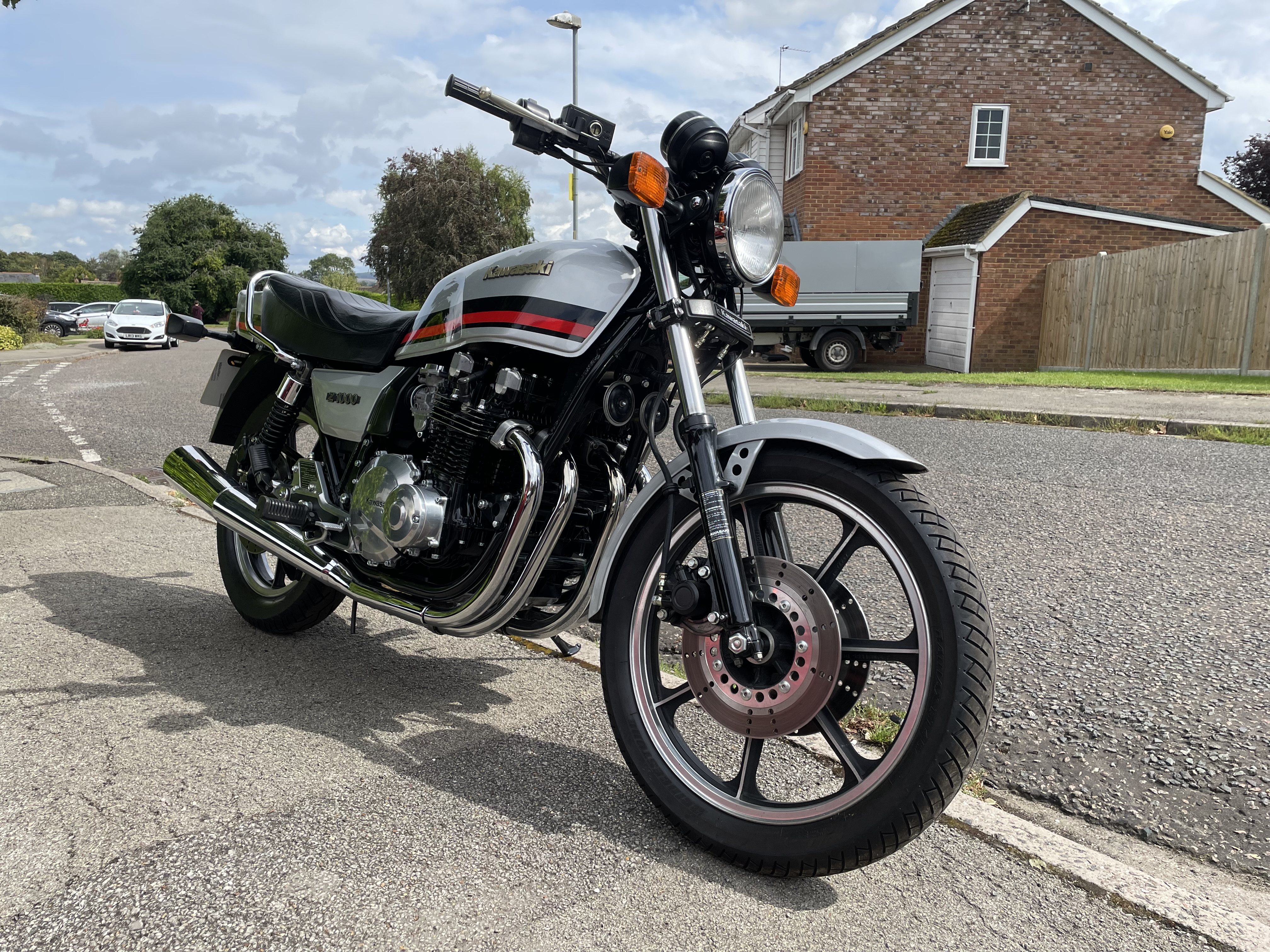

Here is the finished bike. I am now unlikely to use it so will be exploring options to sell.
I tentatively offered the bike to visitors at £12k and did discuss including it in the Silverstone Auctions sale next spring.
