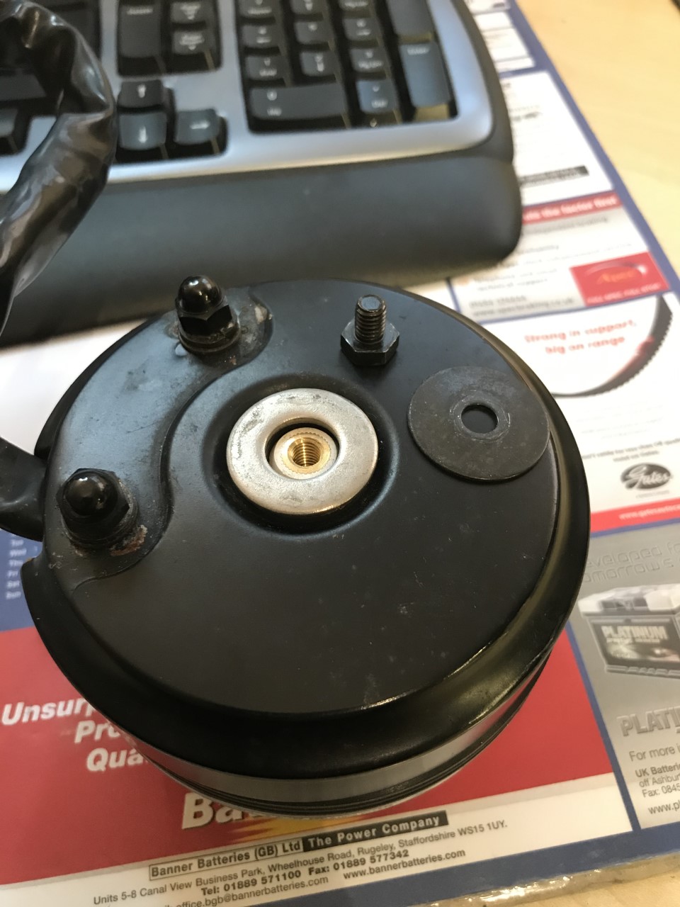

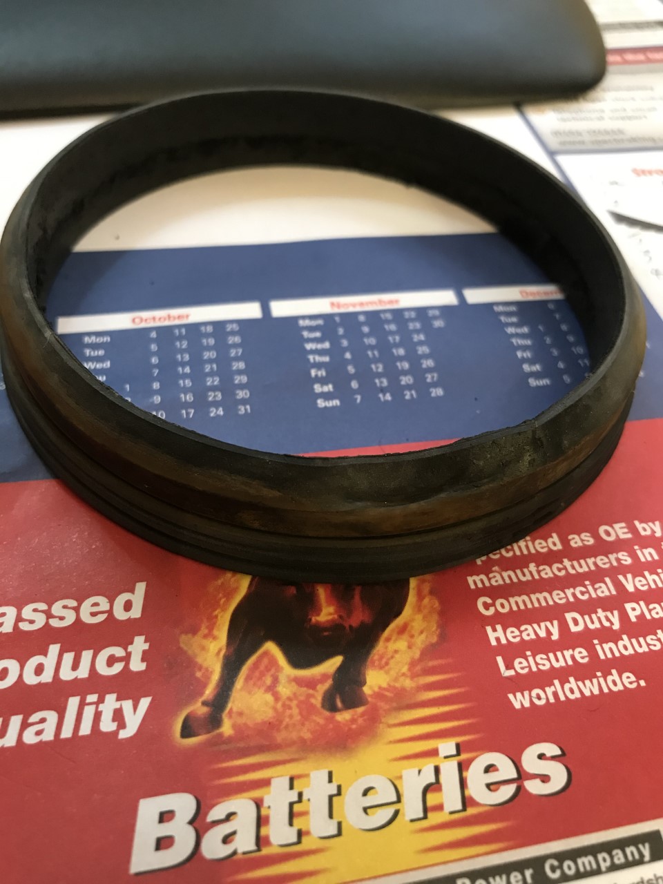

I have though started to look at some components and solutions. One such problem is the clocks. A recent advert made me aware of some new mounting rubbers for the clock pods. From Australia they have good reviews so I bought a pair.

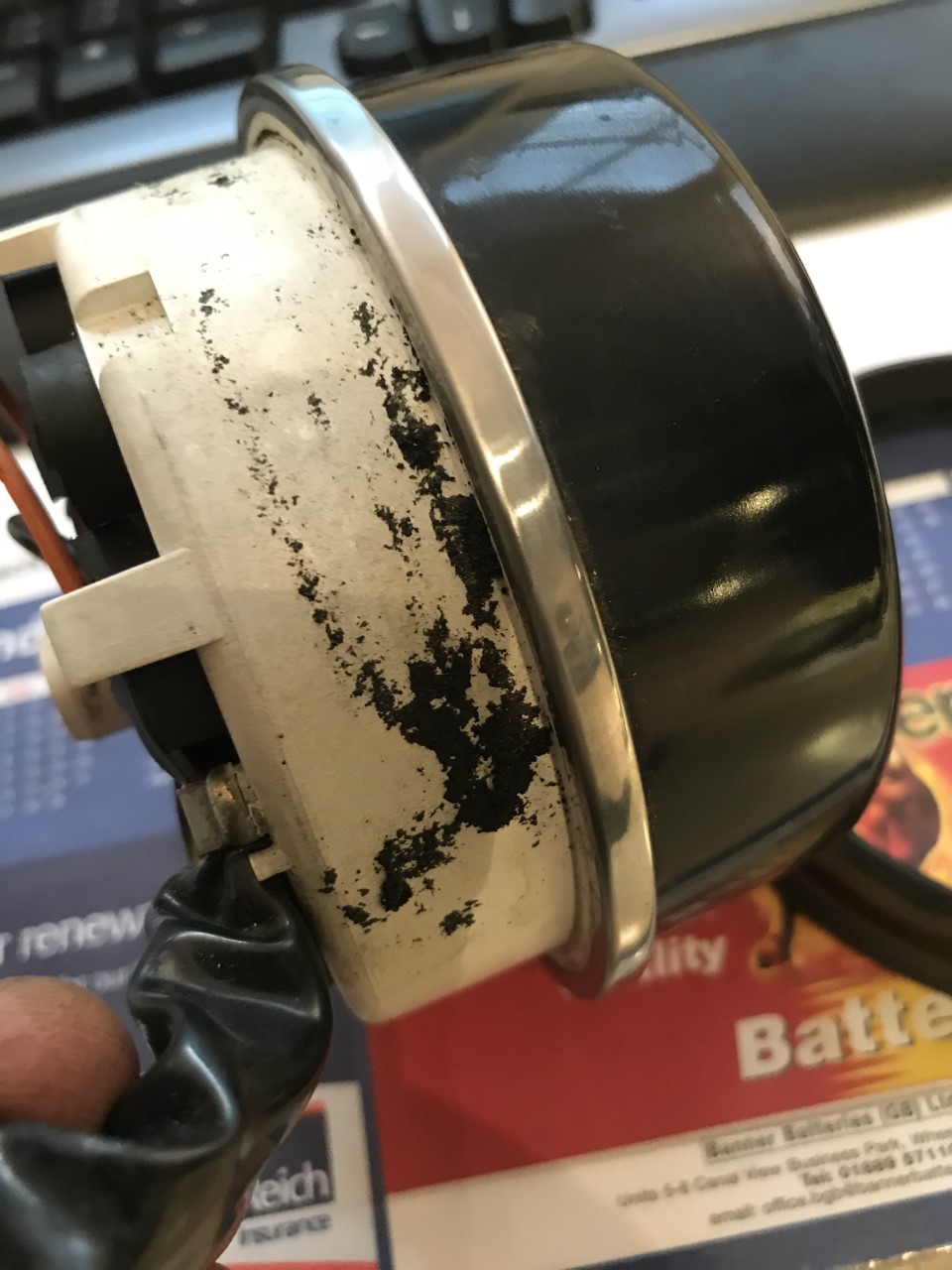

The originals seem to be made from foam ?
When removed from the pod you can see how they have degraded over time.

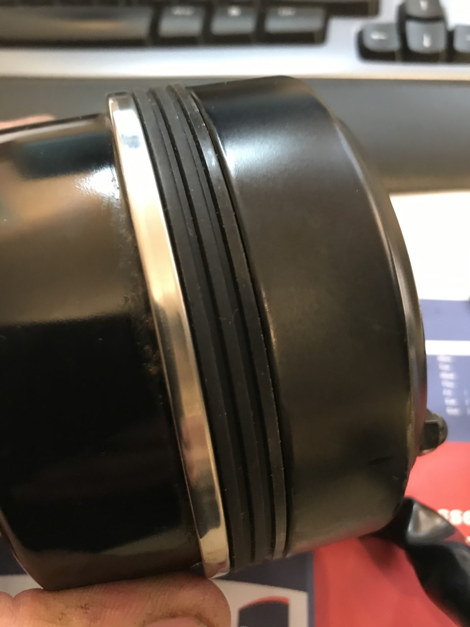

To overcome the loose fit in the past I packed it out with a washer.
Whilst okay as a temporary fix it never really stopped the vibration getting through.

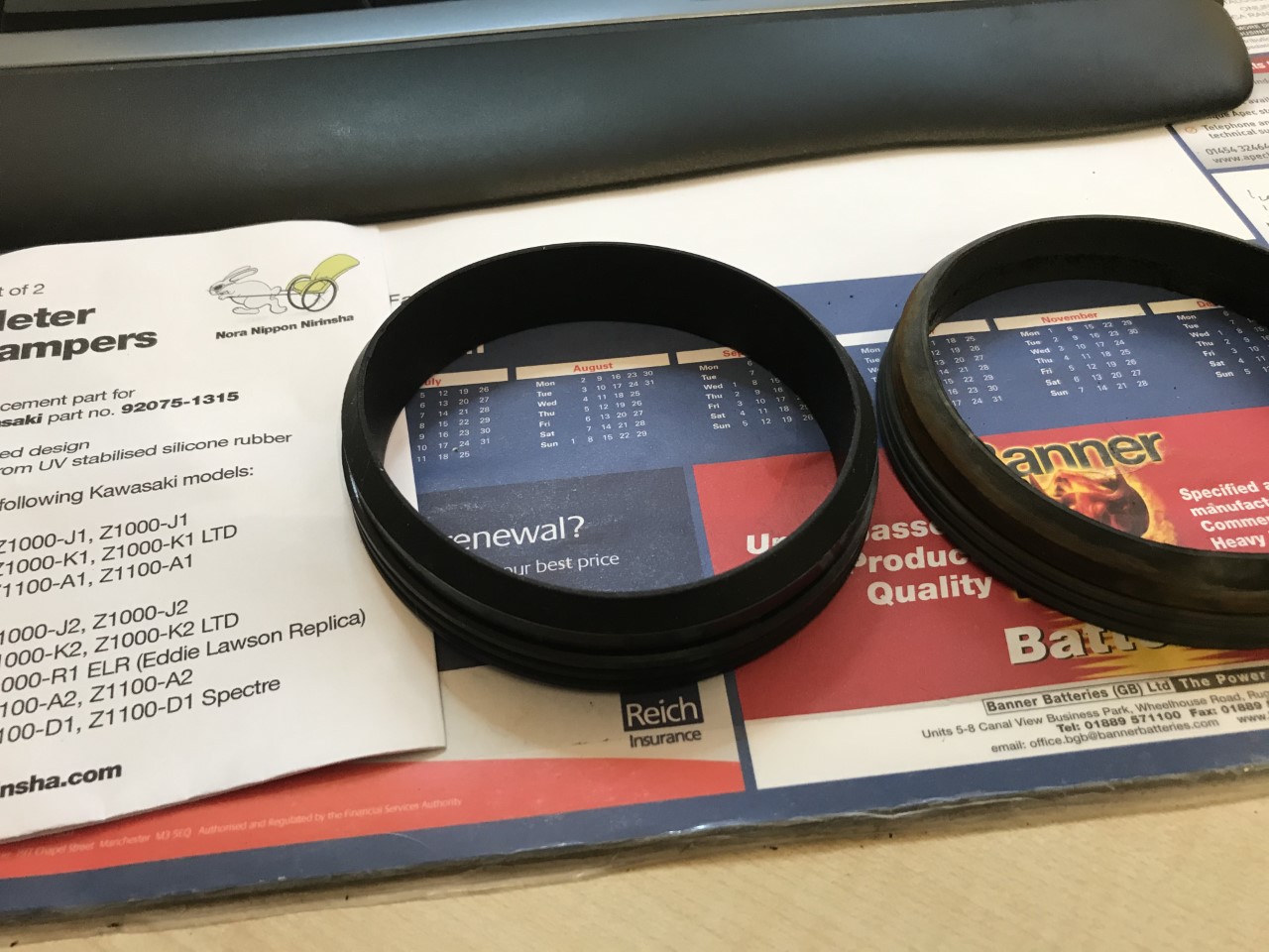

Compare the old with the new.
They really are very good quality and an exact replica of the original.
A happy bunny
A happy bunny

I put the delivery note in one of the pictures.
Nippon Nirinsha.
Nippon Nirinsha.

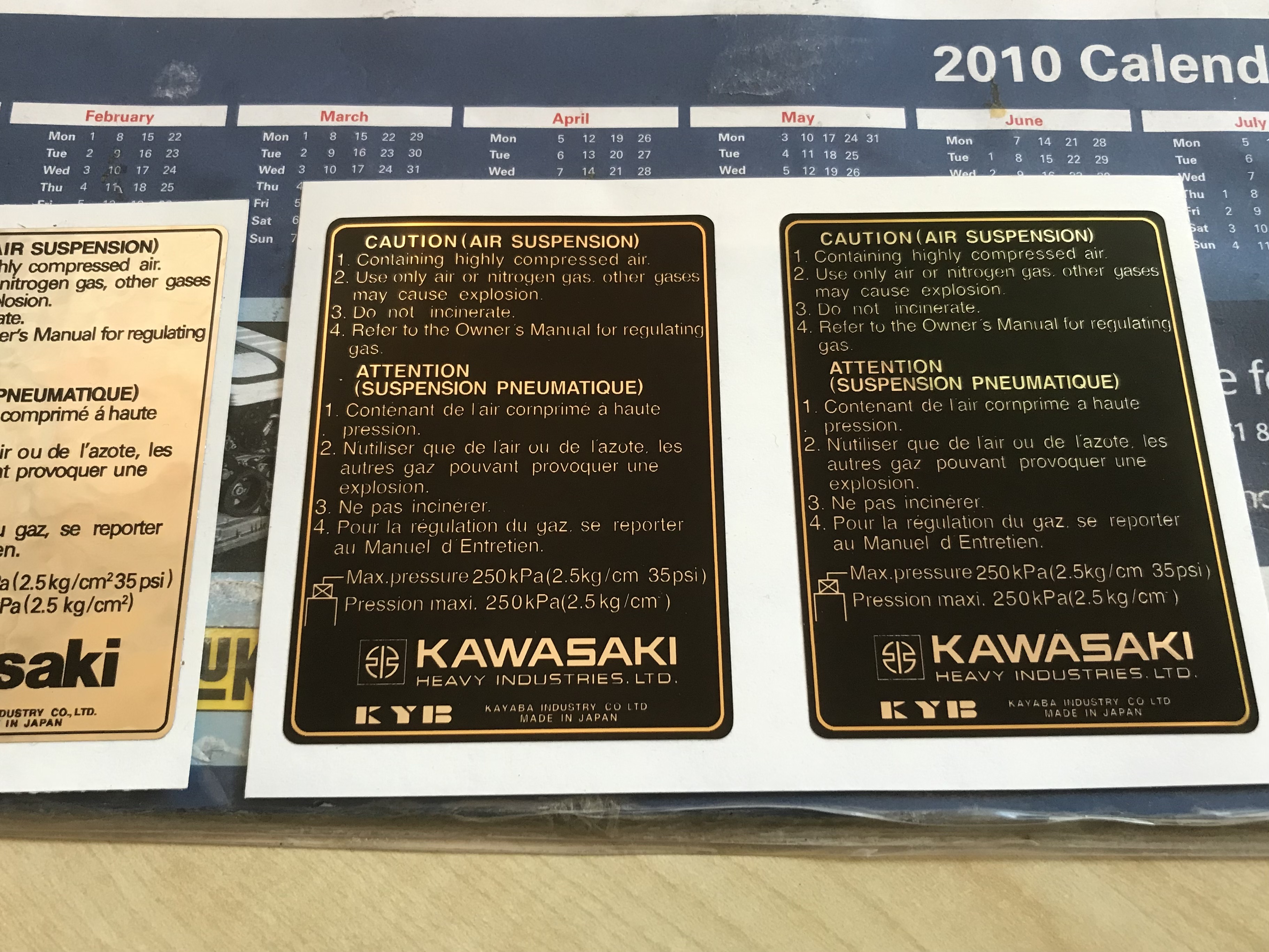

Paint is ready, I have space, at least until the engine is finished, and I have the correct decals. (Correct on the right)
There will be a few more parts to be refurbed by Mikey's magic hands but at least I can make a start.

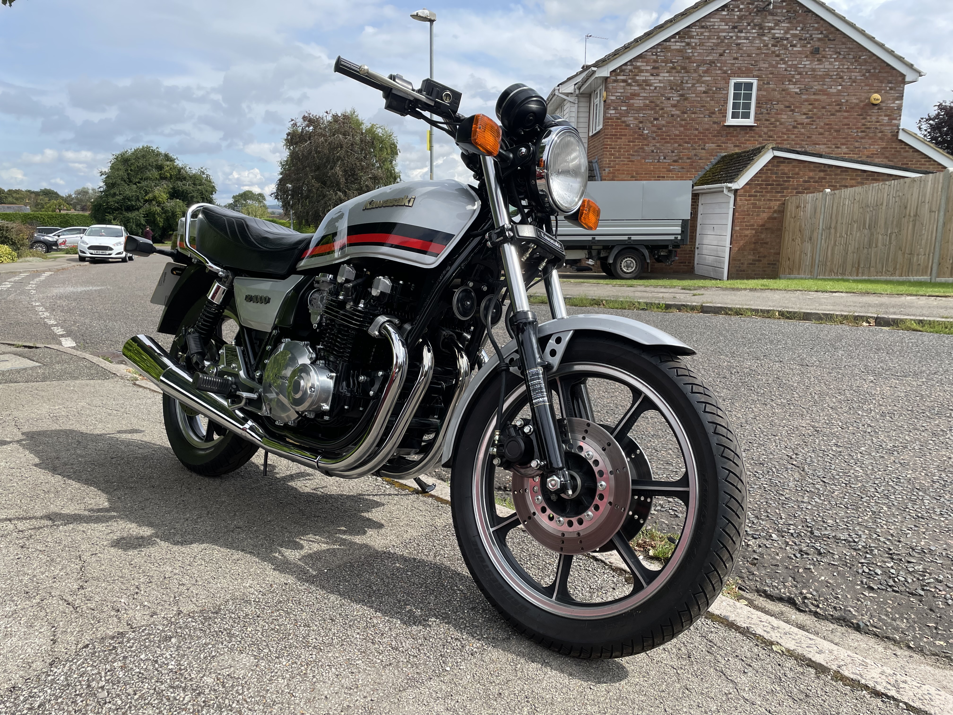

This is the last piece.
The bike will be on display at Stafford.

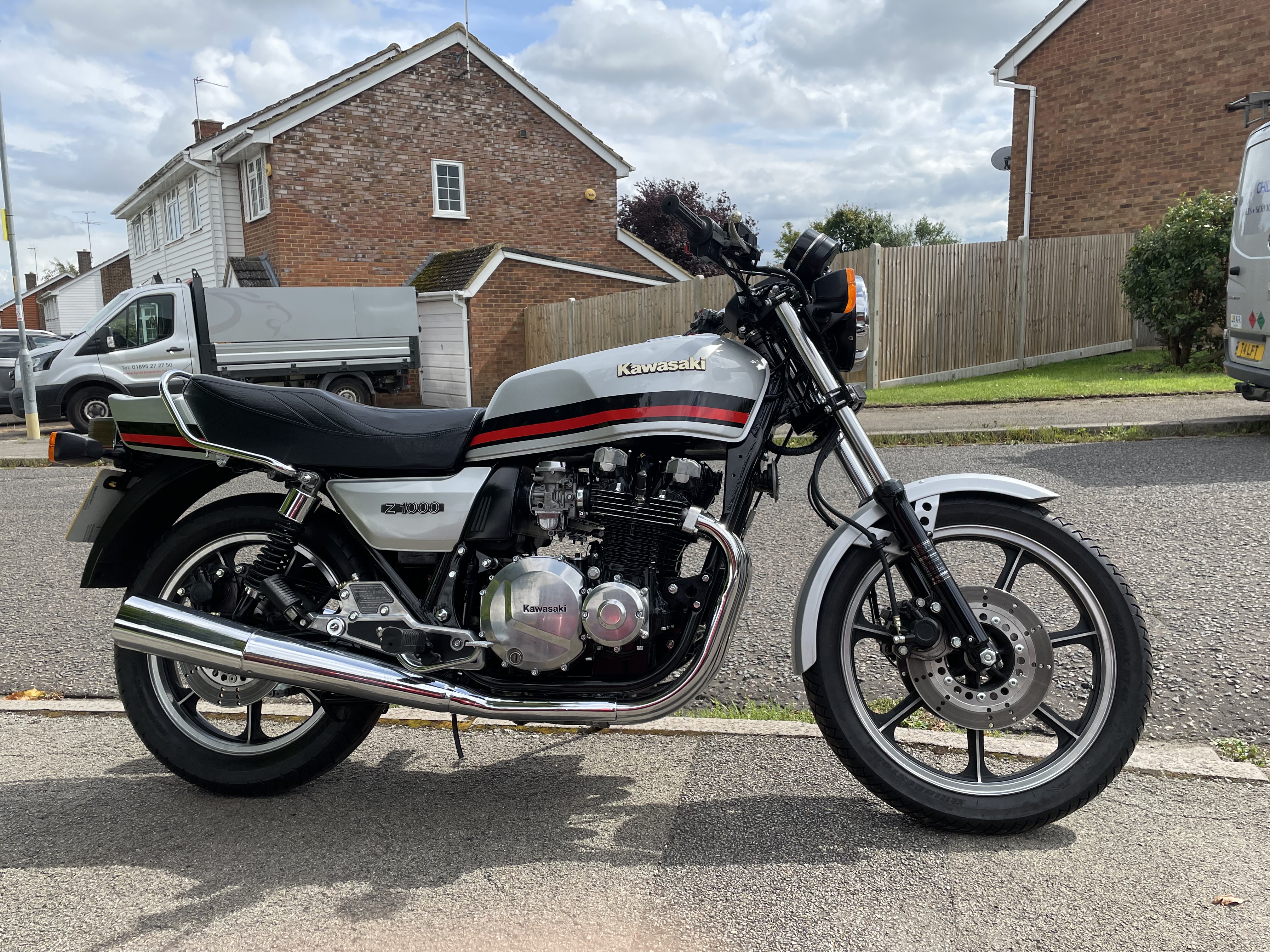

Here is the finished bike. I am now unlikely to use it so will be exploring options to sell.
I tentatively offered the bike to visitors at £12k and did discuss including it in the Silverstone Auctions sale next spring.
