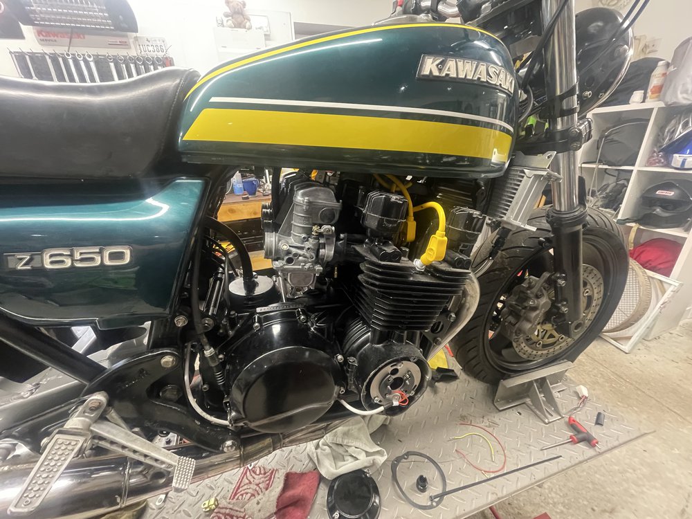

Managed to get a day on carbs today, did some plating and cleaning and looming nae bad! Bought a carb rebuild kit which is total garbage of eBay.. Apart from the gaskets all useless, so will still need to order a few bits. But happy with the progress.

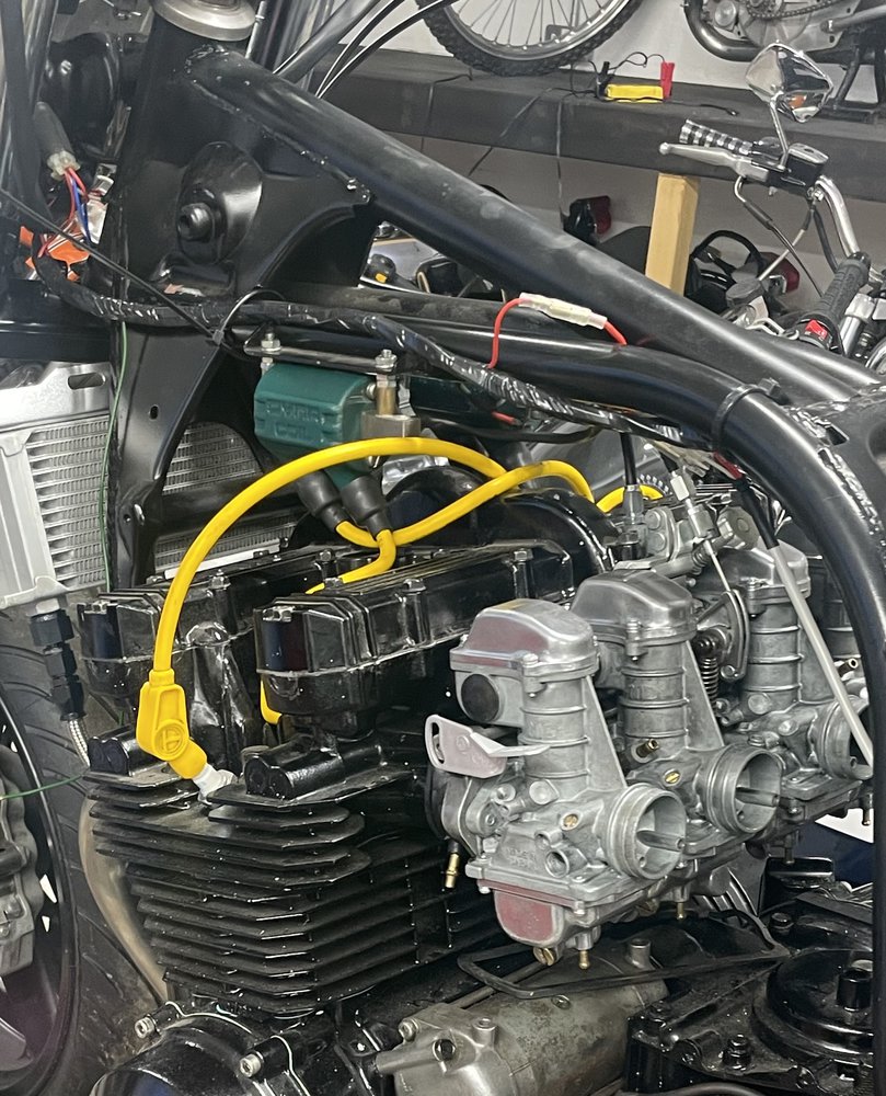

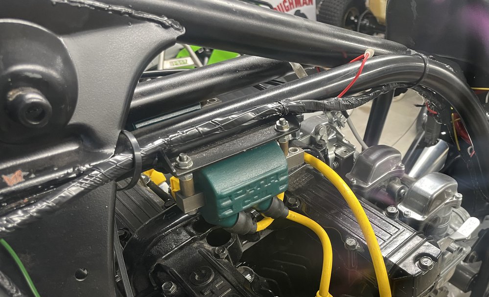

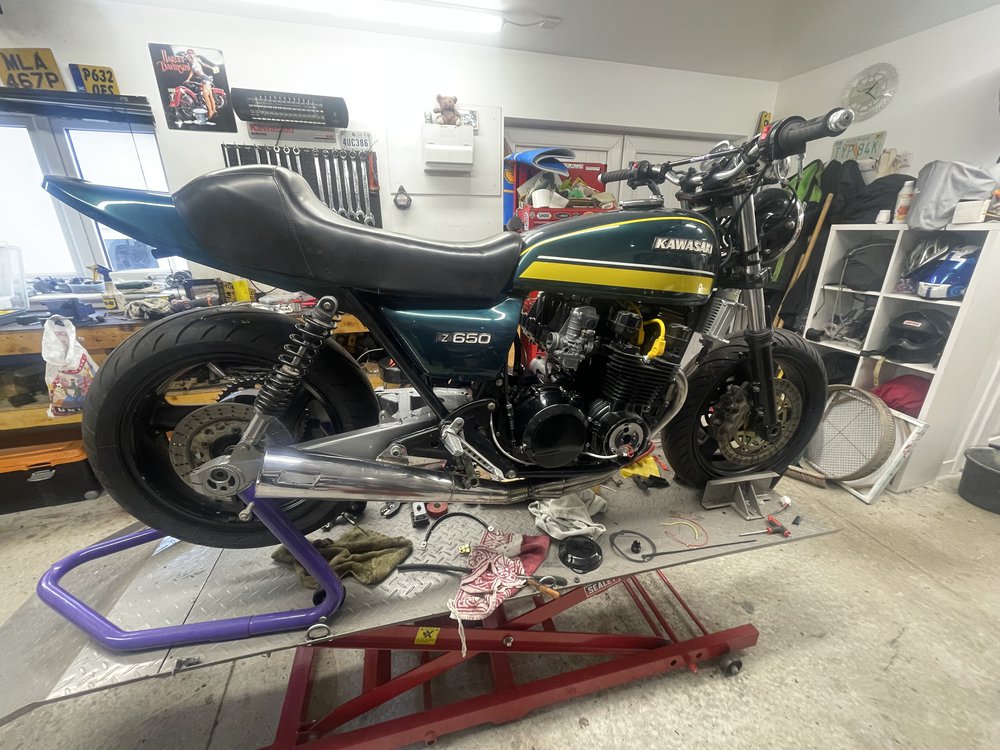

Hi All
Not posted for a while so thought I would update. It’s progressed a good bit. I built my first ever scratch built wiring loom, well happy with it as it’s a tenth of the size of the factory one and has all the functions I needed. (Ignition and lights) lol. Any nice to haves were junked. Kitted out with the finest of cheap shit switch gear we will see how long the last bit it’s coming together. All I need now to fire it up is a mechanical advancer as I can’t fine one anywhere.
Remaining jobs - Rear Brake Caliper. Brake lines all round. For filters and chain. Very close! Be ready to put away for winter lol.
