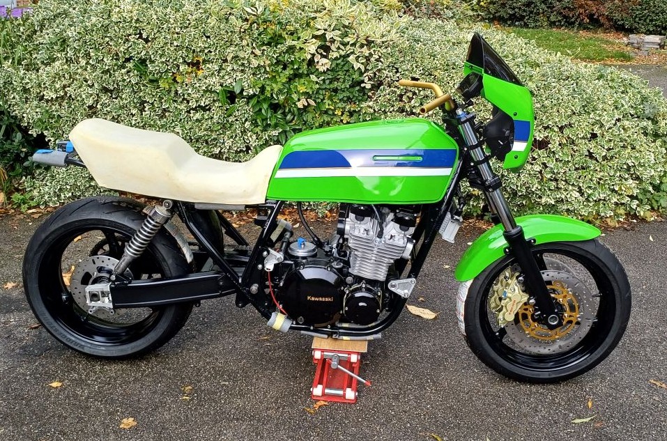

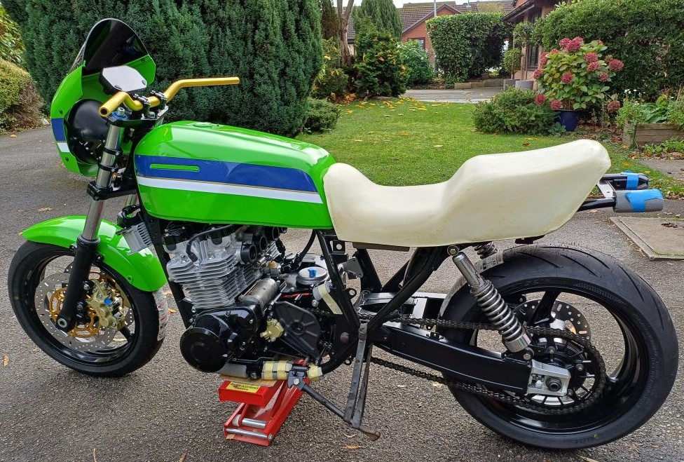

Here's an update on progress on my Eddie Lawson Tribute bike.

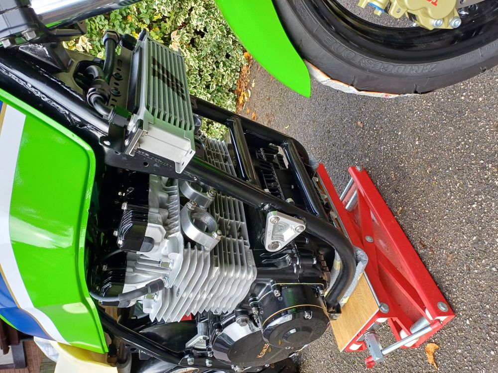

Chain and sprockets now fitted to bike, i've gone for the smallest chain that can do the job, but also the strongest, a DID 520ZVM and managed to get an offset 520 front sprocket made for me in Germany. Hopefully this gives sufficient clearance between chain and frame.
A new oil cooler has been fitted and rubber mounted and plumbed in using PTFE inner, the fittings are certainly much easier to make up than with the rubber inner.

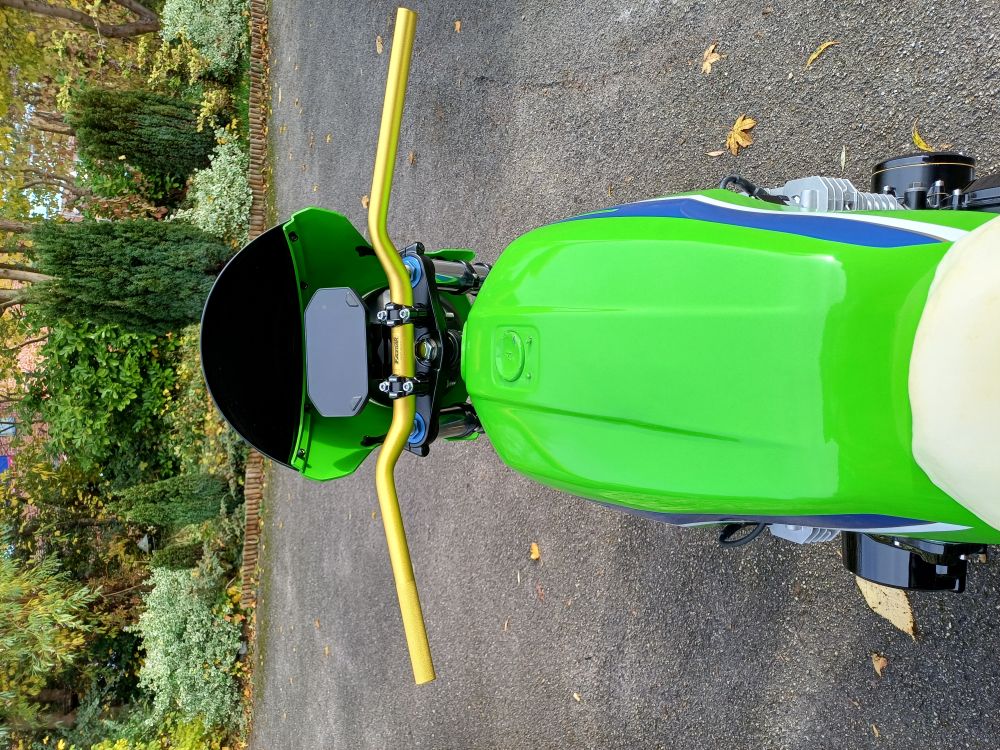

The nose fairing, instrument console, handlebars and headlight have been fitted.
There is still along way to go but I've posted a few photos of the current state of the build.
