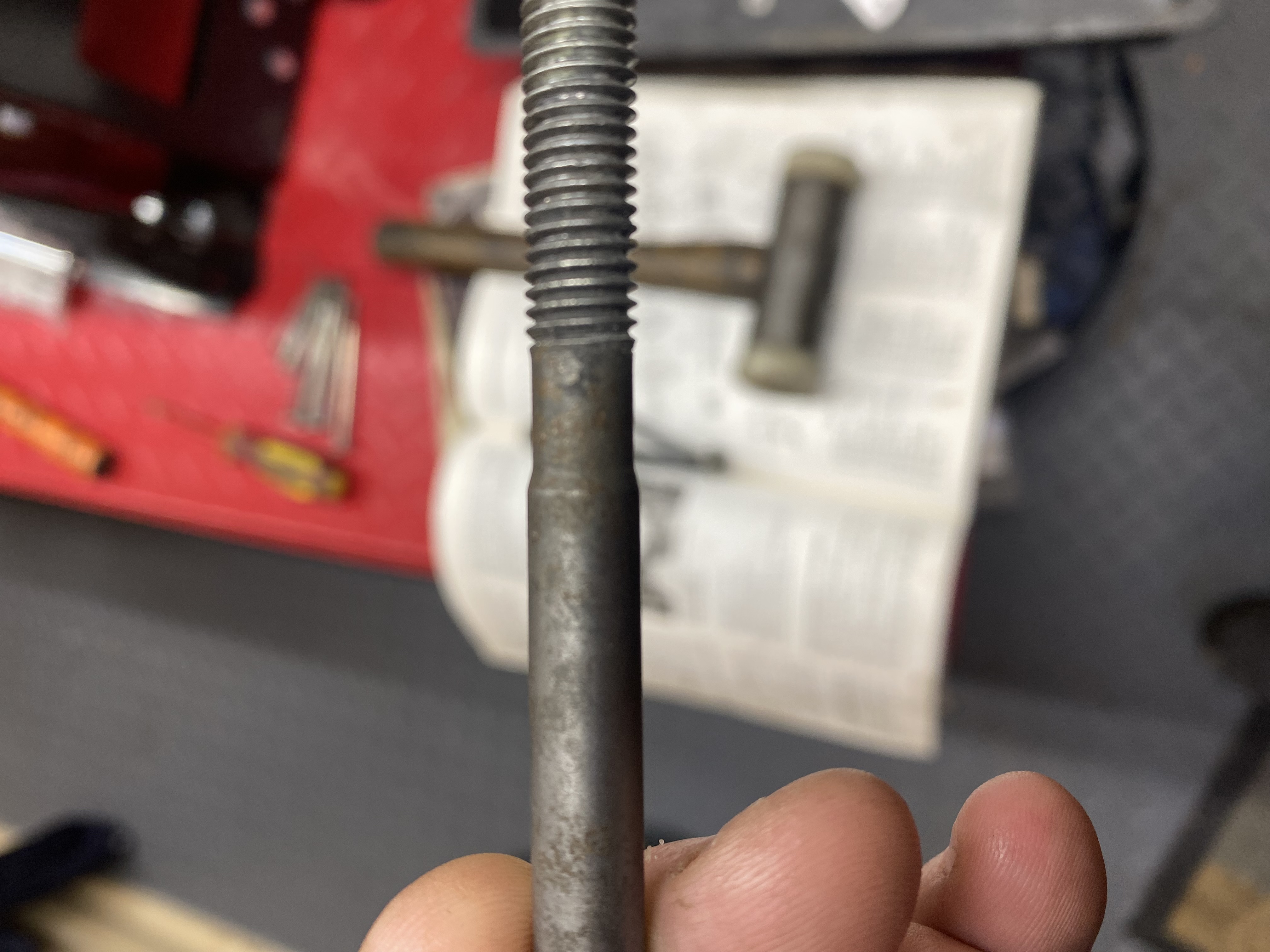

#13 PostAuthor: stusco » Fri Jan 16, 2026 3:56 pm
Getting ready to close up the bottom end, I’ve got to get the fastners plated first so im going through them and find these 2 m8x80 i think they are for crank support what is the wasted part for (where do these go?)
