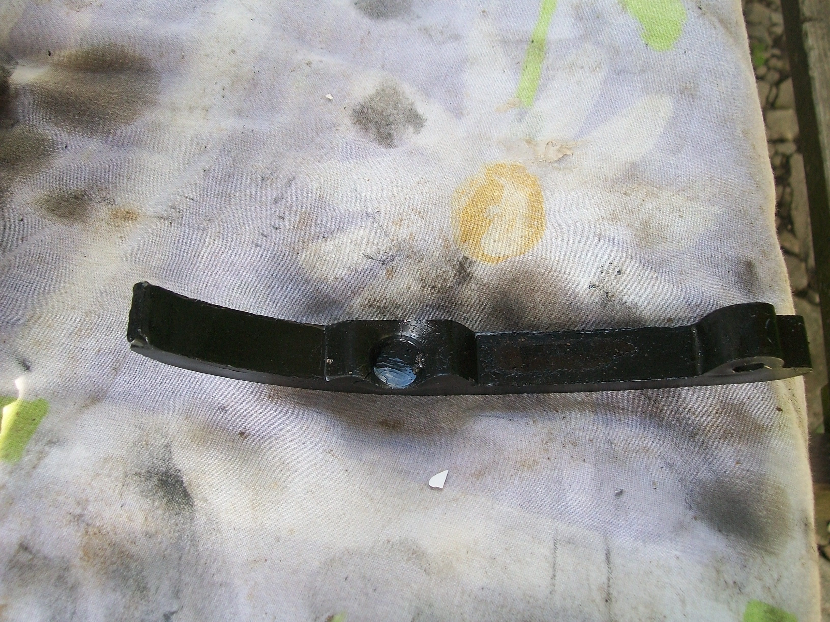

Pulled out the cam chain guide to give it a once over before fitting and found this
Is it good to go ?
Its a bad picture but it bulges out at the sides due to being squashed

stusco wrote:Pulled out the cam chain guide to give it a once over before fitting and found thisIMG_0137.jpeg
Is it good to go ?
I've got one exactly the same
It came out the engine that had siezed
, ate the cam shells and thrown some down the middle of the engine.

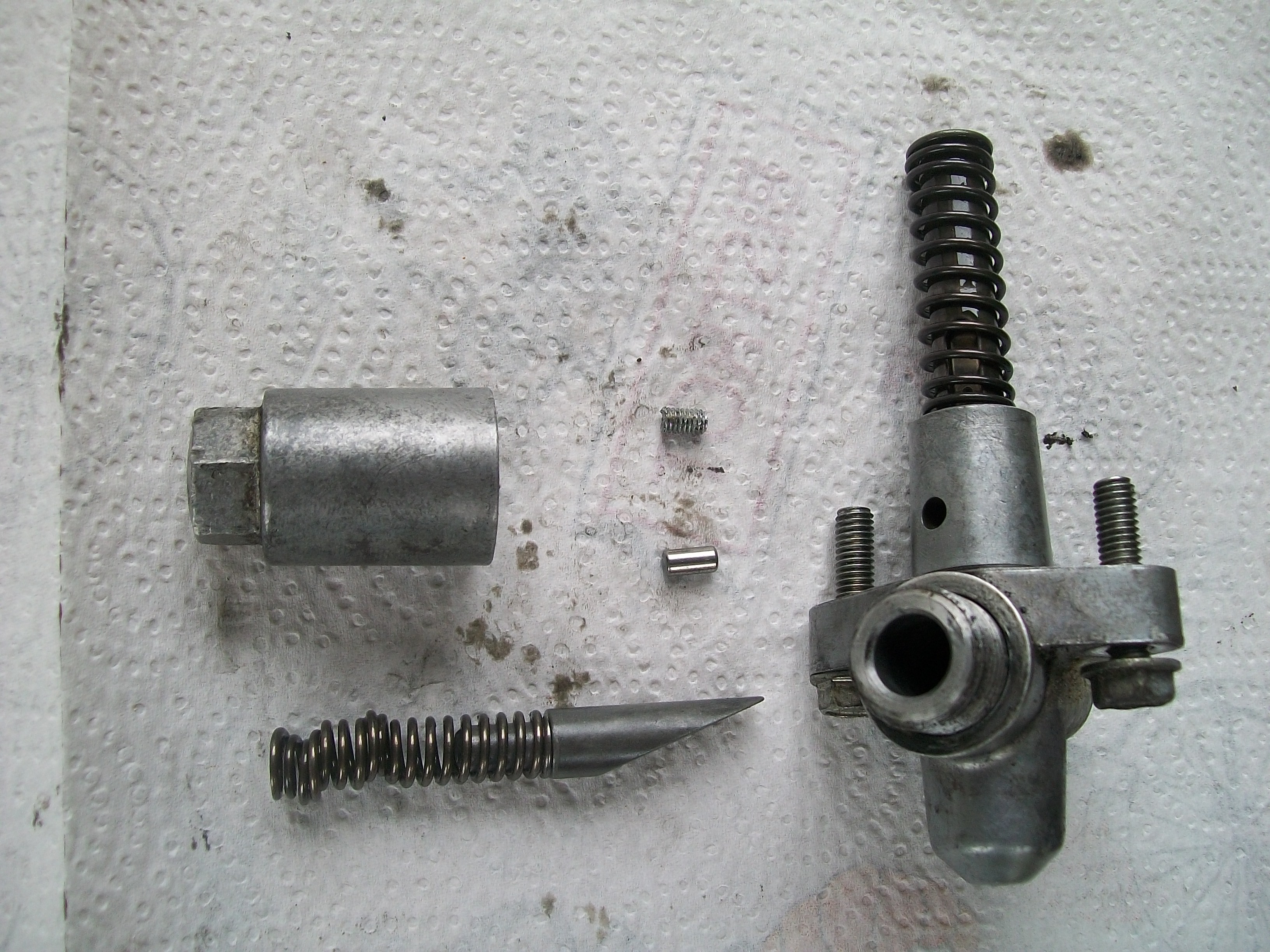

That and the fact that the camchain tensioner spring looked like this
suggested that the tensioning procedure wasn'y followed.

Different years had different amounts of circular 'O' rings round the OUTER studs where the counterbores are or are not.
Either 2 or 4 or even none, so all you do is buy that number and put them in. They actually dont really work so a bit pointless but better than nothing hence the variation in numbers as they struggled to find a solution to the weeping oil at those locations.
The rear slipper blade is a judgement call based on having it in you sight and assessing the general deterioration or overall condition. I wont or cant say just based on one photo but i will tell you i replaced mine that was just like it with the HD version that was available about three years ago. It was from Suzuki Performence Spares.
