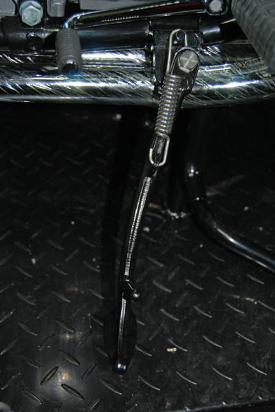

Alex, further to our chat at your workplace, whoever was the "lying little scroat" who sold you that sidestand on ebay,
you said wasn't an A4 one, was it 240mm?
I measured my A4 sidestand for you... it's 290mm from top of mounting bolt hole, to bottom tip, as shown in pic...
~Jay.

I removed the fleabay stand I'd fitted last night and it measured 260mm which answers the leaning tower of Zed question.
The original very bent stand measures 290mm - I decided to fit it last night and was able to remove one of the blocks of wood - It could be bent straight but the mounting is too stretched to go again without sleeving it - and that's not going to be cost effective.
Interestingly the one on the Ltd is off the A1 and although a touch bent measures 295mm.
ZP pattern one looks robust and very similar to the one in Jay's pic.
#P340242 and is a very reasonable price @ £36.50.
Pattern Parts do one just like it too.
#PPT896940 but it's more expensive @ £54.95
Fleabay has them listed at various prices - but I would rather have on from a trusted source.
Saisei do the z1 pattern Doremi one.
#10443 which is also very well priced - but IMO looks less robust @ £35.95

I dont think the picture of the Doremi stand does it justice. I am sure it will be the same quality as the rest.
I think this is a better picture... I will let you decide if it is "beefy" enough
:D

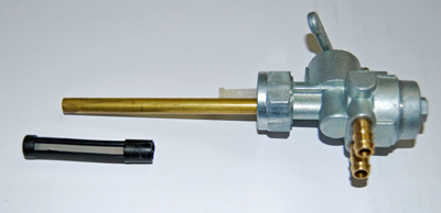

The fuel tap doesn't come with a tube filter for the 'On' position, not wanting to use an in-line filter I found one to fit the 7mm tube, It will need a little improvisation but it'll fit.

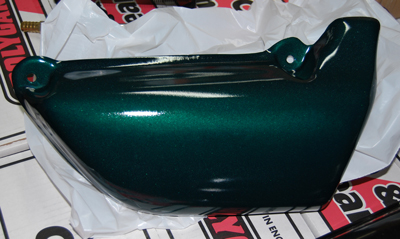

As the slot for the paintset is a while away yet, temporary bodywork is under way, ebray special duck tail under prep.
Some cheapo thin side panels were trimmed to fit - I had some Rover Green to hand - well it'll be green - ish!!

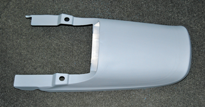

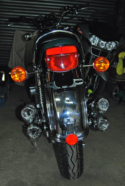

Fitted a pattern replacement side stand which has cured the leaning tower of Zed issue.
After careful consideration I purchased the Zpower Emgo Tiawaneeze option - sorry Dave :oops:
I did look at a few genuine ones, all seemed to be at best bent, the only NOS one on offer was a tad expensive.
The result is as expected - much less angle of dangle, the quality and fit is very good - happy bunny - result.

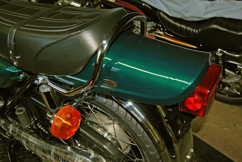

Fitted up the temporary duck tail and side panels, just the tank to go and we have a complete bike - Yay :D

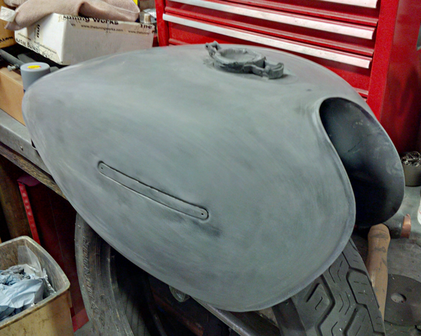

So I took the mountain to Mohammed and took the temporary tank to work - it has taken 3 weeks of ten mins here and there to sand it down, rust kill, remove multiple dents - well most of them - and get it into primer - hope to get the top coats on in the next week or so.
Badges are being treated to some airfix paint to freshen them up.
Ain't going to be a show stopper - but then it doesn't have to be.

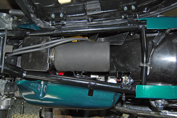

After much deliberation I decided on using the MotoBatt MB10U battery (motorcycleproducts.co.uk).
Hate the bright yellow colour - but the fiqures are in it's favour 14.5AH and 175CCA - plus the added bonus of no risk of leaking acid everywhere! black tape should hide such a sin!

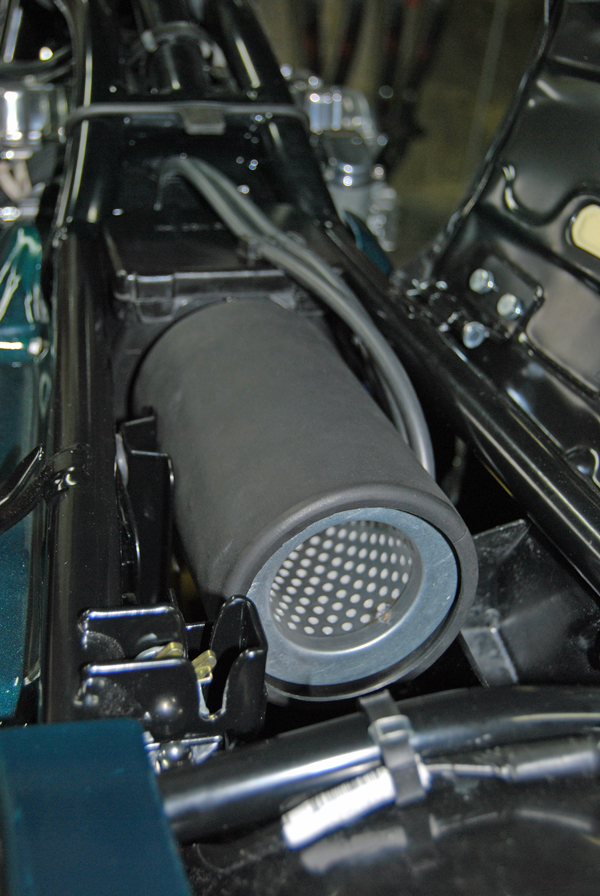

Received the very well priced replica air box silencer from Oztrailia (11016-008), looks exactly the same as what was originally fitted, sourced a genuine clamp from CMS - tick.
Shame to think how many of these are buried in landfill.........

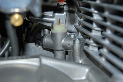

Ordered a float height gauge (the other Japaneeze manufacturer that we don't mention's one) - I did make my own out of an old sliding square - but it didn't work too well :oops:

First I fitted up the new silencer from Oz - I'm leaving the fitting of the new genuine clamp fit until the 1st service.

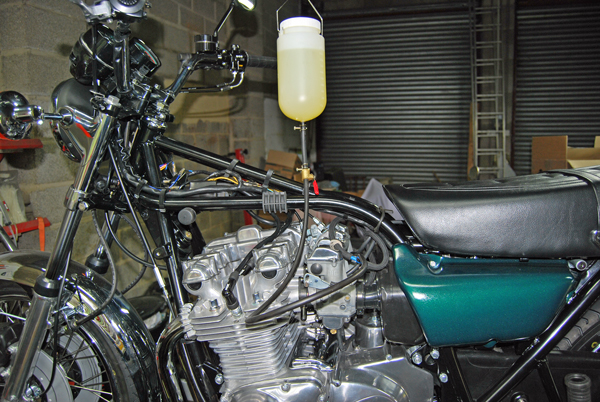

As the Ltd was still too hot to work on I rigged up my remote fuel tank and flushed the A4 carbs through - surprised to see some shards of brass in the drain bowls and some strange blackish globules!

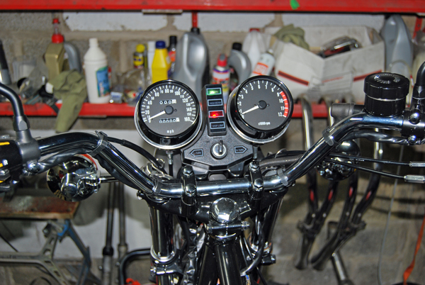

Fitted up the MotoBatt battery and turned on and checked through the electrics.
Mmmmm - oil and neutral light the wrong way round - colours are right in the headlight - wrong in the blue connector in the elec panel - swapped them round.
Tail light and brake light are the wrong way round - harness is right - rear pattern loom right - rear pattern light - wrong colours - quick swap and were good to go.
