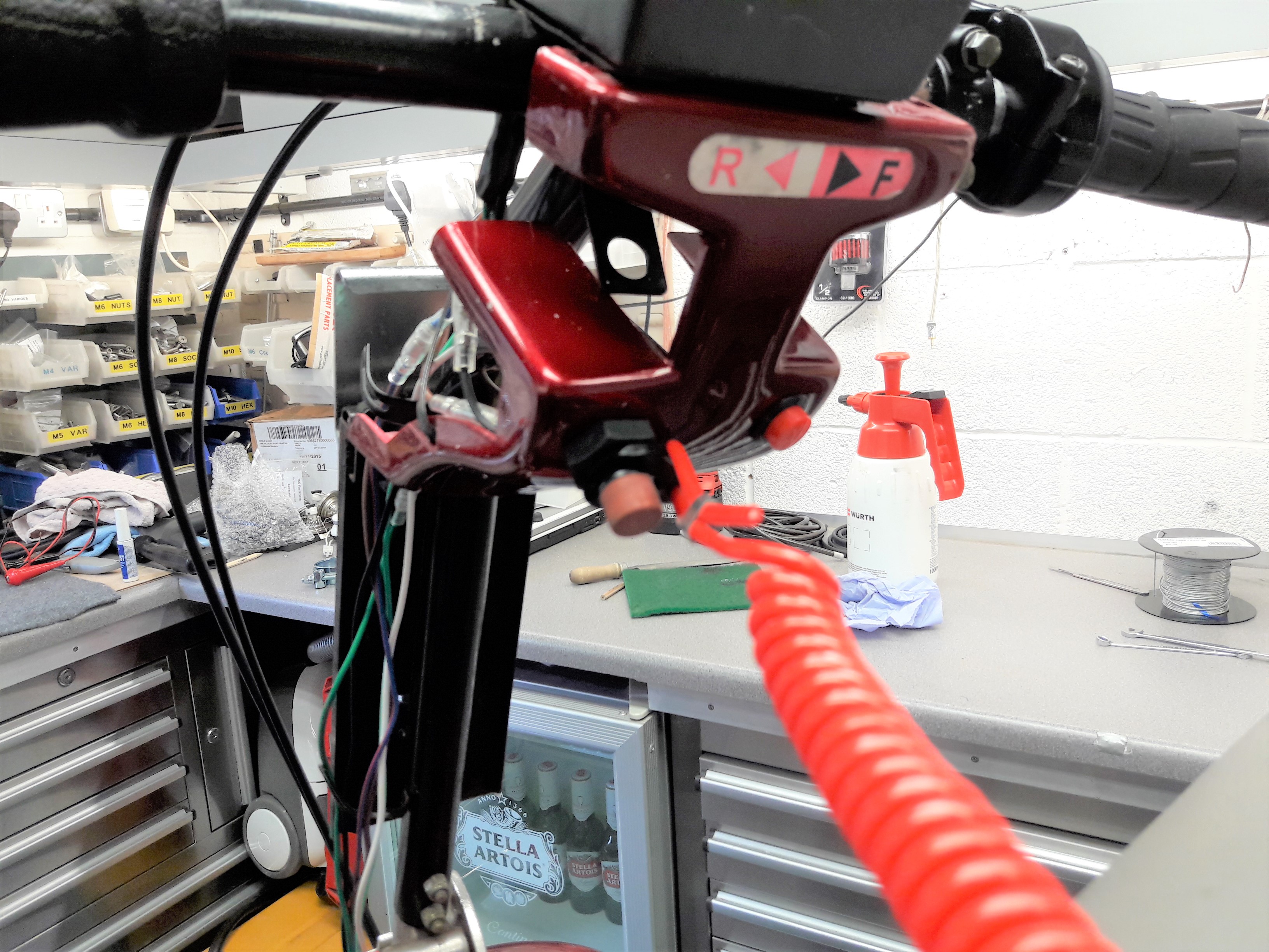

Second waste of time was my 'Safety lanyard'. Simple enough to fit, just spliced it into the main feed to the key. The thought of being thrown from the machine & then seeing it fook off up the high street did not appeal. However..... The switch I have only has closed contacts once the lanyard has been pulled. :roll: :roll: I have an alternative Durite version on it's way.

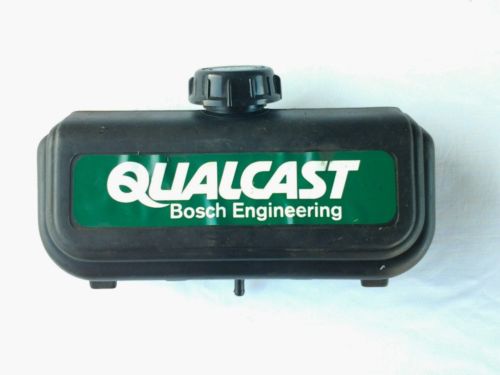

Hmmm..... Qualcast might have something to say about that.
Original Item......
I'll advise on 'shake'down nearer the time. Time and venue will be on a 'need to know' basis. :sou

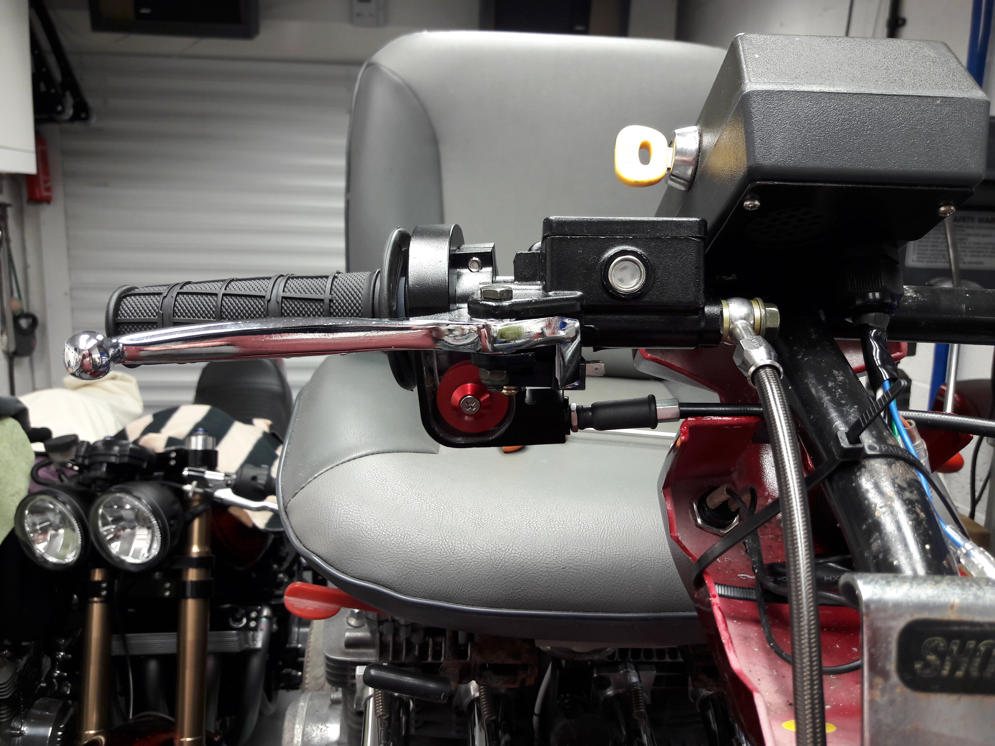

New 1/4 turn quick action throttle assembly fitted.
Brake lines made & plumbed in.
Next job will be to fit clutch outrigger, fab lines & bleed it all up. Then we're pretty much good to go. :yay :yay :yay
