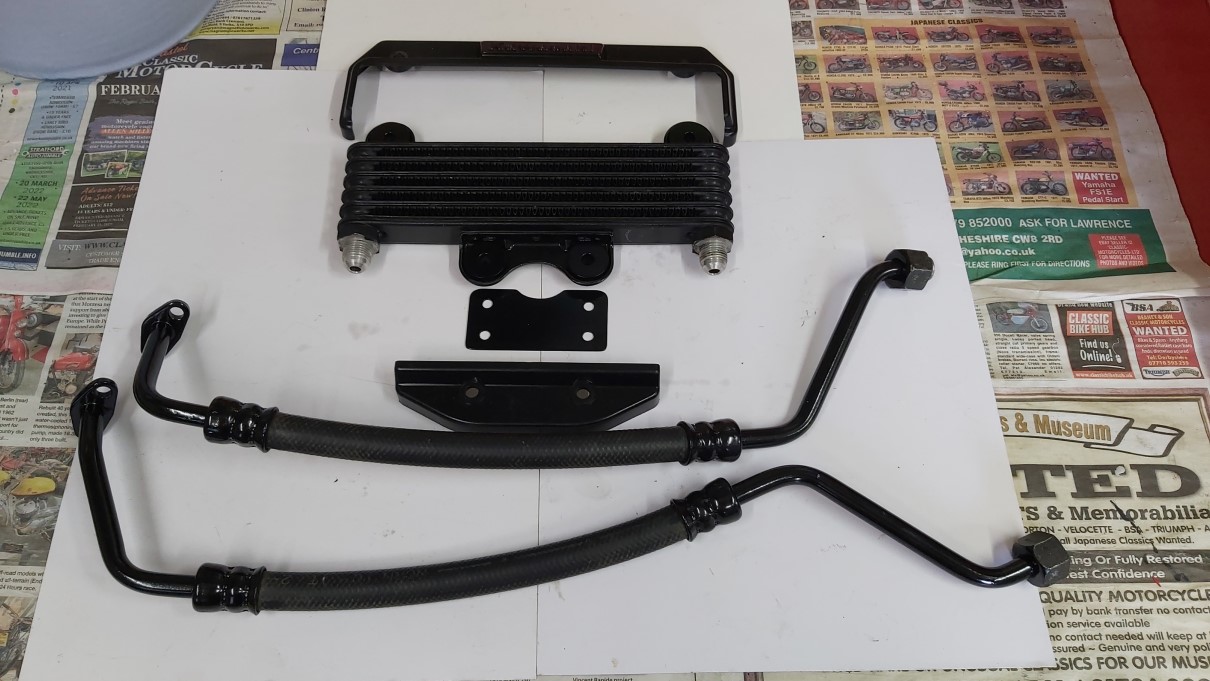

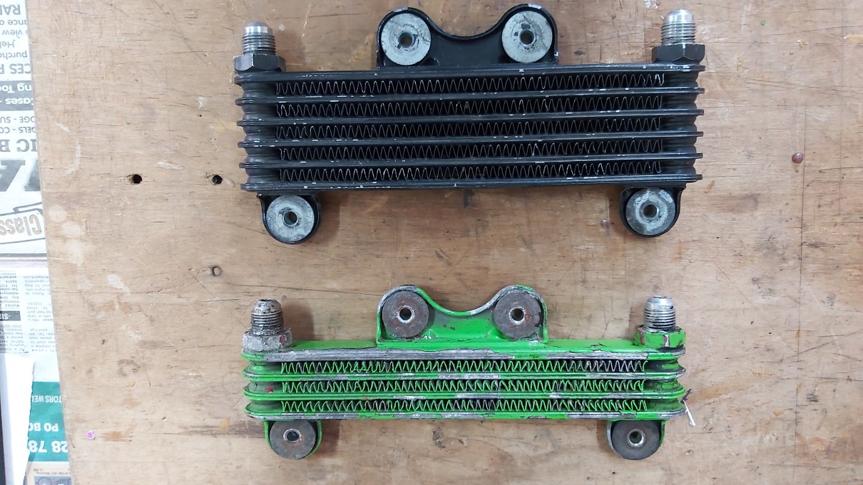

Anyway, I tried to keep moving along with little jobs I could fit in, one of which was the oil cooler. As standard the GPz had small 3 row cooler fitted as standard. But I wanted to get a bit more oil cooling area, as I have fitted a big bore kit and the barrel liners are a bit thin ! I did look at aftermarket coolers, but they were quite a bit deeper than the standard item and would require a bespoke mounting bracket fabricating. After mocking it up in cardboard and taping it to the frame I found it would likely cause issues with the fork legs hitting the cooler/bracket near full lock. So after some investigation, I found that certain models of the later GPz had a 5 row oil cooler as standard. I reasoned the extra 2 rows would give me extra cooling area and being a standard part, should also easier to mount. I sourced a good used one, including pipes, from Germany and found the upper mounts were identical and by making up a small bracket I could use the existing lower frame mounts to the new cooler lower mounts. The cooler only required cleaning & touching up the paint, but I resprayed the black pipes to freshen them up.
I'll fit it to the bike once I have the engine finished up, which should be the next job, now I have a dry garage
New cooler top, standard below
Refurbished cooler/pipes & shrouds with additional mounting bracket

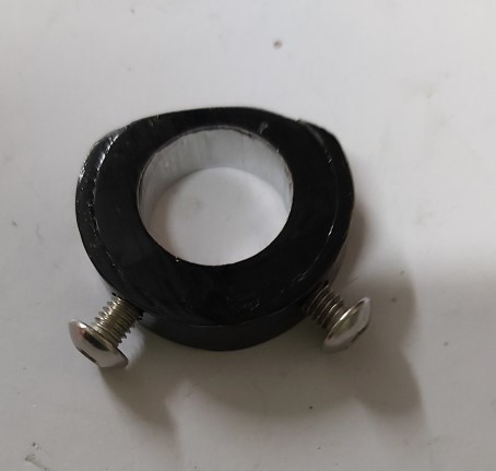

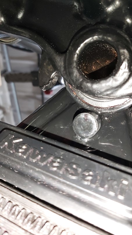

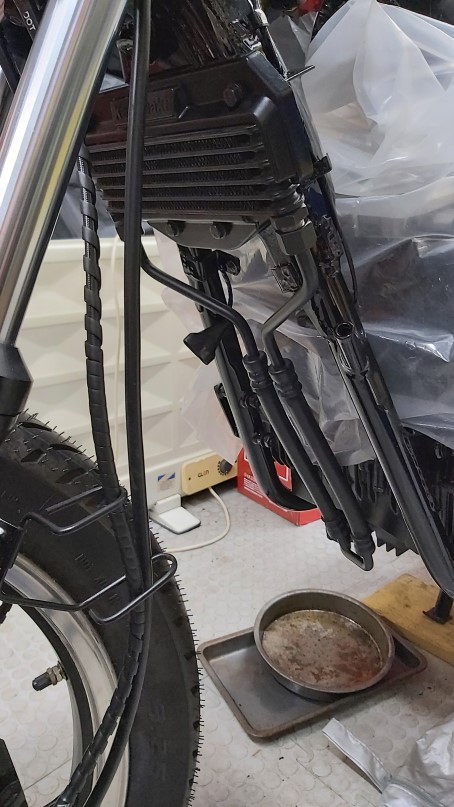

So, after my last update I thought it would be a fairly straightforward job to mount the oil cooler & pipes - but no ! When I tried to line up the pipes to the cooler, they wouldn't sit right at all. After a bit of head scratching, I worked out that the oil cooler was sat too low and by moving the oil cooler to use the original lower mounting points, the pipes lined up ok (remember, I'm using a larger cooler from the later 550 and had originally re-used the upper mounting points). So, I made up some small brackets to bridge the gap between the original upper mountings and where the oil cooler now sat (only about 25mm) and everything went together OK. great, simple fix and on to the next job I thought - but no. When I turned the bars I found the lower yoke now fouled on the upper edge of the cooler before full lock - arrrgh
The lock stops on the lower yoke use a solid peg protruding from the lower frame as the stop. Looking at it, I reasoned I could make up a collar to slip over the peg and reduce the amount of lock to stop hitting the cooler. So, using some ally tube with the correct i/d, I made up a collar and tapped in a couple of M4 button head bolts to help secure it. I also used JB Weld to hold it in place as a belt & braces approach. I'm happy with the result, it's worked out well and I don't really lose that much lock and it doesn't foul the cooler any more
I did also get the cooler pipes ceramic coated as the paint I applied marked really badly during the trial & error of fitting. Whilst the ceramic coat looks good, I was disappointed to find out it also marked during fitting - especially on the upper nuts where the spanner left scratches even though I was as careful as i could be. Perhaps ceramic coating is not as tough as I had believed ???
Anyway, looking forward to making more progress, but without the little diversions
Oil cooler in place
Lockstop peg
Collar ready to fit
and in place
Oil cooler in place
Lockstop peg
Collar ready to fit
and in place

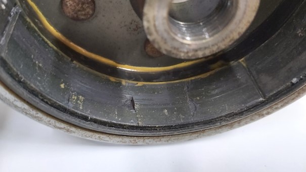

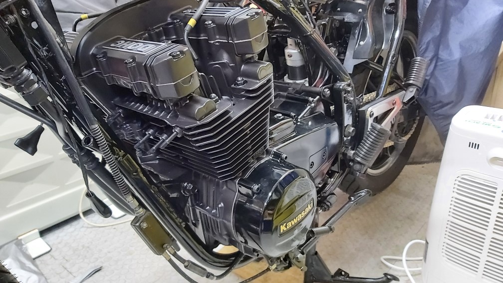

Last weekend was a good weekend in the garage and some major progress has been made on the 550
There was, of course, the obligatory last minute issue to overcome but even that had a positive outcome !

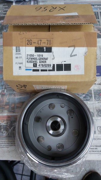

The plan was to get the engine completely oil tight and all the ancillary components & covers fitted, which would be a major milestone in the rebuild. During last week, I spent an evening in the garage getting everything ready in preparation for the weekend. However, when giving a last minute checkover of the alternator rotor, I found 2 sections of the magnets had cracks and one had a small piece missing
I went on the internet thinking I might find a better secondhand replacement but actually found a brand new NOS one for £60
No thinking needed there and 3 days later it was in my garage !
Old Rotor
New Rotor
With the rotor issue resolved it was time to crack on and work through fitting all the bits & pieces ! The cam cover went on first (after copiously oiling the cams & valve buckets), followed by the NOS alternator cover and ignition cover with their badges. Next on was the clutch cable, which also retracts the side stand if you leave it down, followed by the clutch cover, the starter cover and suddenly there were no more bits in my box. It all sounds simple put like that, but there was much fitting/removing/fettling to get everything to sit "right", especially the clutch cable & cover, but it was all worth it !
I'm know I'm biased, but I love the all black finish of the GPz
Old Rotor
New Rotor

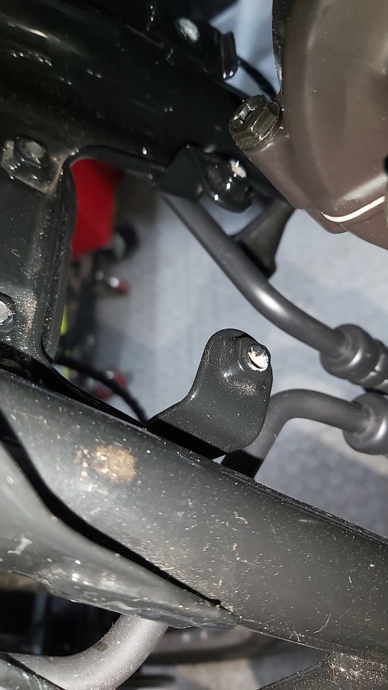

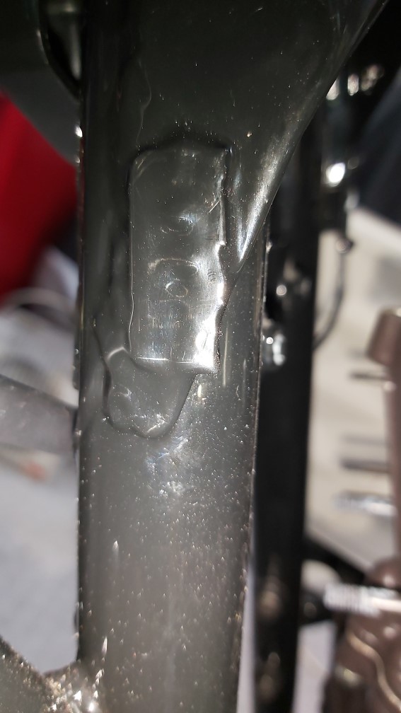

As everything comes in threes, the last problem was I found a broken & missing bracket on the frame. It's for one of the dual horns to mount on and it obviously broke years ago, but I just didn't see it was missing before getting the frame powder coated right back at the start of the project. Now looking at it, I have 3 options -
1. Run with just a single horn
2. Fabricate a bracket and find a good TIG welder to weld it back on the frame. I say TIG as I think it would cause less damage to the powder coat than MIG ?
3. See if I can find an alternate way to mount the second horn. There are a couple of spare brackets I might be able to use but the bracket would be fairly long and convoluted
I'll have a think about which will be the best, but the perfectionist in me wants to re-instate the original bracket - we shall see.
This is the exisiting bracket on the R/H frame downtube
This is whats left of the L/H bracket - only a small piece still attached to the downtube

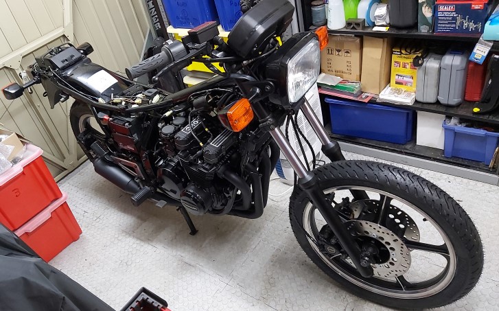

I've put the horn bracket issue to one side for the moment as I may have a solution that doesn't involve welding, but thanks to Moizeau for the suggestion on using a single side spot welder or puddle weld - I'll keep that in reserve

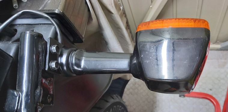

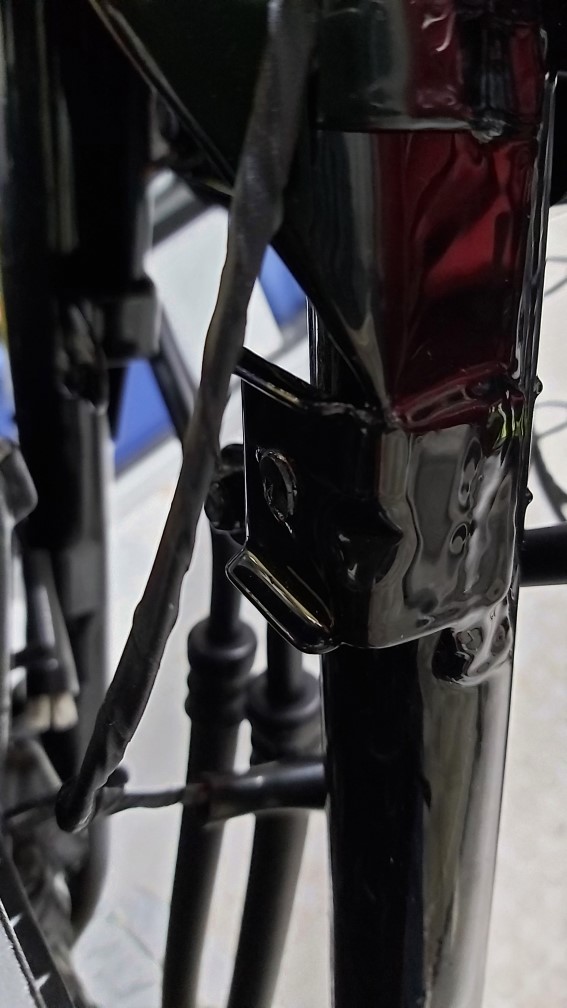

First item on the agenda was to straighten out the indicator bracket after last weeks mishap. The actual indicator bracket was fairly easy to straighten up in the vice and a quick repaint had it looking good. The mounting plate on the frame needed a bit more thinking about. In the end, I fabricated a plate that I bolted onto spare holes in the frame and used a bolt to pull the bracket straight. it worked great and didn't even crack the powder coat
Good as new !

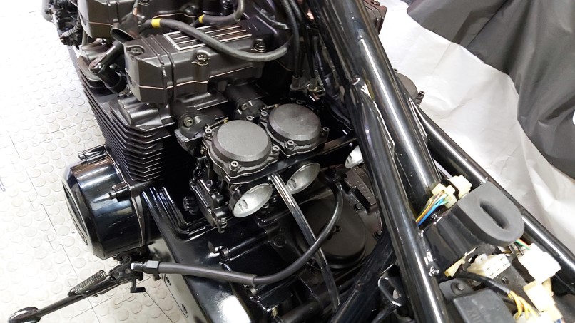

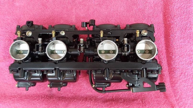

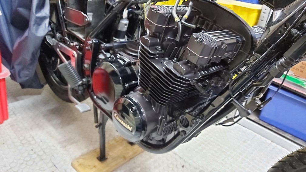

Next up, I rebuilt the carbs with all new "O" rings and gaskets. All the other original parts were re-used as still serviceable. I bench tested them with a dummy tank and It took a couple of attempts to get the float heights right, but eventually they stopped overflowing
The head to carb rubbers needed blending in to match to the carb bores as the rubbers are 30mm i/d and the carbs 32mm. Once matched up, the rubbers were attached to the head and the carbs slotted in. It took a few attempts to find the best route for the throttle cables, but I got there eventually.
Freshly rebuilt
and fitted

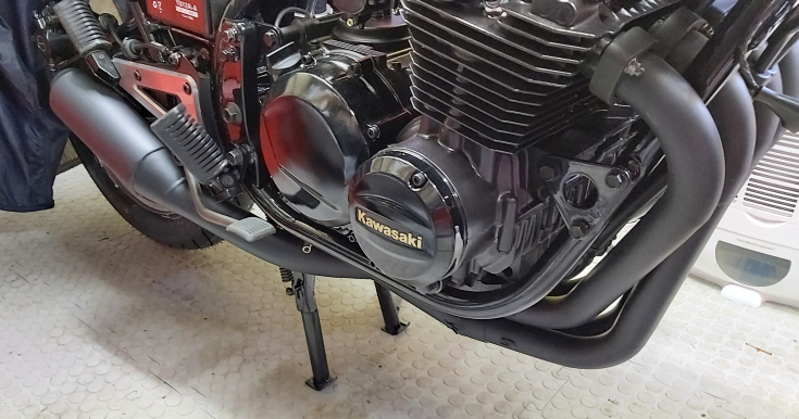

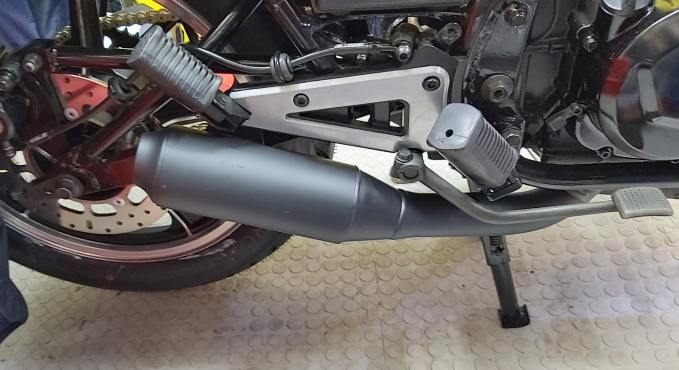

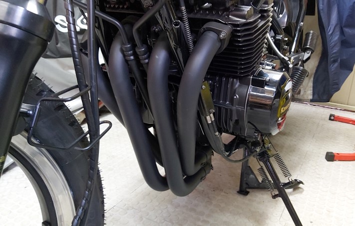

Then it was time to fit the exhaust. This is a genuine Harris system I fitted back in the late 80s. I documented the repair & coating a while ago, but now was the time to see if it was worth it. Even though I had numbered the downpipes, I still managed to get no 1 & 2 mixed up ! With that little mishap sorted, the end can went on and it was then I remembered just how close the end can bracket was to the swingarm. Not wanting to tempt fate, the end can came off and the bracket was relieved to give more clearance. A quick touch up with cylinder black (you cant see where I've relieved the bracket as its on the inside) and back onto the bike. Bolt up the header clamps to find header pipes 1 & 2 are touching. off with the can again - more fiddling & fettling, but eventually I got it to sit right, although there's still minimal clearance where 1 & 2 cross over. I think I also remember this from back in the day, but I may just be imagining it
Headers on
add the end can
with just enough clearance !
and you have a Harris pipe - lovely
Almost a runner
Next time I post an update, it might just be a runner
Good as new !
Freshly rebuilt
and fitted
Headers on
add the end can

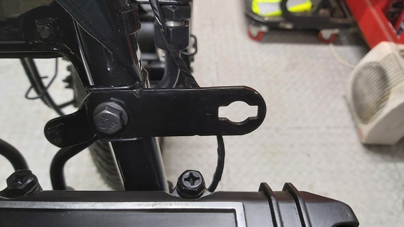

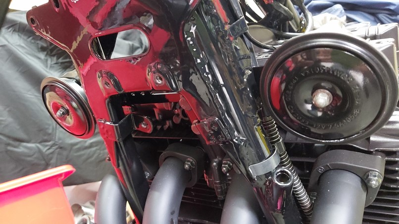

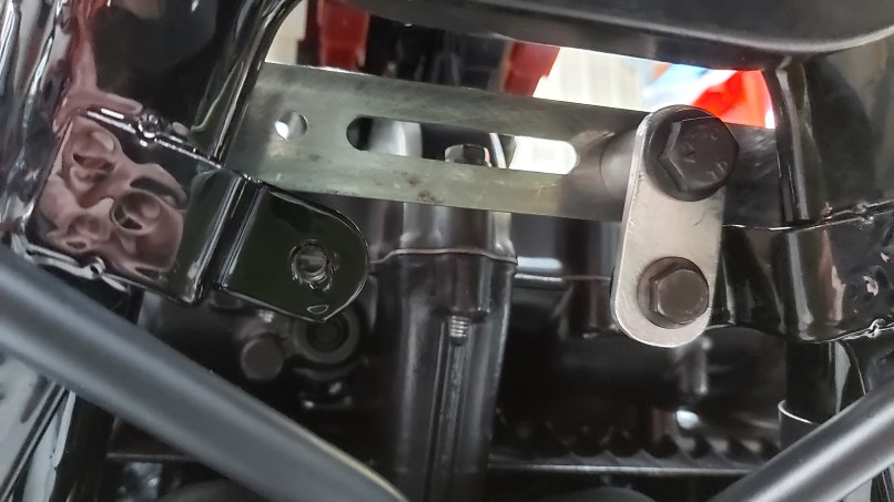

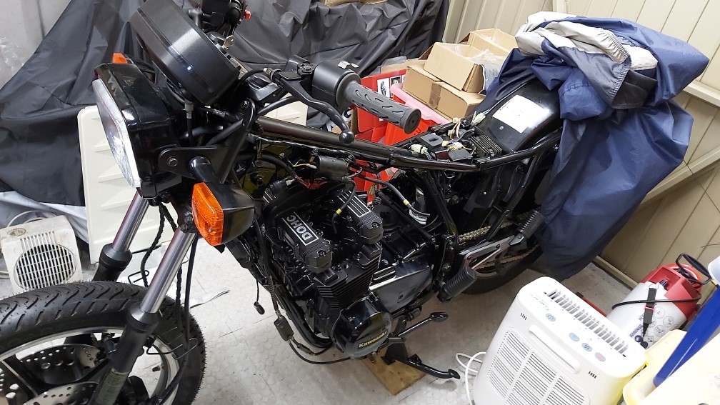

Well, the 550 isn't a runner yet - there's some electrics to sort out and I'm waiting on some help for that, but there's still jobs to be done :-)

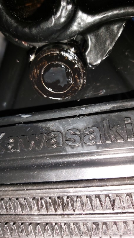

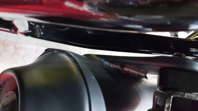

First up was a slight issue with the oil cooler pipes, when I noticed one of them was touching the no3 header pipe :-( A lot of head scratching followed trying to work out why and I thought I'd have to drop the exhaust off (again) and put a slight bend in the oil pipe to clear it. But first I thought I would try loosening off the oil cooler bolts to see if I could get enough movement to get clearance. Once I tried that, it became apparent the top holes in the 2 small brackets I made up to bridge the top cooler mounting points, were slightly out of line - only a couple of mm, but enough to put the oil line slightly off line. Elongating the holes slightly brought it all back into line and problem solved :-) I will look at making those brackets again at some point in the future, but for now they'll do !

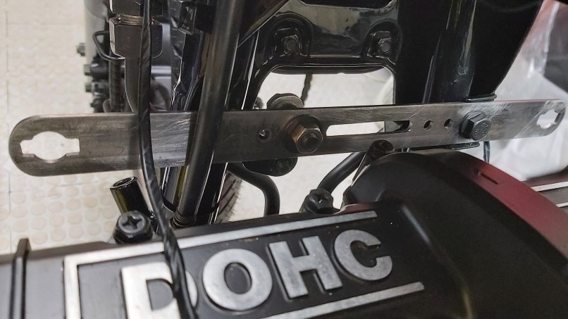

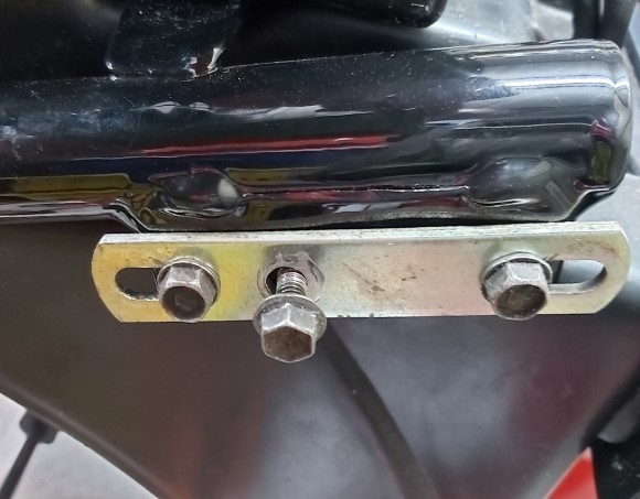

I was having a coffee and a chat with a mate whilst showing him progress on the GPz. As he's an aircraft engineer, I was picking his brain on the best way to replace the missing bracket - possibly welding as I'd already discussed or some other way of getting the horn mounted on that side of the frame. After looking at the problem he suggested making up a single bracket the spanned the width of the frame - use the good mounting point on one end and make up a tie bracket from the spare lug I'd already identified to support the other end - genius
So that's what I've done - I've fabricated a bracket for the horns and a tie bracket, using the redundant mounting point on the frame for the USA spec "Reserve lighting device".
So this is the original bracket on the good mounting point
Here is the new bracket in place - the slot & holes are there for airflow as I was worried about obstructing air over the head as the new bracket sits right in front of the cam cover
It's supported on the other end by this bracket & spacer on the unused frame lug
It'll all be sprayed gloss black before final fitting and I doubt you would spot it if you didn't know it was there. Sometimes it takes a fresh look by someone else to come up with the best solution

A little progress on the GPz but, as always, there's a step backwards as well

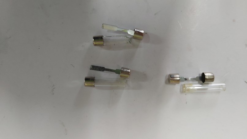

The electrics have been completed thanks to the ubiquitous Ferret, but not without a couple of issues (not his, I might add !) After all the work was complete, I turned the switch and............. nothing. This was traced to a faulty main fuse, so I used another new one and the same thing happened, so I tried another and guess what - another faulty fuse
Out of a pack of 6 new fuses, the first 3 were duff
The rest went in the bin and Ferret fitted one from his stock and we had life !

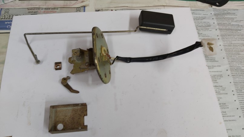

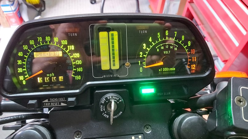

The fuel level indicator was not displaying correctly. A quick check pointed to the sender unit, so I stripped it and found corrosion inside. After a clean up and re-assembling all was good.
I haven't seen this light up for a good many years !
The next day, I went into the garage thinking I was getting close to the GPz bursting into life again, but a simple check suddenly had me on the back foot. I went to put the steering lock on and found it wouldn't engage. Strange, I know it worked earlier in the rebuild as I tested it. The came the inevitable light bulb moment. You remember the issue I had with the forks hitting the oil cooler and how I made up a sleeve to restrict the lock - well as I couldn't now get full lock , the steering lock wouldn't engage - Genius, NOT
How could I miss something so obvious...................................
So, I've had to remove the lock stop and the oil cooler has had to move back to it's original position, which now means the oil lines are too long, etc ,etc. So I'm back to square one with the larger oil cooler. So I now have to modify or replace the lines. I've asked the question in the "help" pages as to whether this is possible so we'll have to wait and see what happens there.
The rest went in the bin and Ferret fitted one from his stock and we had life !The fuel level indicator was not displaying correctly. A quick check pointed to the sender unit, so I stripped it and found corrosion inside. After a clean up and re-assembling all was good.
How could I miss something so obvious...................................So, I've had to remove the lock stop and the oil cooler has had to move back to it's original position, which now means the oil lines are too long, etc ,etc. So I'm back to square one with the larger oil cooler. So I now have to modify or replace the lines. I've asked the question in the "help" pages as to whether this is possible so we'll have to wait and see what happens there.
