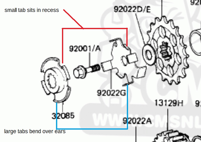

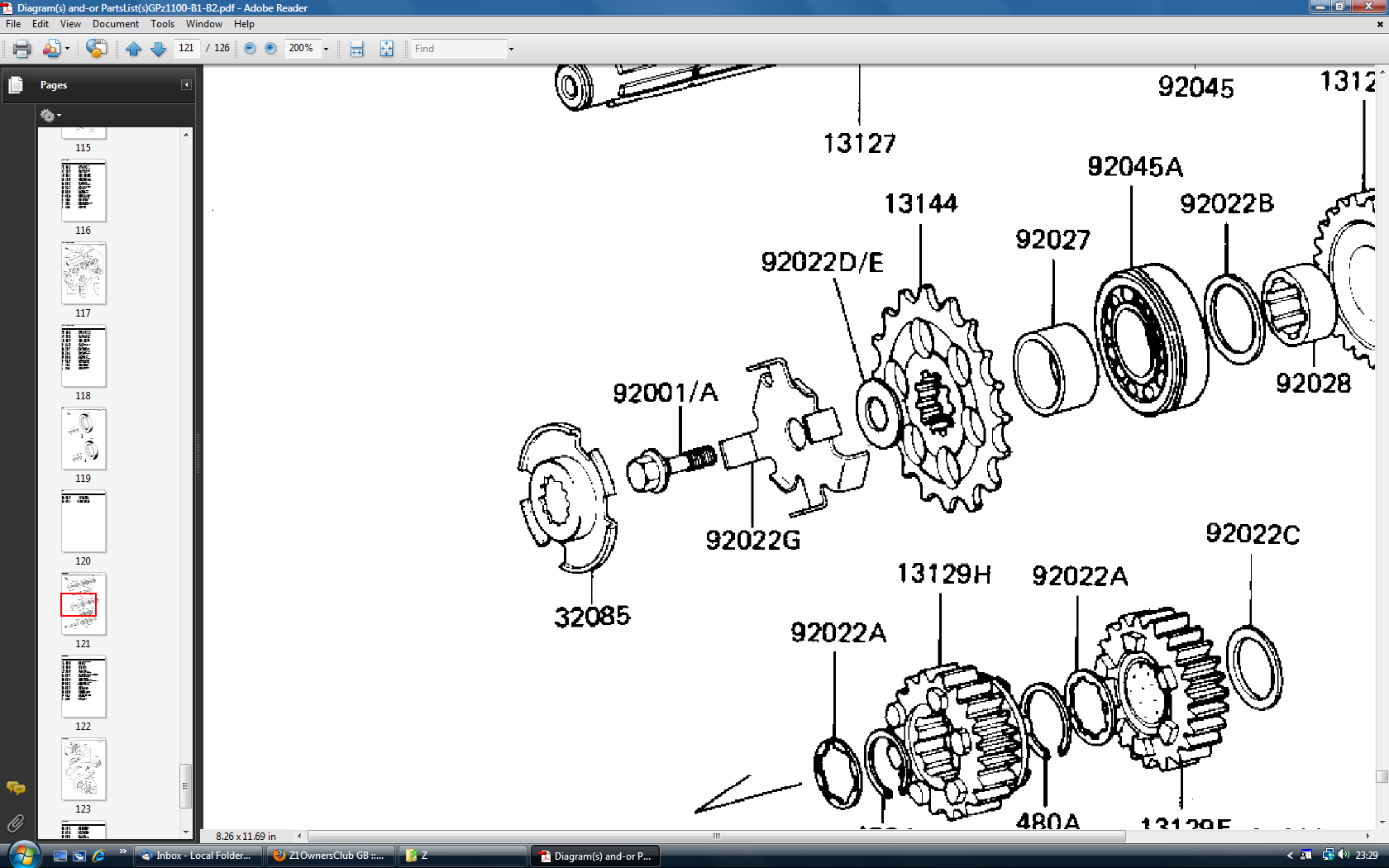

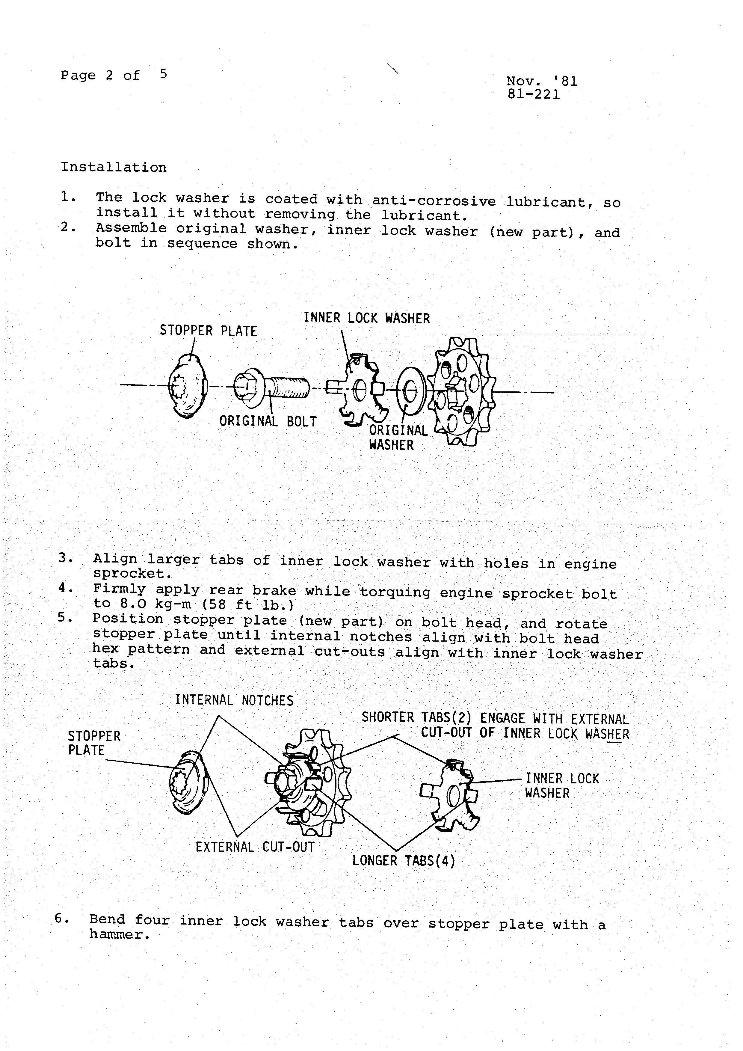

The B1 engine uses these so called 'stopper sprocket' along with a bolt to hold the front sprocket on the shaft. Not sure how they are supposed to work, but anyone know of a source? And if not, what do you use instead?

#127 PostAuthor: Al » Wed Sep 08, 2021 8:24 pm
Have seen them before on ebay.

#131 PostAuthor: lude » Thu Sep 09, 2021 10:33 am
WASHER SPROCKET STOPP
product number: 920221351
Hurry: only 1 left!
https://www.cmsnl.com/kawasaki-kz1100b1-gpz-1981-usa-canada_model15432/partslist/62236.html#.YTnij98o87I
sprocket locker.jpg (103.13 KiB) Viewed 140348 times
The small tabs do all the work stopping the stopper (32085) rotating, the large tabs stop the stopper riding over the small tabs. Without the stopper being able to rotate there is no pressure on the big tabs. I suspect on many chain and sprocket changes the old inner sprocket stopper (92022g)was reused.

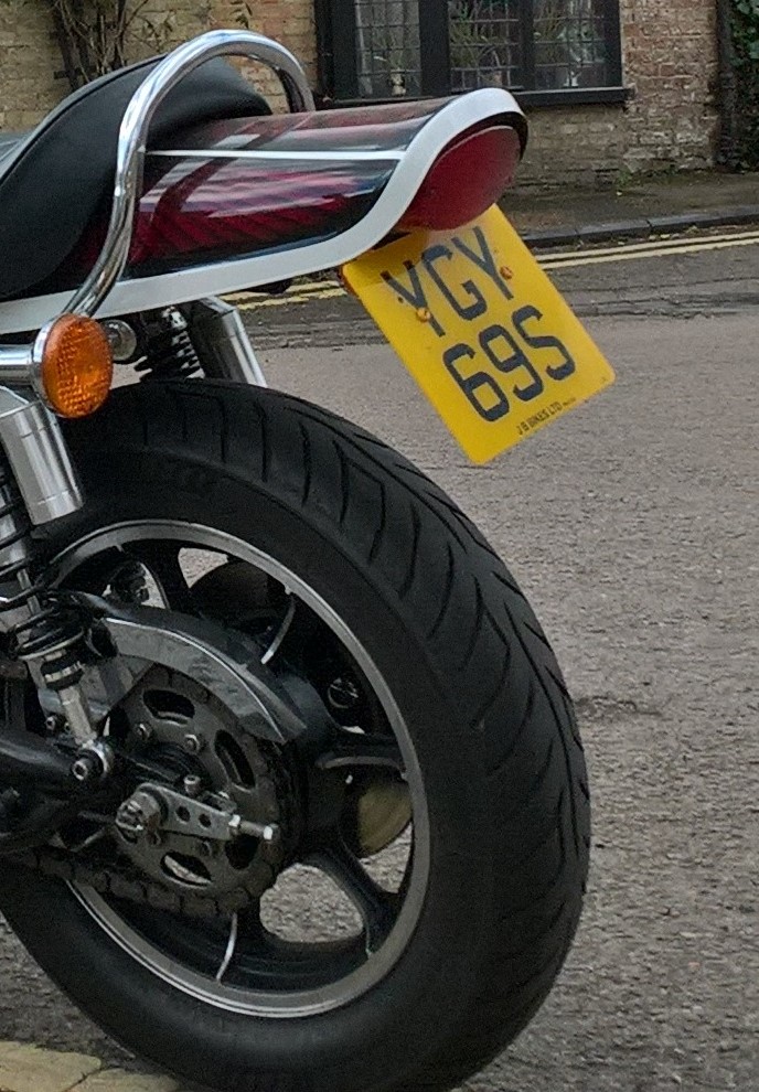

#132 PostAuthor: kev edwards » Thu Sep 09, 2021 5:18 pm
Looking good apart from tail lamp, an ER5 or 6 lamp will look better.
WP_20190317_10_26_18_Pro (3).jpg (280.28 KiB) Viewed 140323 times

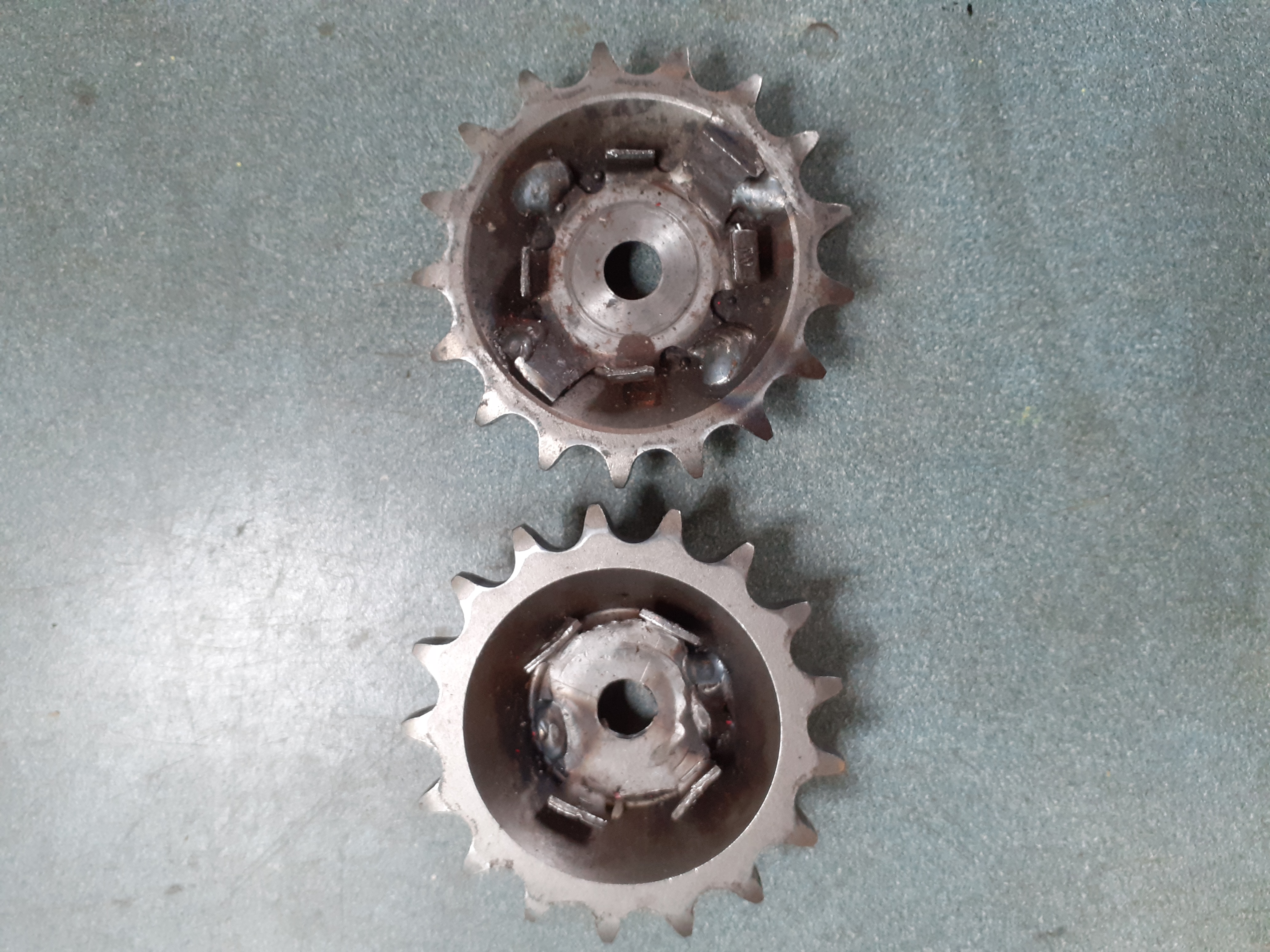

What 'form' (shape) does youre offset sprocket have?
Cant see a pic in the thread.
The retro 'sprocket bolt locking mechanism' takes up a lot of space in the offset sprocket recess.
It is also reliant on holes in the sprocket which the standard flat sprockets have. Not seen an offset sprocket with holes in it.
I use an offset sprocket but it doesnt need the support bearing its only 5/8 i think. It has no holes so i welded 'tabs' to the inside of the recess.
I still needed the 12 point locking ring to grip the bolt though.
I subsequently changed the gearbox for the later type which has a large nut instead of the dubious bolt arrangement.

Posts: 2926
Re: Z650 / 1100
#135 PostAuthor: Al » Sun Sep 12, 2021 12:45 pm
On the RHS is one of my older sprockets (no holes) with the Kawasaki bolt stopper welded to it.
On the LHS is a ZZR sprocket (same as yours) with a copy of the original welded to it.
It wont have escaped youre notice that the ZZR sprocket is shorter along the splines than a standard one and therefore needs a small spacer behind it to stop the shaft protruding beyond the sprocket face.
