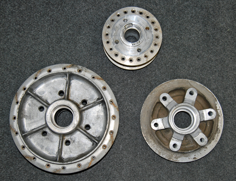

Stripped the hubs out this week, plenty of corrosion.
Hubs washed and ready for ceramic cleaning.
A quick trip through the blaster and were ready for polishing and plating.

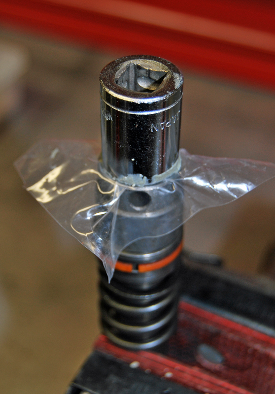

Took a while to strip down the forks for the refurb.
Not being able to see down the tube I couldn't see what I was up against - the broom handle trick didn't work.....
I re-assembled the fork and air gunned the bottom bolt - no good it just kept spinning.
Sent a socket down the tube with some plasticine in the end to find what the shape was down there.
After seeing the shape required I sent an old socket down with some chemical metal in it to make a socket to fit.
After leaving it for half an hour to let it set hard - the bottom bolt air gunned out without a hitch, A strange shape, quite logical really.
Happy days :D

#24 PostAuthor: KWACKERZ1 » Thu Oct 02, 2014 2:16 pm
I find a gator grip socket handy for this type of stuff.
they work brill. And are worth carrying in your underseat toolkit.
http://www.ebay.co.uk/itm/like/15142862 ... rid=229508
freddyz1r
Posts: 1187
Joined: 10th Mar 2013
#25 PostAuthor: freddyz1r » Thu Oct 02, 2014 3:13 pm
Clever hinckley :clap like your thinking :up
the gator grip is ok, but in my experience with them is, if somethings a bit stubborn the little pins 'snap' out while flexing.(I think I'm on my 3rd :oops: )
Cheers freddy :D

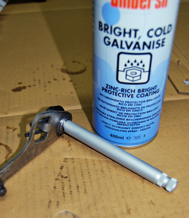

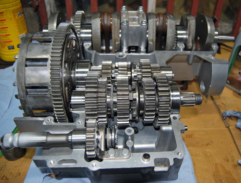

Corrosion on the gear selector shaft and kickstart shaft was sorted by a trip through the blaster and a couple of coats of bright zinc spray.

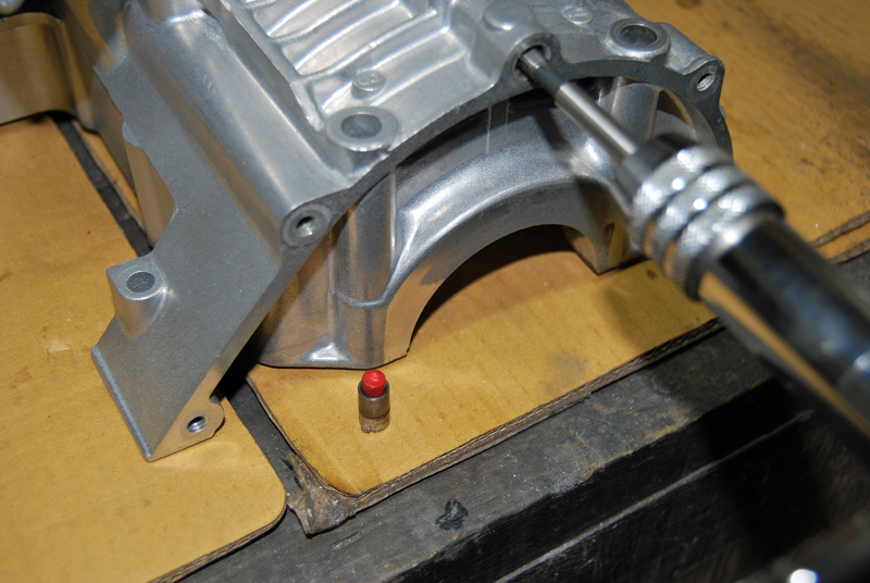

Cleaning the threads out is a slow job - but has its rewards, finding part of a bung could have been a headache later in the build - removal at this stage is so much easier.

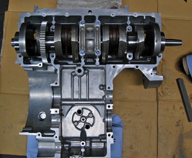

Trial assembly showed no issues, gear assembly ran smoothly with the new bearings.

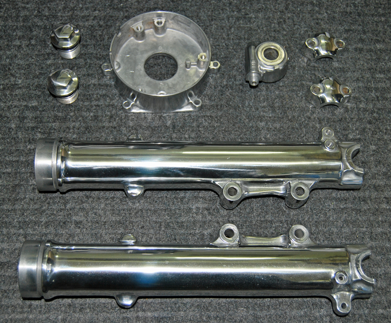

Mikey continues to demonstrate his talent - Polishing doesn't come better than this.

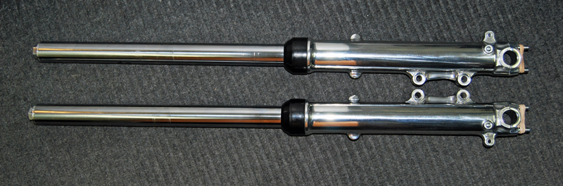

I find building forks good fun, I've used progressive springs and 15wt oil, genuine seals, pattern washers and circlips.
I did get some pattern dust covers - but I have junked them for genuine.

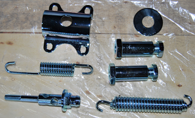

Genuine Studs, drain washers & sealing washers.

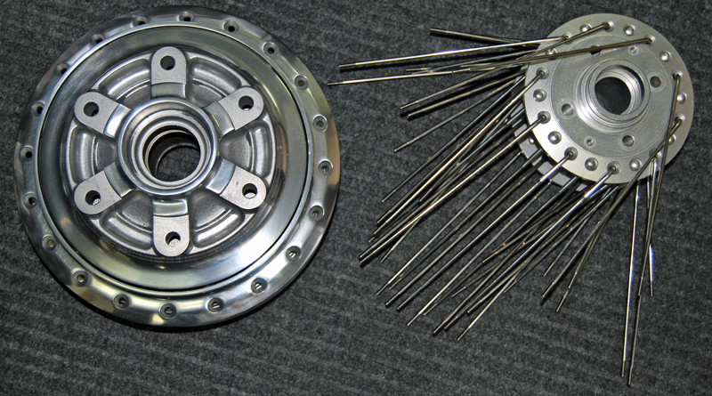

Hubs came back from Steve Smethurst, ceramic cleaning looks great - sisal polishing where I didn't ask for it - does not!!
Test laced the front hub, S/Steel spokes fit the hub really well.
Central-Wheel sent two extra spokes per side - not sure why - maybe just in case one breaks!!!

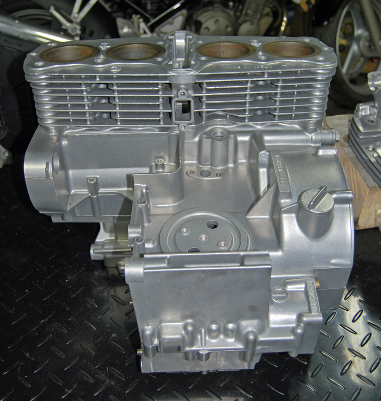

Webike parcel arrived so cylinder liner has gone off to the machine shop for installing and honing.
Another Z Power parcel, 66.5mm piston kit plus another head gasket and a set of genuine stem seals.
Last of the parcels from CMS arrived, I find them useful for some of the genuine NOS original parts.
First of the super bright Zinc plating came back from Mikey.

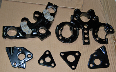

Picked up the powder coating, have left the big bits wrapped, jobs for another day.

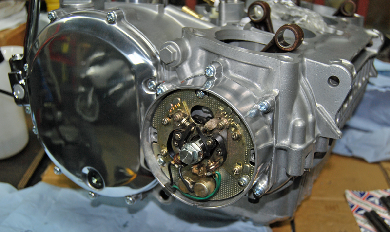

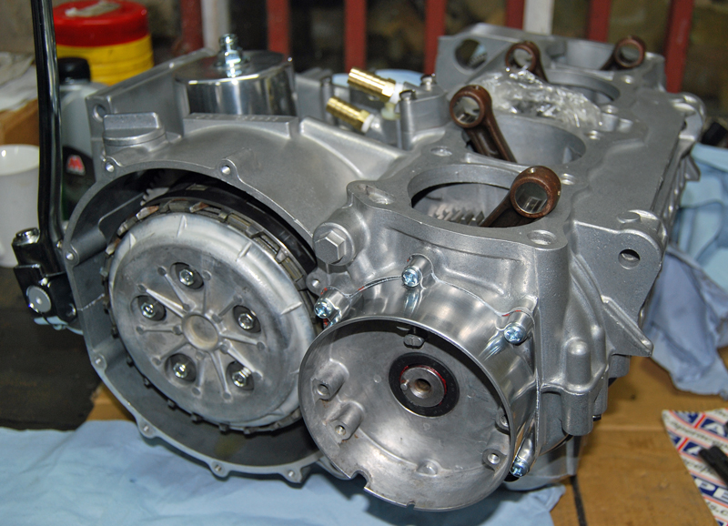

Engine assembly went well, new clutch plates, springs etc finished off the bottom end mechanicals.
Sticking with points on this bike, the budget won't stretch to Dyna Ignition. Mirror polish clutch cover looks the dogs danglies!

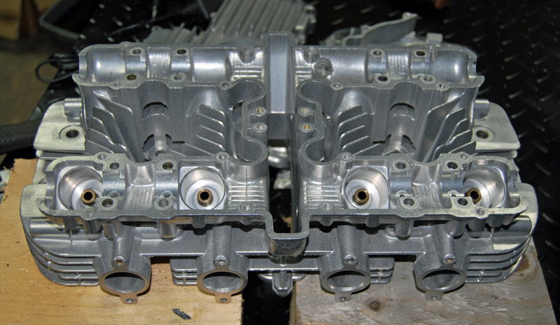

It was quiet at work yesterday so I've started to put the head together, not too pleased with the hot bath the machine shop used to raise the temperature to get the valve guides out (didn't use a torch so as not to wreck the head finish!), the fluid left a brown residue behind which has proven to be a pain to remove.
Sadly the plug threads had to have TimeSerts fitted, the corrosion had eaten the threads away too much to risk.
Genuine new valves, springs, stem seals, spring washers, buckets are in, Stainless Steel exhaust studs look good.
