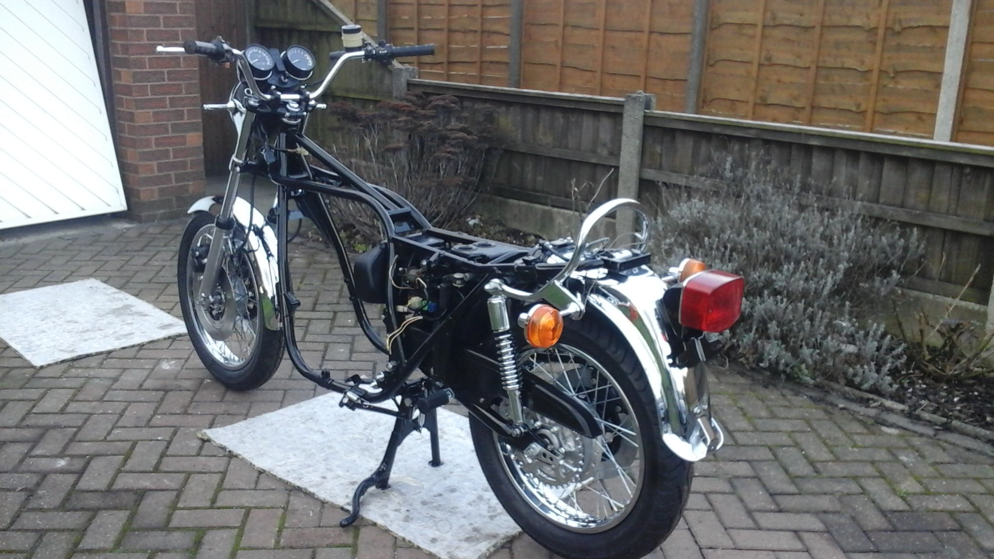

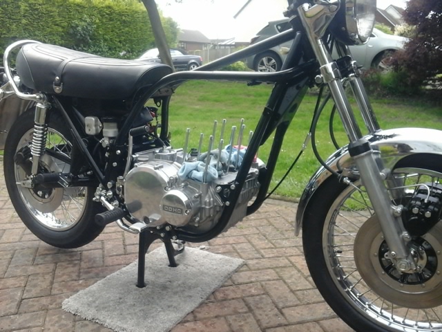

Finally got my wheels back from the chromers, new spokes fitted, patten parts for the back wheel, stainless for the front, the front spokes were 3mm shorter than what the spoke man was happy about, Zed Head confirmed that his old spoke was 3mm longer, so with that in mind went for stainless.
Spent an hour today just to put the wheels back on so I could move the frame about easily, well its coming on, slow but steady.
Got the correct disc's front and rear now, the engine rebuild looms on the horizon.

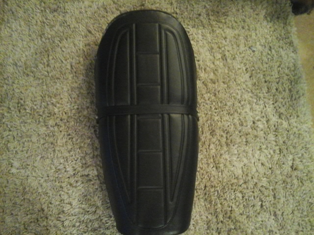

#25 PostAuthor: DavidZ1R » Fri Mar 17, 2017 7:42 pm

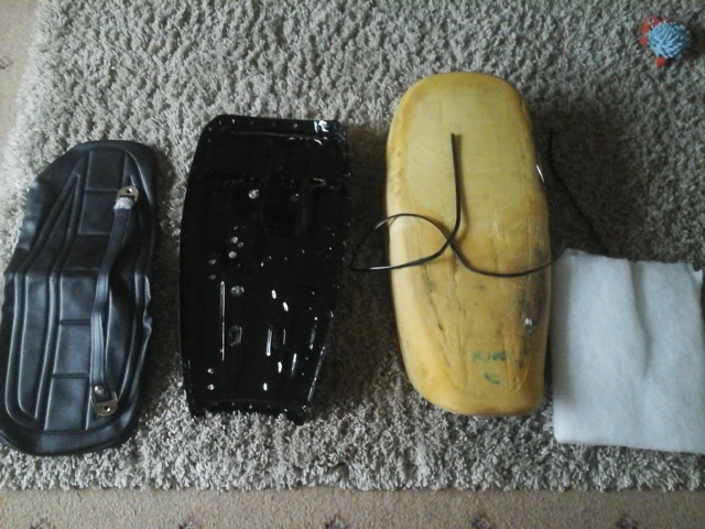

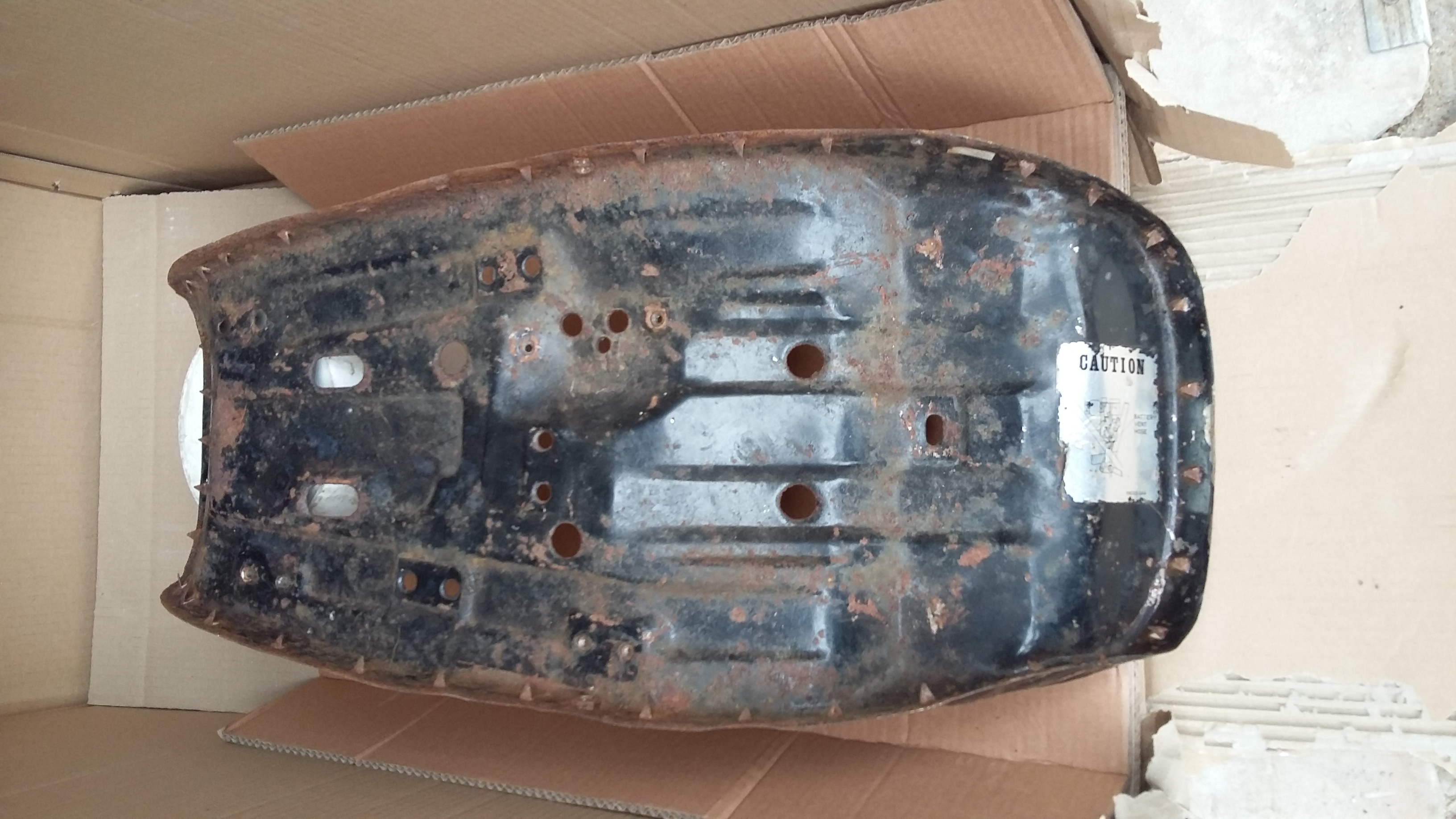

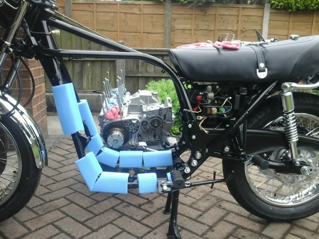

Done a bit more to the frame work, refurbished the seat, engine block away for attention before it goes off to steve smethurst.

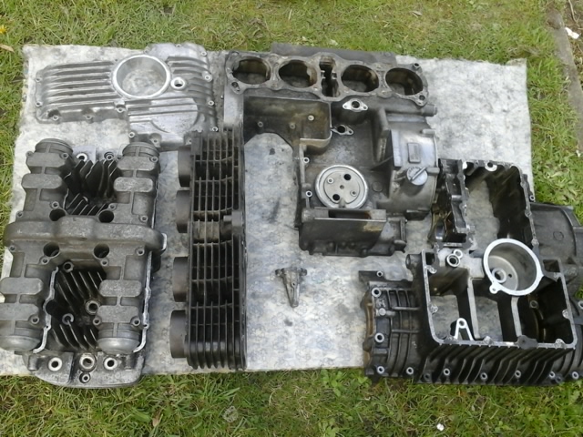

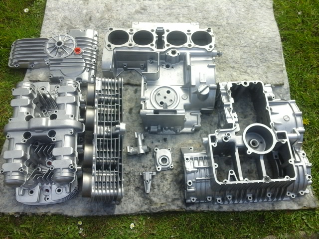

Slow business this project lark, and expensive, got my engine cases back from Steve Smethurst today, quite a bit of corrosion revealed but not where it will be seen tho.

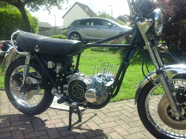

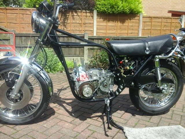

#29 PostAuthor: DavidZ1R » Sat Jun 03, 2017 6:45 pm

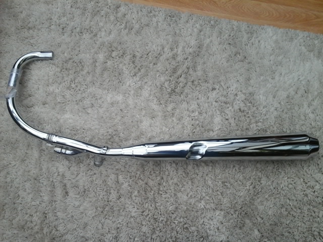

Slow progress, had a few problems with the engine cases but sorted now, managed to get the bottom half of the engine back in, managed to get a nos left pipe, hunting for a right one, if anyone knows of one.

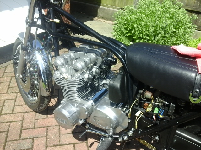

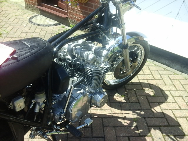

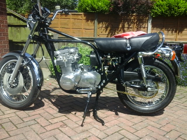

#30 PostAuthor: DavidZ1R » Sun Jul 02, 2017 3:23 pm

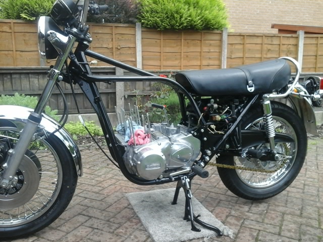

Finally got the head back from engine teknicks, valves reseated, new stem seals, all valves reshimmed to 0.1 , head back on, turns well, carbs next up . Thanks Will for supplying two shims as required.
