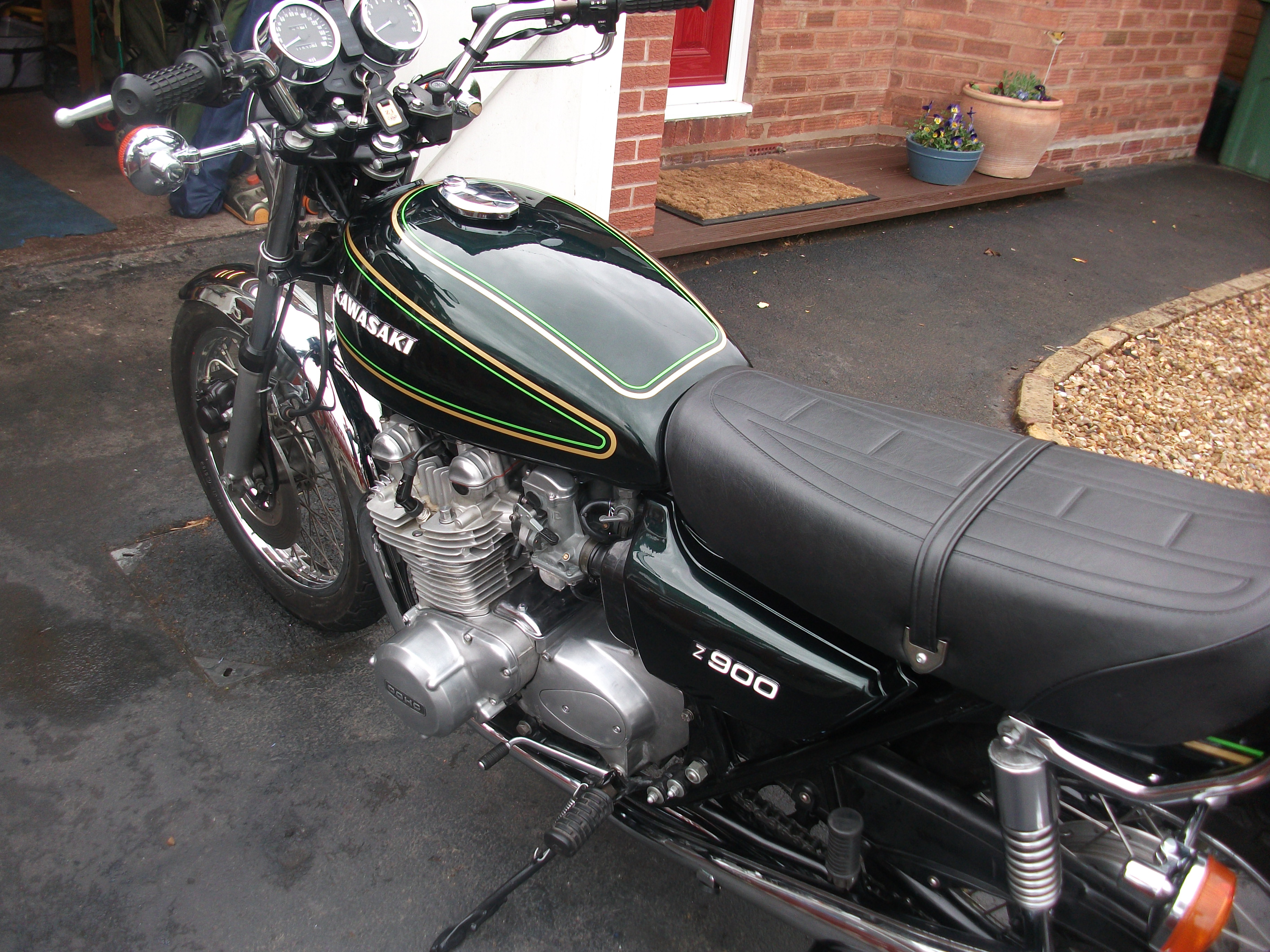

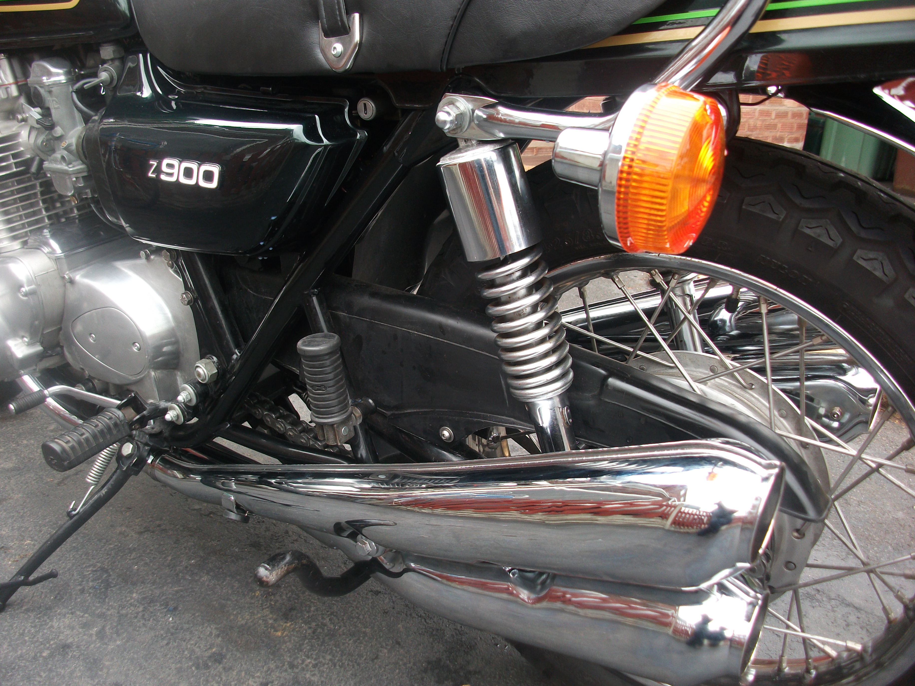

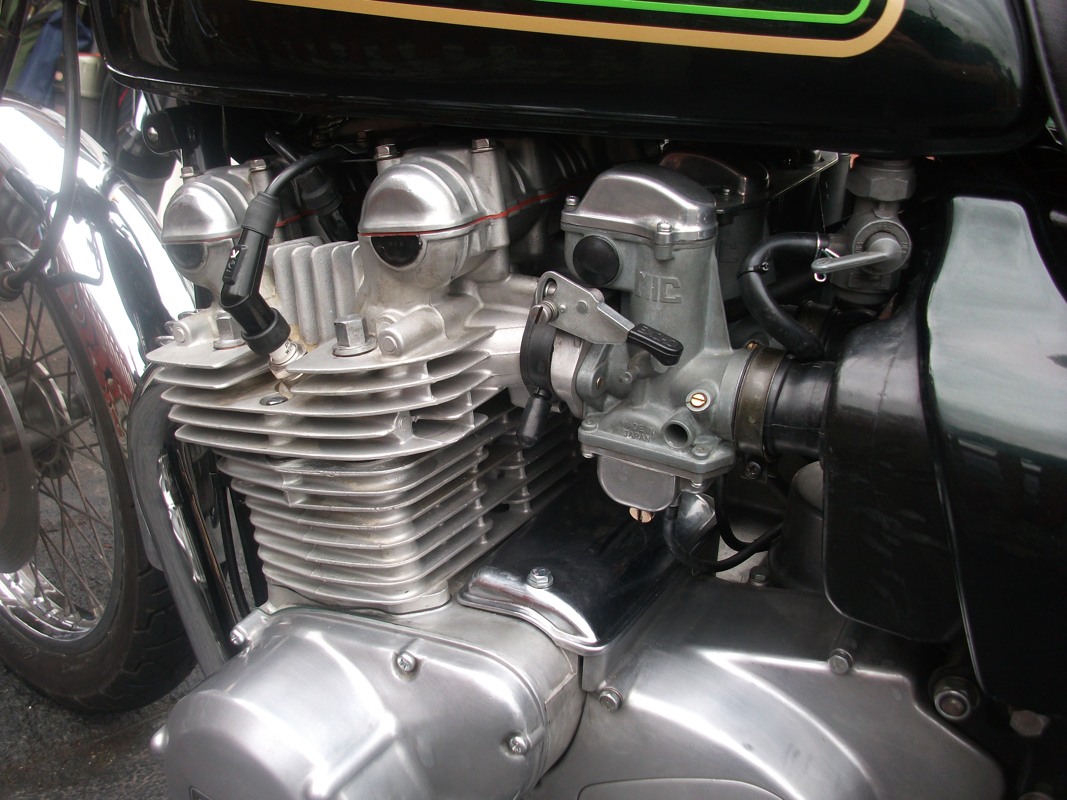

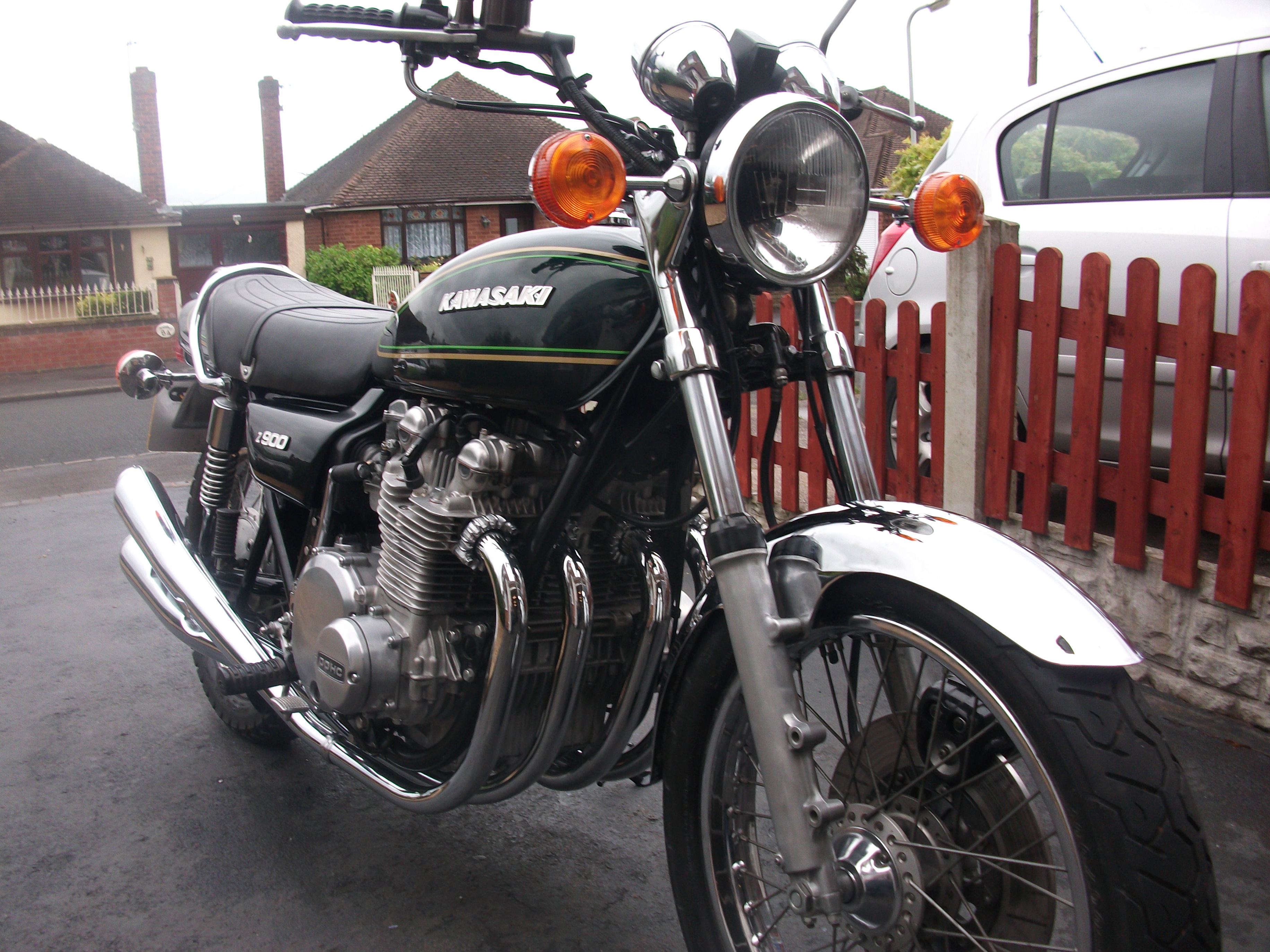

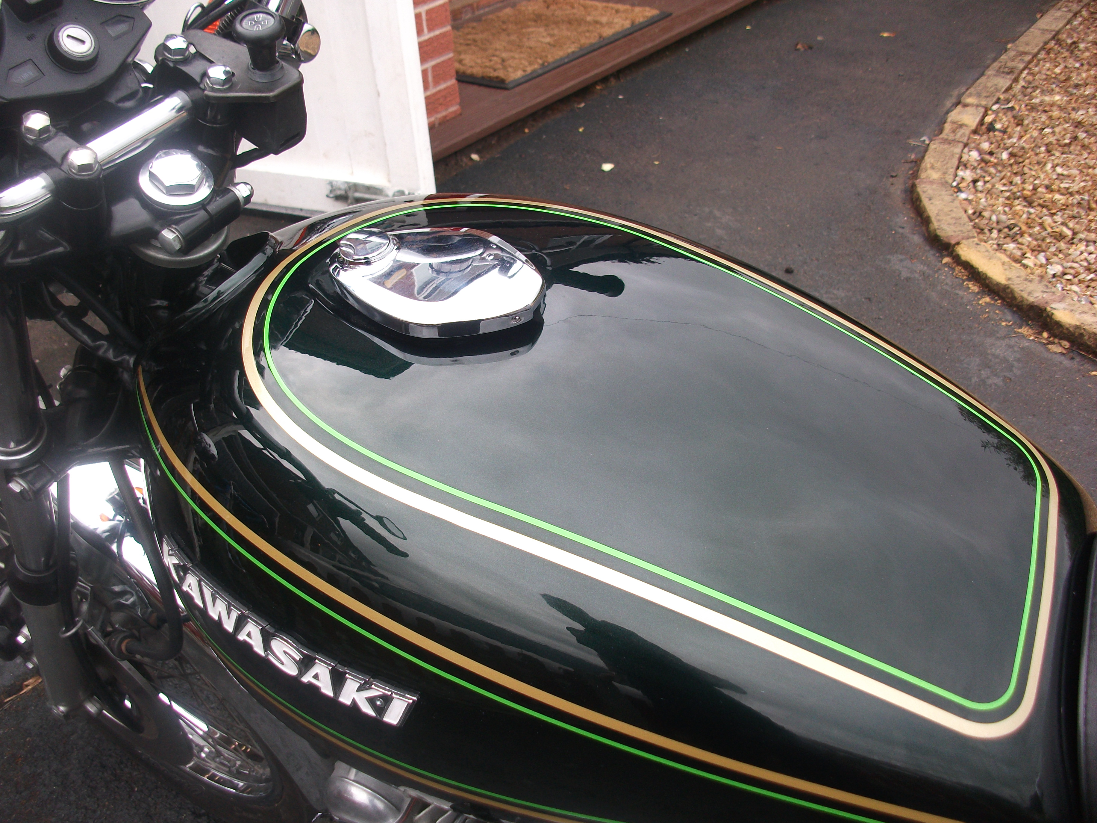

#18 PostAuthor: PAULJAC47 » Tue May 16, 2017 12:25 pm
1976 Z900A4 USA LINCOLN NEBRASKA MODEL.
41K MILES MOT APRIL 2018
HISTORIC TAX
DIAMOND GREEN RESPRAY BY LEE CHAMBERS CORRECT COLOUR AND GRAPHICS
FRAME POWDER COATED
NEW PATTERN FENDERS
NEW PATTERN INDICATORS
CORRECT 26MM CARBS COMPLETELY REBUILT UNTRASONIC CLEANED WITH ALL NEW JETS.BRACE BRACKET ON.
ENGINE VAPOUR BLASTED ALL REBUILT WITH NEW RINGS,HEAD NEW VALVE INSERTS BY JOHN BROSE,VITON SEALS,
NEW VALVES AND SPRINGS ALL SHIMMED AND CORRECT ALL GOOD.NEW CAMCHAIN.
NEW PATTERN AIRBOX SILENCER.NEW AIR FILTER.
COMPLETE REWIRE WITH PATTERN NEW LOOM,ALL ELECTRICS WORK INCLUDING INDICATOR BUZZER,
HAZARD SWITCH PRESENT AND WORKING.NEW OIL PRESSURE SWITCH.BRAKE OUTAGE RELAY PRESENT AND OK.
ALL SWITCHGEAR WORKS WELL AND IN EXCELLENT CONDITION.NEW COILS AND LEADS.
NEW ELECTRIX WORLD GENNY,COMBINED REGULATOR RECTIFIER AND NEW AGM BATTERY,
CHARGING WELL AND MAINTAINING CHARGE.
BOTH CLOCKS WORK WELL THOUGH DO HAVE CHROME COVERS.
CORRECT BRAKES SINGLE DISC WORK WELL,CORRECT M/C.
GEARS SHIFT WELL, NO JUMPING OUT OF GEAR,CLUTCH STRIPPED AND CHECKED ALL GOOD.
FULLSERVICE,OIL ,FILTER,CARBS BALANCED.IGNITION STROBE TIMED.
TYRES NEW FRONT REAR EXCELLENT.
SEAT NEW COVER WITH STRAP
TANK IS EXCELLENT WITH NO INTERNAL CORROSION,CORRECT RIGHT ANGLE FUEL TAP NEW SEAL ON CAP.
NEW COMPLETE FOUR PIPE EXHAUST ,COLLARS AND FITTING KIT,PERFECT.
NEW CHAIN AND SPROCKETS ALL GOOD.
BIKE RIDES WELL AND HAS HAD ABOUT 150 MILES ON THE ROAD SINCE MOT.
