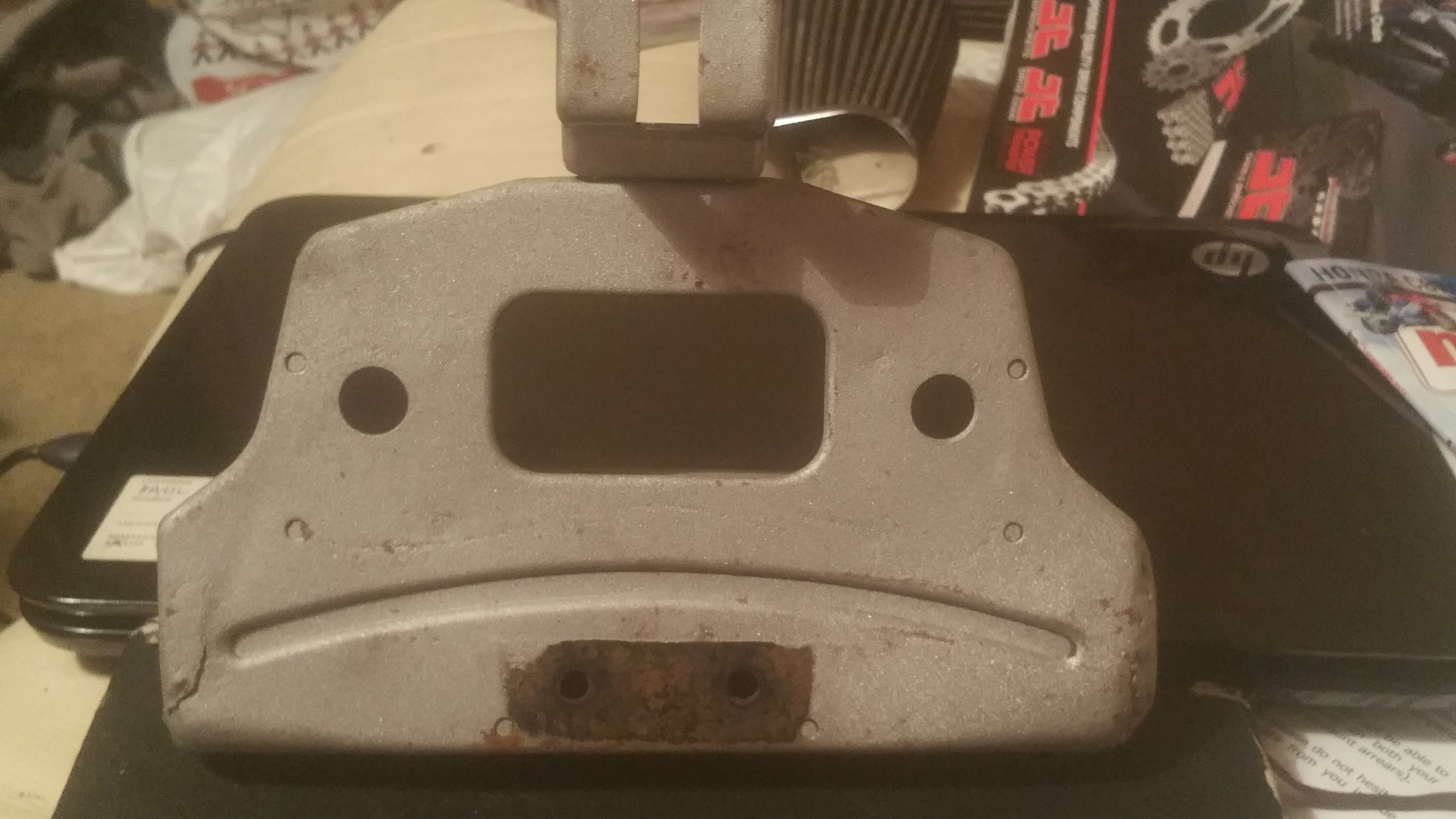

ok I don't have the fairing bracket, but I do have a rear light and number plate bracket.
the rear light bracket needs a bit of love and fettling, but has been dry blasted.

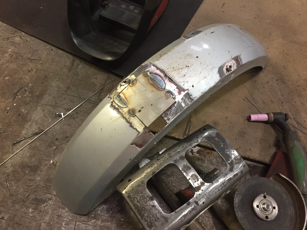

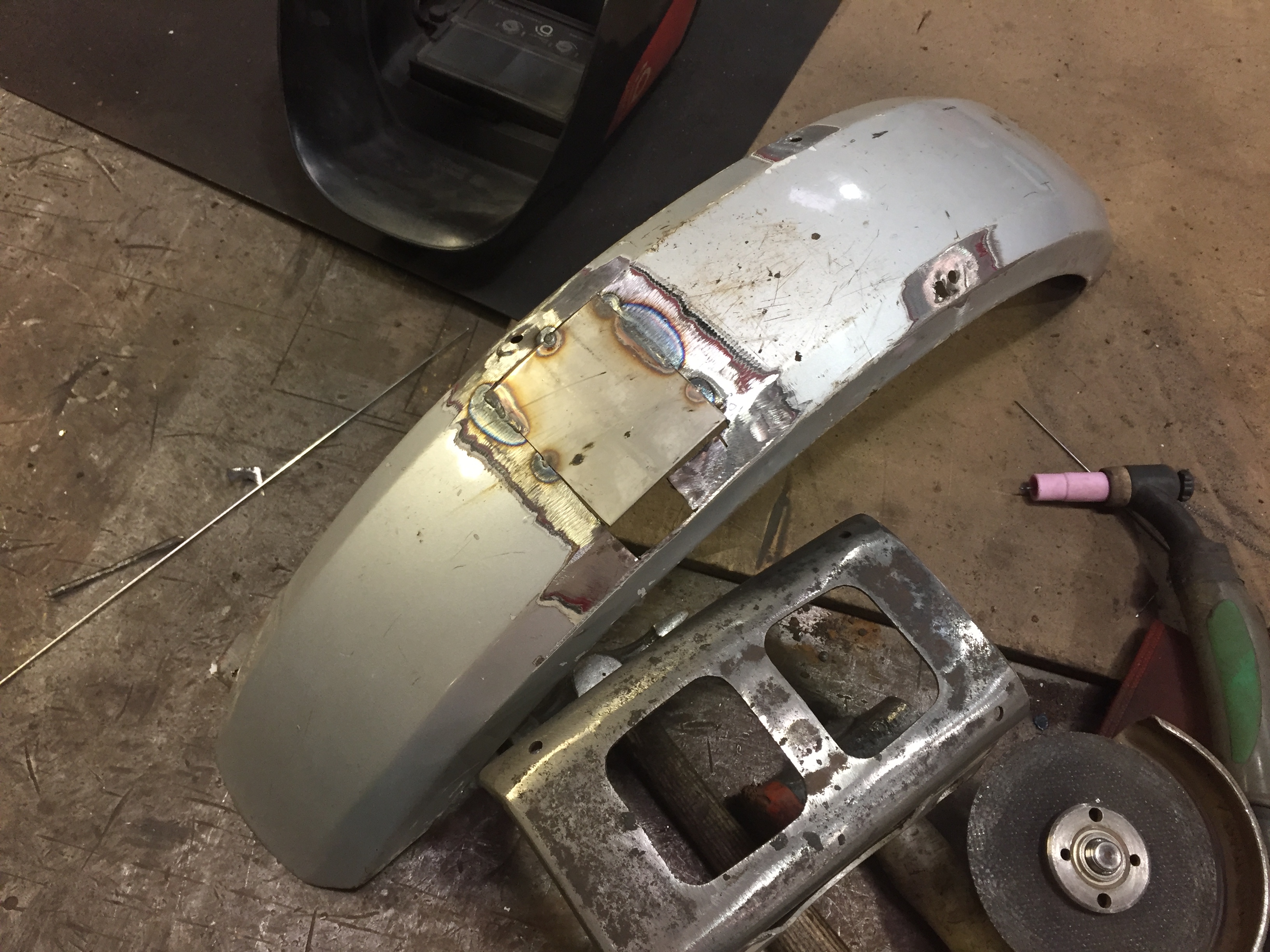

Re: Lawson Jigsaw Project
Front mudguard, had some rot ,
So cut it out & infilled, will be welded, dressed & passed onto Simon @ Flying tiger, along with the other body work parts.
Not going to be a standard paint job, by a long shot
