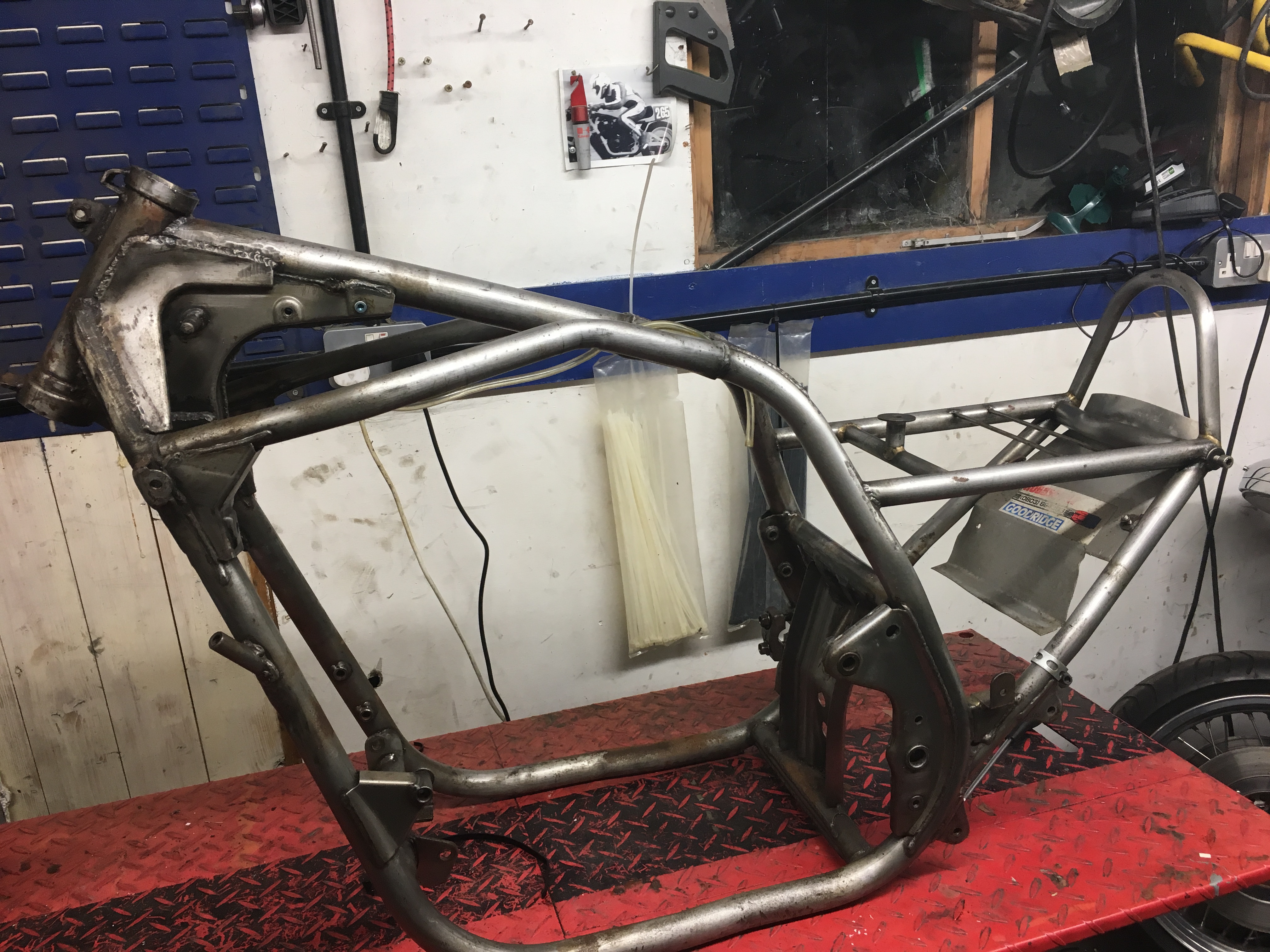

Did some further work on the bike this is what it looks like now.

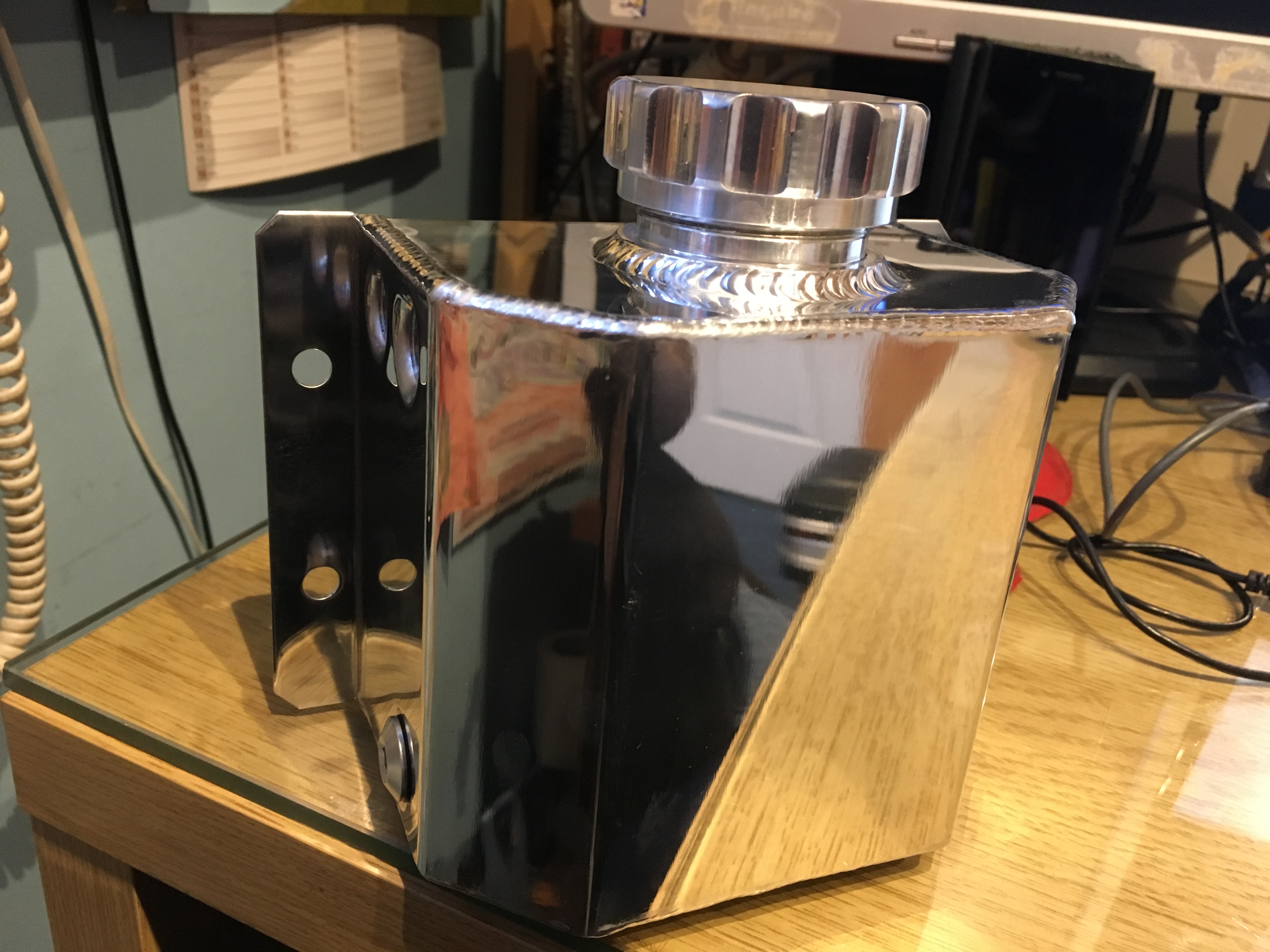

Done some playing with the bike. Ordered a couple ofally tanks to mount as the fuel supply.

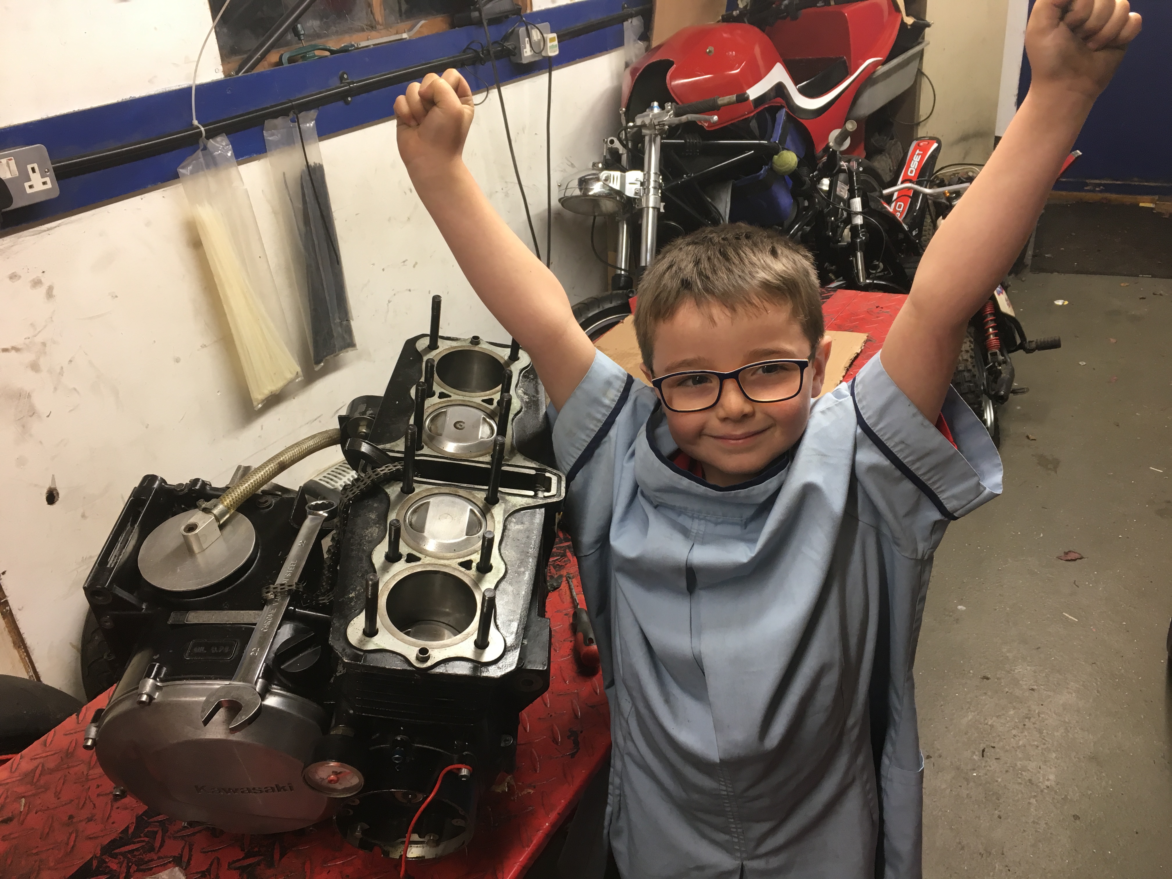

Also started re building the engine. Measured all bores and rings andstarted putting the motor back together . With some help from my lad!
Coose
Posts: 703
Joined: 20th Apr 2015
Location: North Yorks
Re: Gpz Drag bike Project for 2018
#28 PostAuthor: Coose » Mon Nov 20, 2017 7:08 pm
Start 'em young! :D

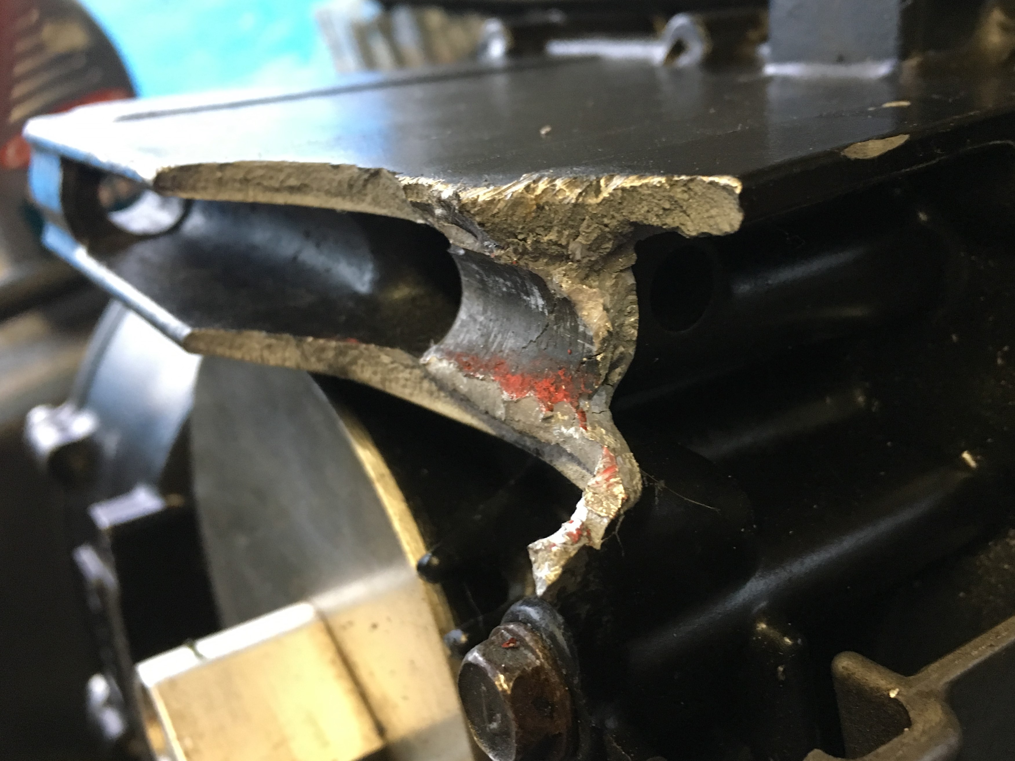

Disaster struck the yesterday,
On Sunday I moved the engine off my hydraulic bench onto the work bench and thought nothing of it.
Yesterday I went in the garage to find the engine upside down on the floor. :shock:
We had a bar through the rear monut and it looks like this hit the deck first and took the brunt of the impact its ripped out the rear sprocket side engine mount.:ooops
So what do I do now ? Weld it up, could this be done as a complete lump ? Strip it and source replacement cases ?
