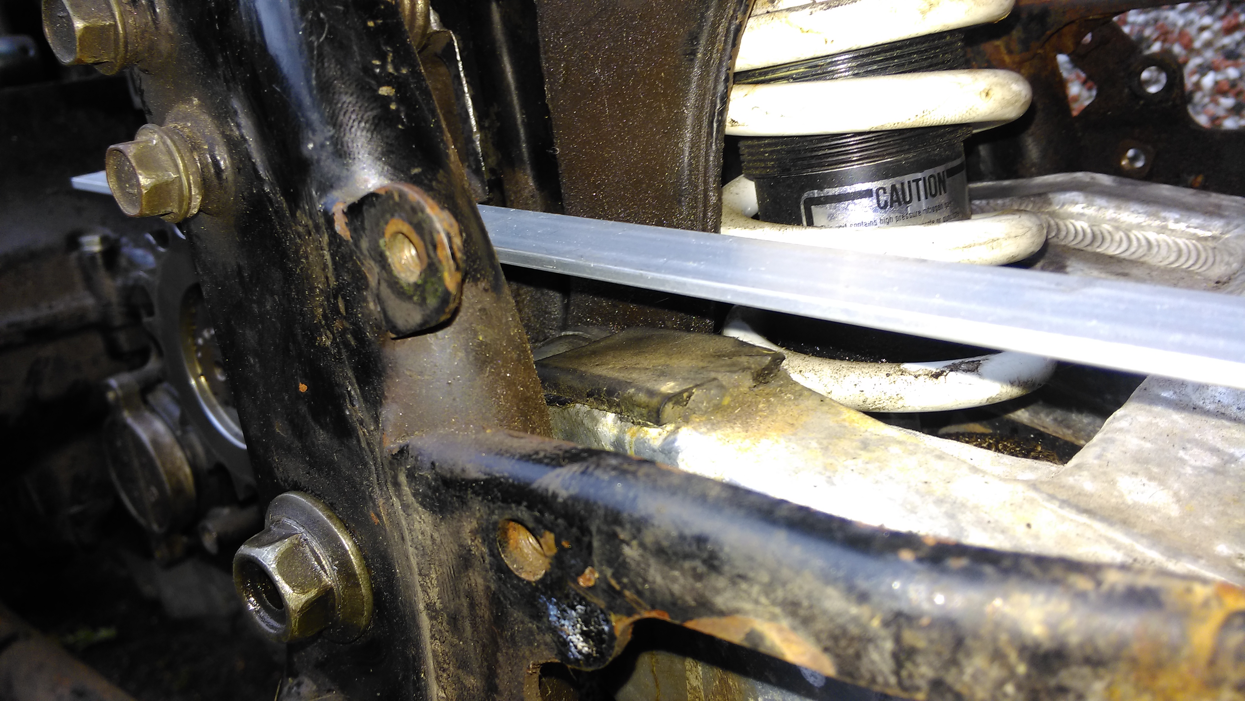

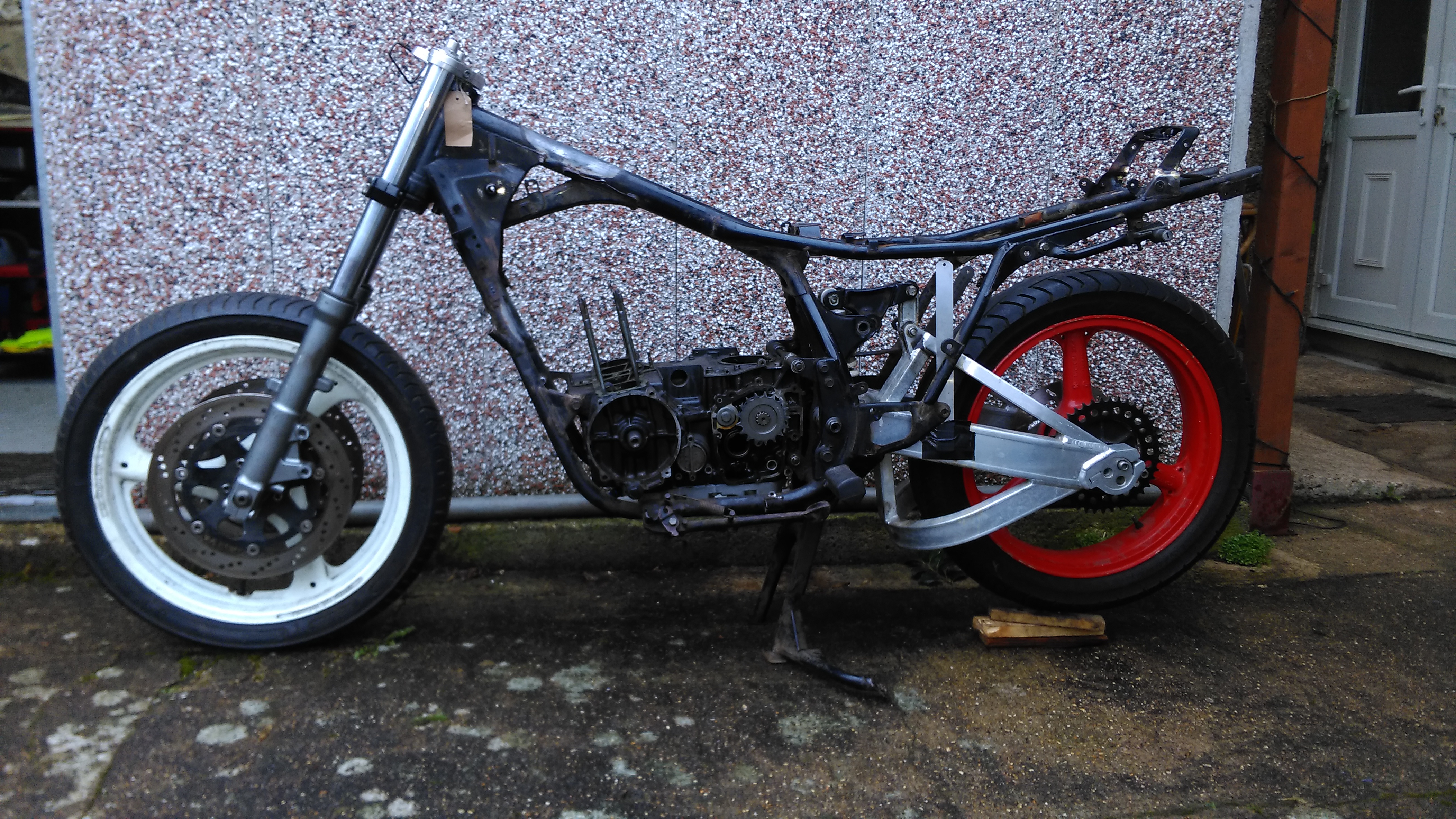

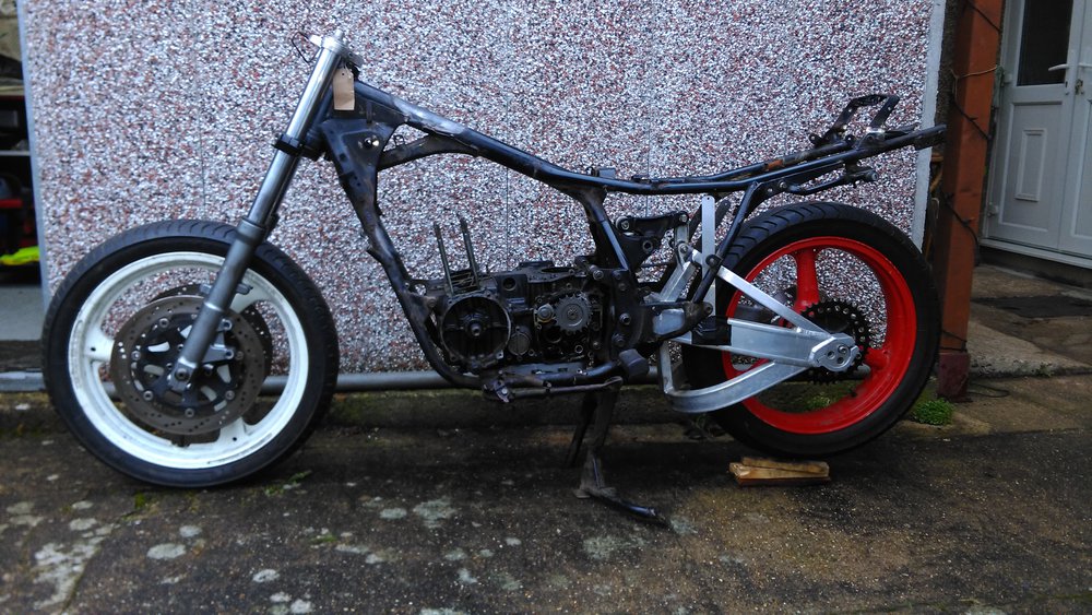

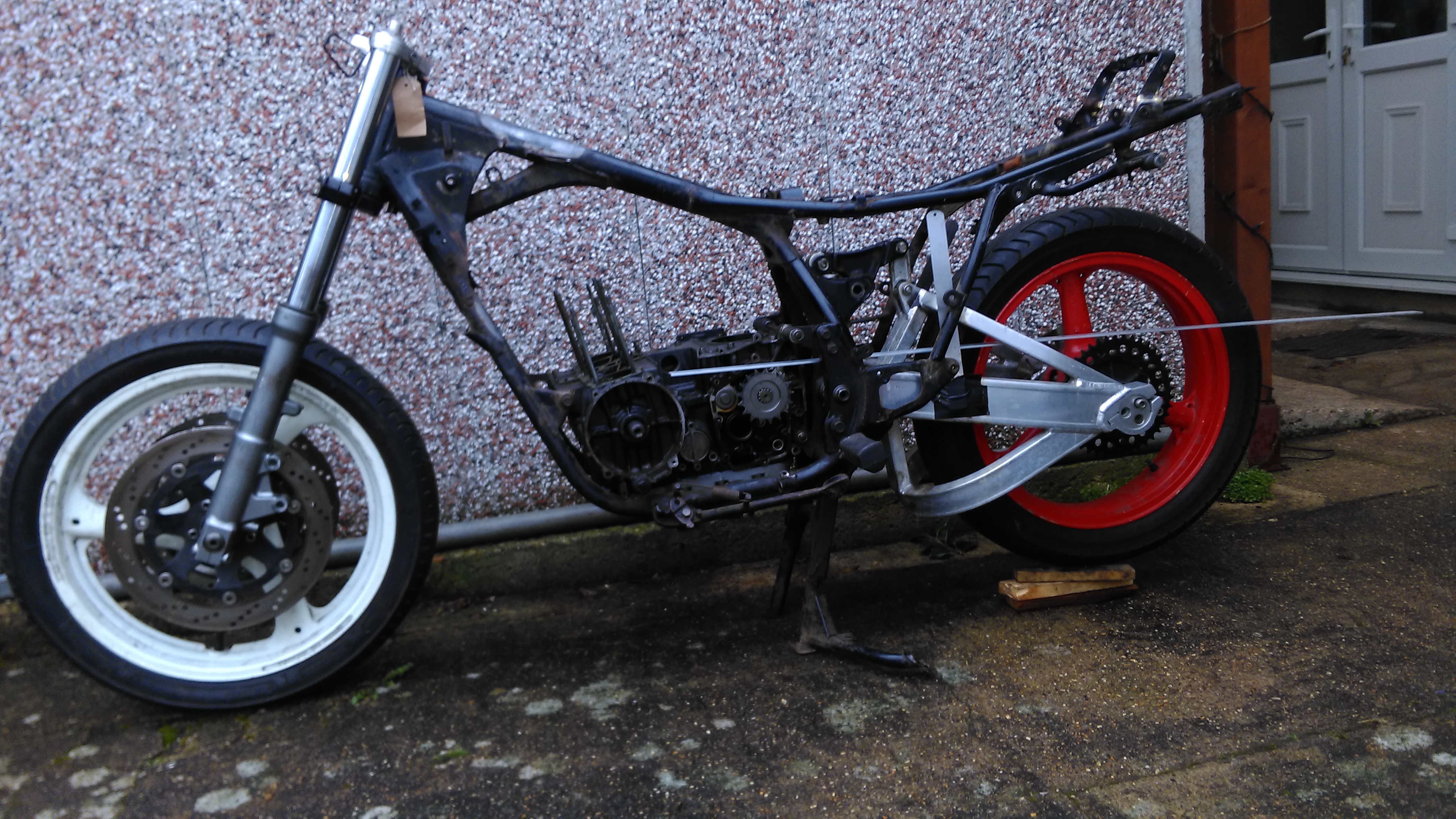

Anyway, I thought I'd try to get a feel for how it would look and managed to temporarily work around the clearance issues, but then run into the next problem. The top shock rocker would not line up to the frame mount. It took me some time to fathom out what was going on, but I figured it out when I compared the 2 swingarms. Look at the previous picture of the 2 arms side by side. You can see that the lower shock mount is formed by 2 plates bolted onto the lower side of the swingarm. the ally one uses the standard plates, but because the main beam of the arm is deeper, they are lower by about 15mm so it pulls the shock down and alters the angle of the top rocker arm. Remember what I said about this looking like it wasn't built around a bike - I reckon someone has taken the dimensions of a standard arm without reference to the frame. How else would you get all these problems ?
Here it is, temporarily fitted
I did check the chain run with a piece of ally on the sprockets to see if it would clear and it would, but I did use a 17t (+1) front sprocket. However, thats a moot point now.............
So if I really wanted to use it, I would get the under brace removed, then I'd need to make up new lower shock plates, then remove part of the footrest mounting, which in turn means changing footrest mounts, etc, etc. It's a shame because an ally arm was part of the look I was going for on the completed bike. Never mind - maybe, I'll just spray the standard arm in ally paint :shock:
So now it's time for plan "B" :D

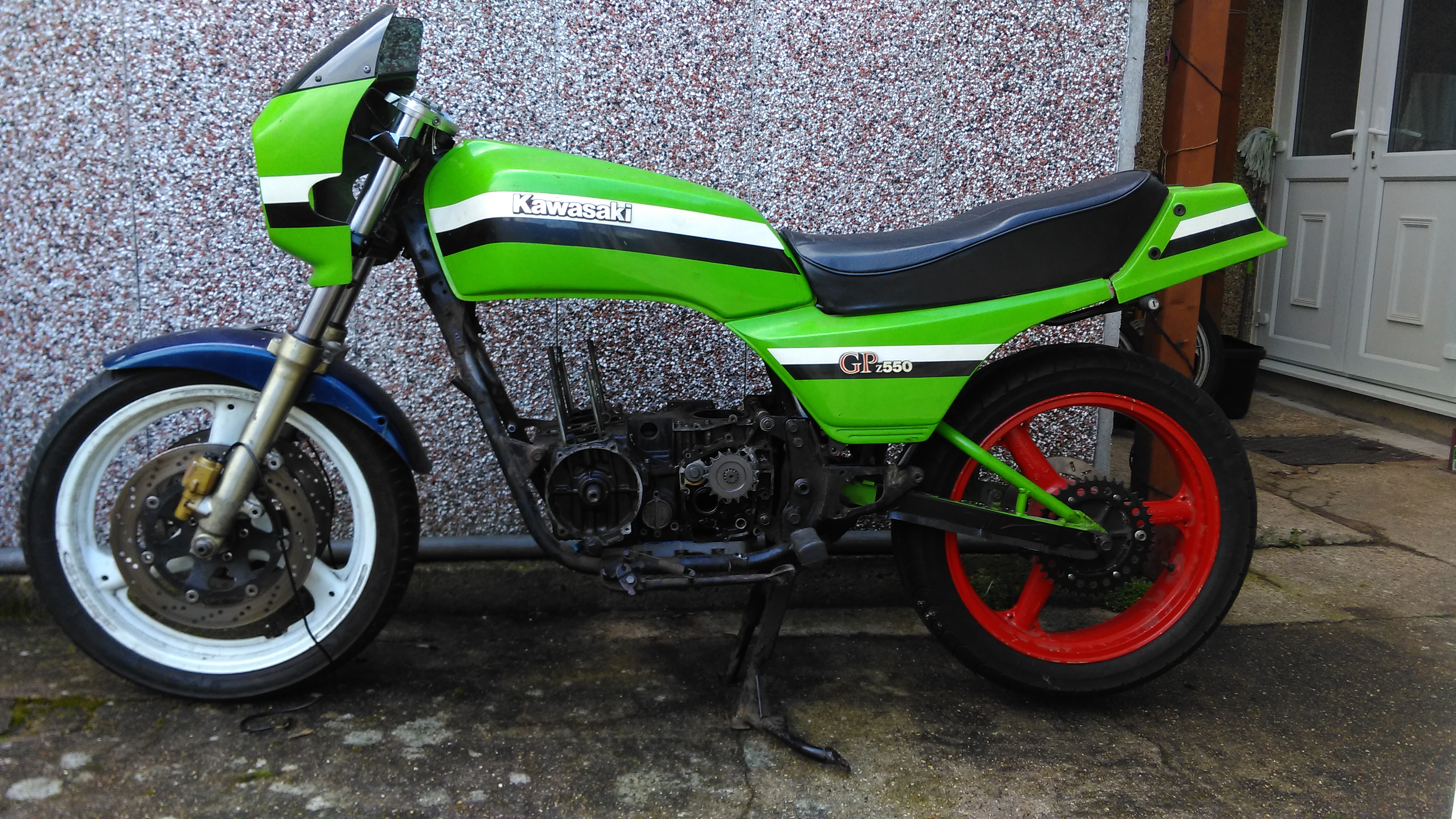

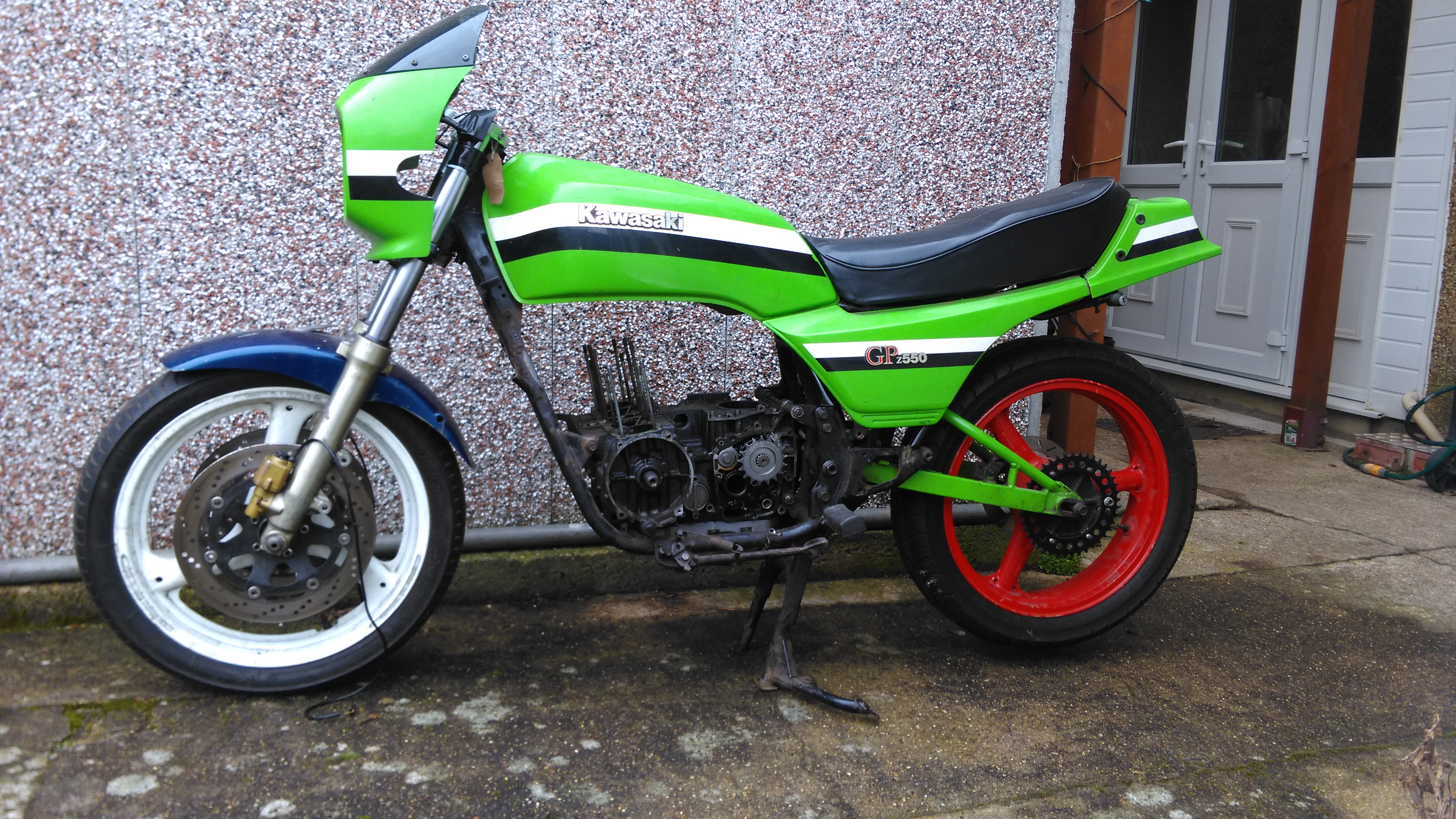

So, It's been a few weeks since my last post and progress has been slow :(
I did re-visit the ally swingarm and spoke to couple of people about modifying it, but their considered opinion is there is too much that needs changing to make it viable. Oh, well - it's headed for ebay, hopefully someone can use it and I'll get something back into the kitty :D
So, I looked at plan "B" and re-fitted the original swingarm. Whilst it wasn't too bad, it just looked a little flimsy against the new wheels/forks -
So I started to experiment with the possibility of getting an extra piece welded onto the bottom of the main arm to beef it up a bit. Using a cardboard template & duct tape, I reckoned a 1/2" "U" channel welded onto the bottom will achieve the desired effect -
The other thing I noticed was that by being black it "disappeared" into the frame. That's to say you didn't notice it as it was the same colour as the frame. Maybe I'll spray the swingarm black instead of ally - that might work, but I'll see what the arm looks like once modified.
So the frame/forks/wheel & swingarm are now away being modified to suit.

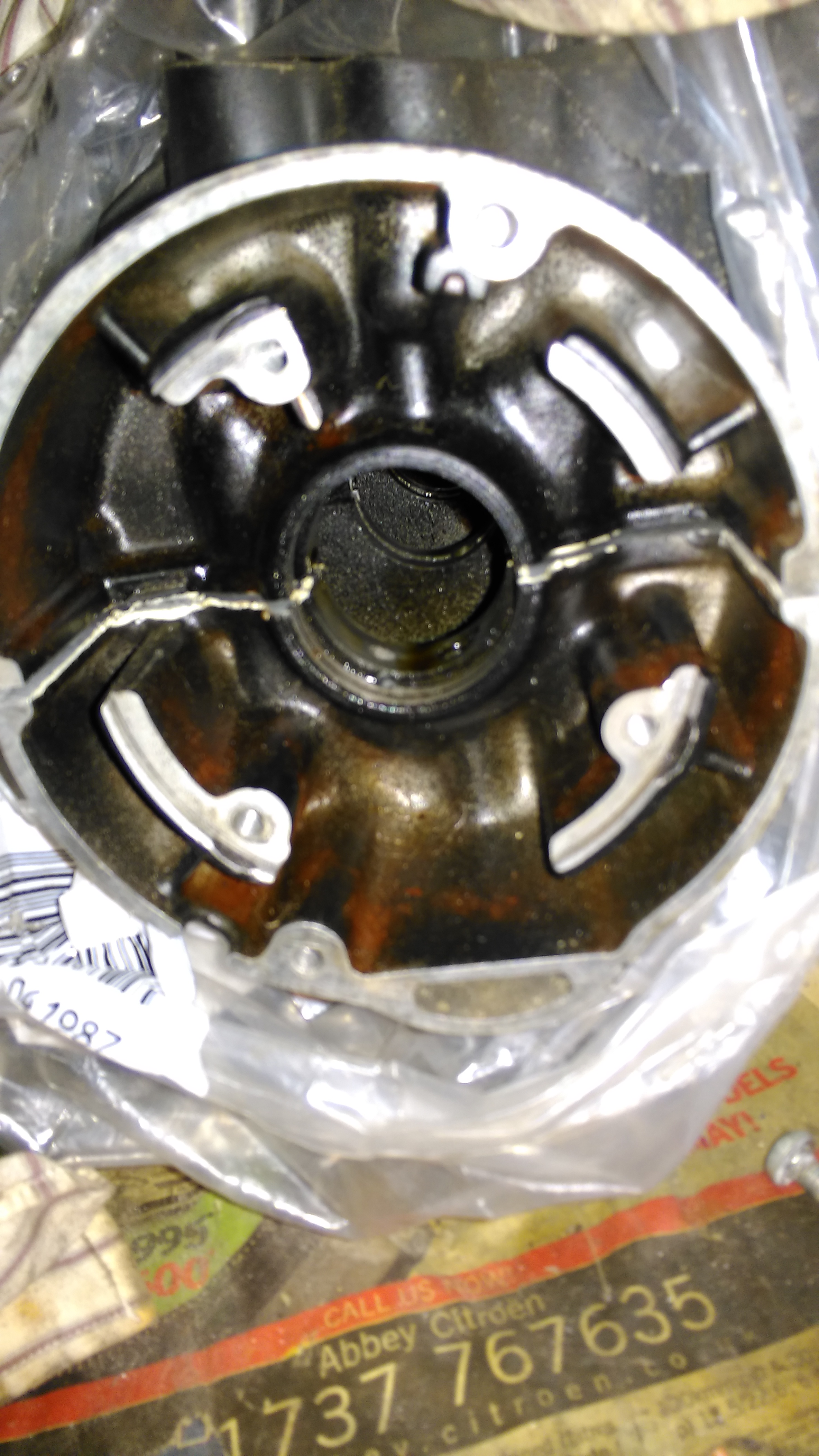

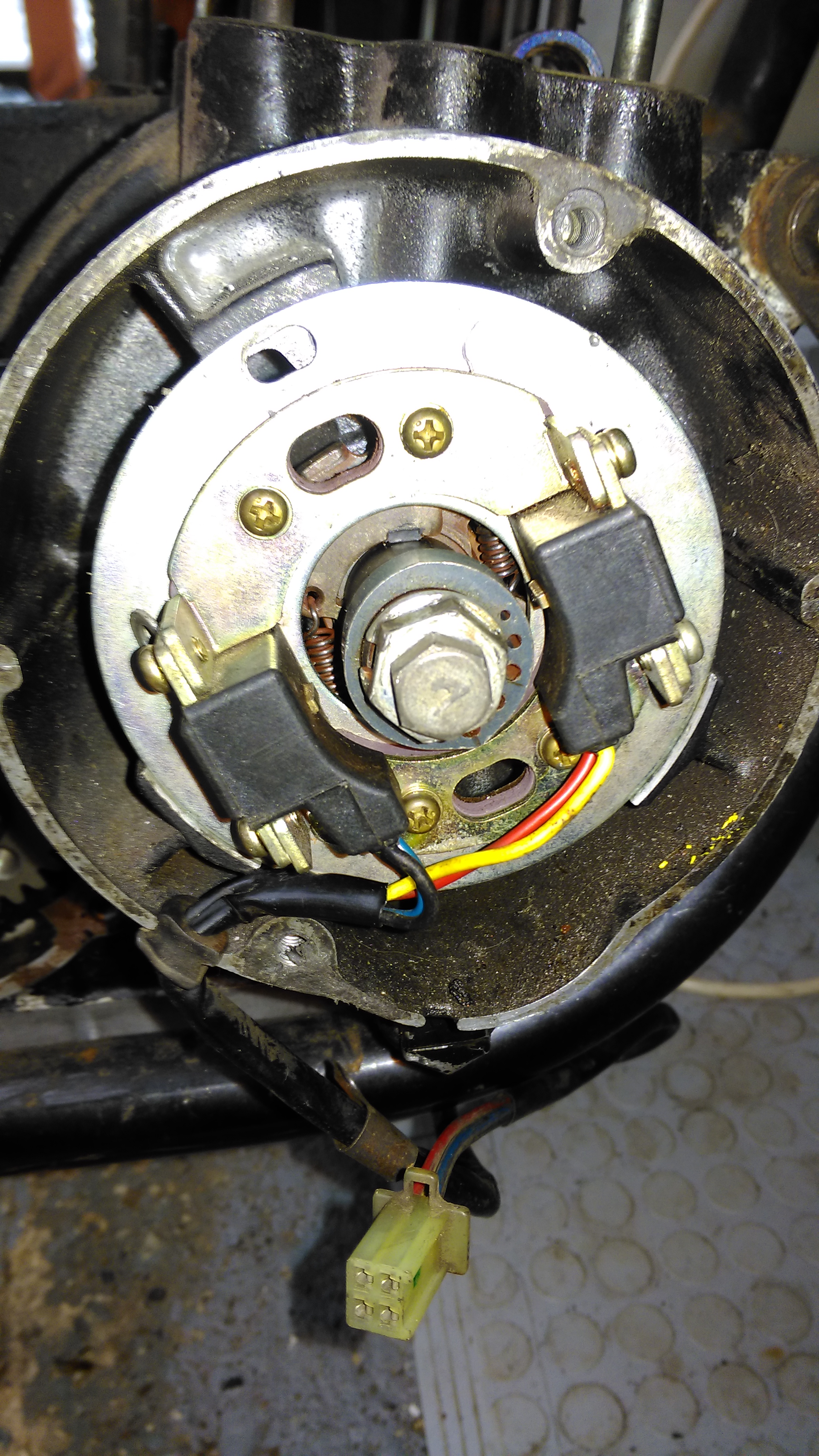

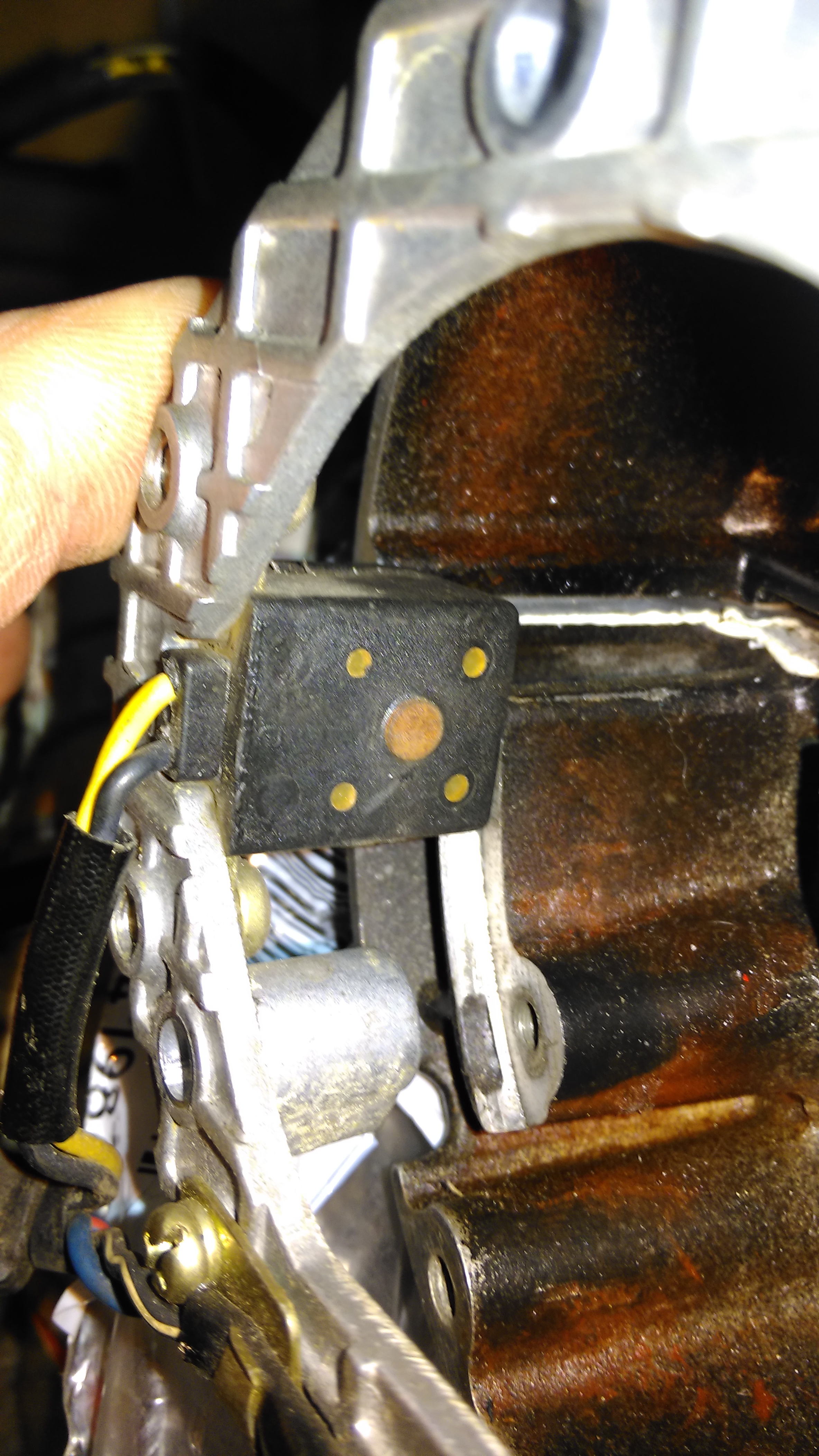

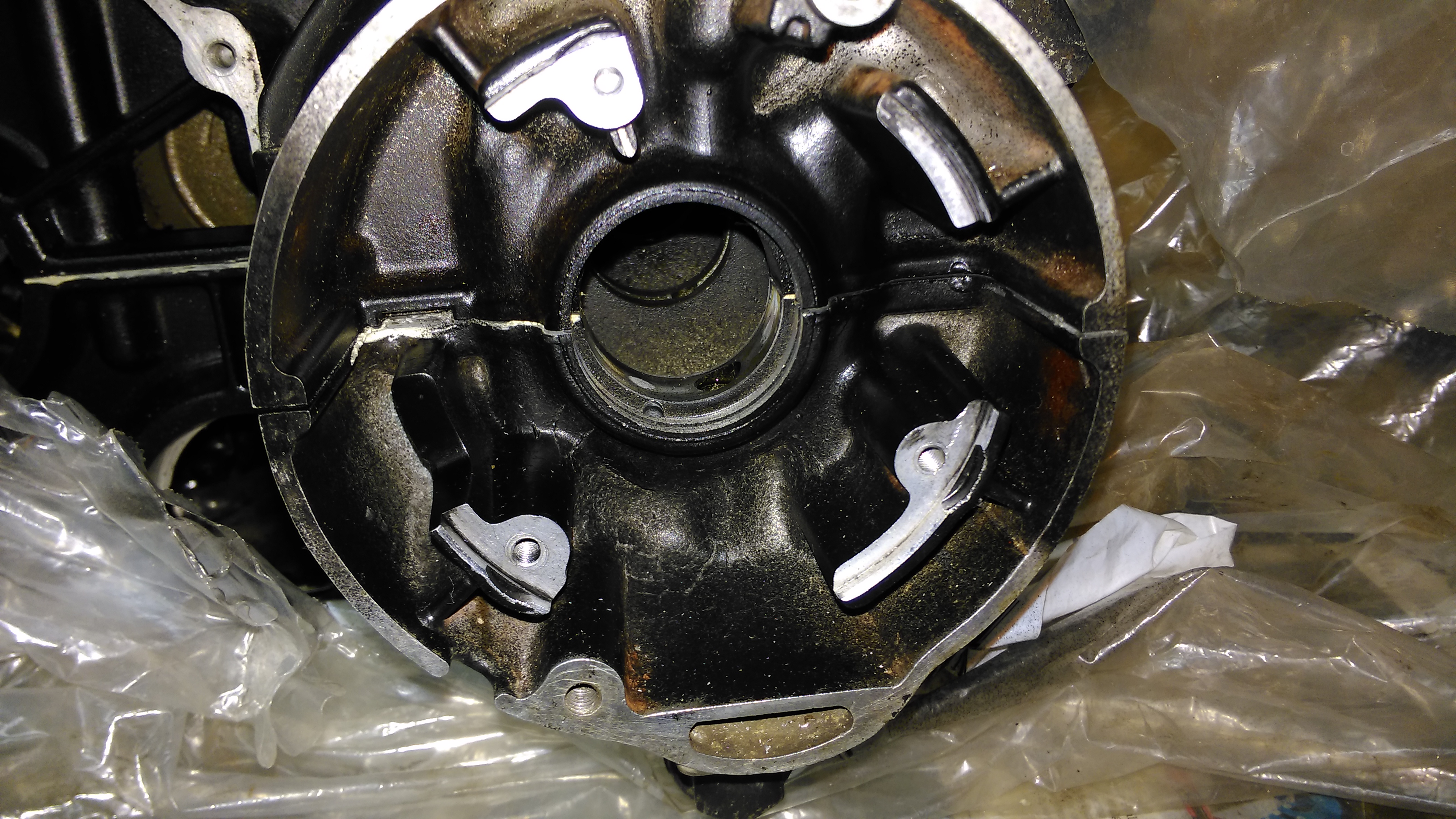

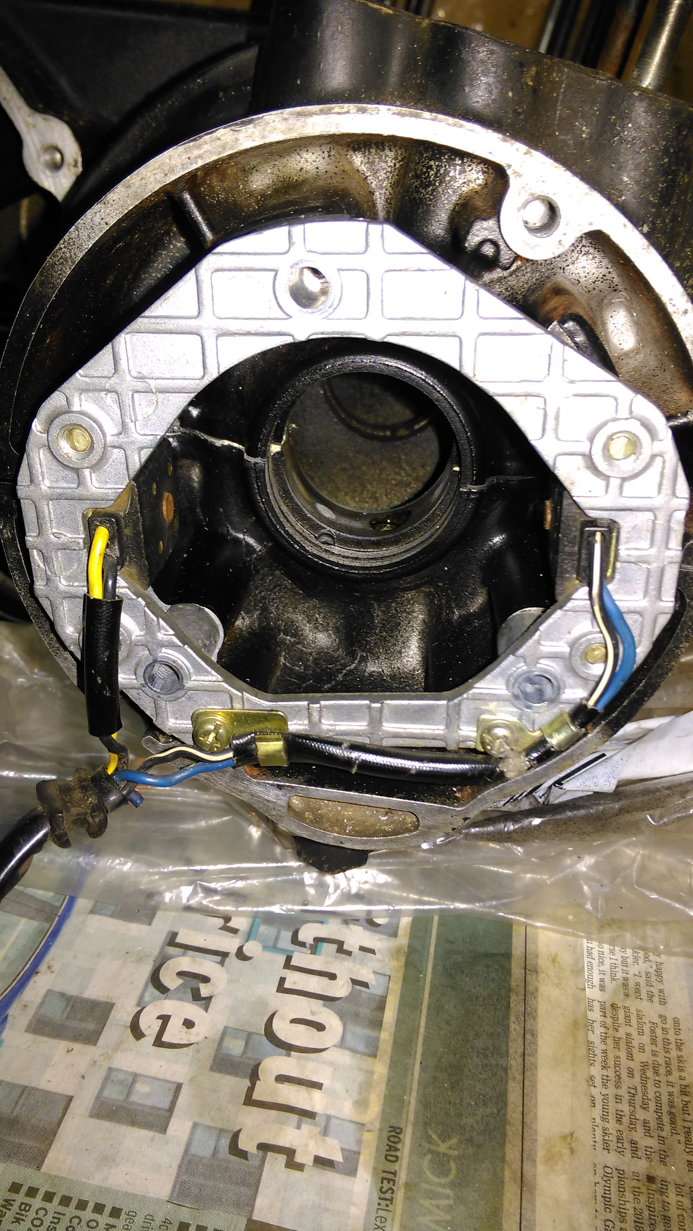

The first modification I wanted to do on the engine, was to replace the "H" GPz ignition plate & bob weight for the advance retard, with the later "A" series static pickup plate & CDI box. The newer CDi has the advance curve built in and also has a rev limiter, which the standard "H" ignition doesn't. I've done this successfully on the GPz750 motor in my P&M and that was a straight swap - not so with the 550 ! When trying to fit the later pickup plate it was fouling on the webs used for the original plate.
Original "H" series plate
Newer "A" series plate fouling on the crankcase web

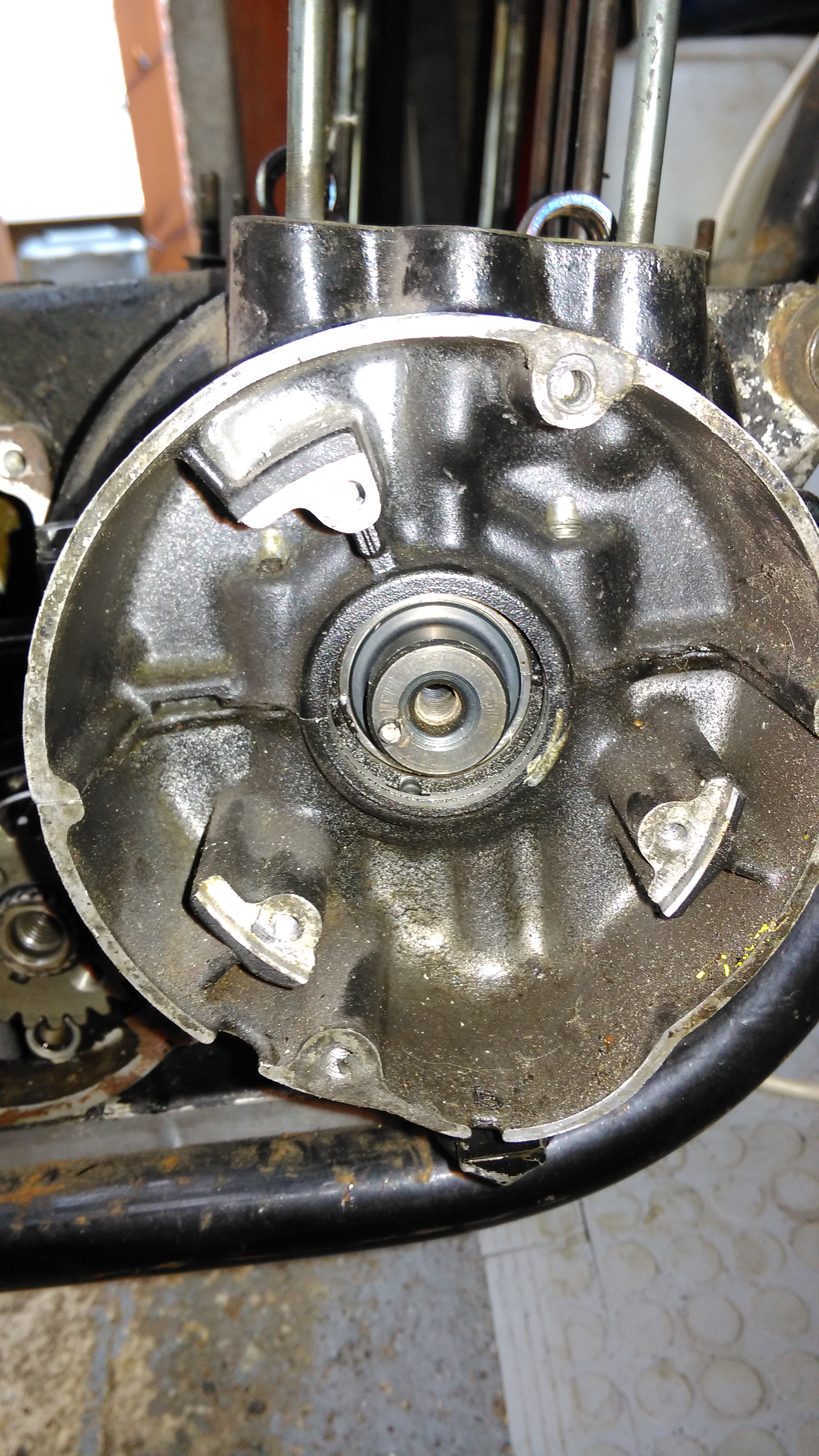

As it happens, I had a set of the later "A" 550 crankcases and I could see the casting for the pickup plate was different - the lower left support had less of a web on it.
"H" cases
"A" cases
So, a good mate took them to work and using a 90 degree drill, took away part of the casting. They came back like this
Ignition plate now sits true :-)
I'll have to get the loom modified to accept the newer "A" series CDI and find somewhere to mount it as it's larger than the standard "H" item, but I like the fact it has the advance curve & a rev limiter built in. :D

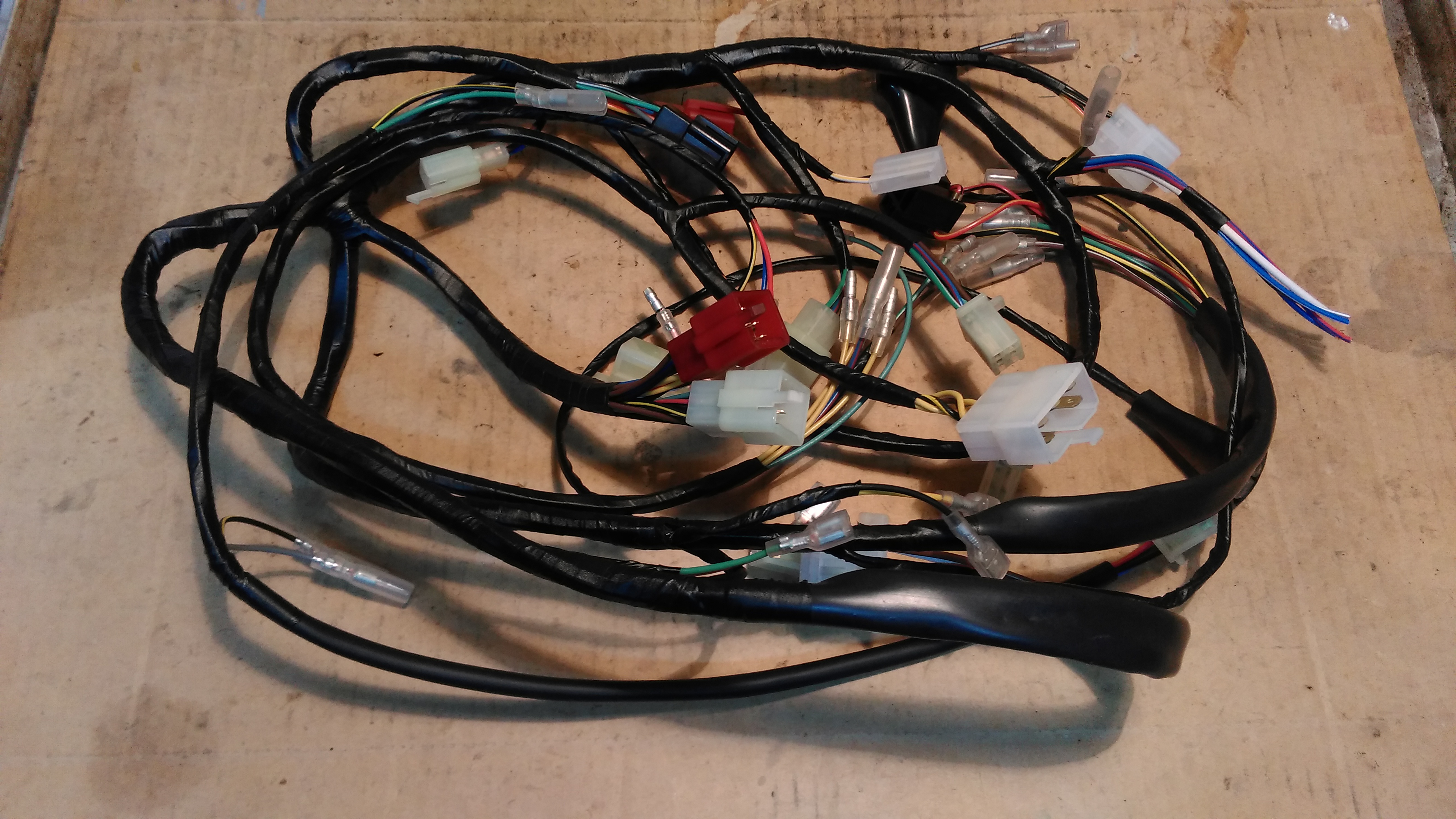

So lets start with the electrics.

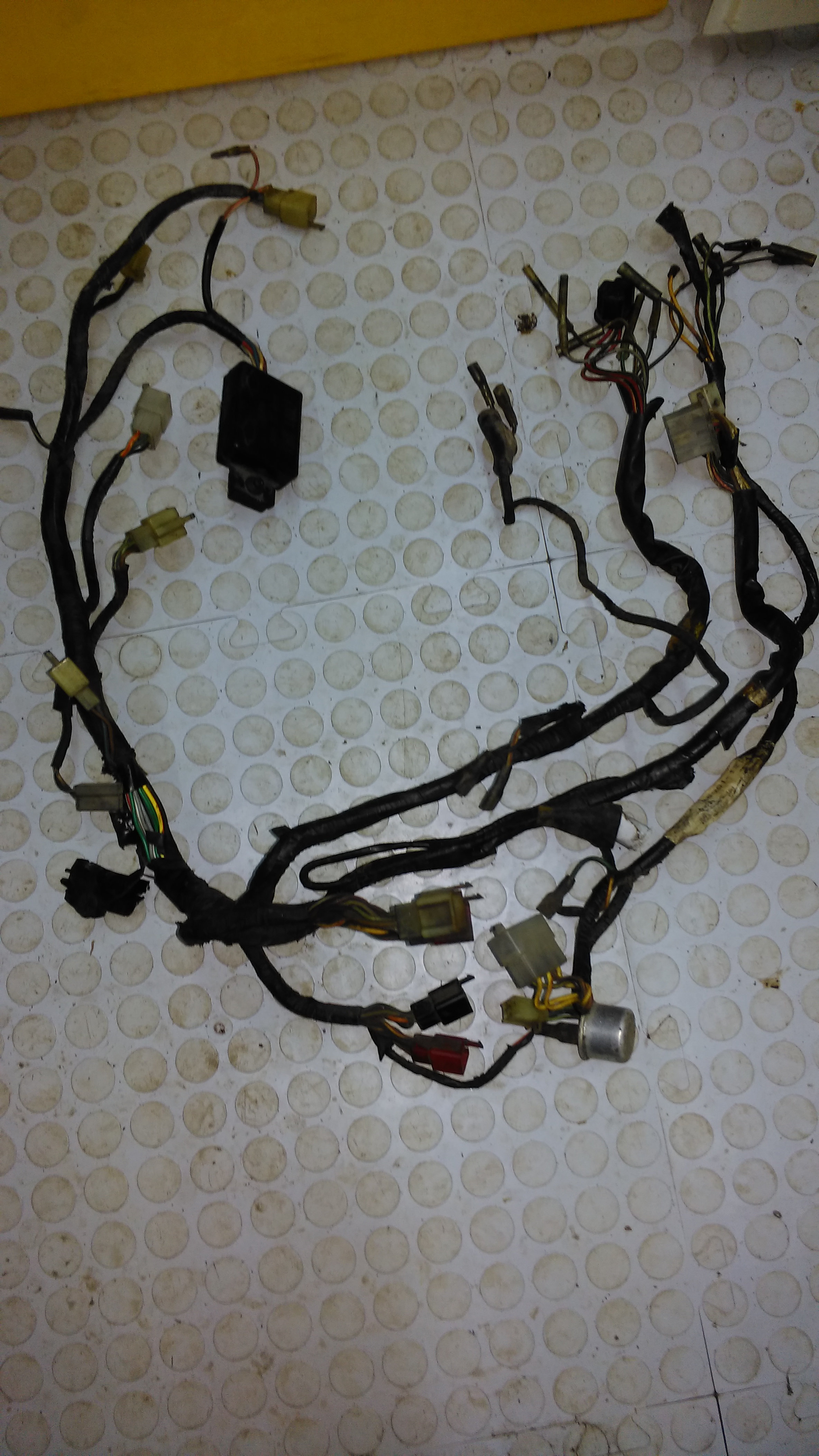

As I'd already said, there were corroded terminals, damaged/hardened cables, repairs and it's a 35 year old loom. I could have had it repaired, but I've suffered too many strange issues with dodgy electrics, so I commissioned a new loom and all switches/senders,etc were stripped, checked and cables replaced to give them a clean bill of health.
Old Loom
New Loom

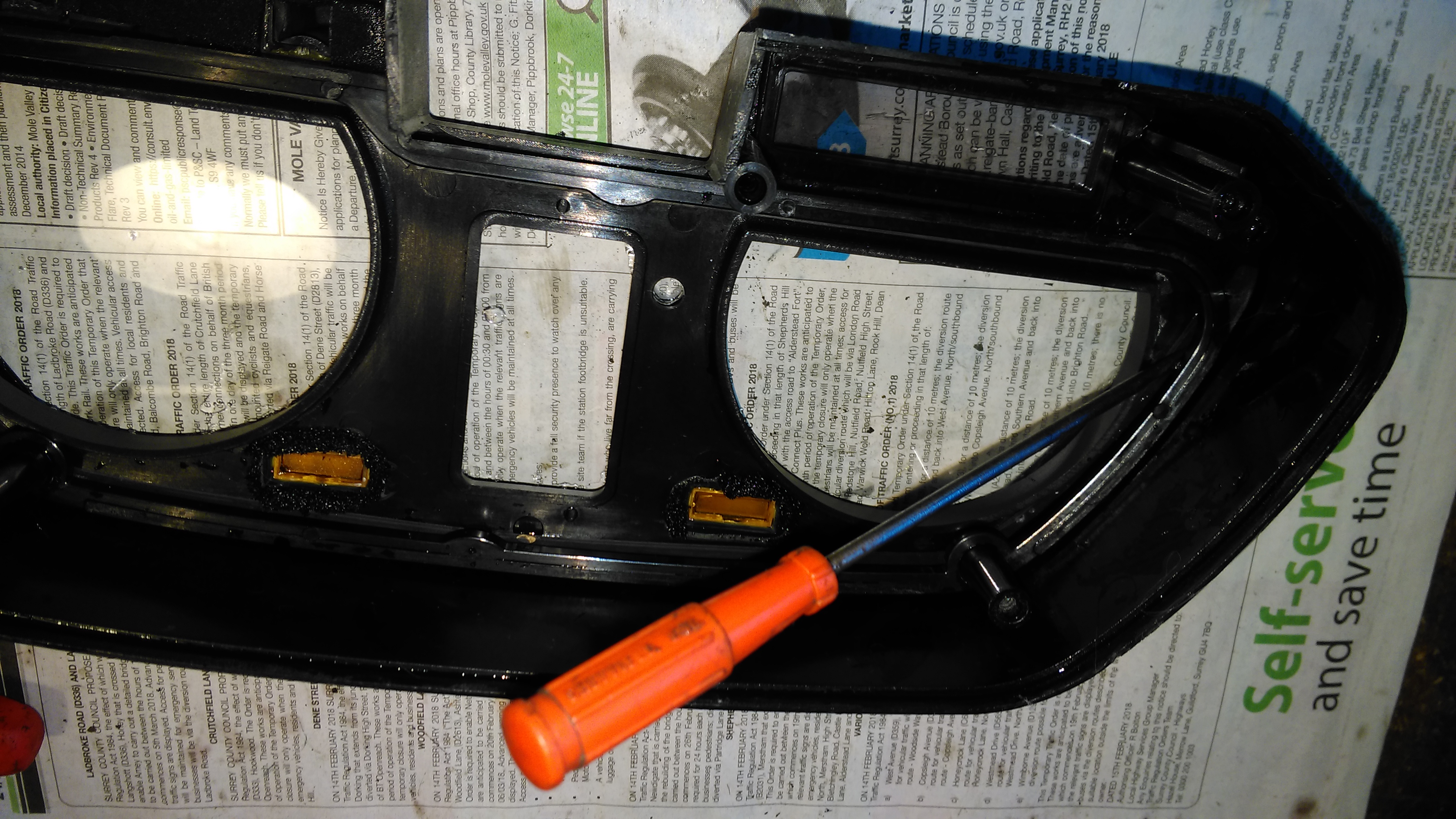

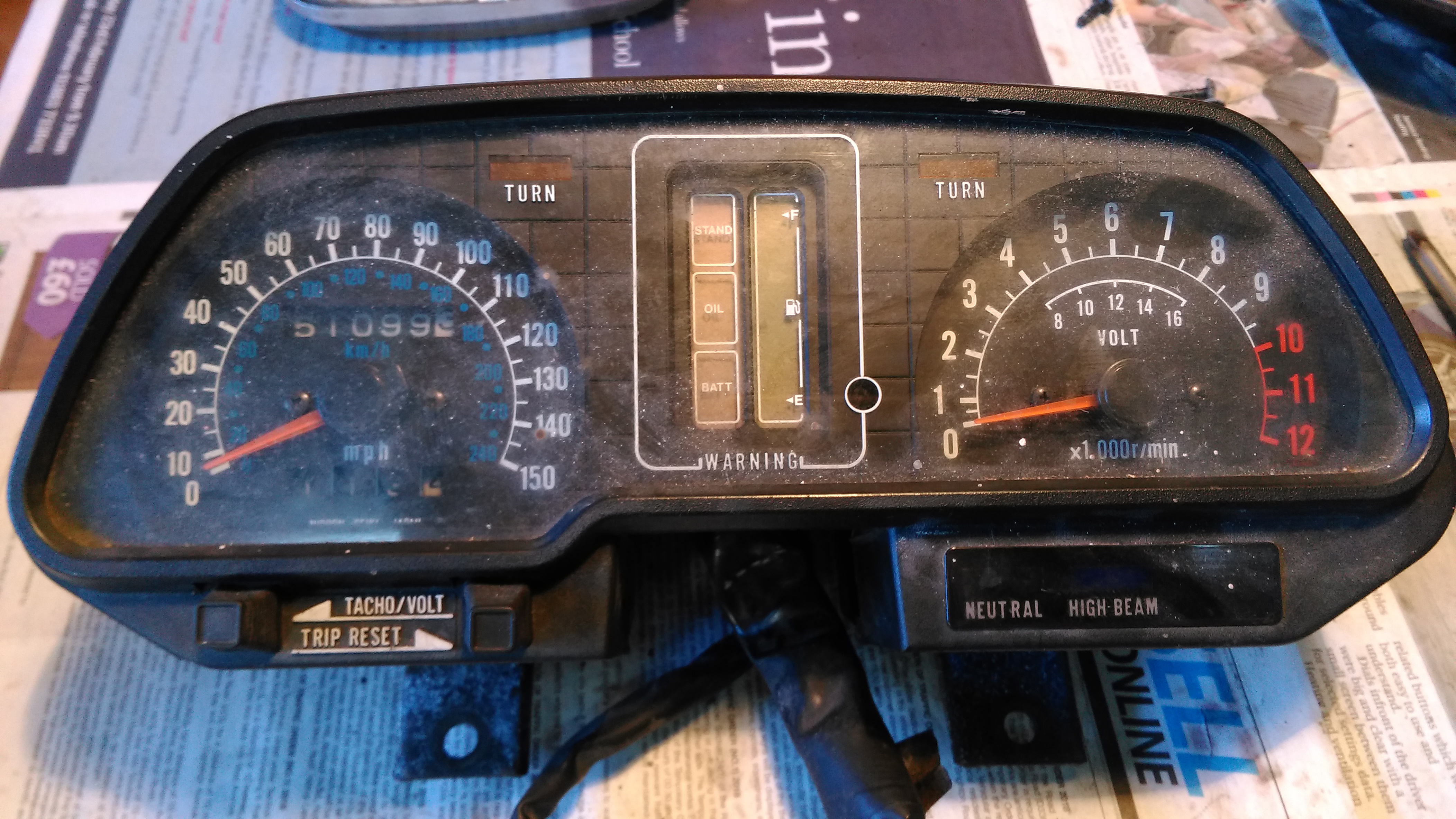

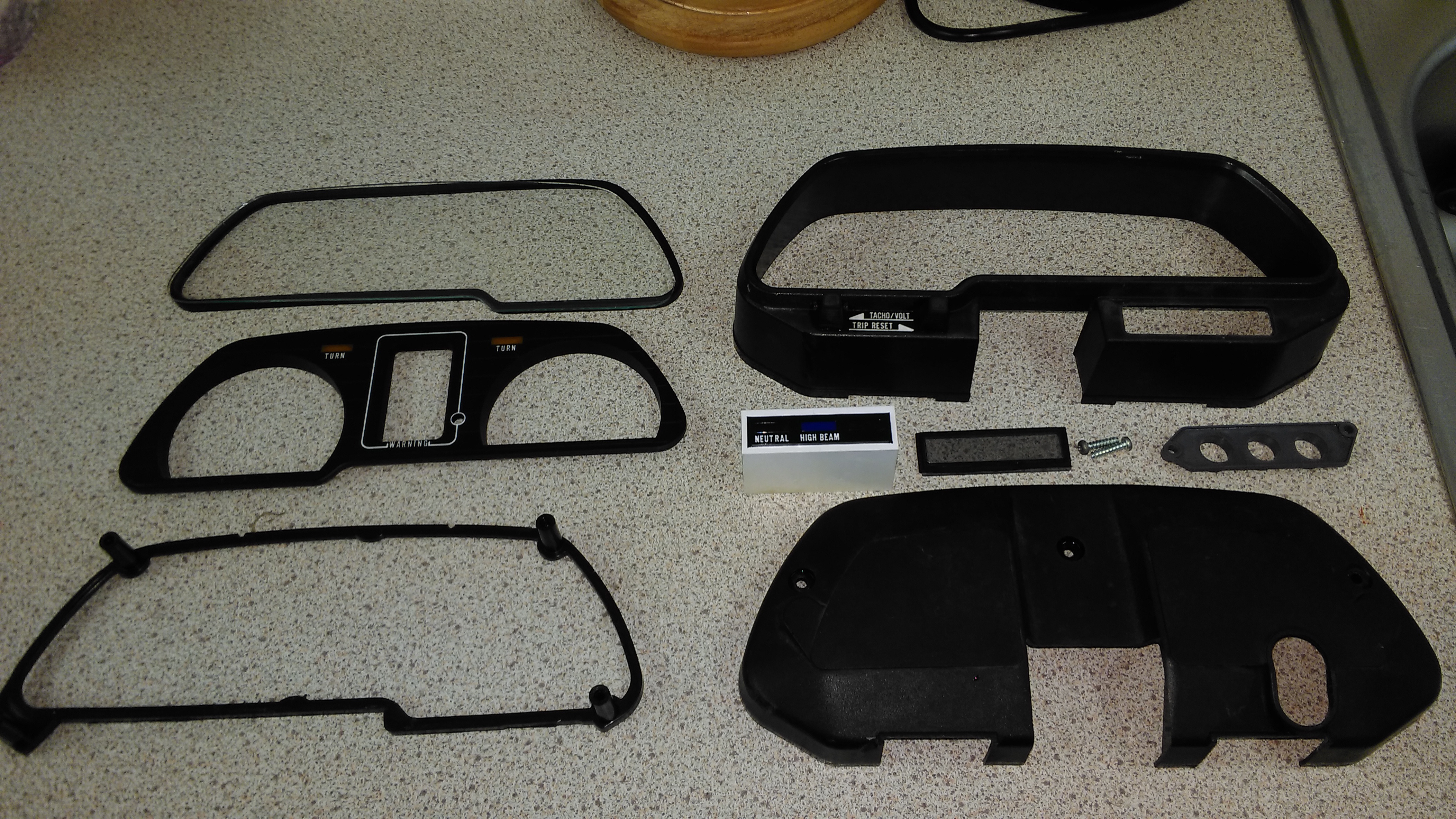

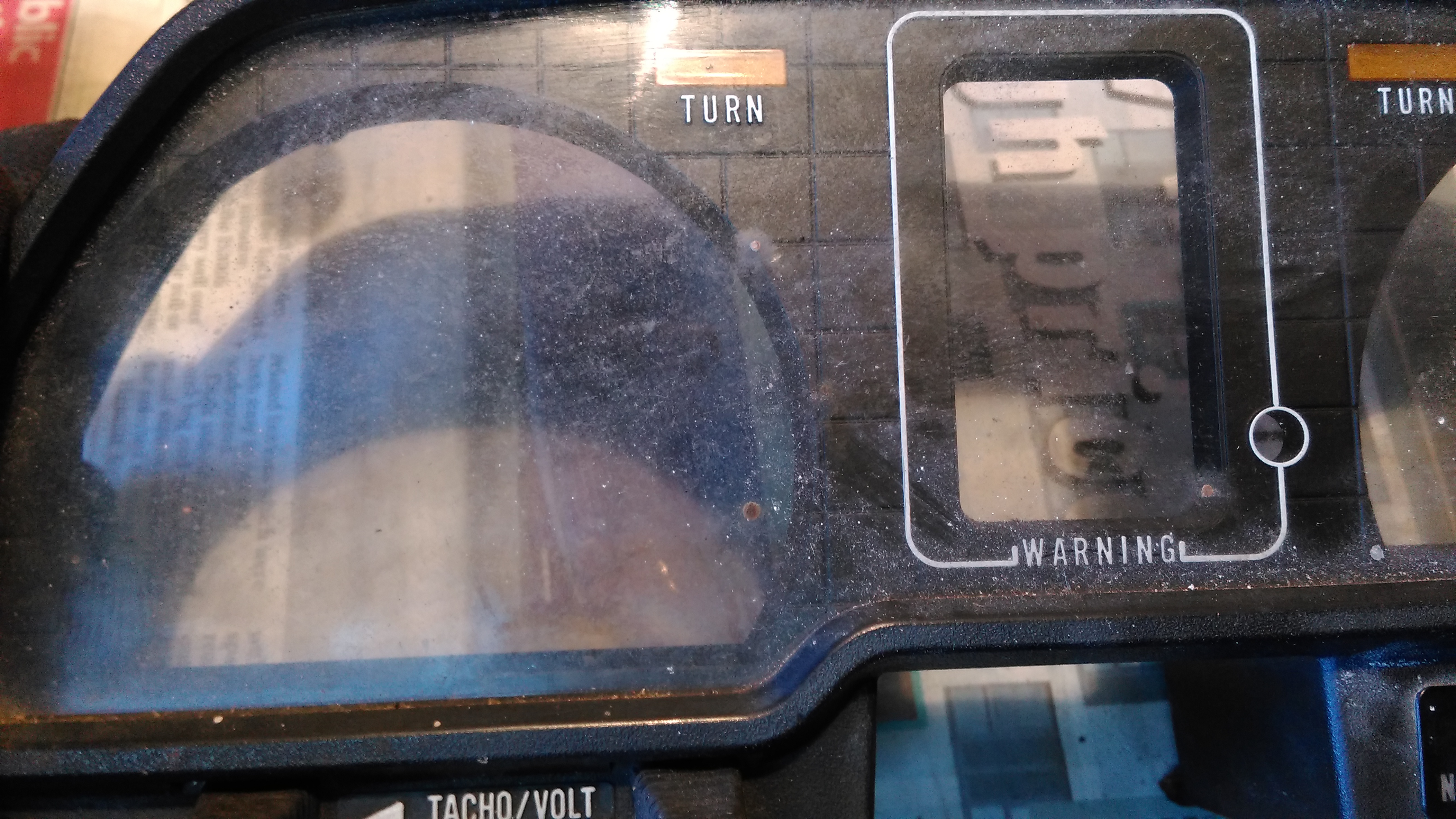

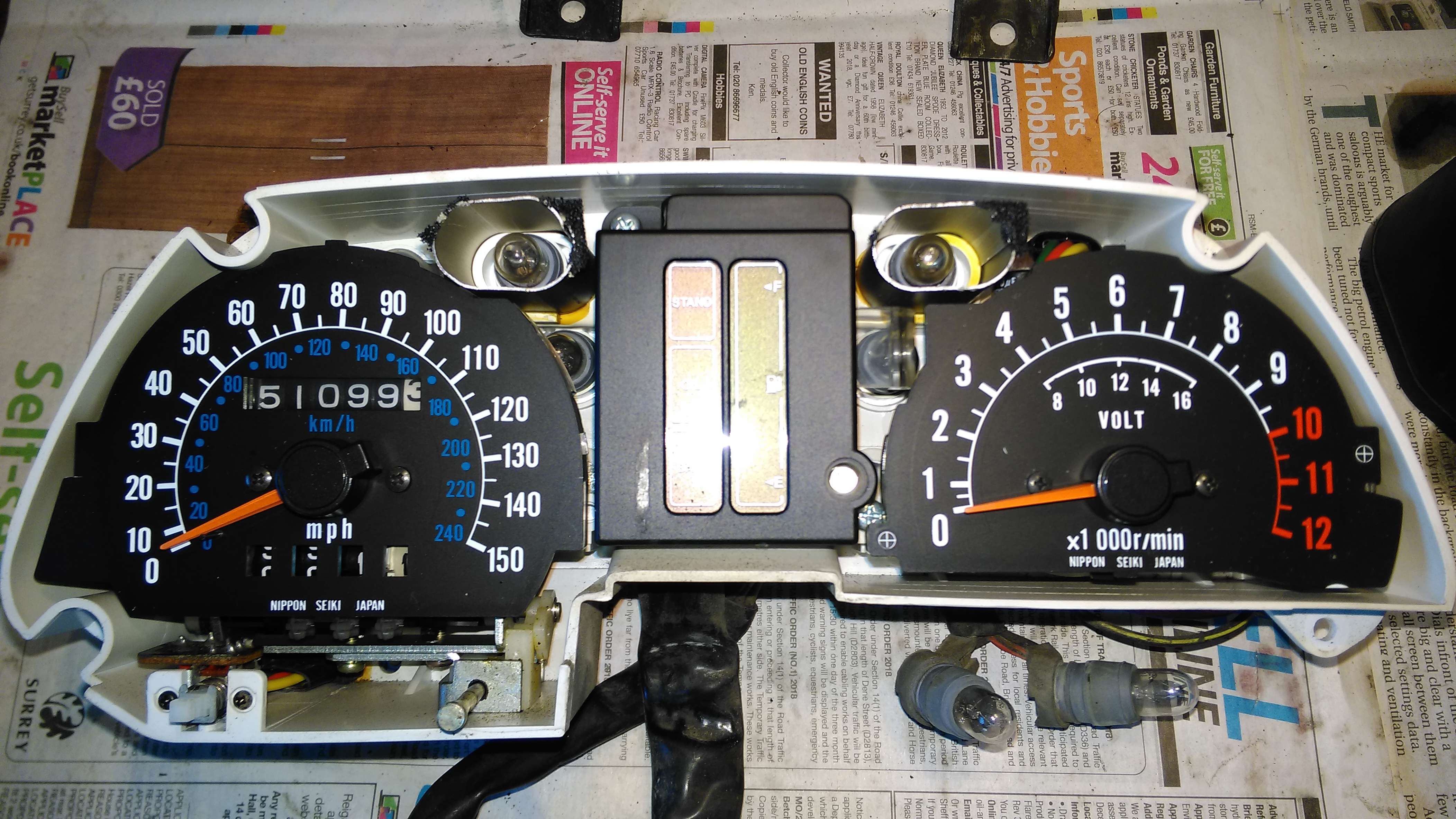

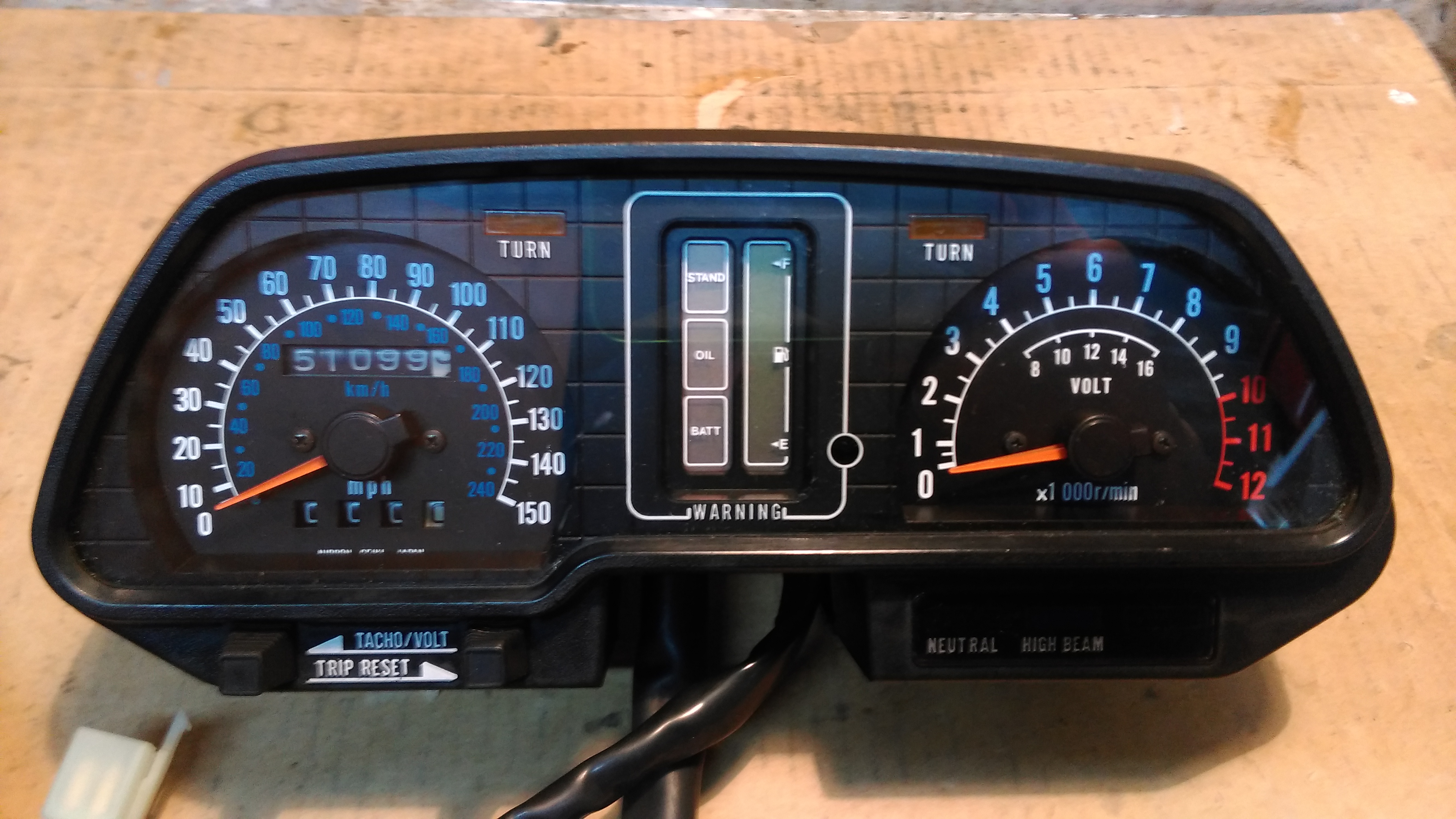

I've also stripped and cleaned the clocks as they were looking tatty. The worst part of this was removing the inner strip that holds in the clear plastic face panel. Some judicious use of a small screwdriver persuaded it to part company so I could clean it thoroughly. Reassembly wasn't too bad, just fiddly. I didn't zero the milage as I want to keep the history of the bike intact where I can.
Before
Face plate off and the internals don't look at all bad
35 years of grime....
Teasing off the cover
All stripped
All reassembled and looking good

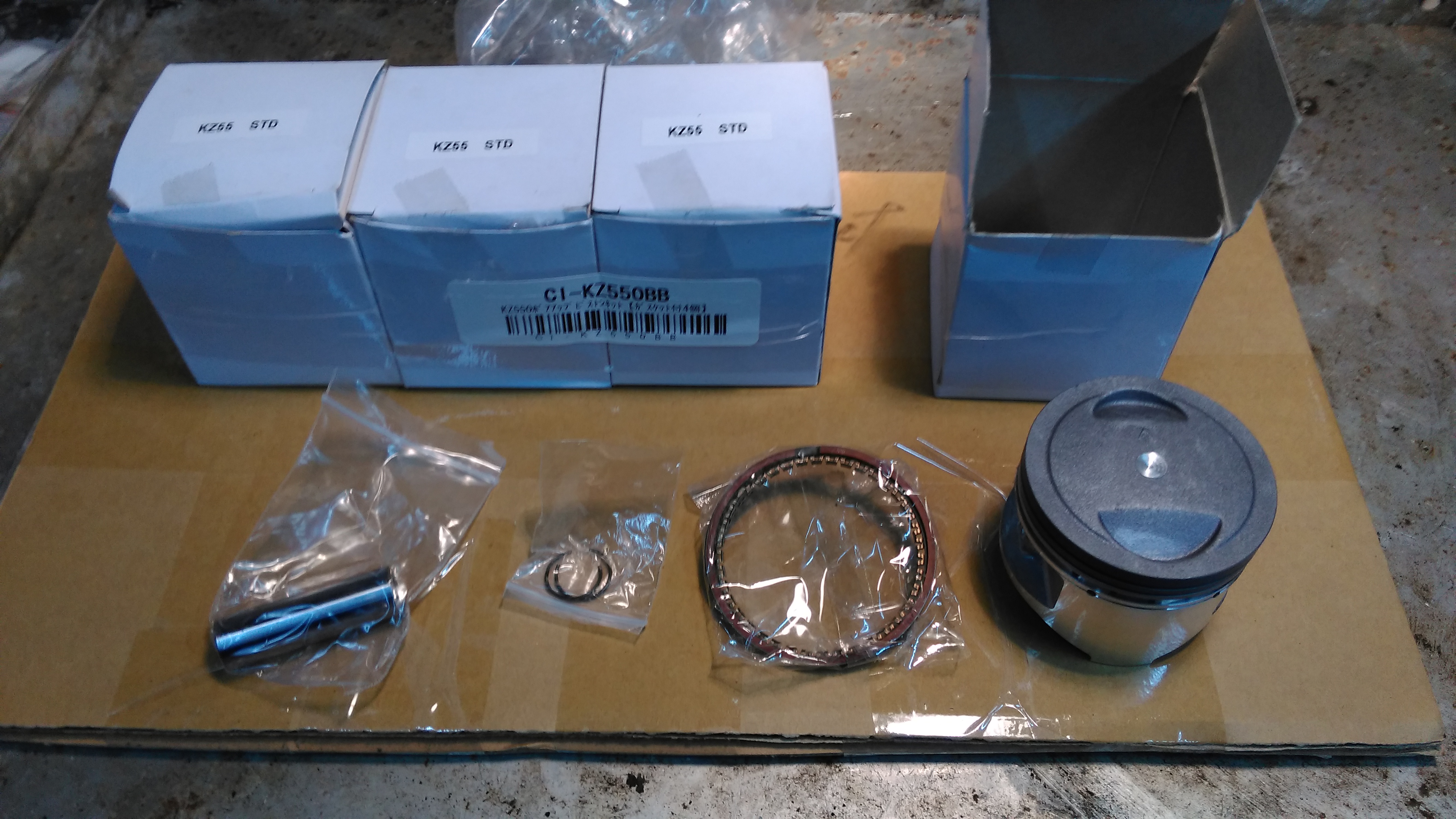

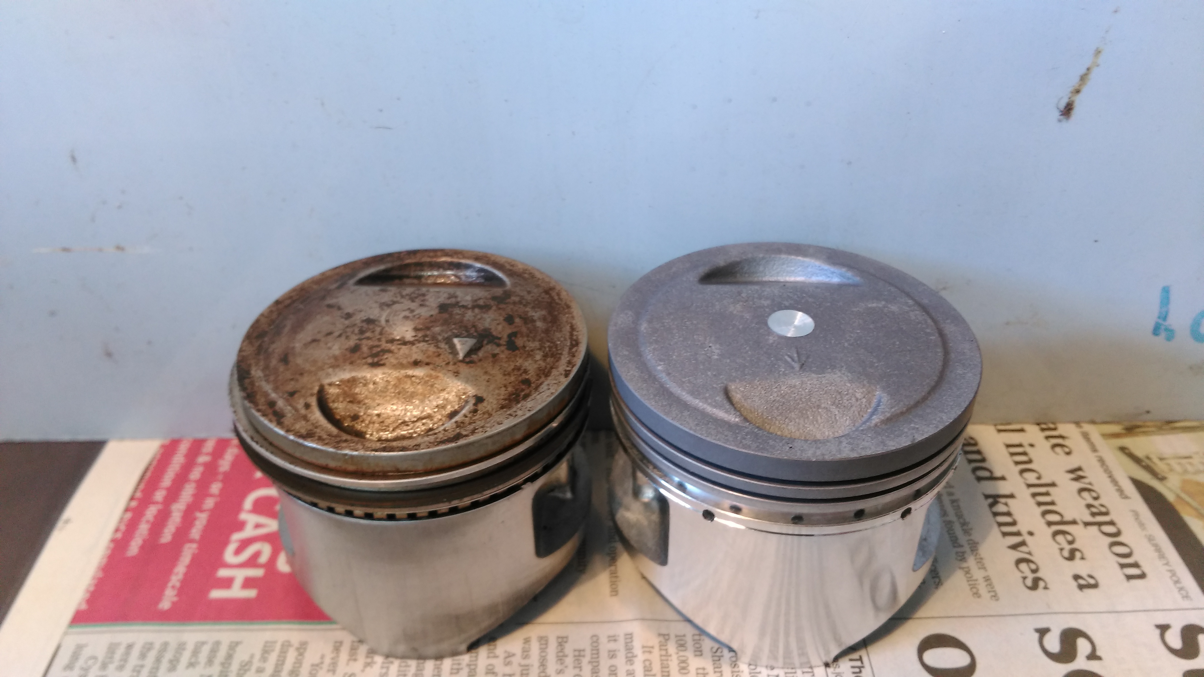

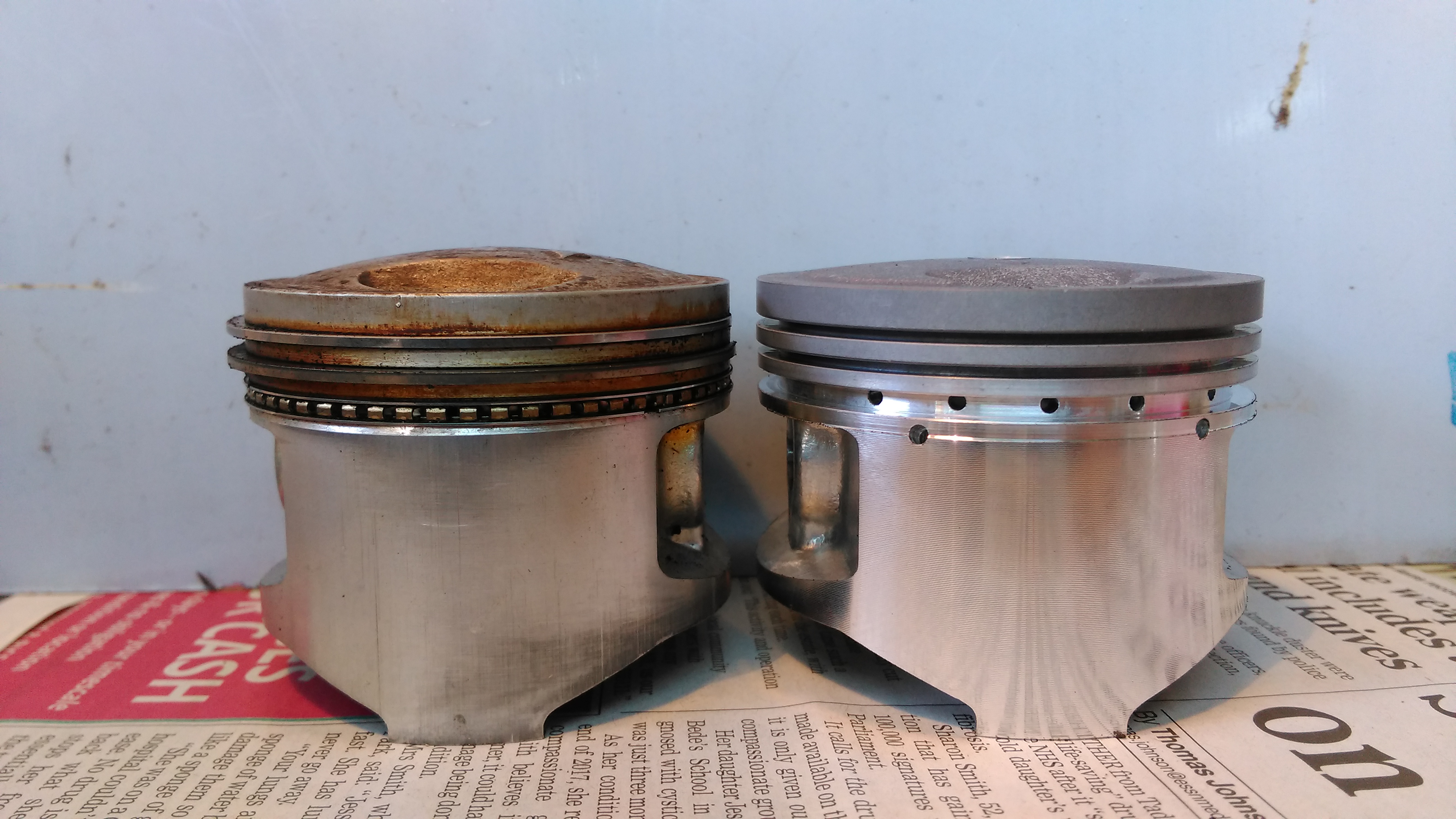

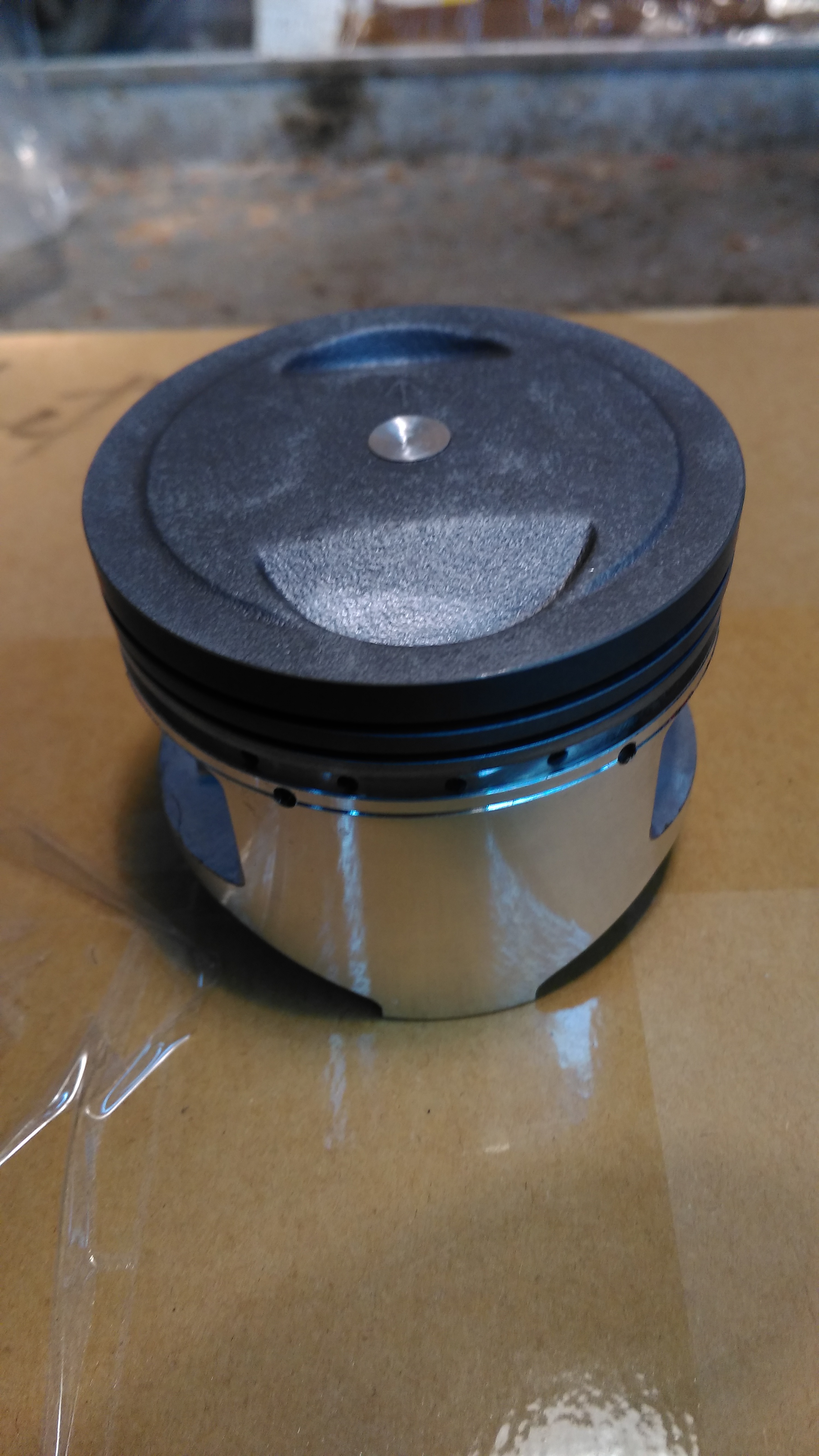

As I've said earlier in this thread, this is not going to be a rebuild to standard spec and one of the upgrades I'm doing is increasing the capacity of the engine to 615cc. This means a 3mm O/S piston, but I'm not using Wiseco pistons, but Cruzin Image. Some may question that decision, but at 1/3 of the cost of the equivalent Wiseco kit, I thought I'd take the chance :D The CI pistons are cast not forged, but as this is a road bike and not a race engine, I do not believe this will matter.
I've already had the barrels bored by the guy that has done my engines for the last 30 years. He was quietly impressed with the CI pistons, declaring they "looked OE" spec and he's seen a few pistons in his time !
The crown height is slightly lower than the standard piston, but that doesn't bother me as the head has been skimmed in the past. In fact, the increase in bore means the CR turns out to be just about the same as the standard set up :D
CI Piston Kit
CI Piston against Standard
