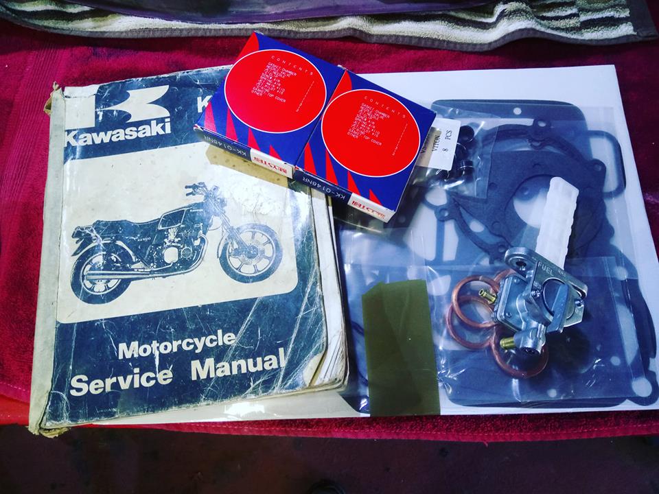

A few parts arrived now. The fuel tap wasn't flowing very well for some reason even on prime. A new one wasn't over expensive. The obligatory carb kit for a bike that's been laid up for a while and a gasket set..... And a block of pure gold . A Kawasaki shop manual.....
