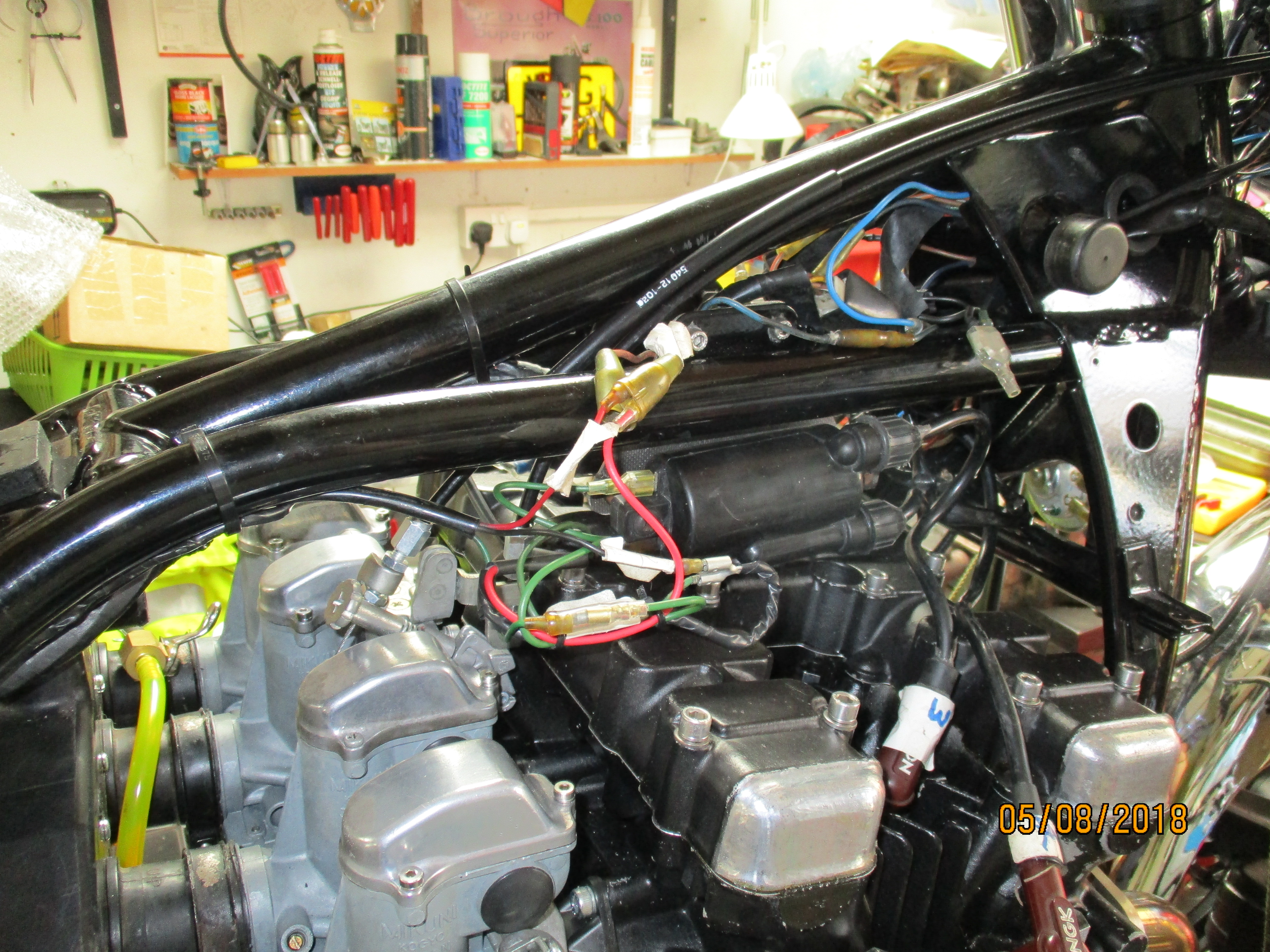

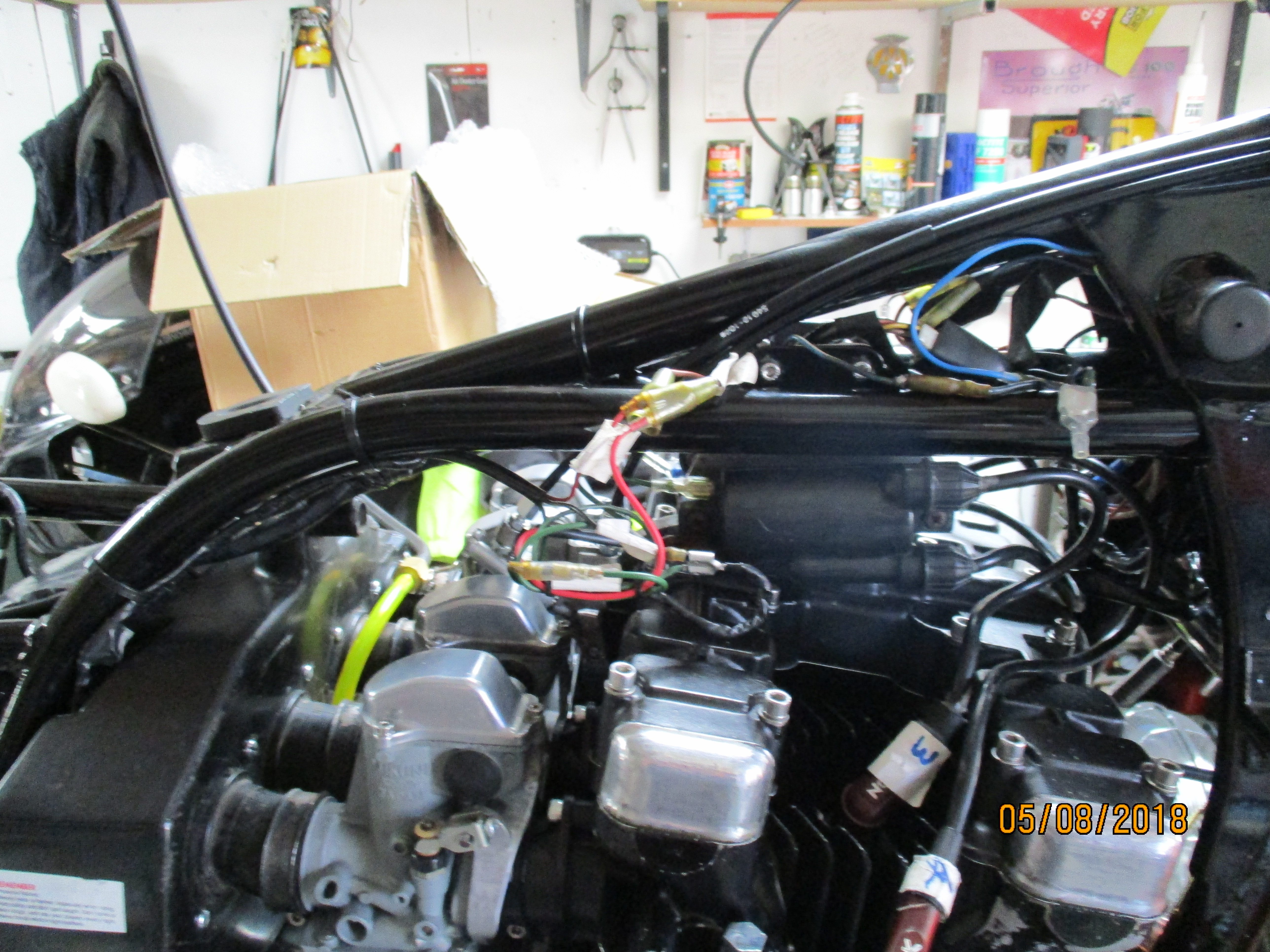

#17 PostAuthor: Dunlop4 » Sun Aug 05, 2018 7:20 pm

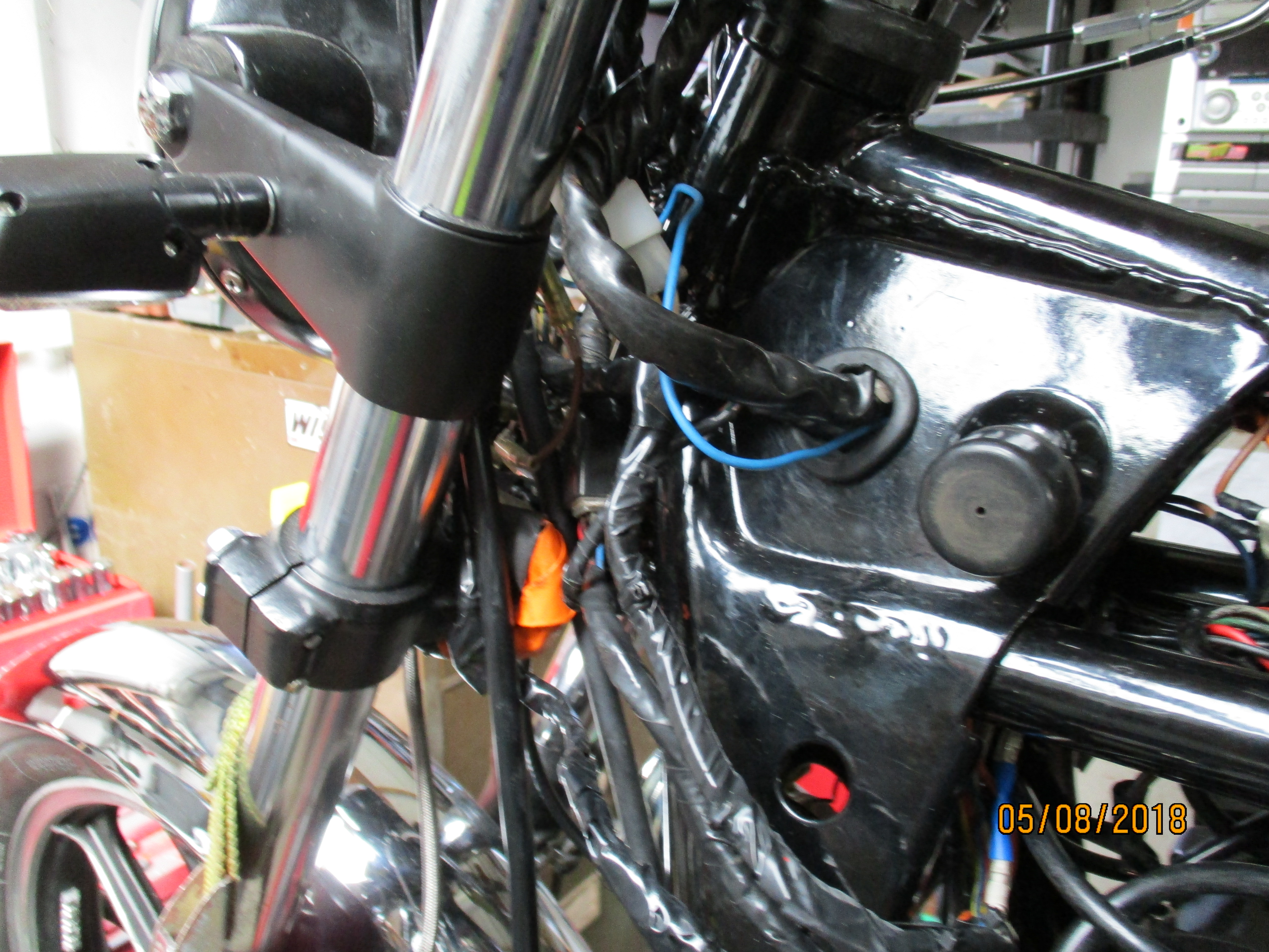

Today i attempted to tidy up the wiring, with mixed results.
I am trying to get the routing right to give it a semblance of order.
After this i will attempt to get it MOTed

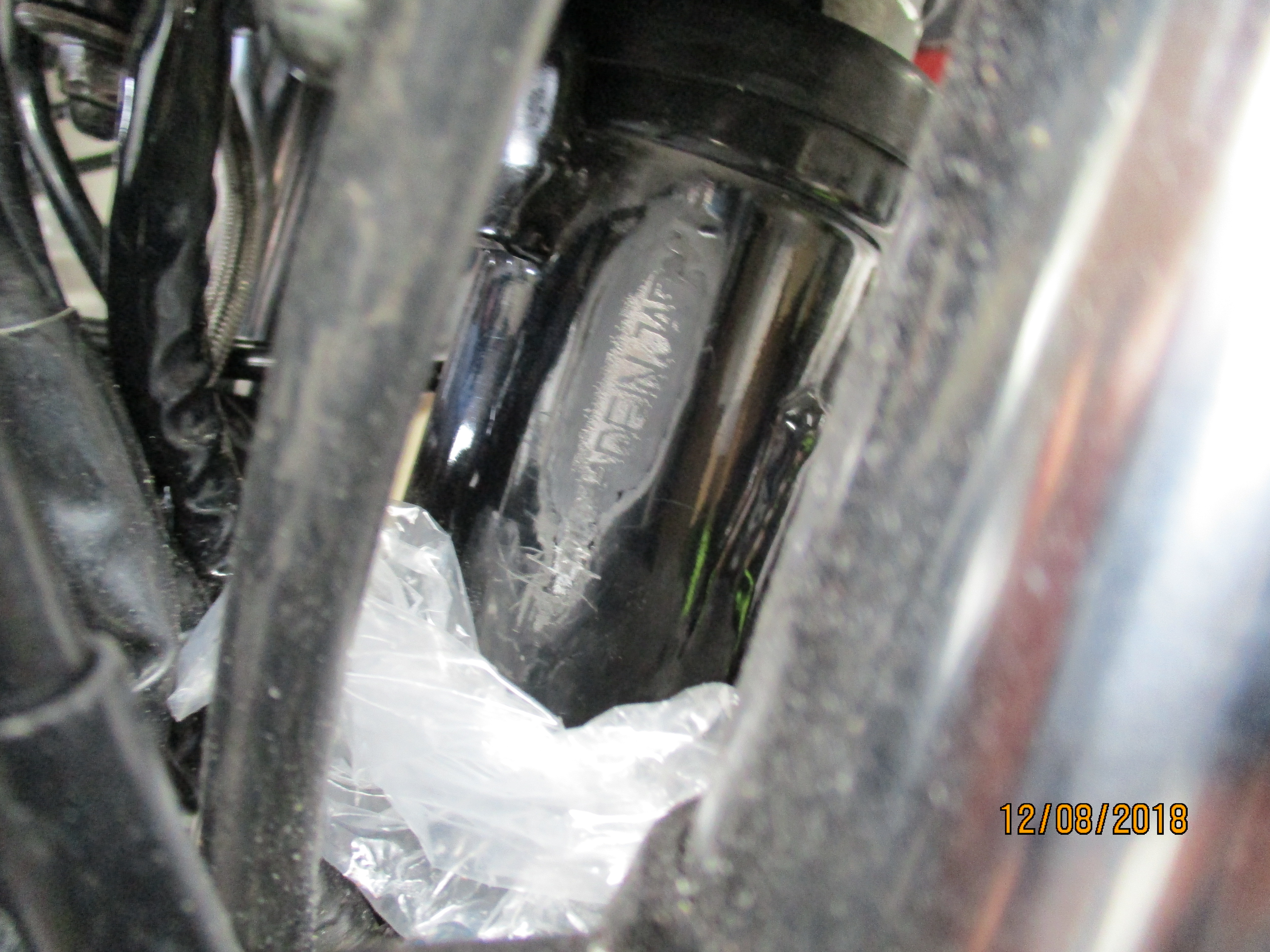

i need to find the frame number for the mot
I have scraped some of the powder coat off the steering head, But only found the made in japan stamp, Does any one know where the frame number are?

#19 PostAuthor: Philippe » Sun Aug 12, 2018 6:17 pm
Hi
the frame number is on the left hand side of the steering head, close to the "made in japan" stamp.

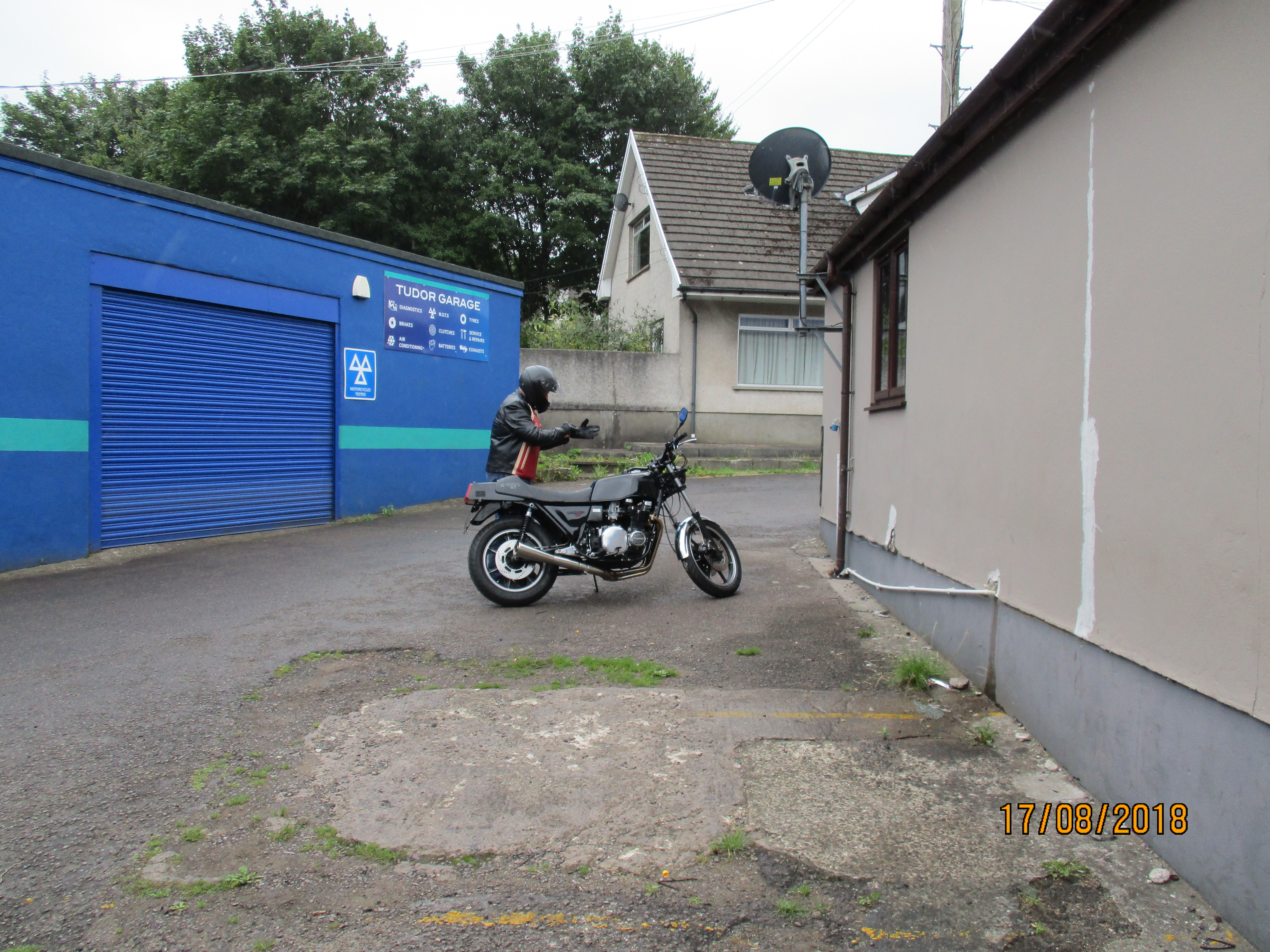

#20 PostAuthor: Avon ST » Sun Aug 19, 2018 2:52 pm

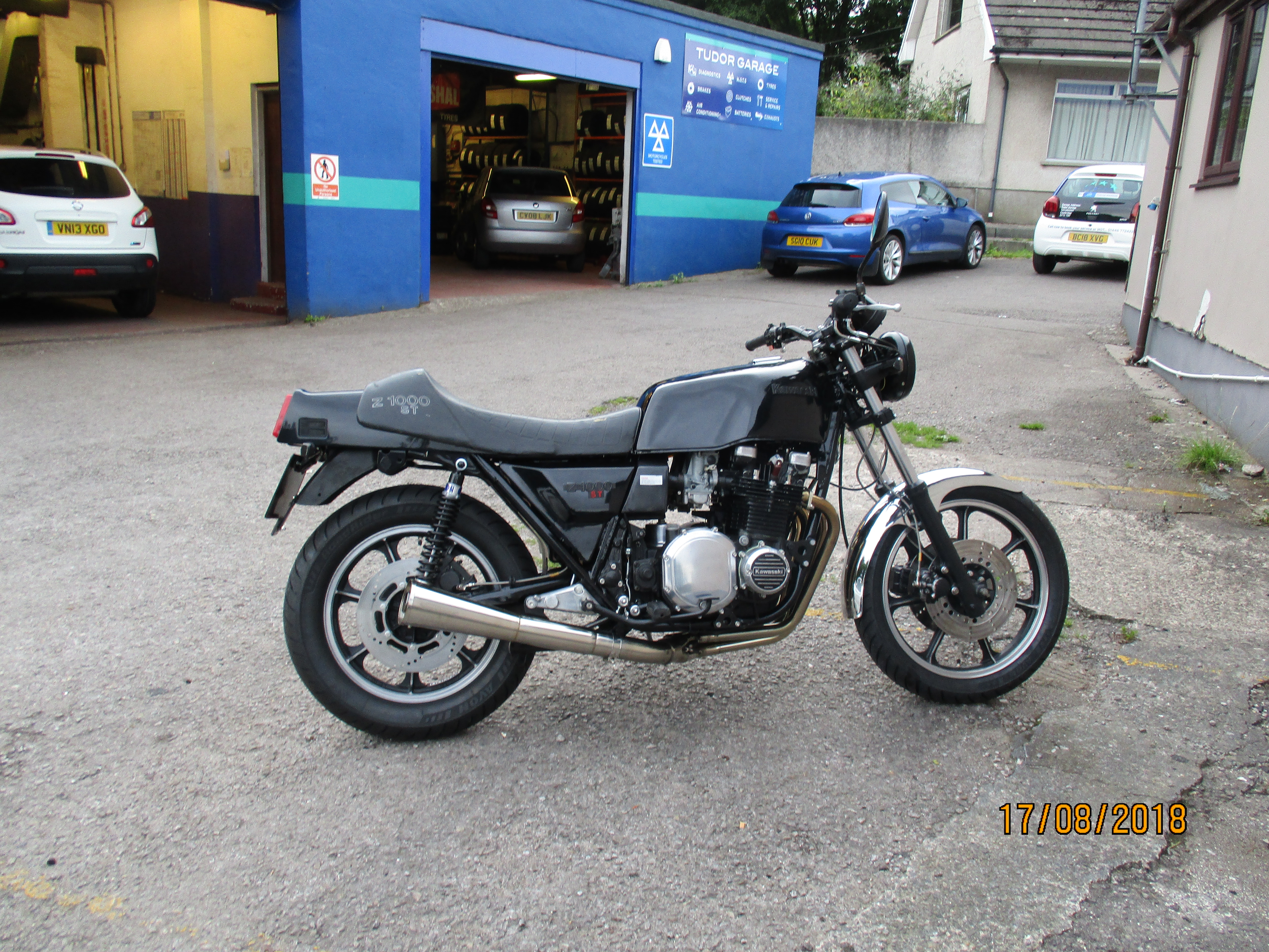

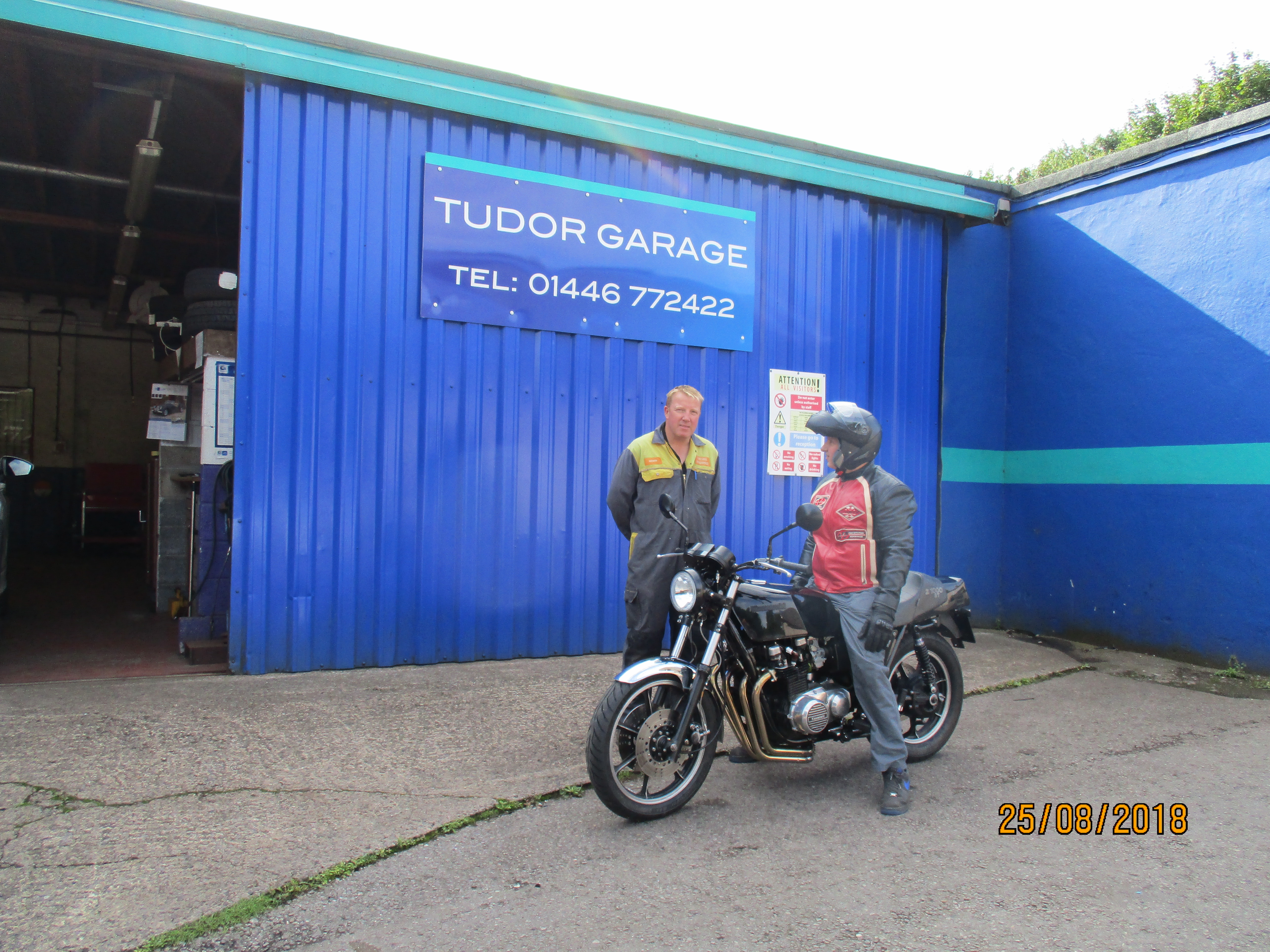

Setting off for mot first time in 18 years
Waiting for mot

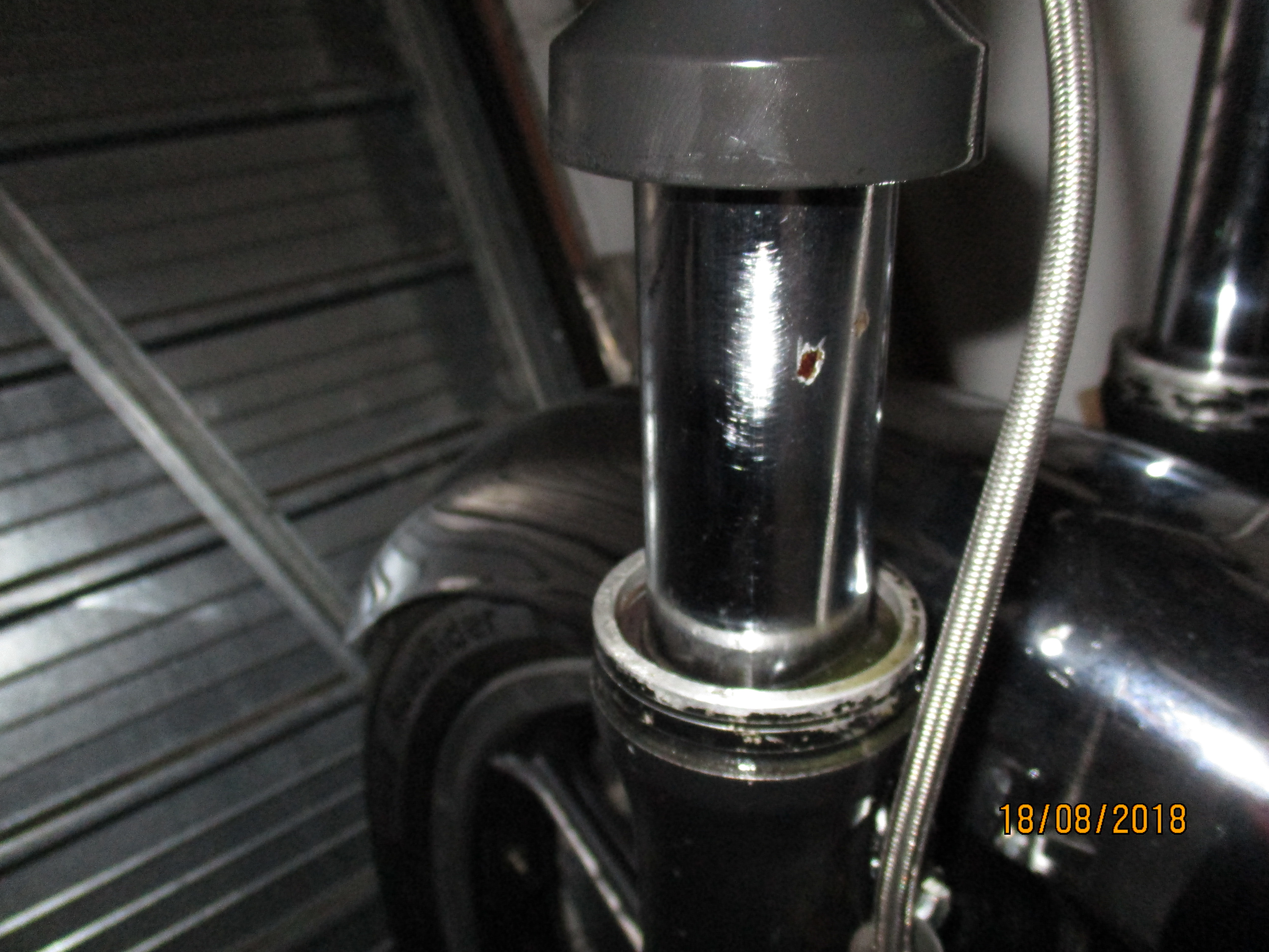

Failed mot on leaking fork seal and no passenger foot rest

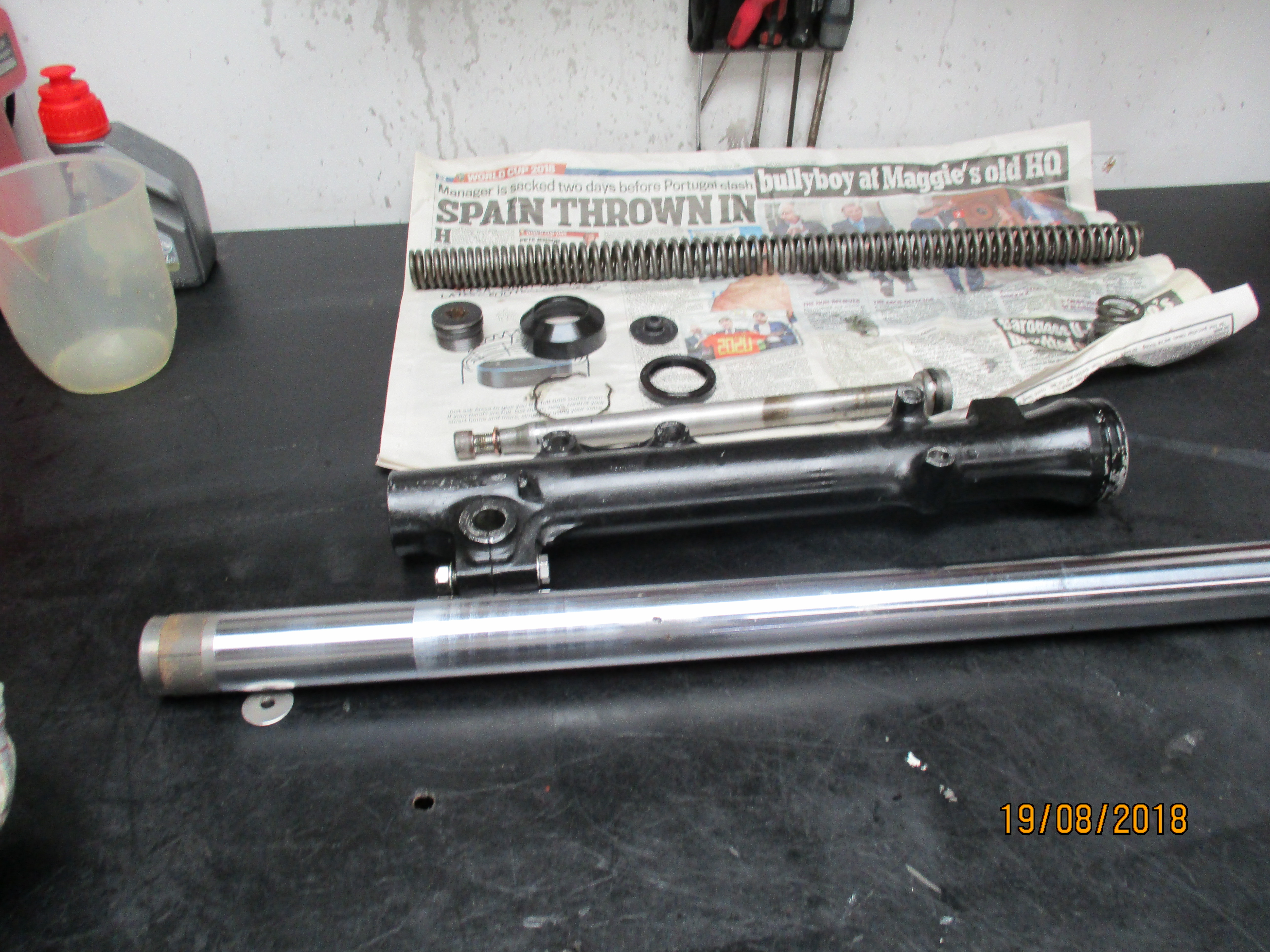

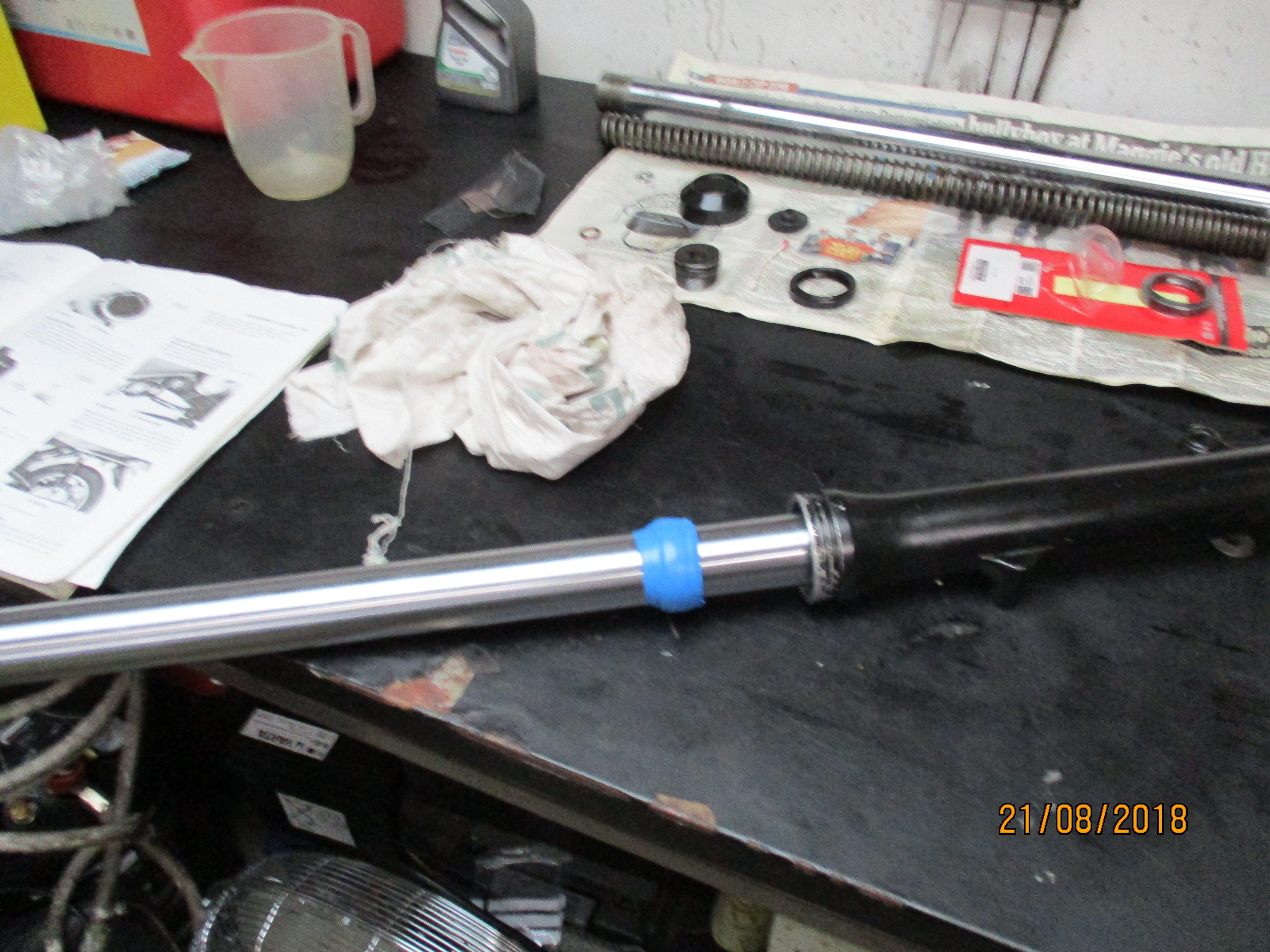

#21 PostAuthor: Avon ST » Sun Aug 19, 2018 3:06 pm
This is the offending fork seal. caused by a pitted stanchion.
Fork stripped ready for new stanchion and seal.

#22 PostAuthor: Philippe » Sun Aug 19, 2018 3:15 pm
Hi Avon
don't let a little set back get you down, replace both the fork oil seals and put some passenger footrests on your bike, these are only minor problems, no big difficulties with huge amounts of costs and work.
Go for it! You can fix it.
During the time I was writing a reply, you allmost fixed the little problem! Good to see that you allso put a new stanchion in it. Once the chrome is damaged it's useless to place new seals, they get damaged after a few miles and the work you did is lost. The rubbing of the sharp edges causes damage to the seal.
When the chrome is damaged above the normal working range of the stanchion there is no problem.

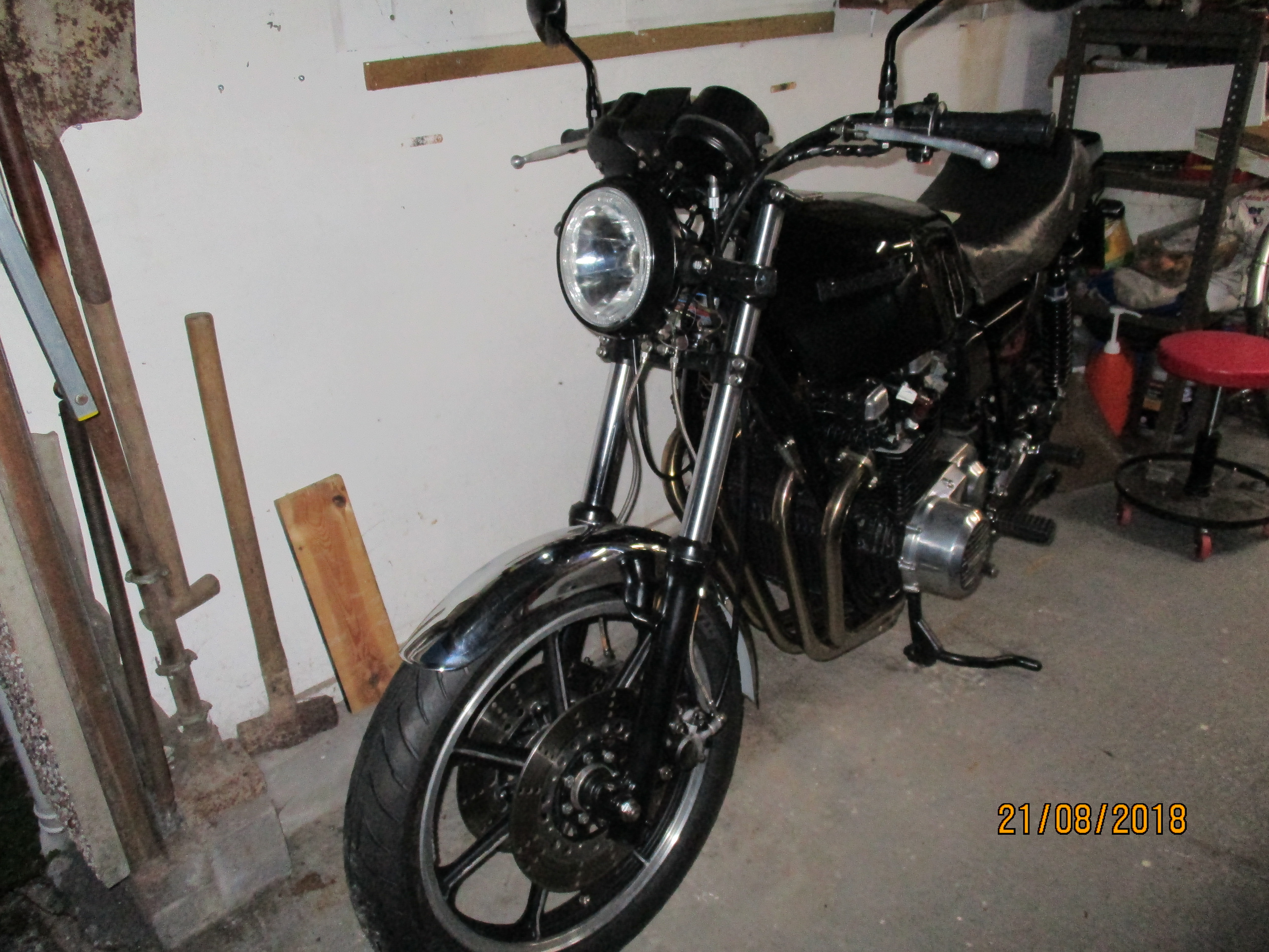

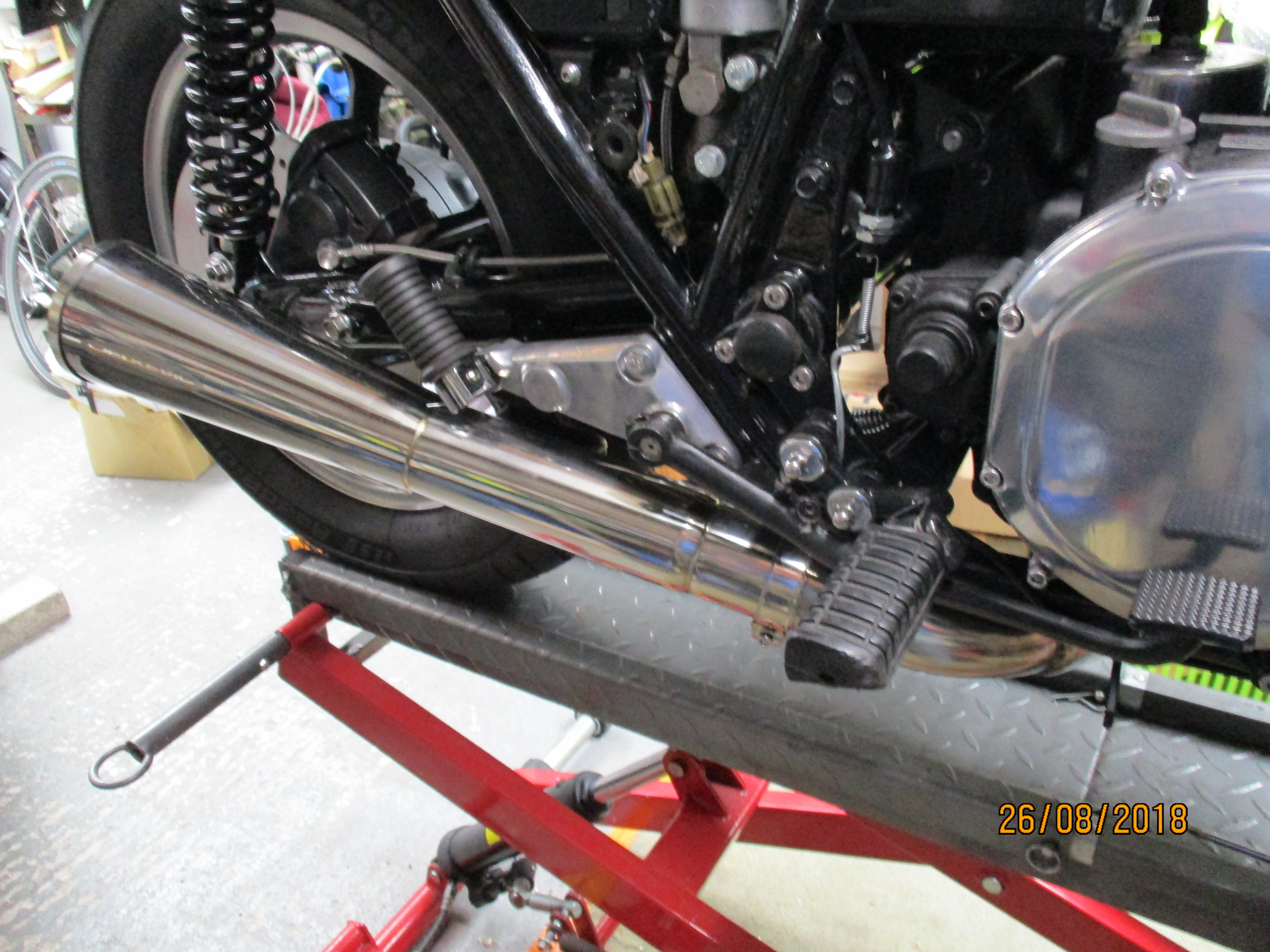

#24 PostAuthor: Avon ST » Sun Aug 26, 2018 4:54 pm
New fork stanchion and seal fitted
Parts all fitted

Ready for mot retest
Passed mot happy mot inspector

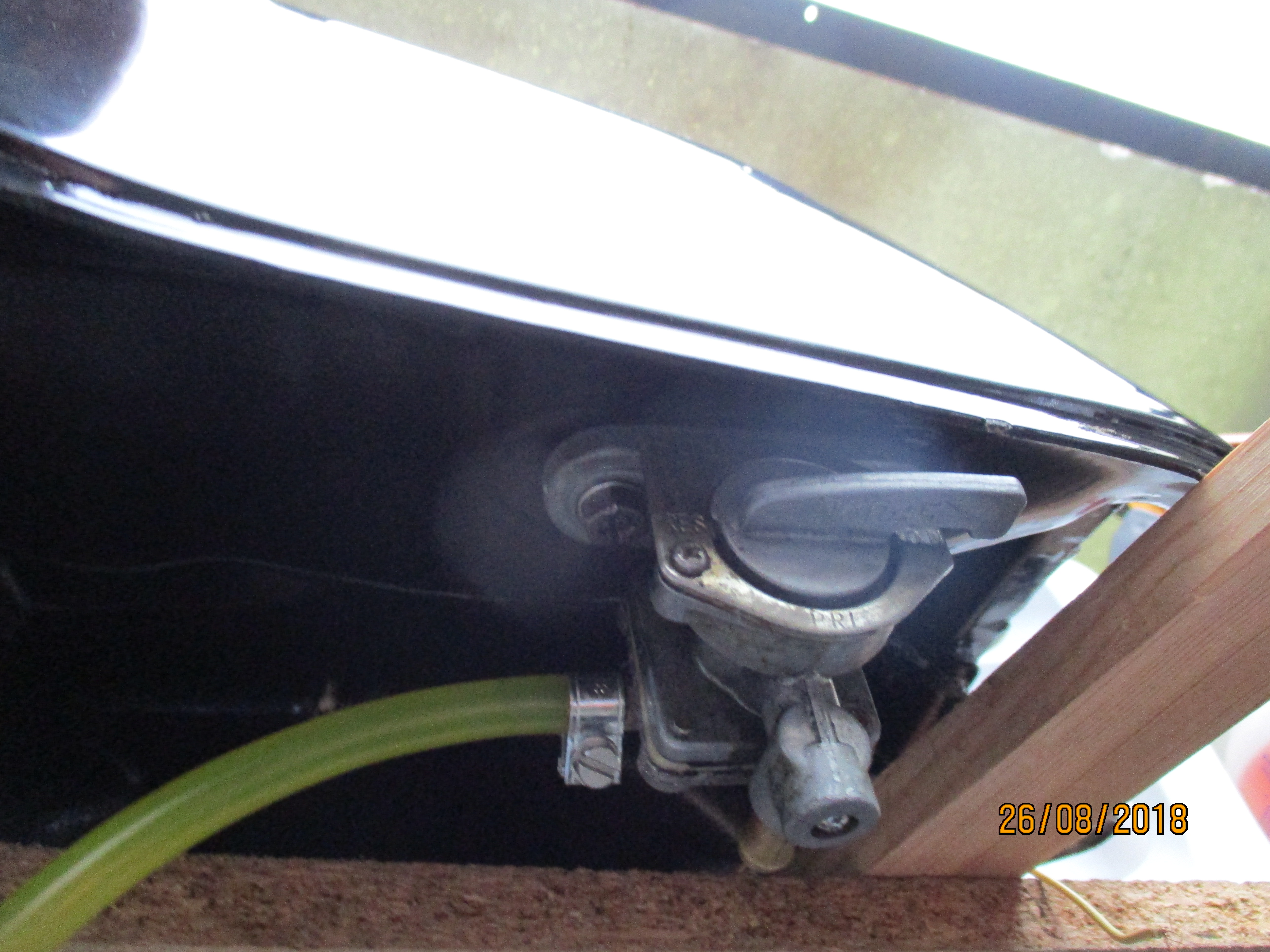

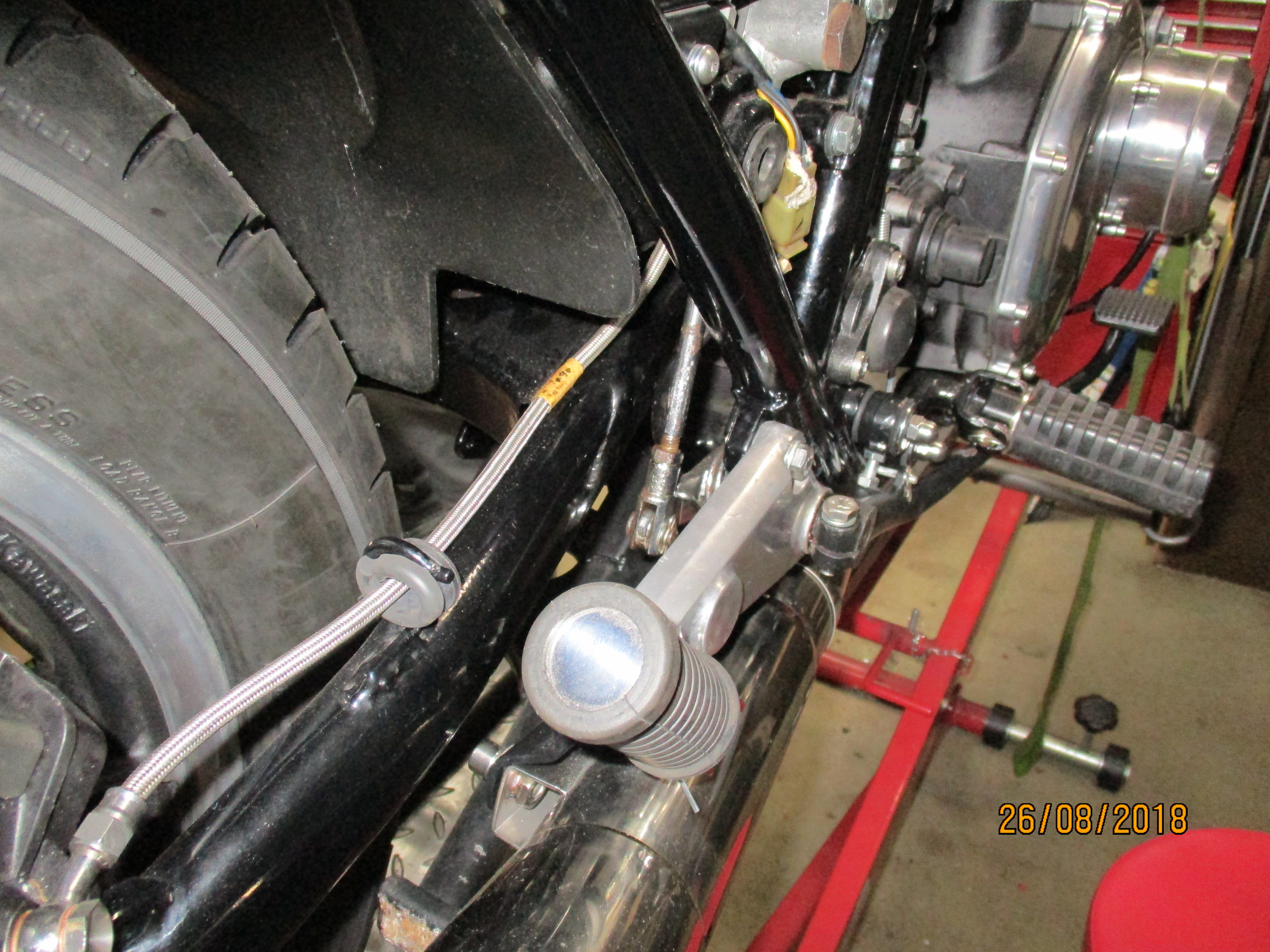

#26 PostAuthor: Avon ST » Sun Aug 26, 2018 5:29 pm
After i came back from mot the rear brake disc was very hot
I backed off the push rod
Small leak off fuel tap bolt

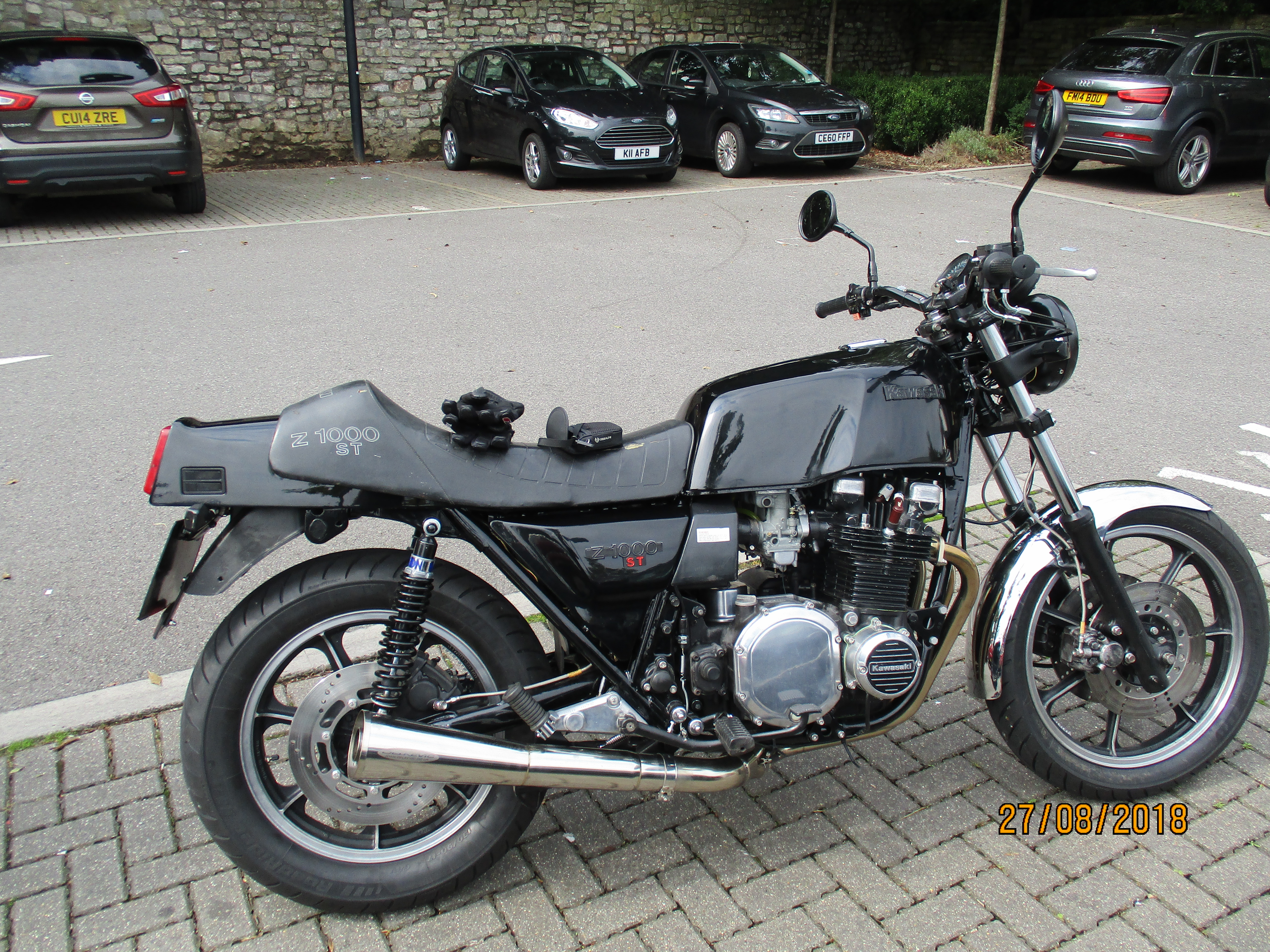

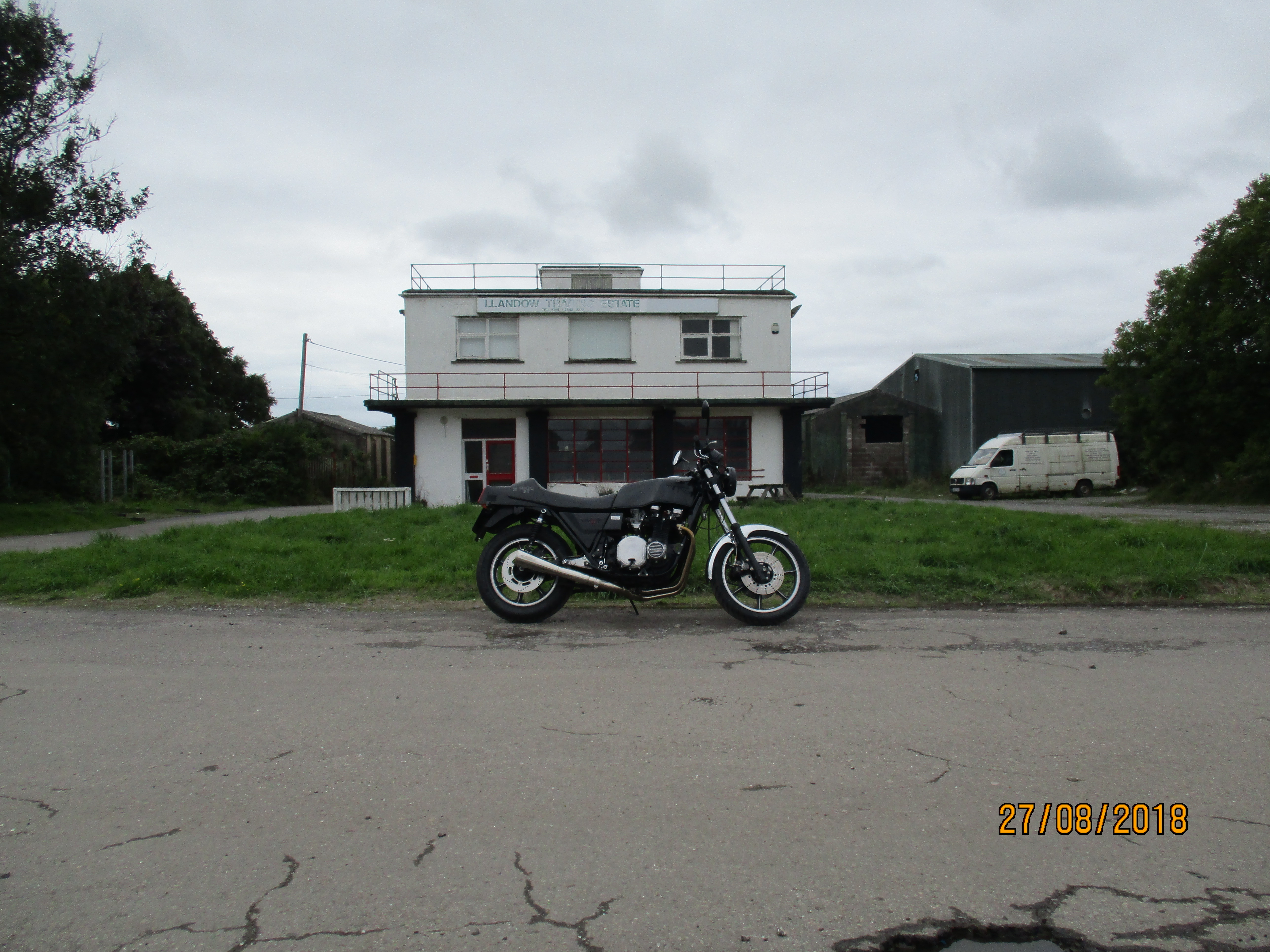

#29 PostAuthor: Avon ST » Mon Aug 27, 2018 5:30 pm
First run out coverd 50 miles
alast problem with back brake to much play on brake pedal
Avon ST
Posts: 24
Joined: 29th May 2018
Location: Cardiff
Re: Z 1000 St E2
#30 PostAuthor: Avon ST » Mon Aug 27, 2018 5:41 pm
During the run out there was a problem with the back brake there to much play on the brake pedal
