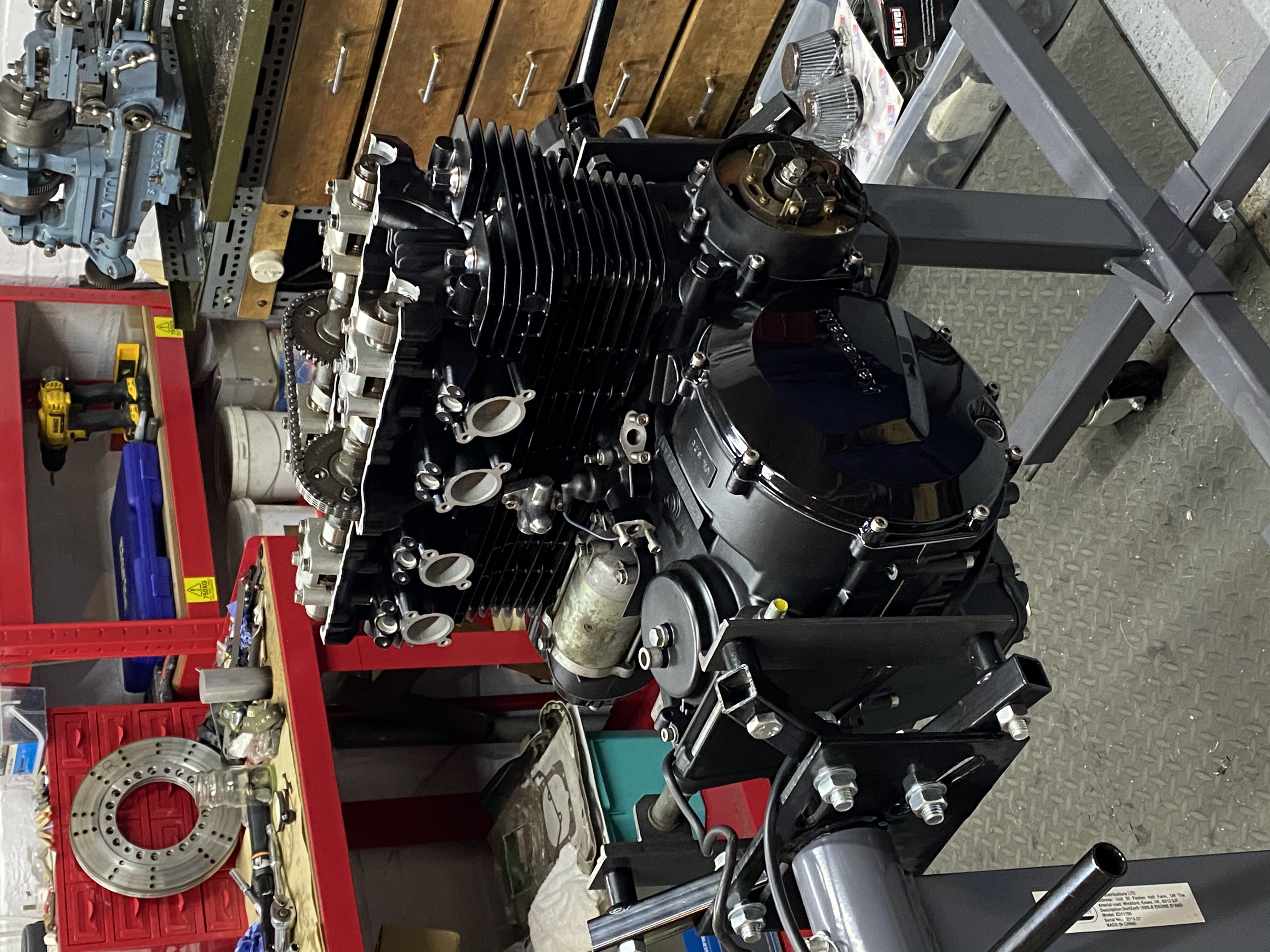

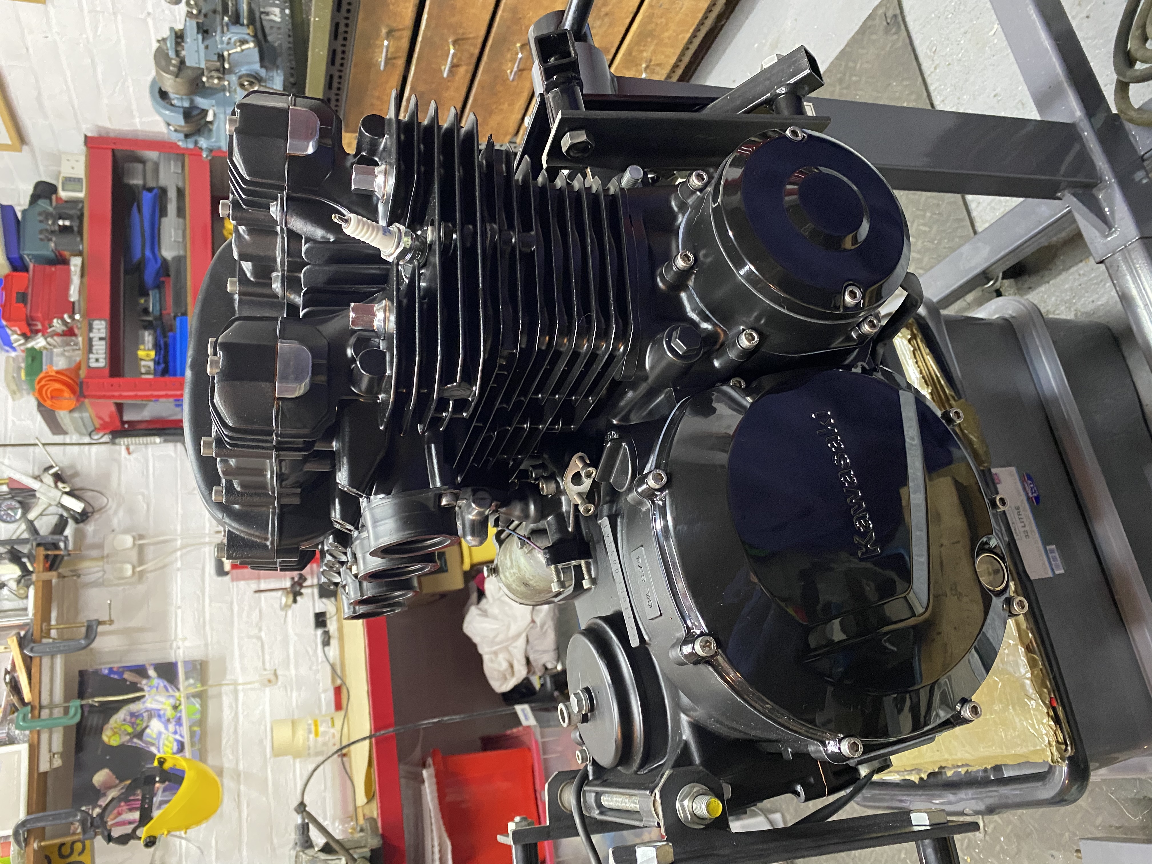

I've had a bit more progress on the GPZ since my last post.
The engine casings have been prep'd and sprayed.
The bottom end is now nearly back together and looking like new. I used the Simoniz tough black paint for the first time and very pleased with the results.
No worn parts in the bullet proof bottom end.
I obviously replaced all gaskets and also used new seals.
New stainless allen screws were fitted where needed and a new cam chain fitted.
And most importantly, everything turns as expected and all the gears work

New oil filter back in and a new sump plug (magnetic) to replace the knackered one.
After all that I can spin the engine over and start on the pistons, barrels, head etc

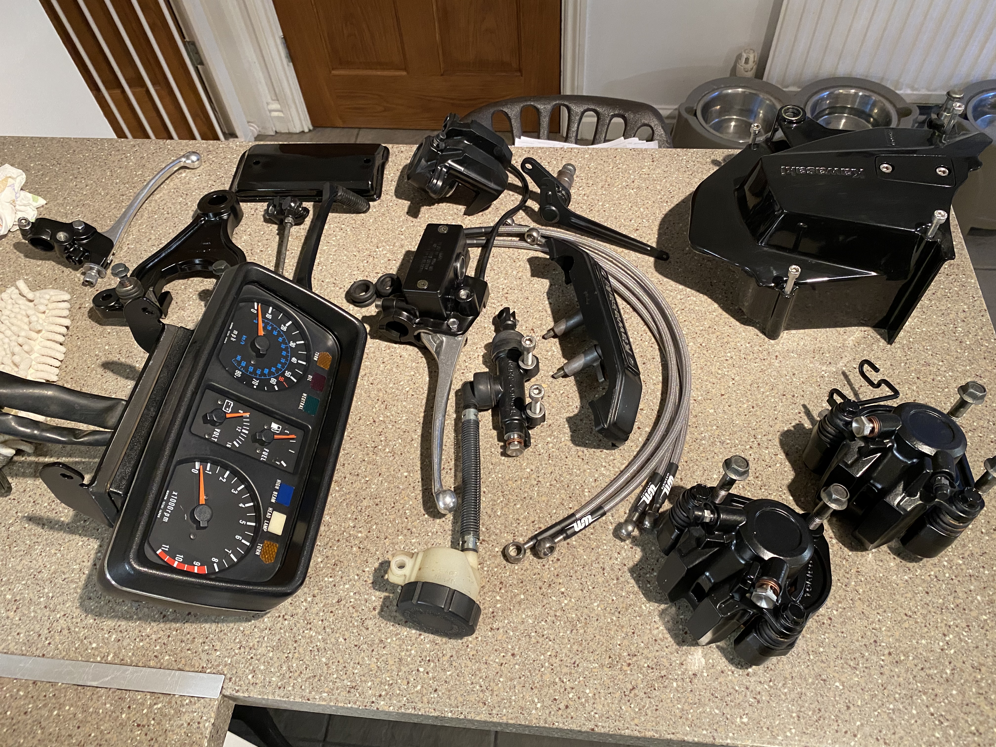

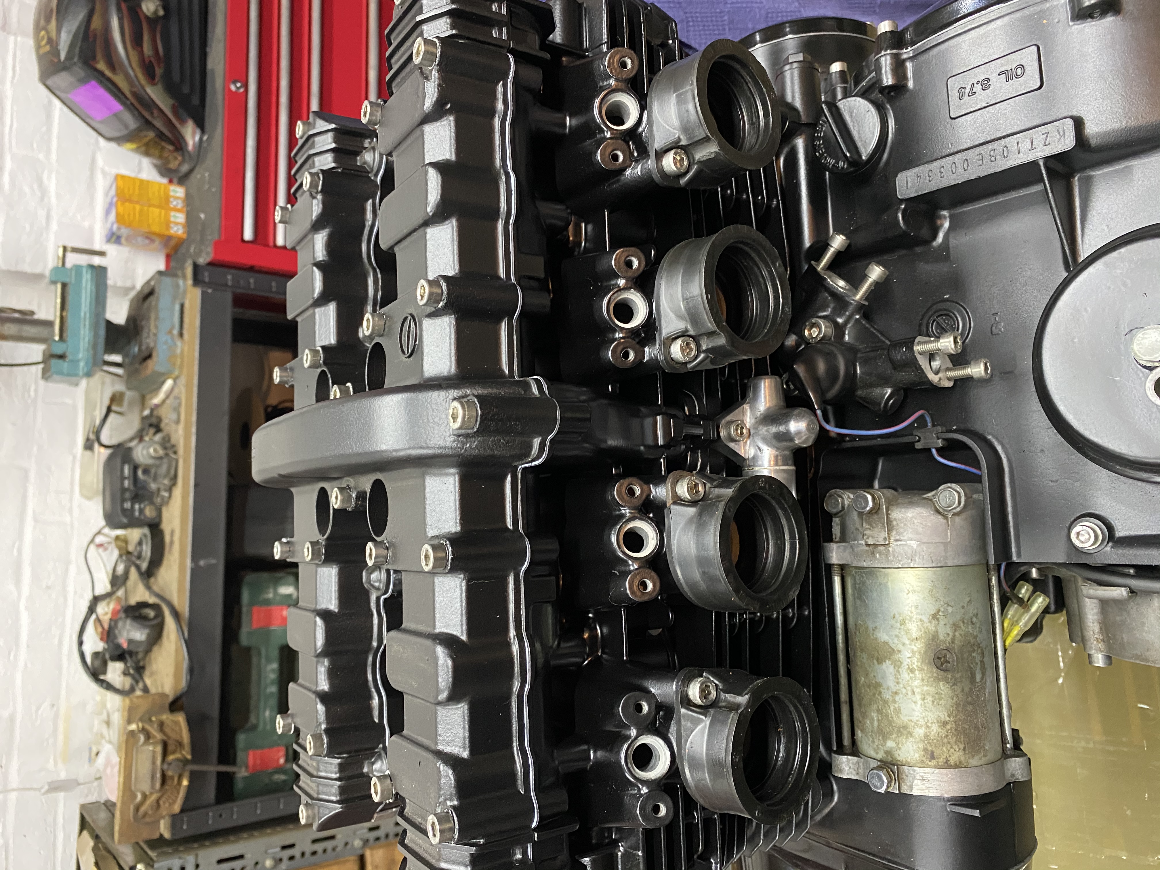

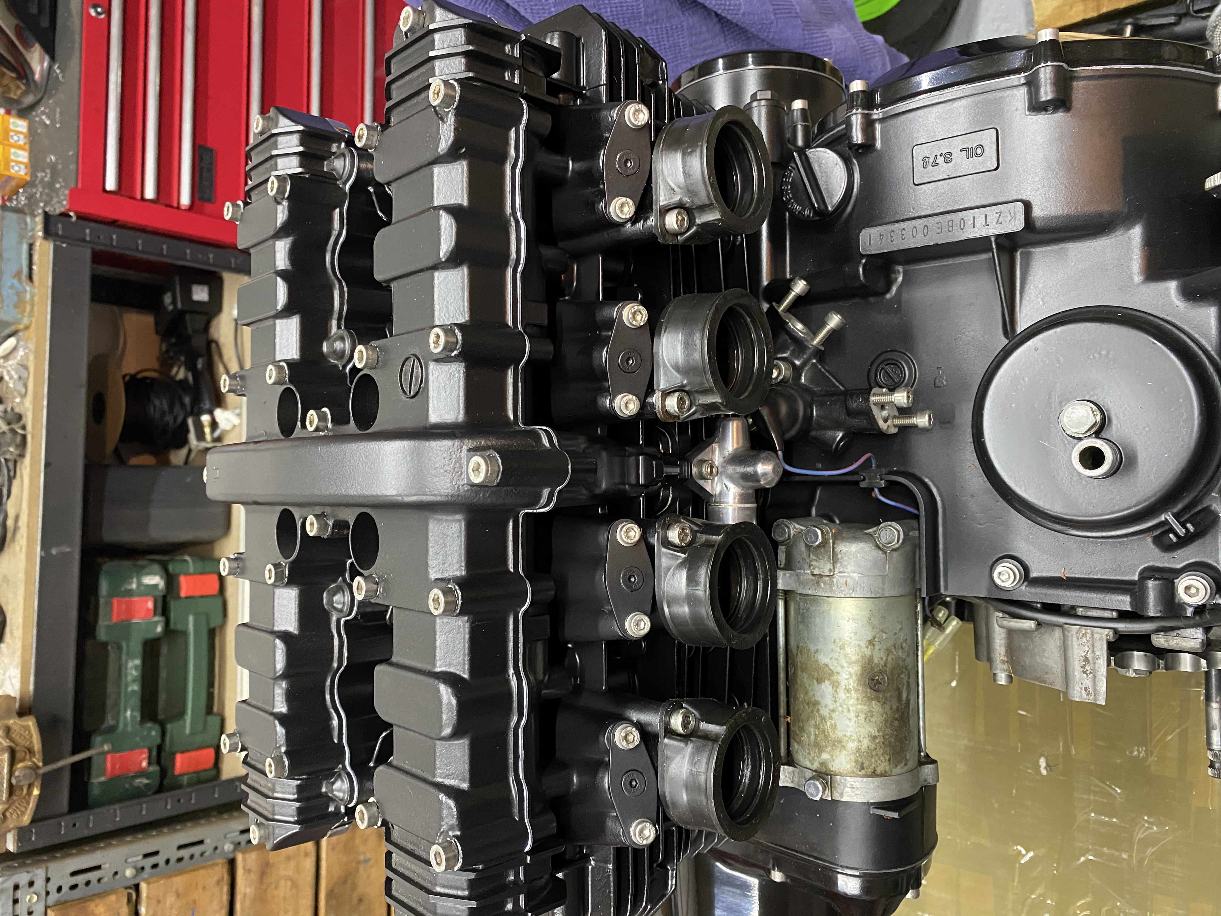

So it’s been a slow year on the project due to time and money but it’s kicked up a gear recently.
During the summer I rebuilt the brakes with all new internals where needed.
I also rebuilt the clocks which had a murky tint on the inside

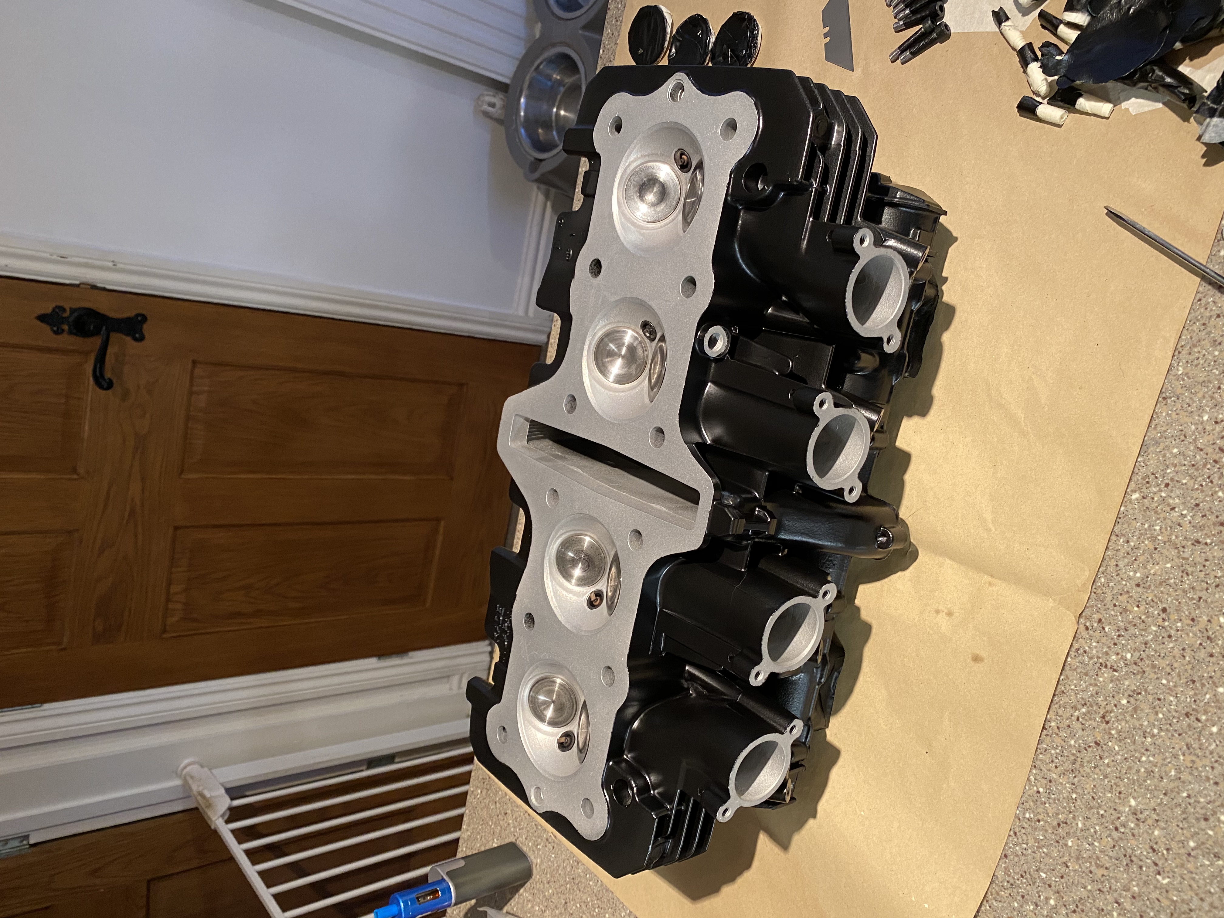

The original head was a mess.
I picked up another one which was re-worked to an expected super high standard by Buzzard which I then painted.
Then I’ve rebuilt the engine to this.
Next step on the engine is shims and put the top on then it’s finished but I broke my wrist today so no more work for a few weeks

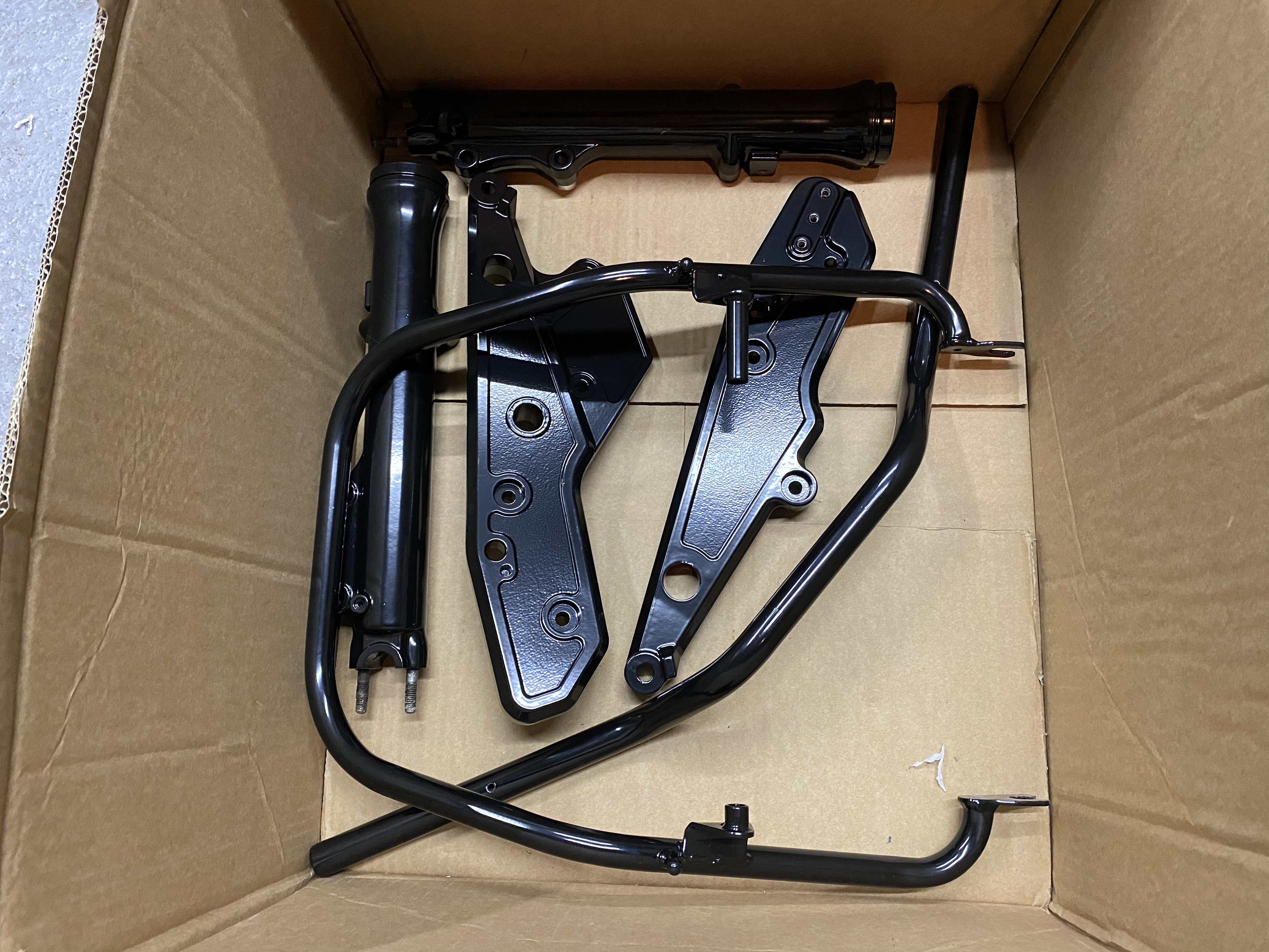

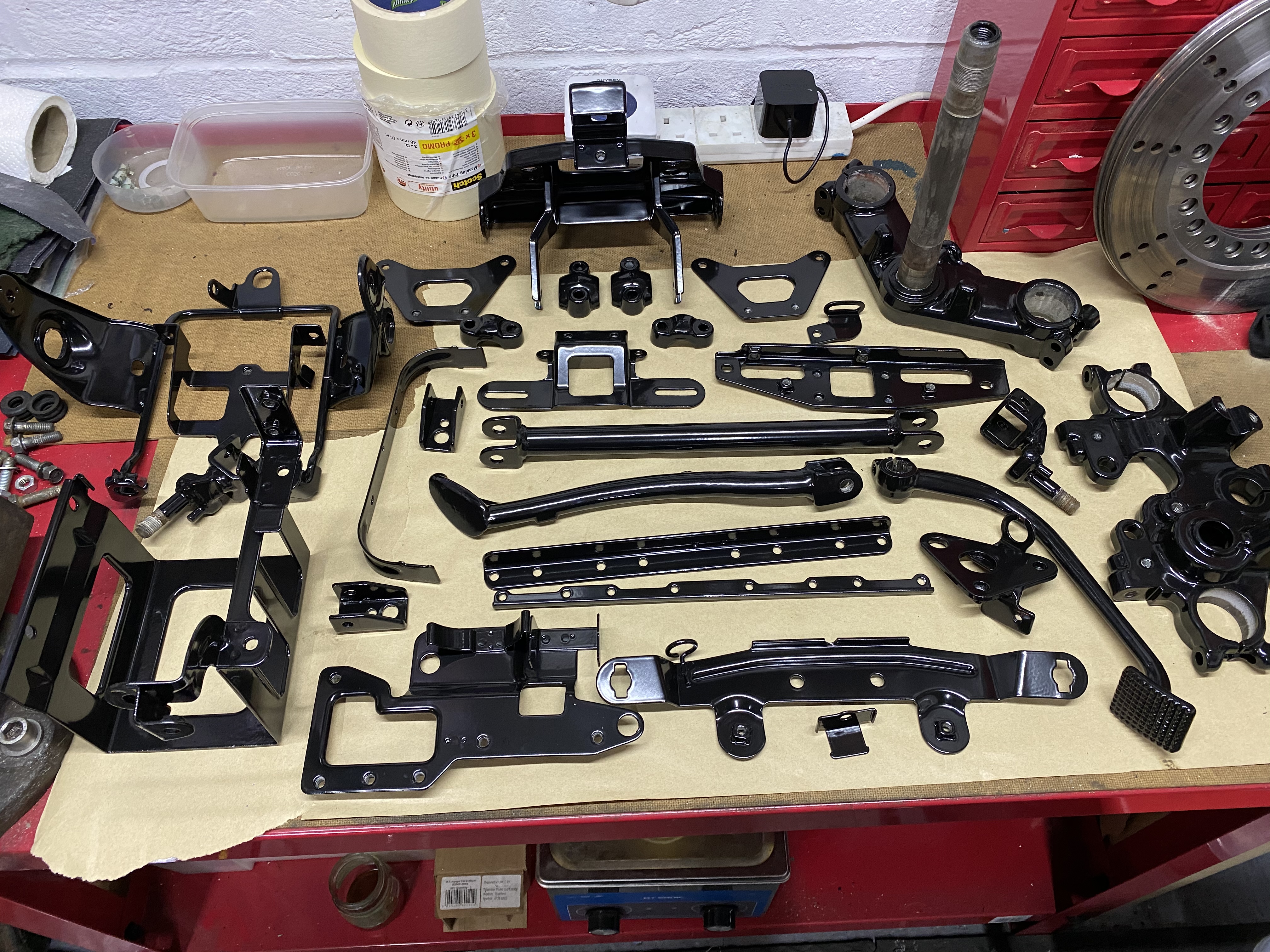

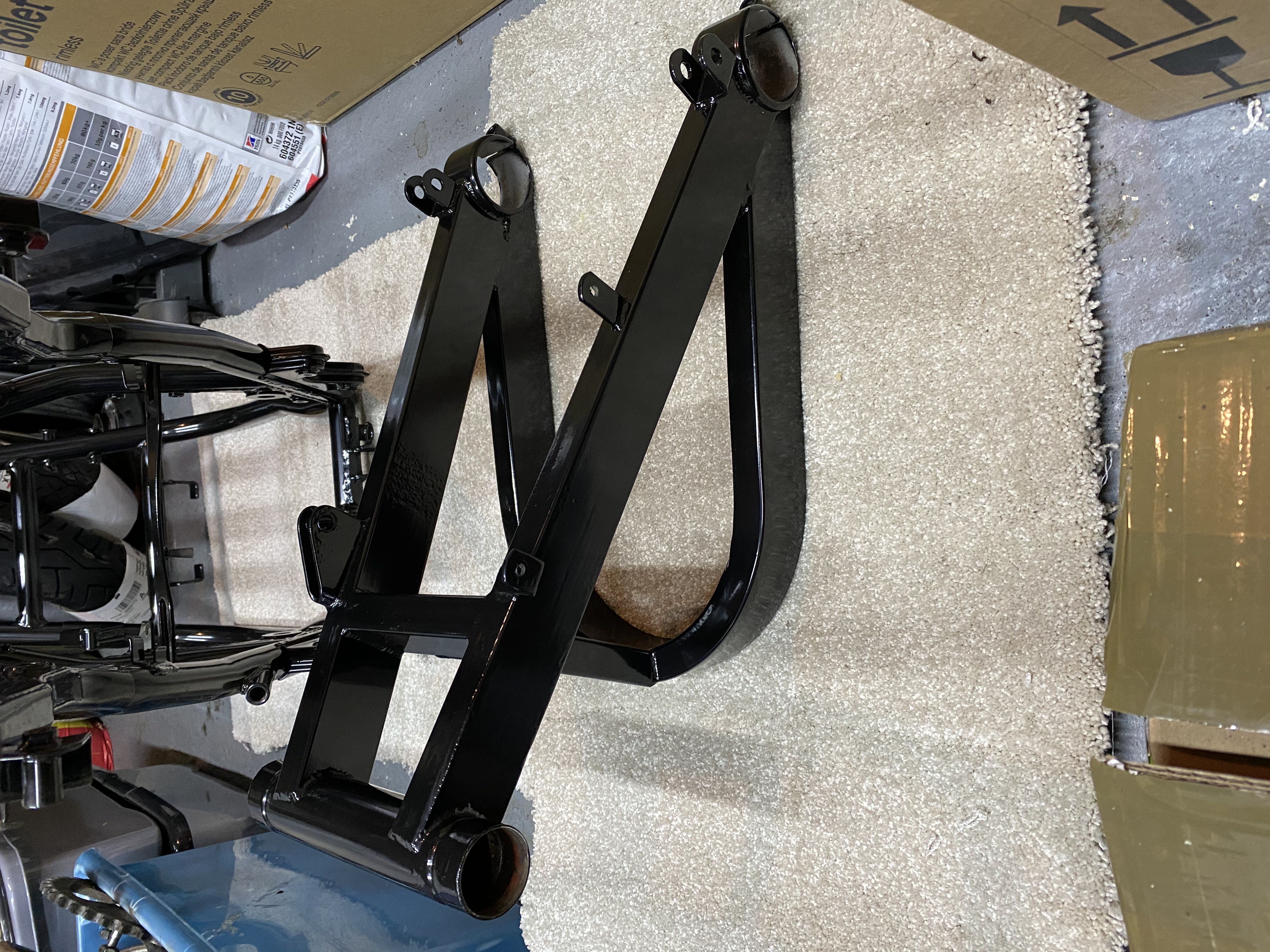

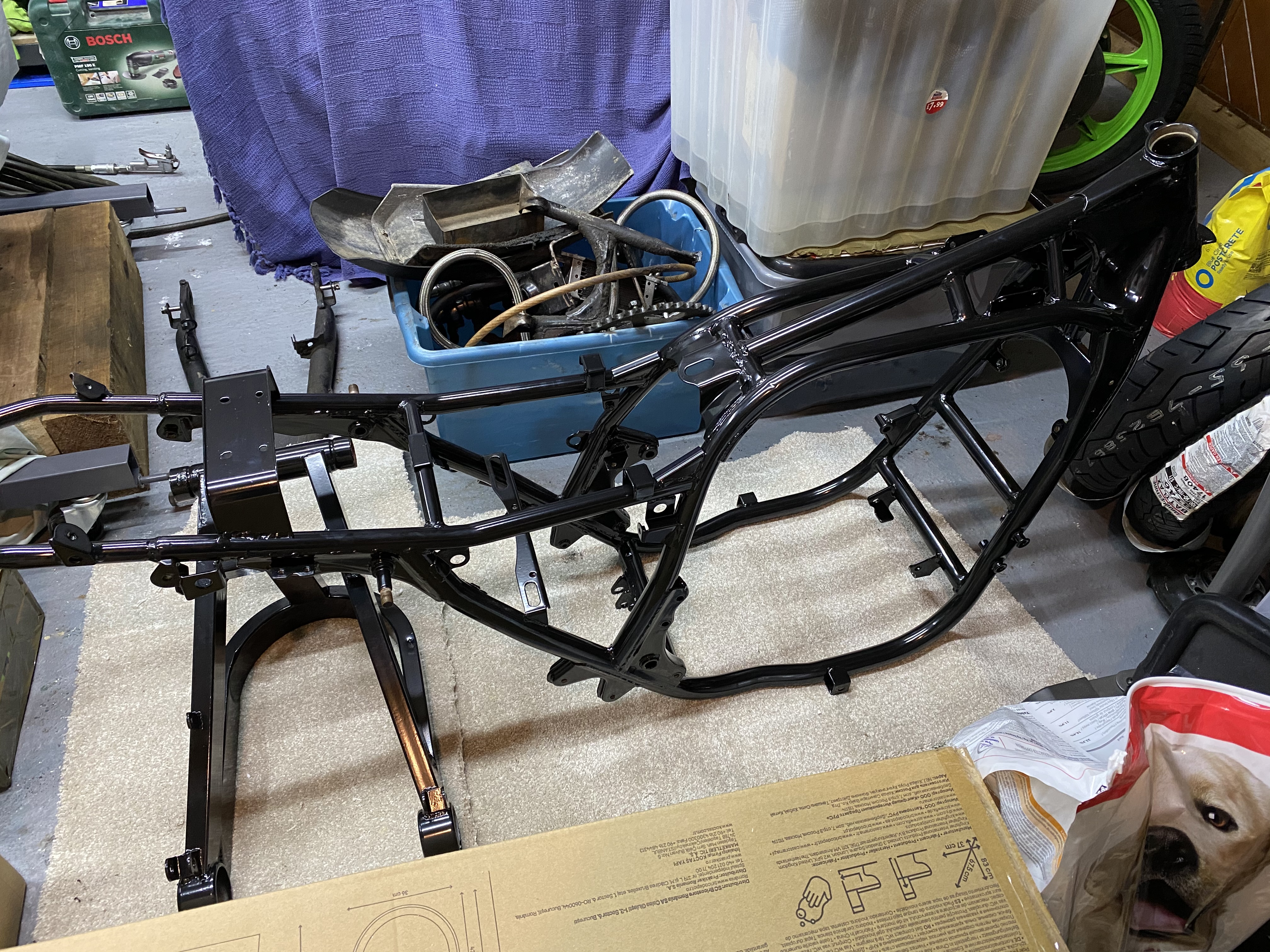

I picked up a steel JMC and welded on the missing chain guard bracket. Then I got the swing arm, frame and a whole bunch of other bits powder coated.
Then there are new shocks to go on
So I’m now starting to see light at the end of the tunnel.

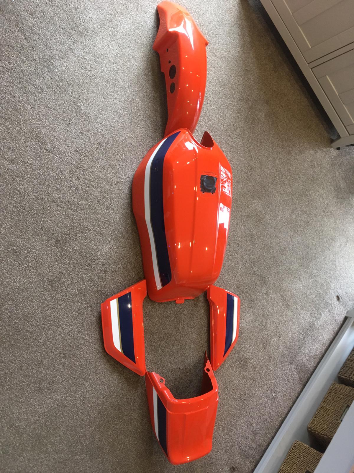

I also picked up a bodywork set off a mate of mine.
He had it back in the 80’s as a spare set for an 1100R.
He painted it and never used it so it’s mint.
So, do I have an orange GPZ or do I pay loads to get it red.
From a cost point of view it might start life orange

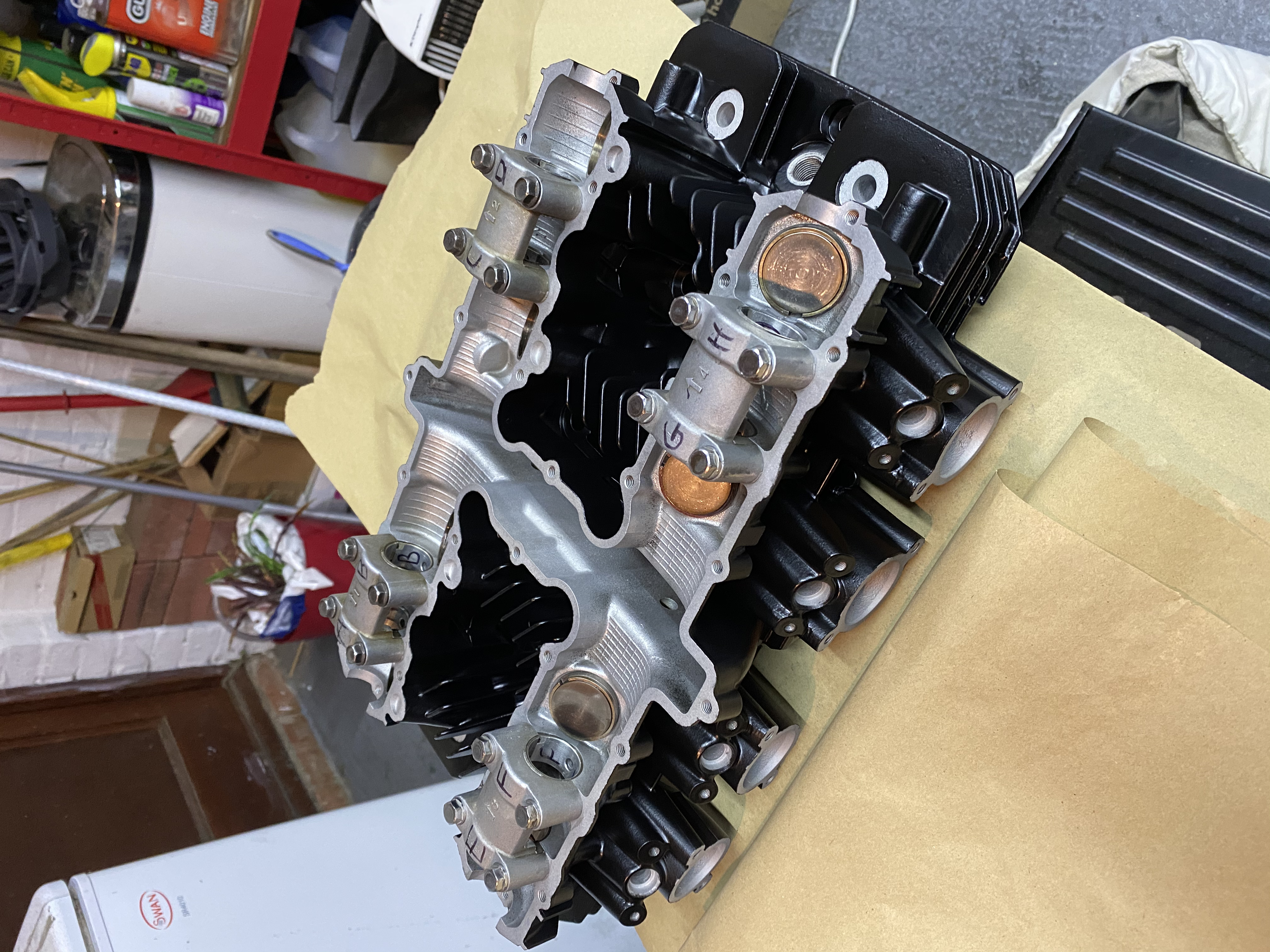

Couldn’t resist doing the shims and putting the top on with my broken wrist.
Was a bit painful but worth it.
Engine rebuild is fundamentally done after nearly a year !
Looks much better as well with the UK rocker cover I managed to get hold of.
Very pleased it’s done properly and should run well.

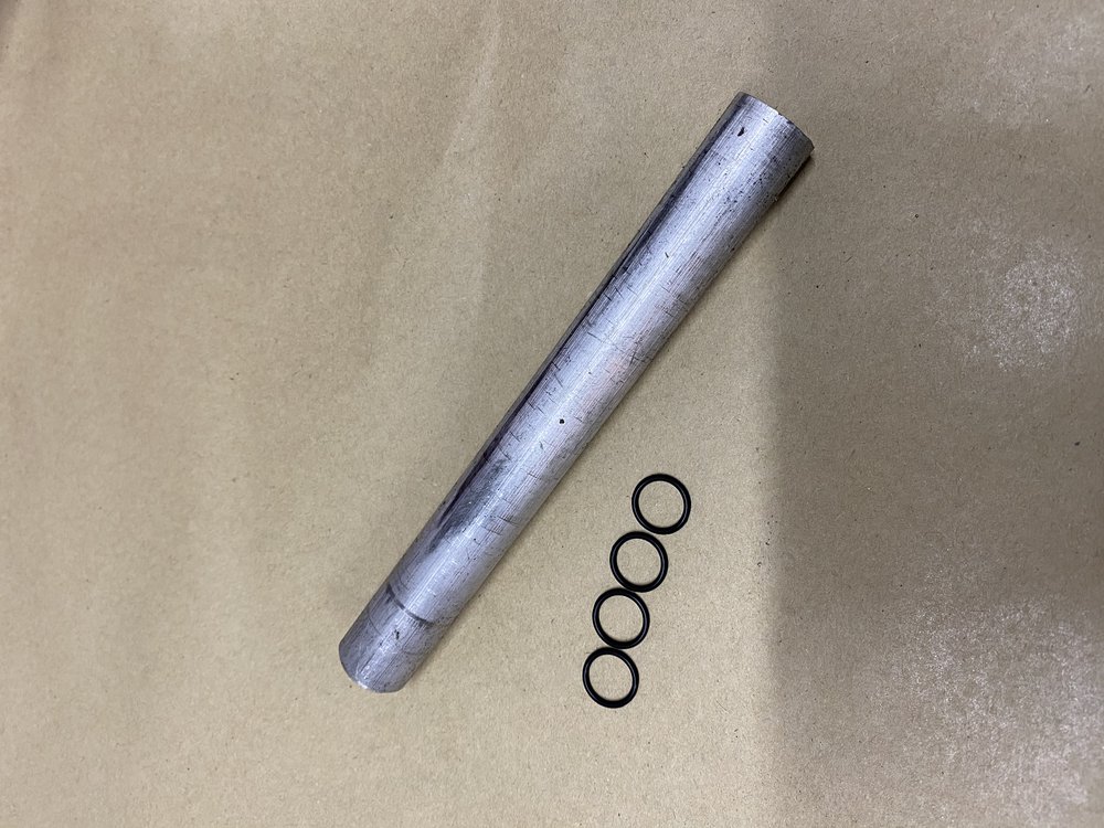

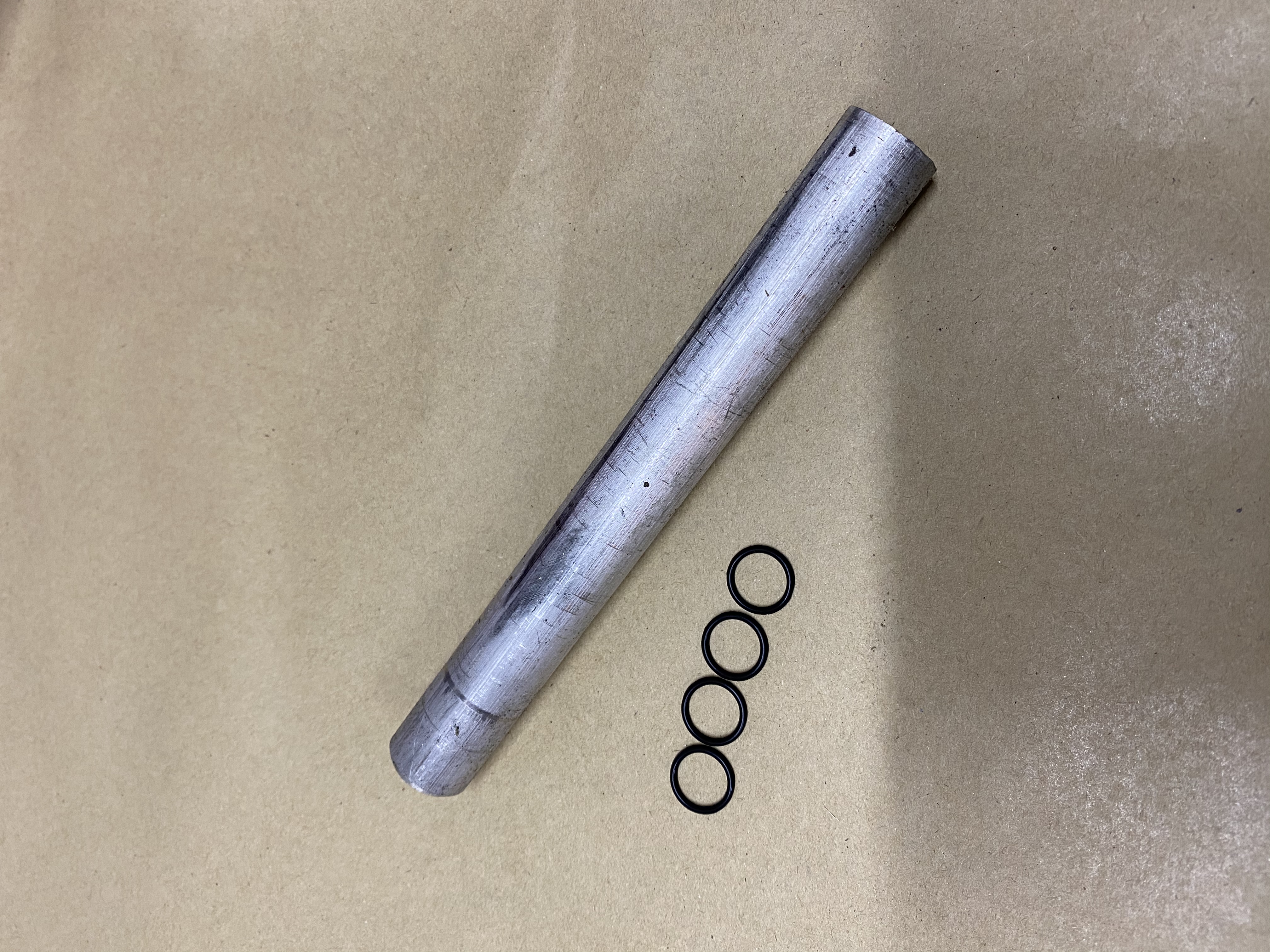

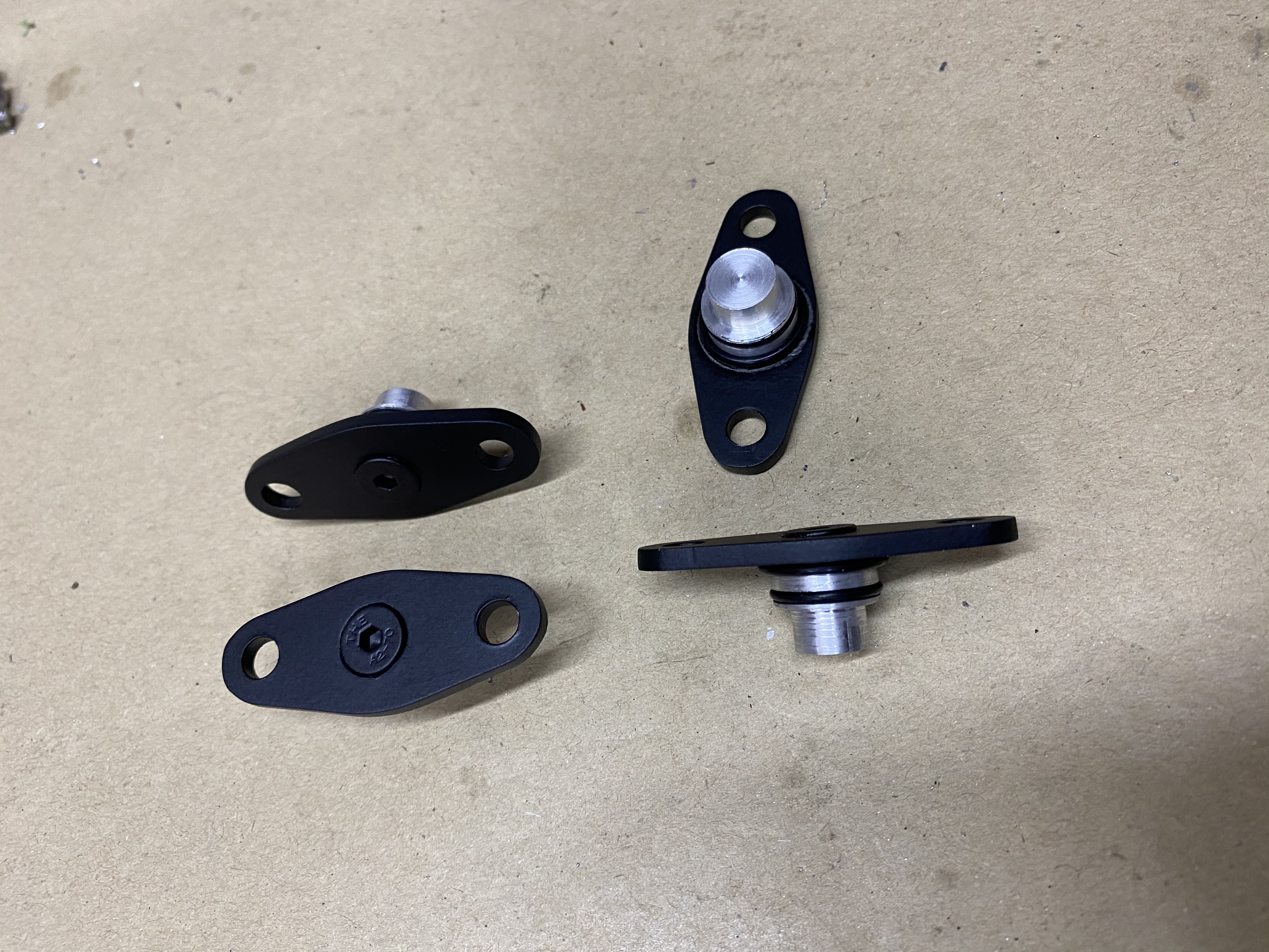

Next job is to blank off where the injectors should go.
When I got the bike it was converted to carbs and the injector holes were bunged with some sort of putty.
The head was shagged so I got another one and gonna blank them off properly
Got some o rings and ally and will knock something up on the lathe

I finished making the blanking plugs for the injector holes. They came out ok
Re: New GPZ1100B1 project arrived today
rickm wrote:Very neat solution
Second that, they look spot on
Wots up DOHC

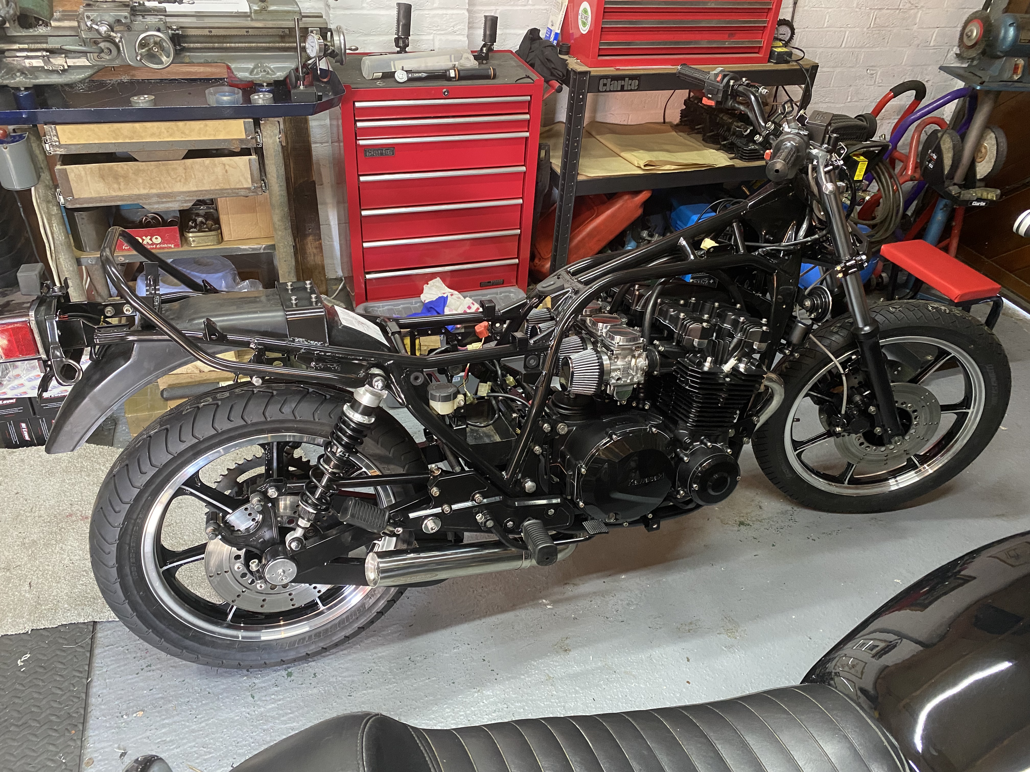

Finally after many hours it’s starting to look like a bike again.
Had some mates up from Hastings at the weekend for a bike rebuild, Paella and lots of beer.
A pile of finished bits turned into something that looks like a bike again
There’s light at the end of the tunnel
