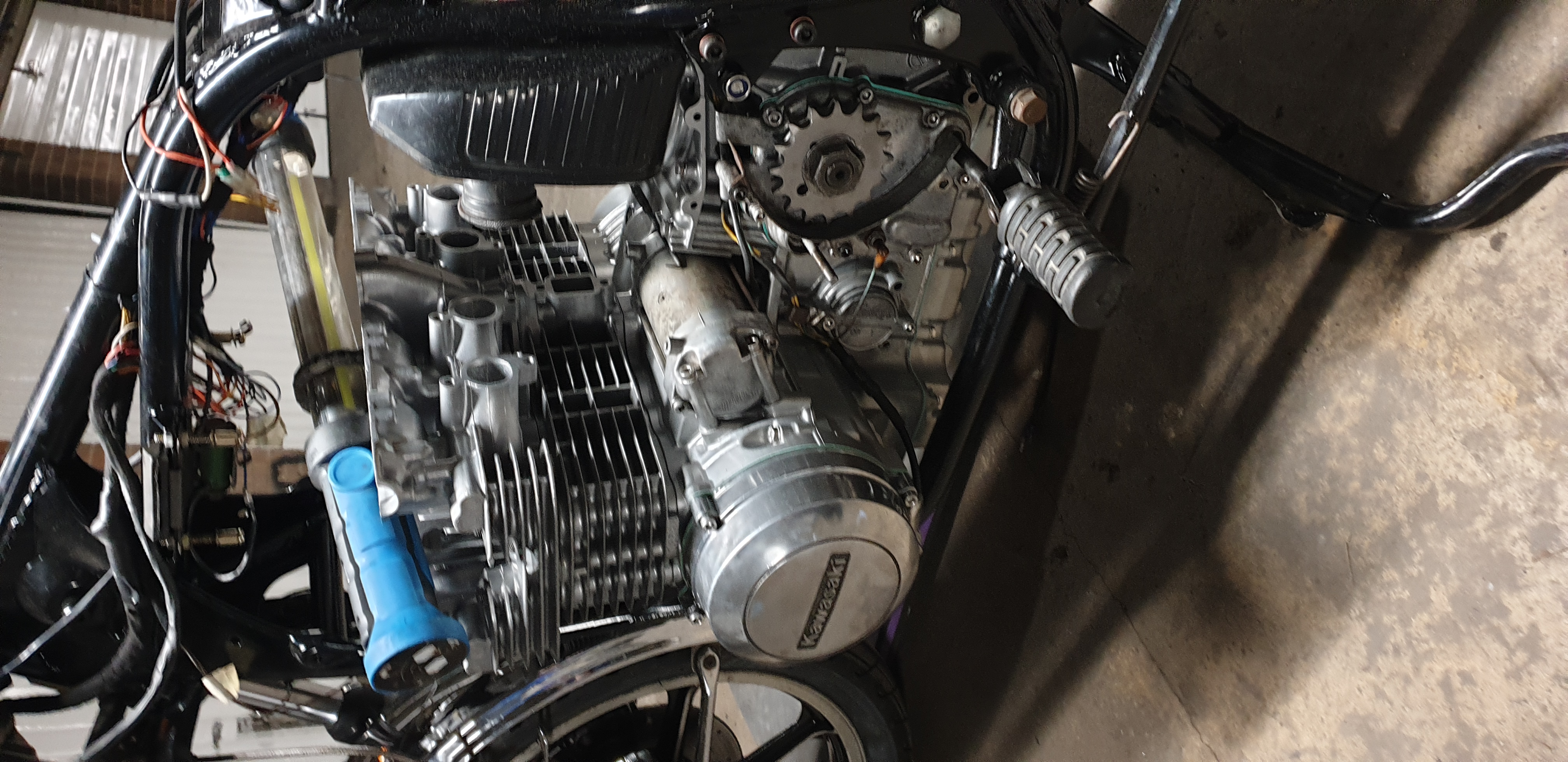

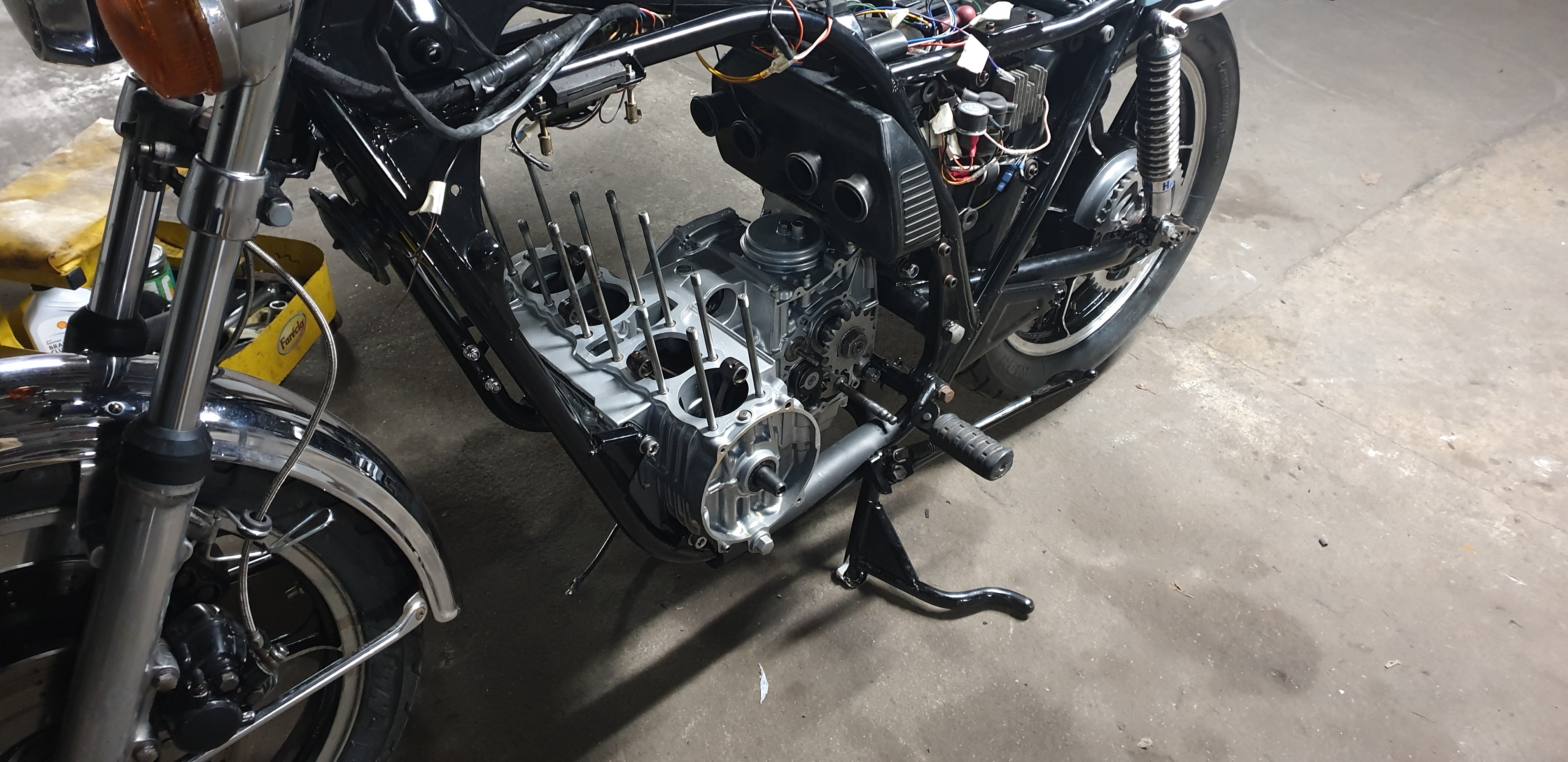

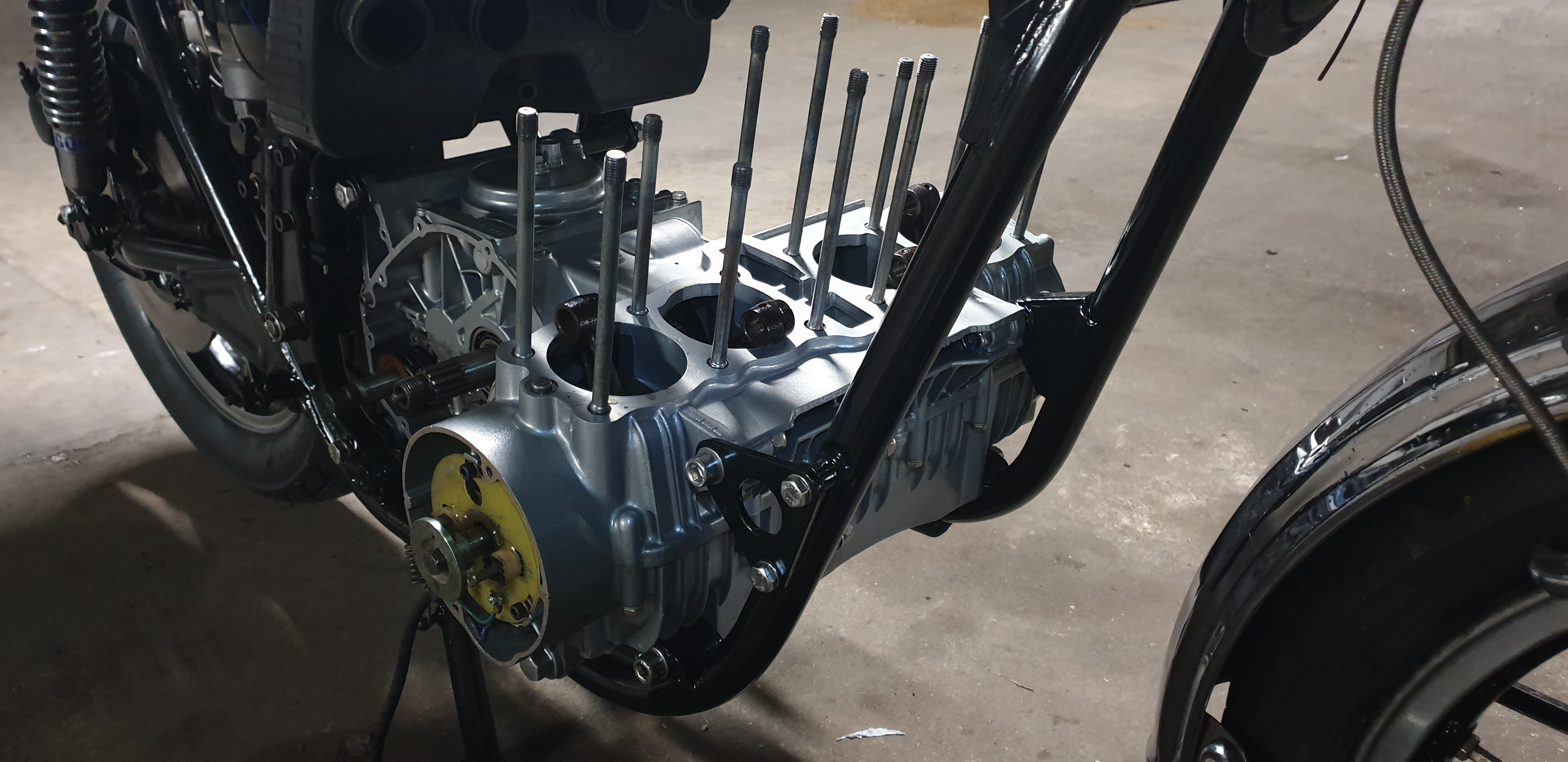

Got the bottom end in, one of those jobs that you realise haf way throught that you should of had some help!! Must remember I'm not 20 anymore.

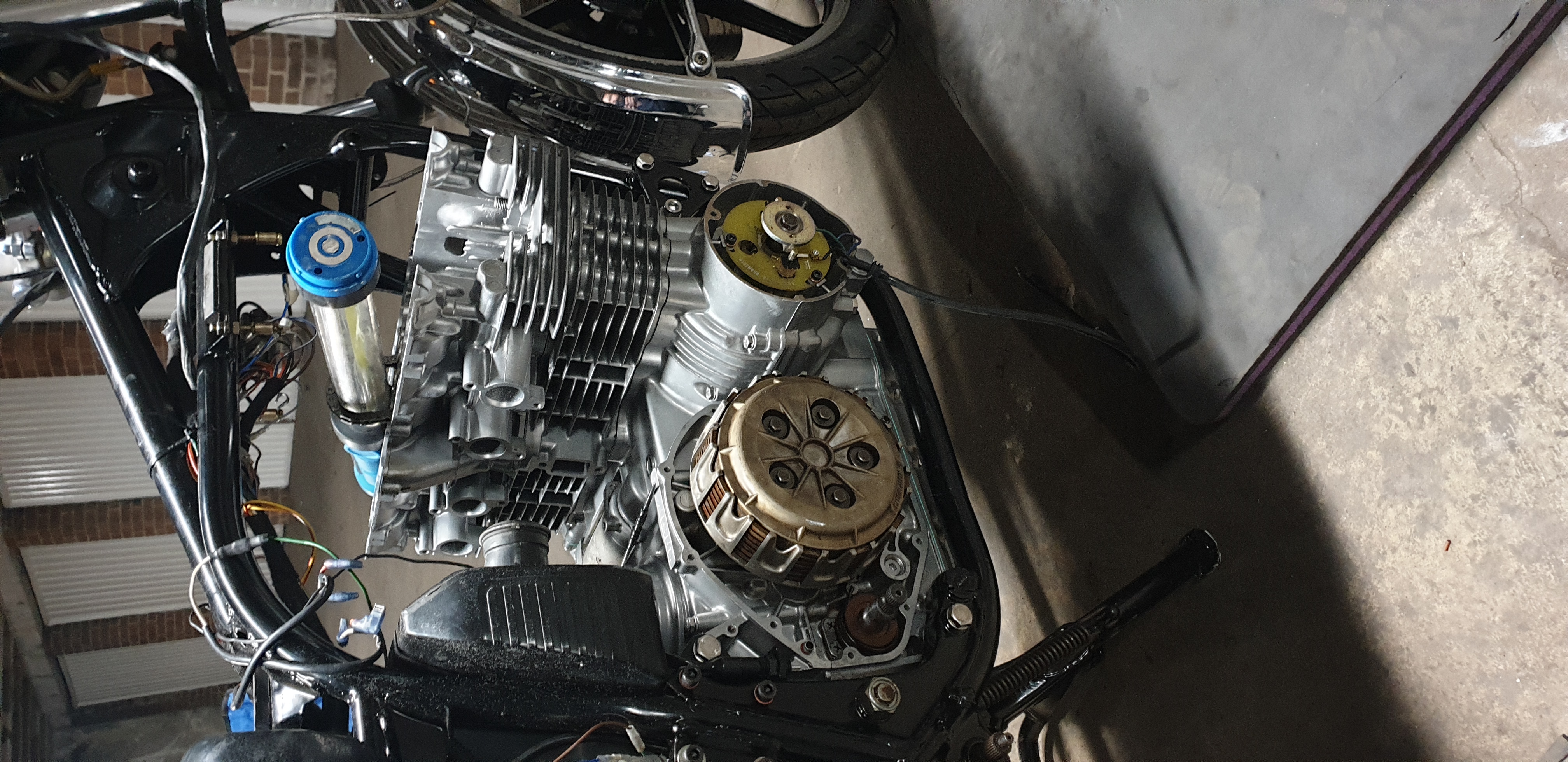

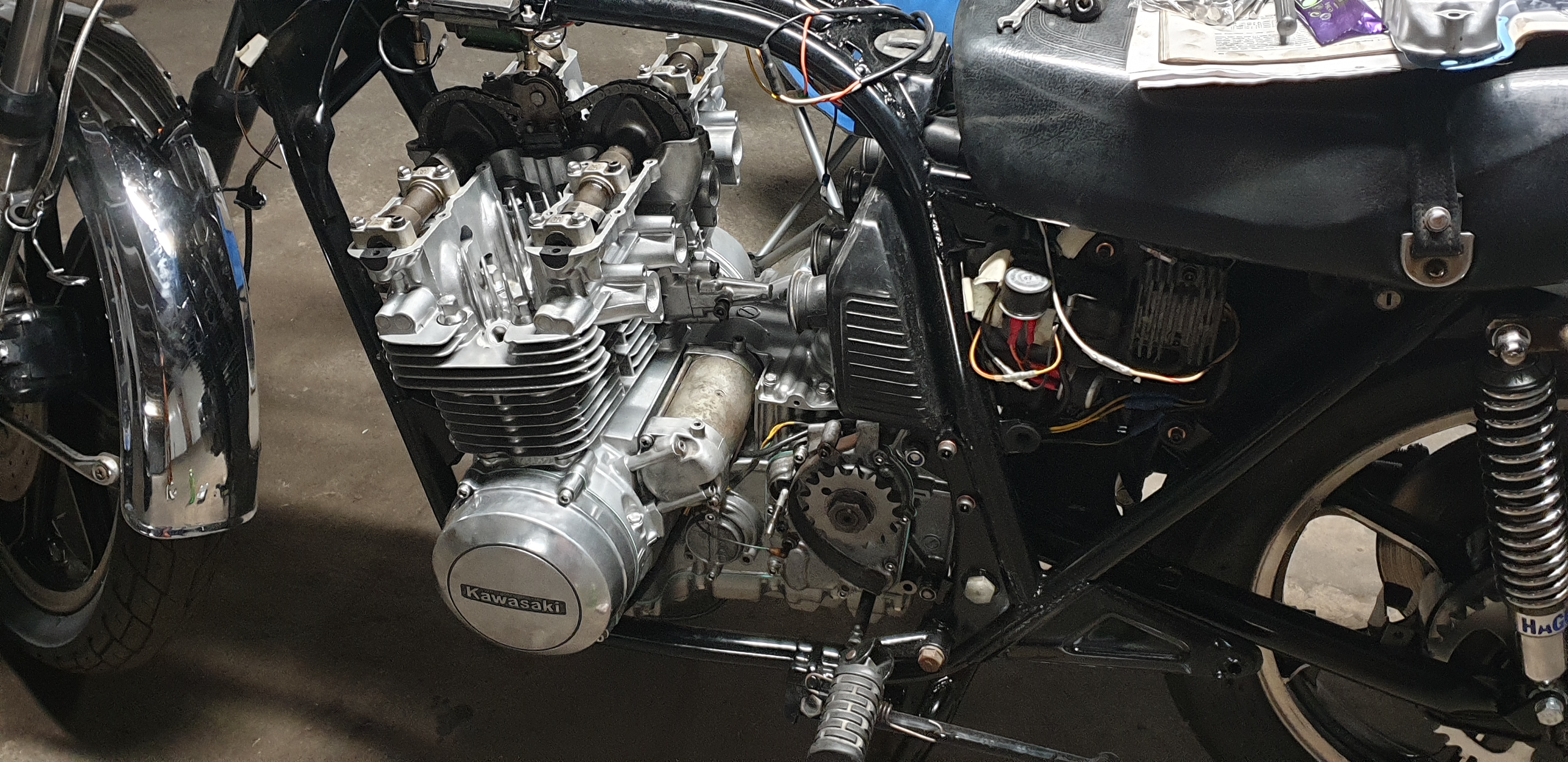

Barrels and head on now, found 3 buggered threads and a dodgey helicoil whilst putting it back together so carefully had to retap the threads and hope the bolts hold. Put the cams in got everything lined up, counted the chain pins everything ok, put the tensioners in and tightened it all up and its 1 pin out!!!!! Bloody motorbikes.
Z650C2 Z250 CB650 Reliant Scimitar GTE
TimH
Posts: 19
Joined: 6th Jan 2020
Location: Rochester, Kent
Re: 650 C2 rebuild
#22 PostAuthor: TimH » Sun May 17, 2020 9:34 pm
Timing sorted now but had re retap all the threads on the head as the bolts were binding, ho hum. Exhaust and carbs next, then got to try and get a couple of dents out the tank and see if it runs!

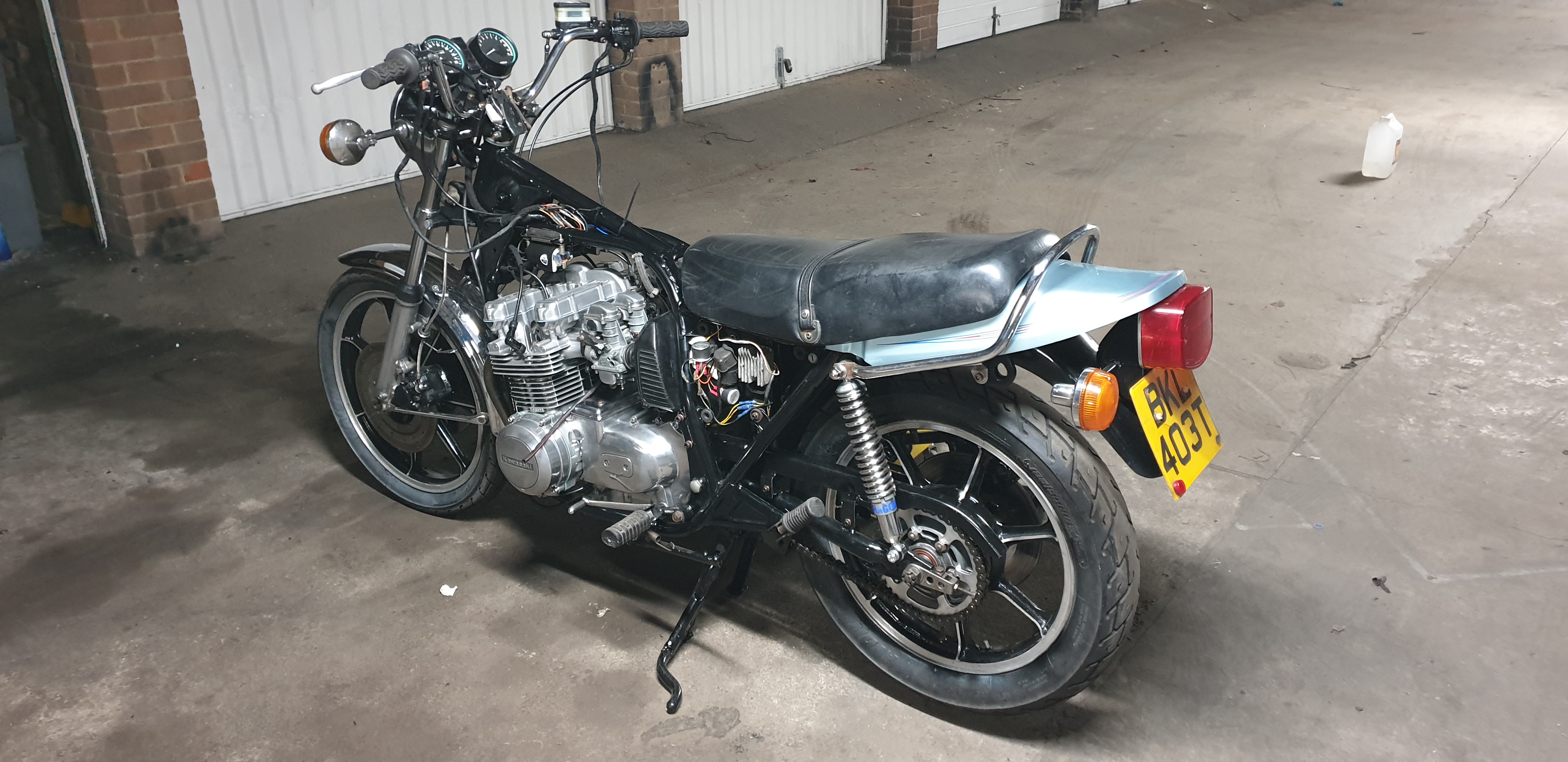

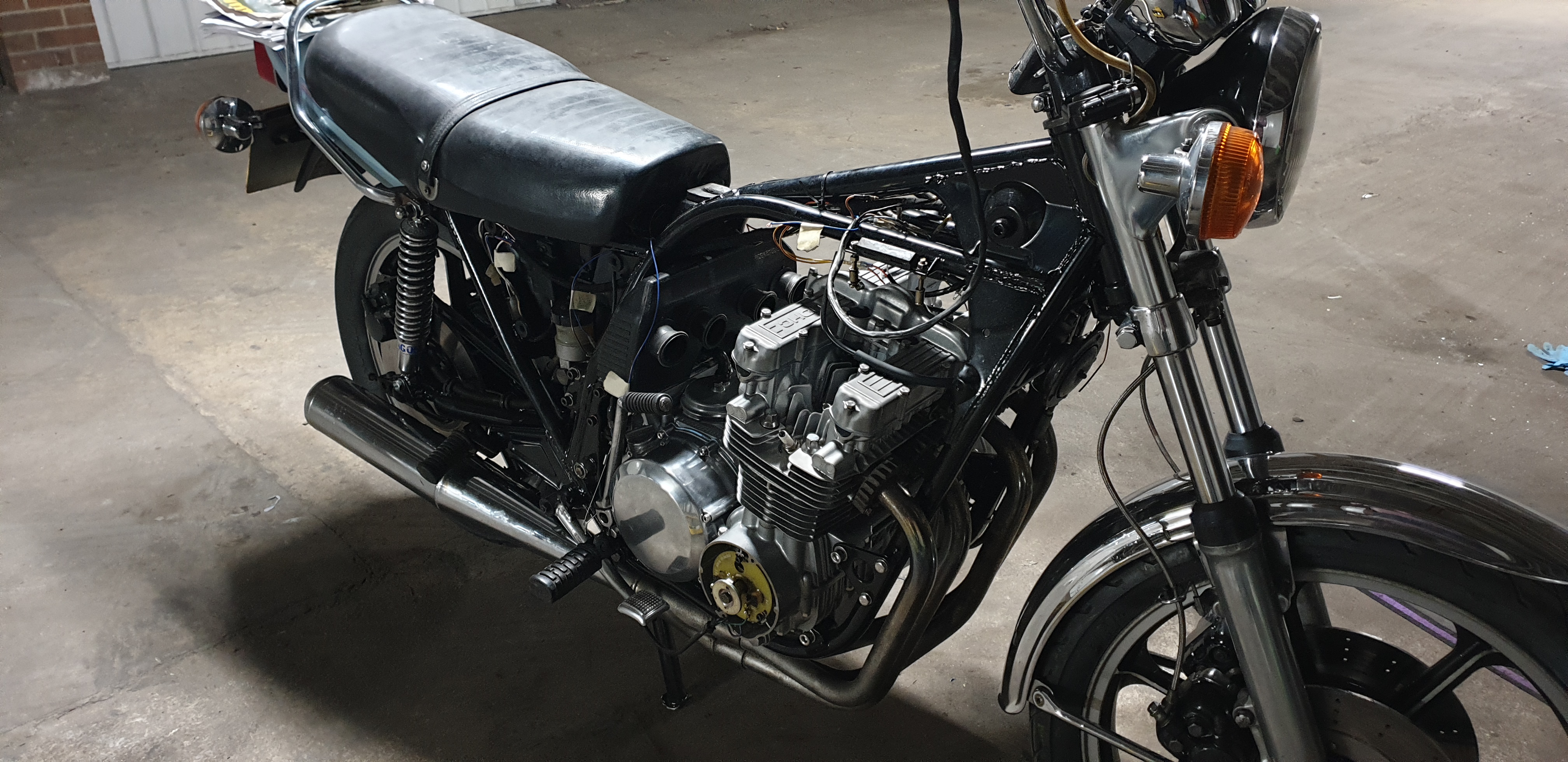

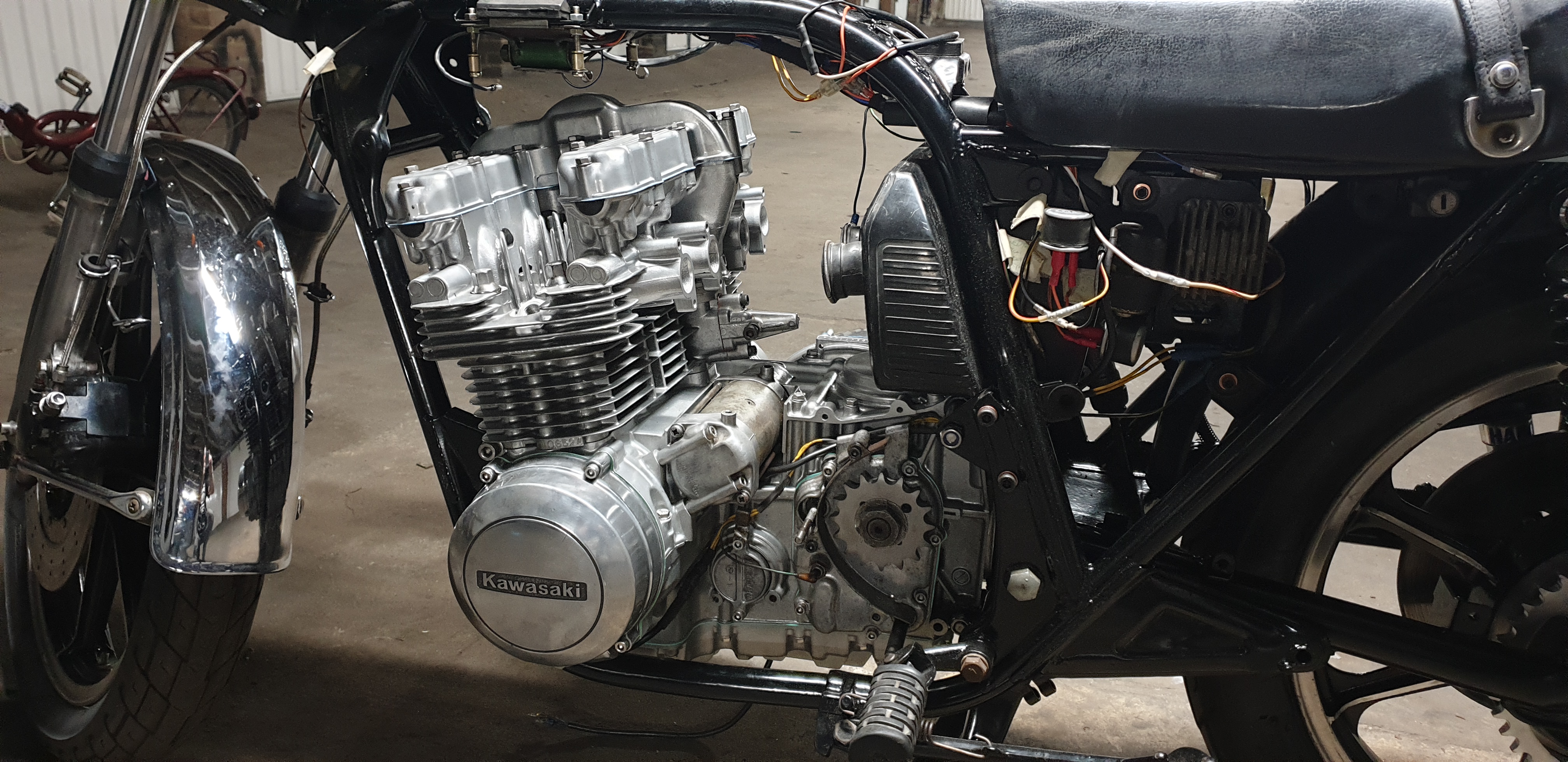

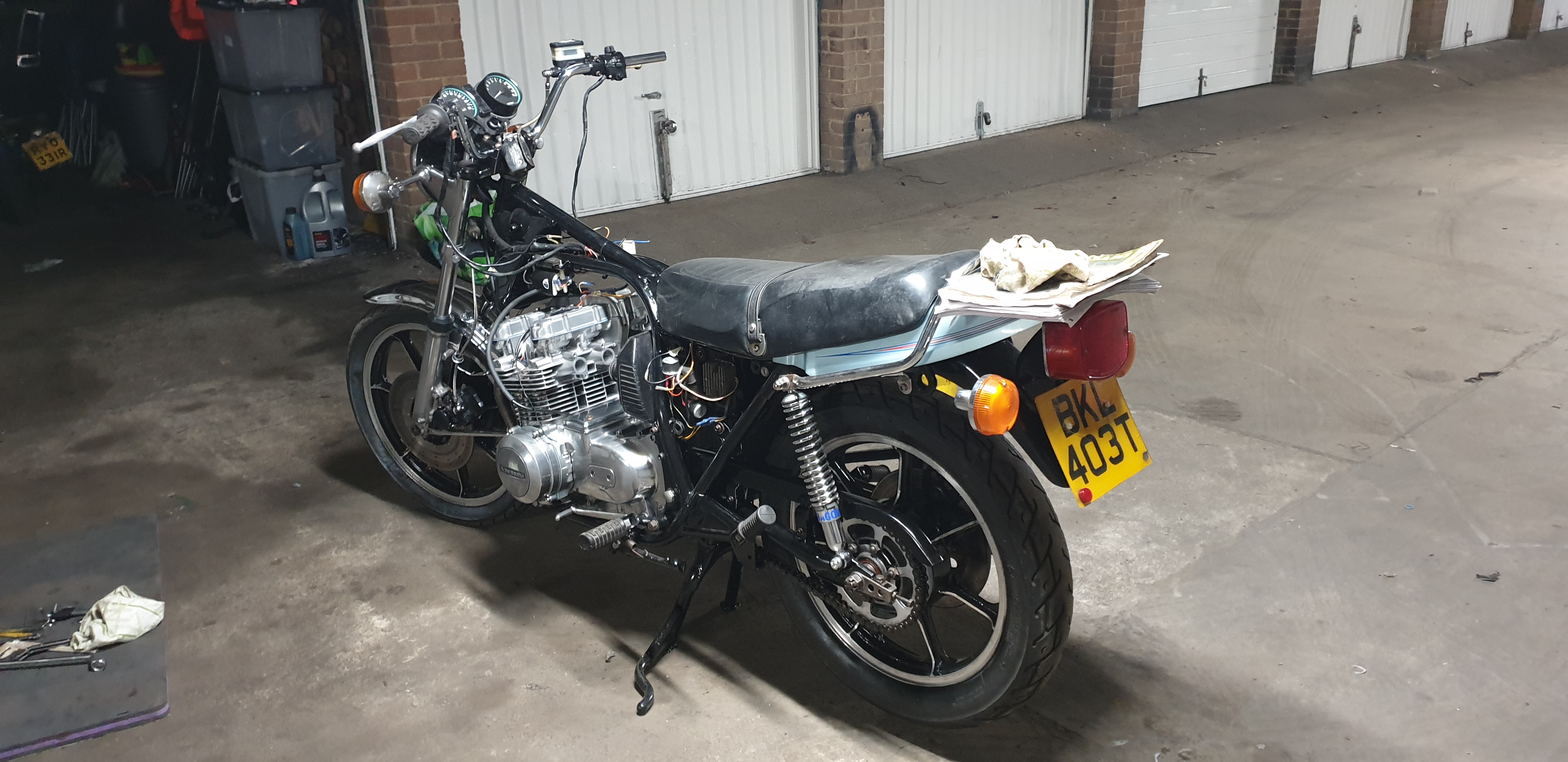

Engine finished,carbs on finally after an hour of swearing and wrestling and swearing again, exhaust on. Got it turning over on the starter after finding a broken wire in the handle bar switch (only had 9 volts at the starter relay). Sounded awful, chain slapping, grinding and all sorts, turned it over using the kick everything moved freely no unusual noises or resistance. Took a chance and hooked up the tank got some petrol in into it and it fired up, sounded a bit rattley but ok but need to time it properly and balance the carbs to be sure.
