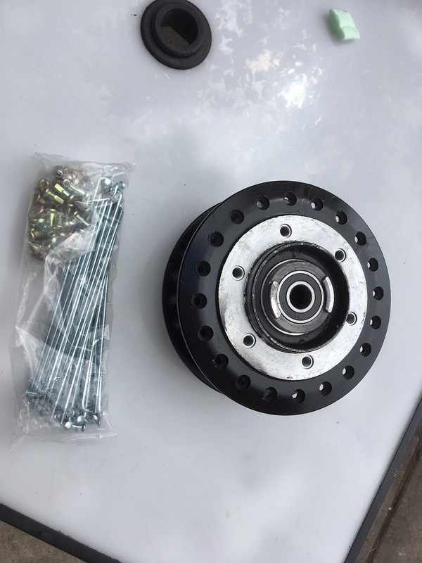

Hub sent on holiday to bonny Scotland for Timesert fitting in the disc bolt holes, meanwhile small boxes have started to arrive, including taper rollers for the headstock, front wheel bearings and spokes, oil filter & spring etc, and all the nuts and bolts etc to fit the engine into the frame. I'm going to whip off the sump plate, clutch and cam covers just to check all is present and correct, and put some assembly lube on the cams. I already discovered no points plate or alternator stator (but they came in the boxes) under their covers or an oil filter. I can't just assume things like the oil pump and screen are there and never look, only to find out the hard way that they aren't, I already could easily have done that with the oil filter.

The Hub came back from Inverness, the Timeserts were done the same day, and the box Fedexed back to me. Today I put new bearings in, and now it is off to Hagon's back in Essex where I bought the bike, for building into a new rim, with the spoke set I bought from France, so the front wheel is getting some serious mileage in even if I'm not.

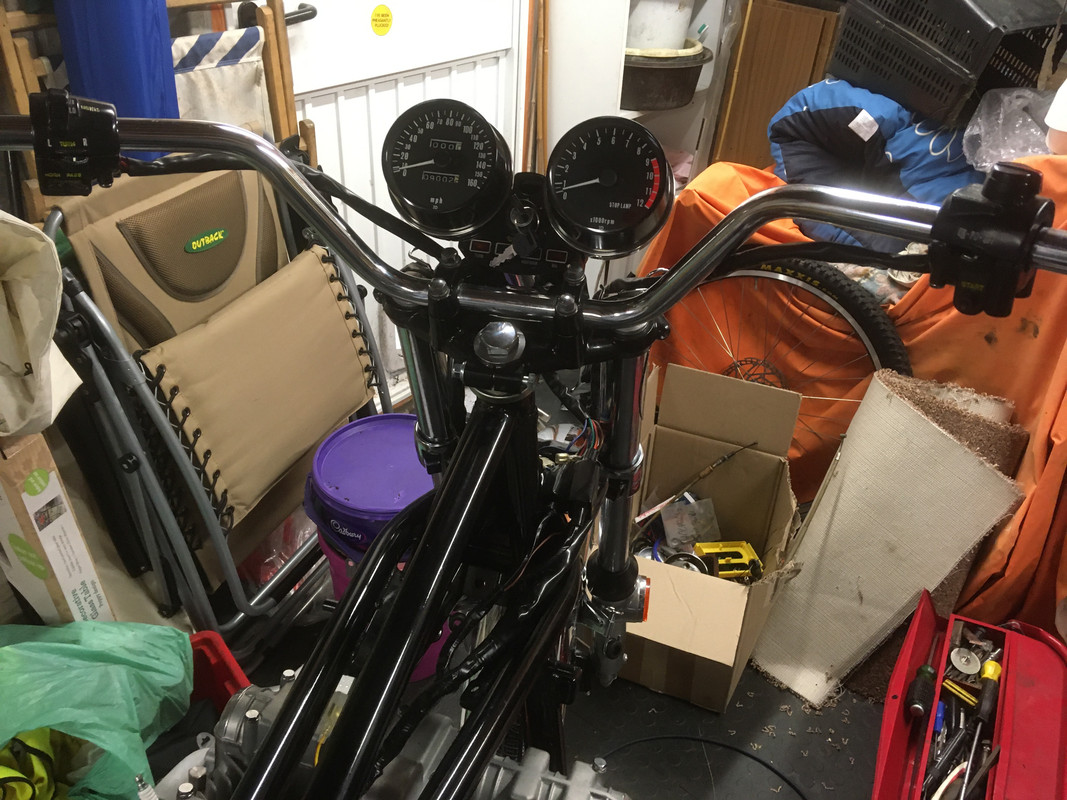

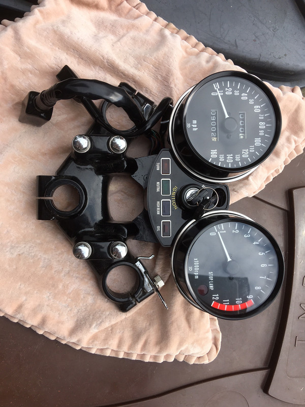

I fitted a new sub loom and idiot lights, and changed the ignition switch, so I have a key that works. I also touched up a couple of minor scrapes.

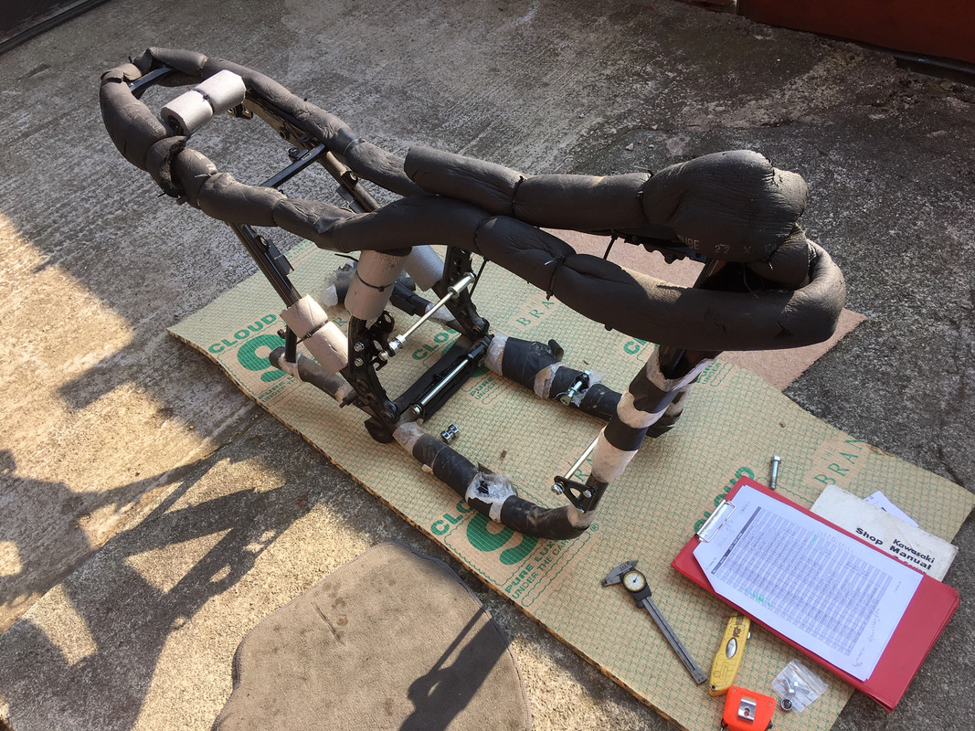

Sunday I got the frame out in the sun, and loose fitted all the hardware necessary to get the engine in, less the missing lower mount. I still haven't sourced one in the UK, so the one for sale in Ohio will probably be ordered this week. There was a choice of a chrome spacer bobbin or a nickel plated one, so I went for the stock look over bling. The clipboard has a copy of the relevant parts book page as a checklist.
There was no centre stand with the kit of parts I bought, after looking on eBay I realised there wasn't a lot of difference in price between a tatty old one and a brand new DoReMi stand, if you could find one. I tracked one down on German eBay, a quality bit of kit, it went straight on, no hassle.

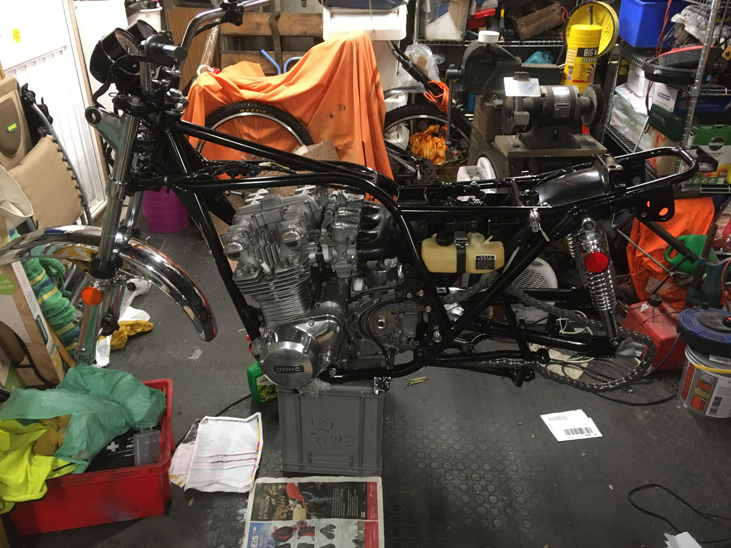

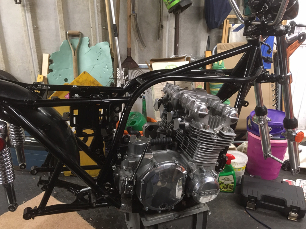

This morning my glamorous assistants showed up to help me get the motor in. Brains on the left (engineer), brawn on the right (6'7"). We tried the conventional way lifting it in, but after getting it well and truly stuck, the engineer suggested we should be lifting the lightest part, so we lowered the frame over the engine. A bit of a faff, but it worked.
WARNING: You know the two 12mm engine mounting bolts that go into the tear shaped special nuts underneath? The parts book has them transposed - if we hadn't stopped to check after trying to fit a long bolt into a short hole, we could have punched through the crankcase!
Finally, with the engine in I get to tear off all the bubble wrap and tape, and see the freshly painted frame in all its glory. If you worry about the plastic crate being up to the job of supporting the weight, I rebuilt my Harley motor with the bike sat on that box!

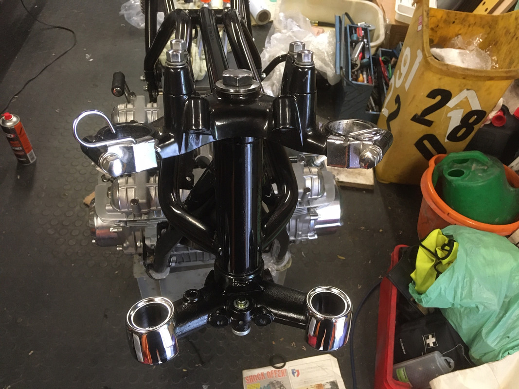

Back at it over the weekend, I'm trying to make what progress I can before the car comes back from its body rebuild (which makes fixing bikes look very cheap) and uses up nearly all the space in the garage.

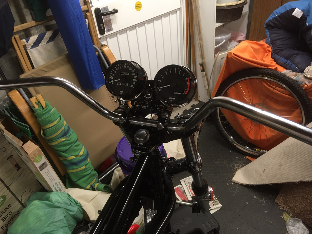

First job was the bottom yoke, on the first day I'd made a bit of a Horlicks of the unrestored one that came with the bike, failing to get the steering lock out, butchering the retaining screw with a drill, then cutting into the stem while removing the original headrace bearing, so not a good start. I decided to make an offer on another at D&K, which already had the steering lock removed, plus a hole for the steering damper, which I've got. The stem bolts are horrible, but going to the chromers, with some other parts, once I've dremmeled the manufacturer's marks off them. Here it is, freshly painted, with new lock and taper roller bearing.
Next, fitted on the bike with the top yoke and blingy mounting hardware.

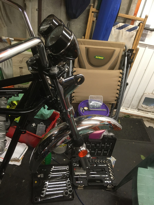

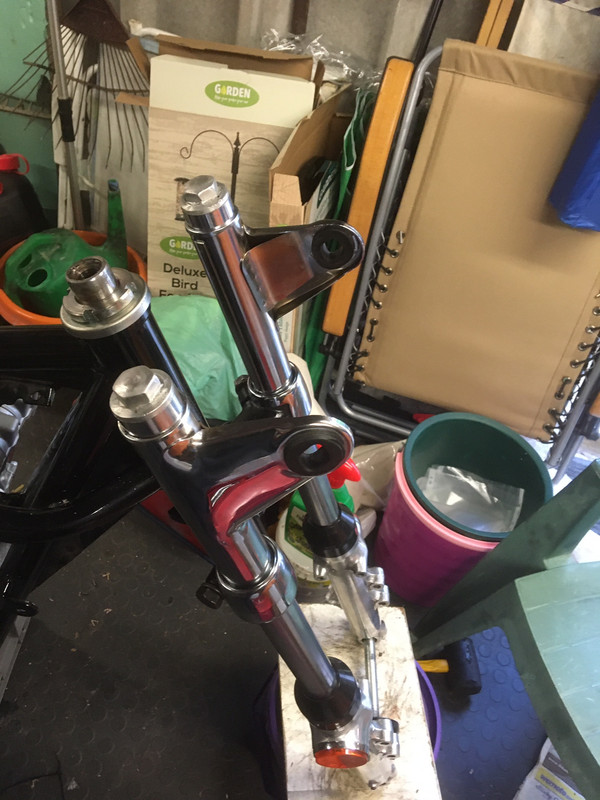

I then decided I was going to fit the forks and headlamp brackets. I know from experience that all the time goes into the fiddly bits, but this looks like real progress. Unfortunately the forks didn't want to fit, I put the yoke over the centre stem, I could then fit one leg or the other but not both at the same time!
Starting to wonder if something was bent, or not actually off a Z1 after all - then I remembered an old IT saying - 'If all else fails, read the instructions'. Luckily I had these, Dennis from the SOHC H**** forum was kind enough to give me a genuine Z1 workshop manual that was hiding away in his attic.
The manual said to get the fork tubes so they were sticking out above the headlamp brackets by 30mm, lower the top yoke over them, then persuade the yoke over the steering stem. It wasn't easy but did work. Putting the bars on gave me leverage to wiggle, and looks good. Then I went to whole hog and fitted the clocks.

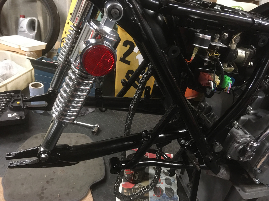

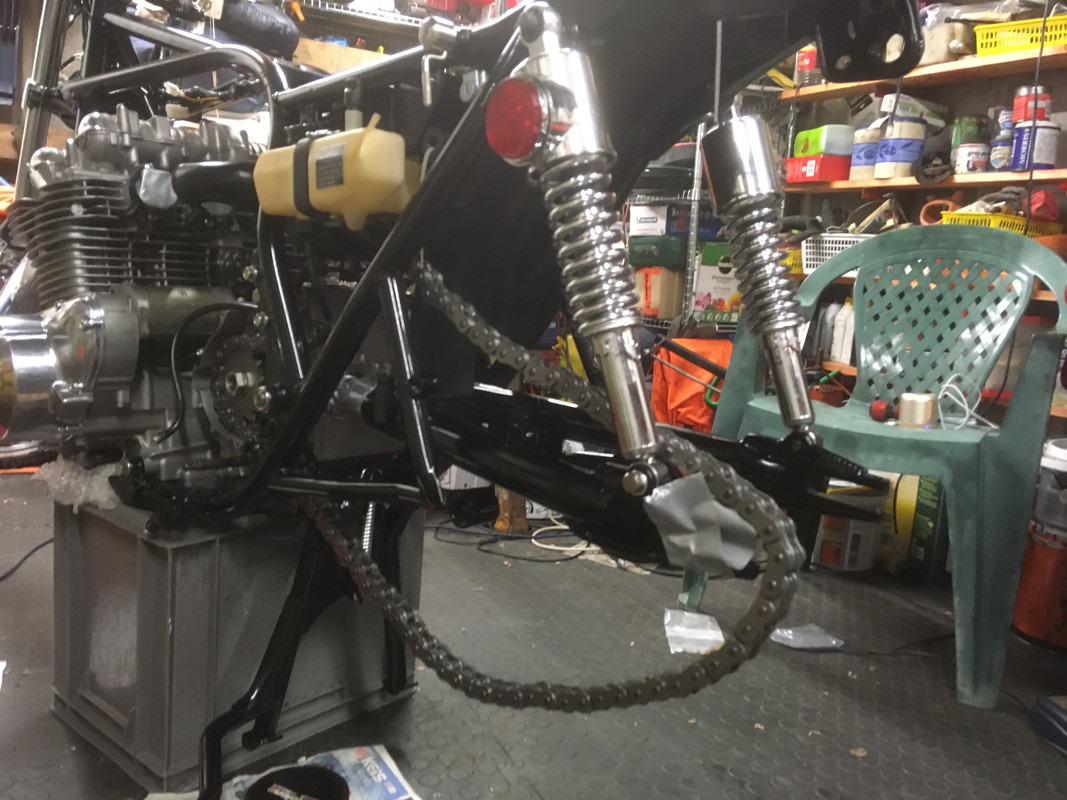

Well another weekend, another installment. I am going to have to slow down a bit I think, because (a) at this rate I soon won't have a project to play with in the garage, just another bike to worry about, and (b) the weekly spend on this project far outweighs the rate at which I can actually earn the money to pay for it. Still, I knew what I was getting into, and there's still the cost of an exhaust set to think about, as well as the small matter of the last installment to pay of my 911's long running body restoration.

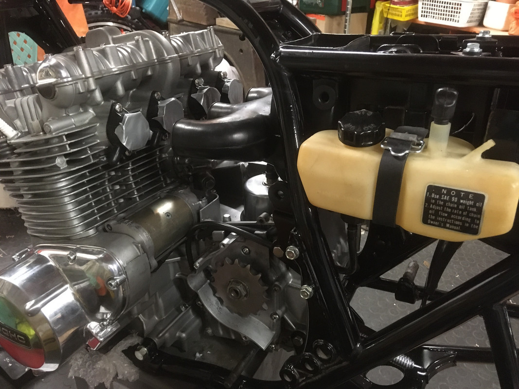

I now had all the hardware necessary to fit the swinging arm, apart from the endless O Ring chain which I ordered from Germany. That arrived this morning, so maybe next weekend. Not having the special tool to hold the sprocket still, I have no idea of how I'm going to hold the sprocket still while I tighten the nut. I can use the back brake, but that involves having a back wheel, brake and torque arm, which is off to the chromers. What did you use?
Also newly fitted is the airbox, oil tank and starter motor. Someone suggested that if I am to run the chain oiler 'dry' I need to remove the driving pin from the gearbox output shaft - well although I got the tank and pump with the bike, as far as I can see there is no pin there, so maybe it's just as well I chose to run an O ring chain.
I followed the measurements on the service bulletin on fitting an O ring chain, so I got a Z1B sprocket, the spacer for the rear sprocket, and ground 4mm off the lower bracket mount and bolt:
That refitted I am ready for the swinging arm. However without the chain my attention wandered to the front end, and I fitted the front mudguard.

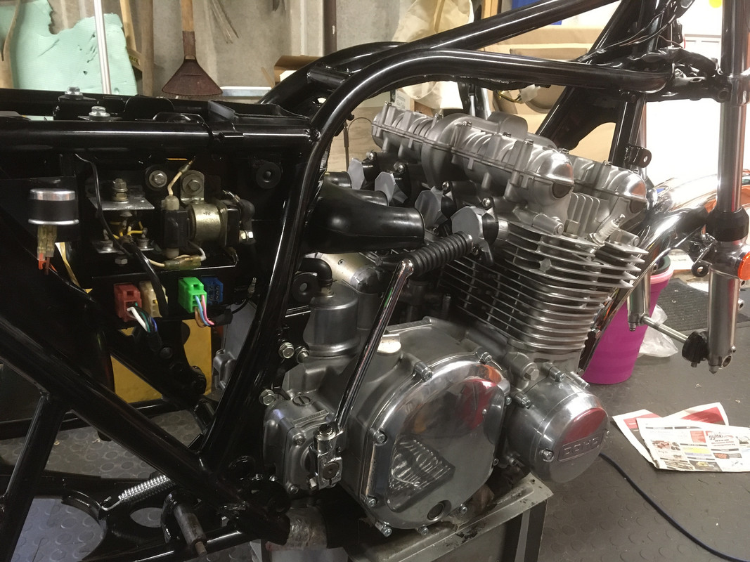

Then the wring loom went on, I think I have the routing right to the right hand side of the headstock, please tell me if you know otherwise. That got plugged into the orange socket, and the turn signal flasher, at the front I attached it to the clocks and ignition switch plugs.

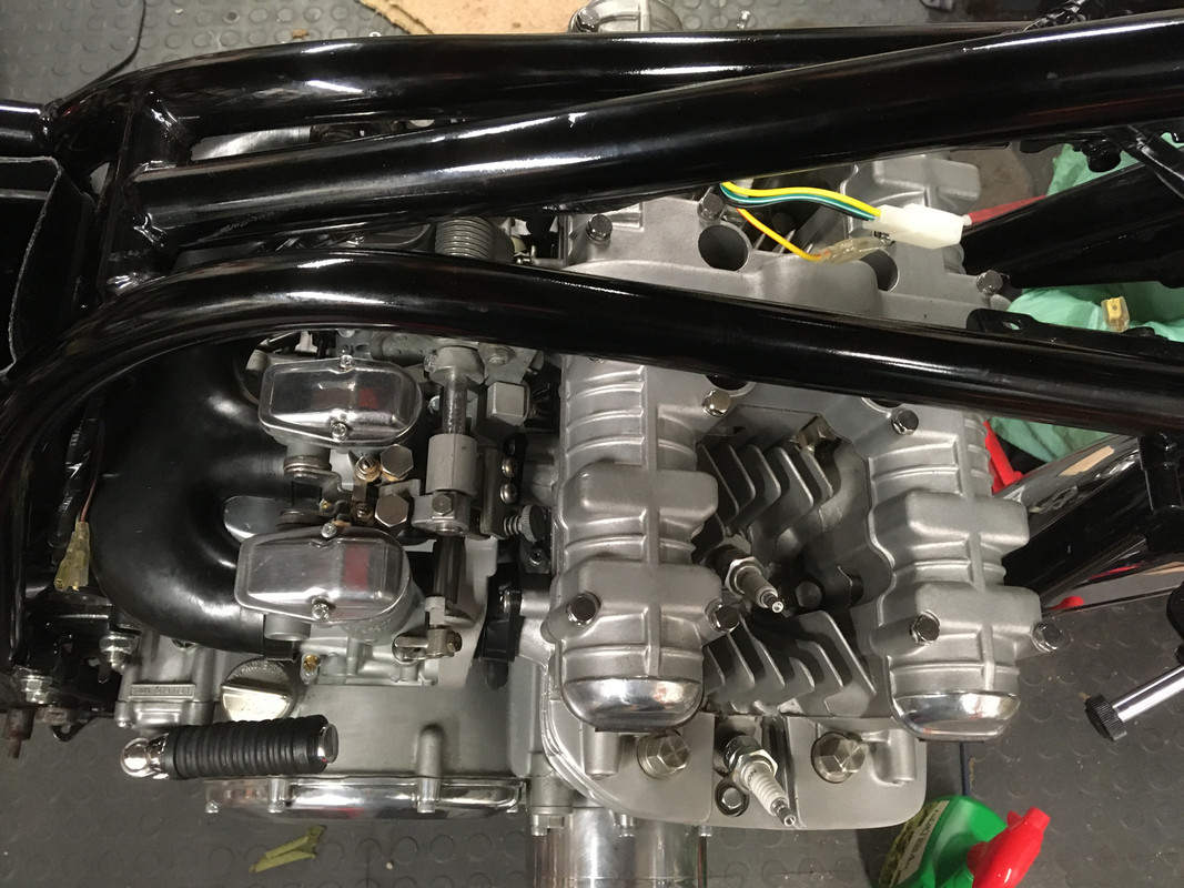

you're doing a real nice job! Congratulations.
I must say that the main loom goes on the left hand side of the headstock, not on the right. The switchlooms however run both on the right hand side of the headstock.
The wires of the points run from the points, under the engine ( there are two metal strips attached to two engine bolts) behind the right hand frame pipe and then under the central upper frame pipe to the coils.
Good luck with it!

Thanks Philippe, I realise now that the parts book was trying to tell me the correct route for the loom. It will actually be easiest to unplug it at the orange plug and pull it out through the forks rather than undo the plugs to the gauges and ignition switch.
Someone’s going to have to draw me a picture or something for the points lead, I’m still as clear as mud about where it goes. However if it involves going under the engine then it will have to wait until I have wheels attached and the bike is no longer sat on a plastic crate. I think the two clips are in the parts box, however the parts list has 8 of them, so I’m going to have to find out where they all go (HT leads?)

Points wire goes up the rear of the right frame tube which your rear brake light switch is in front of ,hope this makes sense

Thanks for that. The wire is very much going the scenic route, it explains why I can't see it on photos. on the other hand you really don't want an unclipped points wire melting onto an exhaust and causing a very sudden stop.
Last night I put the swinging arm in, as the endless chain had arrived from Germany. I held the chain out of the way with a cable tie, my main problem was I needed 3 arms, or an assistant to put the spindle in while holding the swinging arm in the right place. getting frustrated I thought 'Ganesh (the Hindu elephant God with 4 arms) would be good at this'. Finally all in place I realised that the swinging arm was wider than the gap between the two exhaust hangers, and I had the swinging arm below it, out of reach of the shocks. Bad words were said, and out it came again. Finally.....
