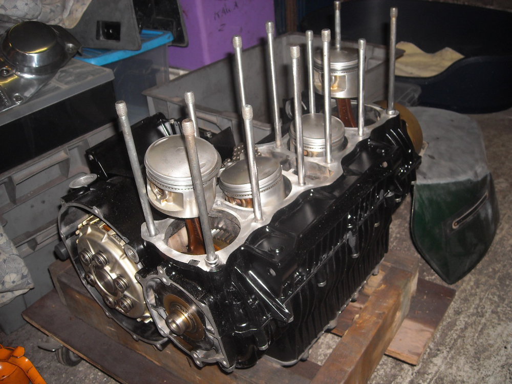

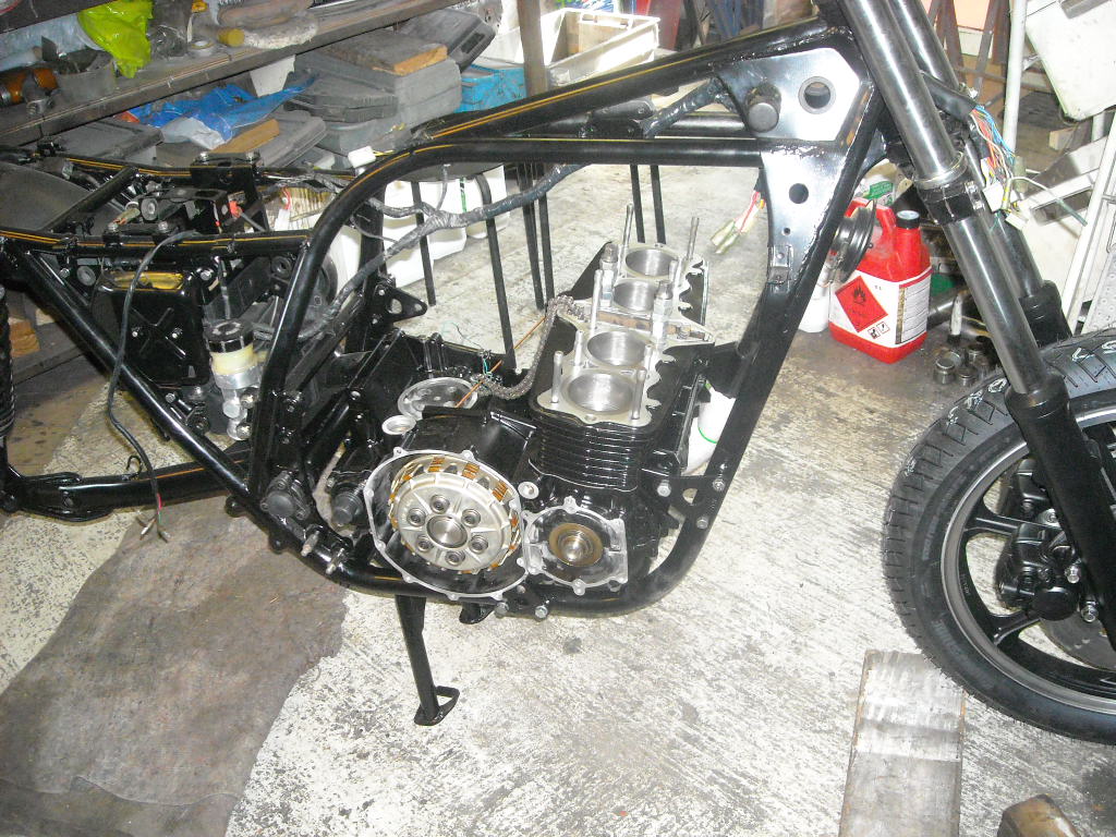

the lower engine is assembled
the lower engine
the pistons were cleaned and received new piston rings

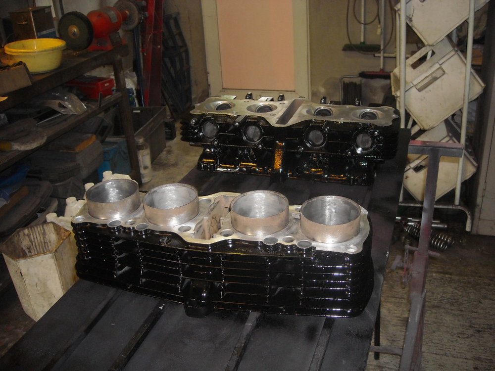

the cylinders and the cylinder head are painted
the painted part
the cylinder bores were honed, the valves lapped in

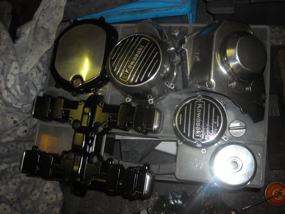

the other engine parts were degreased and they received a clear coat, after a week they spent half an hour in the oven to cure the clear coat.

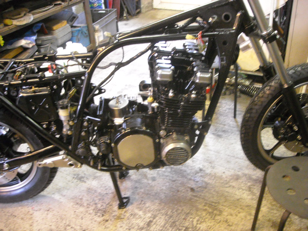

After mounting the pistons in the cylinders, the engine was mounted in the frame
the engine is in the frame
and then it was time to complete the engine .
the completed engine

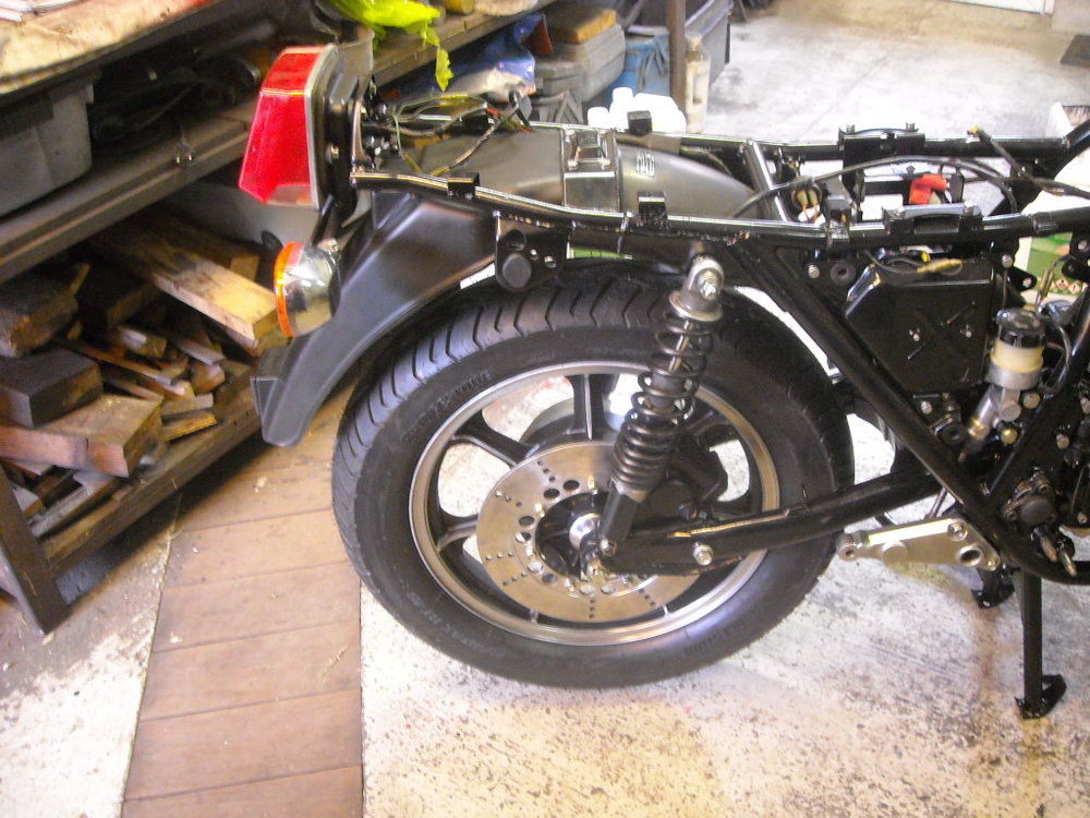

After that I mounted the rear wheel and mudguard
the rear wheel and rear mudguard

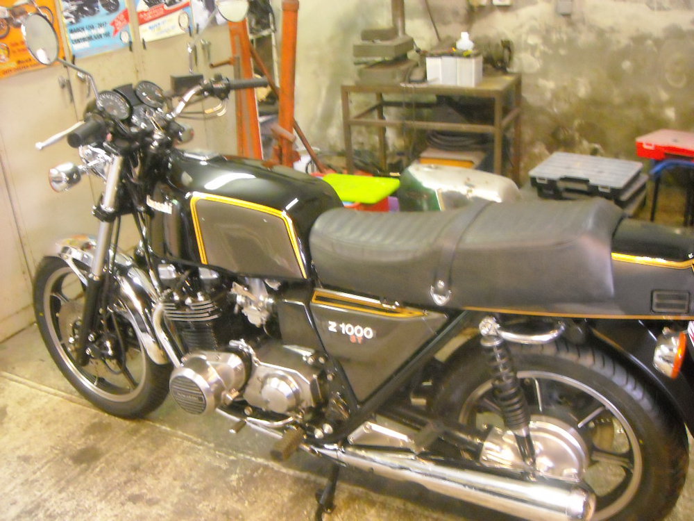

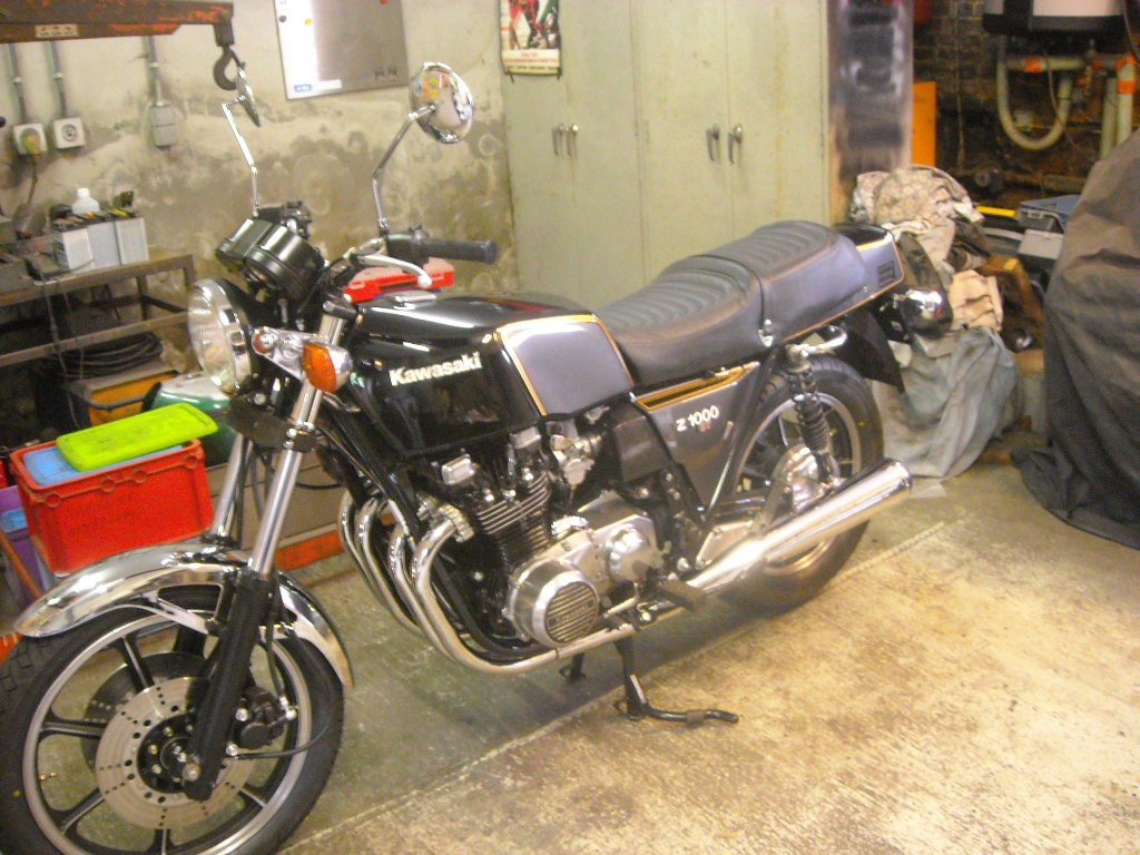

the past weeks the parts came back from the chromer, all the bolts, the front mudguard, the rear brake pedal and the complete exhaust are rechromed.
All the parts that needed to be regalvanised are back and mounted.
Due to family matters, which took a lot of time, I used a spare body set, an ebony one and mounted it on the bike.
She's finished !!!
I hope I can fire her up for the first time tomorrow, fingers crossed!
She didn't became a showroom model but she's in a very decent shape , let's hope there are not too many bugs when I ride her in.
Just some pictures:
