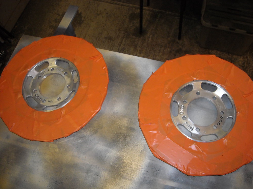

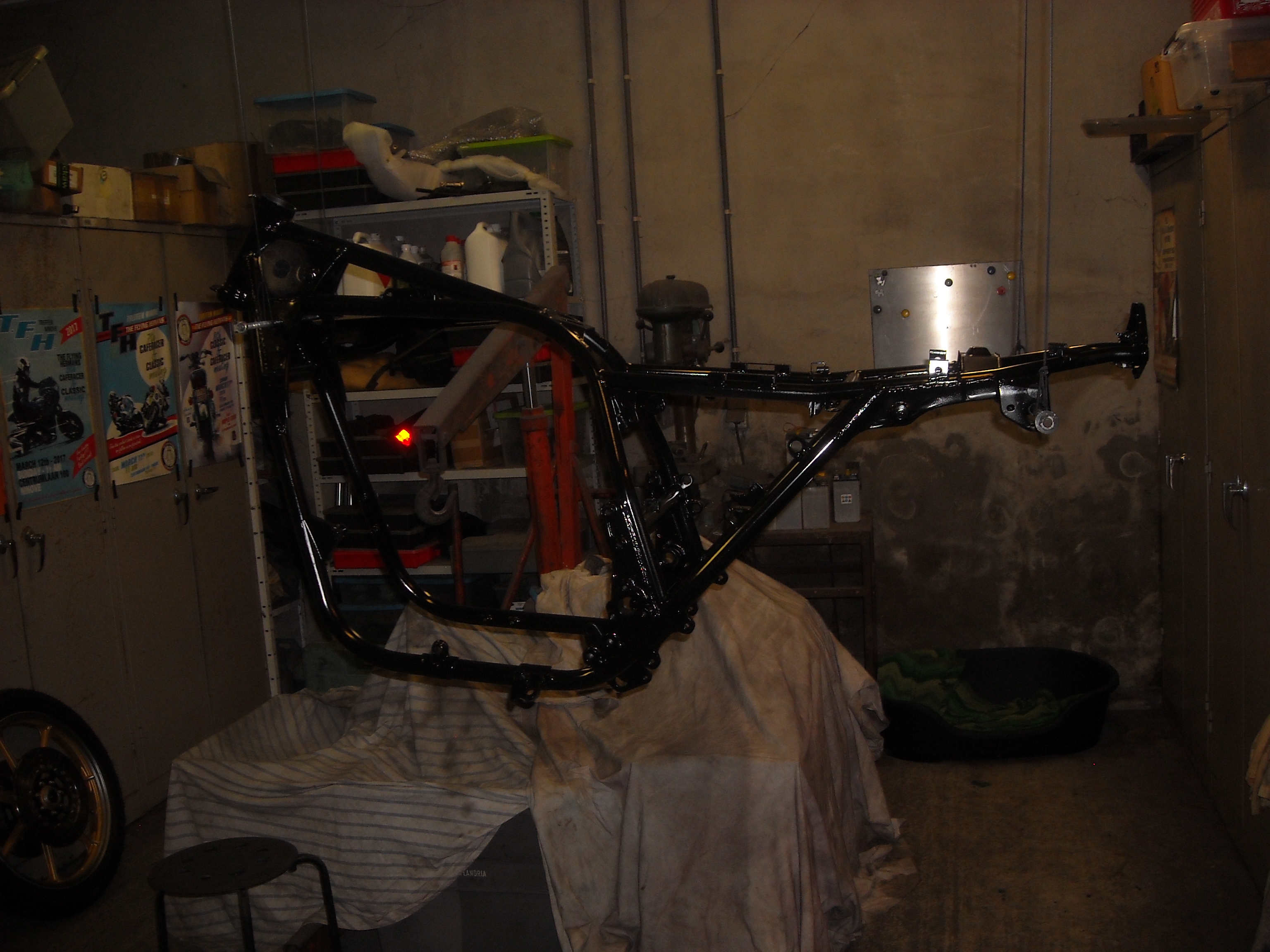

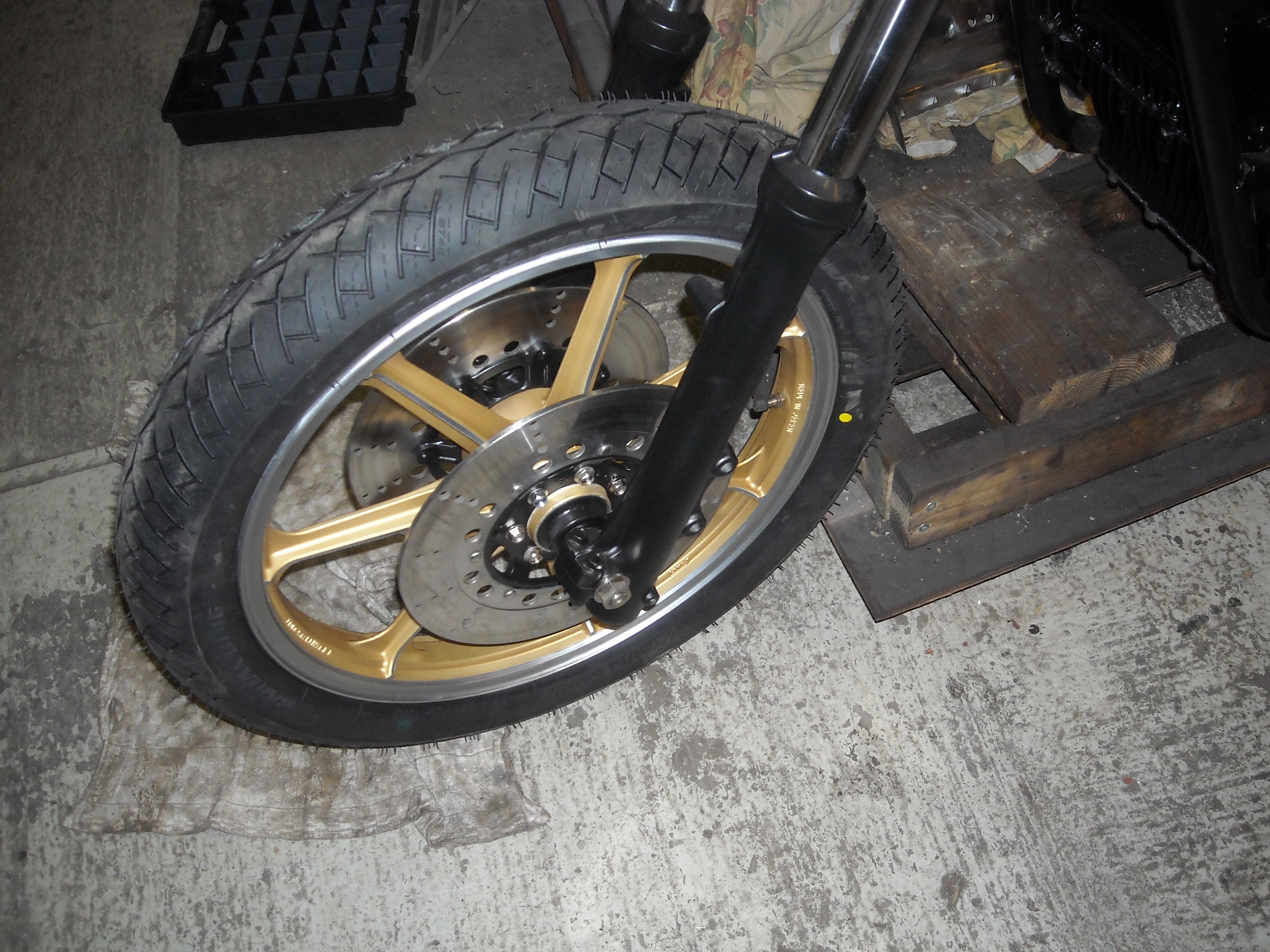

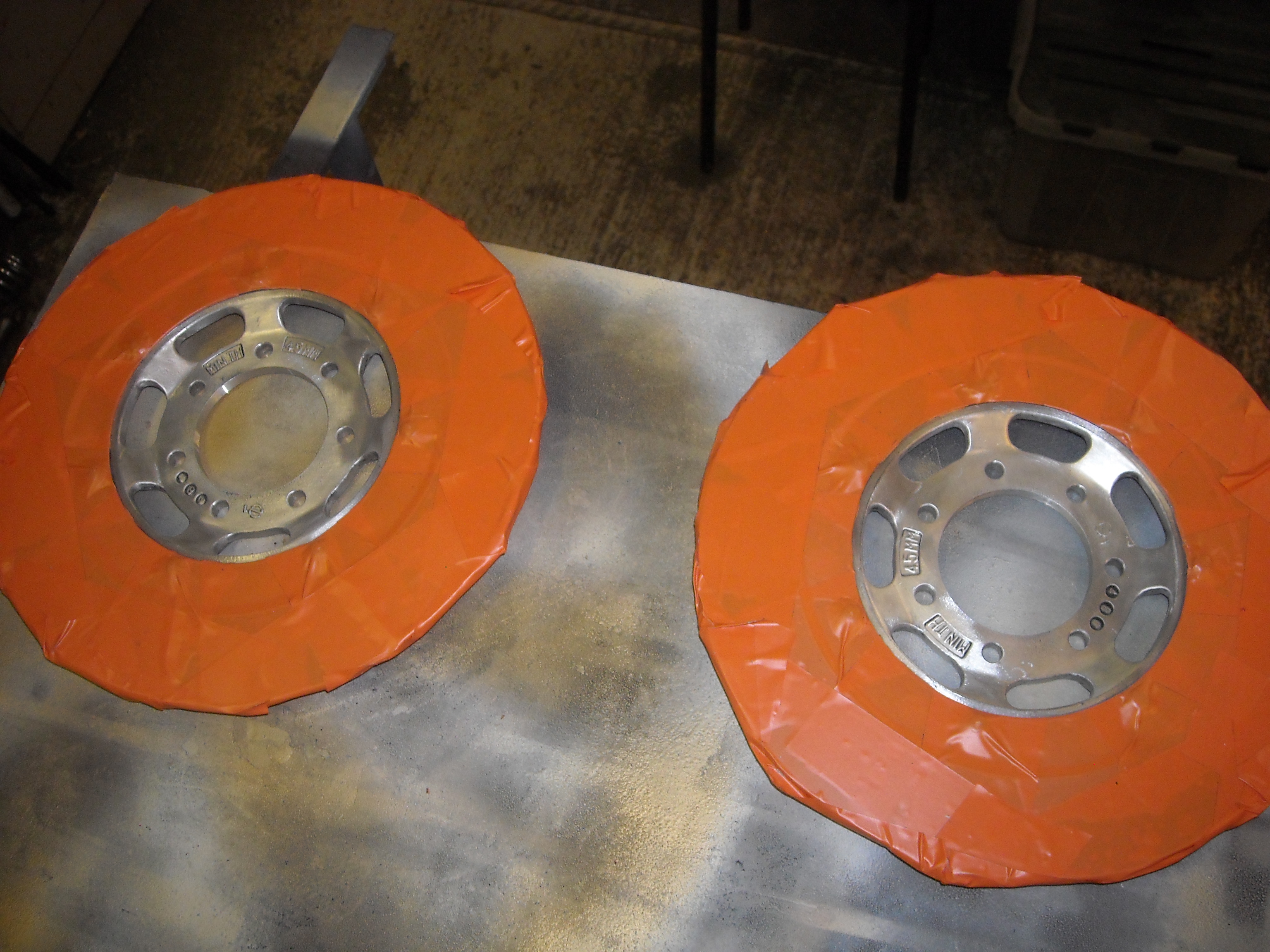

The disk rotors were stripped, taped and painted.

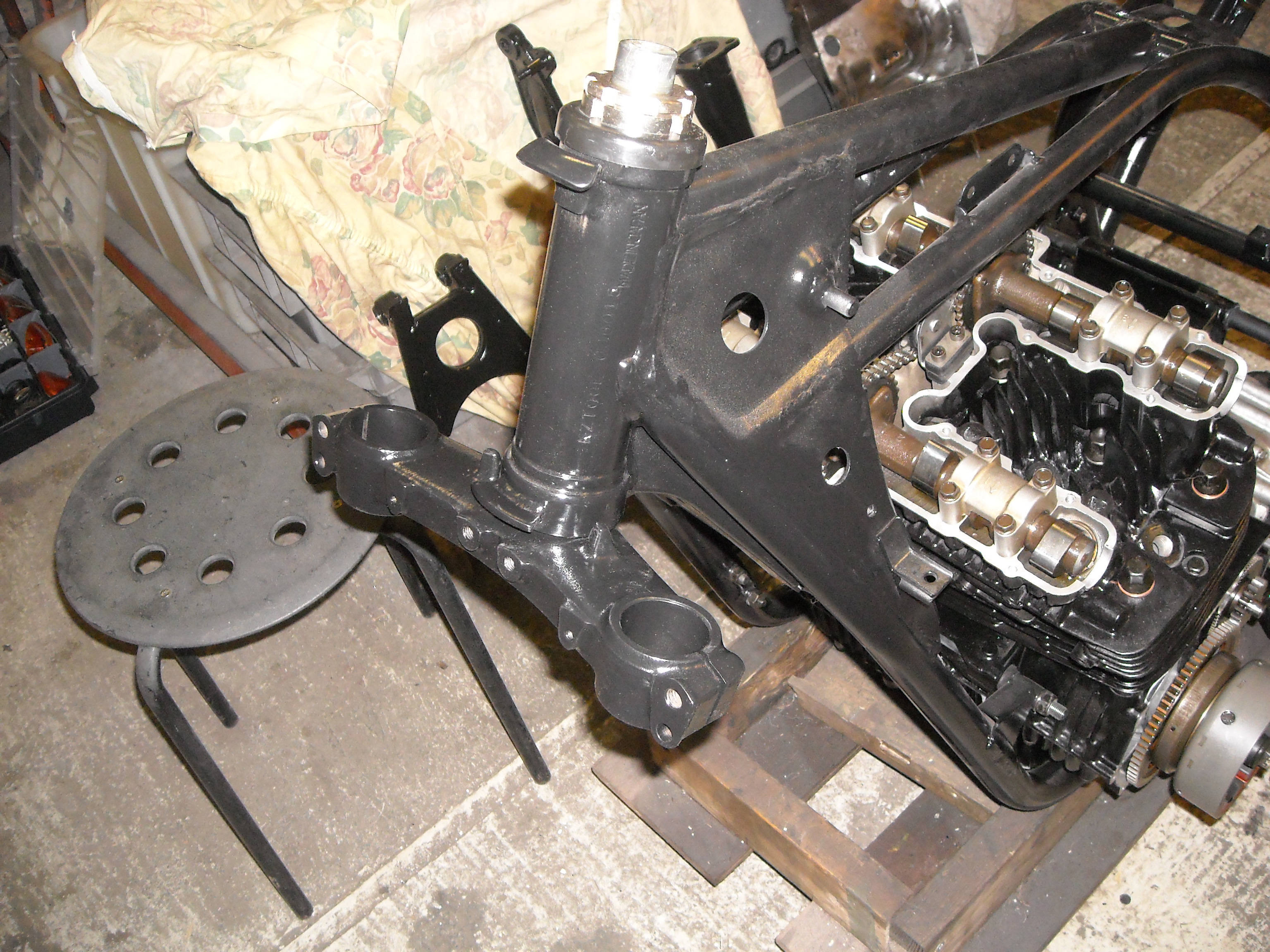

The frame was stripped, degreased and painted

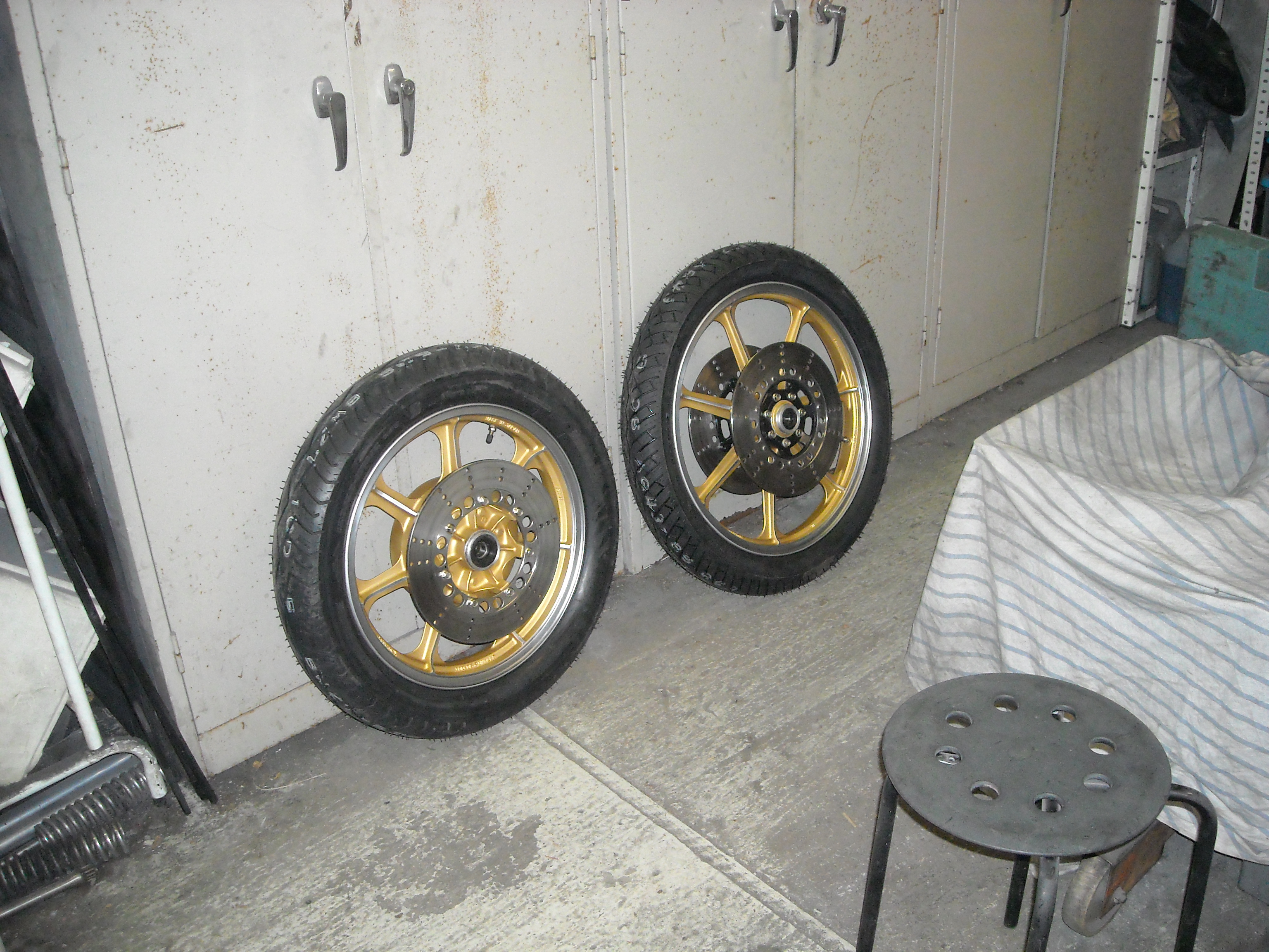

The Battlax BT46 tyres arrived.
They were mounted on the wheels and the disc rotors were mounted too.
For the moment I'm stripping off the paint of the major frame parts: the swingarm, the main stand and the lower triple tree.
Most of the smaller frame parts are ready to be painted.

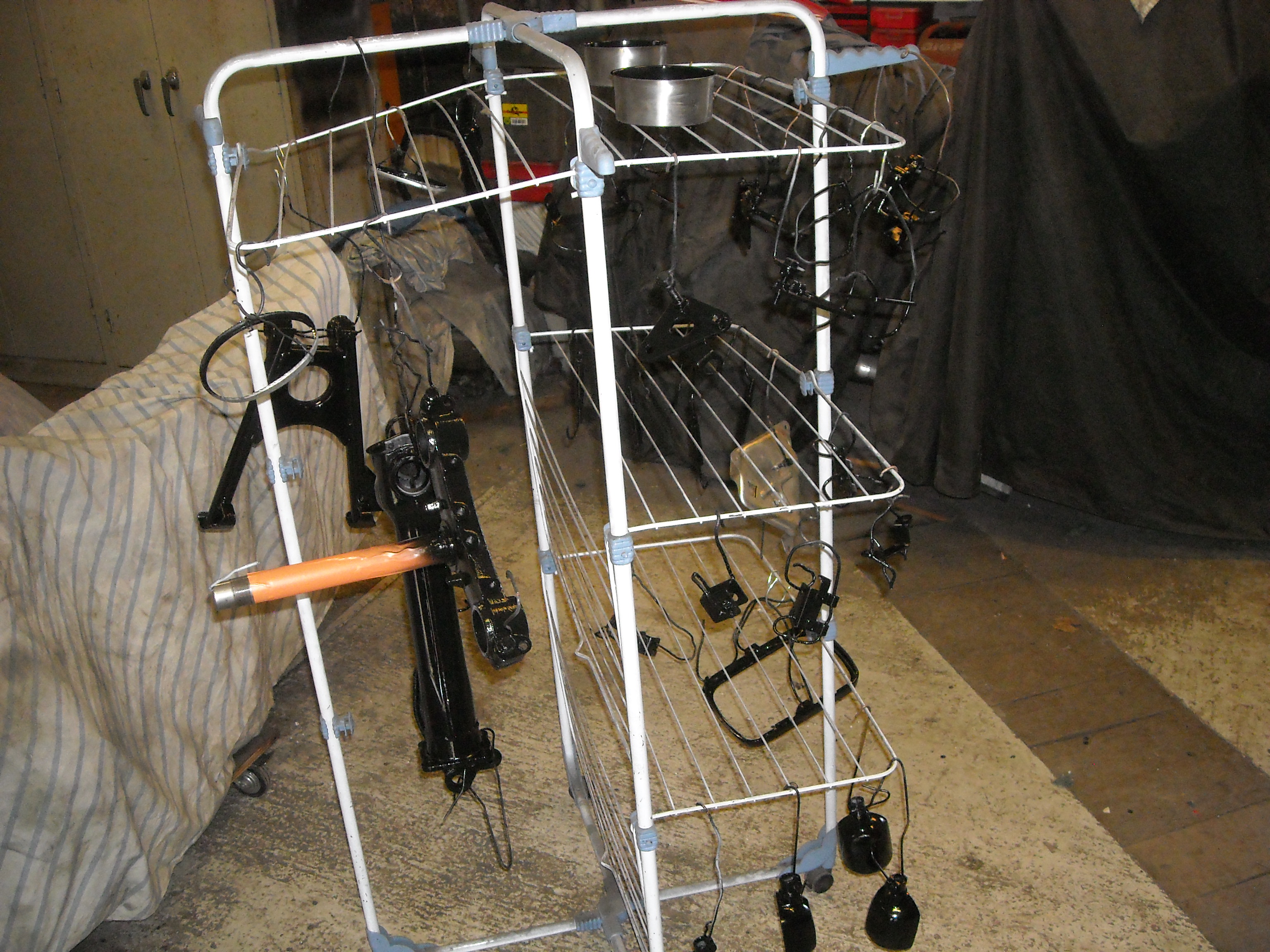

on saturday the main frame parts were stripped , the swingarm, the main stand and the lower triple tree were prepared, some more smaller parts were stripped .

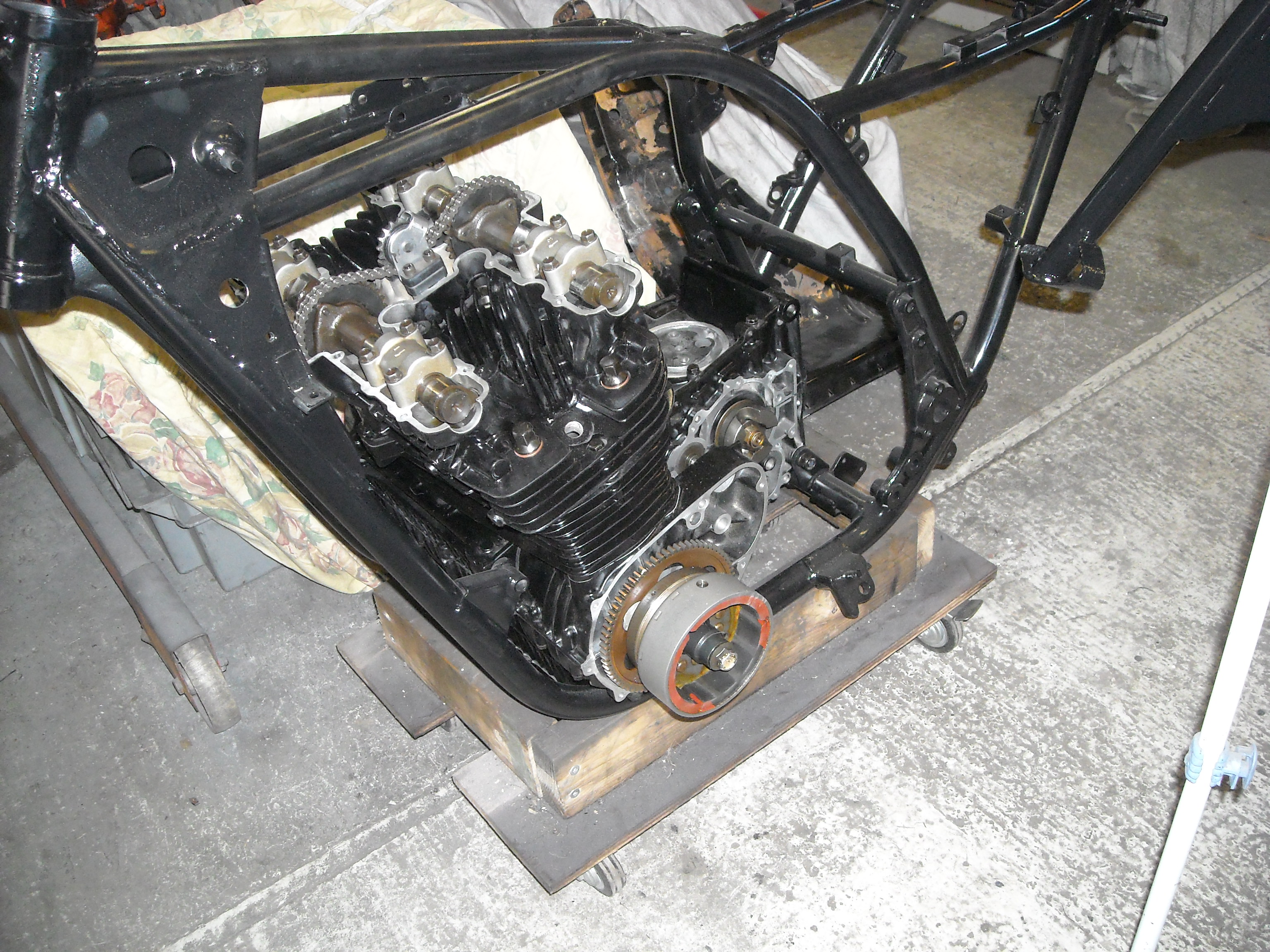

on sunday I had a lot of fun together with my mates son: we assembled the engine.
After partial assembly the engine was placed into the frame after which the engine assembly continued and this is the result of a day full of fun!

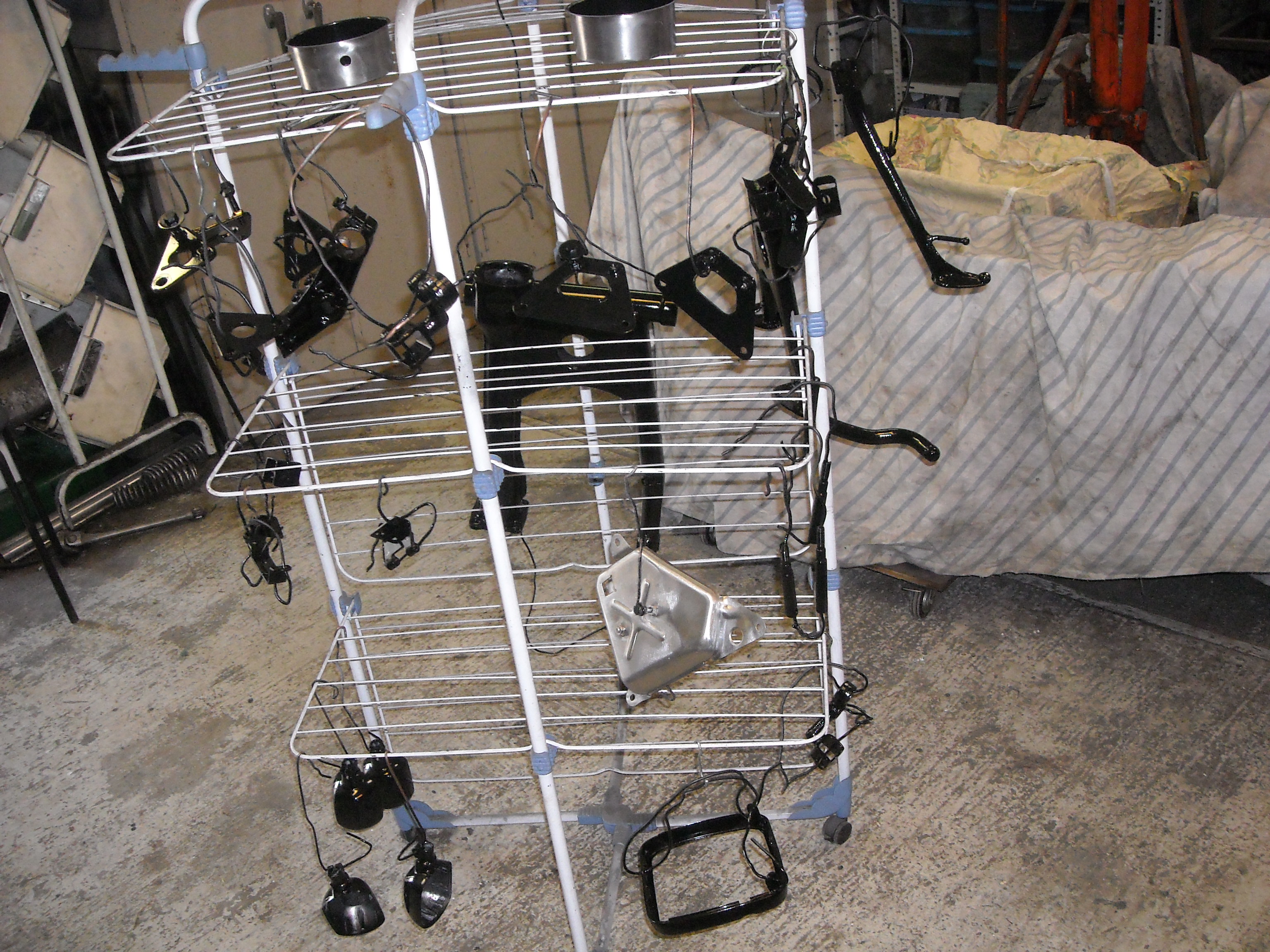

This morning the temperature was high enough to do some paintwork.
After degreasing and making sure I could handle the parts after spraying, the paintjob was done in less than one hour.
The parts are drying now and perhaps tomorrow I can start the assembly of the bike, we'll see how far that'll take me.
During spraying I ran out of paint, nothing to worry about since I have to do some more paint stripping of other parts and I have to do another painting session. I always try to have some extra parts which are ready to be sprayed just in case I have paint left after the main goal is achieved. I almost succeded in spraying all the parts I had prepared, only the electric plate is left and will receive paint the next time.

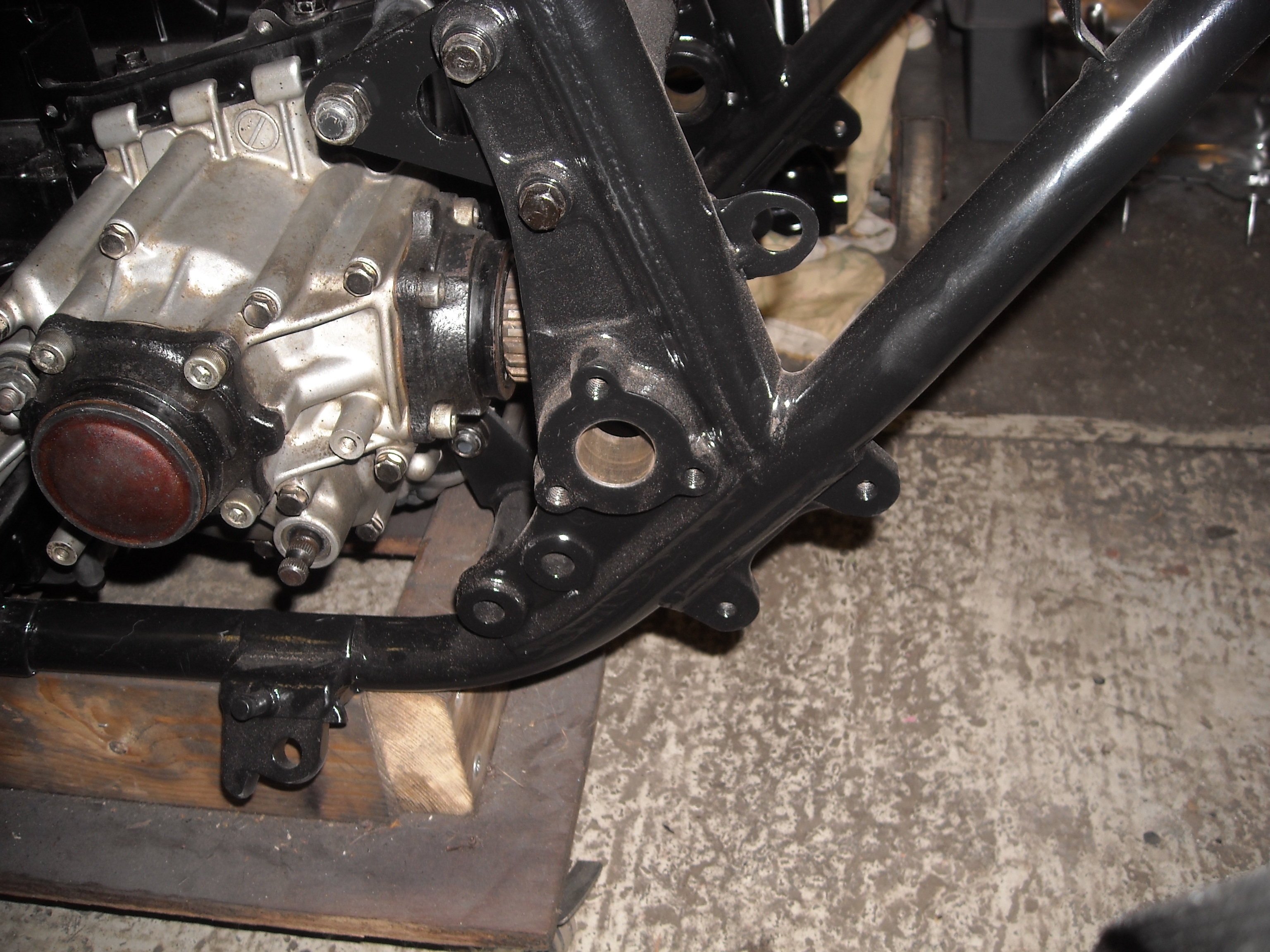

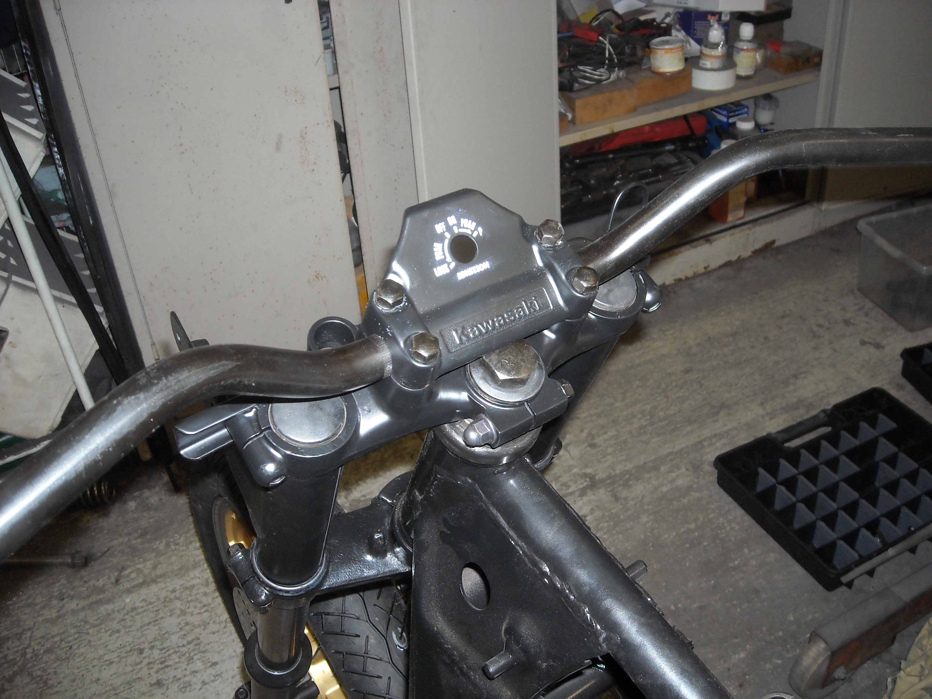

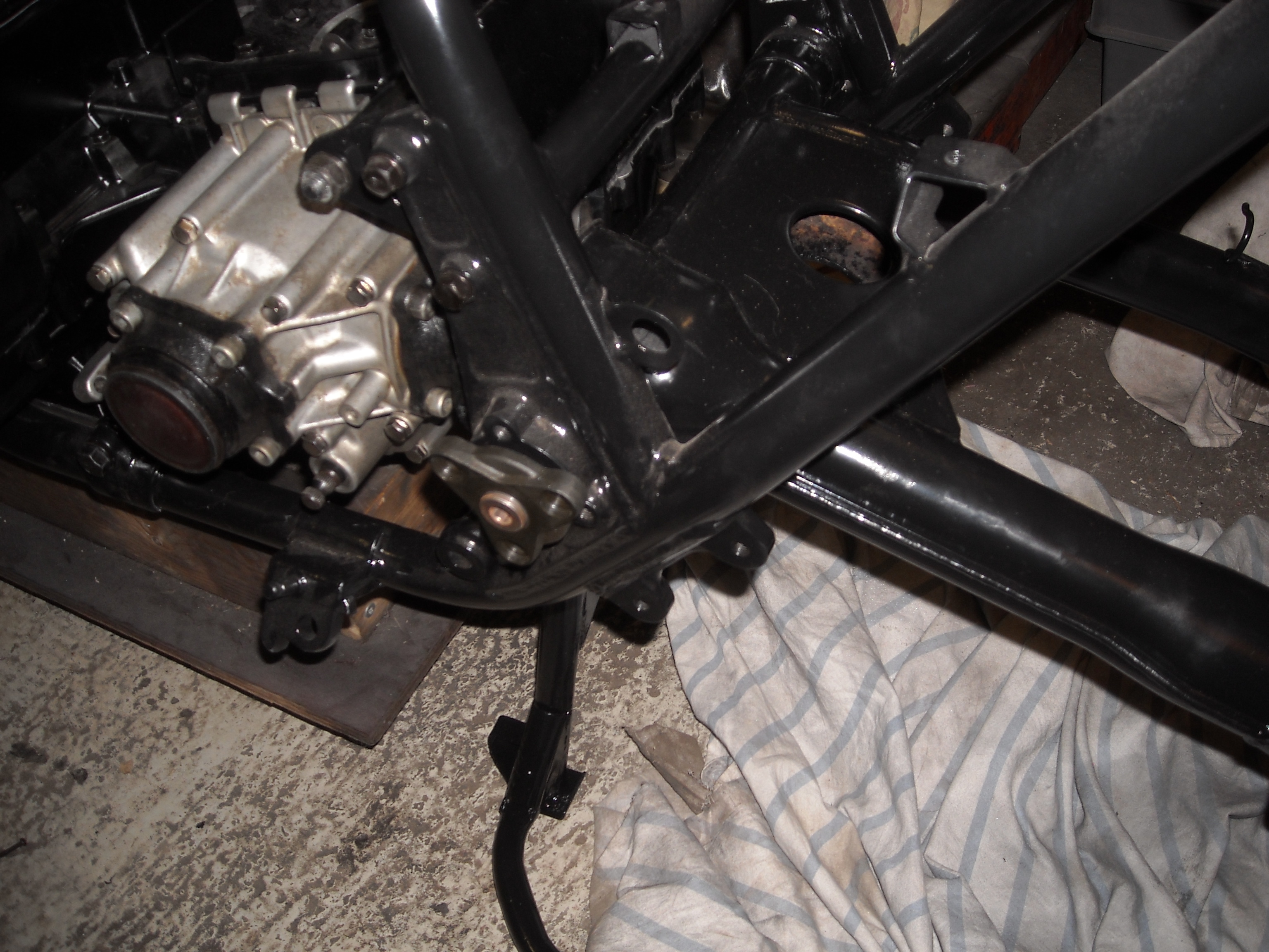

The frame received new conical bearing shells in the headstock and the steering stem was mounted.
After that, the front bevel gearcase was mounted and then it was time to mount the swing arm.

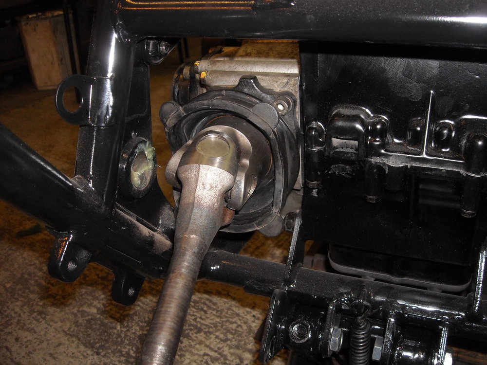

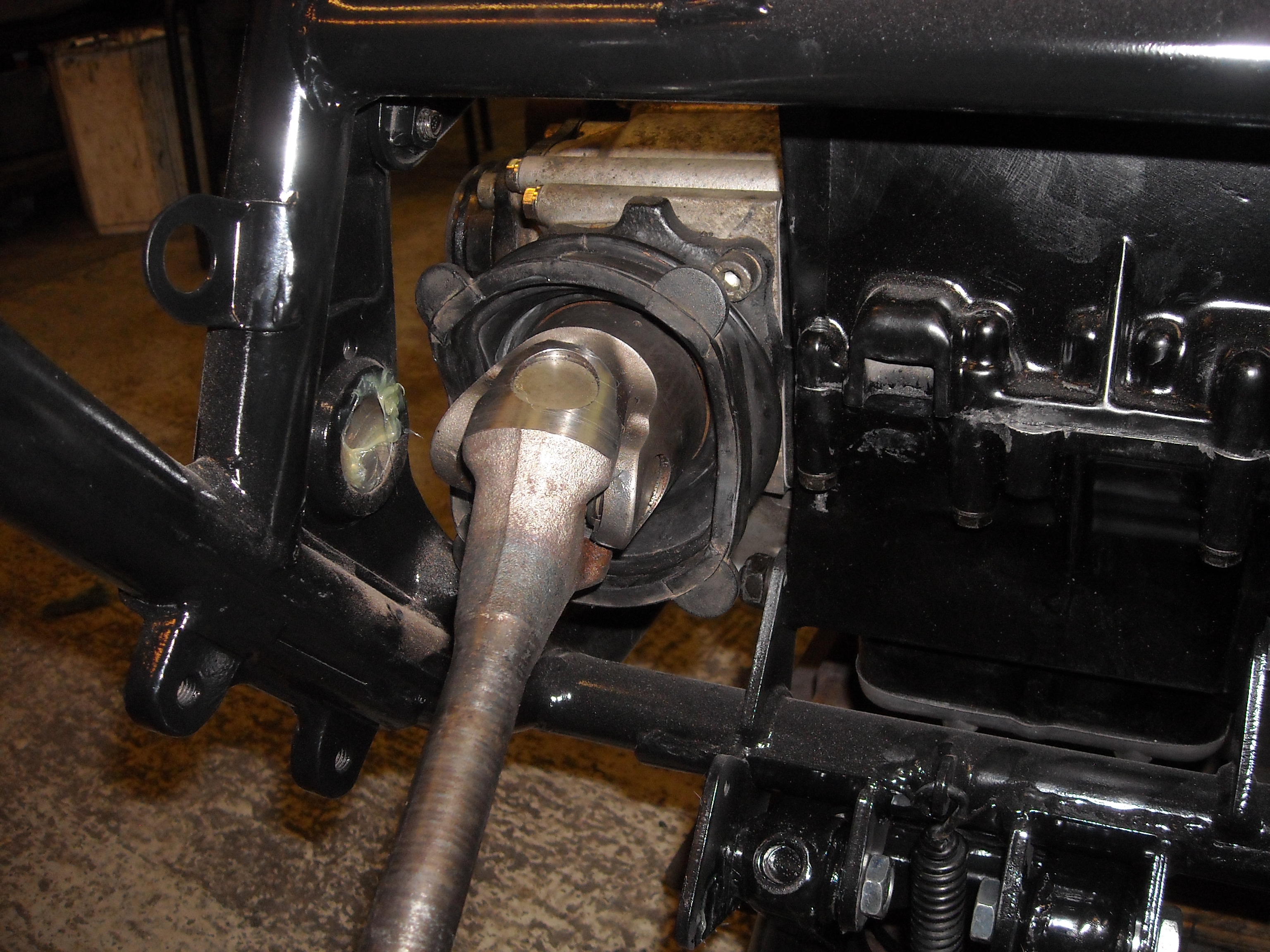

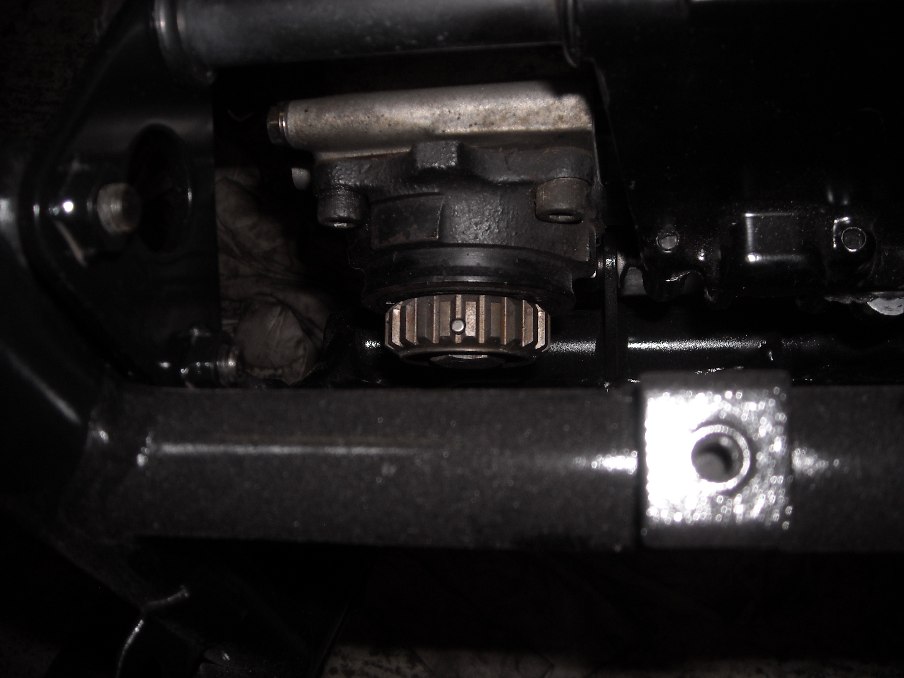

I decided to mount the drive shaft first. The last time I placed the drive shaft in the swing arm and it took me a lot of time to secure the drive shaft so this time I decided to mount the drive shaft first and then the swing arm.
When mounting the drive shaft don't forget to put the tiny pin in the front bevel gear case. This little pin secures the drive shaft and prevents it from coming loose when driving.
Make sure that the holes in the frame, where the shafts are mounted, are clean and lubricate them with bearing grease.
Before mounting the swing arm into the frame make sure that the rubber protective cap and the clamp are mounted on the bearing housing of the front bevel gear case.
Slide the swing arm over the allready mounted drive shaft and twist the swing arm in order to get it at the correct place.
Insert both cleaned and lubricated shafts through the frame and secure the swing arm.
The whole procedure for mounting and adjusting the swing arm is described in the shop manual.
It's a bit complicated to explain it completely here, if you're restoring or repairing an ST, just get a manual, it's worth every penny!

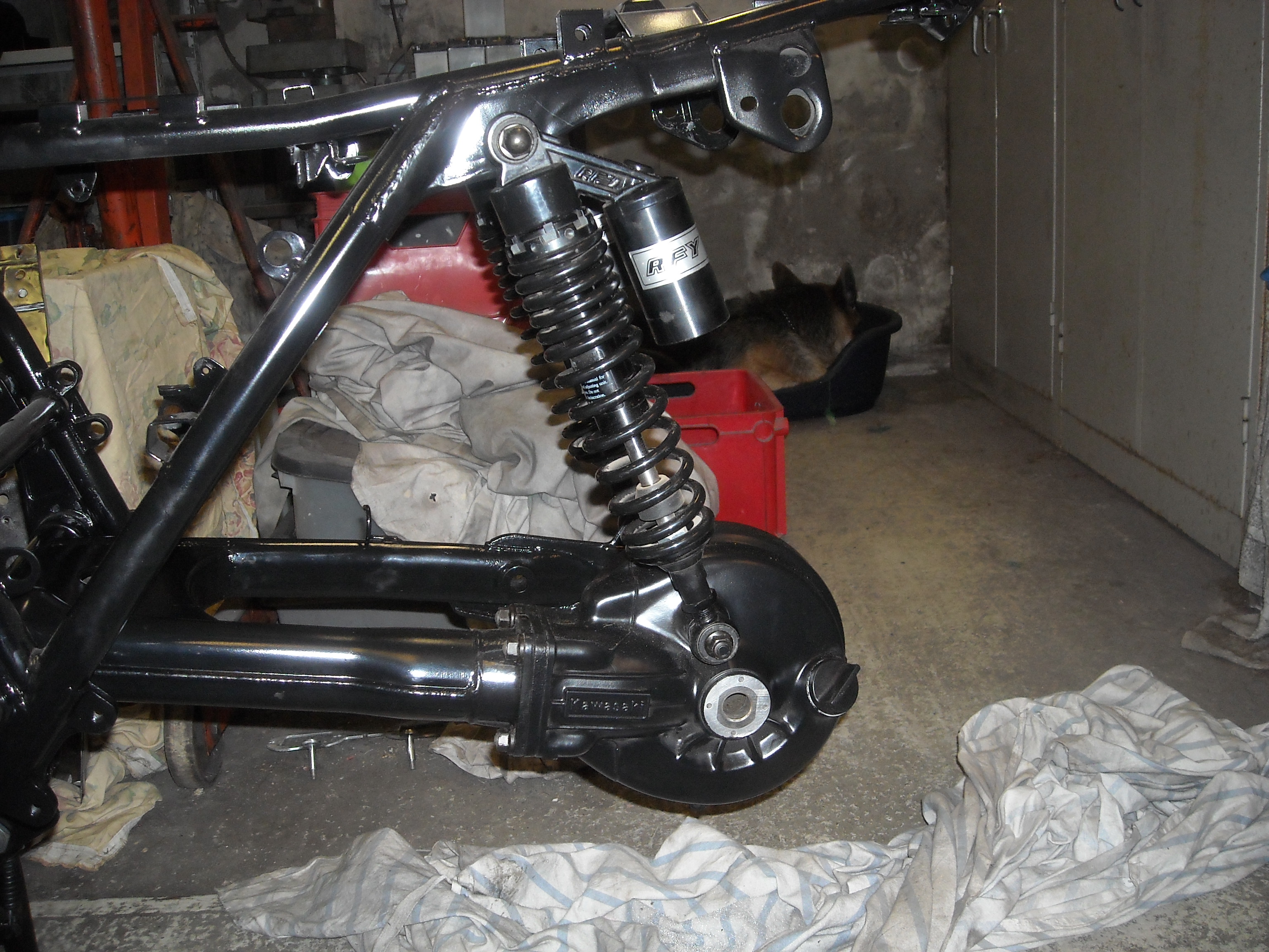

Afterwards I mounted the final gear case and the rear shock absorbers.
This side of the bike was ready to receive the wheel so I returned to the front of the bike.

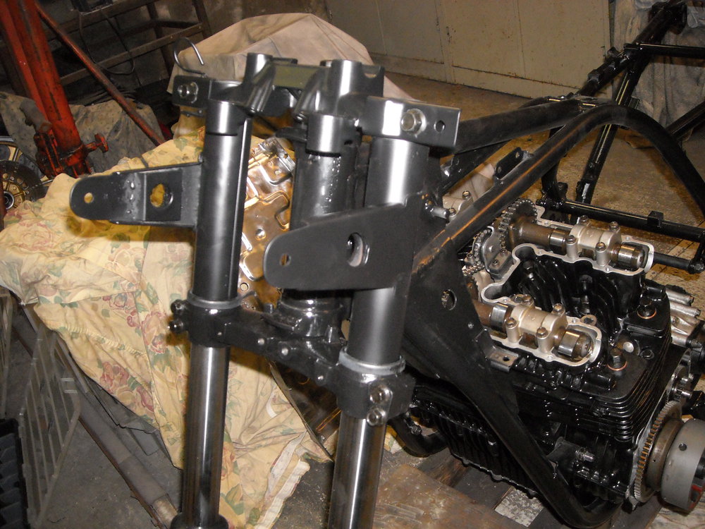

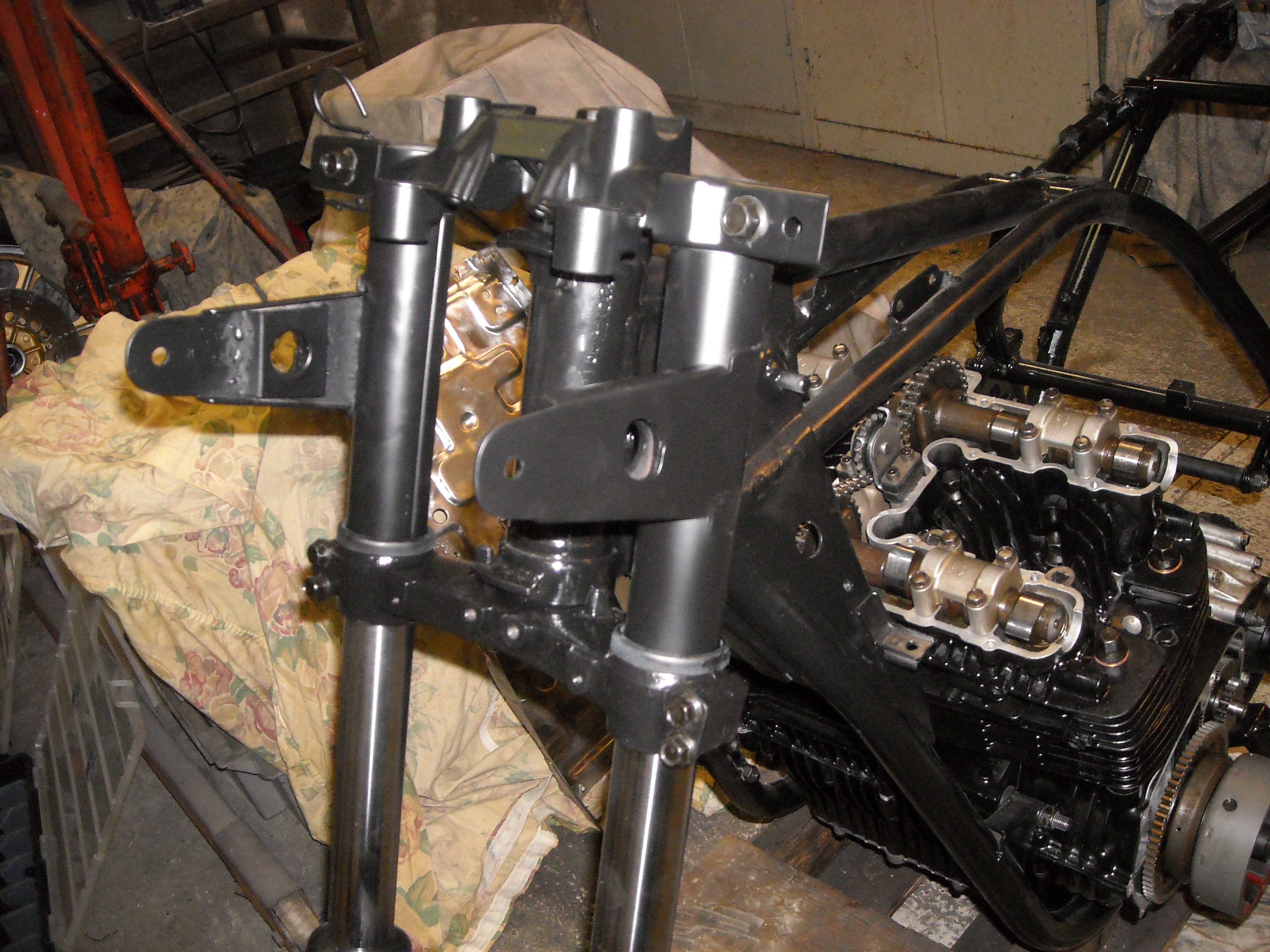

The front fork was installed.
After the fork legs were secured they received the lamp ears and the head of the steering stem was installed.
The handle bar was mounted and secured with the holder.

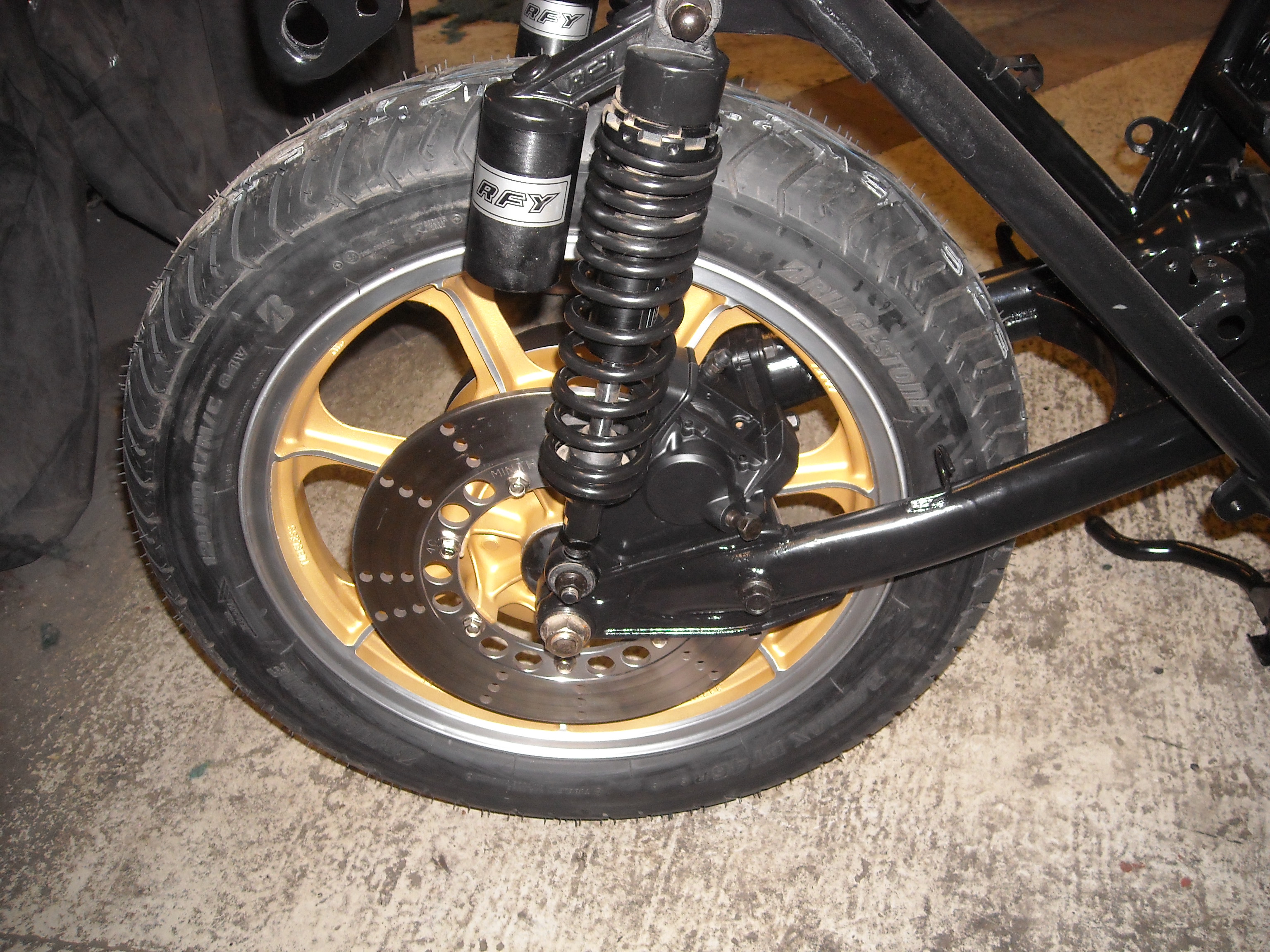

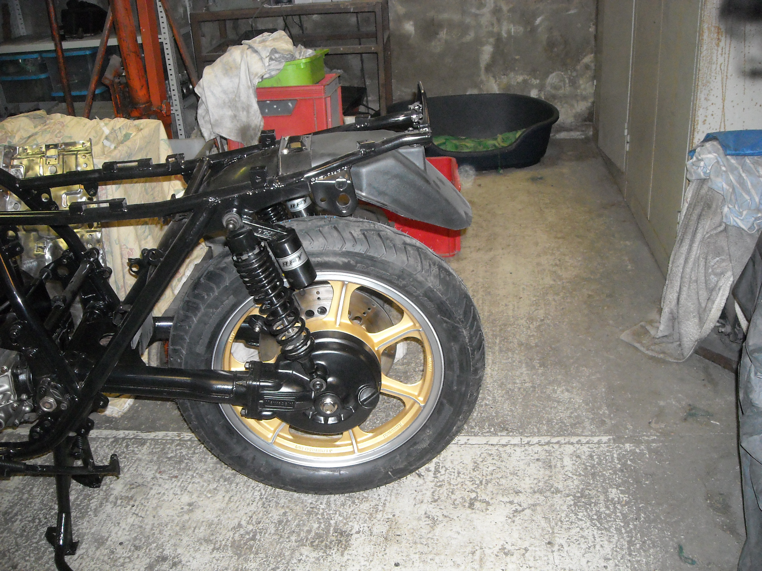

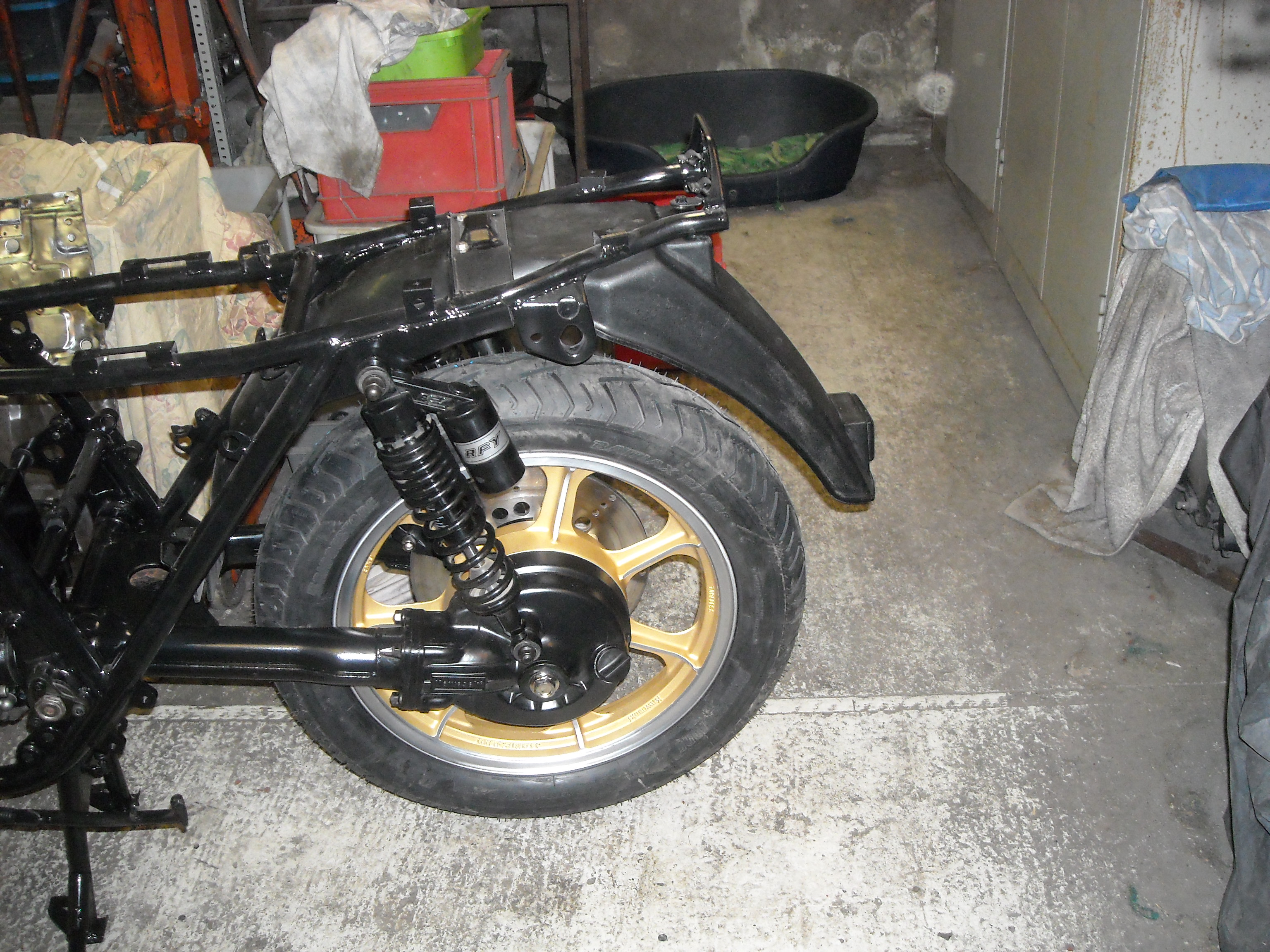

The rear caliper was assembled and then it was time to mount the rear wheel.
Gentlemen, the bike is standing on it's wheels !

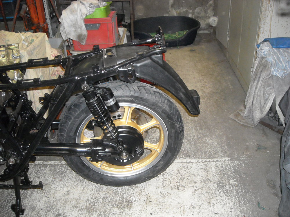

I couldn't resist mounting other parts so I started with the rear mudguard.
Should I use the long one ...
...or the shortened mudguard?
Just give your opinion please, I'm waiting to decide!

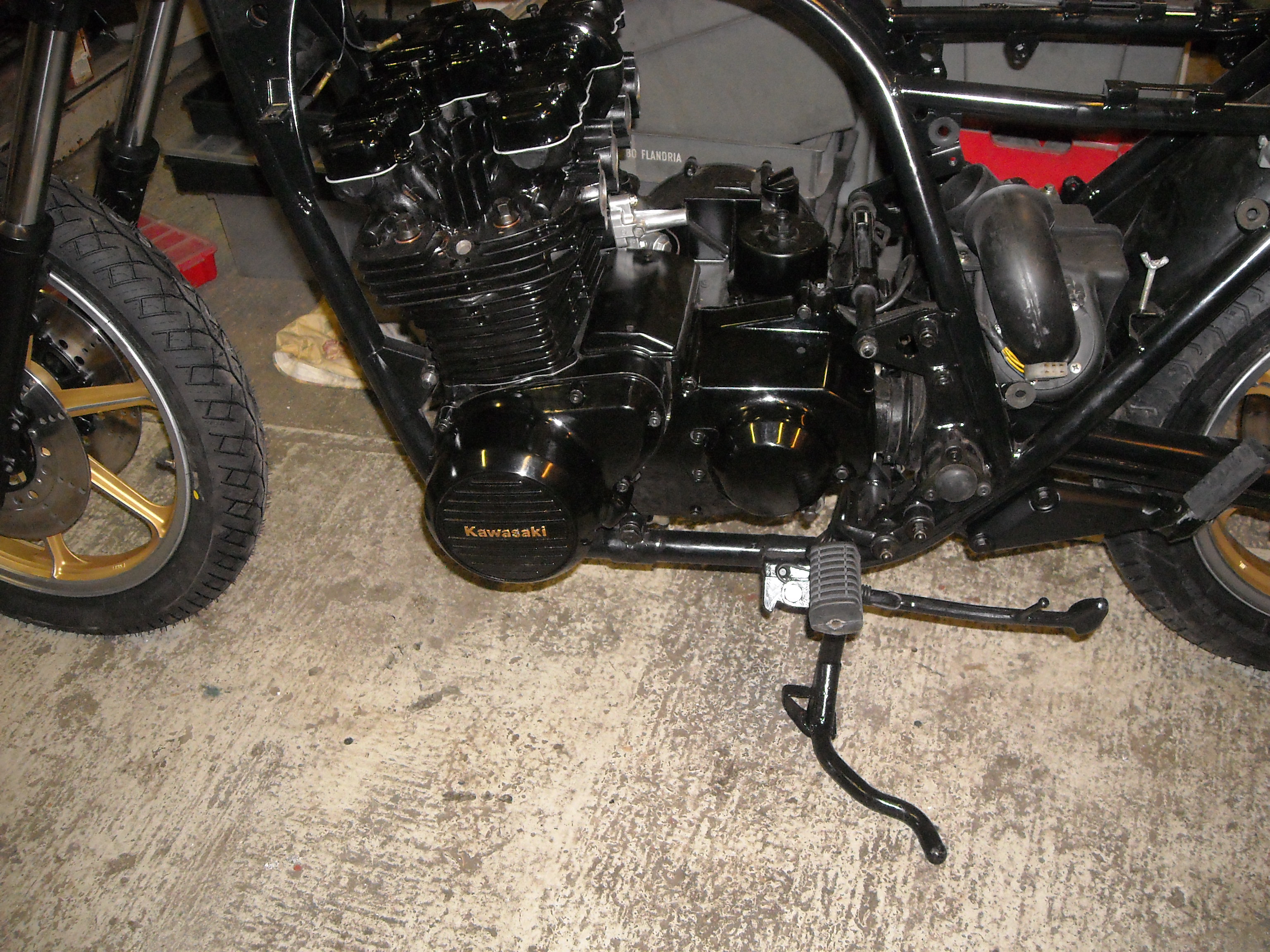

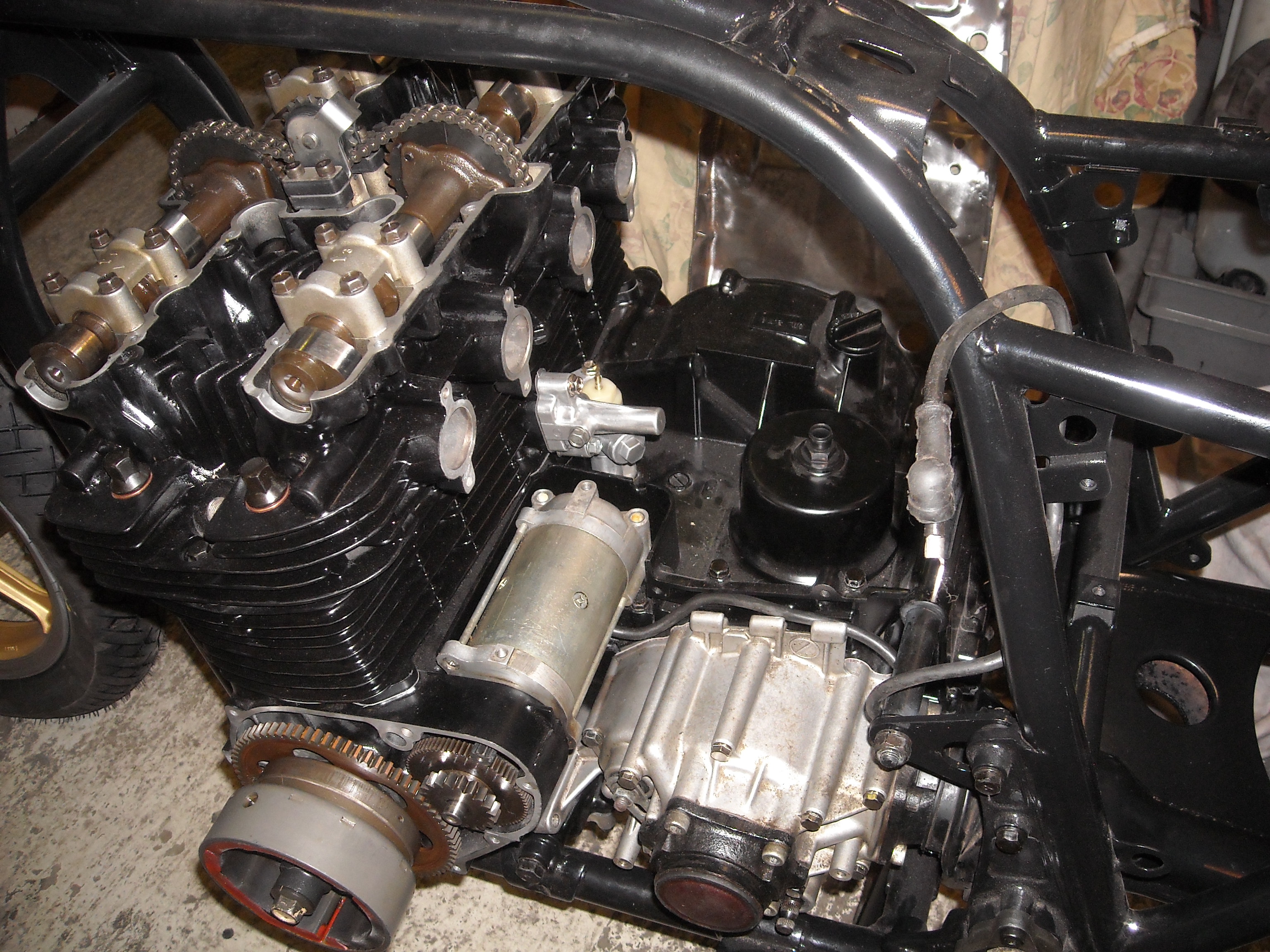

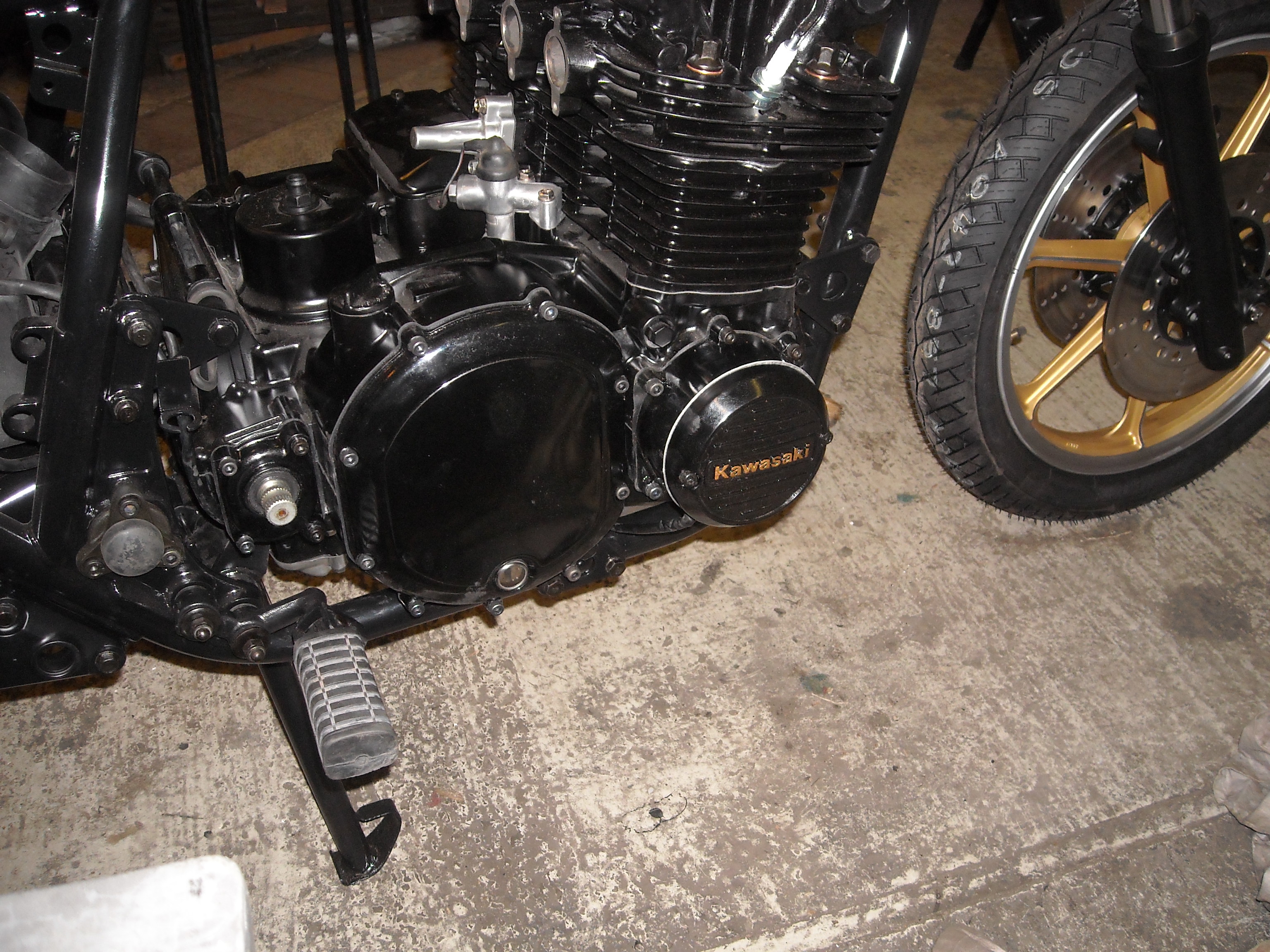

So it was time to do some assembly work on the engine.
The starter engine, the breather body and the oil passage with pressure switch were mounted.
Now it was time to complete the engine.
The engine covers were next.
They were painted a few weeks ago, received a glossy clear coat and baked in the oven.
This is how they look like when mounted:
The engine is complete and ready to receive oil!

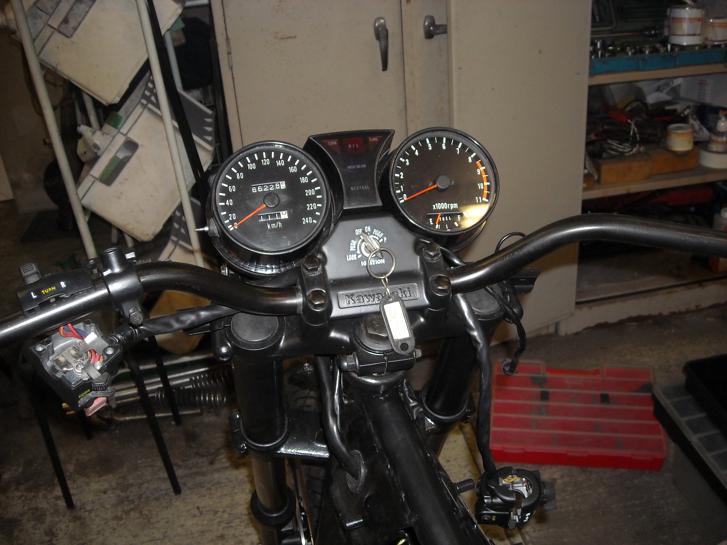

The clocks were painted, assembled and mounted
It starts to look like a bike!

Looks great. I'd go for the shorty on this and save the long one for a standard bike.
rickm
Posts: 473
Joined: 8th Aug 2017
Location: Kent
Re: Z 1000 ST ELR
#28 PostAuthor: rickm » Sat Feb 19, 2022 9:09 am
Agreed, short mudguard (if any) on an ELR rep.

#29 PostAuthor: GPZ592 » Sat Feb 19, 2022 12:23 pm
Looking good. +1 for the short mudguard :up

Philippe, what are those RFY rear shocks like for quality ?
Have you ridden with them on the road before the resto ?
H2B GPZ900R
