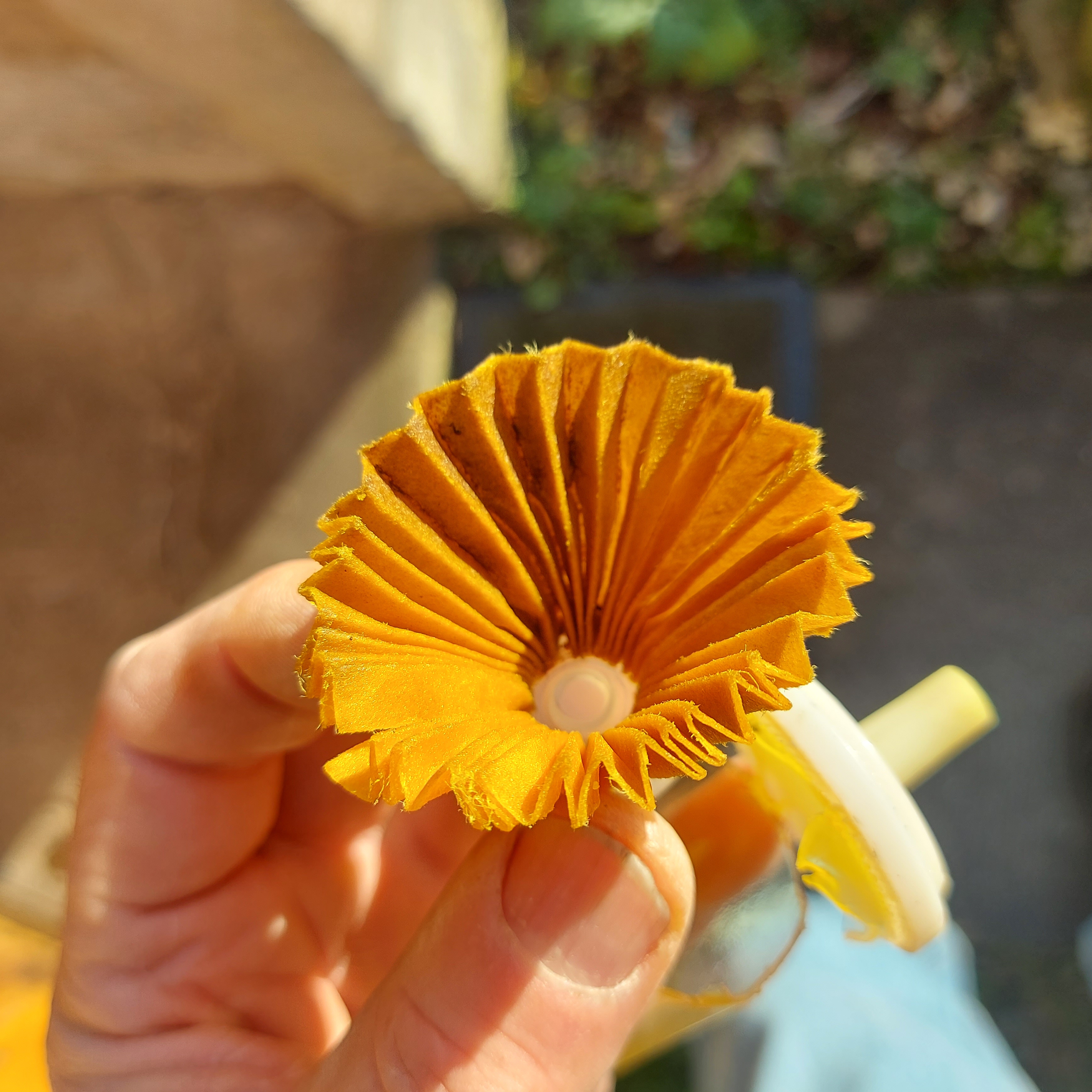

Inlet fills the outer chamber, outlet is taken from the inner chamber after it has gone through the filter element.

warren3200gt wrote:Inlet fills the outer chamber, outlet is taken from the inner chamber after it has gone through the filter element.
Yes it was on the wrong way and a bit clogged.
However maybe not enough to stop flow. You tube search suggests
can fit eaither way but reason to do correct way is mainly so you can see the build up of debris. Anyway away to get new one and fit.
Of more concern is grays comment re tank cap. May be an issue there.
Will need to check my emanual to check fitting order and clean

Fuel supply is too slow if fitted feeding into the inner chamber and slows further as it fills with crud.

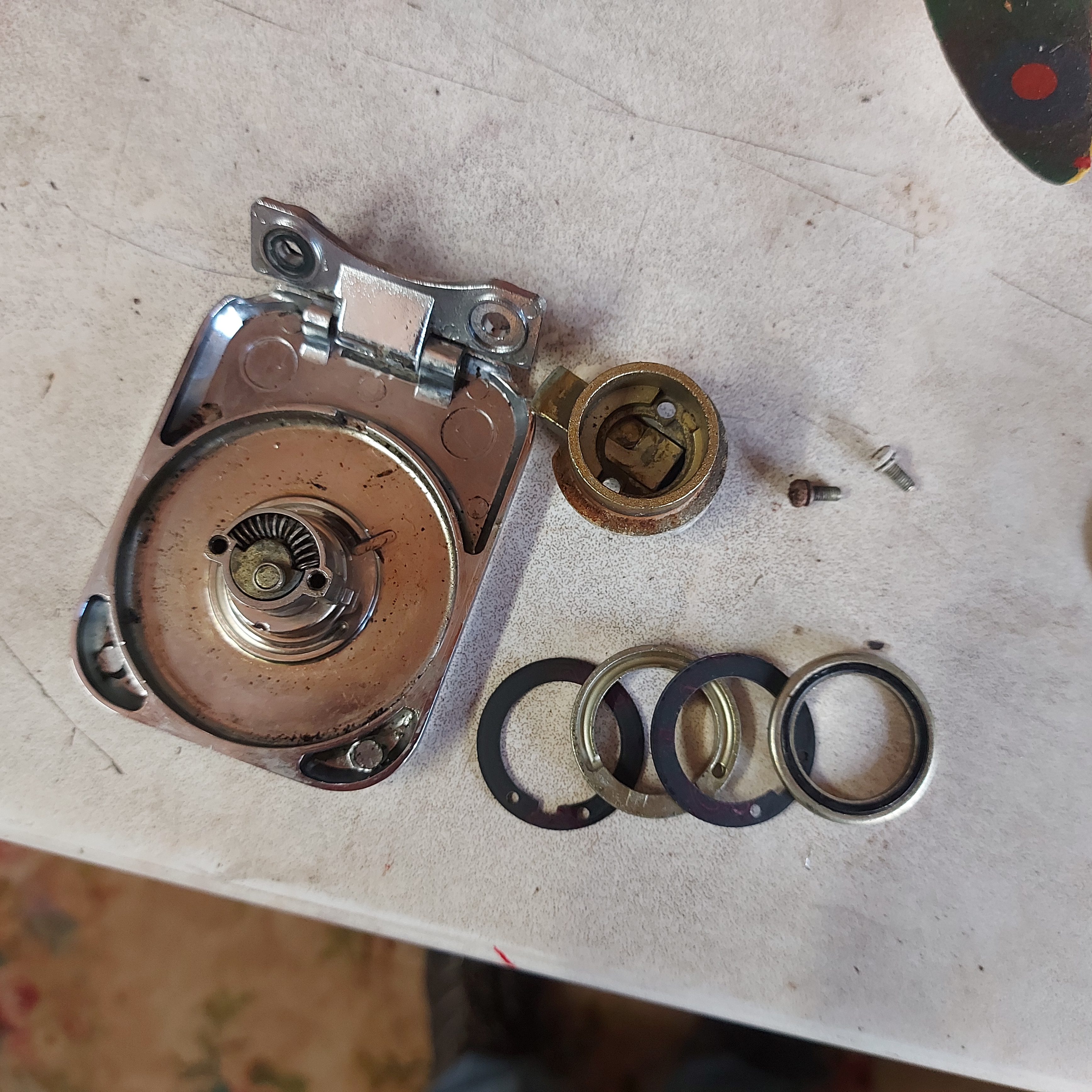

the lid and the parts looks not bad - air comes in the keyhole, through the barrel, into the channel cast in the lid that goes from 7 o'clock on your picture, clockwise to 5 o'clock to the slot in the casting leading outwards, thru one of the holes in the 1st gasket, round the channel cast in the top ring in the pile , thru the hole in the 2nd gasket and then onward to the interior of the tank ( can't see a channel in the bottom round metal ring) Difficult to tell without the parts in hand.
The air takes a long path, but the path looks pretty open as far as I can see. But if the holes don't line up when you reassemble, the problem will persist.

Re: New Registration
