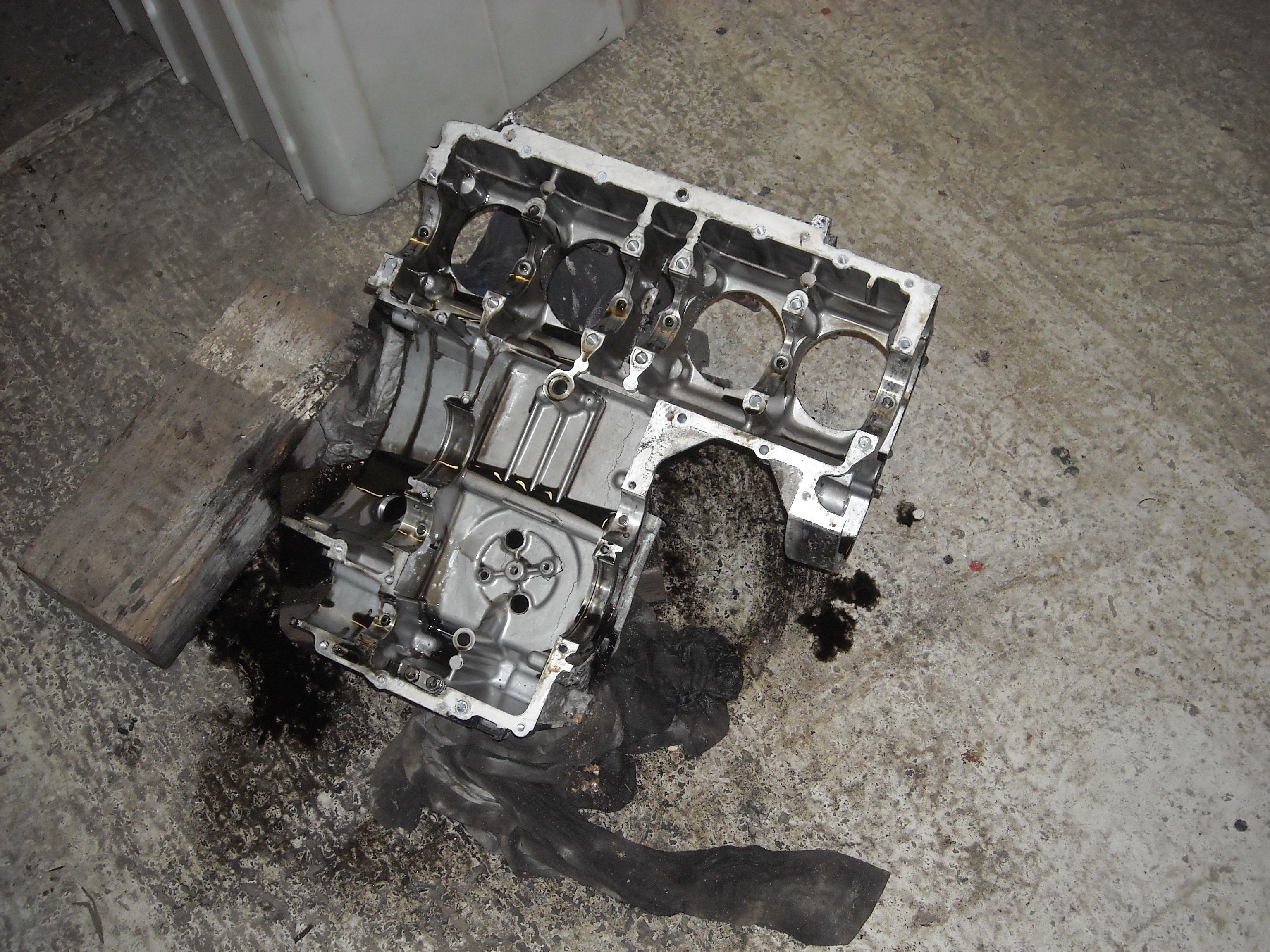

the disassembly of the engine went quite good.
The chain sprocket cover was very hard to remove: the gear selector axle was corroded in it so it took me about one hour to get it off.
No damage done but a lot of fiddling and WD40 spray to get it free.

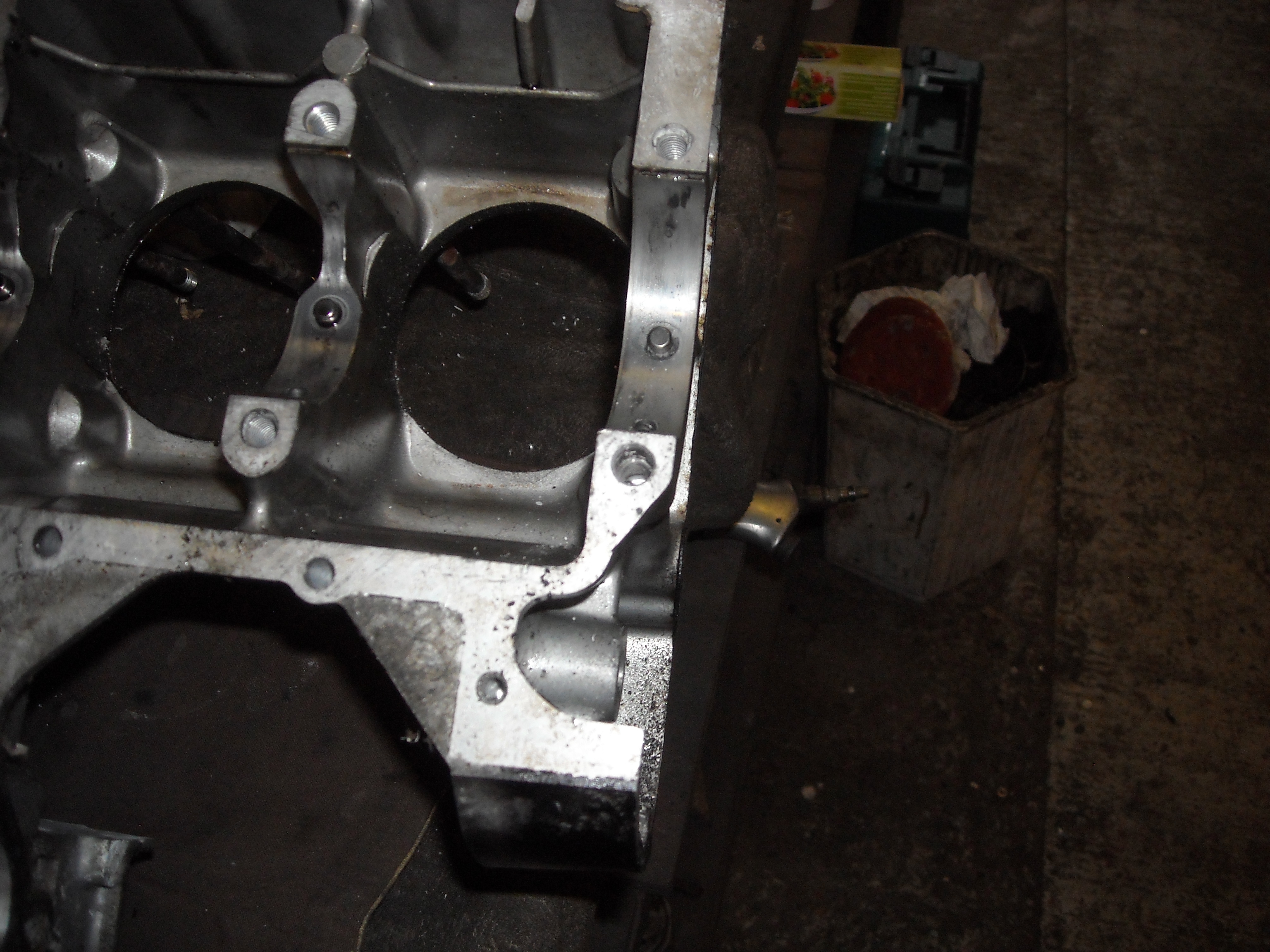

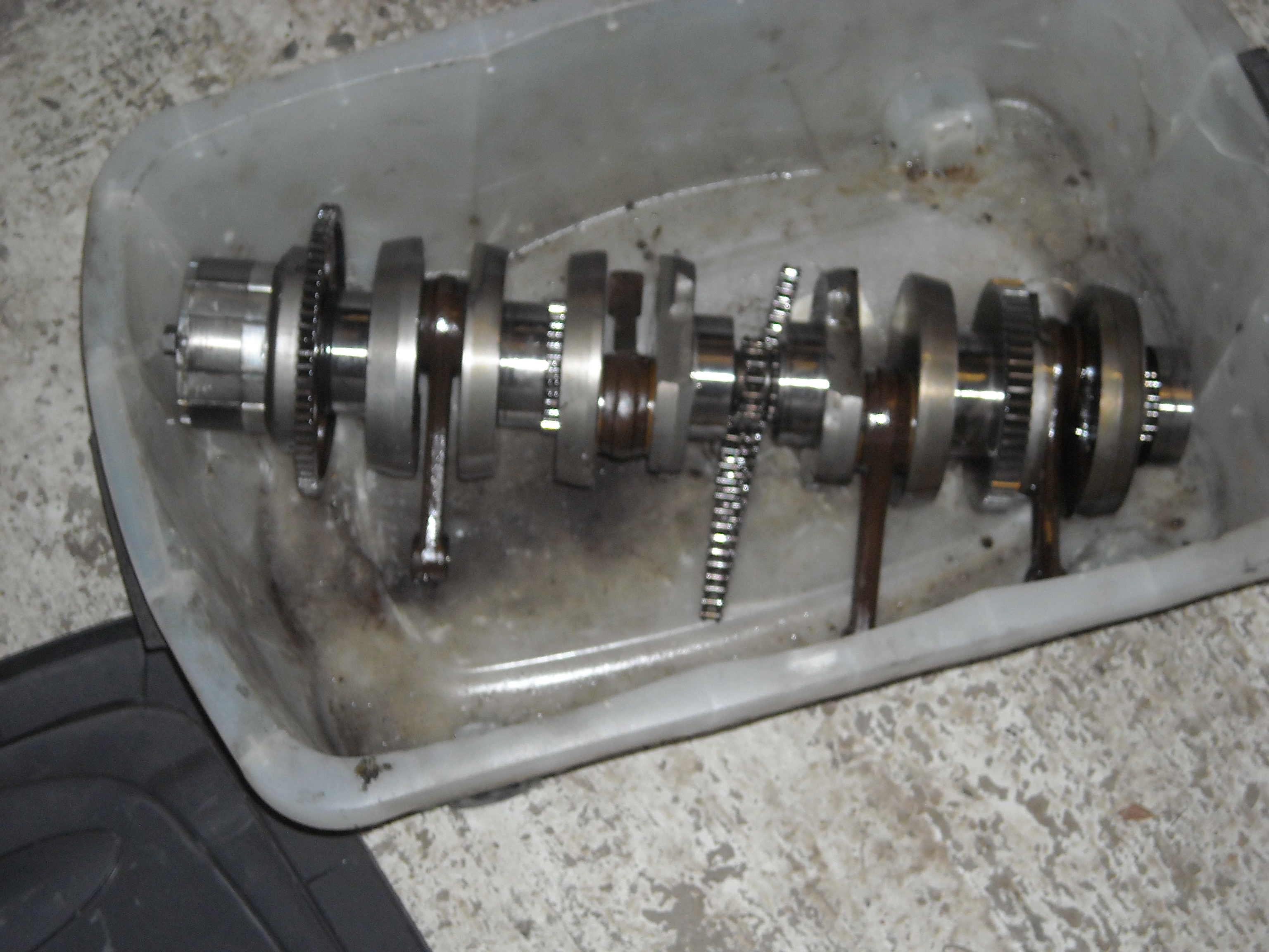

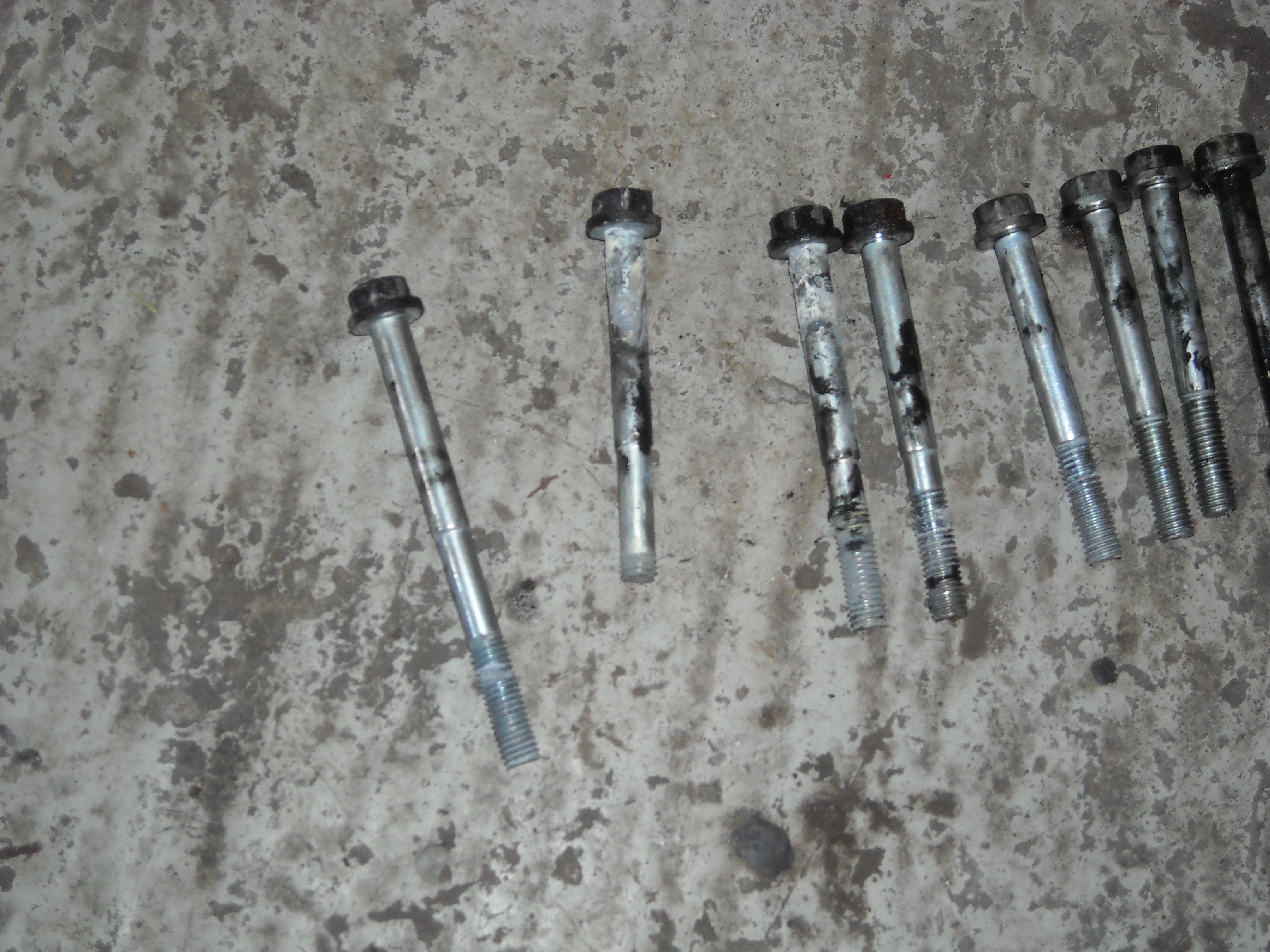

All the other covers came off easy and then it was time to split the cranckshaft case.
The small bolts came out without any problem but the larger bolts around the cranckshaft took more effort...and one of them broke off.
Let's hope I can get the remaining part out without causing damage to the upper cranckcase half. Time and patience will have to do the job.
The inside of the engine is very clean, the cranckshaft looks like new!
All these signs can only confirm that the engine didn't ran for more then 10.000 Km.
So just one problem to solve and then it's time for cleaning, cleaning, cleaning all the engine parts.

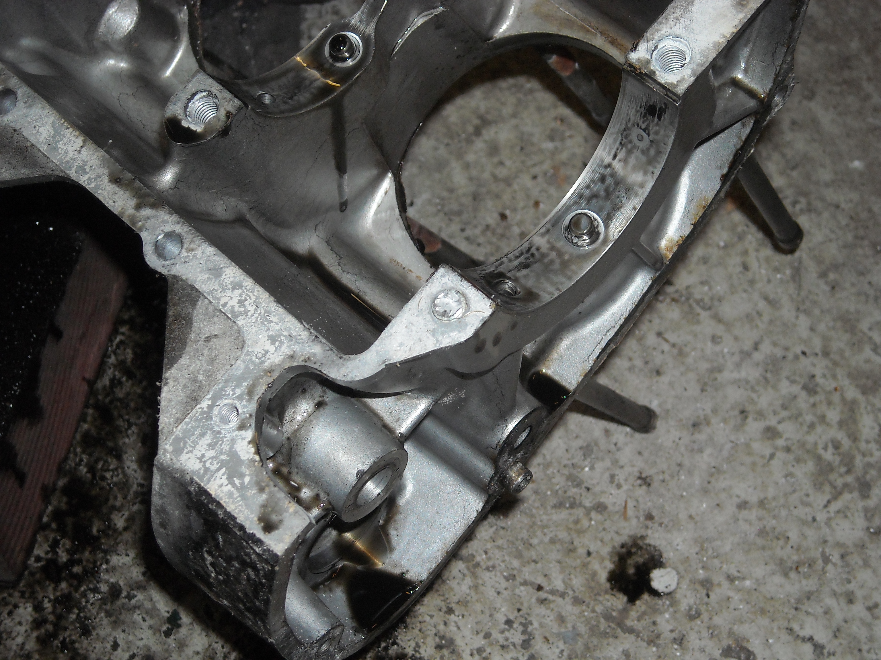

The sheered off bolt in the upper cranckase was removed by drilling it out and by replacing the damaged thread by an M8 helicoil.
the repaired thread

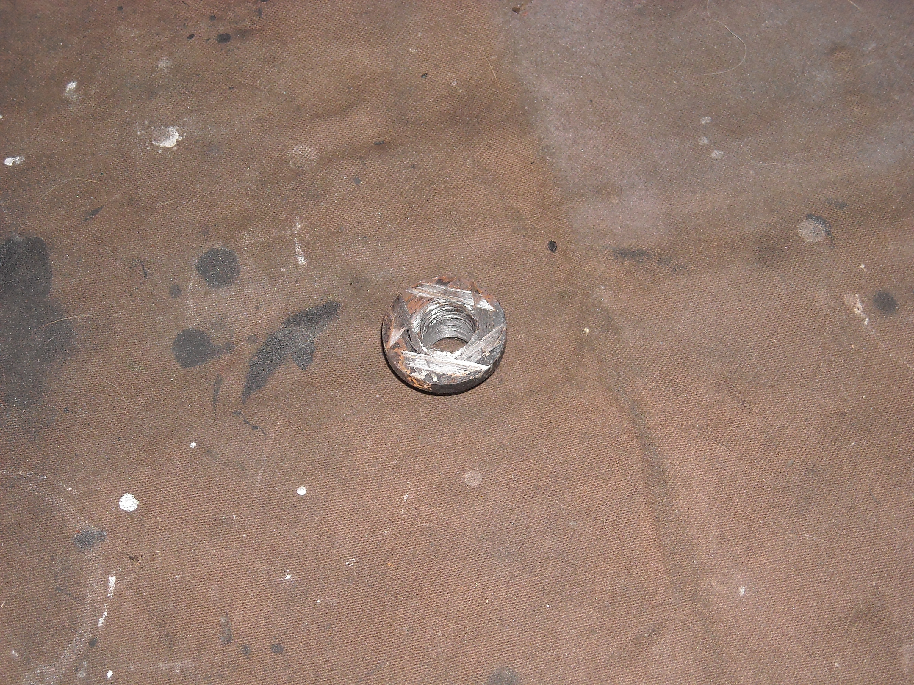

Then there was the oil drain bolt in the sump that I couldn't get out...it must have caused problems in the past because I couldn't fit a 17 mm socket wrench on it, there was too much damage.
Just remember that the advised torcque for the drain bolt is 3 Kg/m...
So I had to start thinking ...that hurts :rock
Plan A: reduce the diameter of the bolt so that I could use a 16mm socket on it...of no avail, it remained where it was.
Plan B: heat: I heated the bolt and tried to get it out by using the same 16 mm socket... no succes
Plan C: drilling a 13 mm hole in the bolt, thereby destroying it but it was lost anyway, screwing an extractor in it and use a tube as a lever:
Succes!
the oil drain bolt after removal

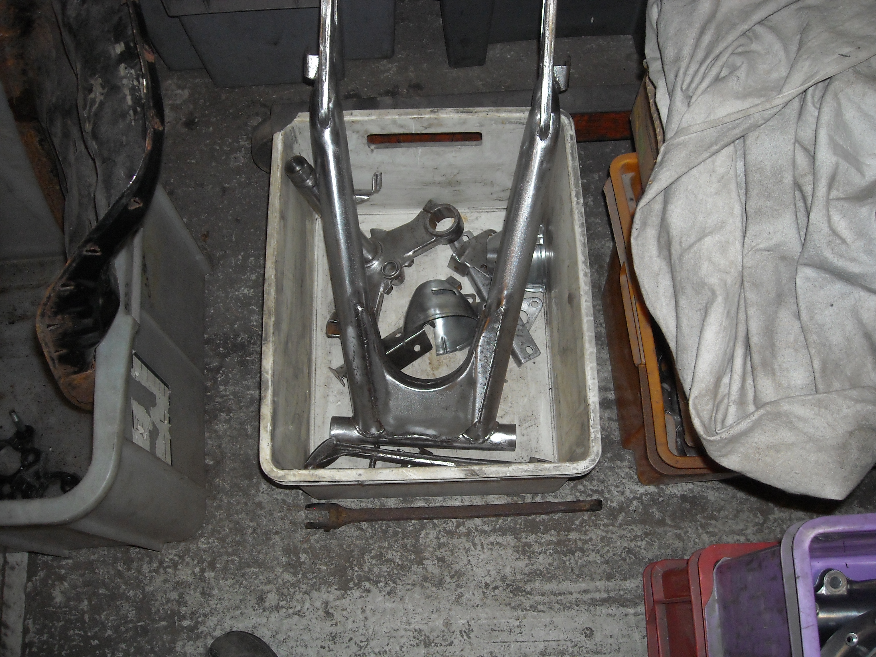

A lot of frame parts are cleaned, only two parts to go and the paintwork can begin.
The parts which need a matt black coat are painted
the painted brake parts

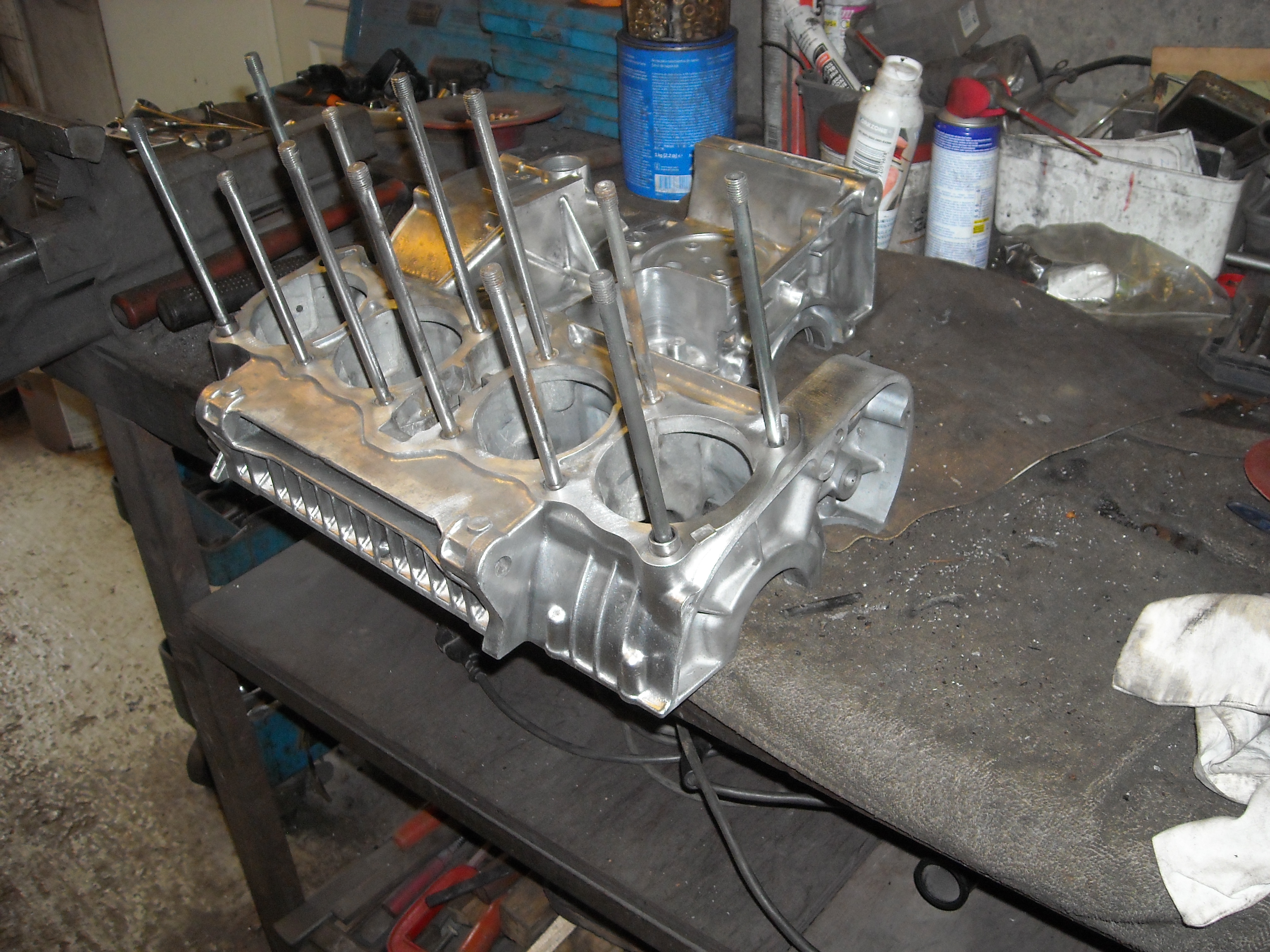

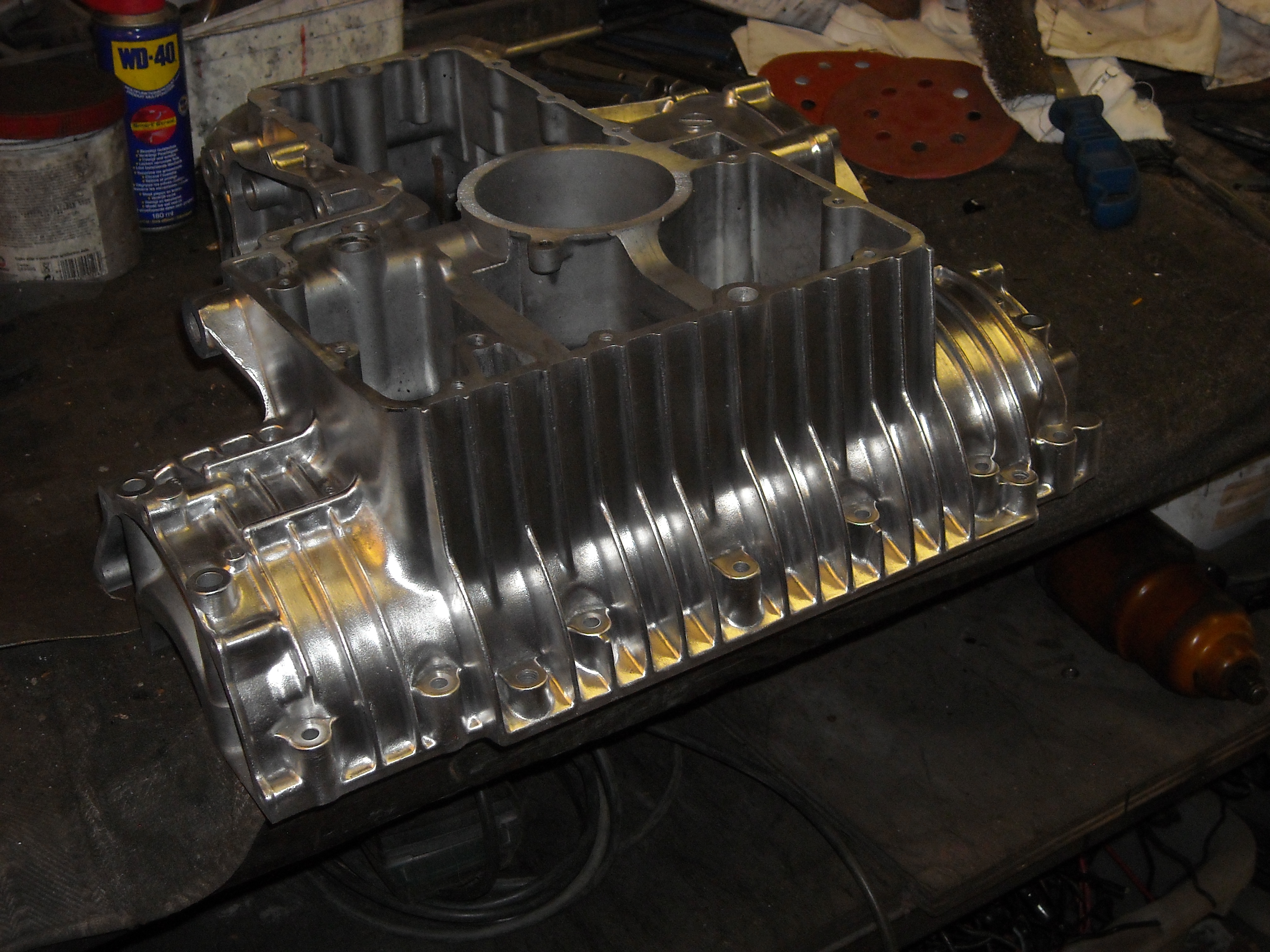

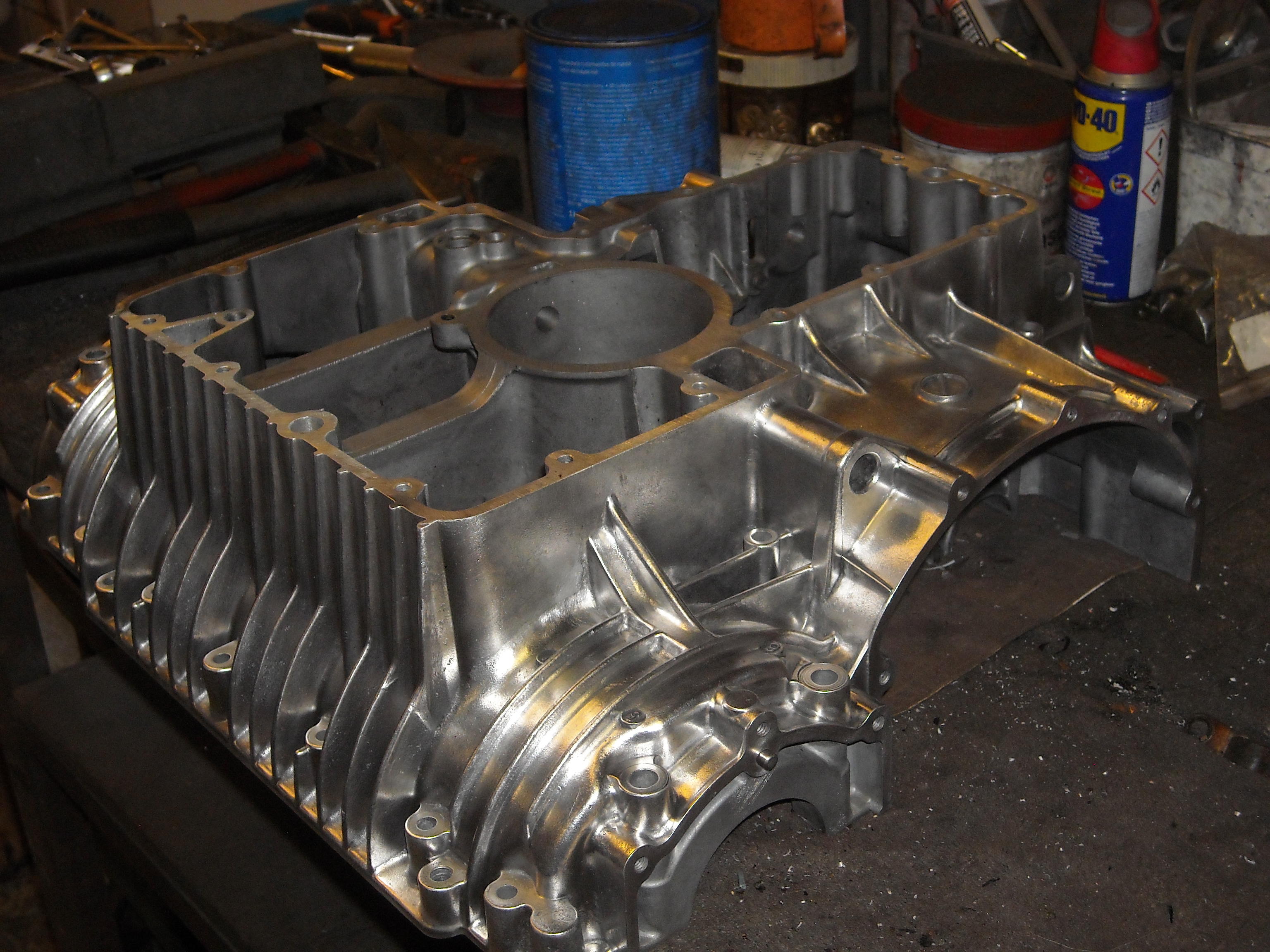

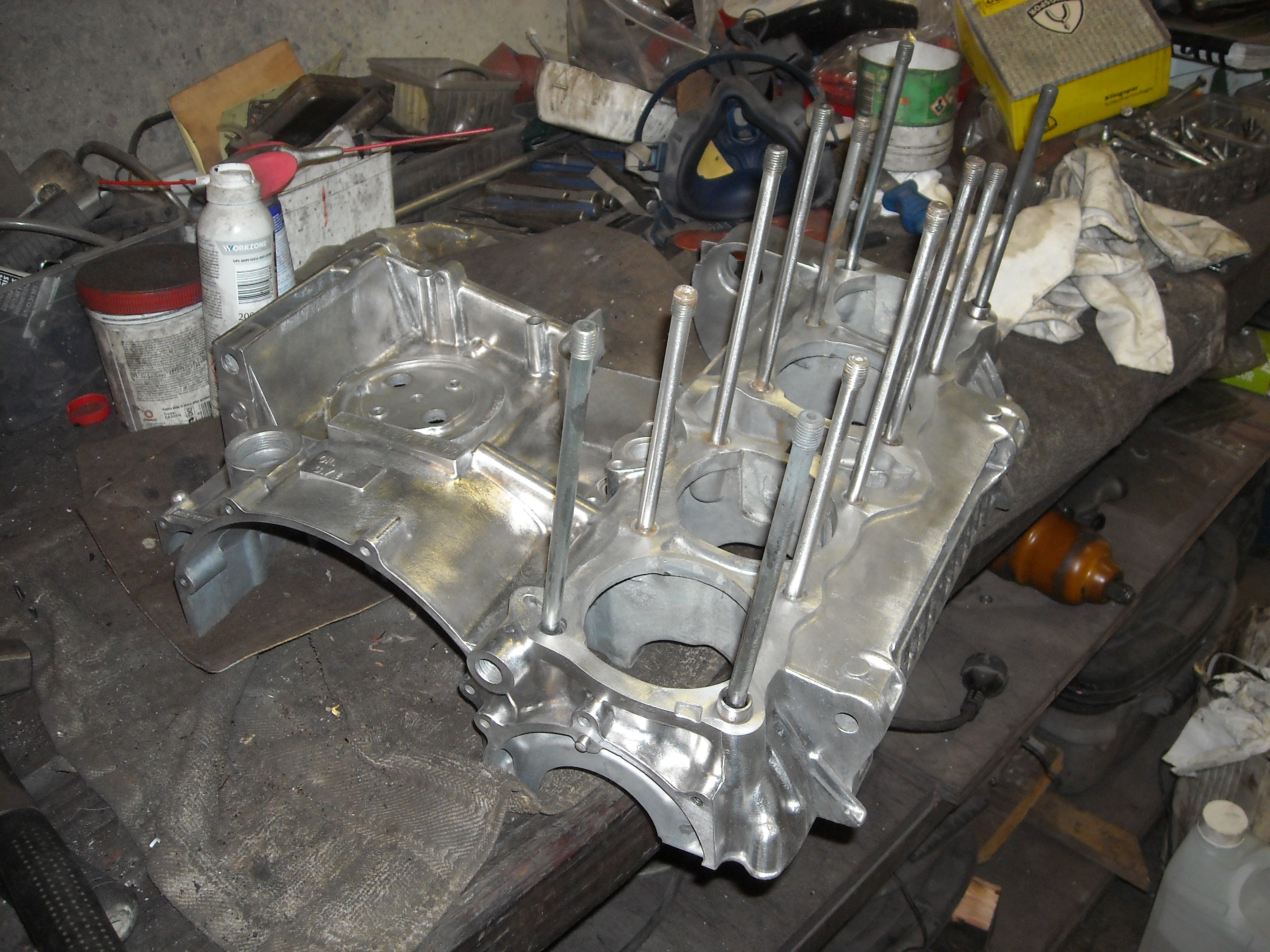

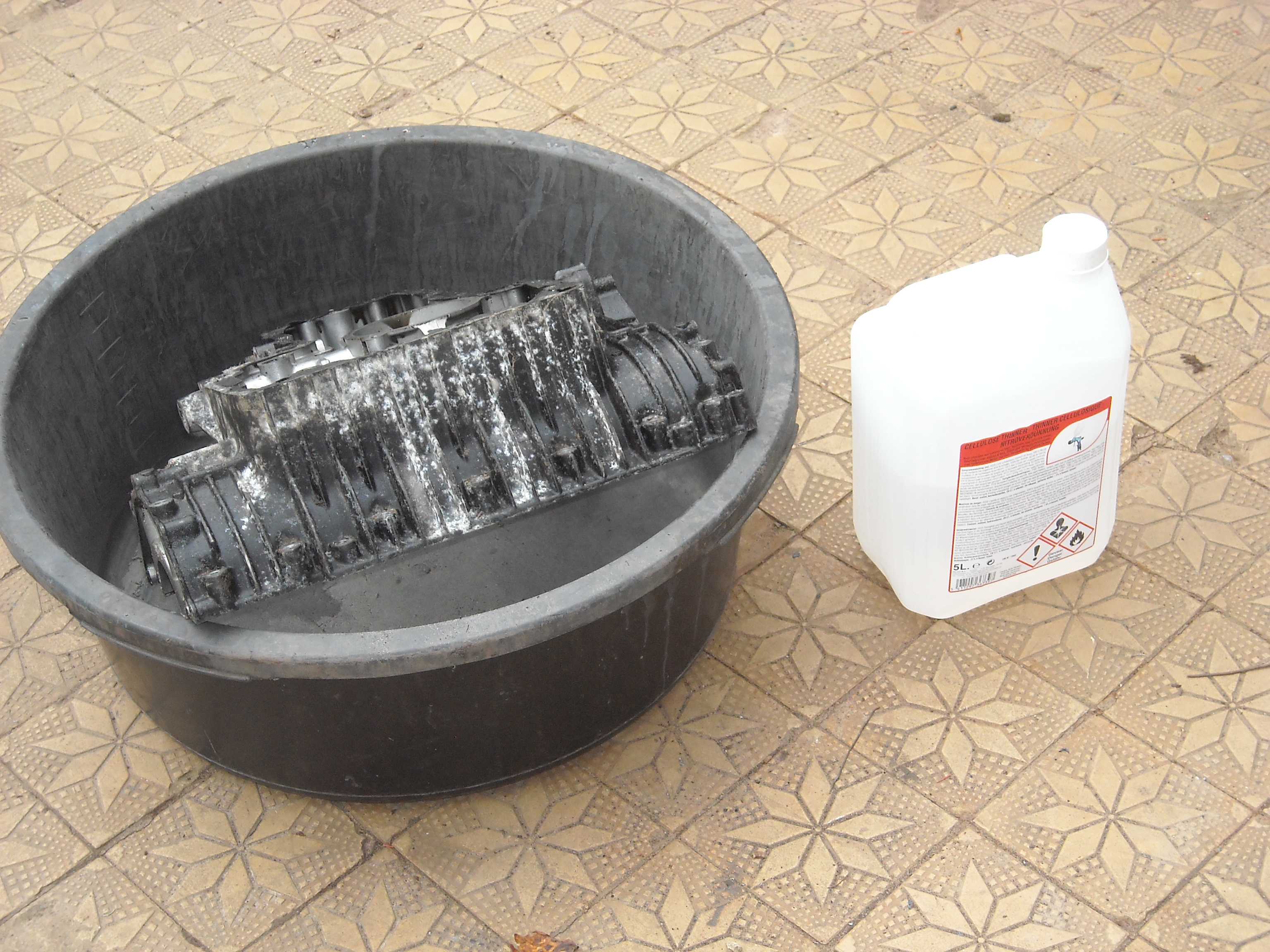

I've started with the cleaning of the engine...the lower cranckcase was done first:
before
as you can see I'm using a masons tub to clean the lower cranckcase with cellulose thinner.
The black paint came off rather easy thereby showing the heavily oxidized alloy.
After a few hours of using the nylon brushes on the drill, this was the result:
The upper cranckcase is also cleaned but that took me a bit more time.

That lower crankcase half looks stunning and I need to know which brushes you use to get that finish.
Any chance you could send me a link so that I can order some?

Yes that finish looks great although I suppose with the cases loose it makes accessing the nooks and crannies easier!
I have used scotchpads for this job with a bit of ally cleaner but it is time consuming and for me not great results.

As you can see at the beginning of this topic I use a lot of different brushes.
I buy them at a local hardware store and I can give you the name of the manufacturor of the red nylon brushes: it's ROTEC, a dutch company.
I have no link for that manufacturor, perhaps you can "google" it.
The metal brushes were bought at another store and are of different shapes. They have thick or thin metal wires and have a diameter of 8 mm. The thick wires are stiffer and are good to remove paint. The thin wires are good to remove oxidation.
Keep in mind that it takes several hours to clean a cranckcase half. The barrels and cylinderhead take almost a day to clean them!
For the final touch I use some sort of rubber brushes made by 3M. They come in three colours yellow, white and brown, depending on what kind of finish you want. I start with the white one and proceed with the brown. They cost 32 Euro a piece, so they're not cheap!
I hope you can find them in the UK because some people in the EU don't ship to the UK (customs forms etc).
And yes, it's a lot easier to clean them when they're apart, it's feasable to clean them when the engine is in one piece but almost impossible when the engine is in the frame.
Good luck to both of you!

The upper cranckcase is almost clean and the studs are almost ready to be painted, just a little more rust to remove.

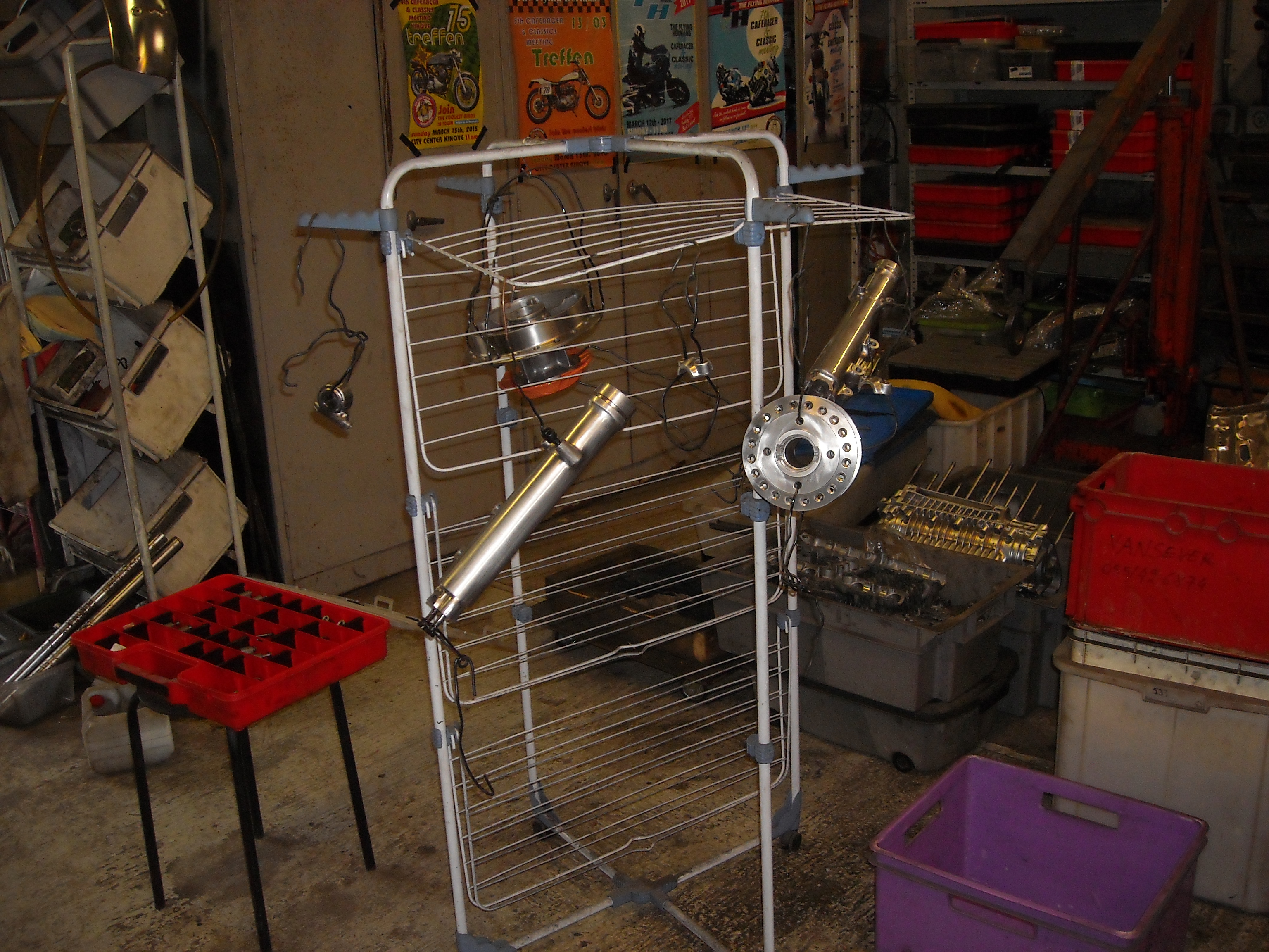

The alloy frame parts (forks,hubs) were degreased and received a clear coat. Within a few days the clear coat can be baked in the oven and when the spokes and nipples arrive, I'll be able to assemble the wheels.
the alloy frame parts

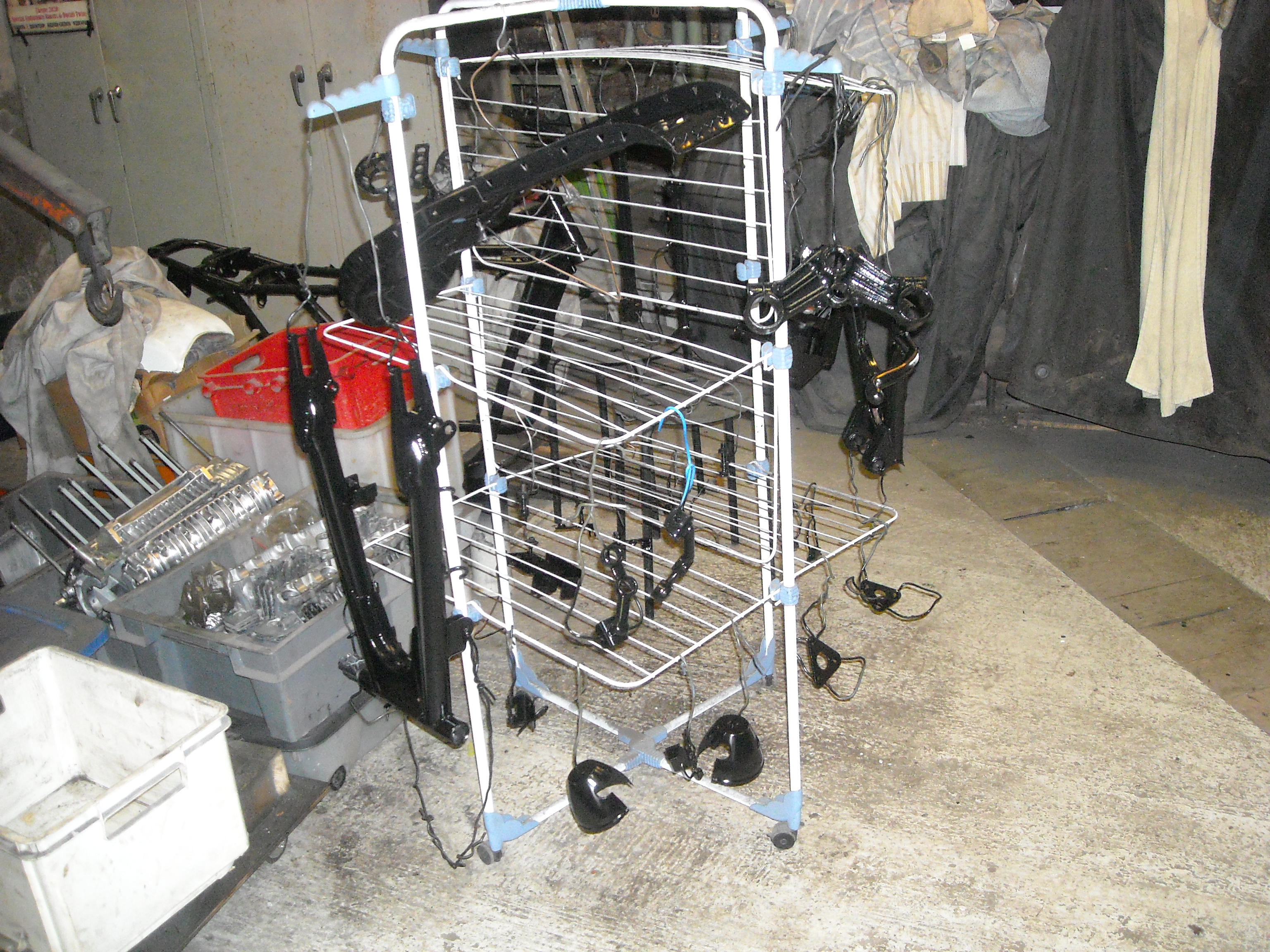

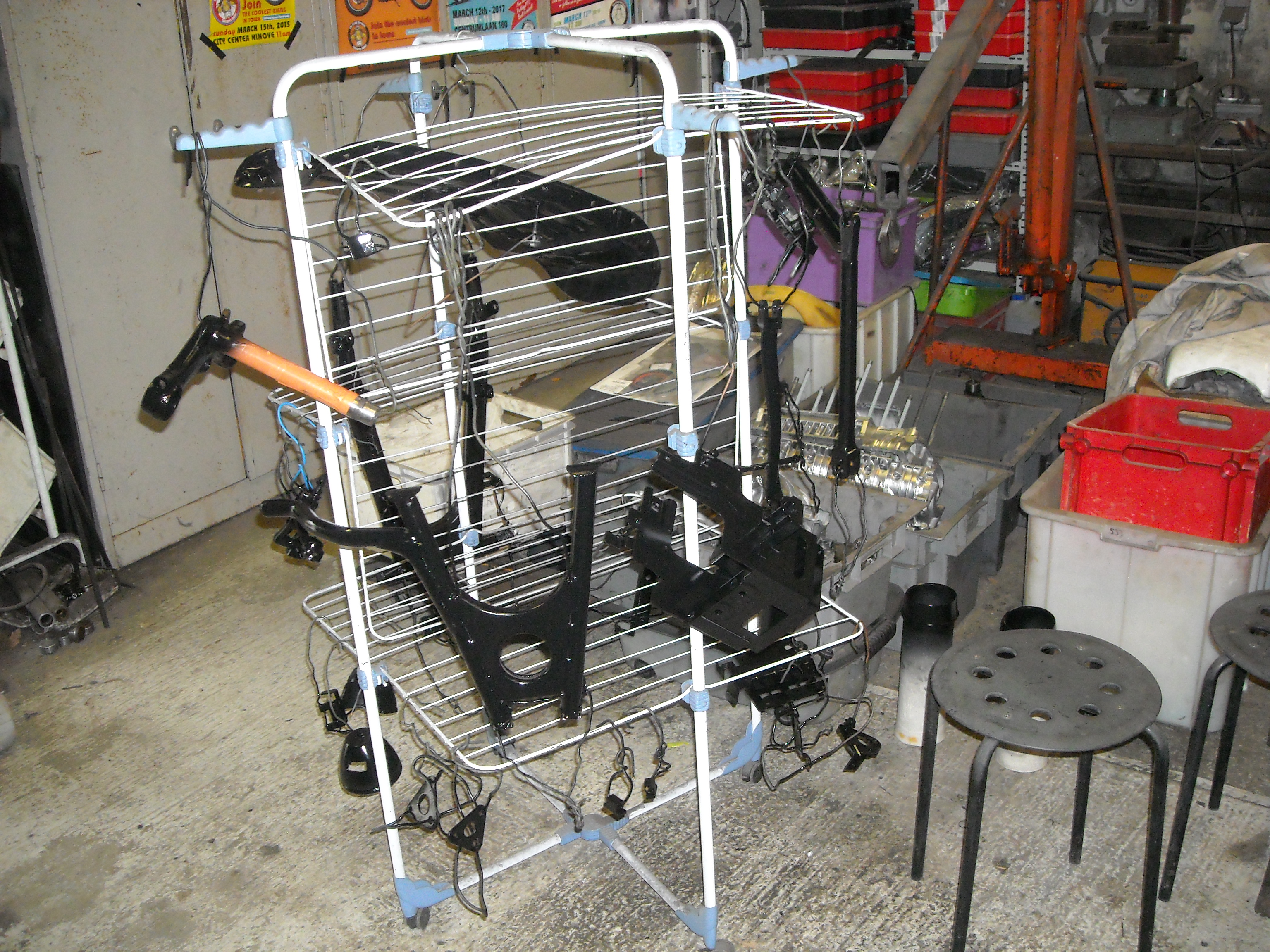

the frame parts are painted! The assembly can begin !
This morning I managed to get the rest of the frame parts clean: the battery box, the electrics plate and the front footrest hangers.
All the parts got electric wires or welding rods in order to hang them to dry. They were all degreased using aceton and the lower headstock was taped off, the swingarm needle bearings were protected with paper.
After they dried I started the painting.
It took me about 1,5 hour to paint them and I used as much paint on the frame parts as I used on the frame itself.
Tomorrow they'll be dry and the assembly can start.

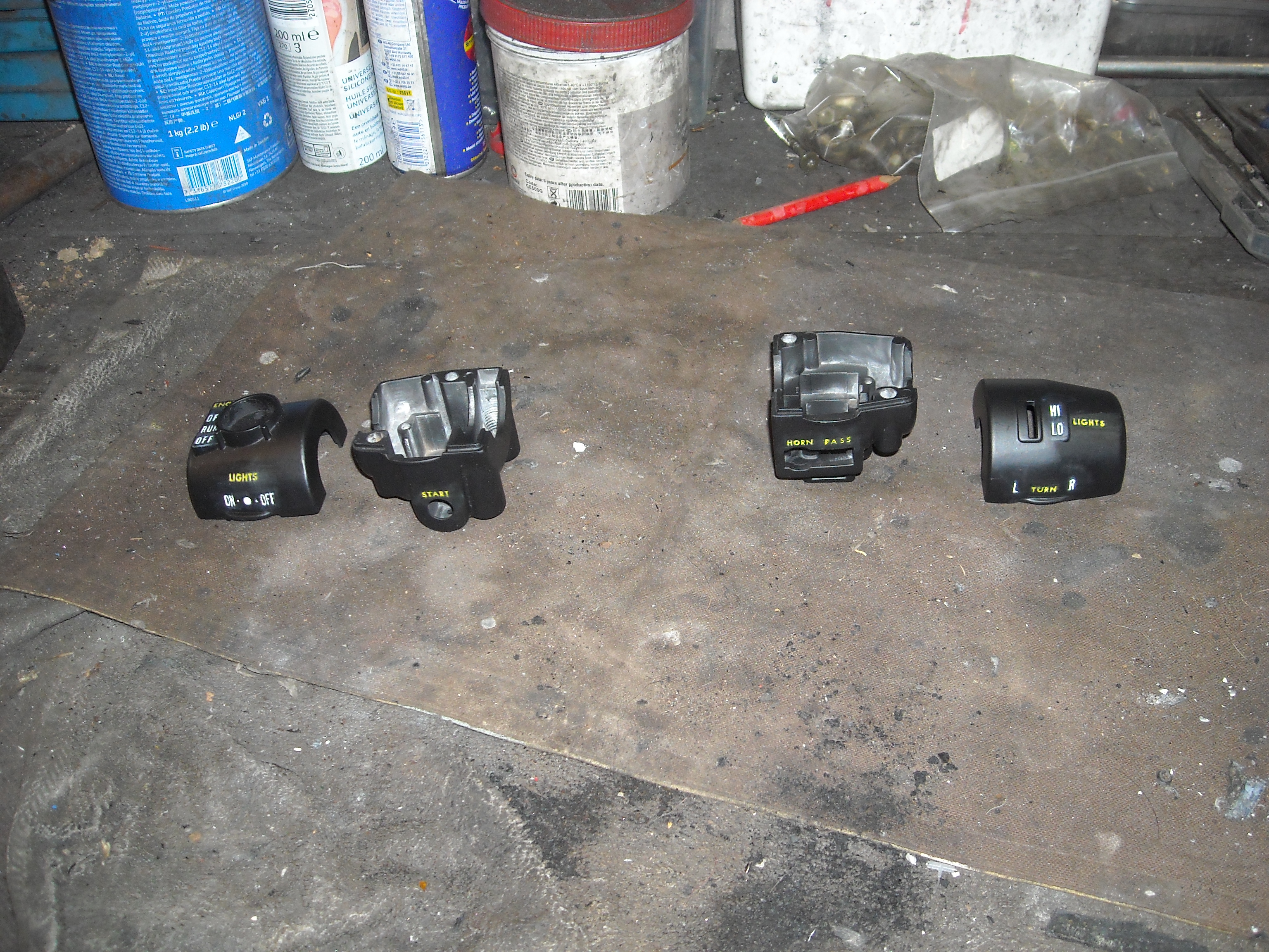

The cases of the handlebar switches received the white and yellow lettering and those are also ready to be assembled.
