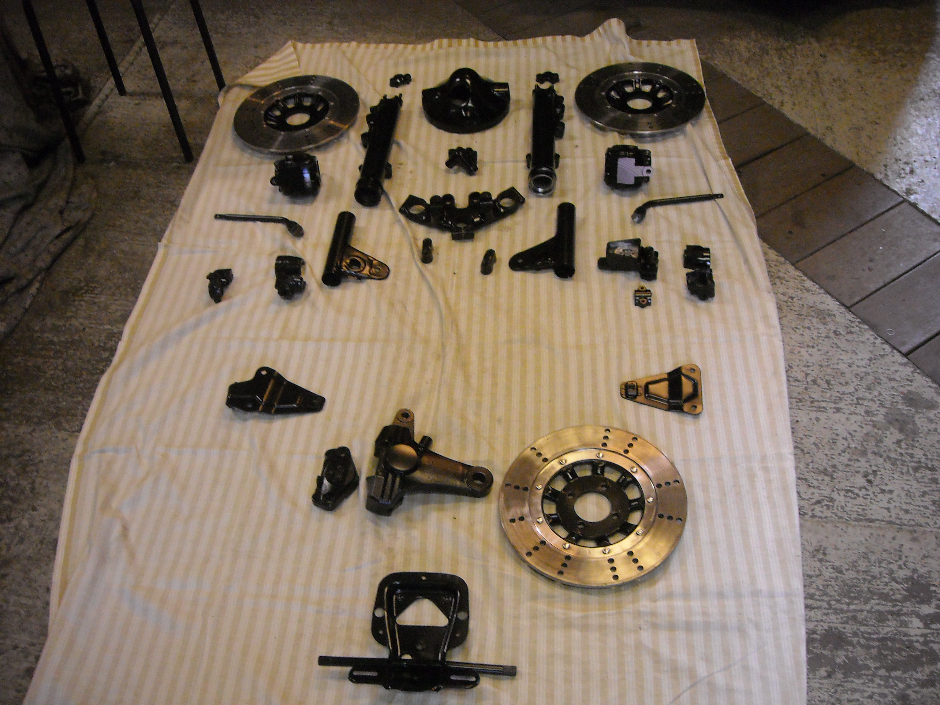

the previous time I mentioned the other frame parts which needed a less shiny gloss.
They're all painted.
It took me again some time to strip all the old paint but I managed it.
This is the result:
As you can see, again a lot of parts.
Every time again I wonder how many parts there are on a bike and how much space they need to store them.
It's like a big three dimensional puzzle, they all fit together and then they don't take that much space anymore.

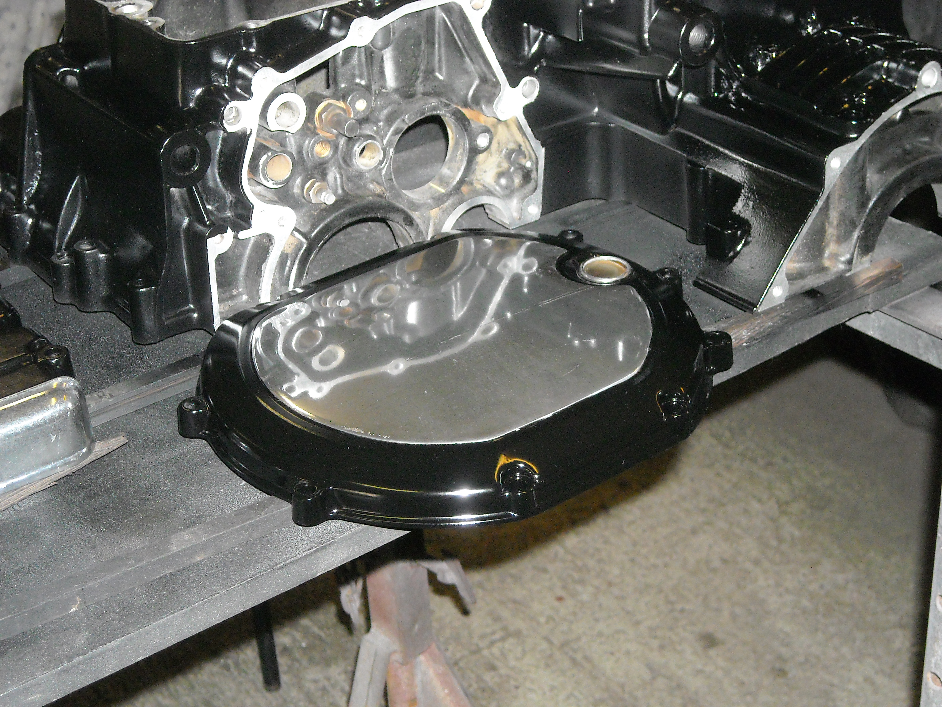

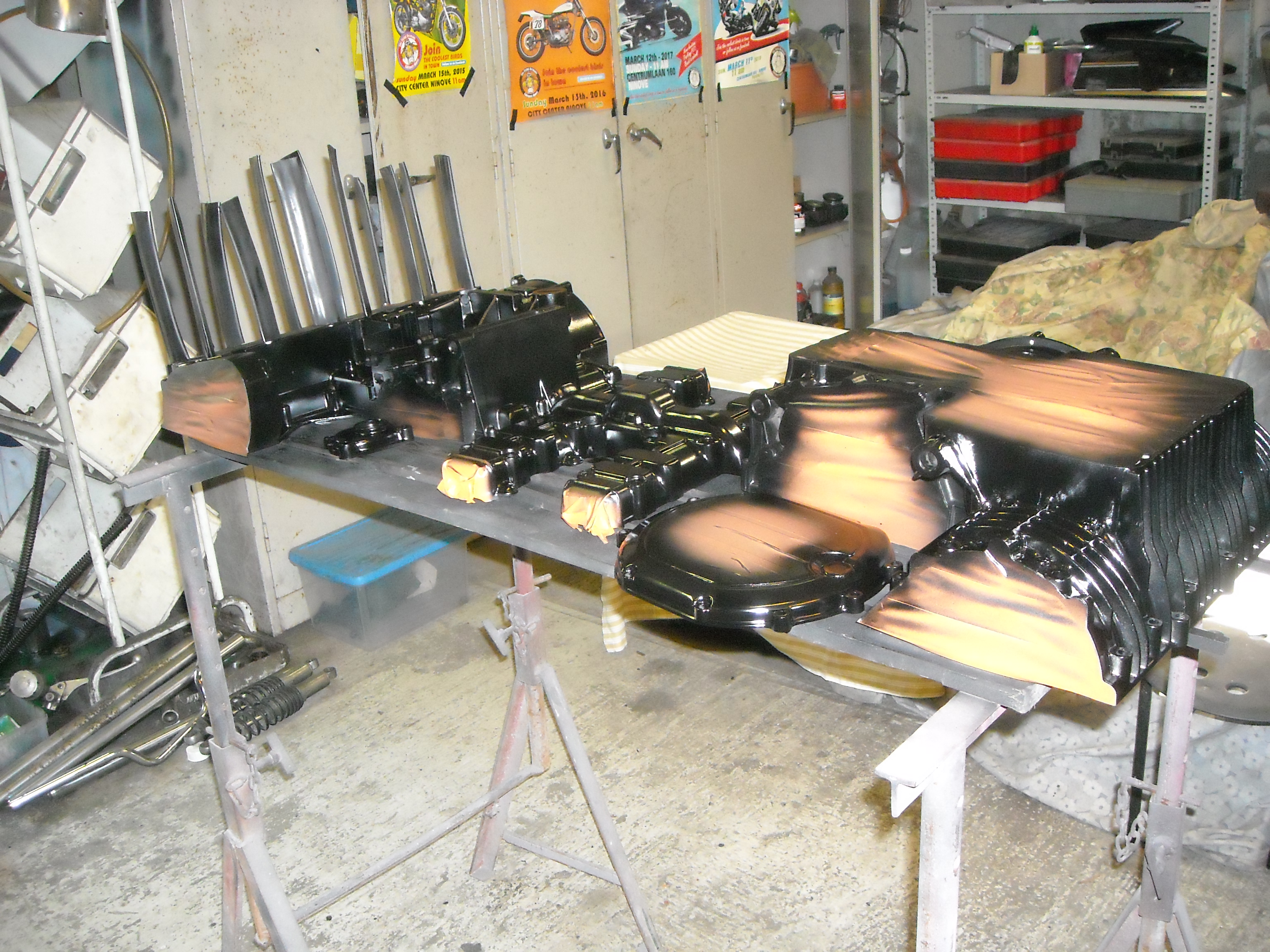

After the frame parts I started on the engine.

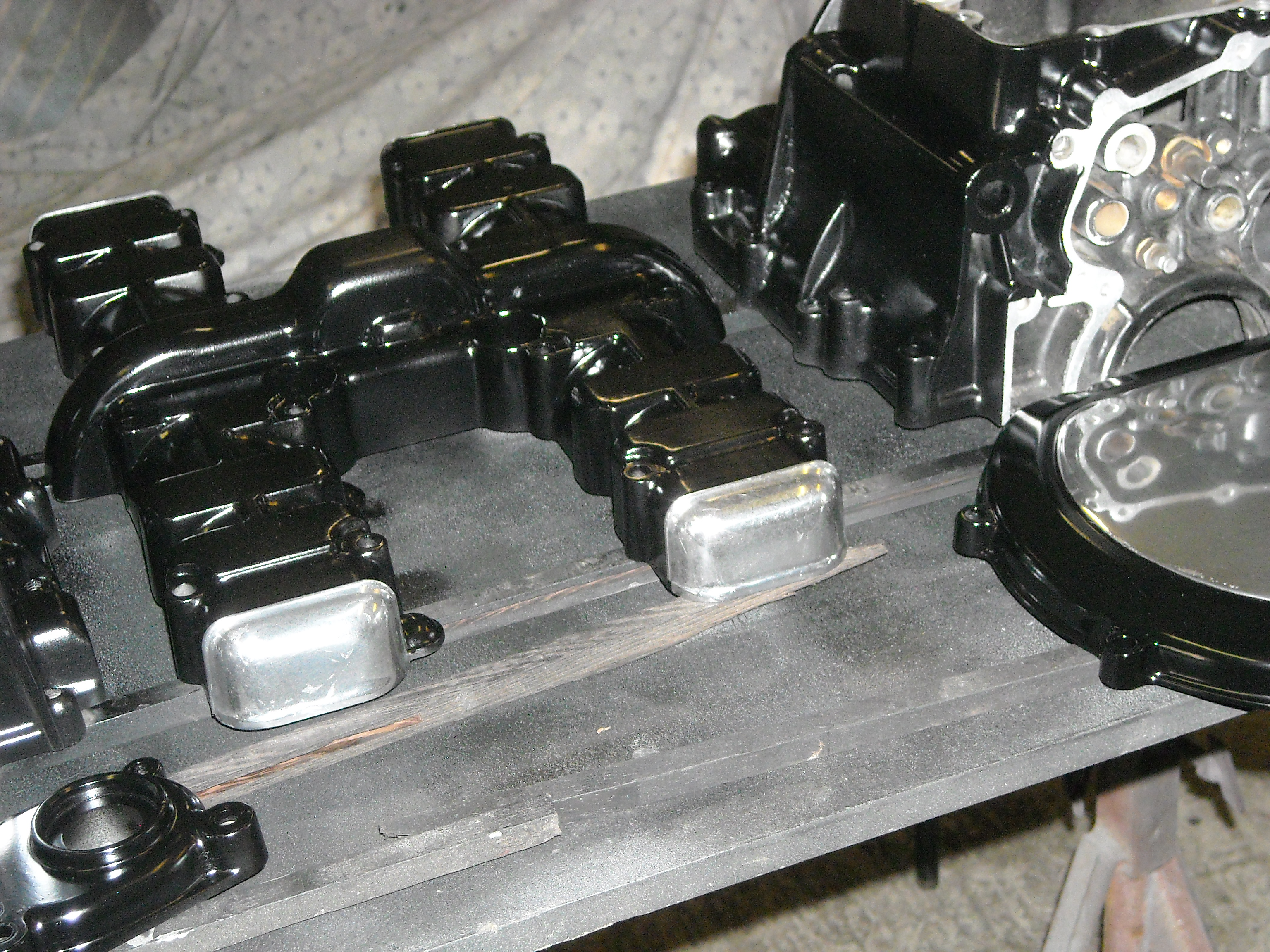

The cranckcases were degreased, stripped, degreased again and taped off.
They received a coat of satin black "Restom" paint.
The contrast of the black paint and the polished aluminium is beautiful!

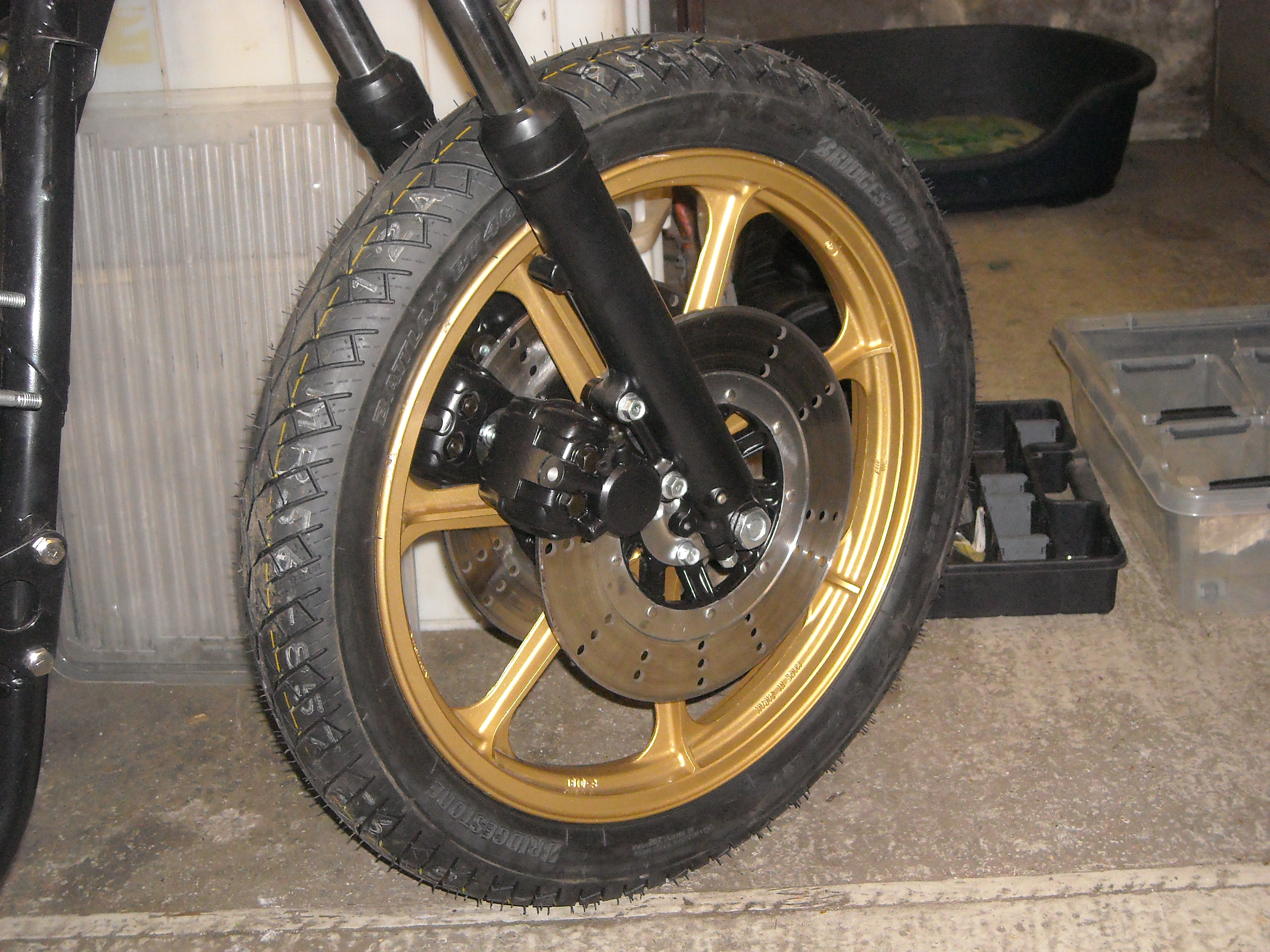

In the mean time the new tyres arrived, Bridgestone BT 46 Battlax.
I mounted them on the wheels .

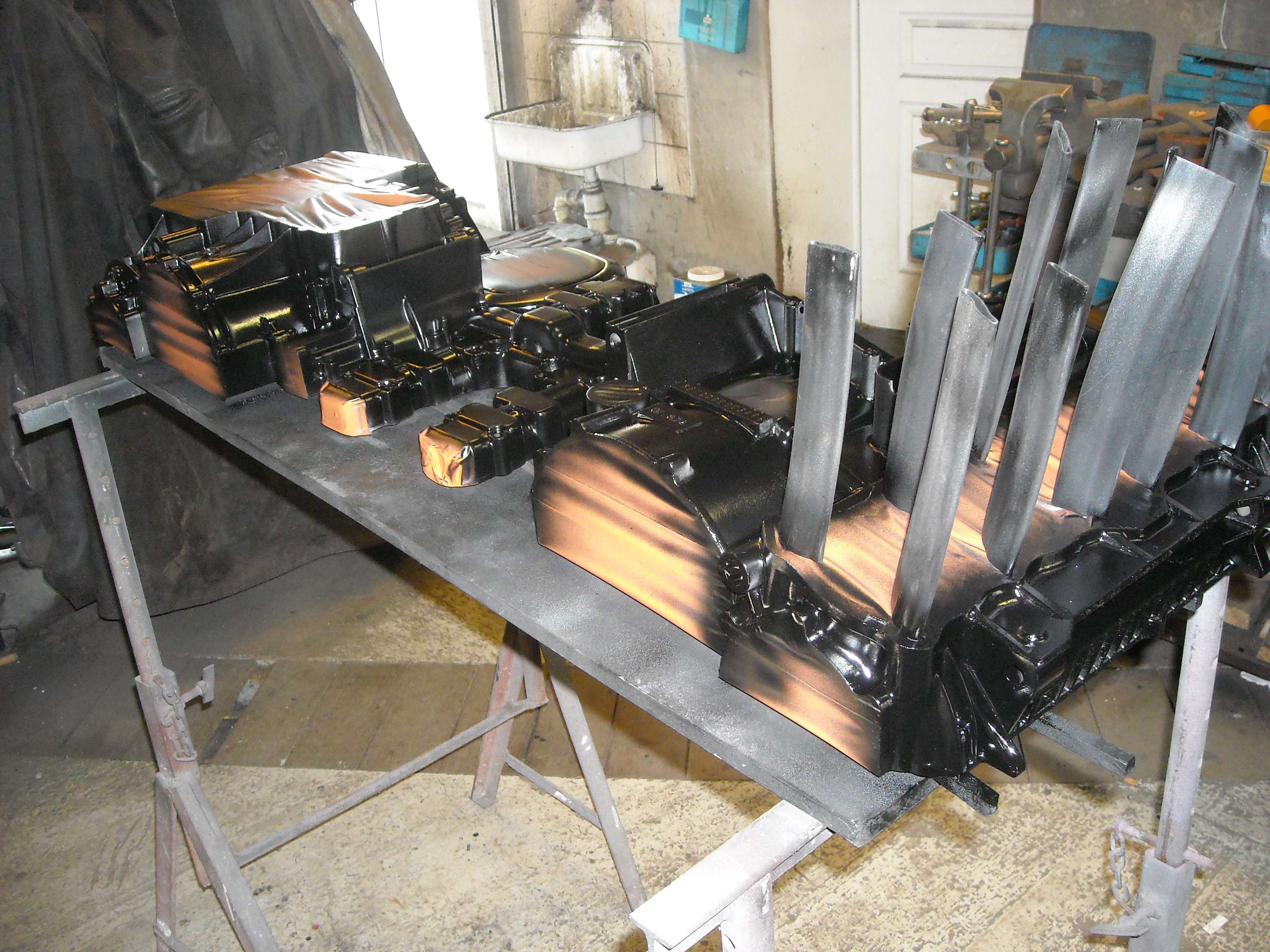

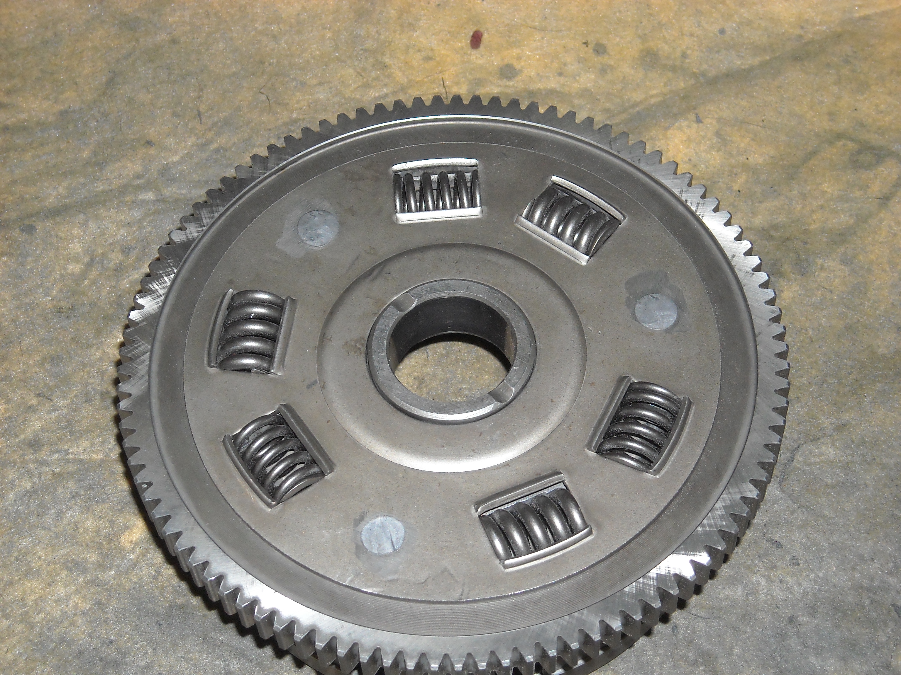

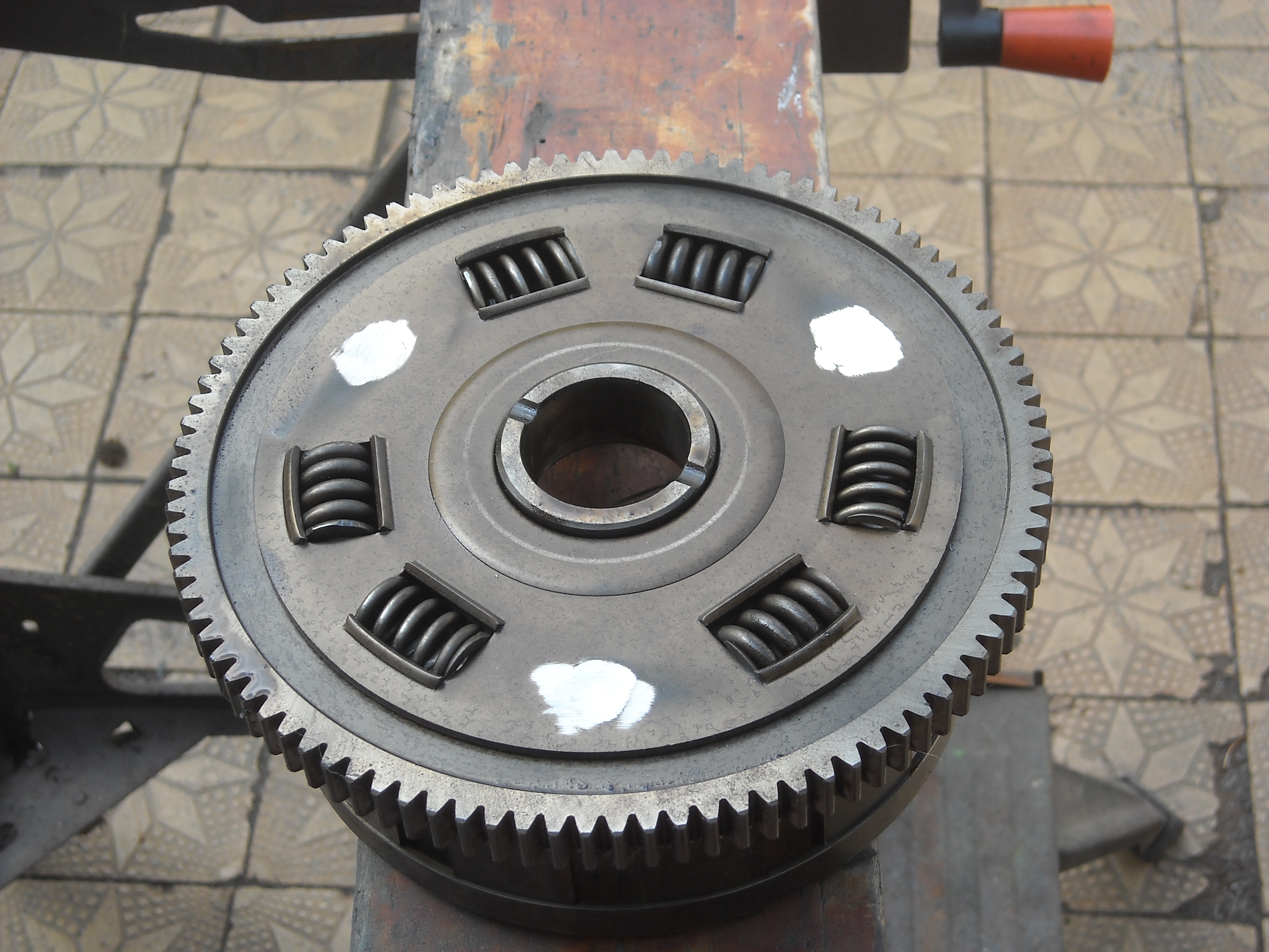

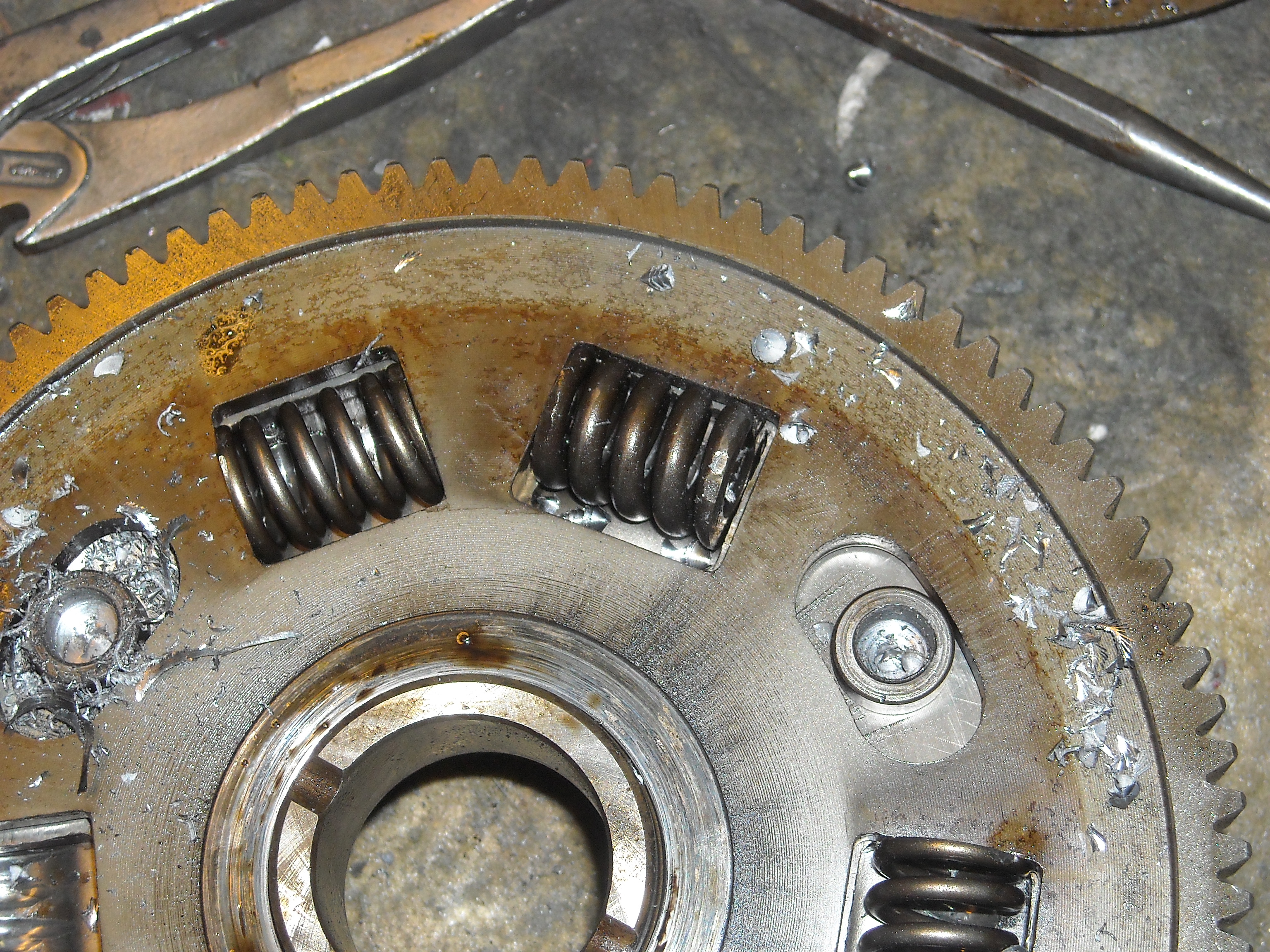

When I dismantled the engine a few weeks ago, I noticed that the clutch basket needed repair.
The springs were loose and one of them was broken.
In the past I already ordered some repaired clutch baskets and so I had a few old spare baskets which needed repair before they could be used again.
I decided to order a repair set and to do the job myself.
Pieter Laterveer, a very good mechanic from Holland gave me advice by sending me some videos of how to do it.
So I decided to give it a go after seeing the videos.

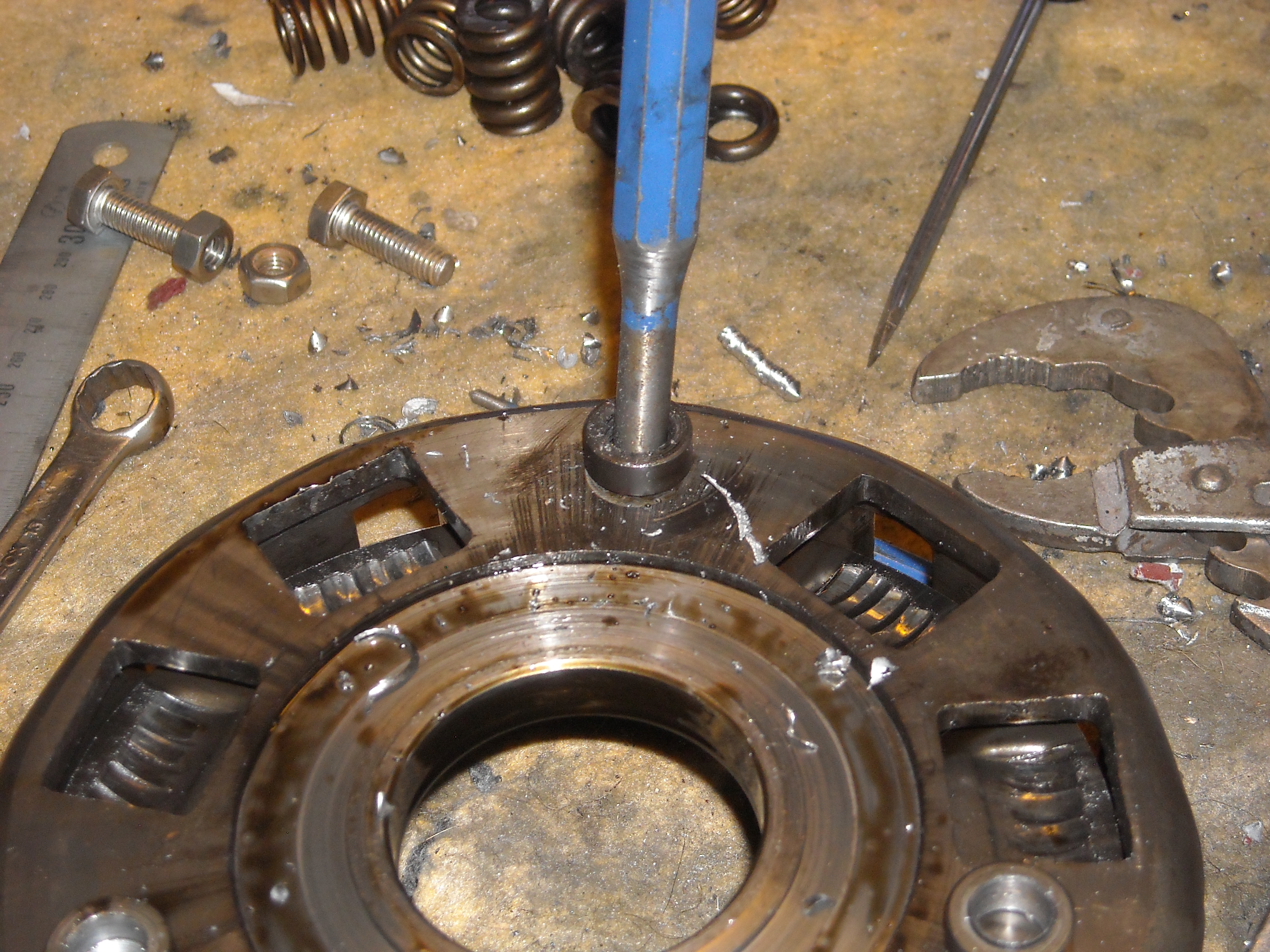

I started by grinding the 3 rivets away.
After that the rivets were drilled out with a drill of 9.5 mm
Don't drill them completely away, leave a bit of metal so you can punch them out.
When the rivets are out you have a lot of parts. Make sure you mount them back in the right order!

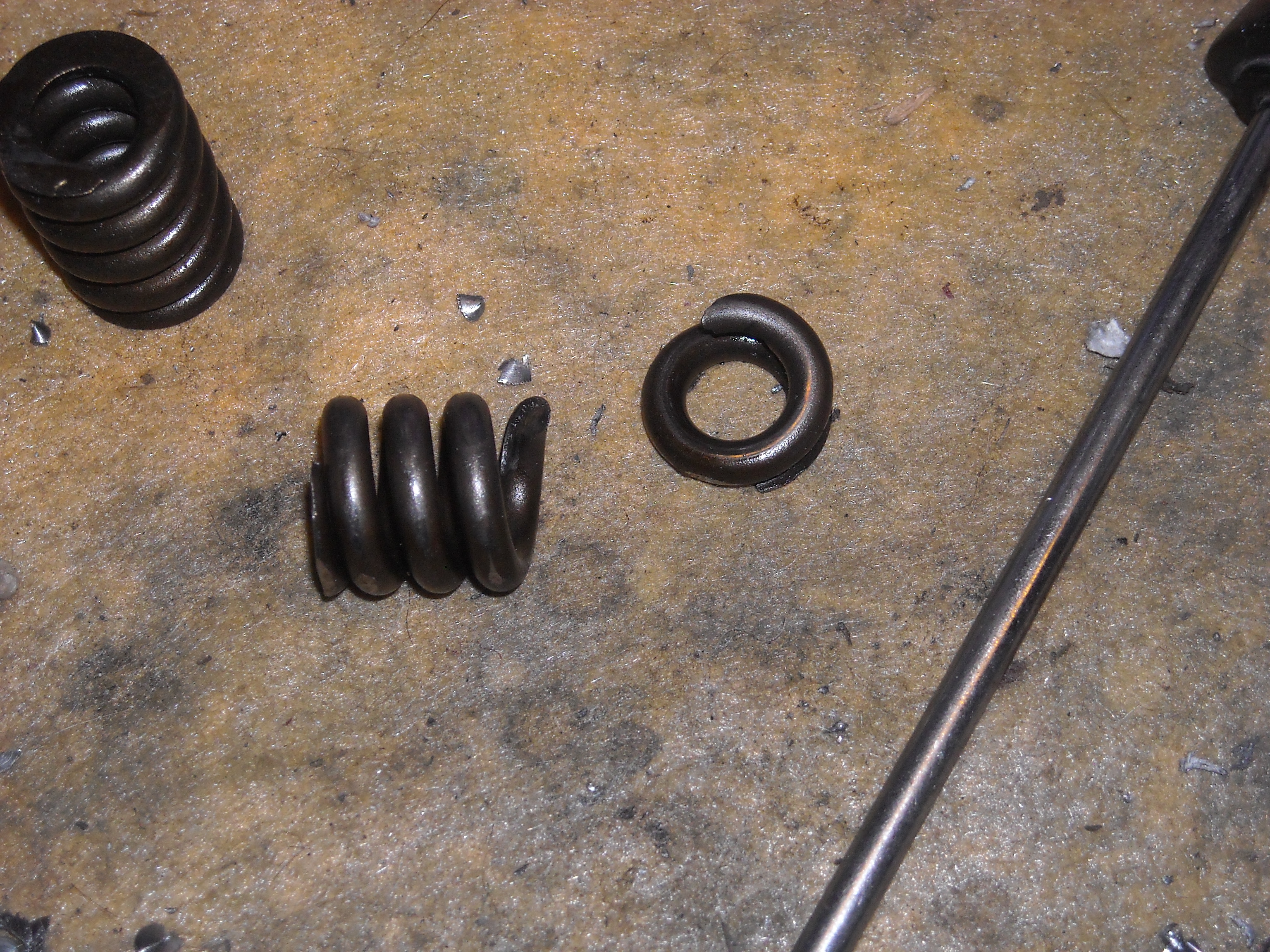

The old springs came out and yes, one of them was broken
When putting the new springs in, make sure you use one thick and one thin spring at a time between each rivet
The thick spring goes into the rectangular hole of the inner disc so it has a bit of space compared to the clutch basket.

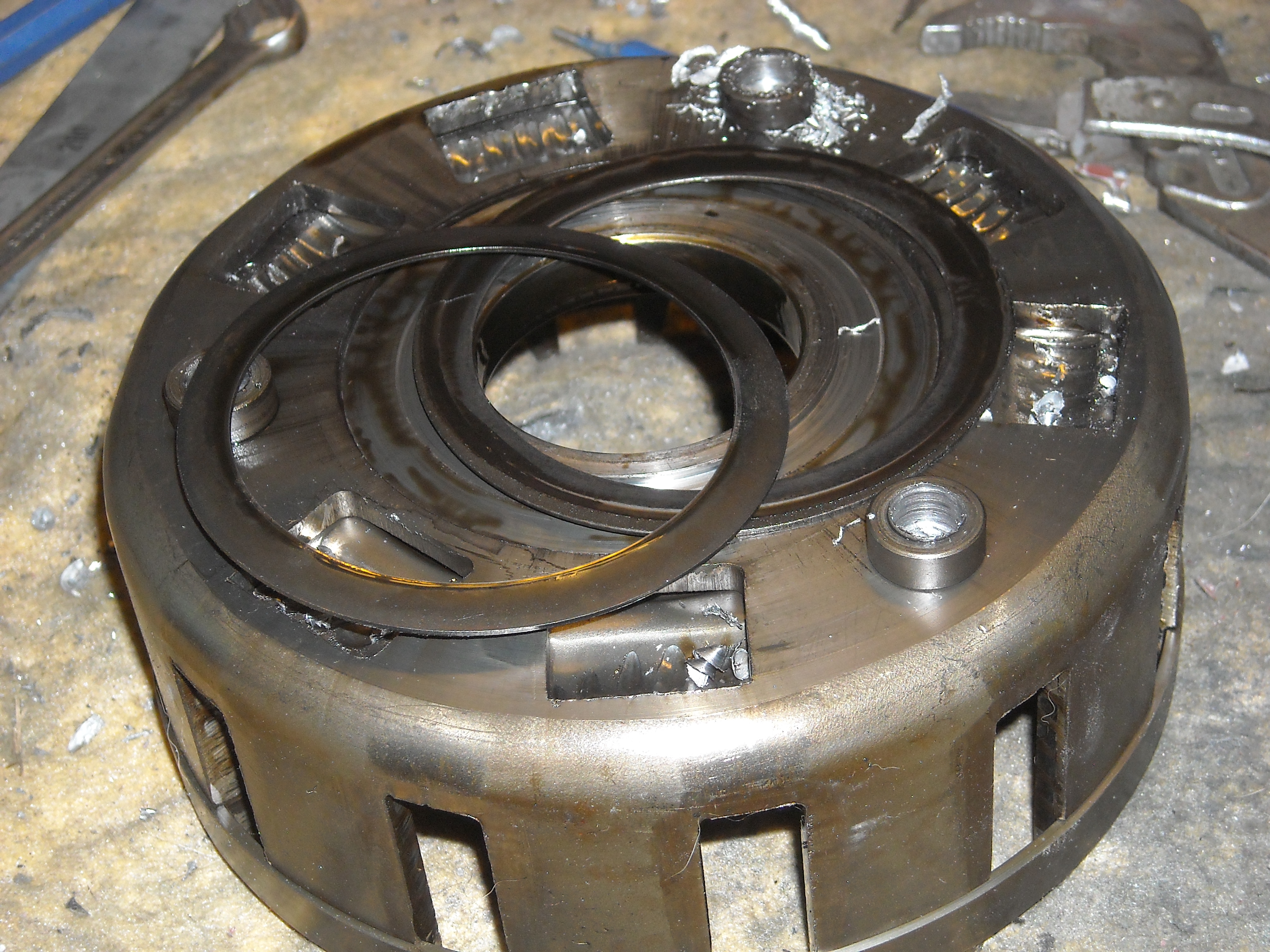

I used two M8 bolts and nuts to keep the different parts of the clutch together and slided a rivet in the third hole.
After the first rivet was fastened, one bolt was removed and the second rivet was fastened, after the third rivet this was the result:

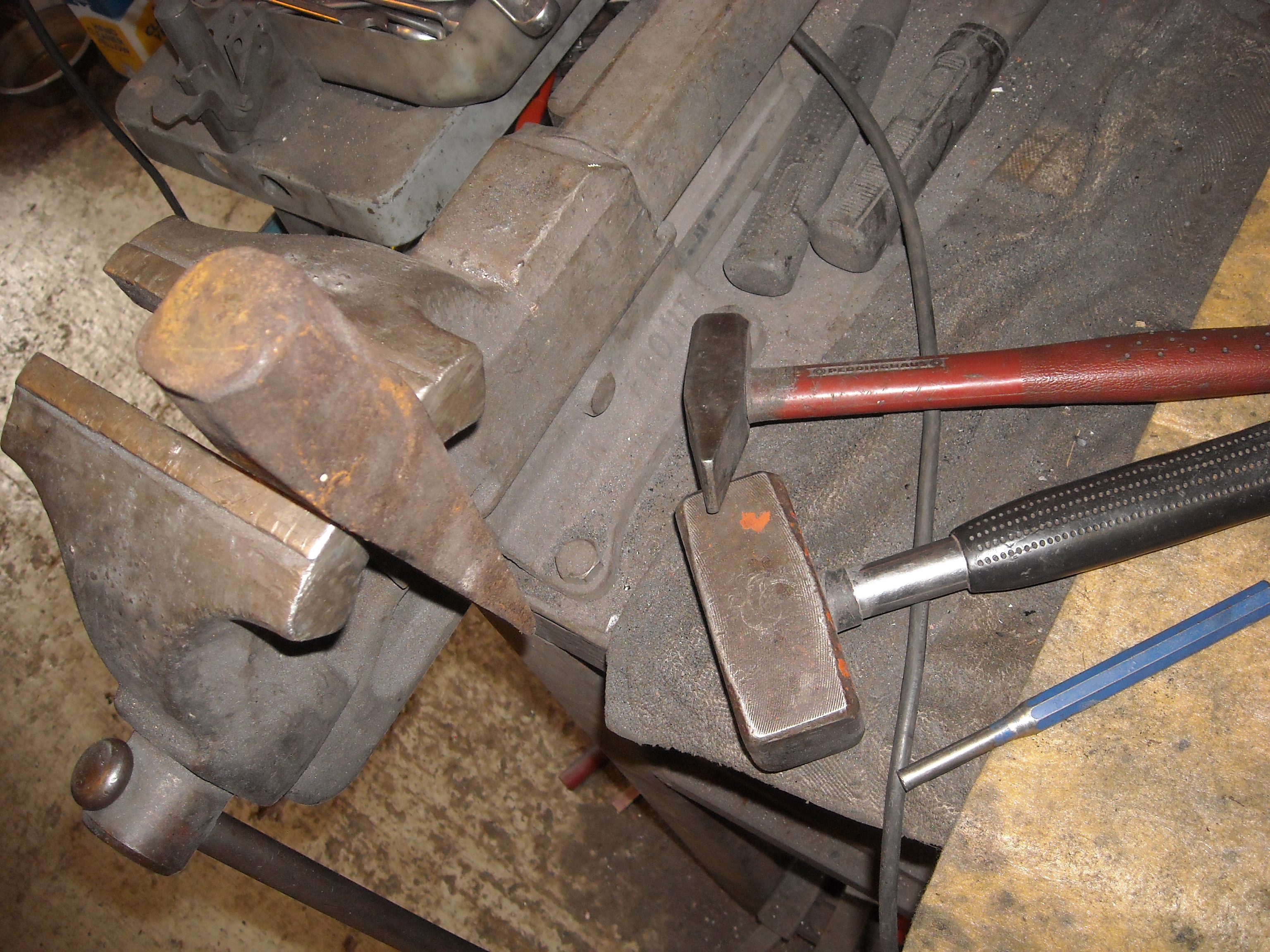

These are the tools I used to tighten the rivets
The rivet heads need a support when you want to fasten them, I used a steel wedge in a bankscrew.
When I mounted the clutch basket on the axle I used a new needle bearing, it would be unwise not to do that .
So this one is ready to be used again (I hope so...
More news to come soon!

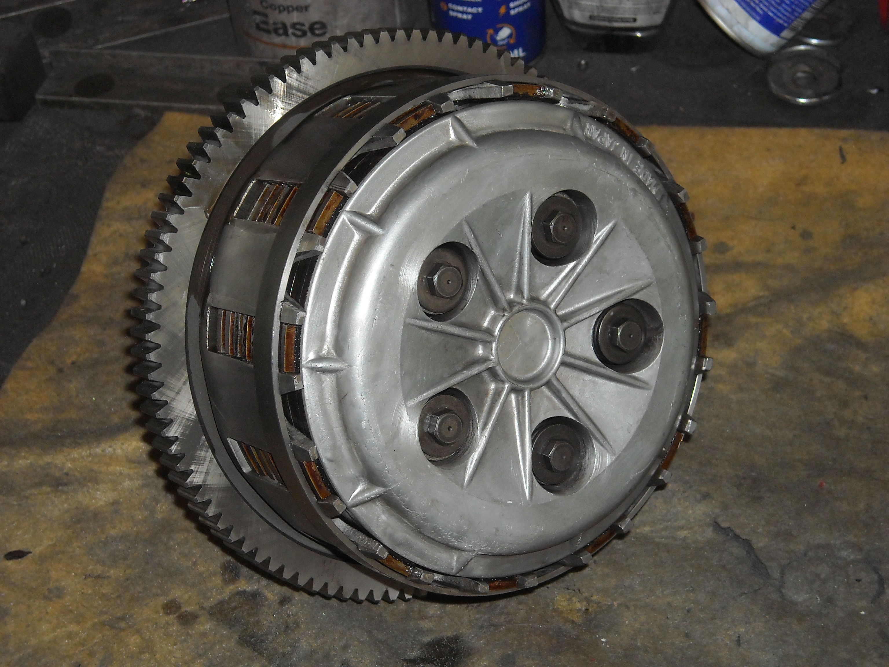

I had lots of fun the past few days.

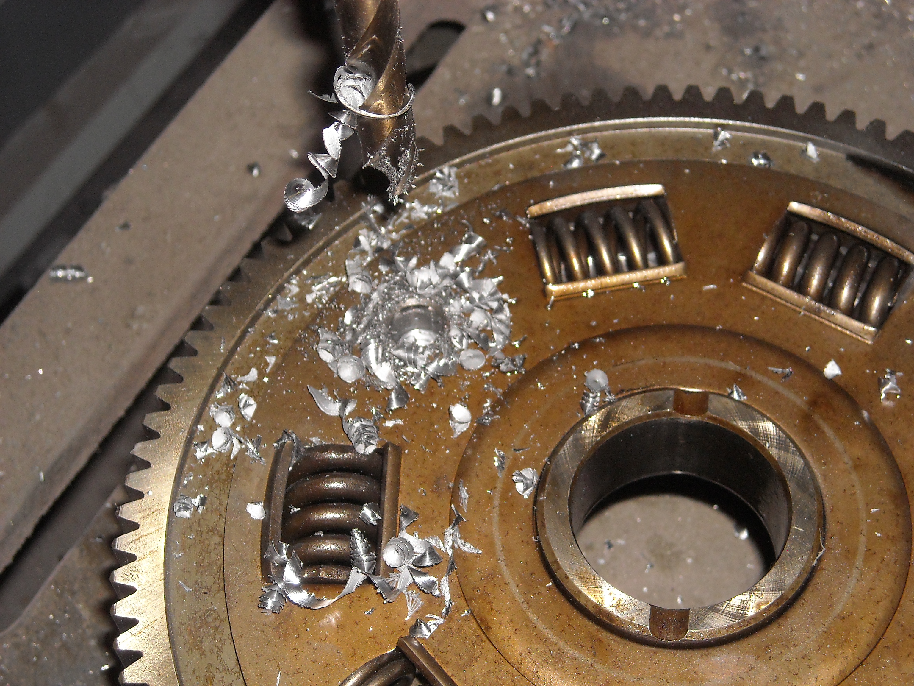

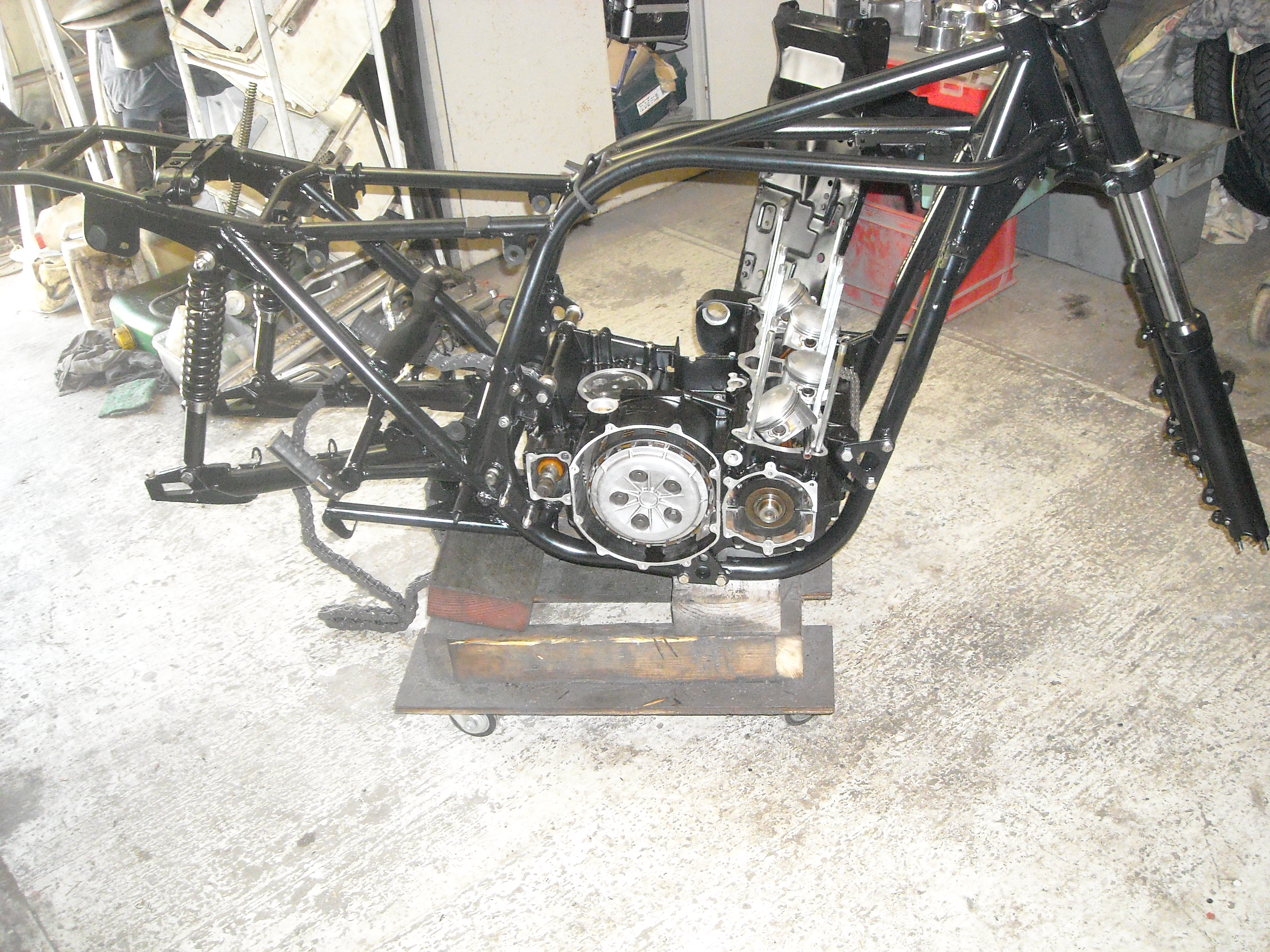

Hi guys I'm back

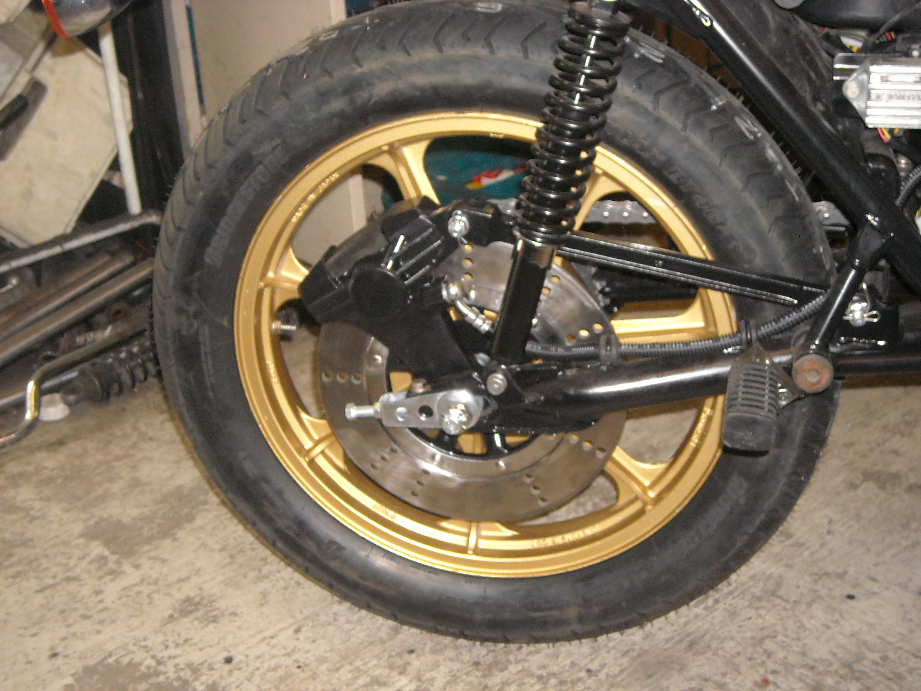

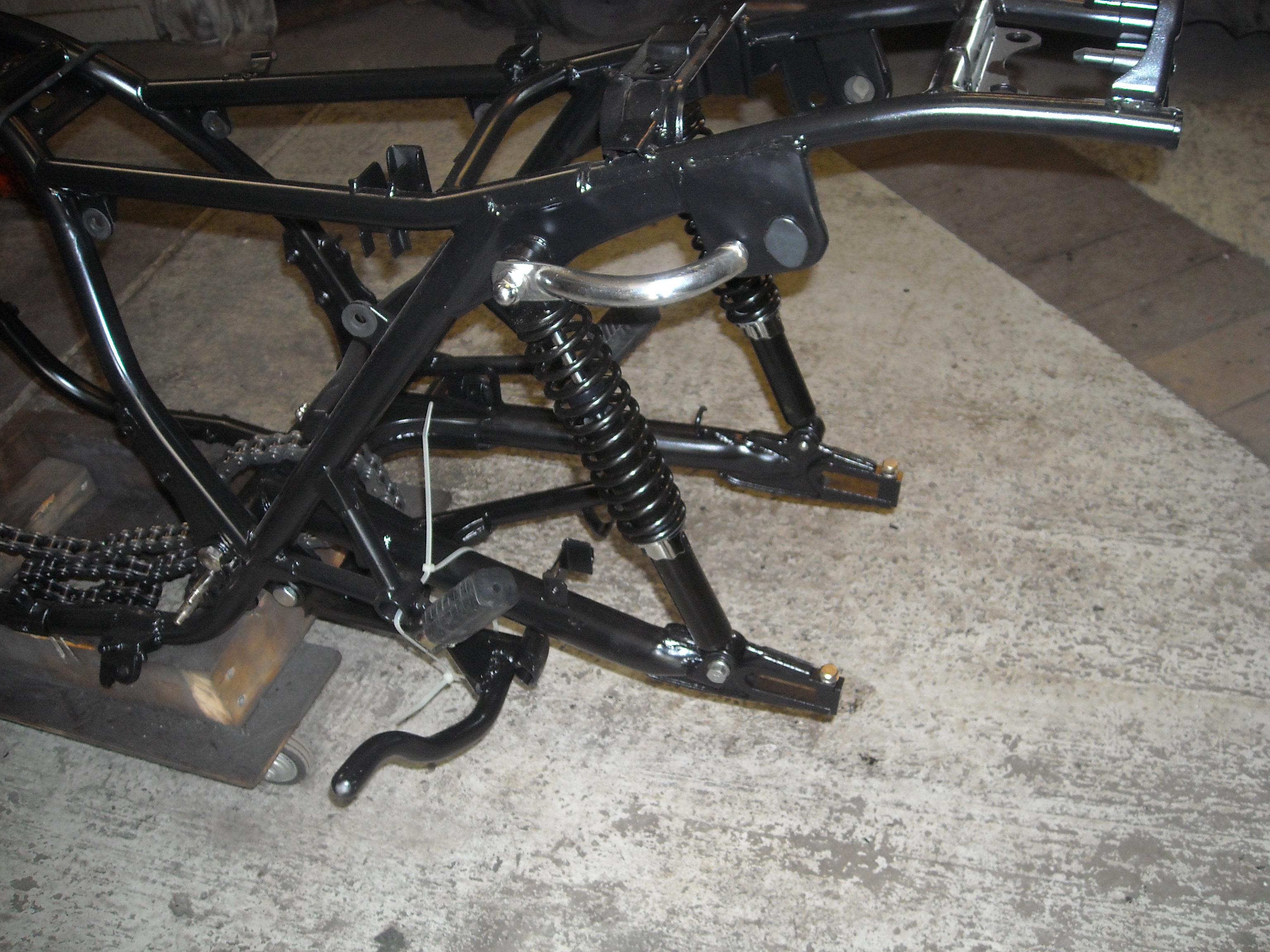

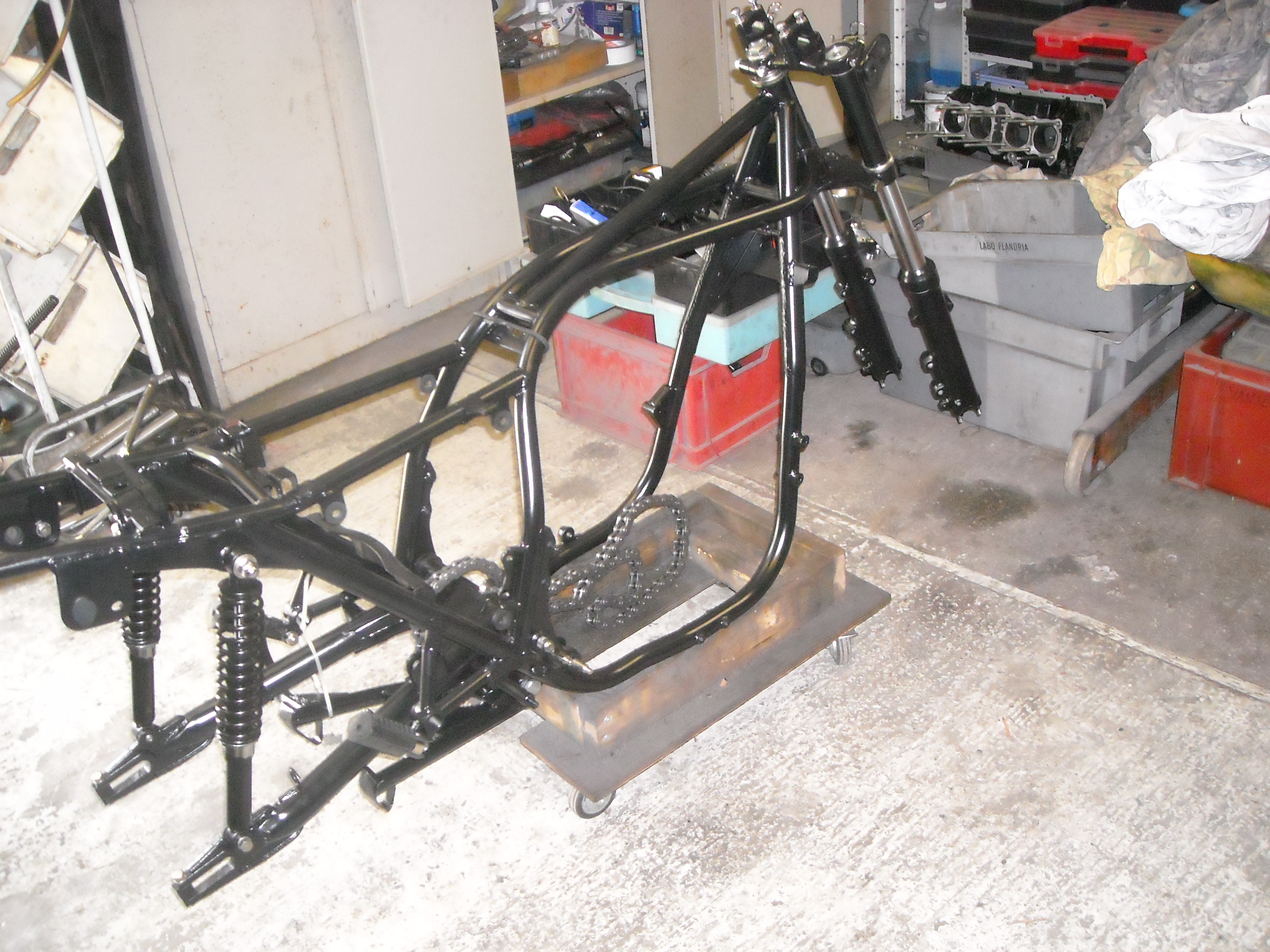

After the clutch adventure I couldn't resist to start the assembly of the frame.
The swing arm was first, followed by the rear shocks and the main stand

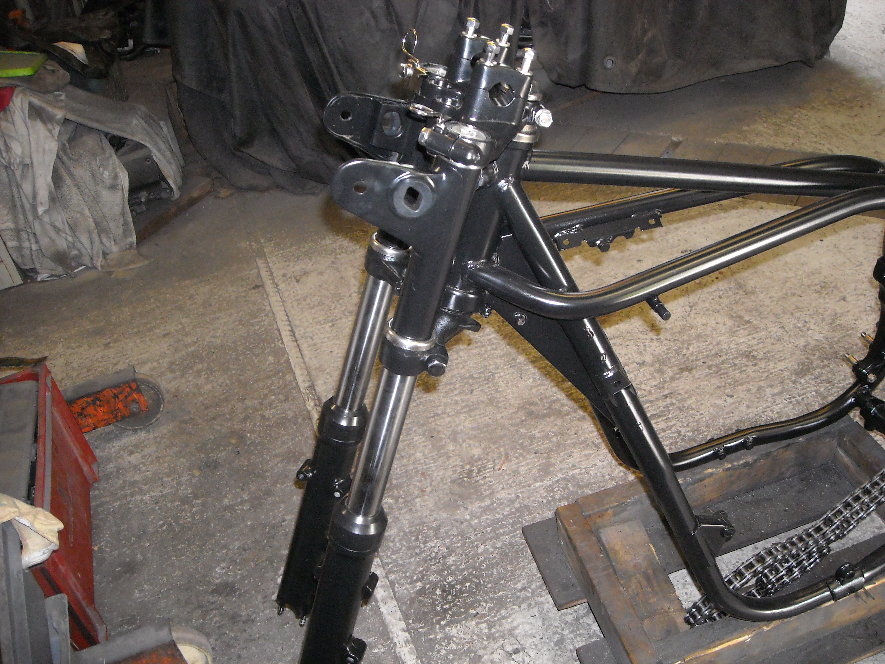

Then the yoke was mounted with new conical roller bearings and the fork stanchions were assembled too.
This is how the frame looks now
It starts to take some shape.

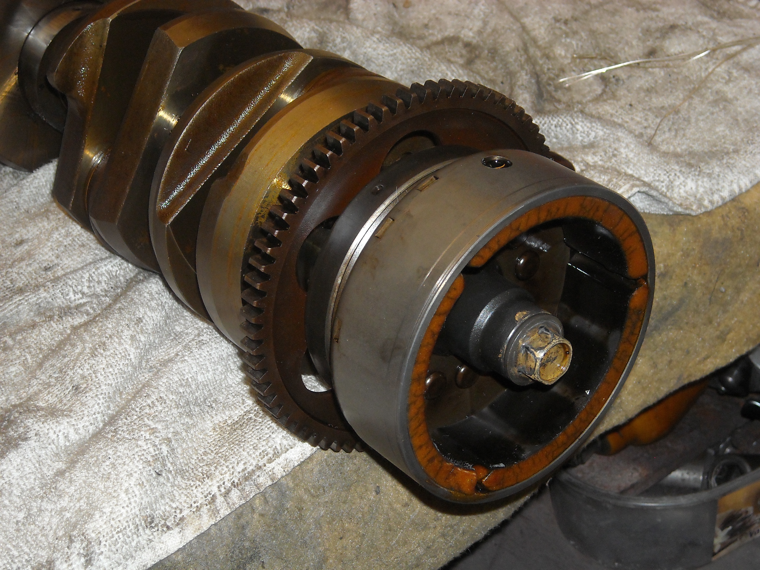

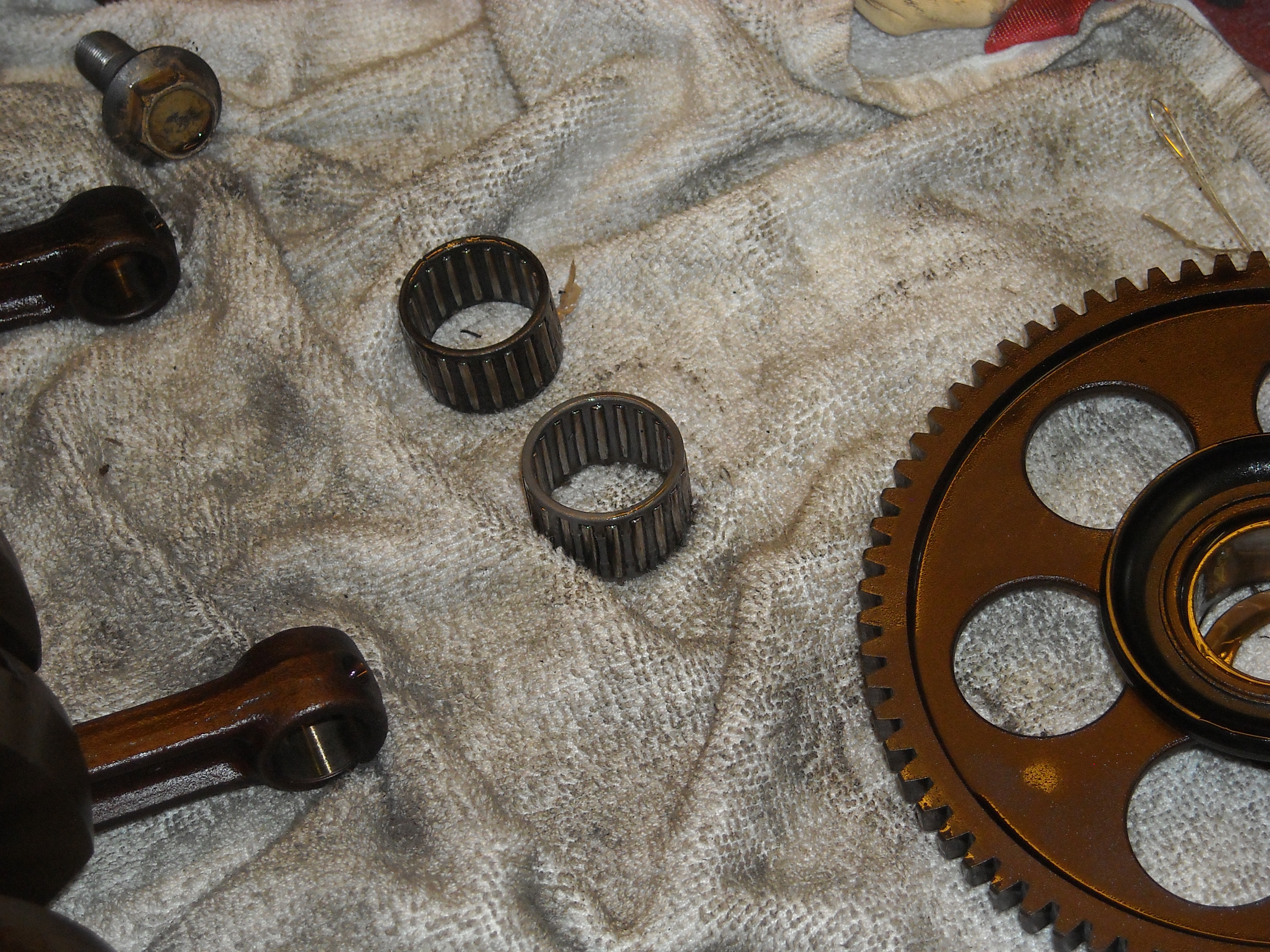

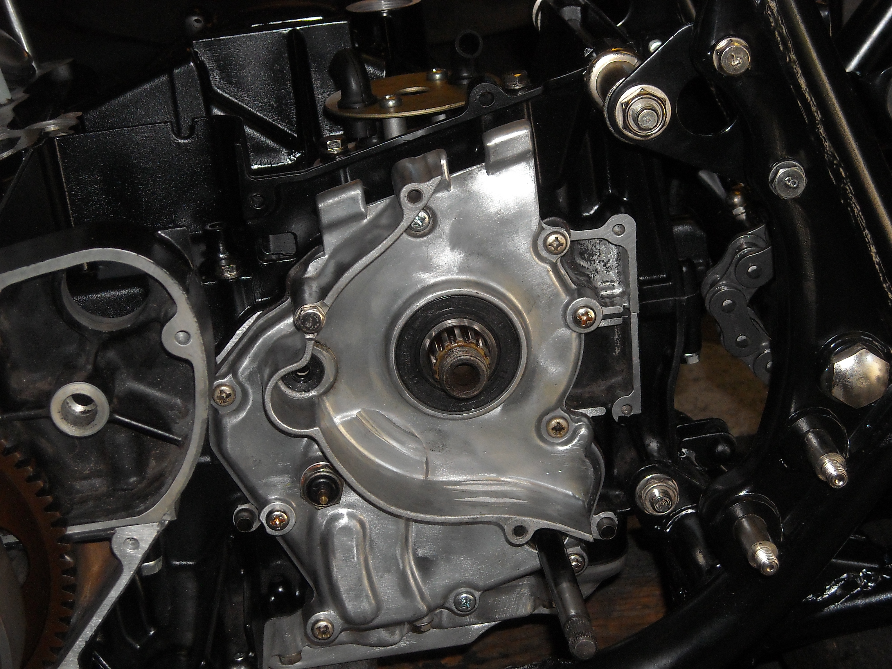

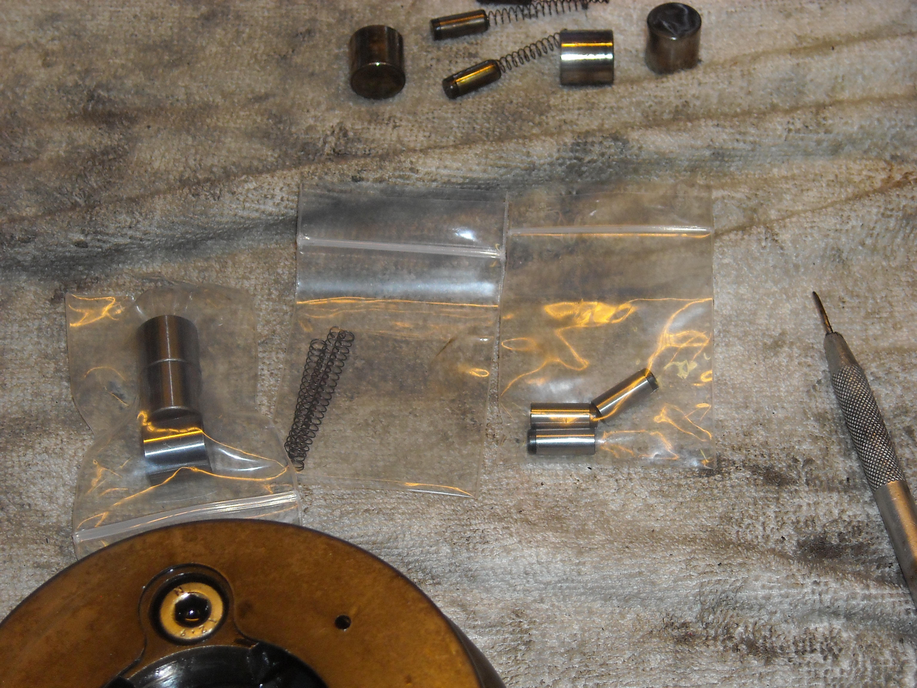

To close off the day I replaced the starter clutch mechanism.
The rotor came off quite easy with a pneumatic impact wrench.
I used a new needle bearing ...
...and new starter clutch rollers and springs
So this one is ready to be mounted again

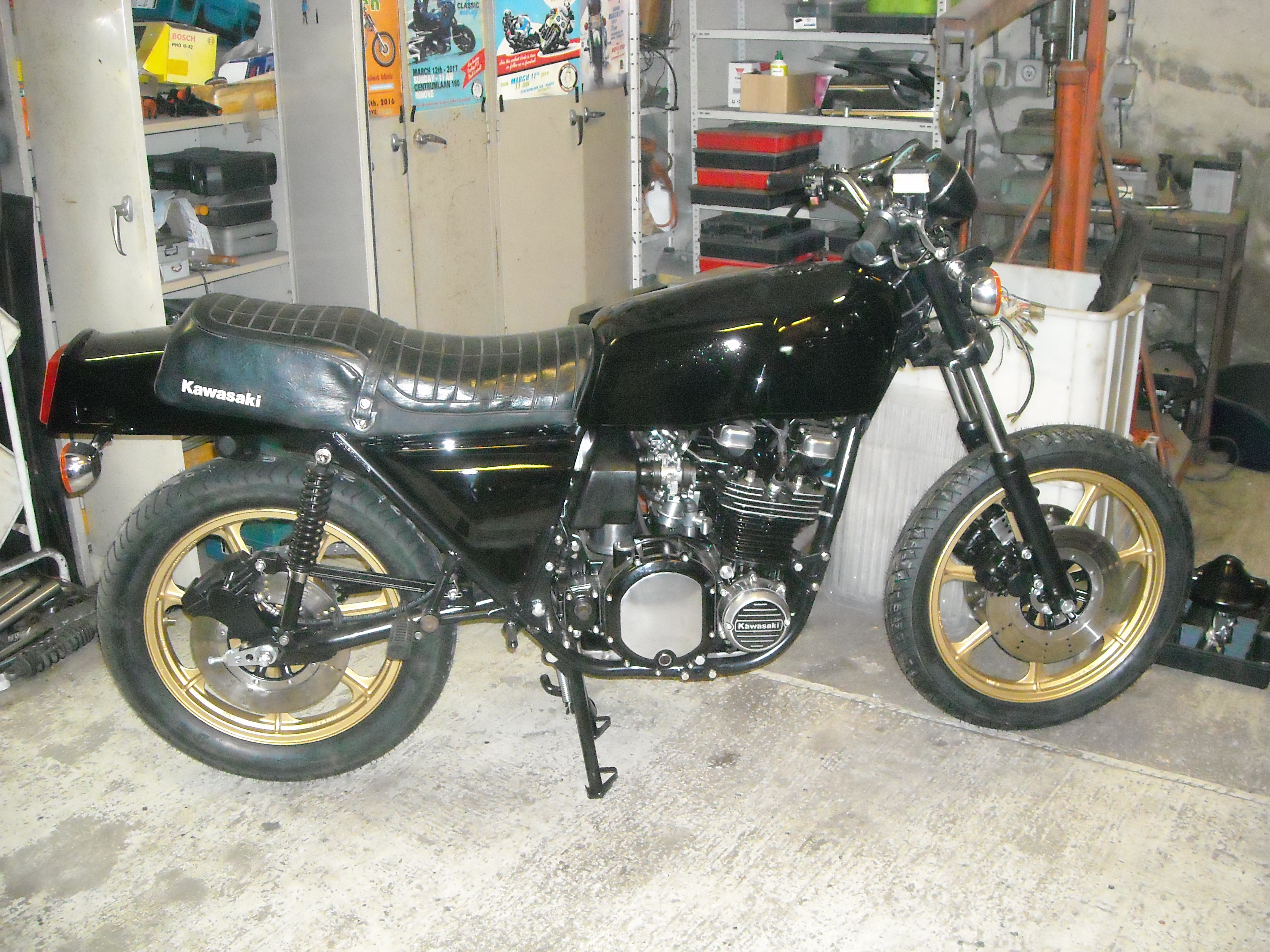

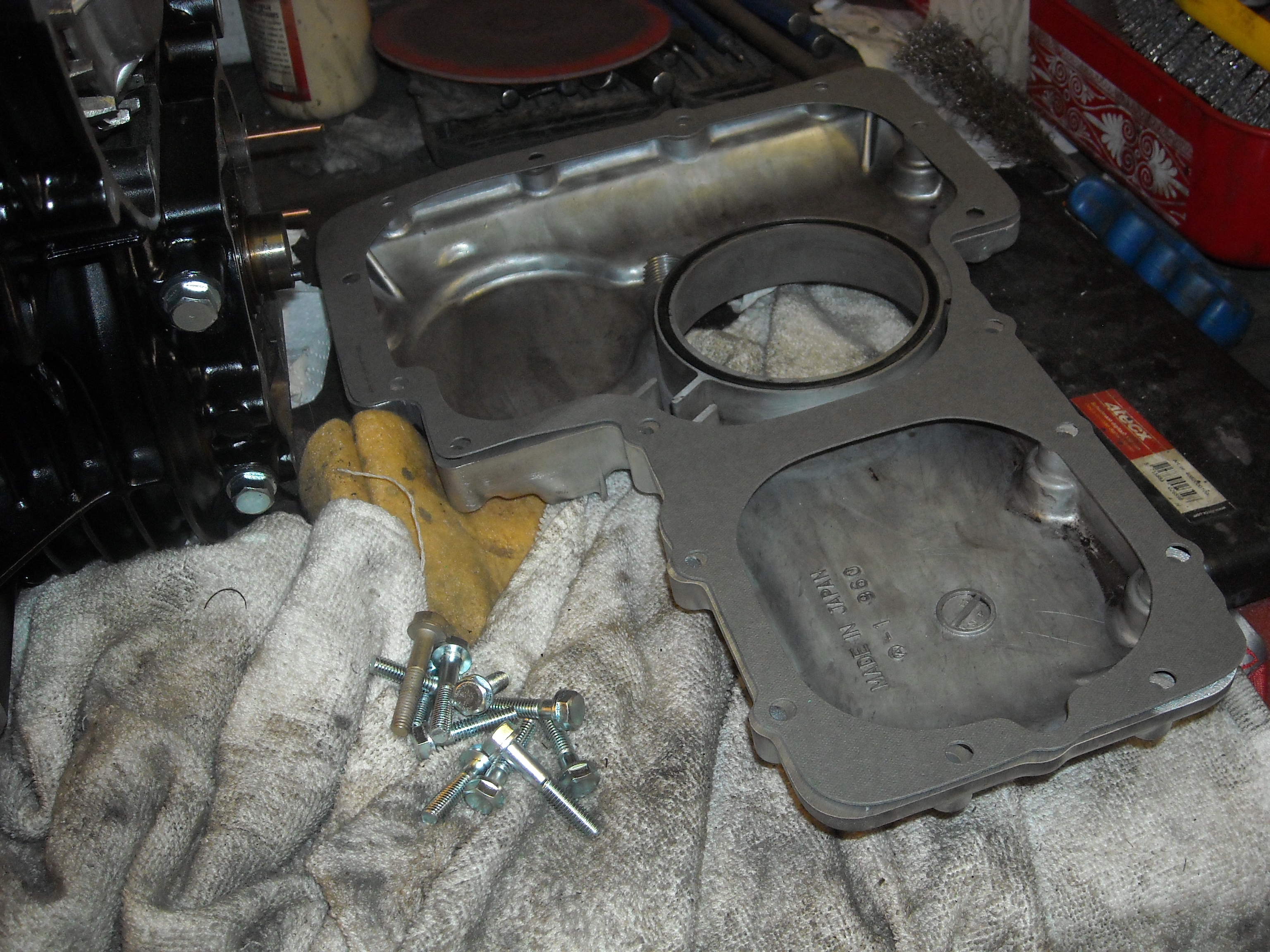

Re: Restoration of a Z1000H (God help me please)
Hi men
it's been a good day !

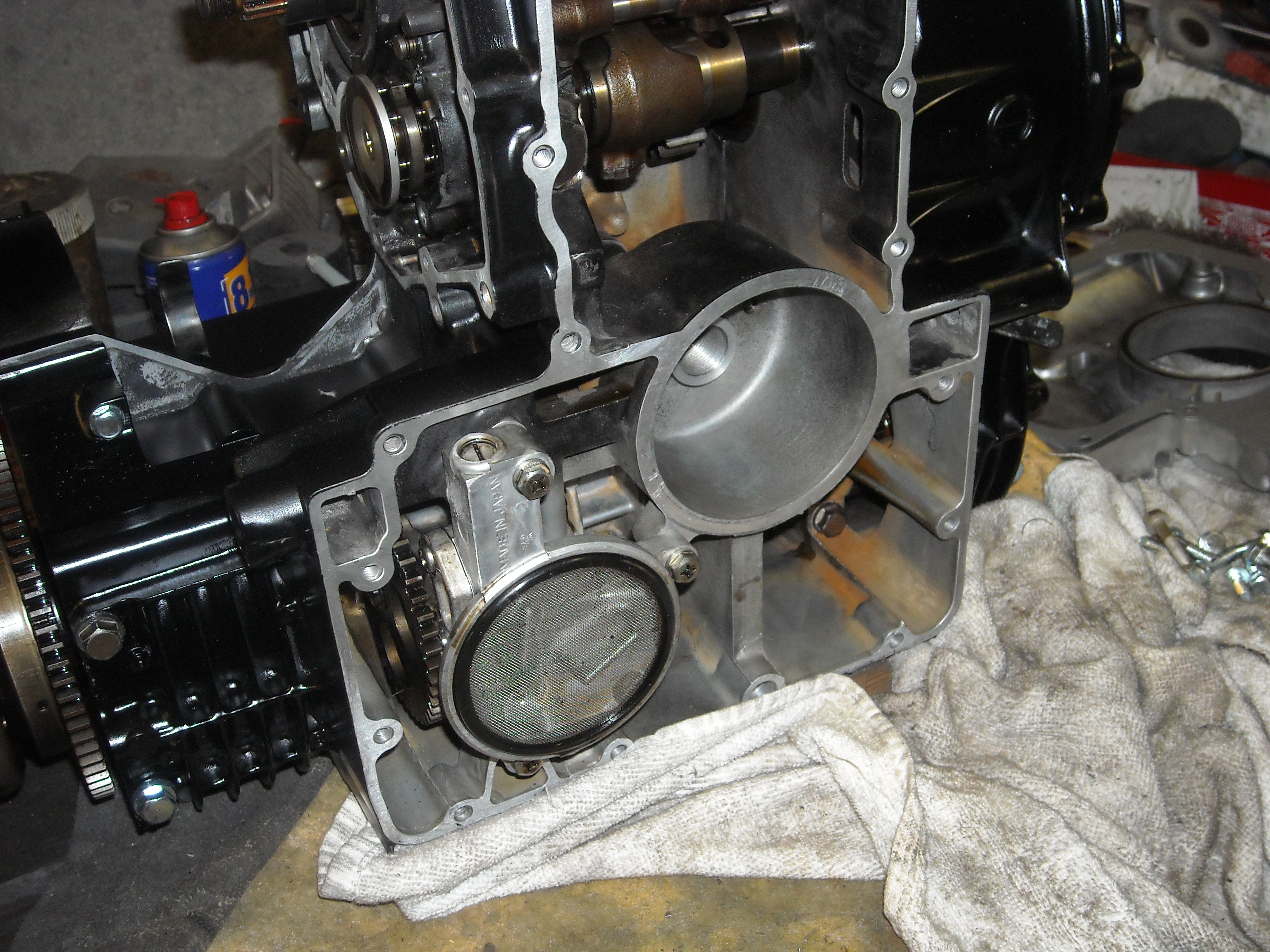

The lower engine is assembled and the pistons are mounted.

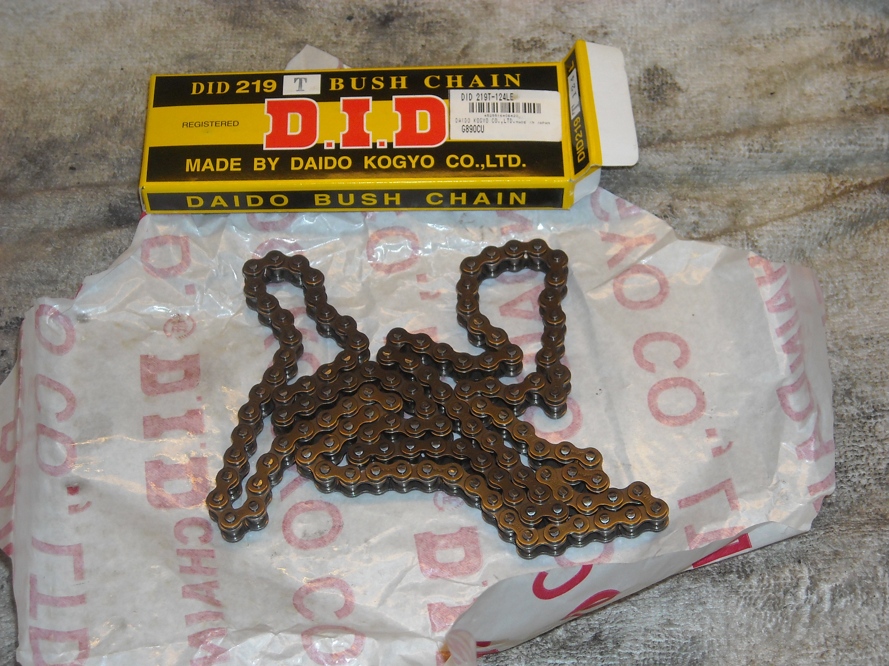

A new endless 124 link camchain is used before the cranckshaft went into the upper cranckcase.
The assembly went smooth, it only took me one and a half hour to get the lower engine together.
The cleaning of the pistons, putting new rings on and mounting them on the cranckshaft took me another 2 hours
Once again I waited to install the oil pan, you never know what the clips will do...
After the pistons were secured, the oil pump and the oil pan were mounted.
New O-rings and gaskets were used.
In the afternoon the temptation became too big and I mounted the lower engine in the frame...
The gear shift mechanism was installed afterwards, I do that afterwards to resist the temptation of using the gear selector shaft to lift the engine .
So that's all for today.
More to come within a few days.

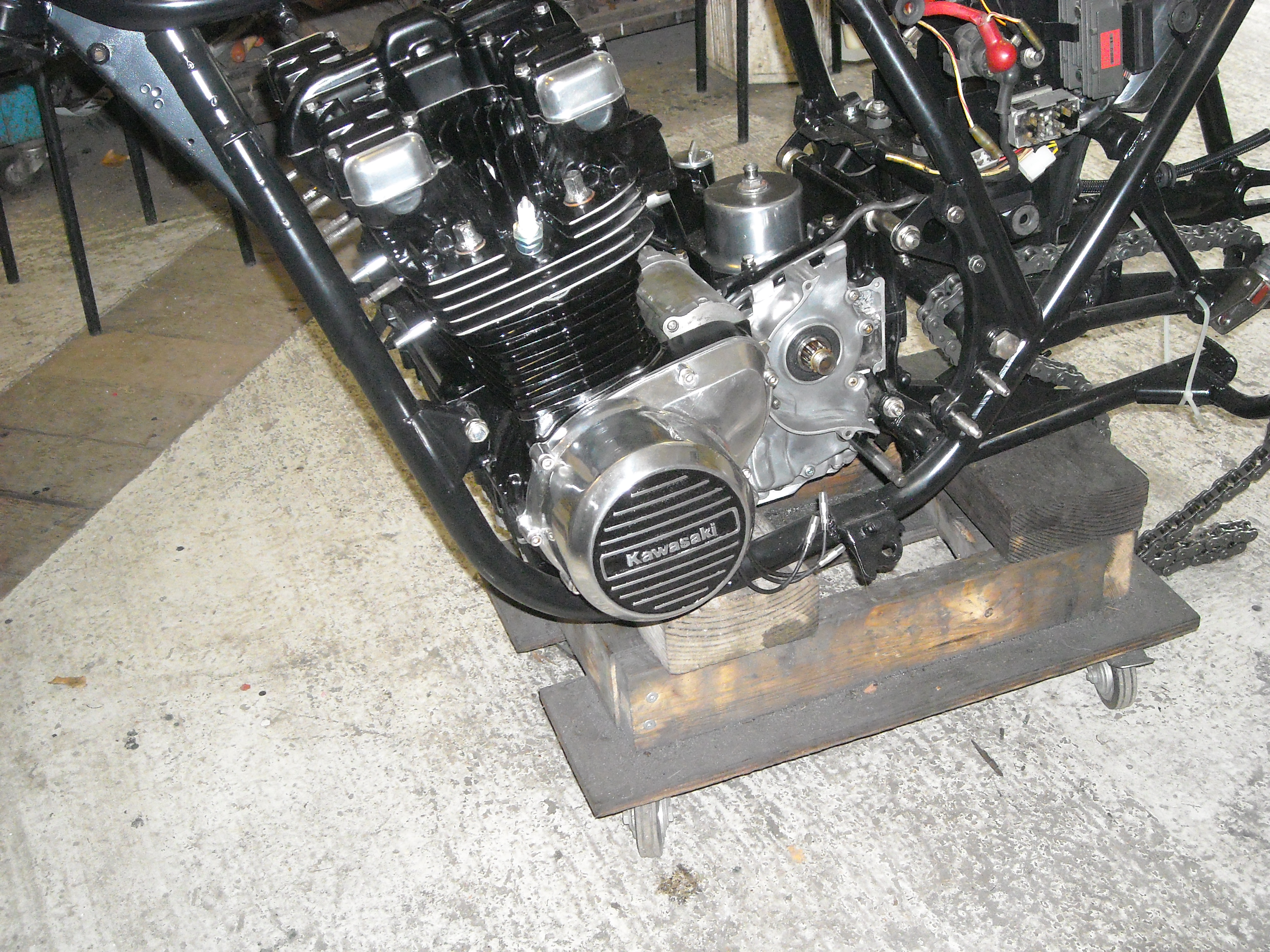

Hey guys

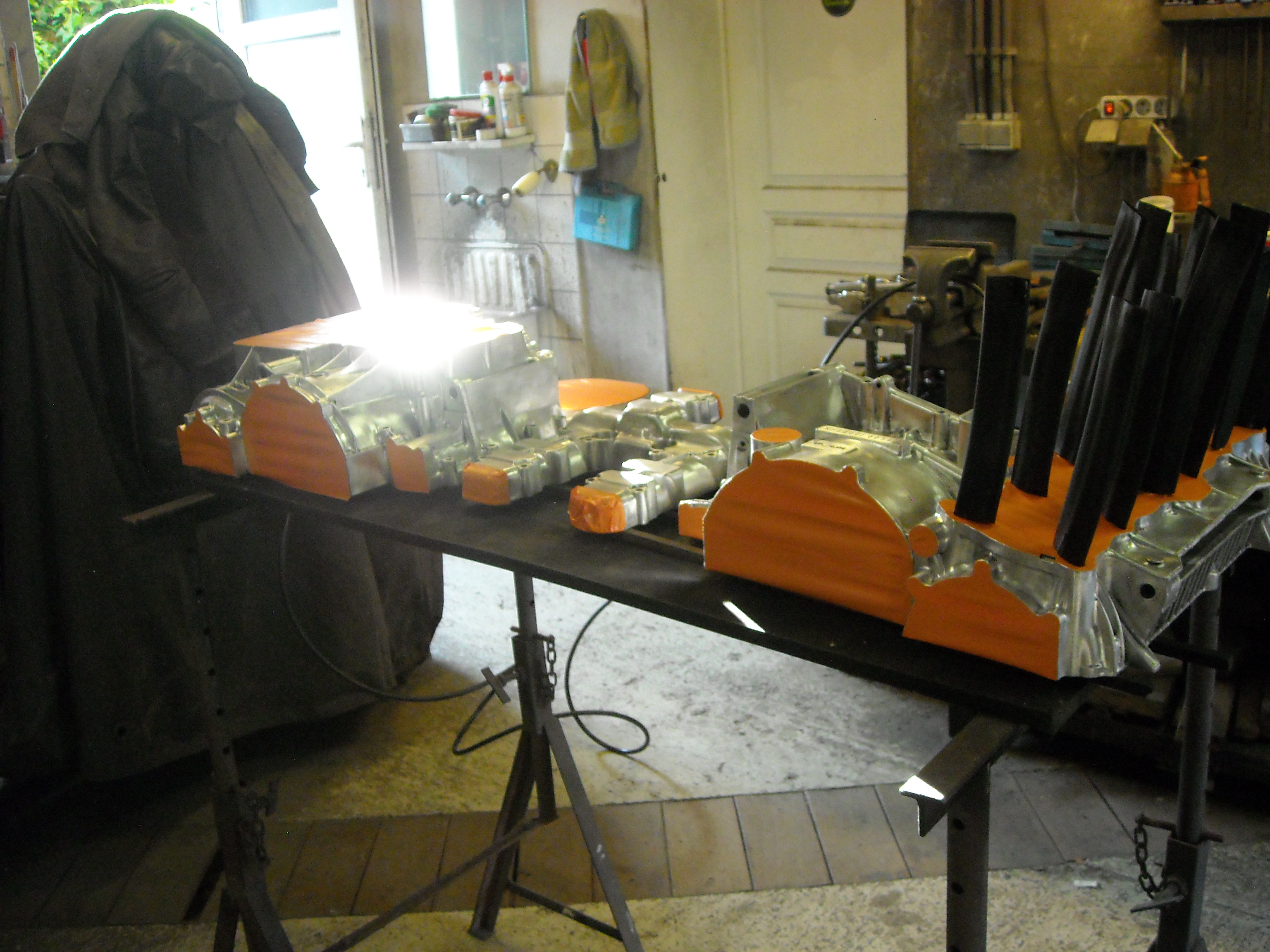

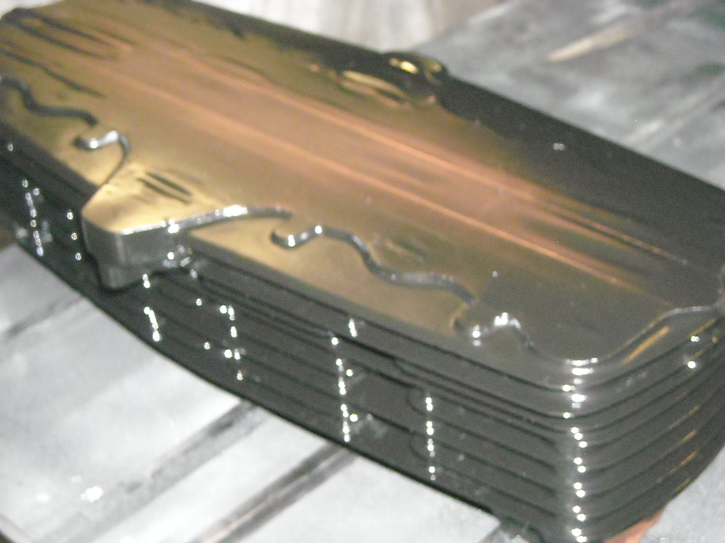

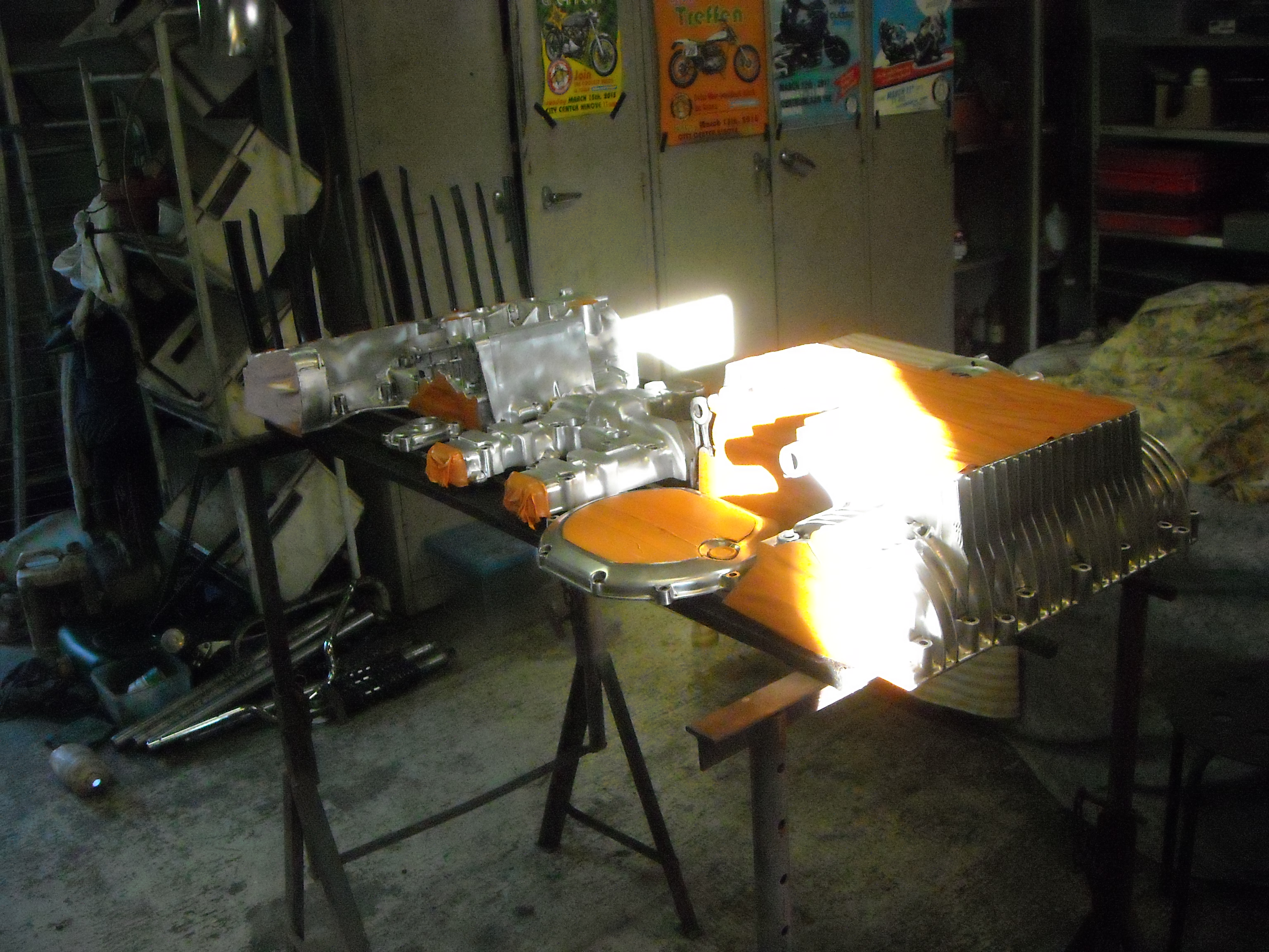

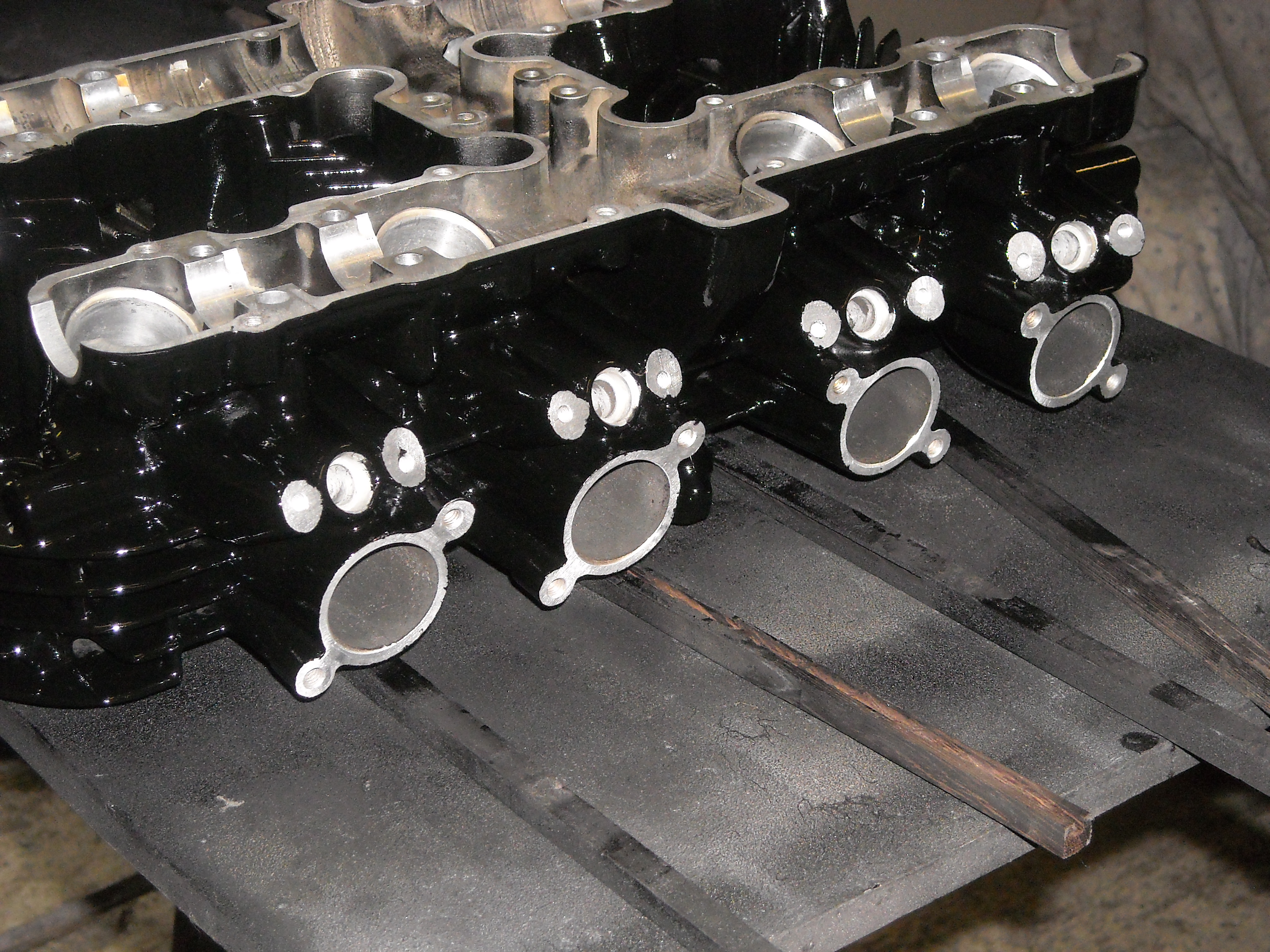

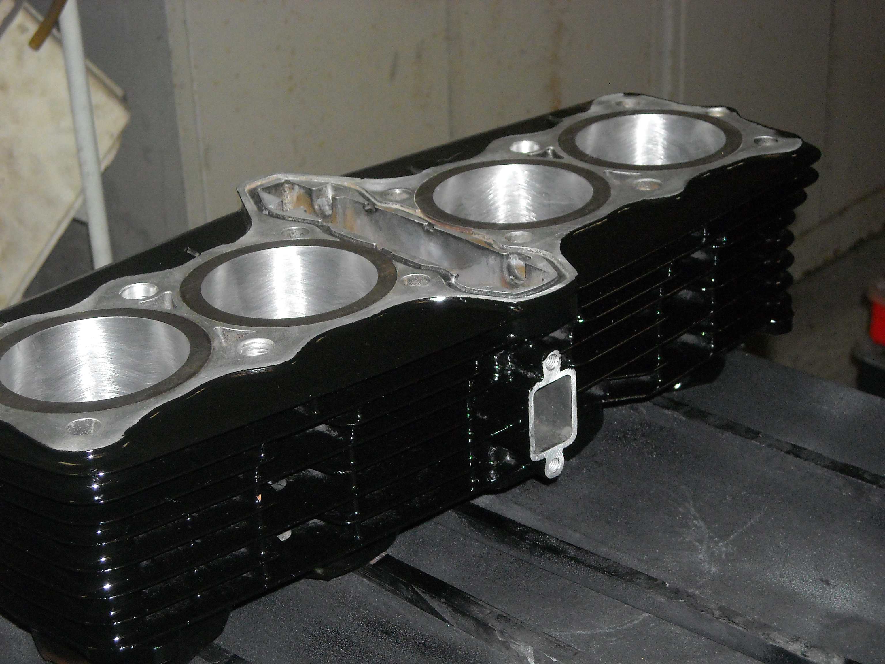

the past week I've been busy with cleaning, degreasing and stripping off paint of the barrels and cylinder head
This morning the parts were taped off after a final degreasing session and painted.
As you can see I'm using an old camshaft cover to protect the inside of the cylinder head against paint. Old half moons are used also to close the upper side.
The exhaust openings and the opening for the rev counter gear are protected with paper. The rest of the openings are taped off.
This is the result when the tape is removed.
Perhaps some of you can see that the cylinders are honed too. That's necessary when new piston rings are used.
In between cleaning and degreasing I also found the time to polish and to add a protective varnish to the cranckcase covers.
Those will be baked soon and mounted.

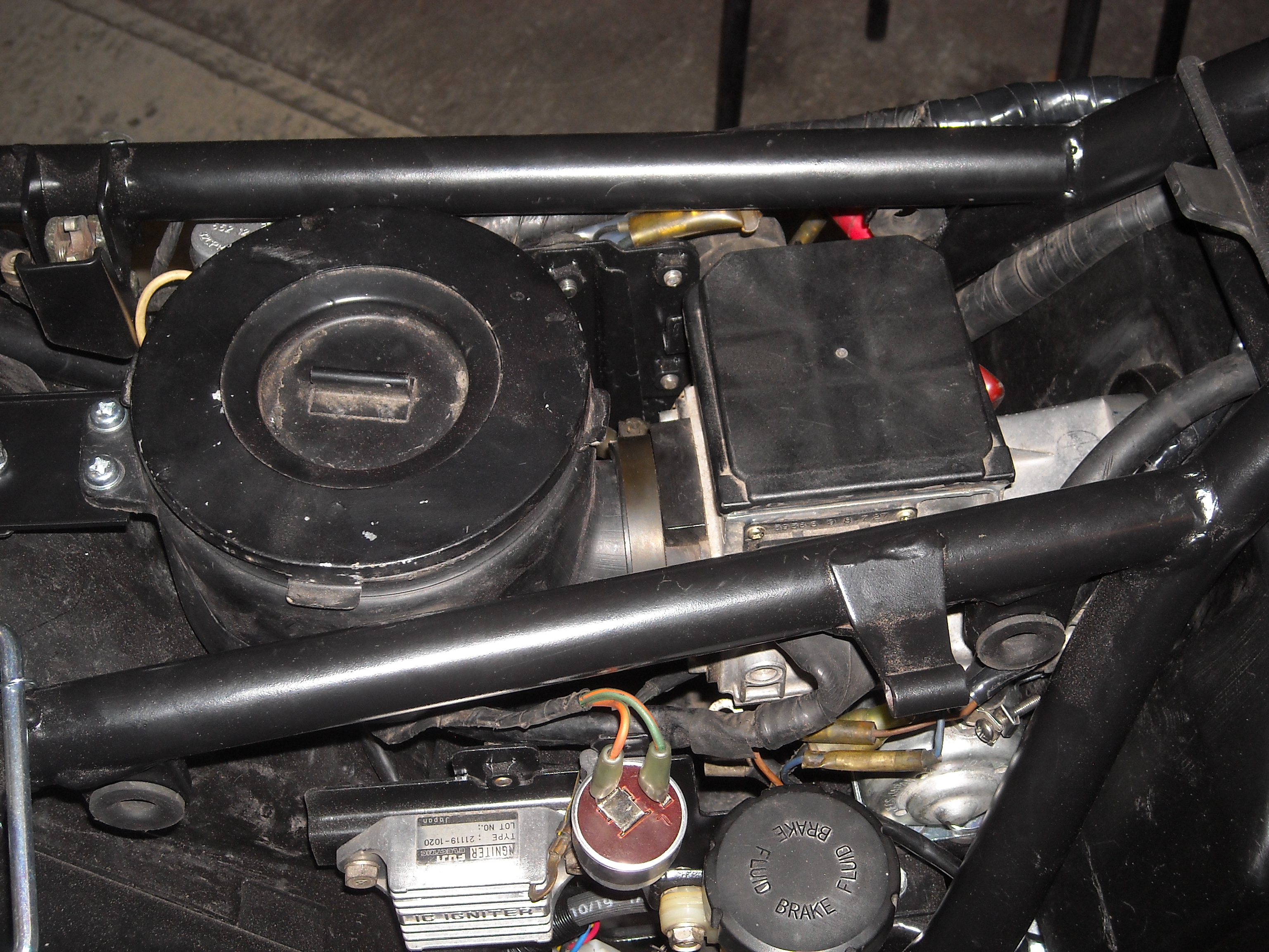

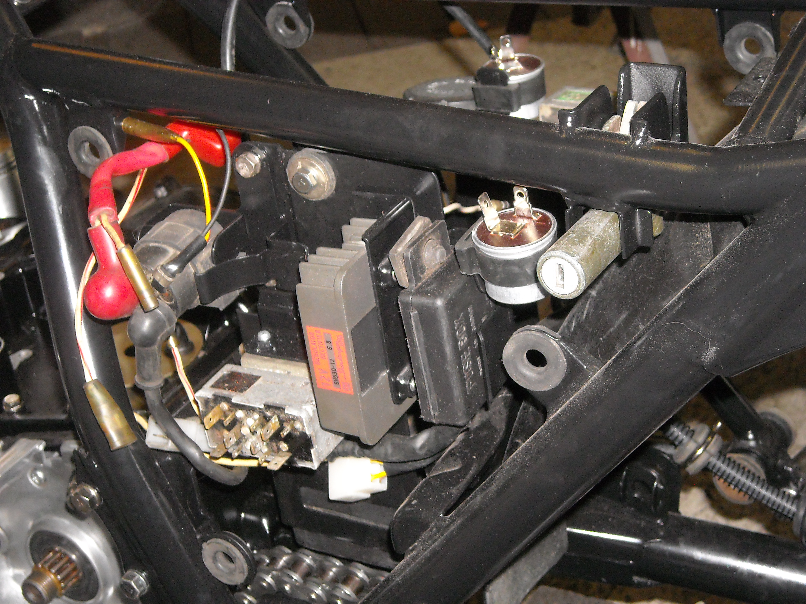

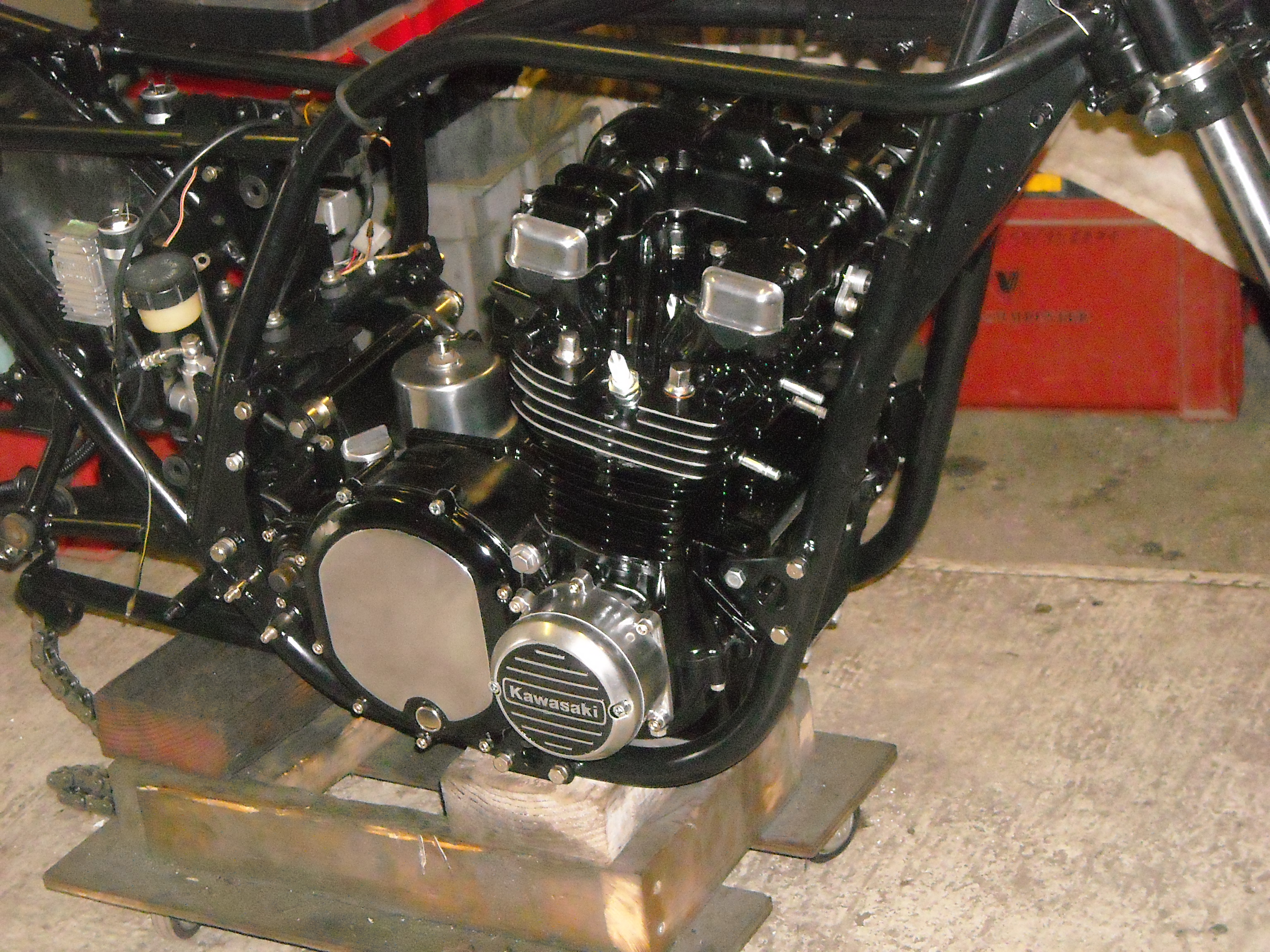

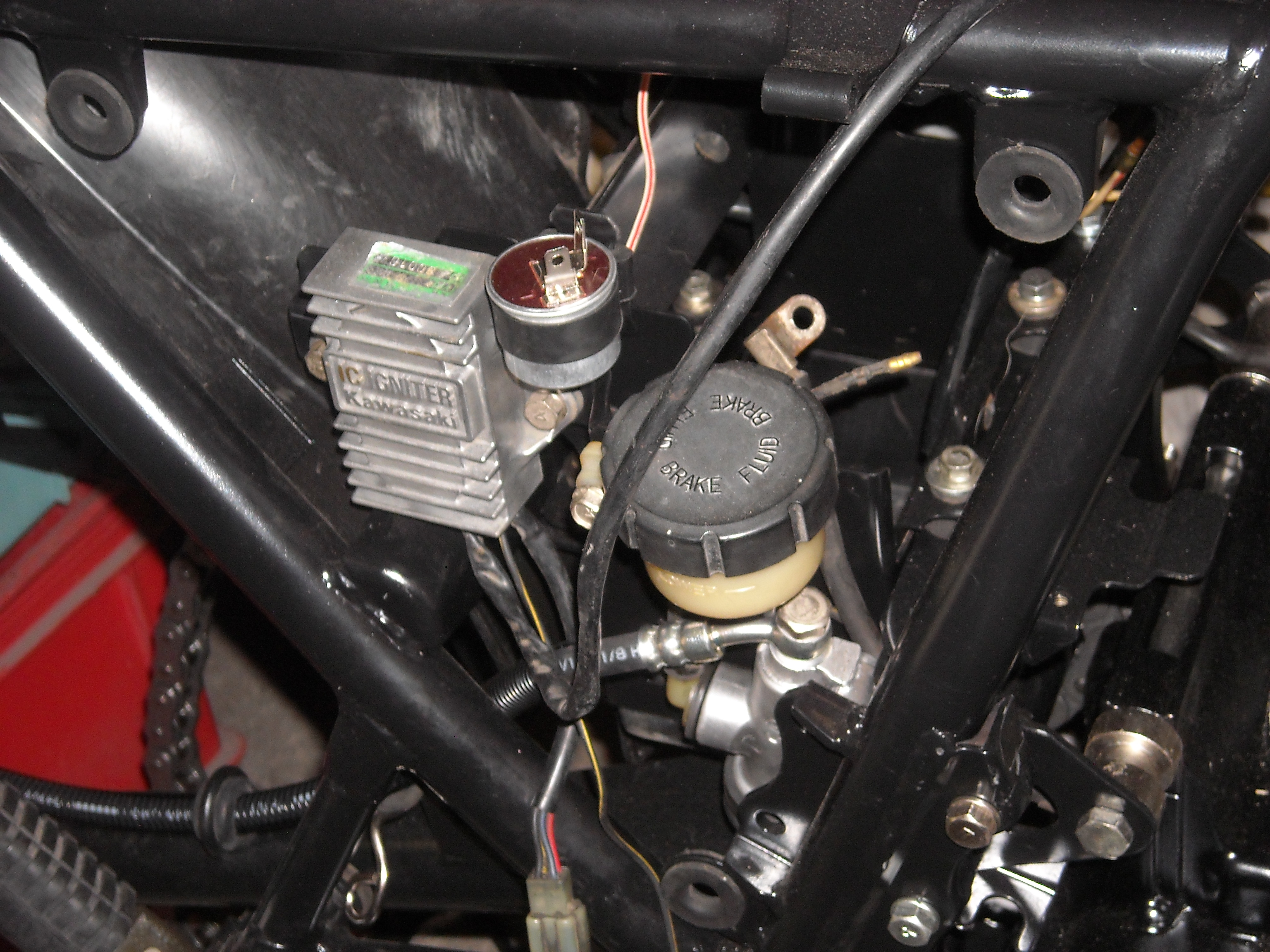

The battery box and a few electrical components are mounted, it starts to look like I'll manage to do the restoration.
I'm still waiting for a lot of bolts and nuts to be replated. The replater said it would take 4 weeks...perhaps his weeks last longer than mine.
When the paint is fully cured the cylinder barrels will be mounted, the valves will be placed in the cylinder head and then the engine can be assembled completely.
That's something for next week.

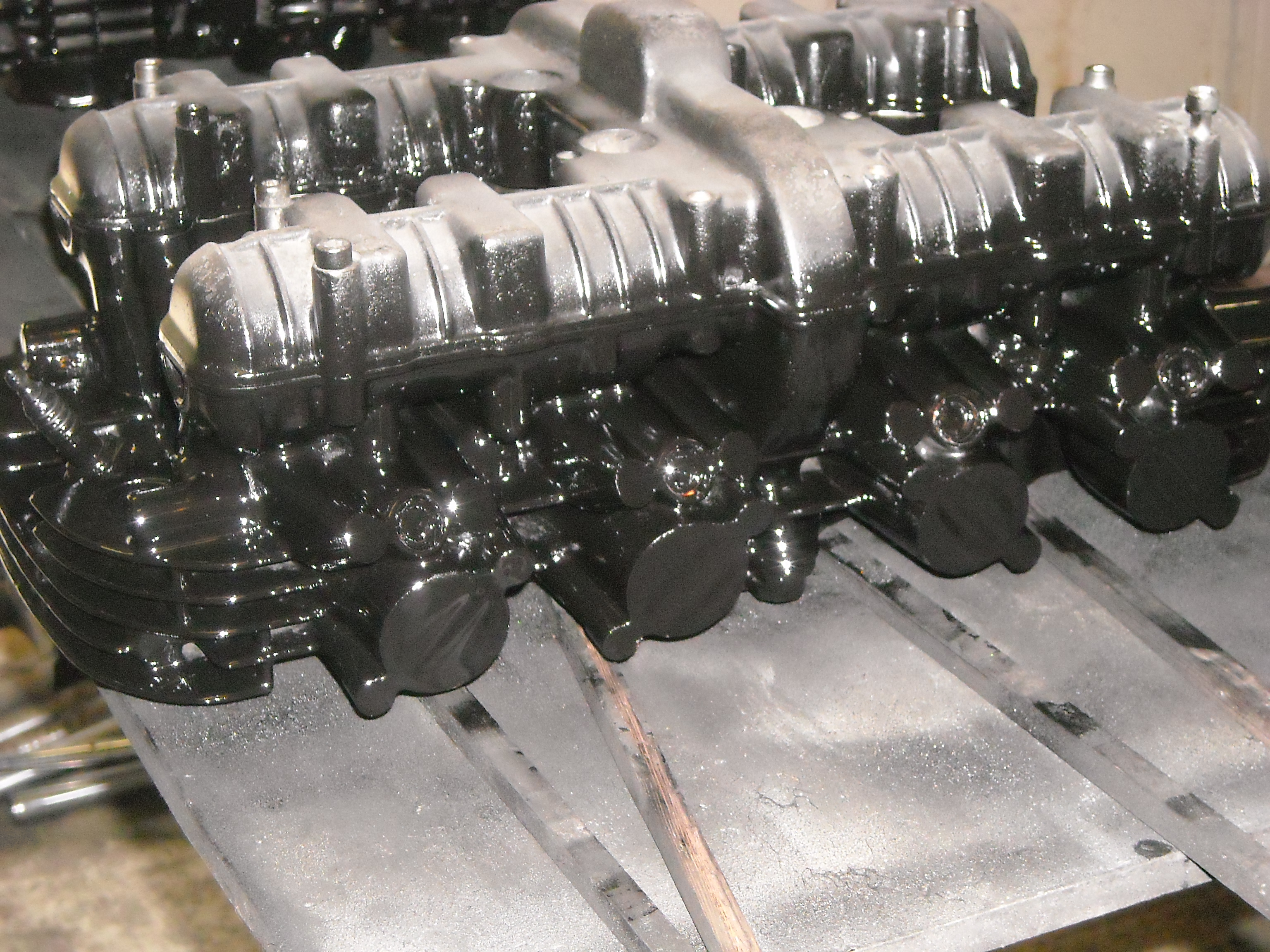

Once that done, the pistons slided in the barrels and another step was taken.
Then it was time to mount the valves in the cylinder head. When that was done I started to mount the camshafts in order to check the clearances for the valves. The exhaust valves had 0,15 to 0,20 mm of play so that was OK.
The intake valves had clearances between 0,25 to 0,35 mm...a bit too much. After changing shims the play was reduced between 0,12 to 0,15 mm. Fair enough.
In the mean time the cranckcase covers were baked in the oven to cure the clear coat.
When they cooled down I mounted them.
This afternoon the cylinder head was mounted, the camshafts were installed and the camtiming checked
All went very good and this is the result after a day of fun.
So far so good.
Next week more news.
today has been a successfull day!
This morning I mounted the barrels on the cranckcase. A 15 minute job with the Kawasaki piston ring compressor but before I could mount the compressor I needed something to keep the pistons steady.
The pistons of the Z1000H are different from the ones used on an other Z1000.
Not only are the half moon depressions on the crown bigger but the mantlet itself doesn't reach as deep . I needed other things to hold them steady. I used 10 mm soft copper tubes, you all know these, the plumbers use them to connect water taps.
So far so good.

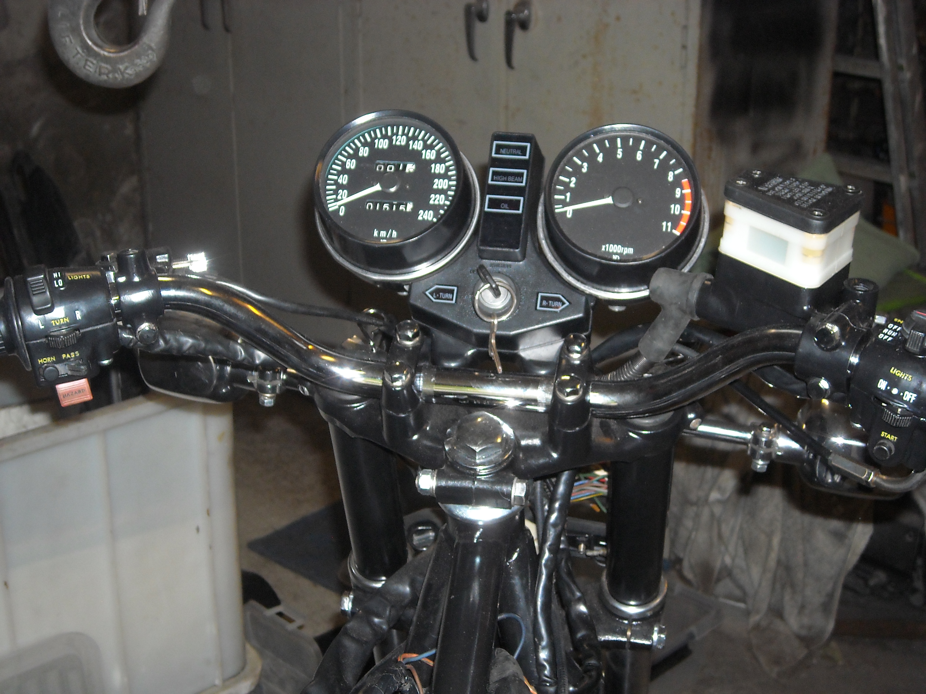

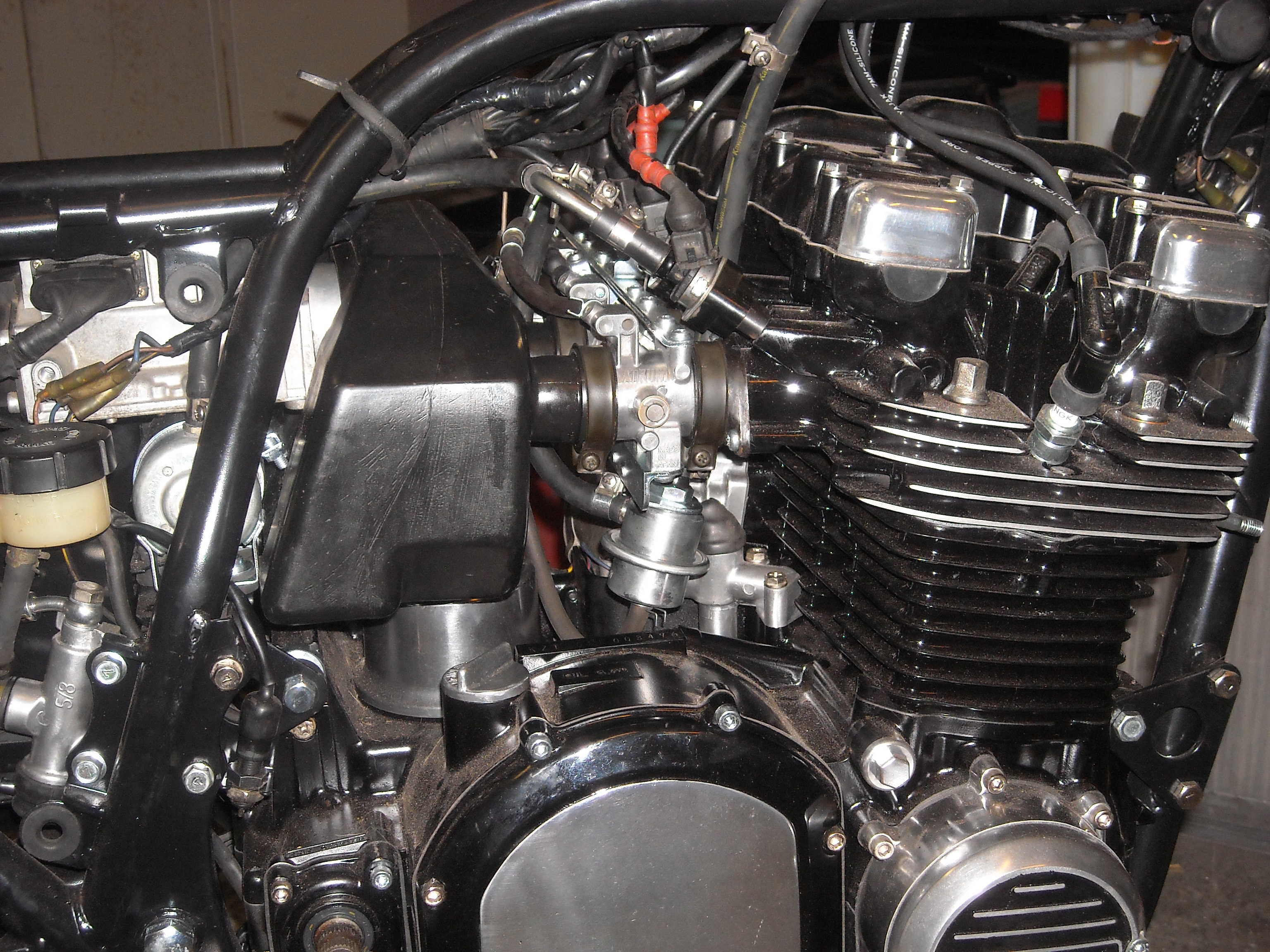

Hello men
it's been a few weeks since my last update but here it is.
The past few weeks I've been waiting for the parts to be replated...I spent the time with preparing the body parts in order to paint them.
As usual all the old paint was removed. The fuel tank and the front mudguard needed putty in order to hide the traces of damage caused by little accidents a long time ago.
The usual sequence of filling, grinding, painting, filling,....had to be performed 4 times before I was pleased with the results.
The plastic body parts received a layer of adhesive primer and a layer of epoxy primer before they received a layer of gloss black.
Now all I have to do is grind them with wet or dry sanding paper with a grit of 1500 and 2000 before I can apply the transfers.
Last thursday, july 13, I received a phone call from the replater: the parts were ready !!!!
I immediately went to Brussels in order to get them and I spent the rest of the day sorting them out.
On friday I started adding the brake rotors on the front wheel and the axle so I could mount the front wheel under the fork legs.
The rear wheel was assembled and mounted and yes, she's on her wheels!
Now that I had all the replated parts back I was able to mount the clocks, the handlebar, the switches,...
This morning I started to mount the air valves, the fuel injectors and the fuel pump.
The air flow meter and the air cleaner house were installed too
I couldn't resist the temptation of mounting the body parts on the bike to see what it looked like
A lot of these parts are just mounted to see if they fit, and yes, a few of them will have to change place in order to be at the correct place so that everything works.
It's cramped in there, a lot of parts in a small place and they all have to work together to let the bike run as it's supposed to do.
More news next time.
