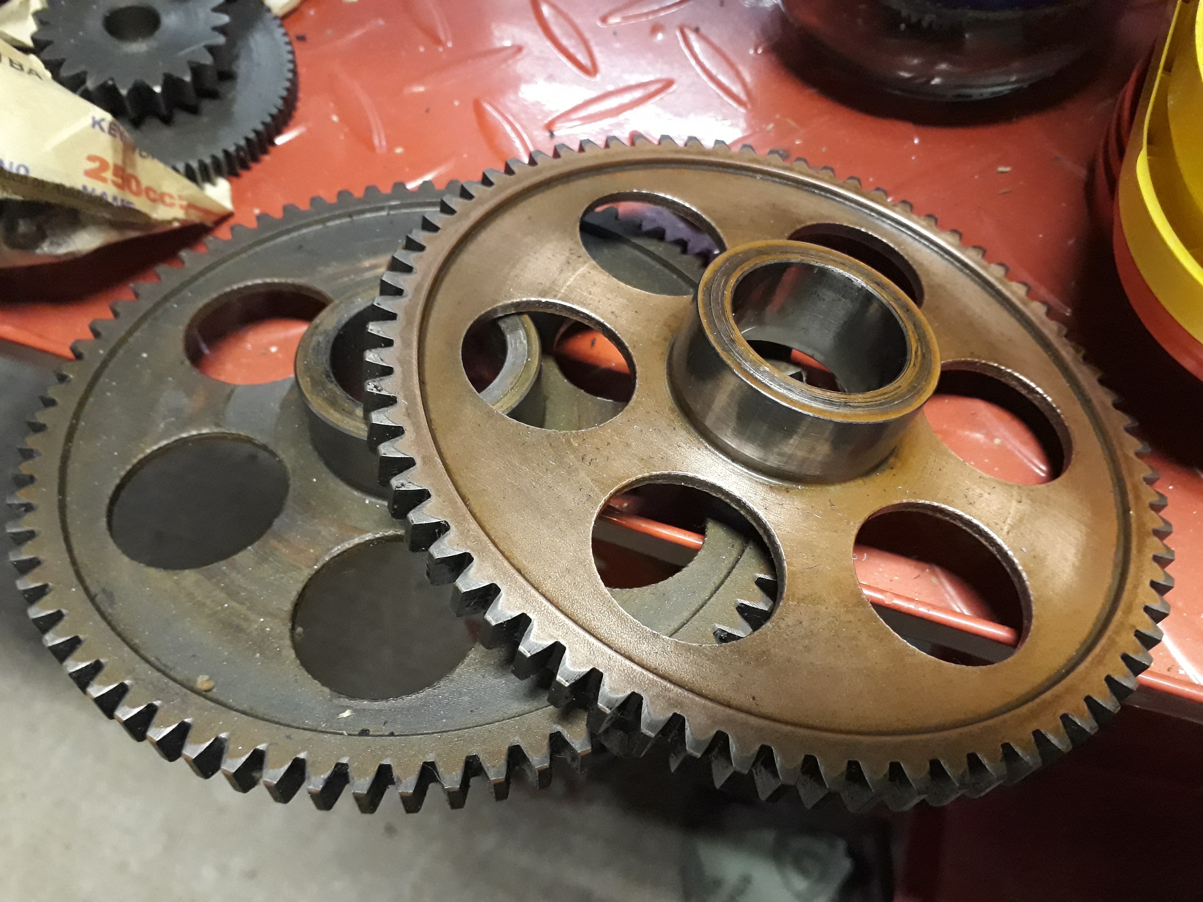

I managed to get the bits I needed to fit the starter clutch etc - Thanks Rob! - and the aftermarket starter clutch refurb stuff and a new needle roller bearing. But looking at the ring gear and idler gear, they were really nasty and smeggy, and the idler gear had what looked like bits of old magnet between the teeth, presumably from a knackered alternator...

So, I found the six bolt lock-up that was tucked away in a box that hadn't been open in years. And was I happy? Er, no. It is, as expected, for a GSX-R... so I'm currently in the situation where I have a lock-up unit for a five stud clutch, while the bike has a six bolt clutch, and my spare is also six bolt. I could as Rob suggested earlier, get hold of an earlier clutch and it's stronger steel basket, or find a lock-up unit to suit the six bolt clutch that I've got loads of spares for...
