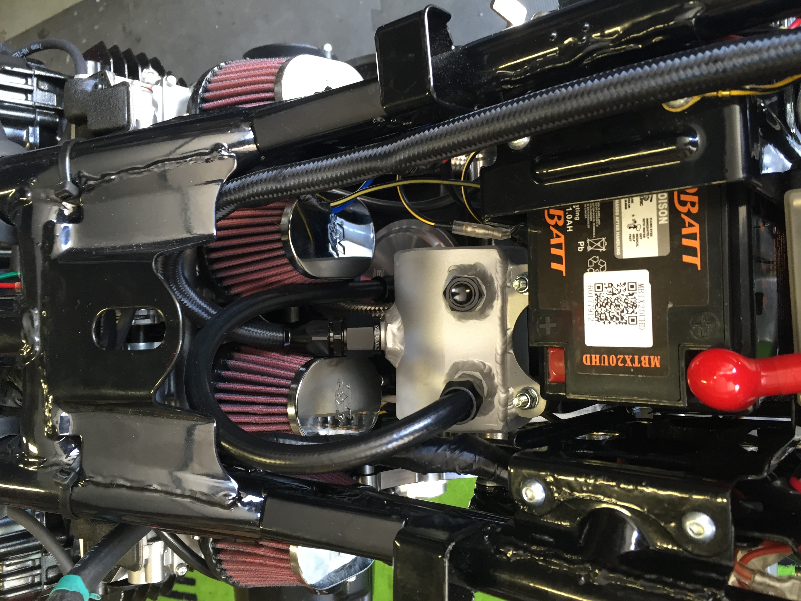

So finally got round to fitting my catch tank. I may change the 8UN fitting for an angled one to tidy it up and not sure on the final resting point for breather filter yet but we will see..

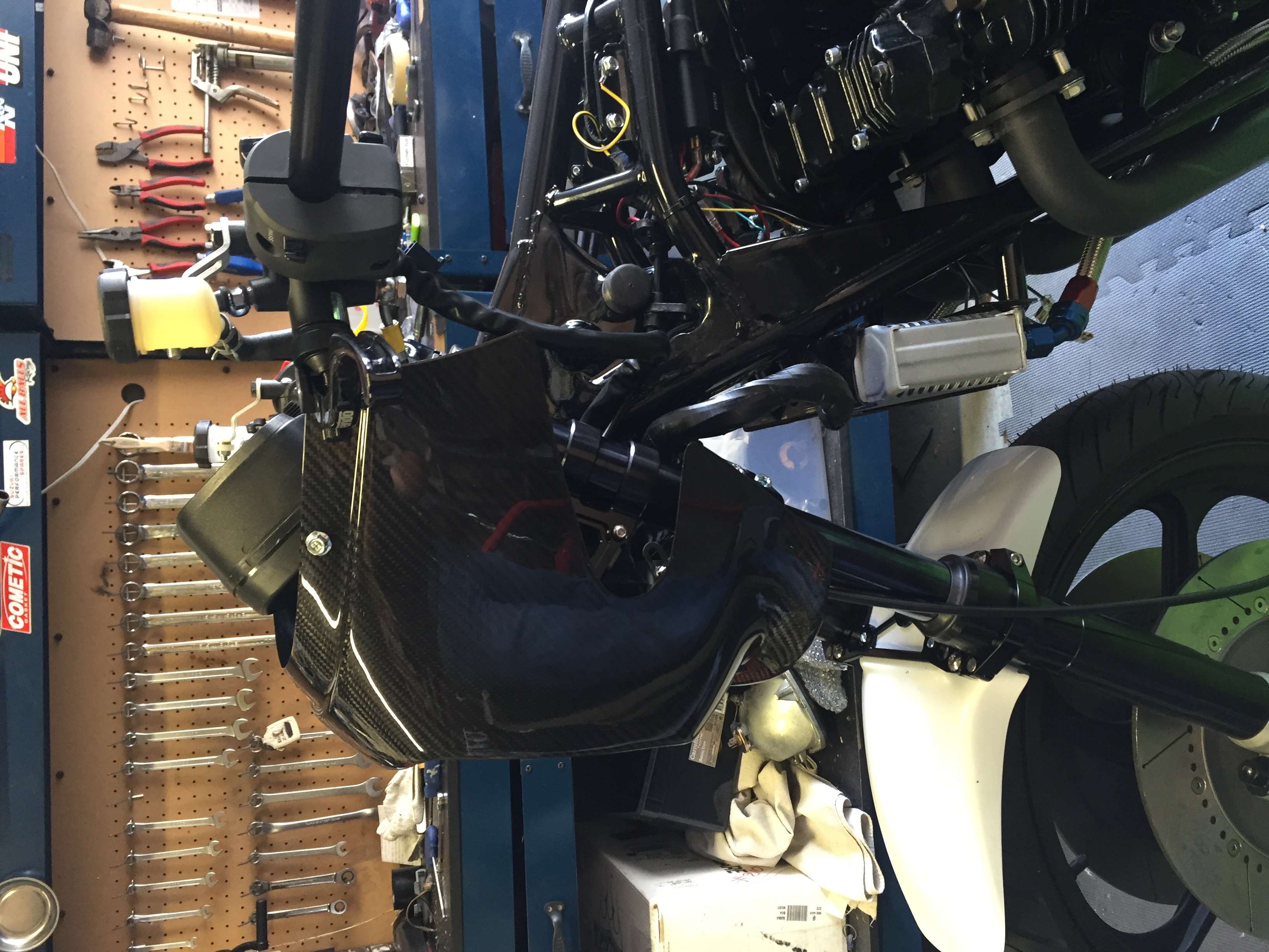

Also mocked up the fairing and seems a few issues. Headlight is too close to the forks so dragging everything back. The ones I got were 105mm offset. Does anyone know what the standard headlight for the R is offset at? Ie how long do my headlight brackets need to be?
Also is a bit too low I reckon, but damn ignition barrel is so big it can't go any further up.. Will have to rethink that a little.

One of the most complicated parts of my build was the headlight bracket. In the end I cut out the headlamp bowl to accommodate the ignition switch.
As I made my fairing brackets I could adjust that to suit but I would suggest you fit the bottom fairing bracket without the headlamp then make the top brackets and get the fairing to line up.
You can then fit the headlamp to suit that.
The Sanctuary bike I based mine on uses a frame mounted headlamp and fairing and after all the trials I had with mine I can sort of see why.

Chris, I am using the headlight to mount the bottom of the fairing as per the standard mounts, so it's kinda limiting what I can move. I'm waiting in some rubbers etc for the headlight as everything is loosely fitted just now, once I have all that firmed up will see where it end sitting. I think I will have to do the same with the headlight bowl too, unless I can get a shallow switch, but seems easier to cut the bowl.
