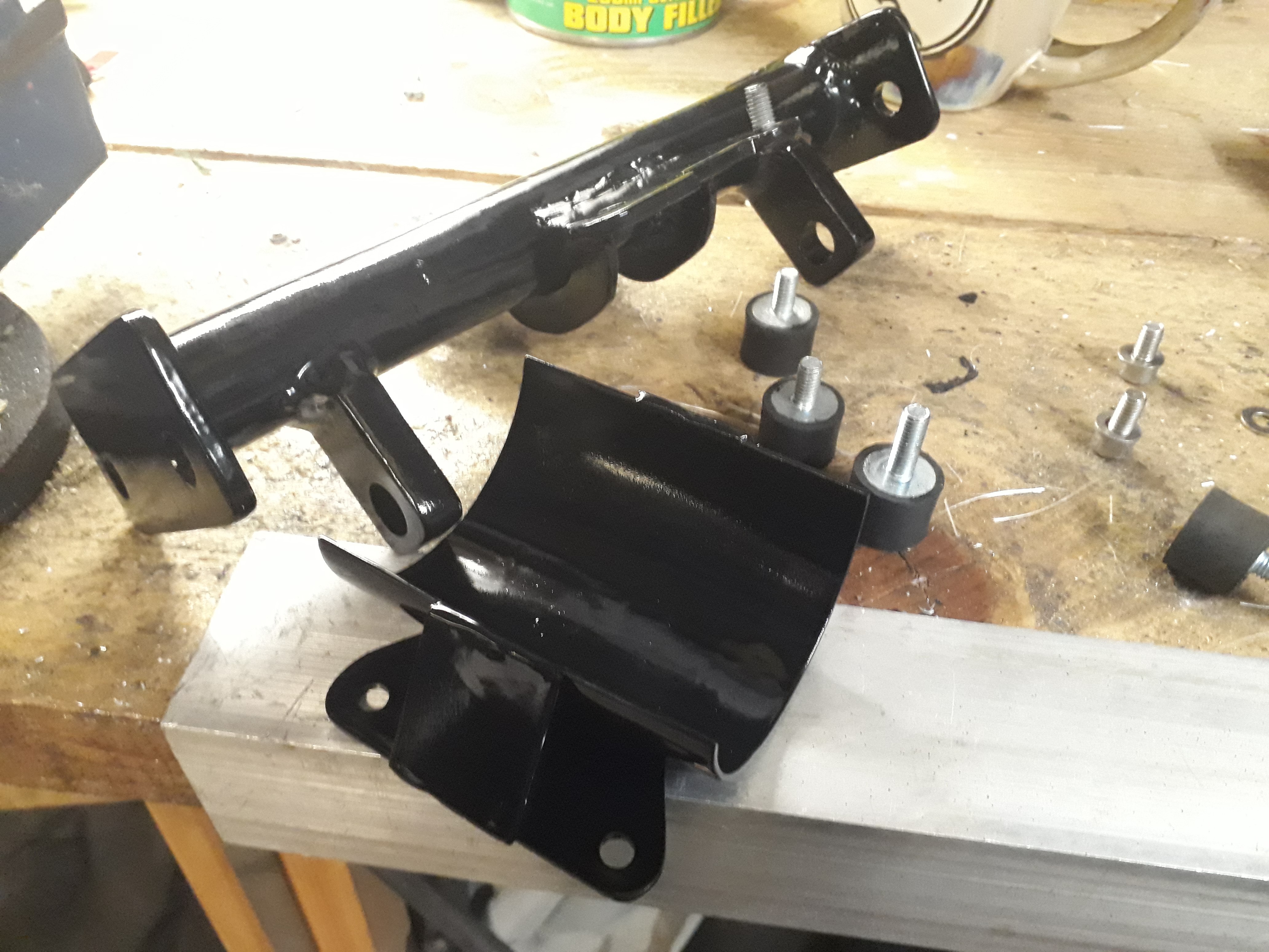

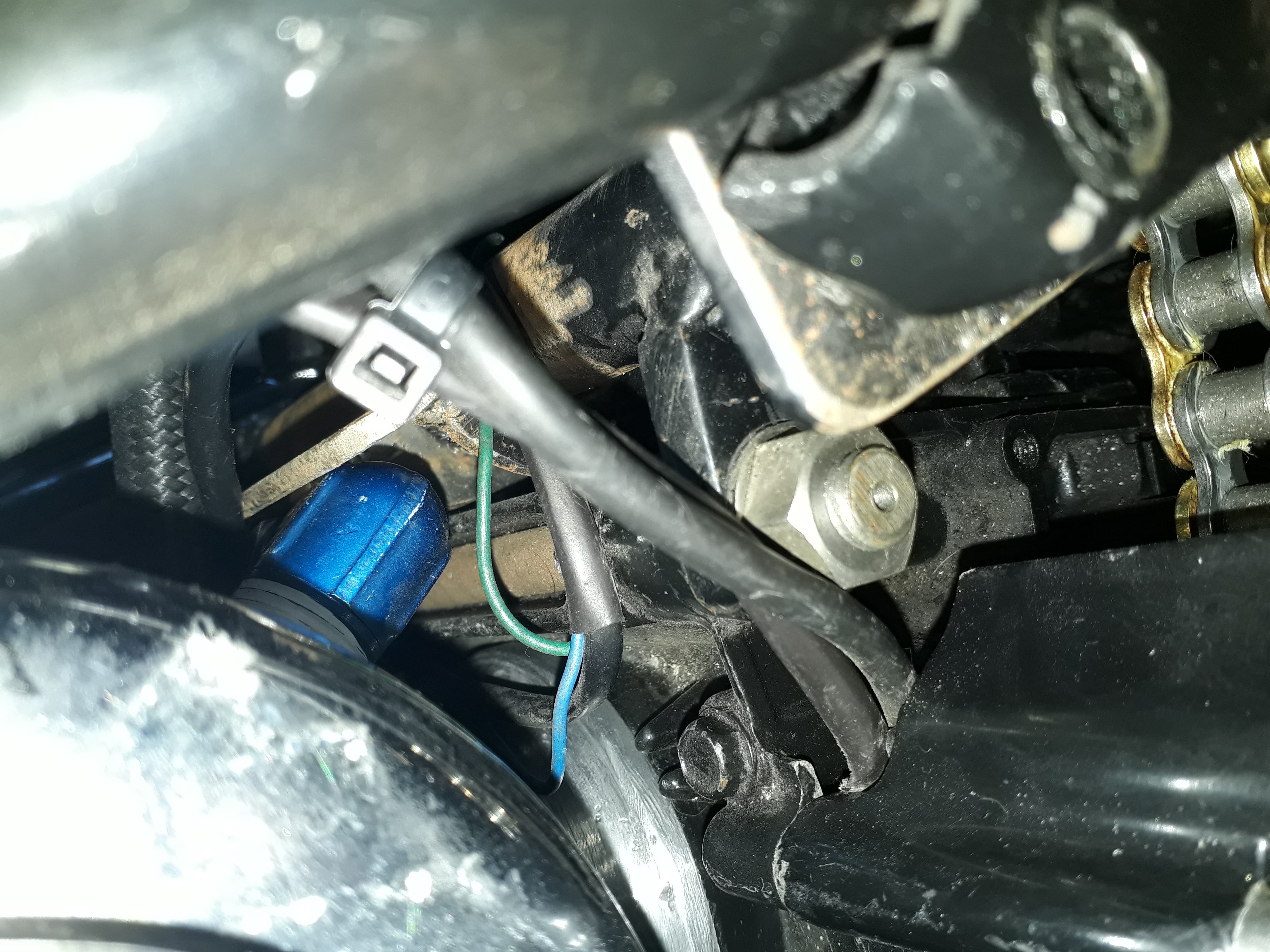

#233 PostAuthor: MDM » Tue Nov 24, 2020 9:56 am
The oil return fitting on the turbo was very, very close to the bracket on the rear engine mount that holds the oil pump. So that needed clearancing, and the bracket needed a threaded stud welding on it as there wasn't enough room for a bolt for the rubber mounting points.
The engine mount, and the mounting support for the pump, were painted while they were out, and refitted. I'd add a pic or two here, but...

#234 PostAuthor: MDM » Tue Nov 24, 2020 10:00 am
Ahah, I remember now...
clearance issues...

#235 PostAuthor: MDM » Tue Nov 24, 2020 10:01 am
And the modified rear engine mounting that has the bracket for the oil pump mount and the pump mount itself...

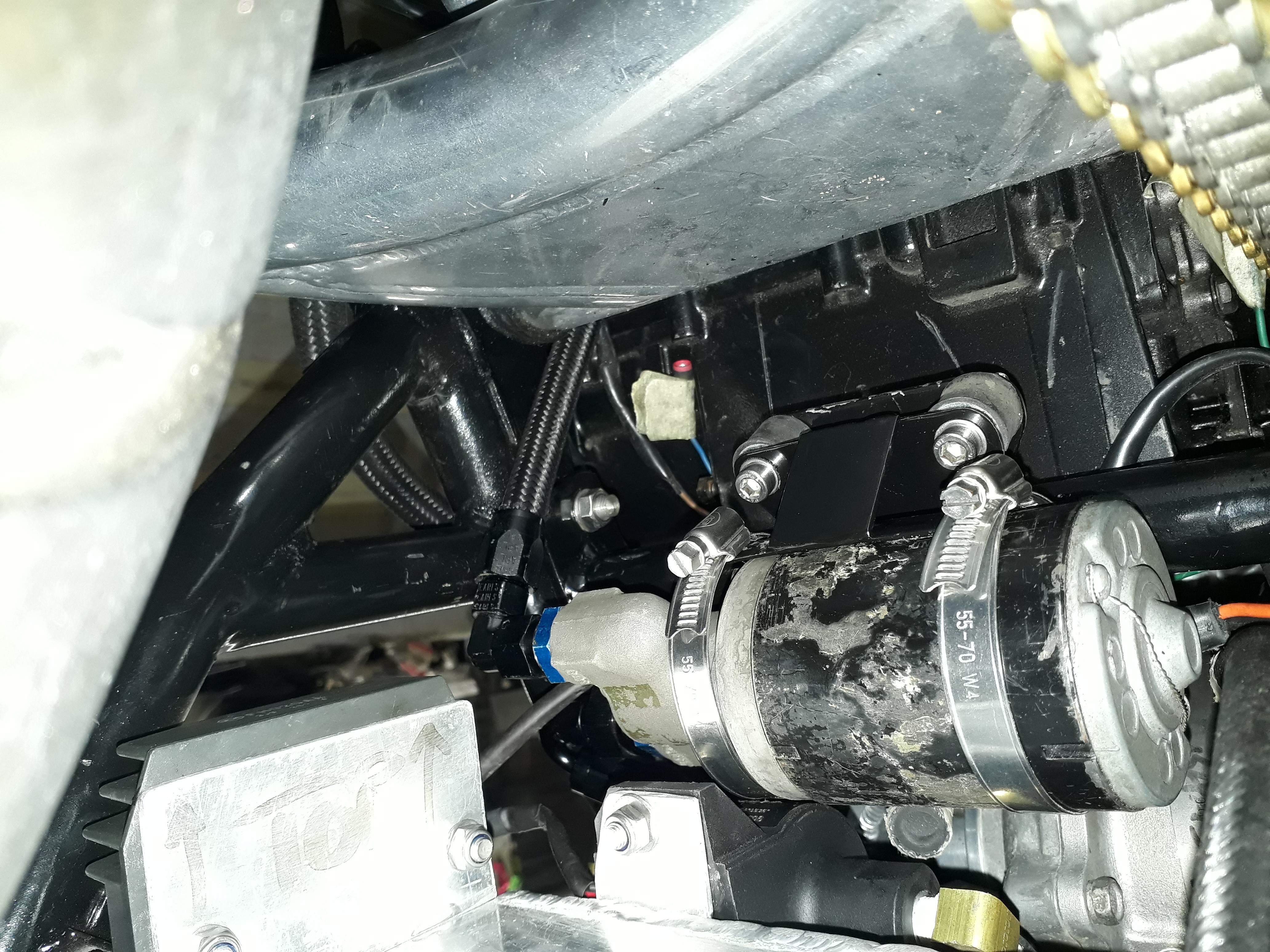

#236 PostAuthor: MDM » Tue Nov 24, 2020 10:03 am
And the pump re-mounted in place...

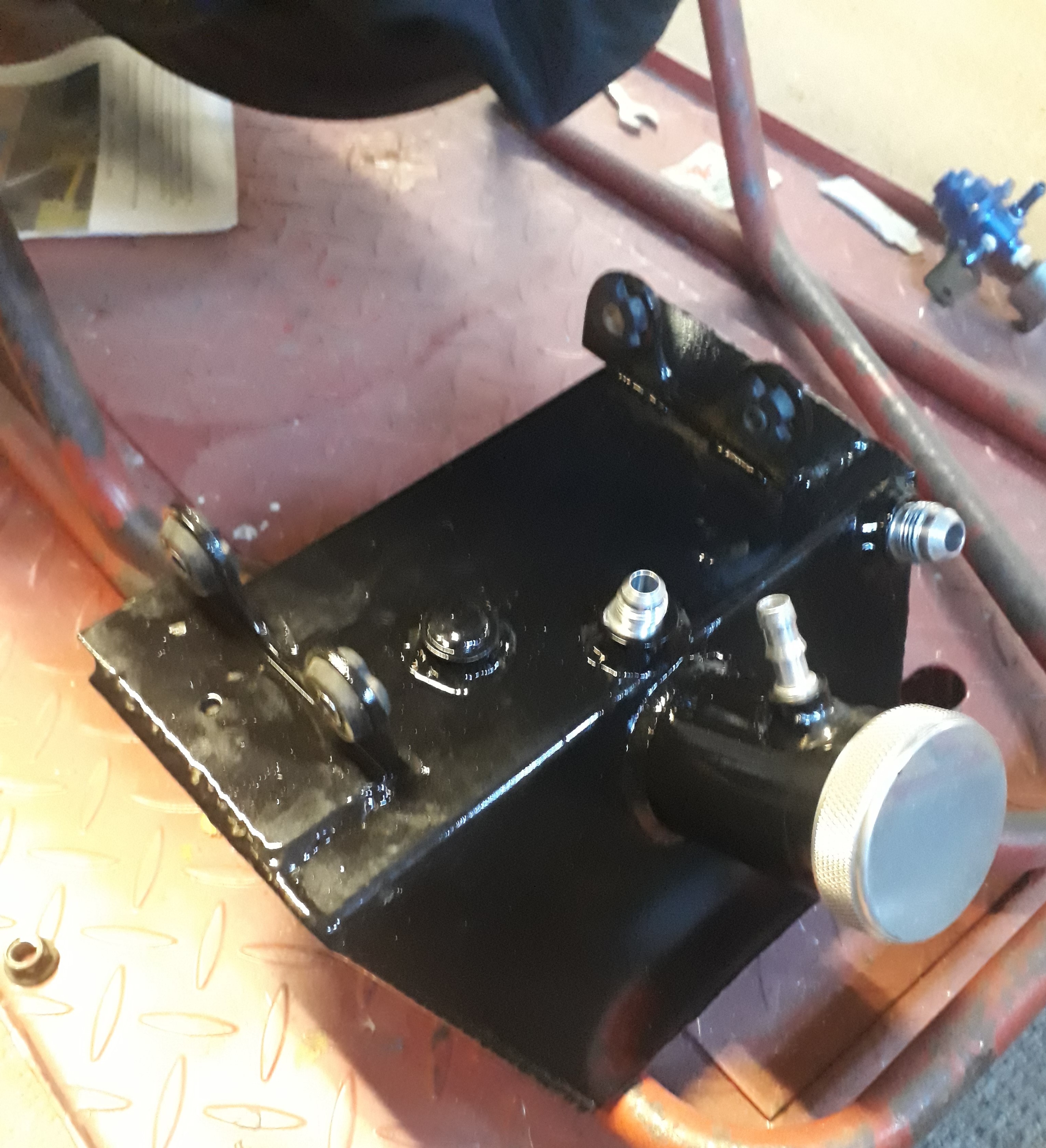

#237 PostAuthor: MDM » Mon Dec 07, 2020 12:22 pm
Oil tank repainted after having one hole bunged up and a coupe of AN8 fittings welded into place.

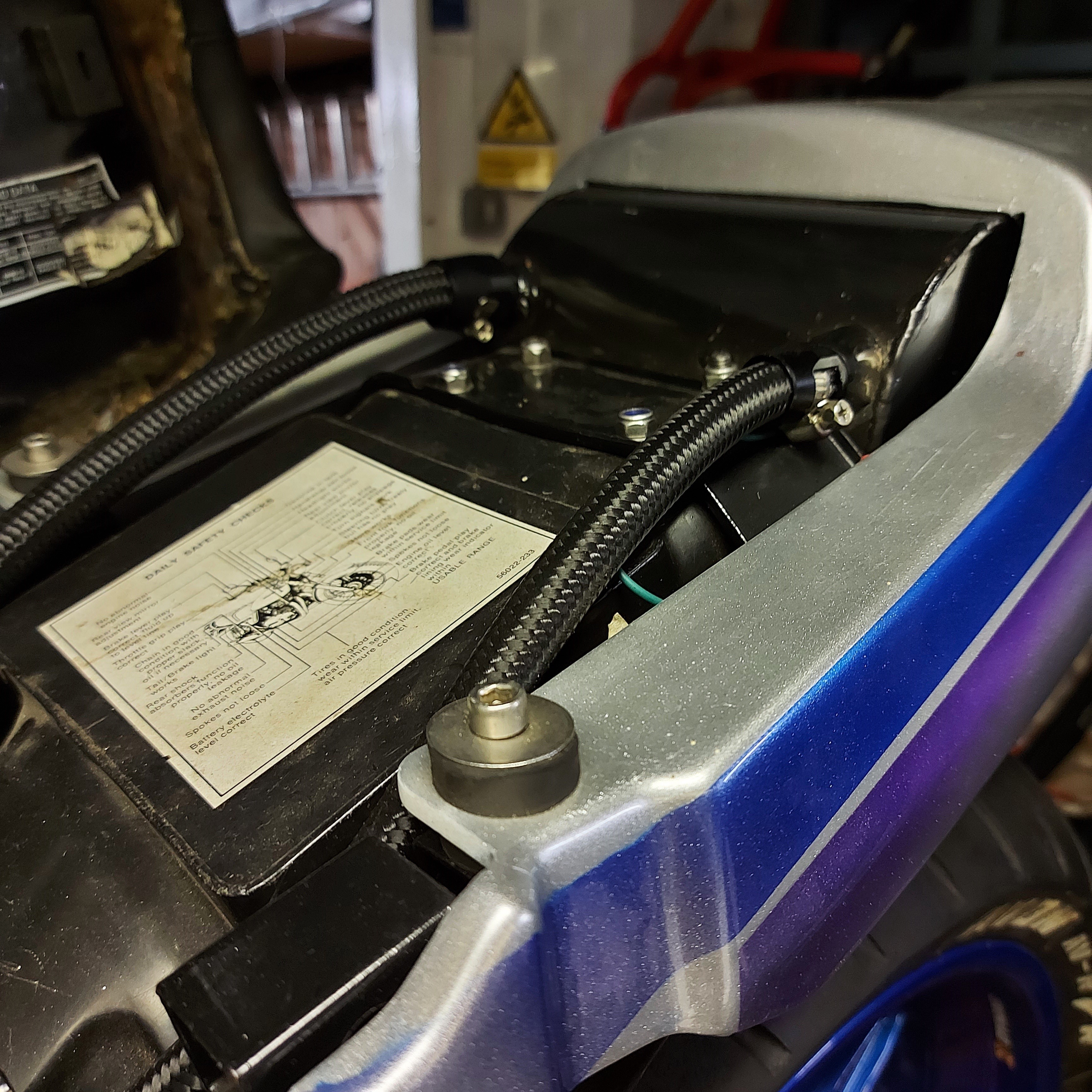

#239 PostAuthor: MDM » Mon Dec 06, 2021 12:42 pm
And while it has been a very long time since my last post on this thread, I did spend some time on it yesterday, sorting out engine breather hoses... I might even take some pics next weekend (don't hold your breath)

#240 PostAuthor: MDM » Mon Jan 03, 2022 11:09 am
Breather hoses sorted at last...
