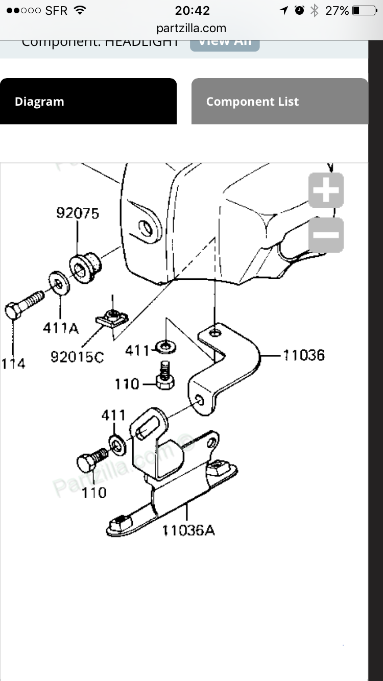

This is the std setup I'm using,

Lee. This is what would normally fix the fairing and would be where you get your datum point. If everything starts from the bottom yoke you would get everything else lined up.
I made my own based on this as I had to space it out.

Thanks Chris, that makes sense. Will have another bash today and see how it goes. Cheers!

Chris, this has been super helpful, now I am getting somewhere. Any idea how much standoff on the splitter as standard? I don't have the original any more. I'm measure I need something like 70mm standoff which seems a lot more than a splitter would be, but that said I guess the yokes are a different shape from standard.

I mounted mine against the bottom yoke but used the rubber and dowel mounting as in the battery box or tail piece. Therefore it's only 5mm from the yoke. The splitter sat on top of the dowels.

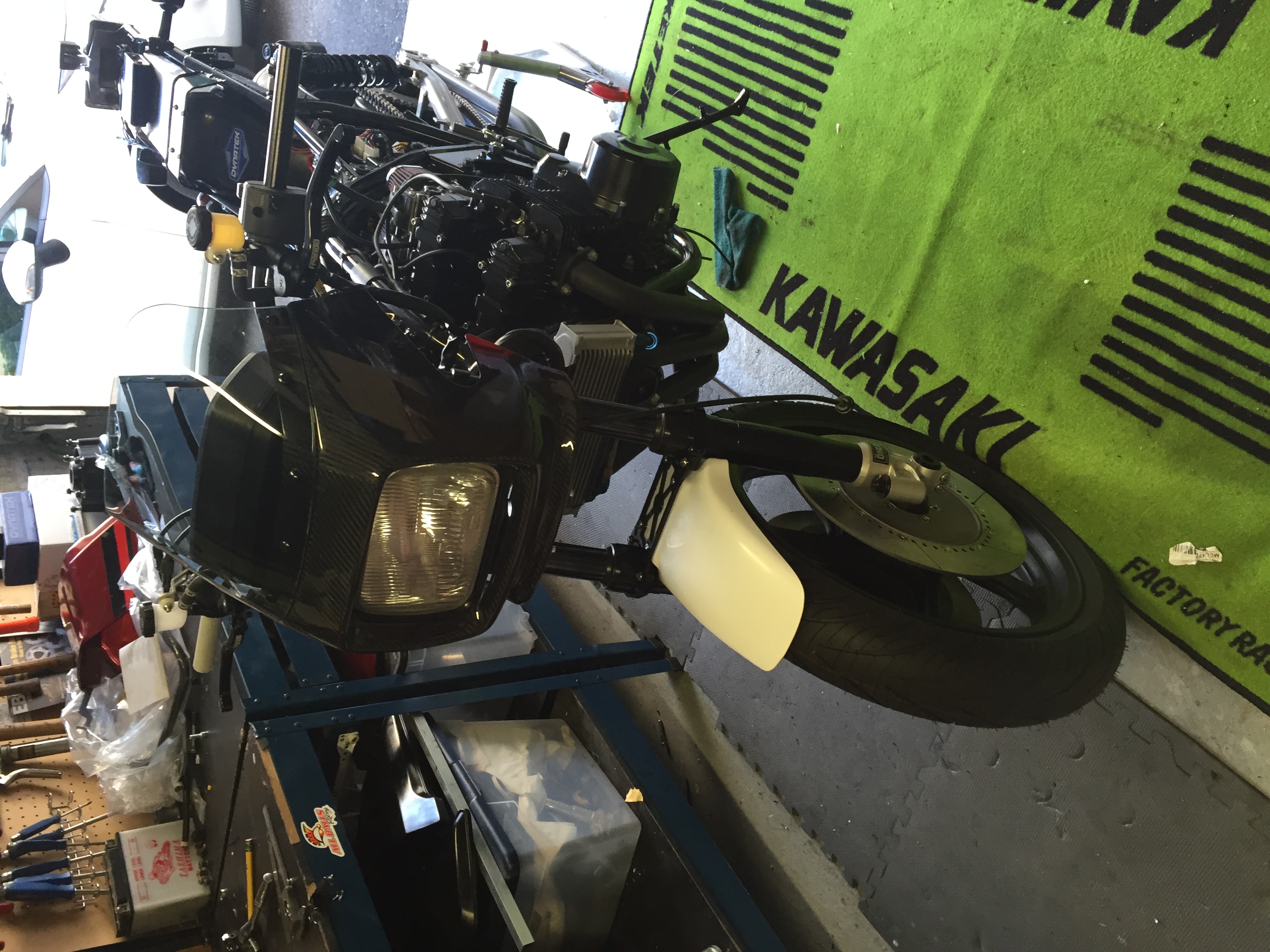

Anyway now I have the fairing pretty much lined up and I think the headlights brackets will work after all.. still have to finalize where to mount to the yokes because the zephyr ones on it don't have the pinch bolts at the side, but I have a plan.. for now I'm happy enough that I can take the bodywork for paint finally... So planning to take a day off this week and go see the painters..

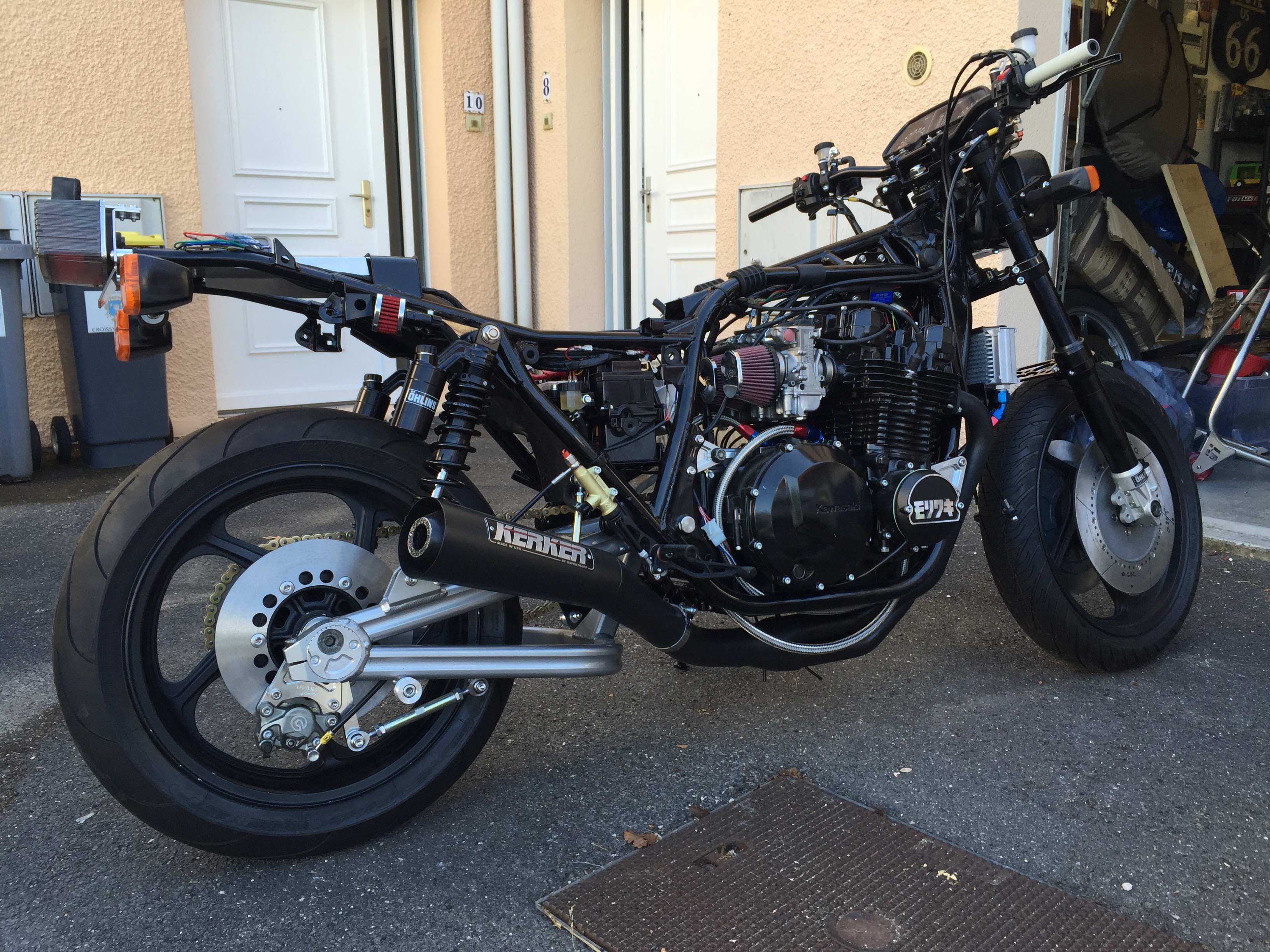

Since I'm still in limbo as to what will happen to me at the end of the month with work I decided to take a couple of days off to do some important stuff :) Plus I thought I better finish this project before I get shipped off somewhere else and it got lost in storage somewhere!
Went over all the electrics today and sorted out few niggles, checked every nut and bolt, fitted indicators at front etc and finished all the other small things you always plan to do later..
So just need my bodywork back now, a few small odds and sods like grips, replacement nuts and bolts and rubbers that I kept forgetting about and front caliper mounts and we are set.
How it stands today.. Can't wait to get my surprise bodywork back! Lol
