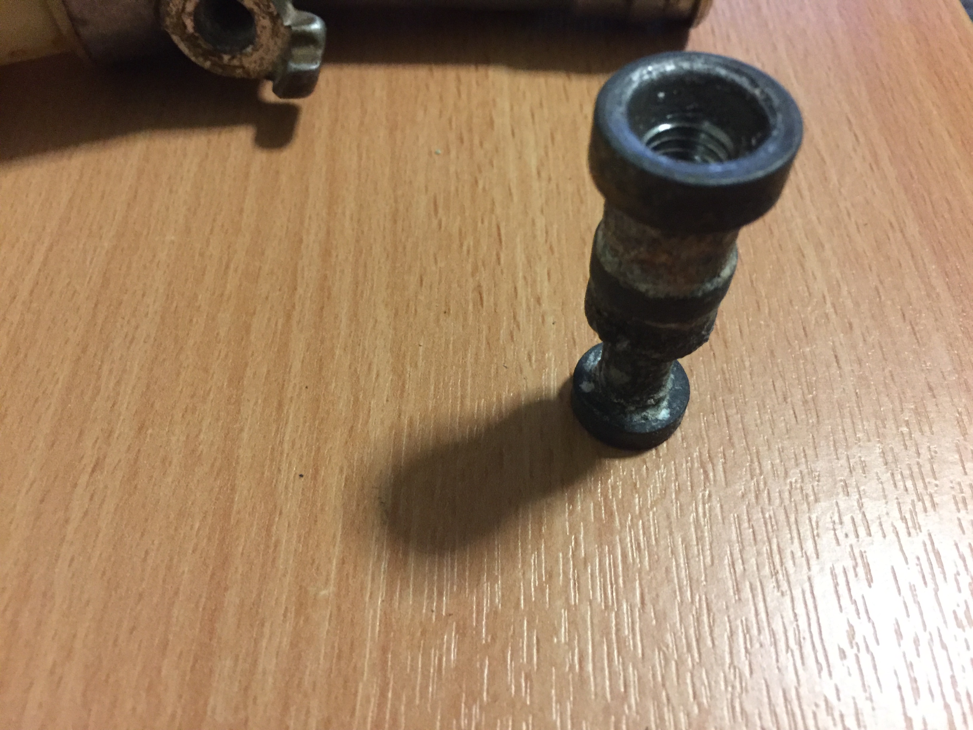

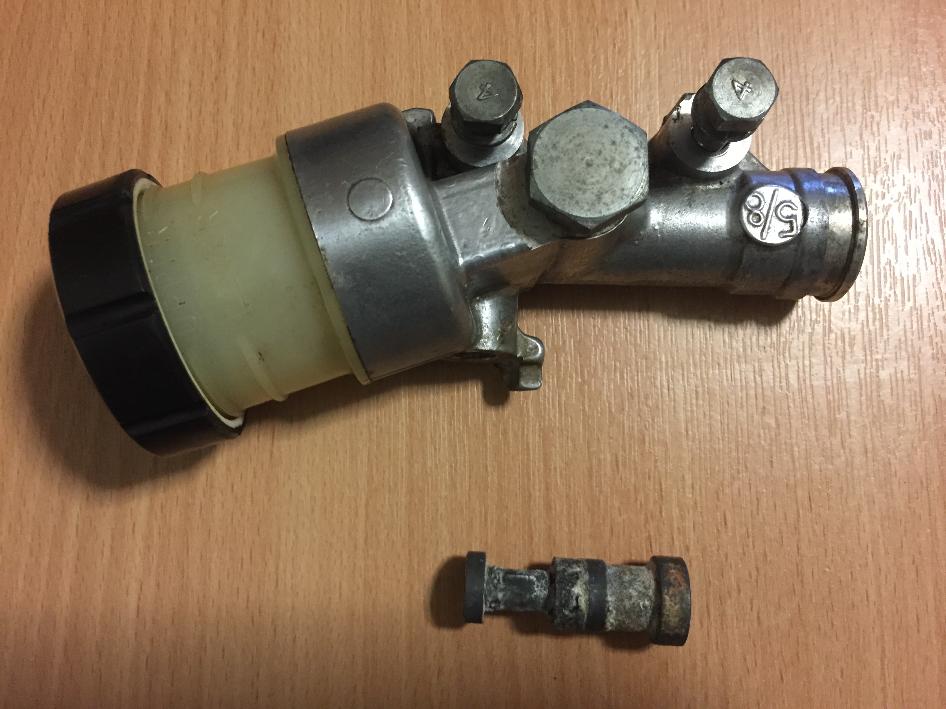

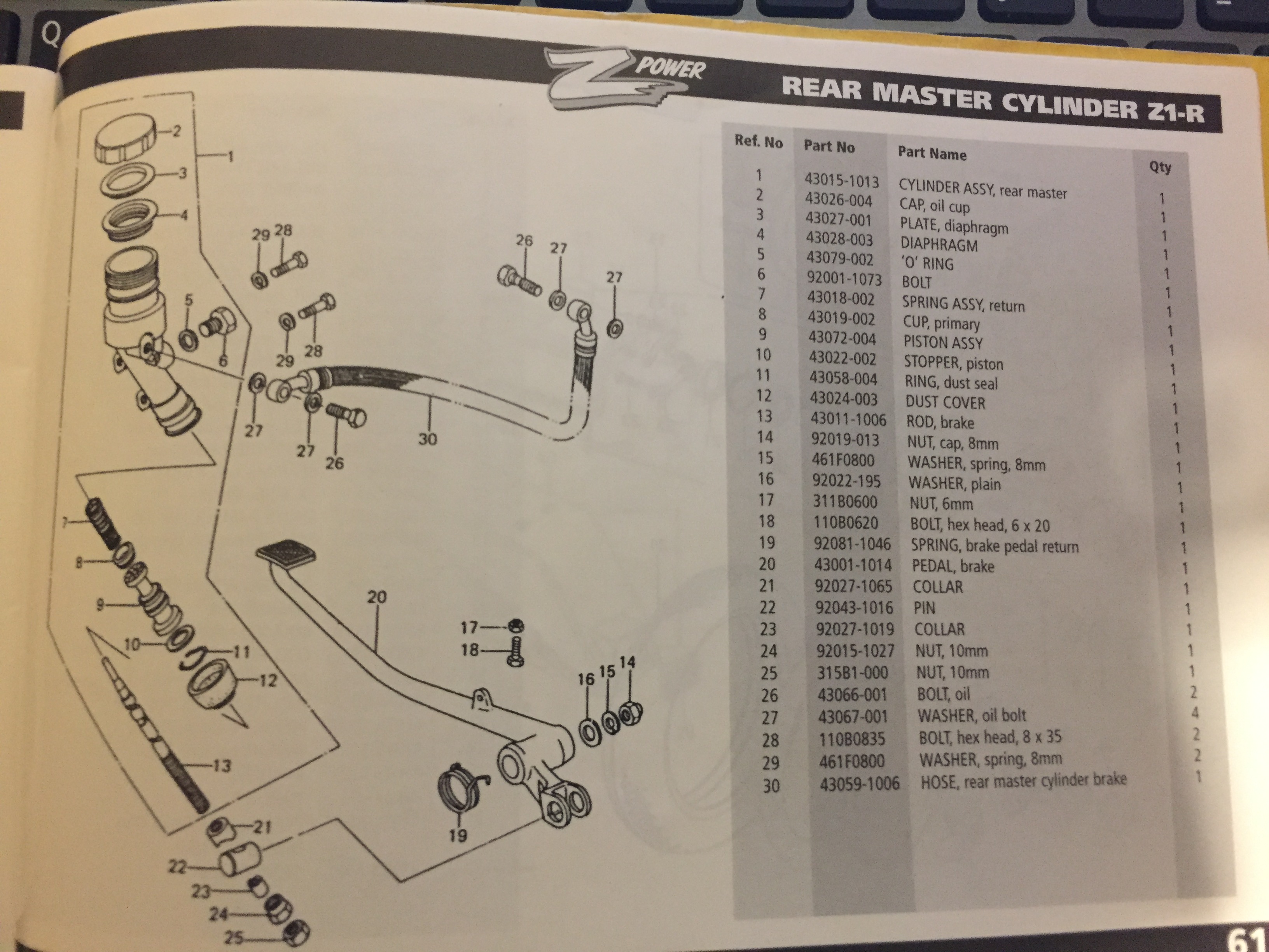

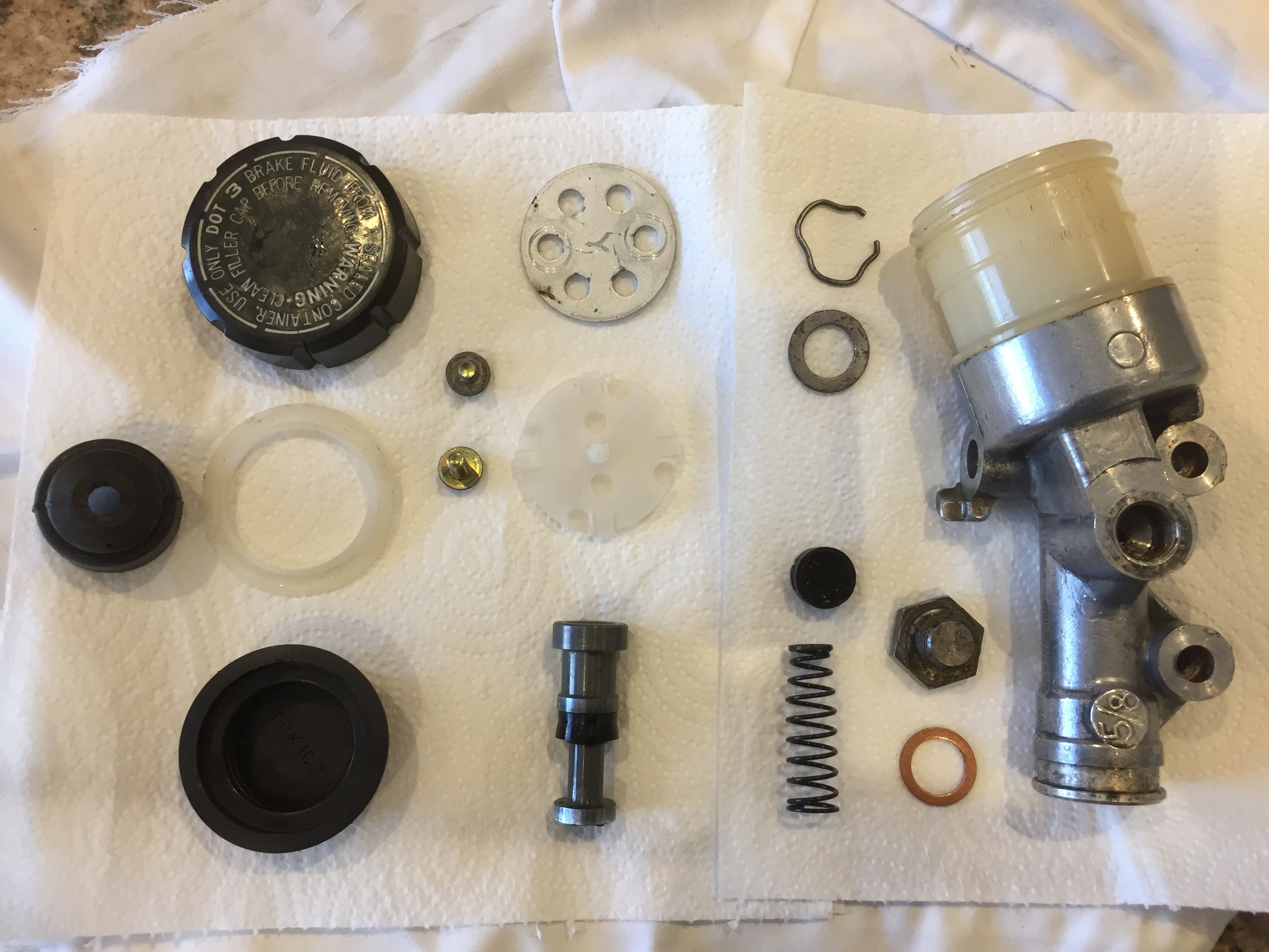

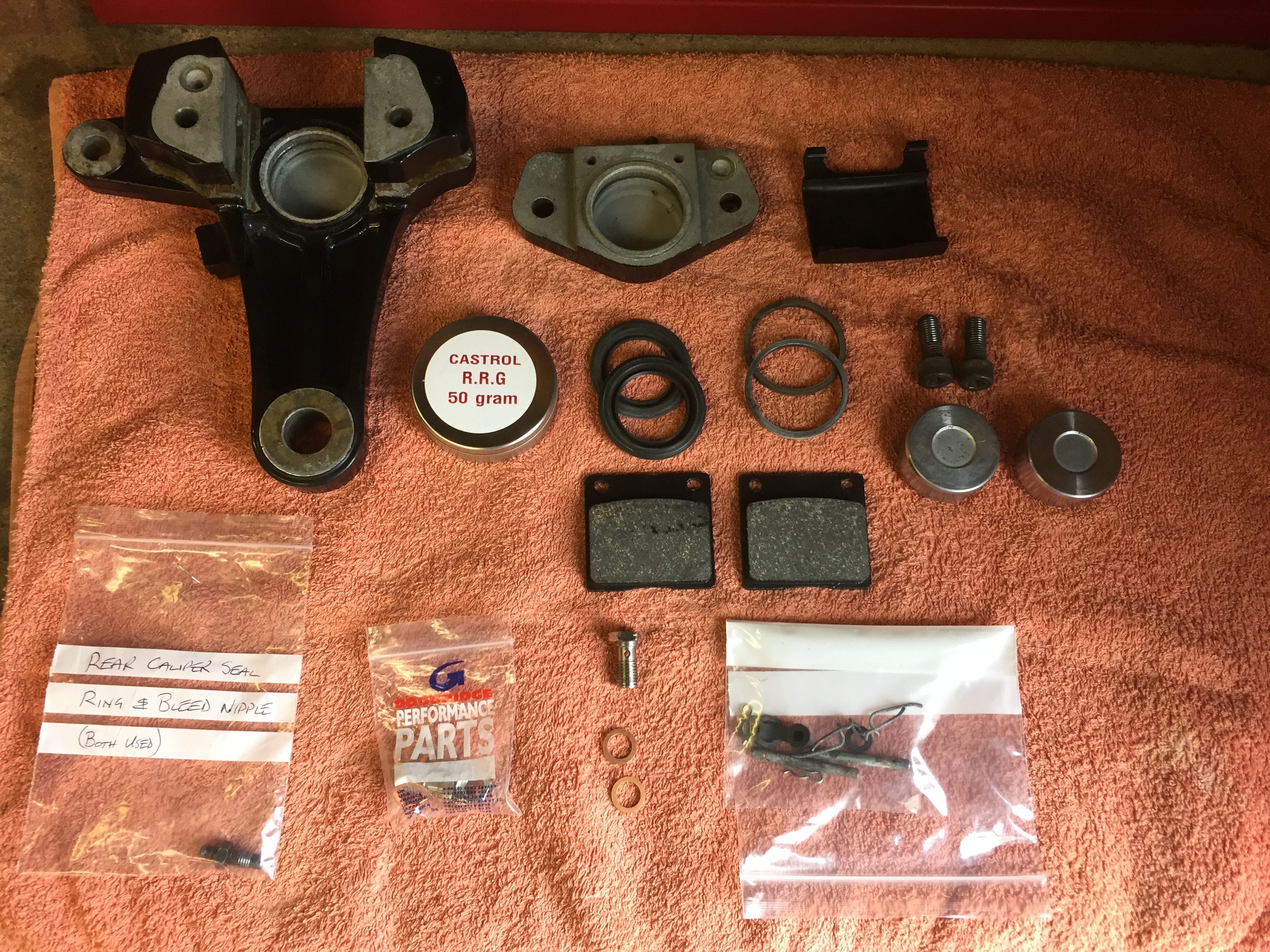

Haven't been able to do much on the bike over the past few months and hit a bit of a wall with progress once I got back to working on it - couldn't get any fluid through to the rear caliper (I'd thoroughly cleaned everything, replaced all master cylinder and caliper internals and fitting a new brake hose). After trying everything else, I finally sorted it by...................... stripping the master cylinder (again!) and cleaning out the two holes under the side bolt (supply and relief ports?).
Rear caliper was stripped again and everything was rechecked
After reassembly, fluid was bled through with a Mityvac and brake seems spot on now - pretty much everything changed for new and the pipe's back on!. On the home straight!

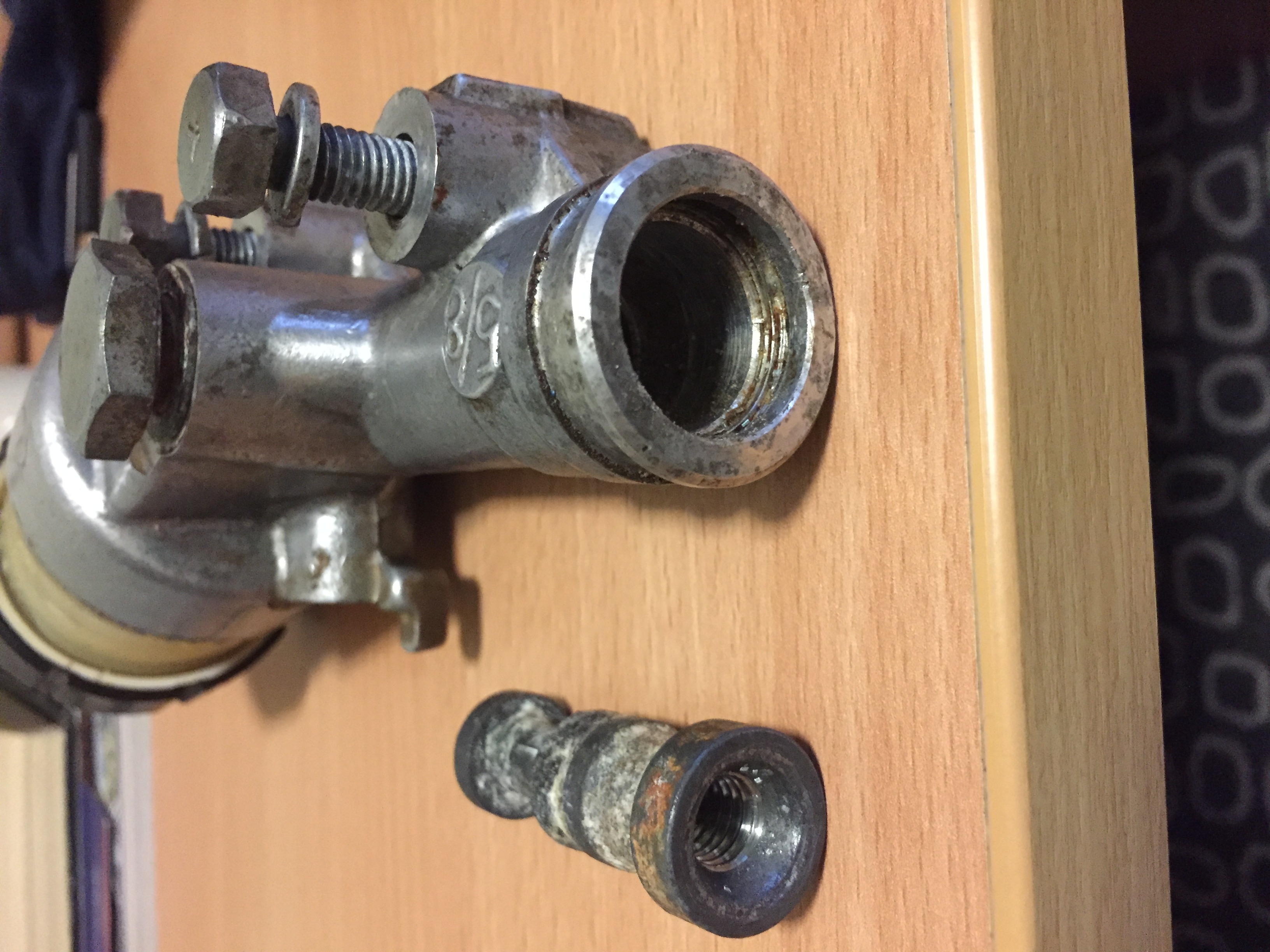

Curious about your rear brake reservoir rebuild as I have one on the bench at the minute that's resisting me a little. The reservoir is pretty old and gungy and I'm struggling to get the piston out under the reservoir. It's presently sitting upside down and had a good dowsing of penetrating oil all over the piston (hopefully getting down the bore. Is there a trick to remove / unseize? I also didn't spot that the plastic discs at the bottom of the reservoir come out.... do these unscrew or just need gentle persuasion ? Can't remember to manual being too useful when I last looked.
I had the same problem with the piston - mine was stuck fast but I got it out by drilling and tapping it.
You've probably got this already?
The plastic disc is held into the reservoir by small plastic tabs - just lever them out of the body (gently!) - Good Luck!

Brilliant - thank you, that is certainly the sort of solution I think I need. That piston seizes well in there doesn't it !
Thanks also on the strip out of the discs from the reservoir cup. I was thinking of this just to make sure that I thoroughly cleaning any crud out of there. Will probably review once I shift that piston out and see if I actually have a problem. Looks easy enough with care, hadn't spotted the plastic tabs keeping it all together.
Many thanks for the help Bobby

No probs mate - just remember to clean out the two holes under the side bolt (think one is the supply port and the other (smaller) one is the relief port. I cleaned mine out with a set of safety pins I bought from my local hardware shop for a quid - after trying wire brush bristles and cable strands, that worked a treat! Good Luck

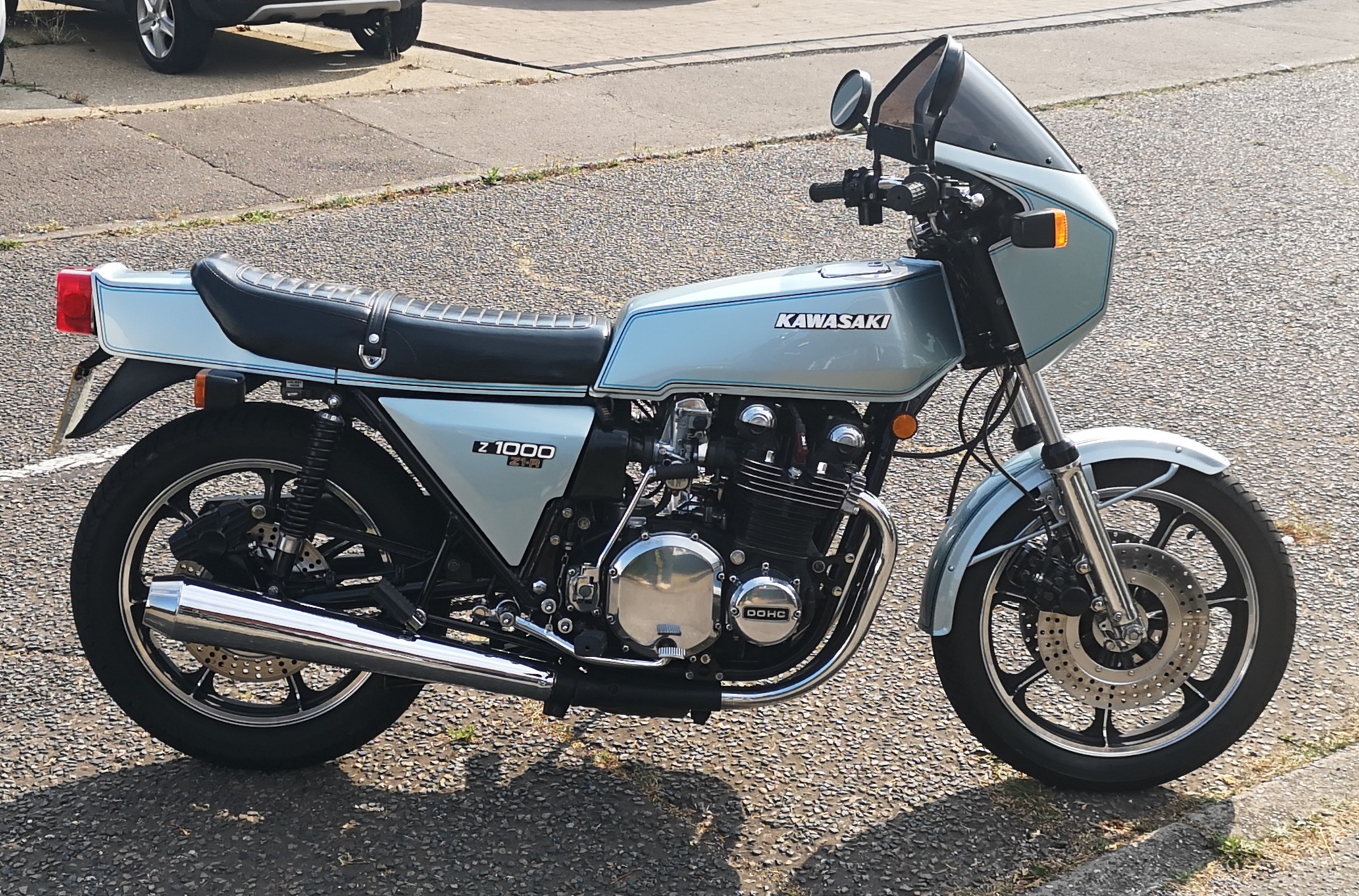

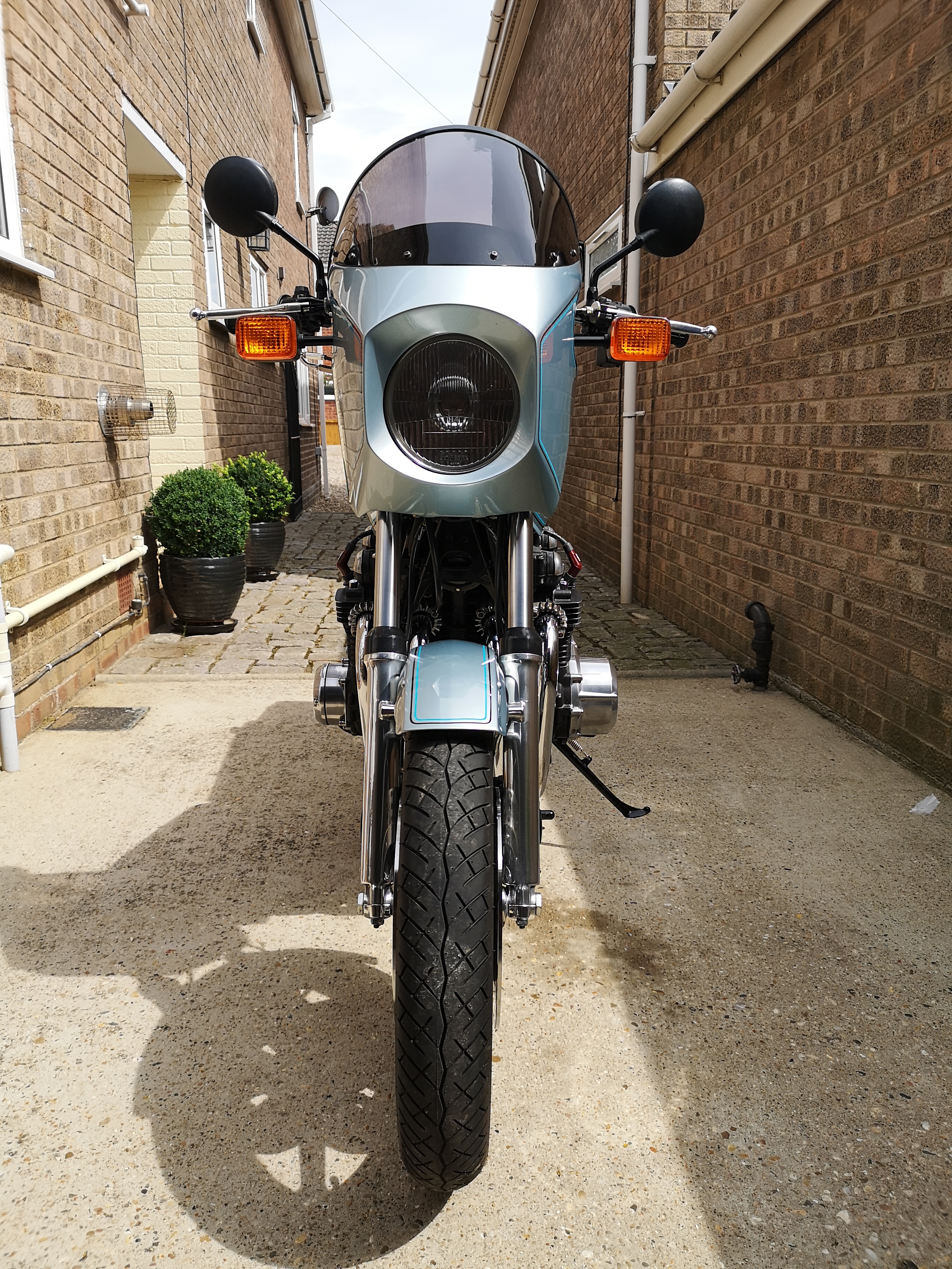

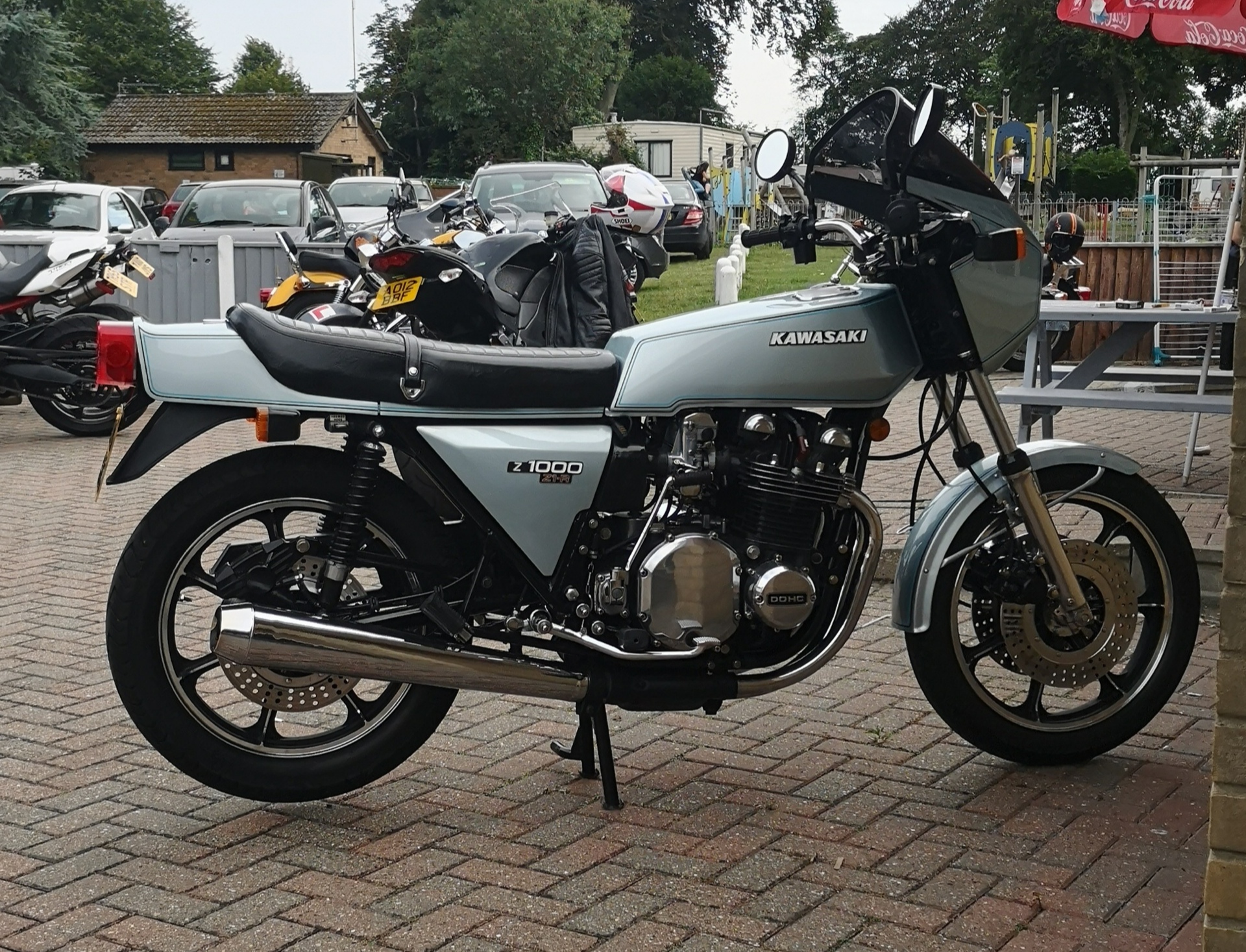

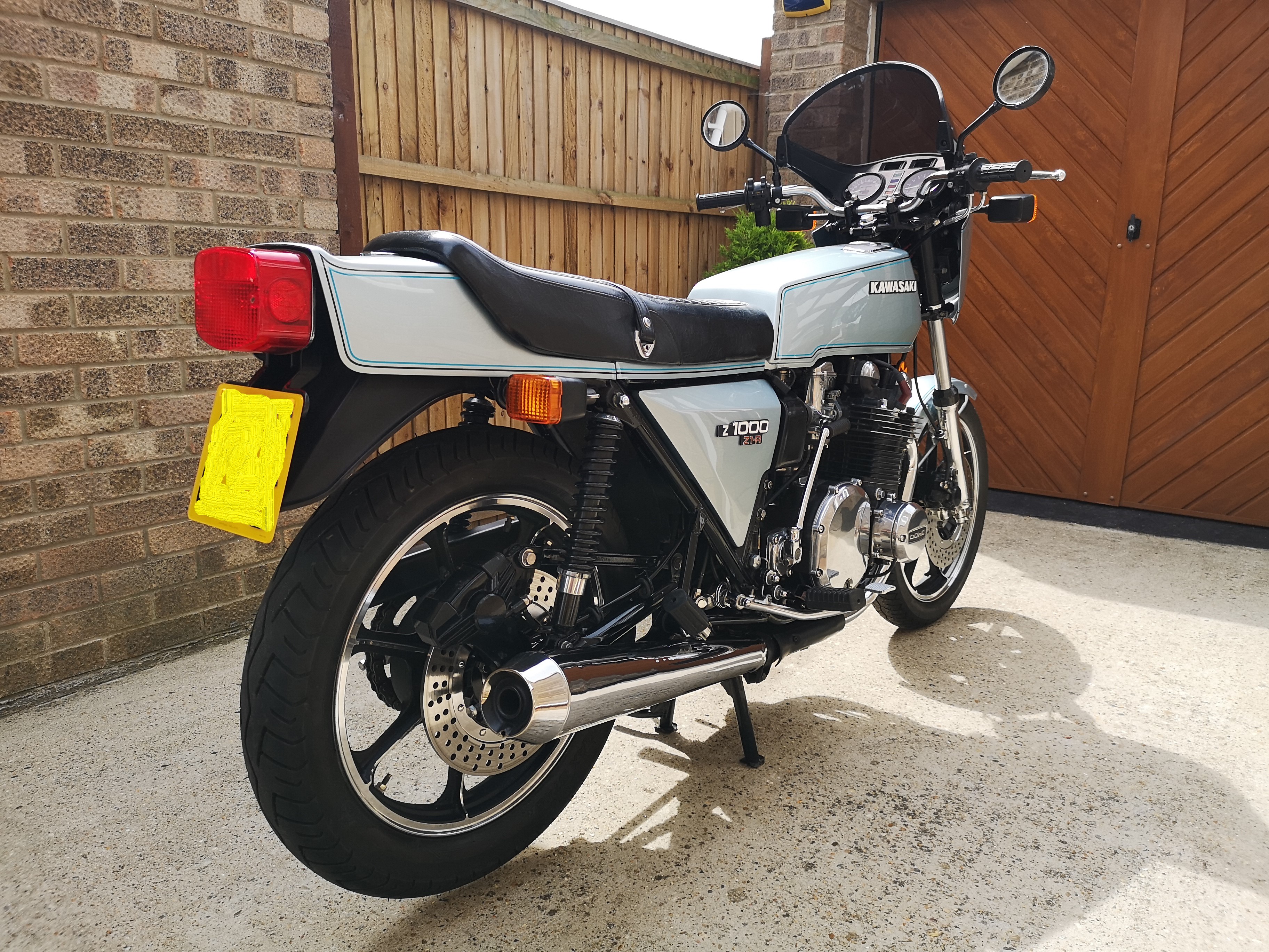

Re: Z1R - The Work Begins!

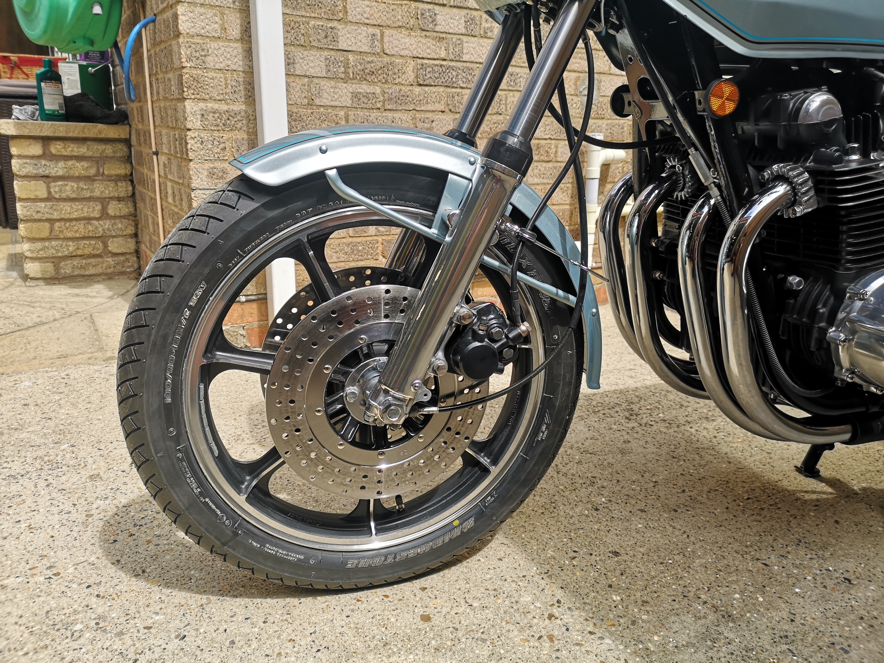

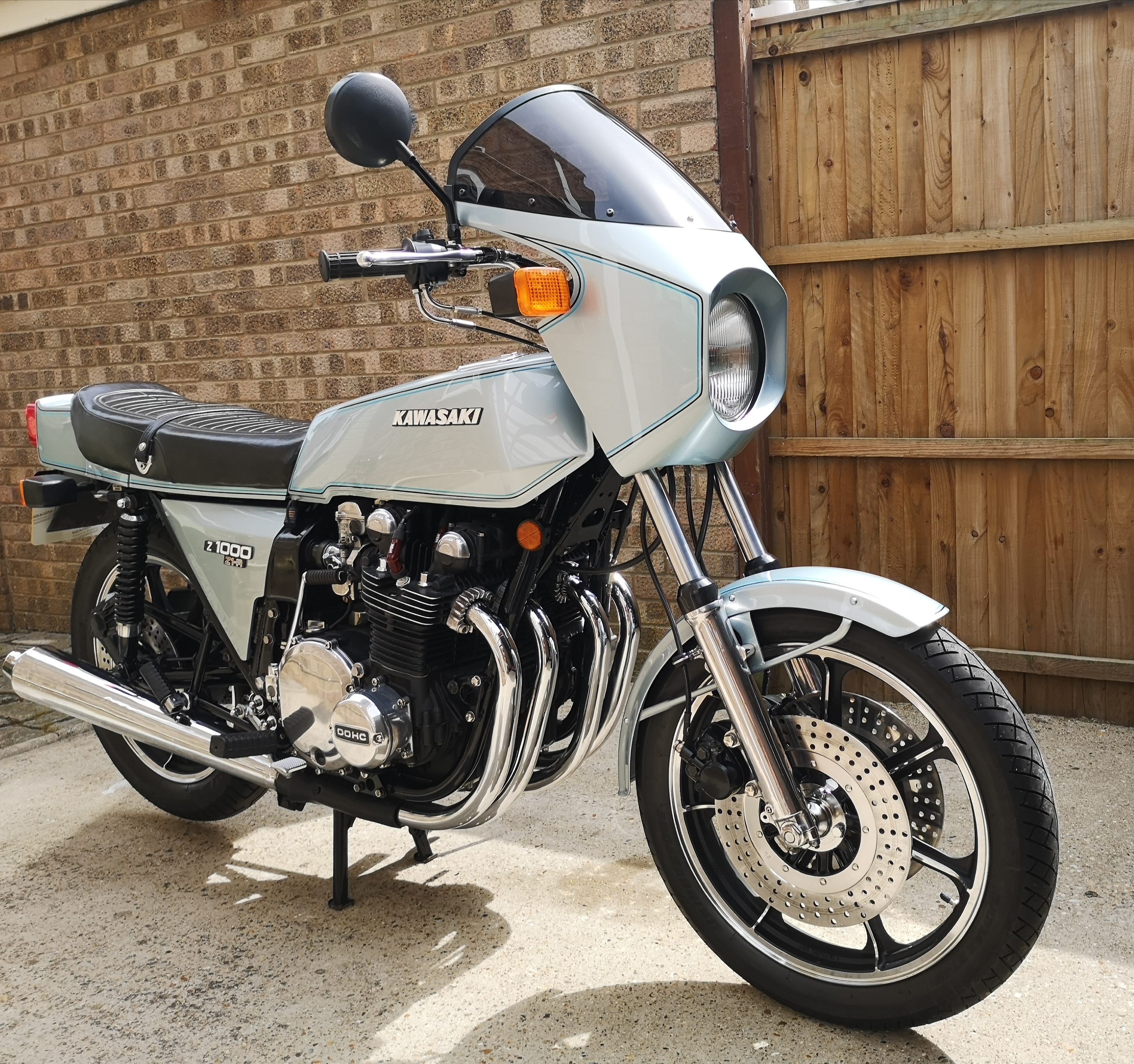

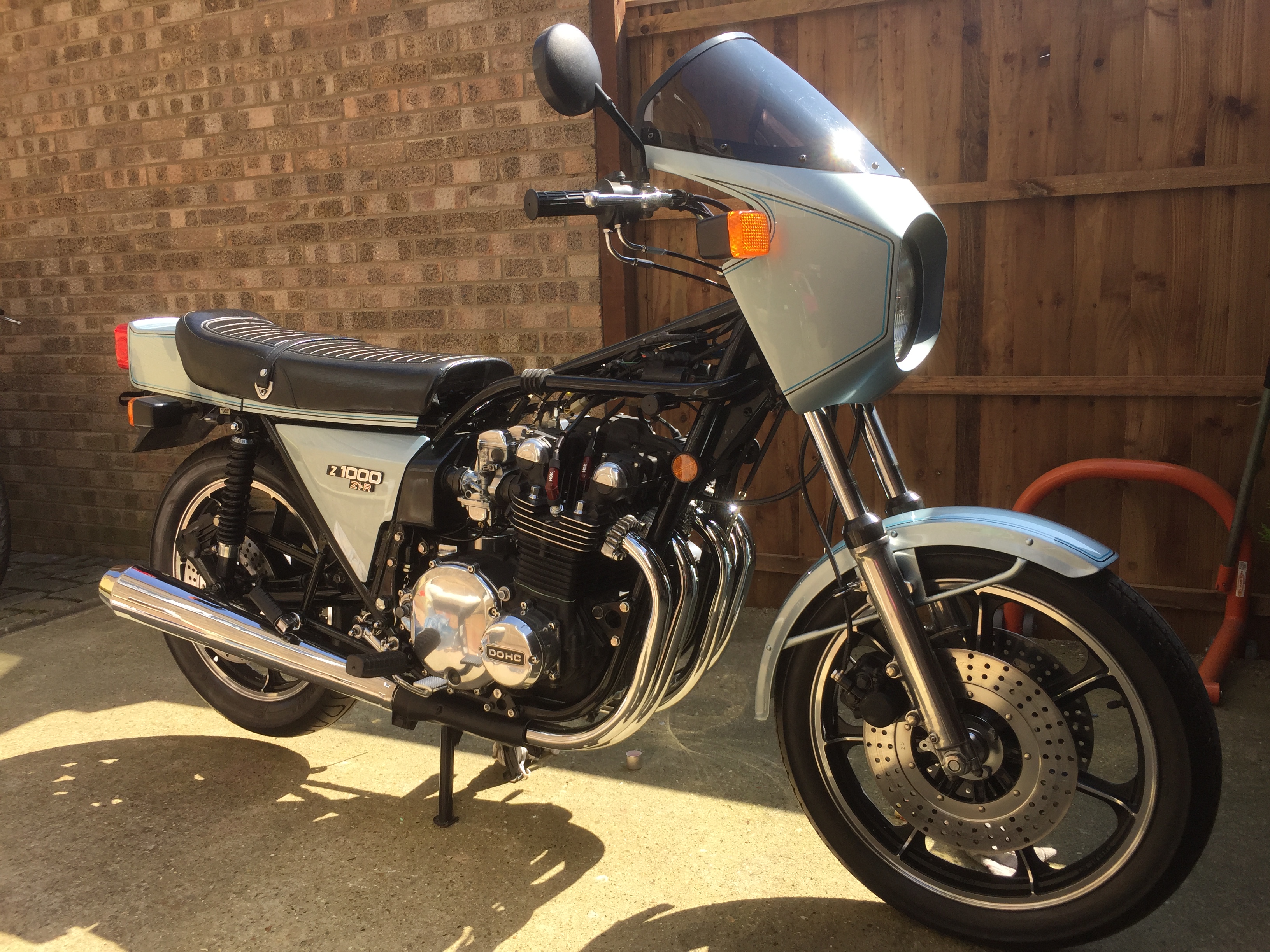

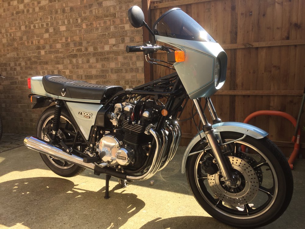

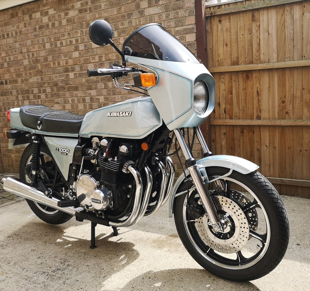

Well, it's taken me a while but I finally got there!
Apart from a couple of minor cosmetic bits, the Z1R's finally finished and I've had a brilliant Summer on it!
I've always 'tinkered' with bikes in the past and had a (relatively small) bit of mechanical knowledge but never attempted anything at all like this and after my first post
, it's fair to say it's definitely been a very steep learning curve!
I don't post on here too often but the knowledge and information gained from this site has been invaluable so thanks to all that have helped along the way. Got plenty of pics of the bike at various stages of the rebuild and didn't know what to put on here so attached a few of the 'finished' bike. Anybody want any more - just let me know.
There were plenty of times when things didn't go the way I wanted them to but all I'd say to anybody else in a similar position to me when I started is take your time, take pics of everything and go for it! If I can do it - anybody can
