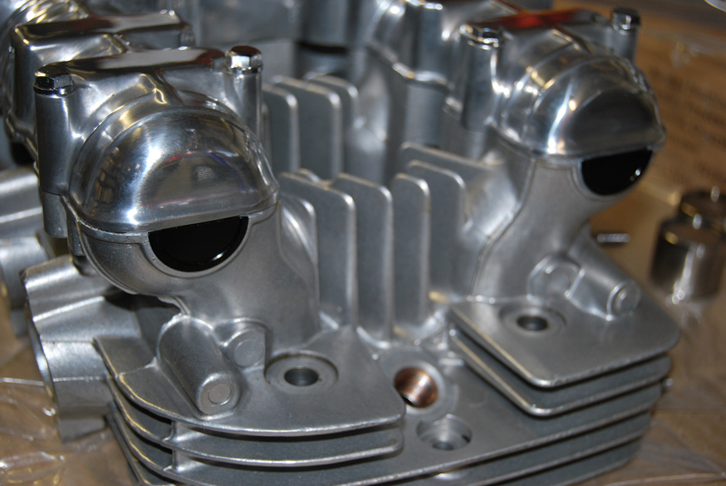

Quieter now at work so I had time to finish the prep on the head.
Mikey's polishing on the cam cover, new bolts and a set of PMC black alloy cam end plugs - sure does give the desired effect.
A couple of hours of rubbing with duck oil managed to remove most of the staining the machine shop left me with.

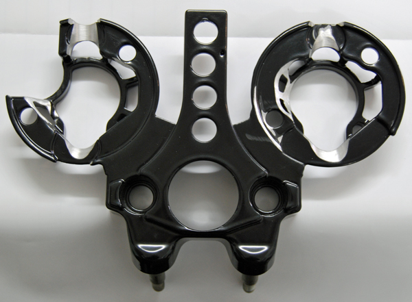

Half hour with the blast cabinet saw the sprocket bolts and yoke brake splitter ready for primer.
Sunday was a day of five mins here - five mins there, but still managed to make steady progress.
The blasted brake splitter was given a couple of coats of satin black spray, a couple of polished stainless bolts and on it went.

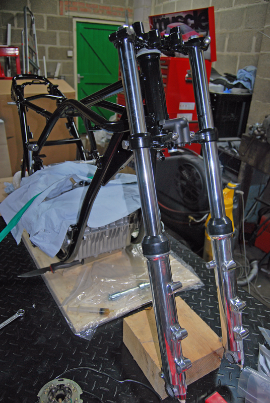

Managed to get the forks in place - two less things to trip over..

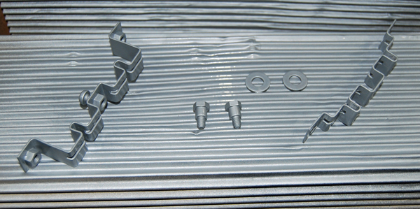

Using pattern gauges requires a few modifications to the original bracket.
Worth the effort as they now sit straight.

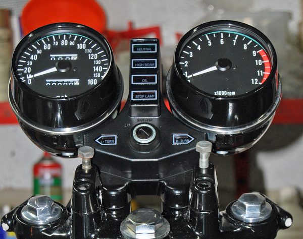

Pattern gauges + loom, lower covers, idiot light covers and lock set.

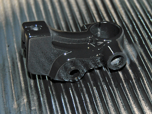

The scabby clutch lever perch got a trip through the blaster and coat of paint.

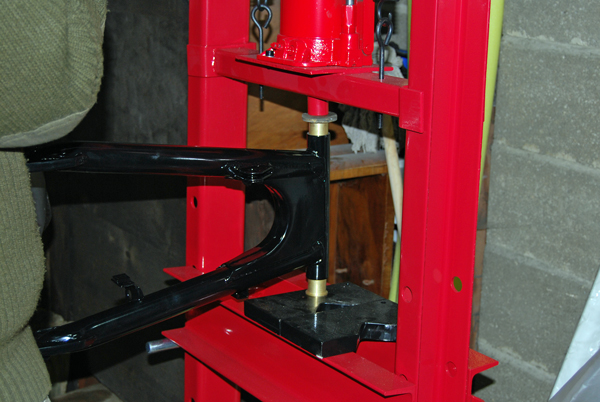

New bronze swingarm bushes got pressed in..

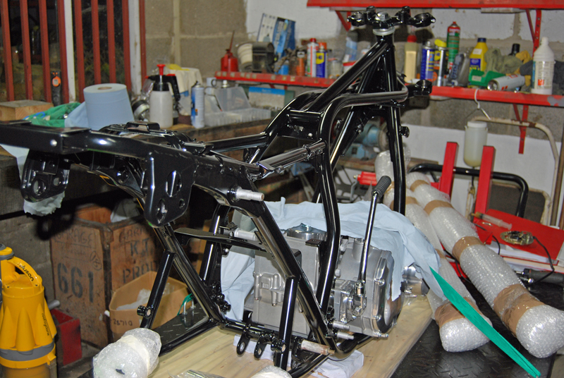

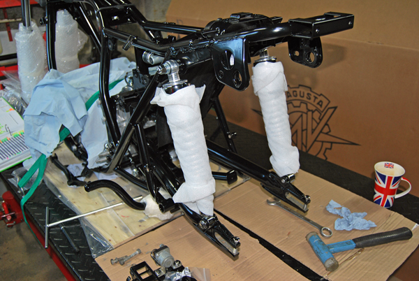

Half hours work on Sunday saw the centre stand fitted along with the swingarm and shocks.
Long way to go
Long way to go

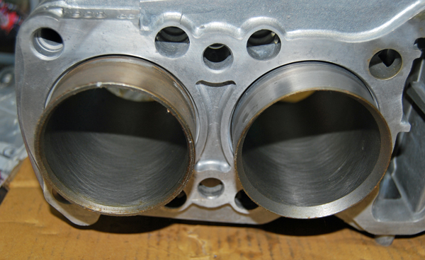

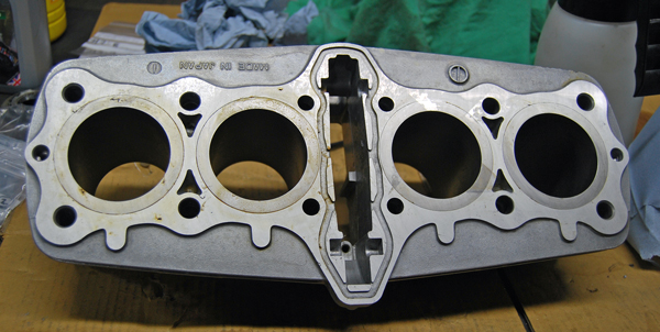

I collected the cylinder block from the machine shop, the new liner is difficult to tell appart from the others.
To recap the liner was from webike, the machine shop said it was a repair liner, 1mm oversize in almost every way, bore measured 65mm.
Liner was turned down to the correct outside dimensions then bored and honed with the others - the new liner sat approx 1mm proud and was skimmed down with the others.
Notice the ring lead is also deeper cut on the new liner.

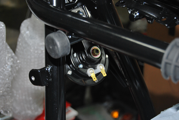

The original horn had a broken bracket and didn't work - Dave's (Saisei) replacement looks pretty darn smart - nice and loud too!

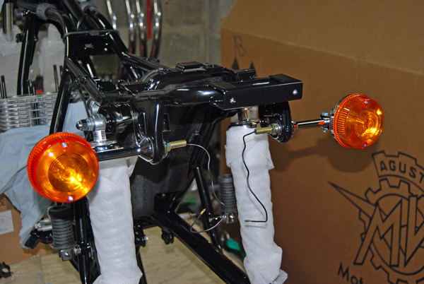

As the beast didn't come with any rear indicators - a pattern set will have to do - as said - it's not going to be rivet counter original.

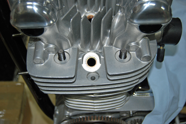

Things were going well so I was keen to get on - all I've got to do is - head off - double check piston protrusion - gasket on - head on - happy days!!!
At this point I was about to regret my choice of studs!!!!
On fitting the head - all the nuts bar the nearside front span on by hand - this one required a spanner at first but freed up a little as it went down- they all then tightened down without issue - the same cannot be said for undoing them.
The nearside front nut turned 1/4 of a turn then locked solid - further pressure unwound the stud, once removed I had to fight the nut off using a vice and a heavy duty air gun, the pic shows the damage to the stud - the same was true for the genuine nut!
As the pic shows the stud was missing part of the first thread coil, It had not bottomed out on the nut and the installation height was stock - (I had used a washer on each stud to take up the missing gasket height).
As shown in the above pic - I re-installed the nearside front original stud to check the installed height - measured the internal clearance of both old and new nuts - all spot on.
On inspecting the other studs they too didn't look good around the top thread coil, with nagging doubt creeping in - I decided to replace the APE studs with a set of genuine ones - after all - the original studs were good enough for the first 38 years!!
I had tapped the crankcase threads after the ceramic cleaning - but I'm kicking myself for not thread chasing the APE studs before the build, at some point during installation the first 1/4 of the coil on the No2 offside rear stud has clearly fractured off and somehow got mashed into the thread - nice!
I should have smelled a rat as the studs were a little tight on installation - some a little tighter than others.
