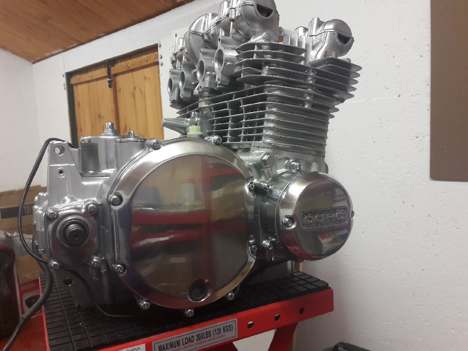

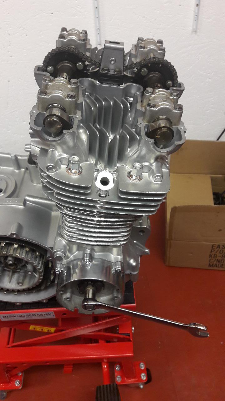

Last Update this year I guess :lol:
Why is it so satisfying when you get to try the tank on for the first time :D
Engine coming along nice at Buzzworkz (Z1 Club Buzzard)

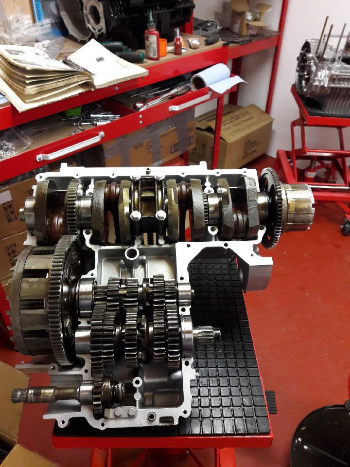

#32 PostAuthor: BigZCas » Mon Jan 22, 2018 9:28 am

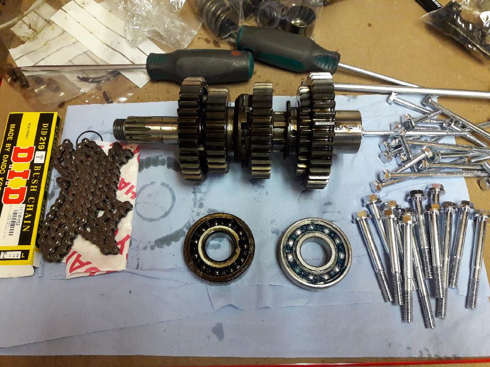

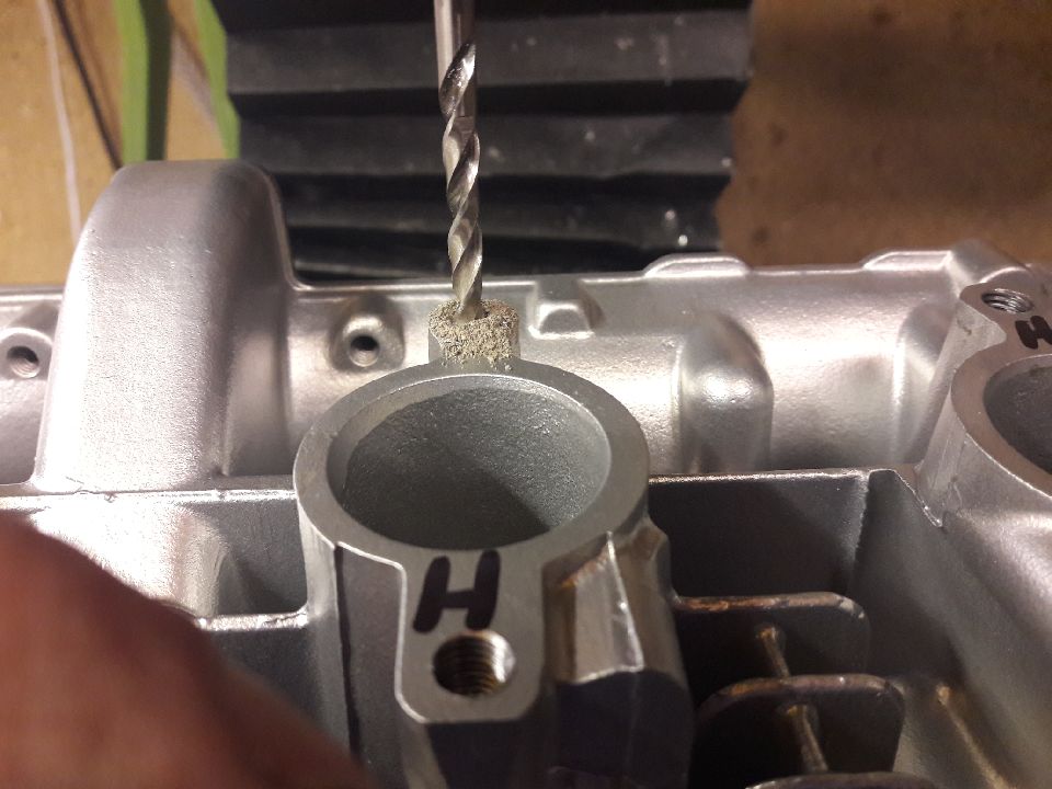

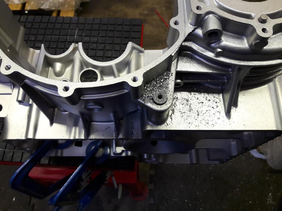

Some nice reference pictures :)

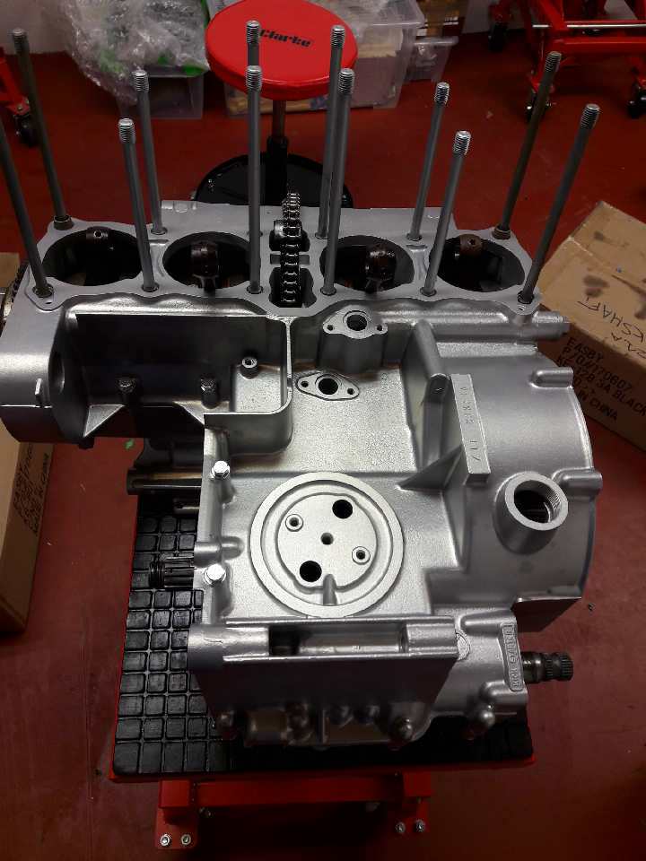

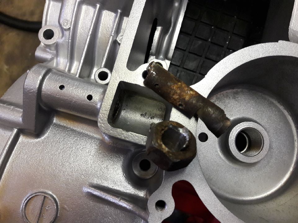

All the inevitable broken studs milled out and Helicoils fitted.

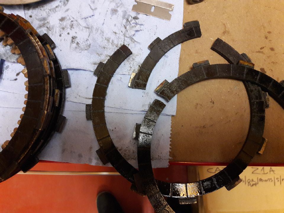

Clutch plates :(
Z1- Engine Overall 16 (1).JPG (118.25 KiB) Viewed 8156 times

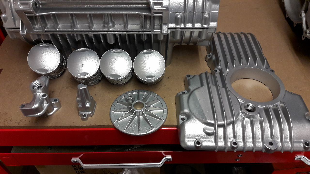

#33 PostAuthor: BigZCas » Mon Jan 22, 2018 9:32 am

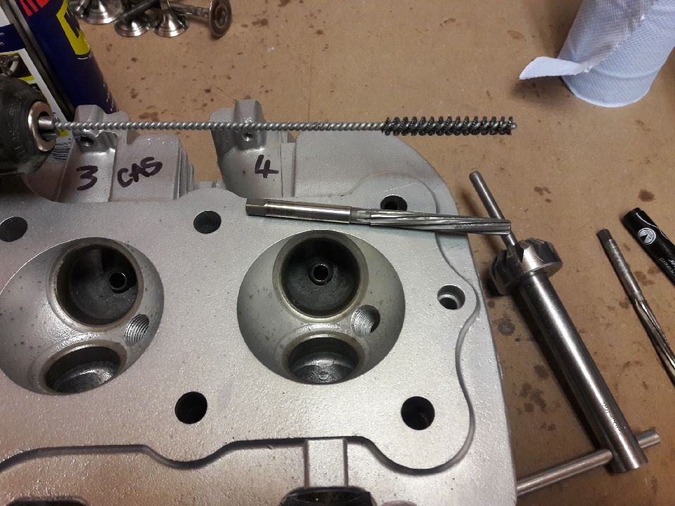

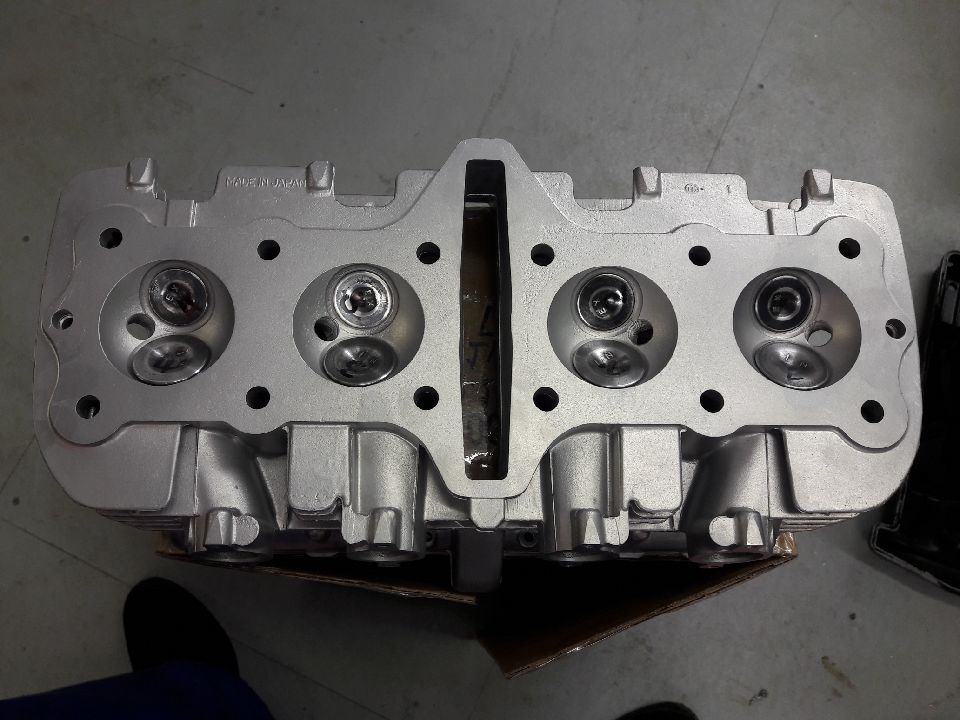

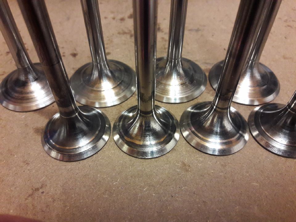

New valve guides fitted.
Valves polished and seated.

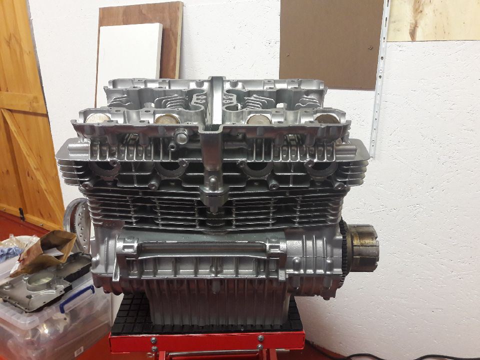

#34 PostAuthor: BigZCas » Mon Jan 22, 2018 9:36 am

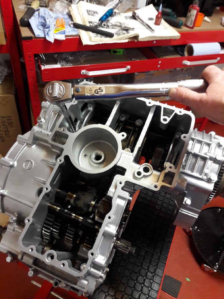

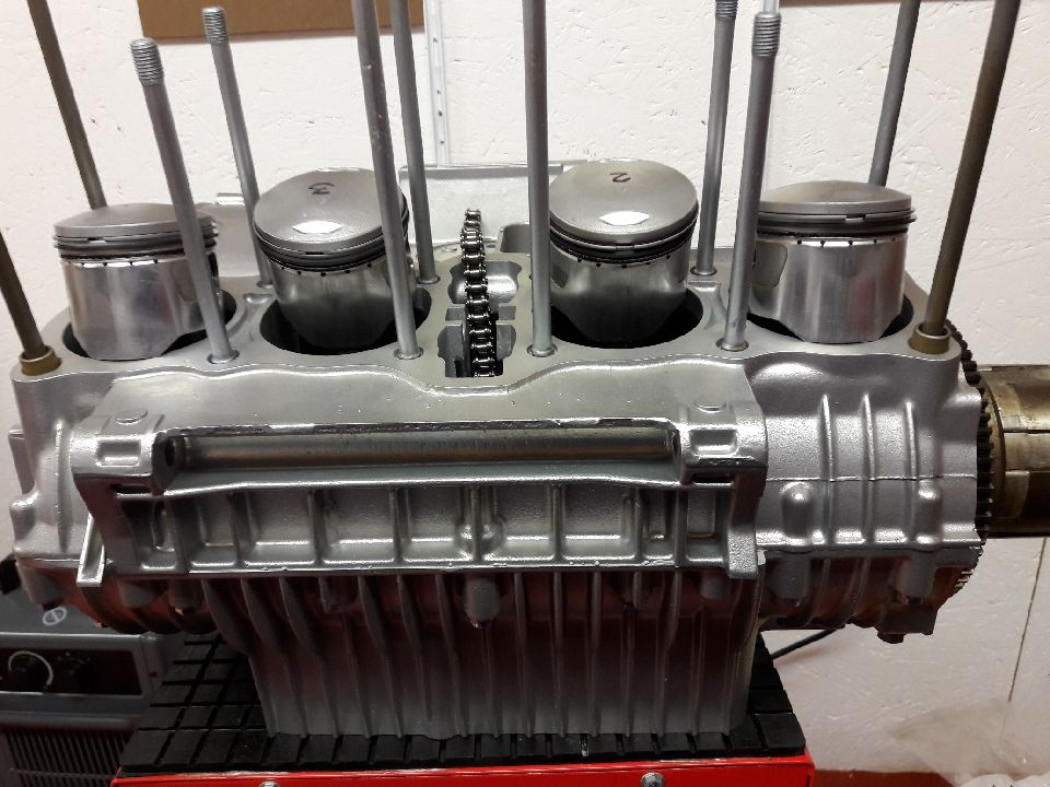

And so the assembly begins :D

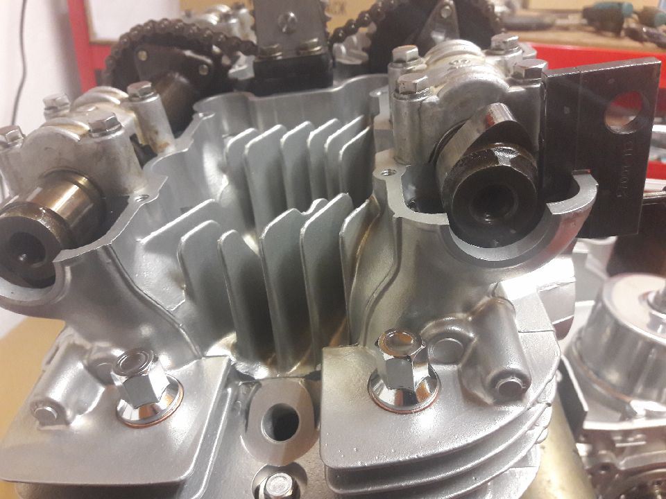

Lovely bag of goodies there, ready to go back into some beautifully clean casings!

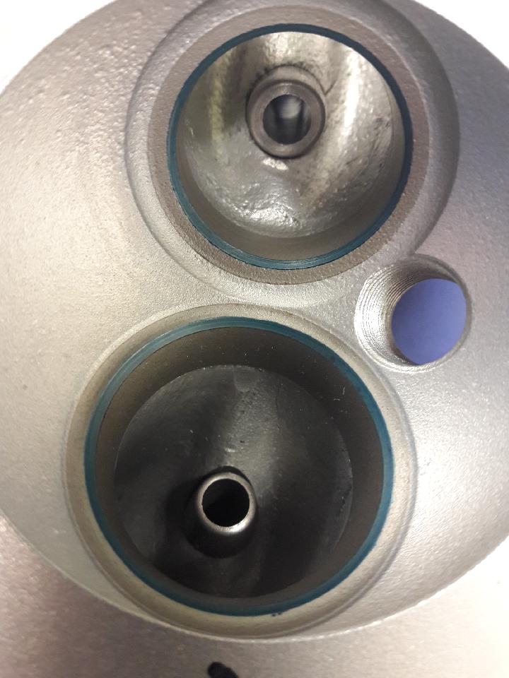

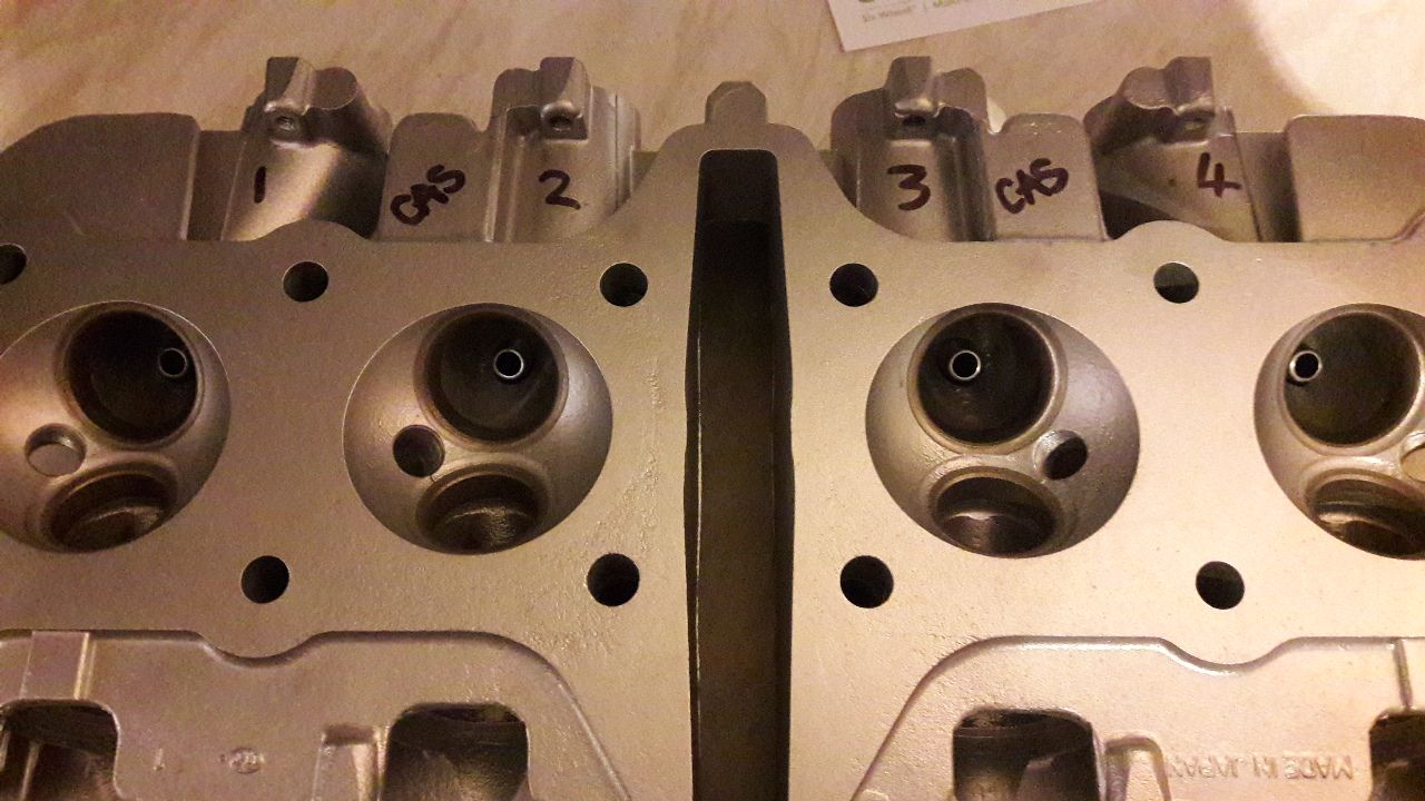

Couldn't help noticing what looks like a crack between the plug hole and the ex valve seat on pot no.2
chrisw1
Posts: 394
Joined: 13th Mar 2017
Location: Oswaldtwistle
Re: Z1a Restoration
#36 PostAuthor: chrisw1 » Tue Jan 23, 2018 8:51 pm
Hows it coming along ? ........engine back together ? ...great project
buzzard
Posts: 228
Joined: 15th Jan 2007
Location: Hampton
Re: Z1a Restoration
#37 PostAuthor: buzzard » Tue Jan 23, 2018 10:54 pm
Ref crack between exhaust seat and plug thread. This is a thing that occurs quite often and I've seen it In lots of heads in the past nothing to worry about. I reckon half the heads ive done have the odd crack in them. Buzzard@ thebuzzworkz.

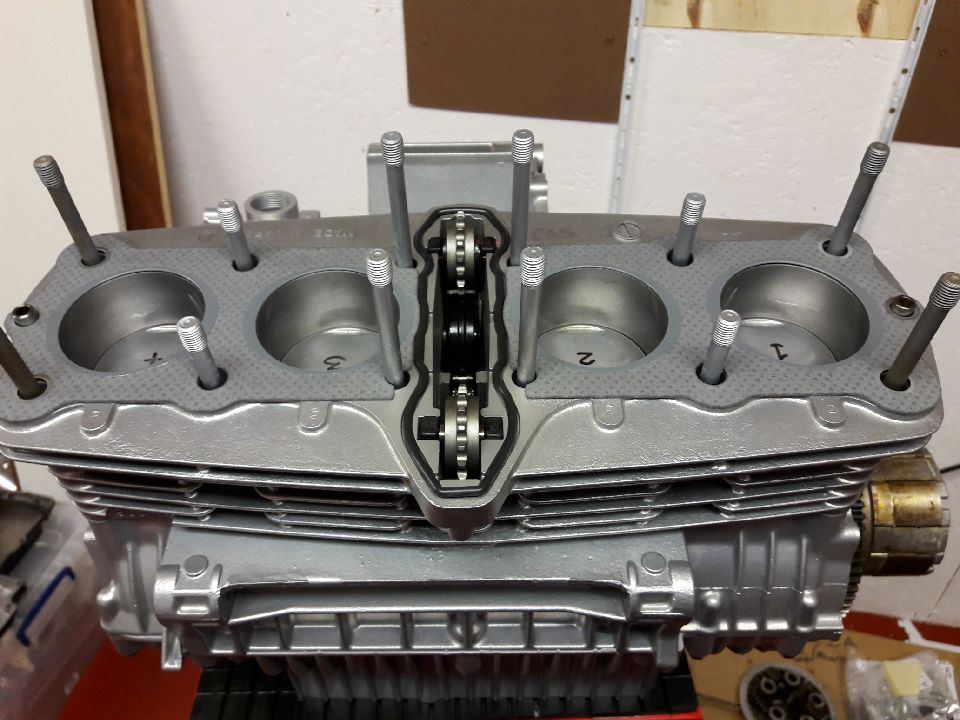

#39 PostAuthor: BigZCas » Mon Jan 29, 2018 8:46 am

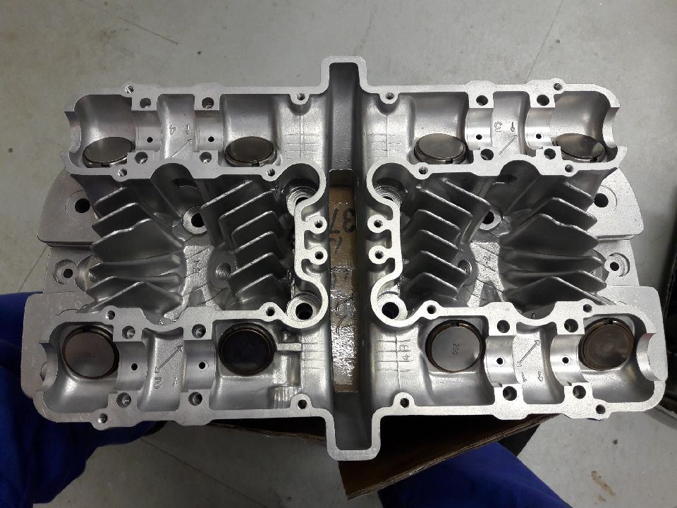

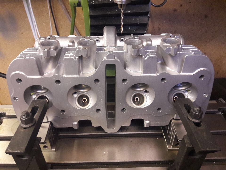

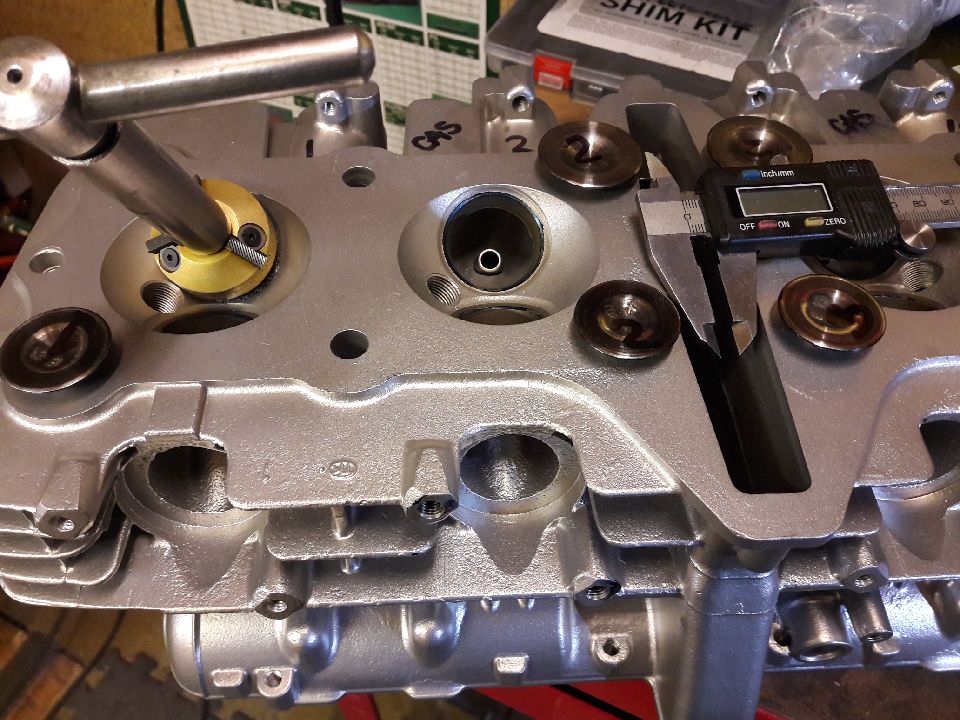

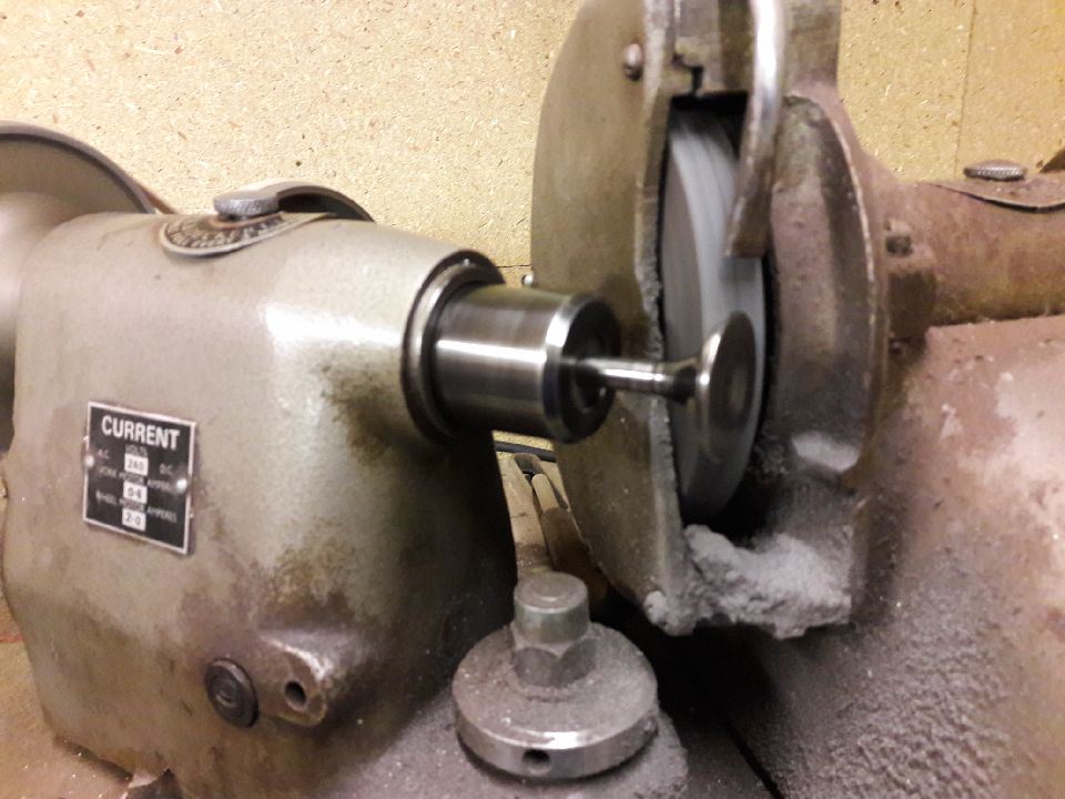

Head Re-Build this weekend - :)
Re-Cutting The Valve Seats
Z1 - Engine Overall 29.jpeg (147.73 KiB) Viewed 8005 times
Checked With Engineers Blue
Z1 - Engine Overall 30.jpeg (80.69 KiB) Viewed 8005 times
Stem Heights Checked, Cylinder Head Finished and Assembled
Z1 - Engine Overall 31.JPG (133.68 KiB) Viewed 8005 times
Z1 - Engine Overall 32.JPG (104.96 KiB) Viewed 8005 times
Barrels and Head assembled
Z1 - Engine Overall 33.JPG (117.87 KiB) Viewed 8005 times
Z1 - Engine Overall 34.JPG (123.54 KiB) Viewed 8005 times

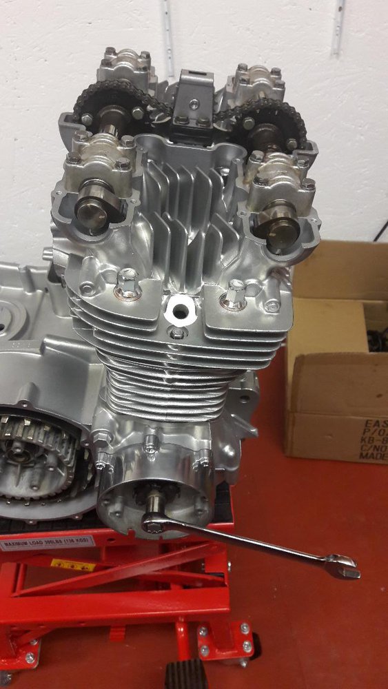

Cams In, Cam timing Checked OK.

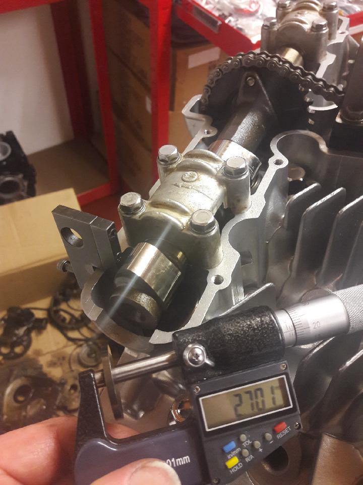

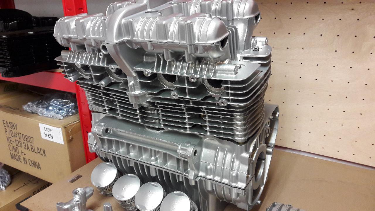

#40 PostAuthor: BigZCas » Mon Feb 05, 2018 5:51 pm
Shims sorted 0.004" to 0.005".

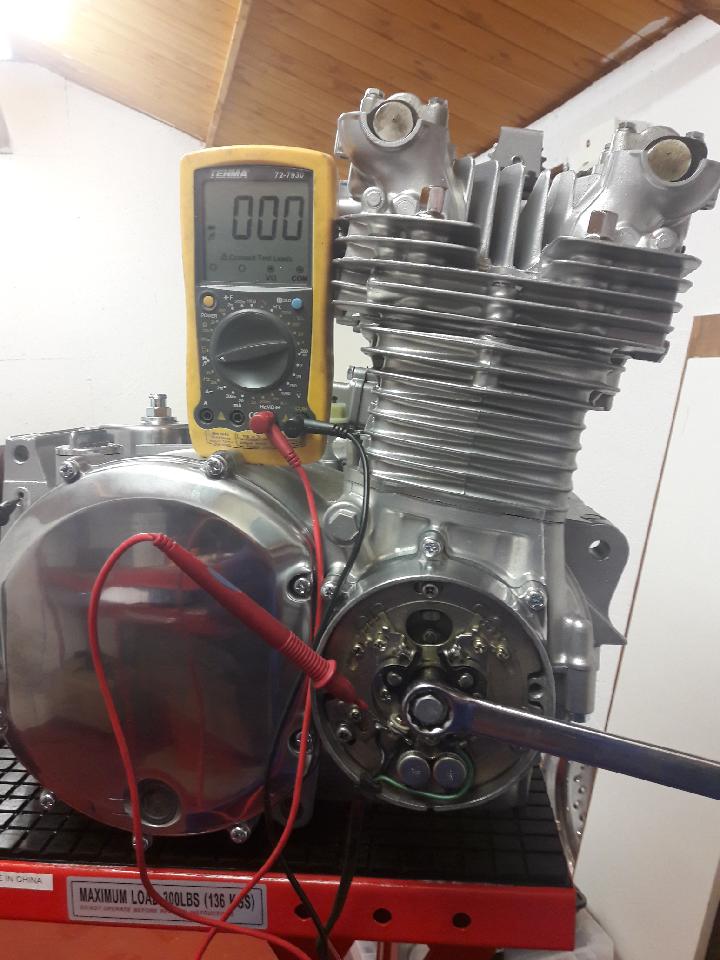

Static setting timing.
Just the sump and cam cover to go :) :) .
Will be picking up from Buzzard this Sunday :D
I will report on how many times I knock the bike over trying to fit it in a couple of weeks.... :lol:

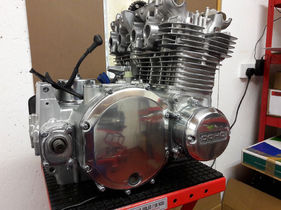

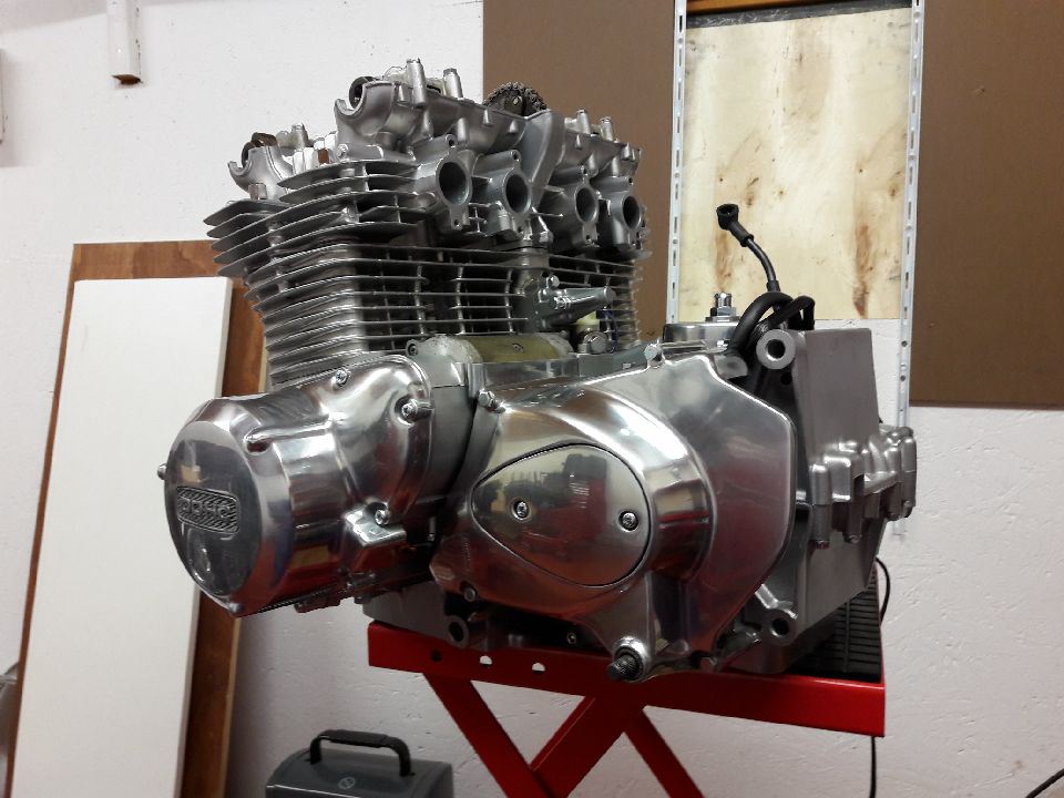

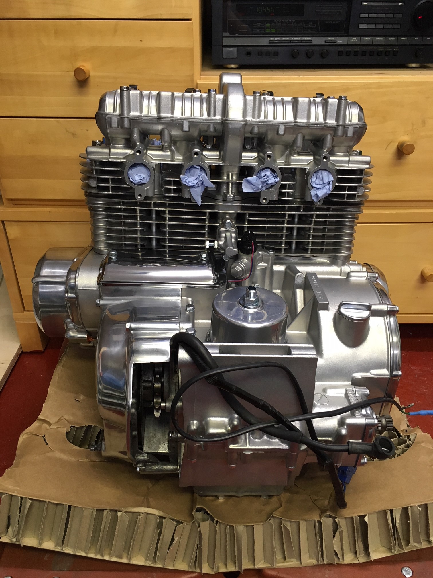

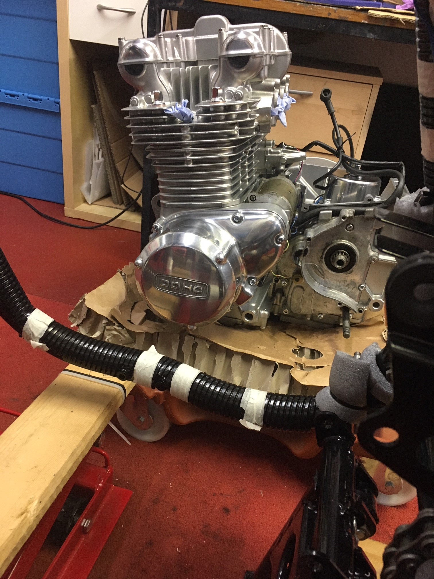

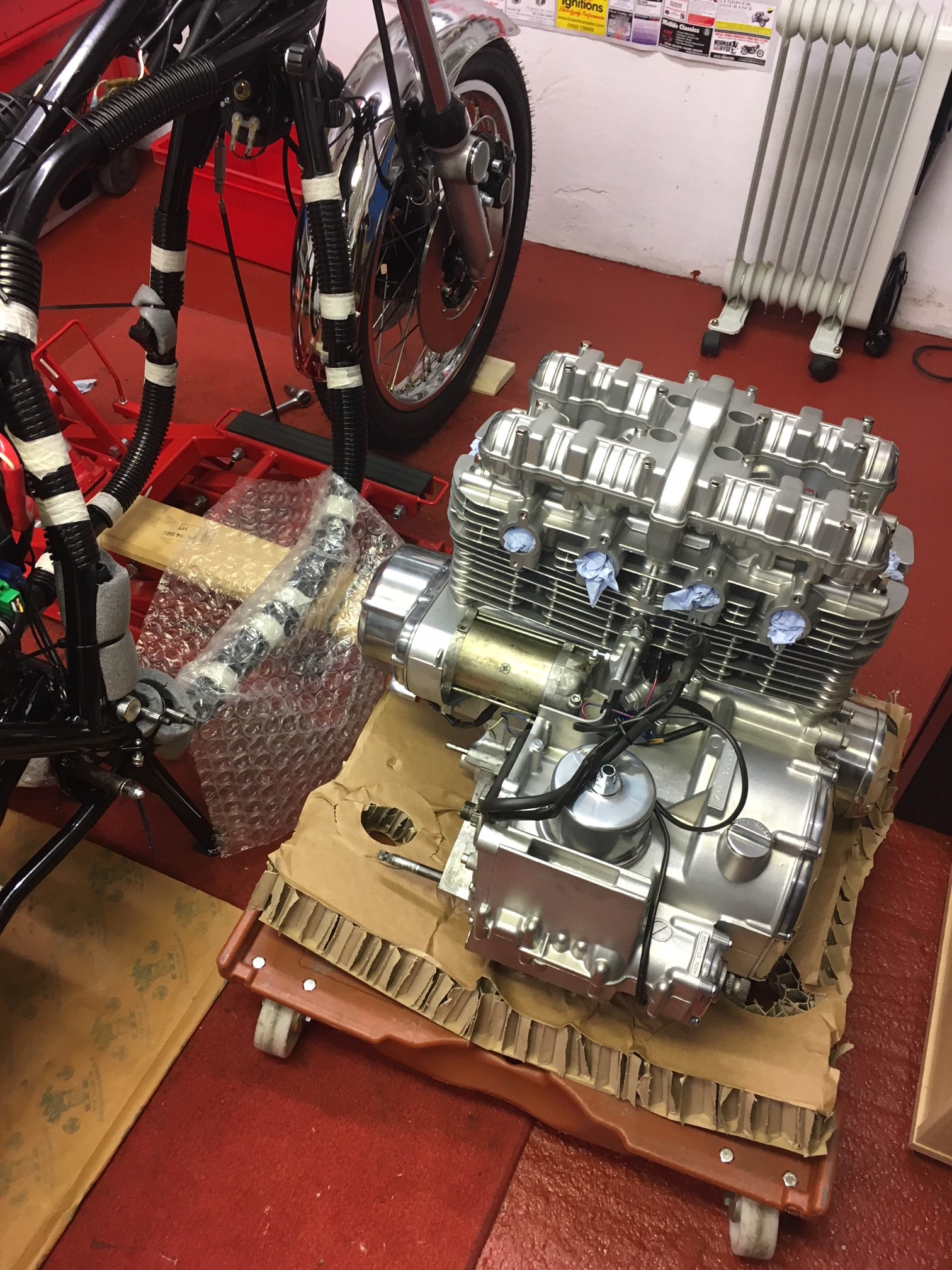

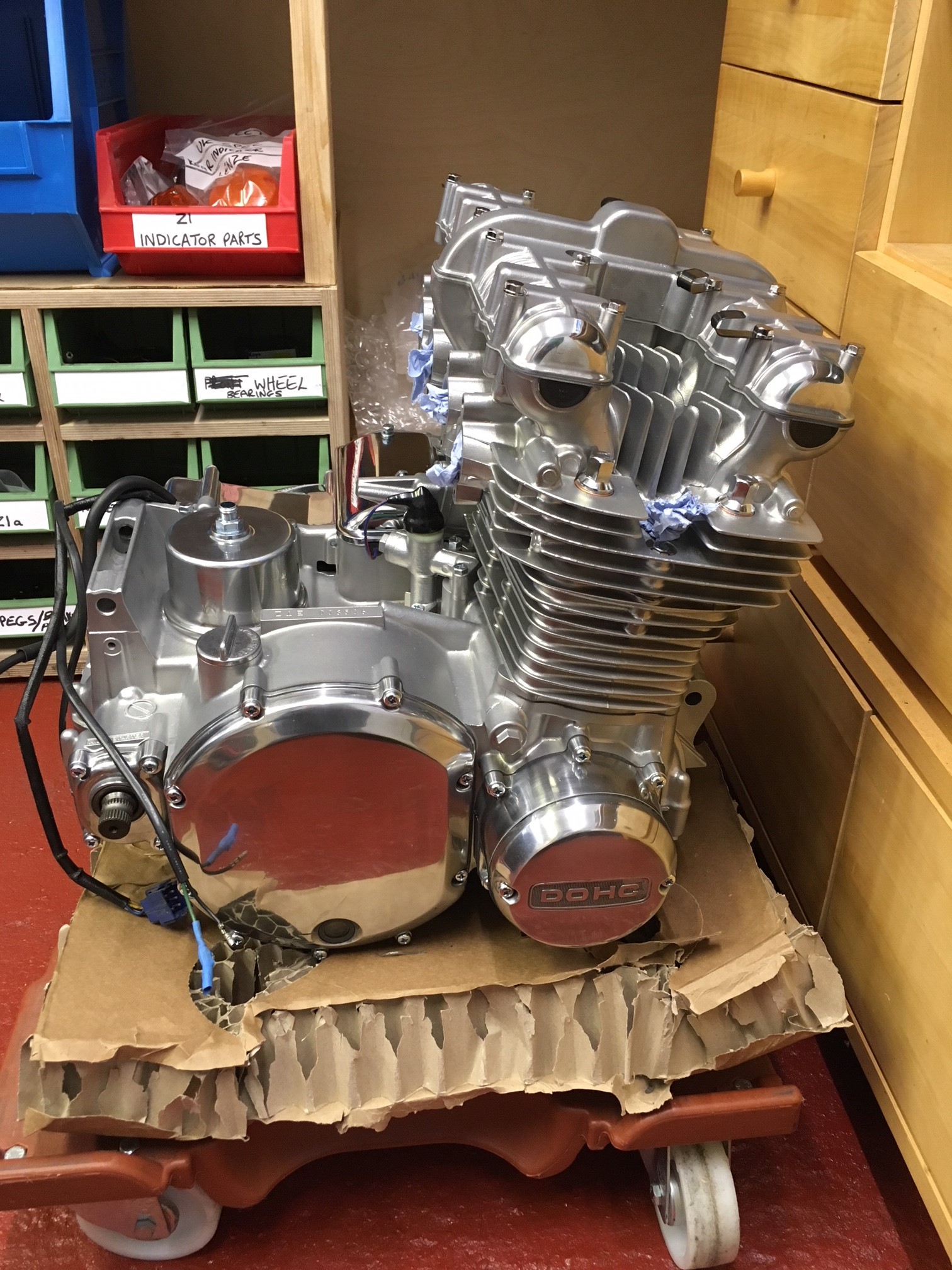

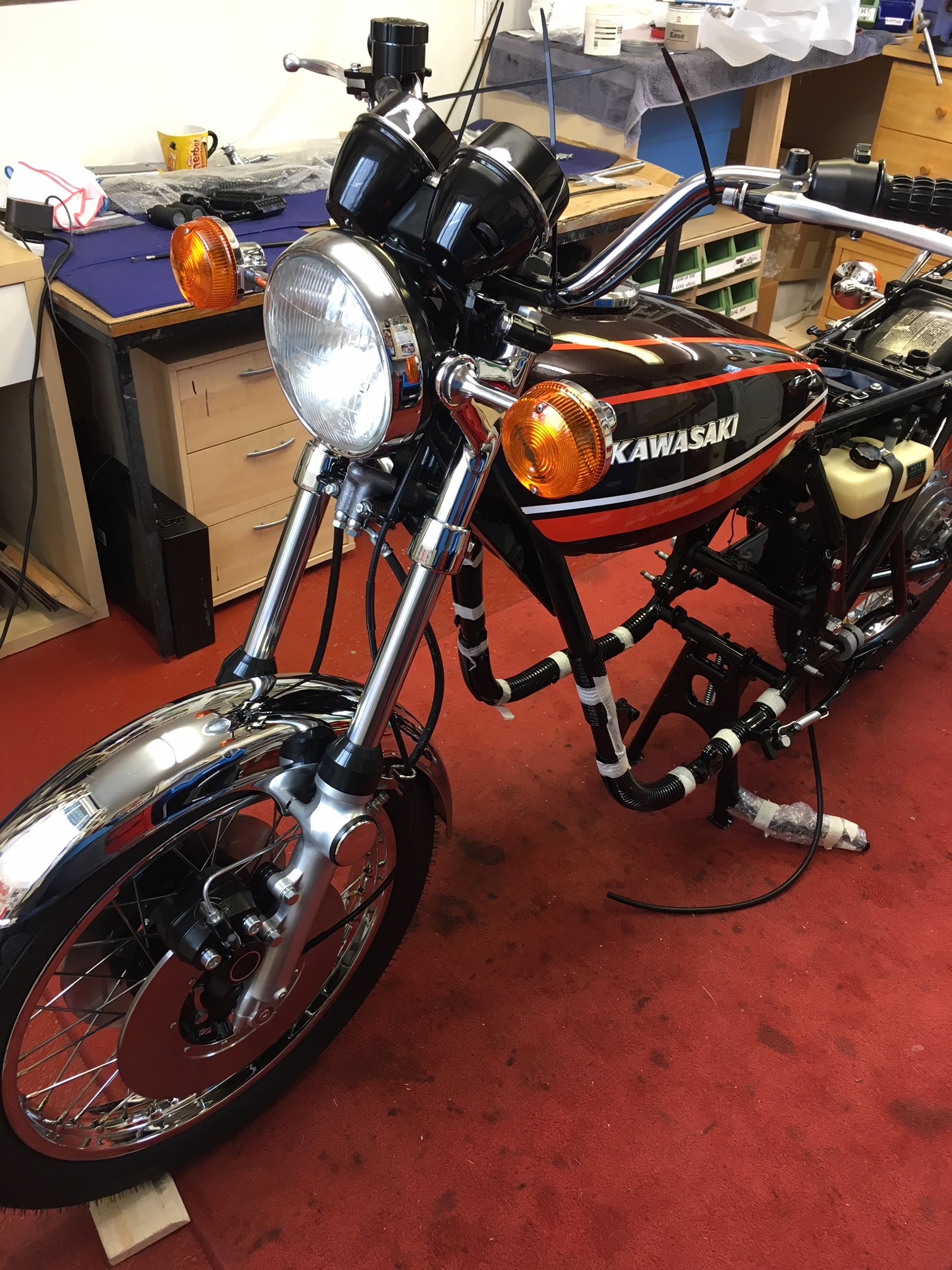

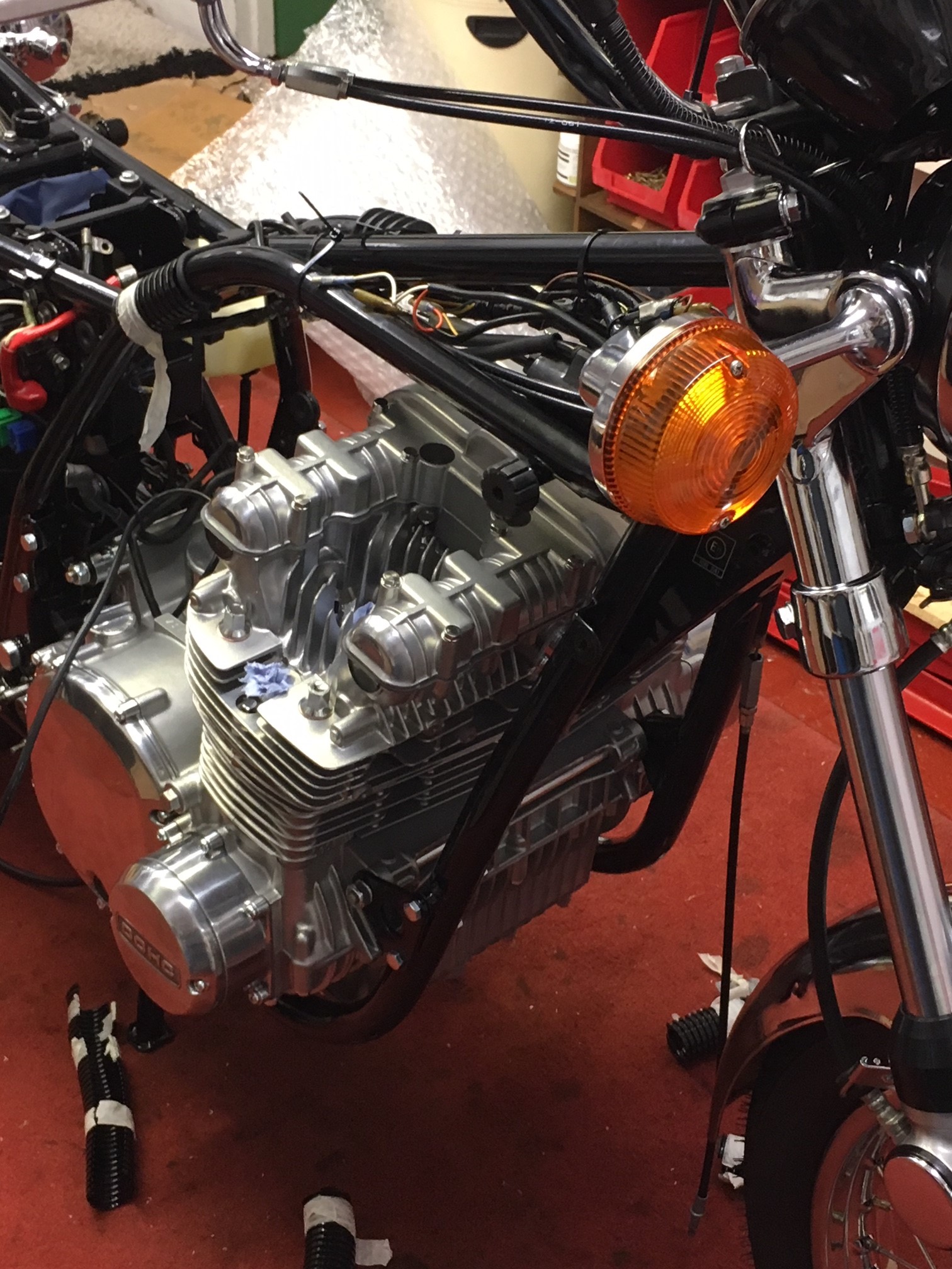

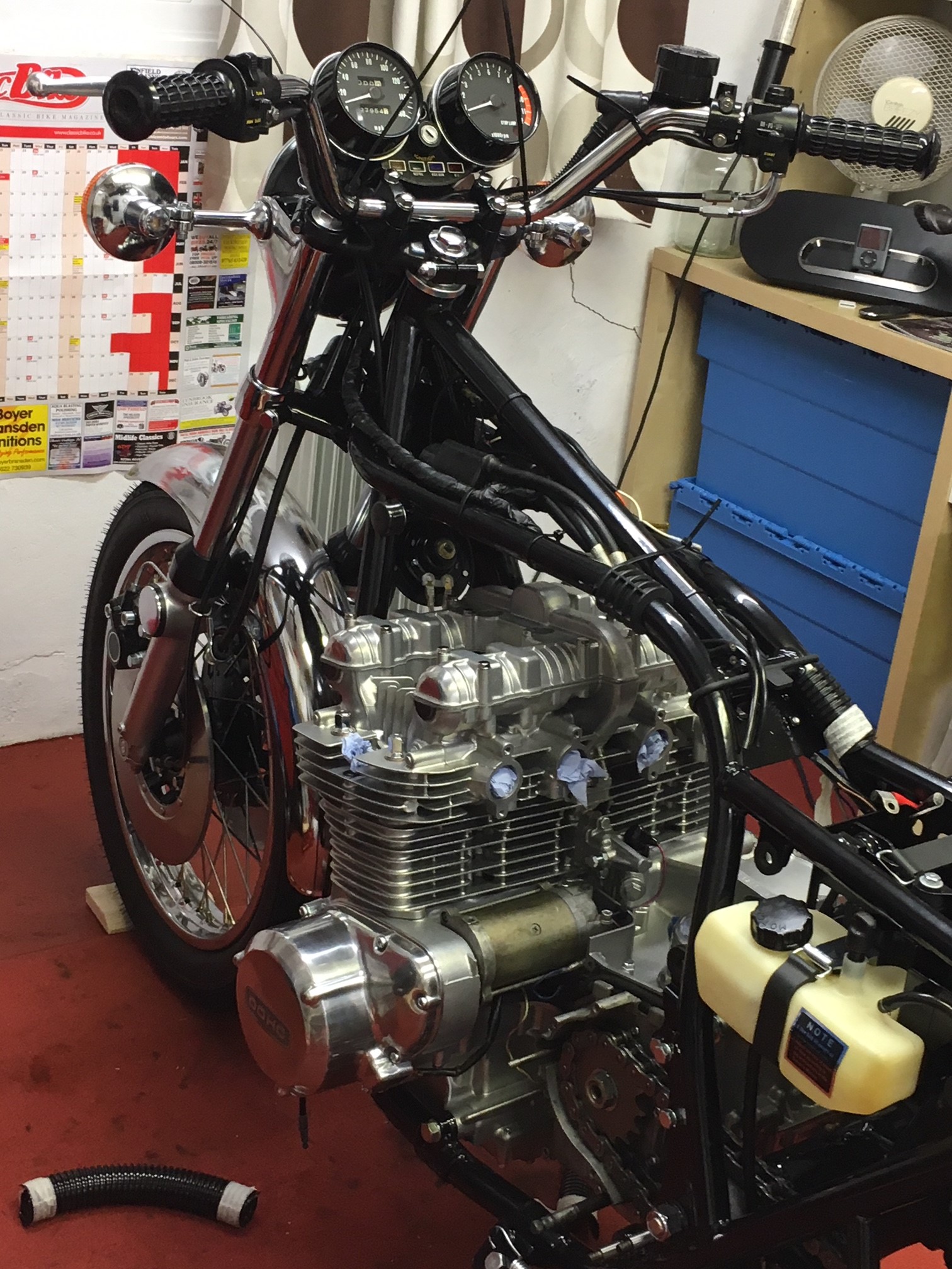

#43 PostAuthor: BigZCas » Tue Feb 13, 2018 9:54 pm
Picked up the engine from Buzzard on Sunday, very pleased :D
so I made sure the frame was wrapped with Copex, great stuff very tough, there is no way the frame can get damaged using this, would recommend.
Invited my son and mate round to give an hand, the 3 of us put it straight in without incident. :shock:

#44 PostAuthor: wheelysteve » Tue Feb 13, 2018 11:34 pm
BigZCas wrote:Picked up the engine from Buzzard on Sunday, very pleased :D
What size/type of copex did you use?

#45 PostAuthor: neilbarrett » Wed Feb 14, 2018 8:58 am
motor looks very nice.never new the z1a had a chain oiler
