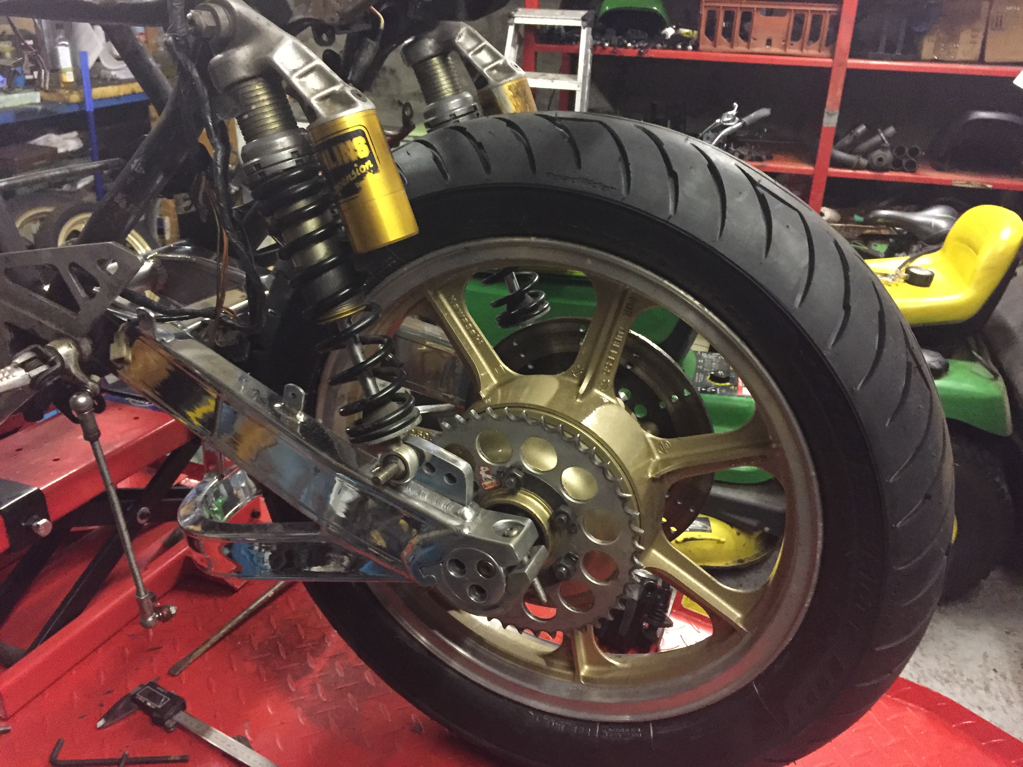

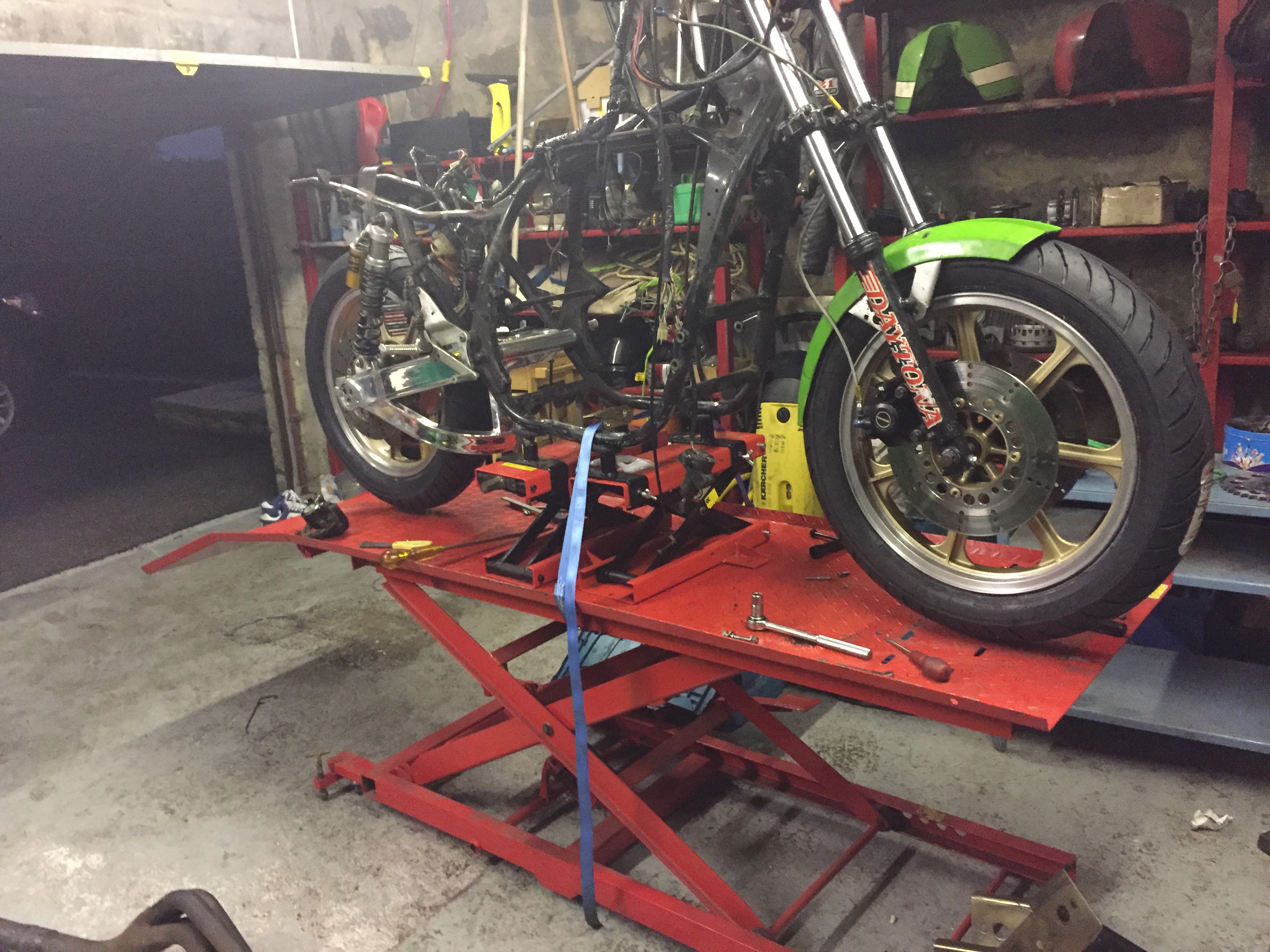

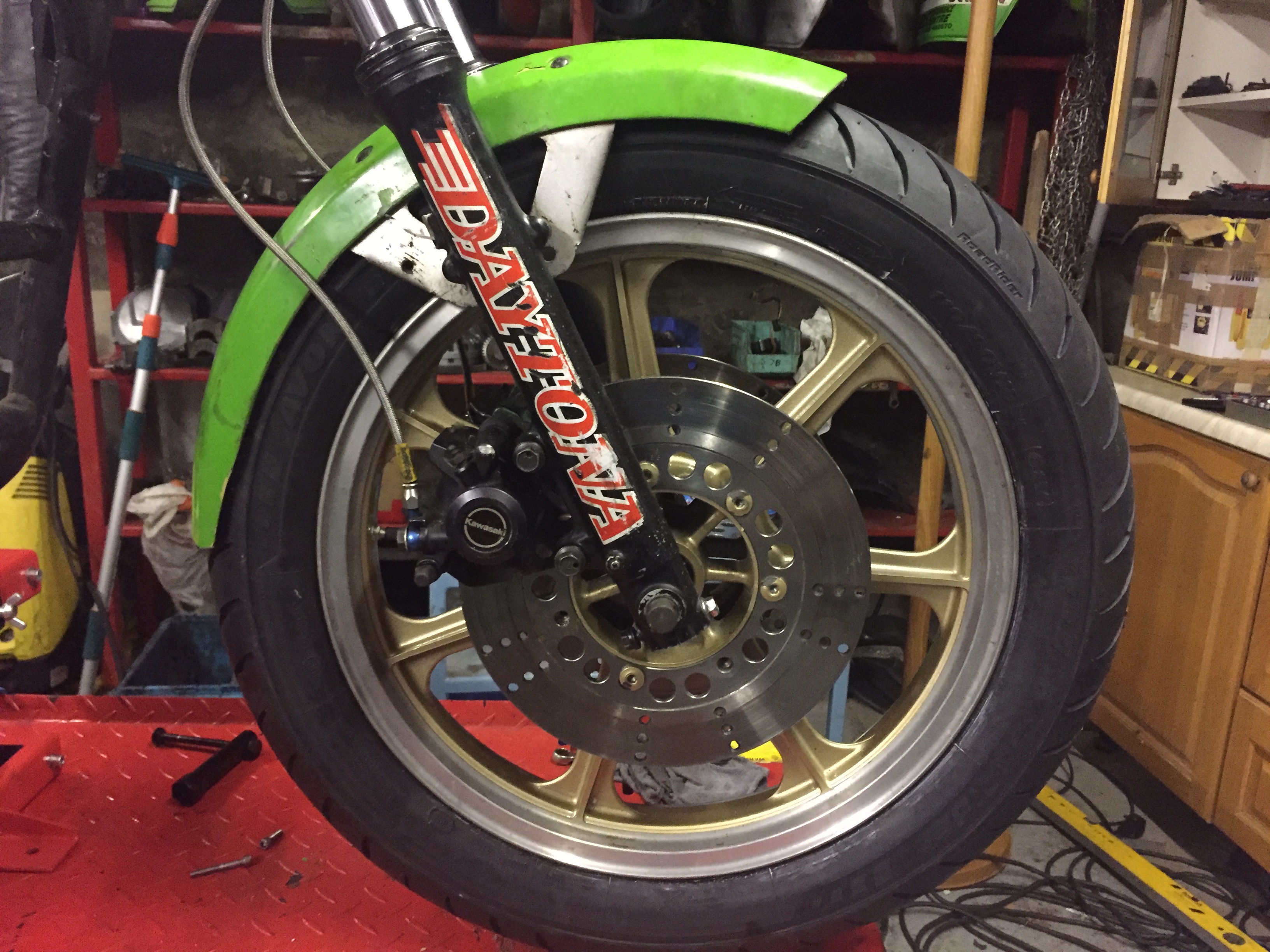

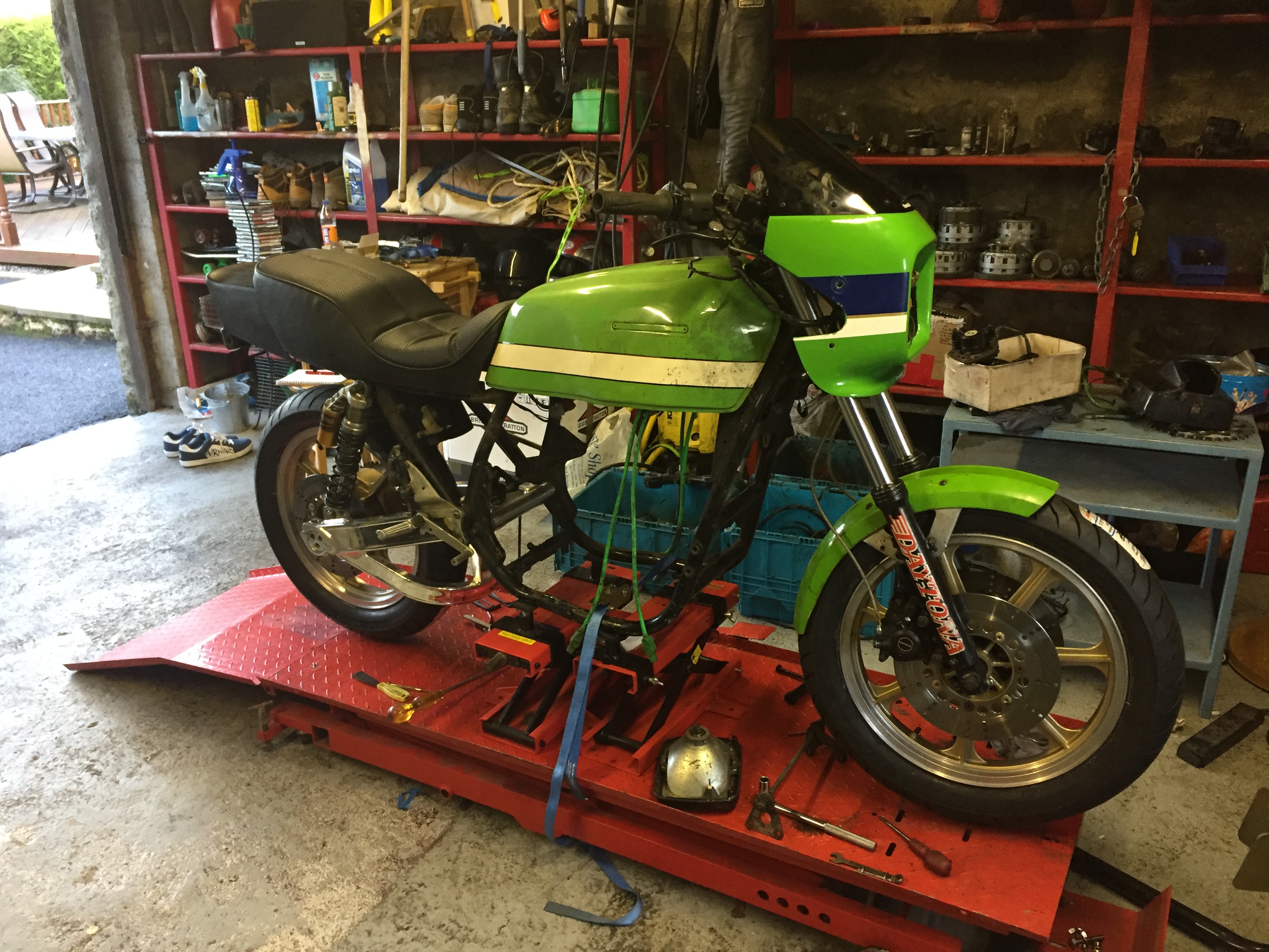

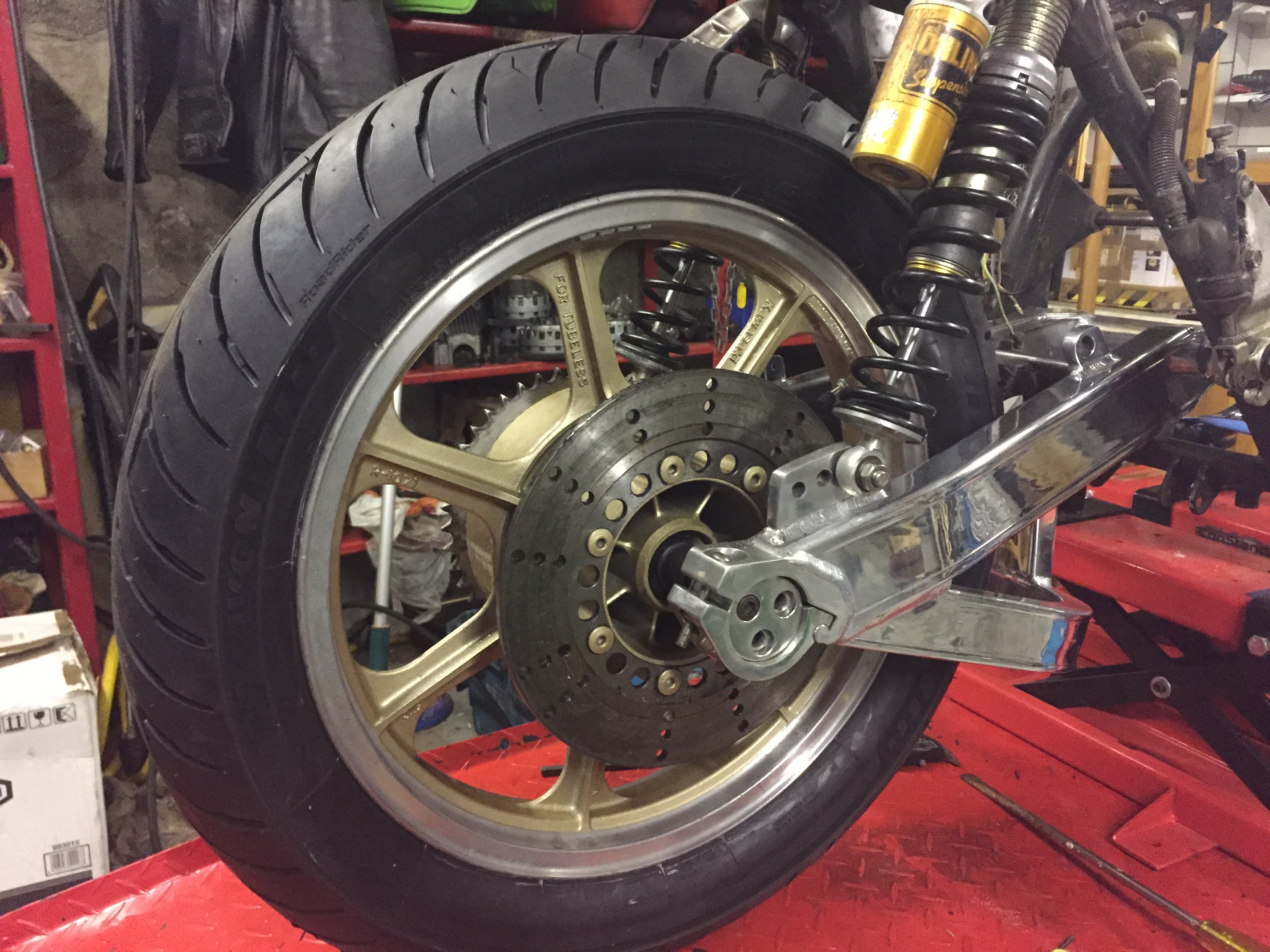

#36 PostAuthor: z1000puddin » Mon Jul 24, 2017 9:41 pm
Got my tyres fitted, went for Avons, worked out @ £200 including fitting, balance & valves.
Discs fitted, I'm not sure if I like the short front mudguard, will need to look at that .
The rear brake calliper seems to be a GPZ type, but I don't have a calliper mounting bracket . Another thing to sort.
I'm just waiting for my 1100R clocks & wiring loom to arrive.
Got my fairing thanks Julian .
Rotor, rear mudguard & a couple of other parts from Al.
Not sure yet if I go with a 630 chain or go to a smaller 5 series??
Battery box should be arriving from Martin this week, then I will start reinstating the de- lugged side panel brackets also.

z1000puddin wrote:The rear brake calliper seems to be a GPZ type, but I don't have a calliper mounting bracket . Another thing to sort.
It all depends if you want originality or performance. I got a PMC underslung AP caliper kit from Webike. The adjustable torque arm fits to the centre stand lugs (losing the C/S in the process) and it looks the mutts. If you go this route then buy the component parts minus the caliper from Webike and get the AP2696 caliper from Dennis Trollope racing. The calipers are made in Coventry so you end up paying extra for the caliper's travels around the globe.
For performance, weight and reliability I used a 530 chain conversion from Debbens.
Fred

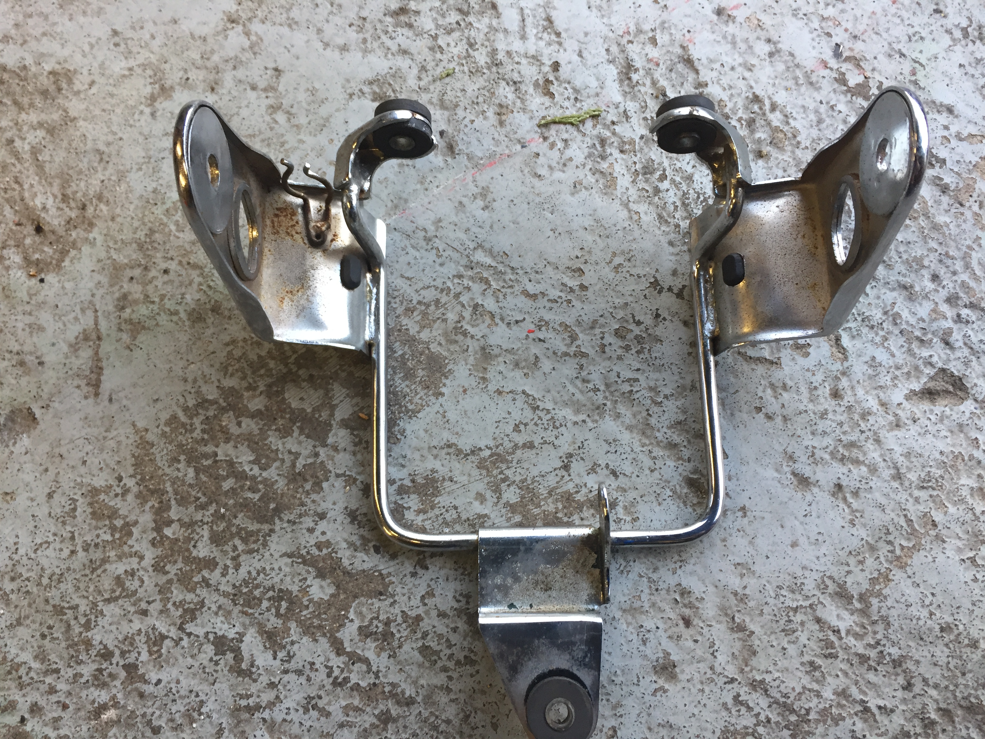

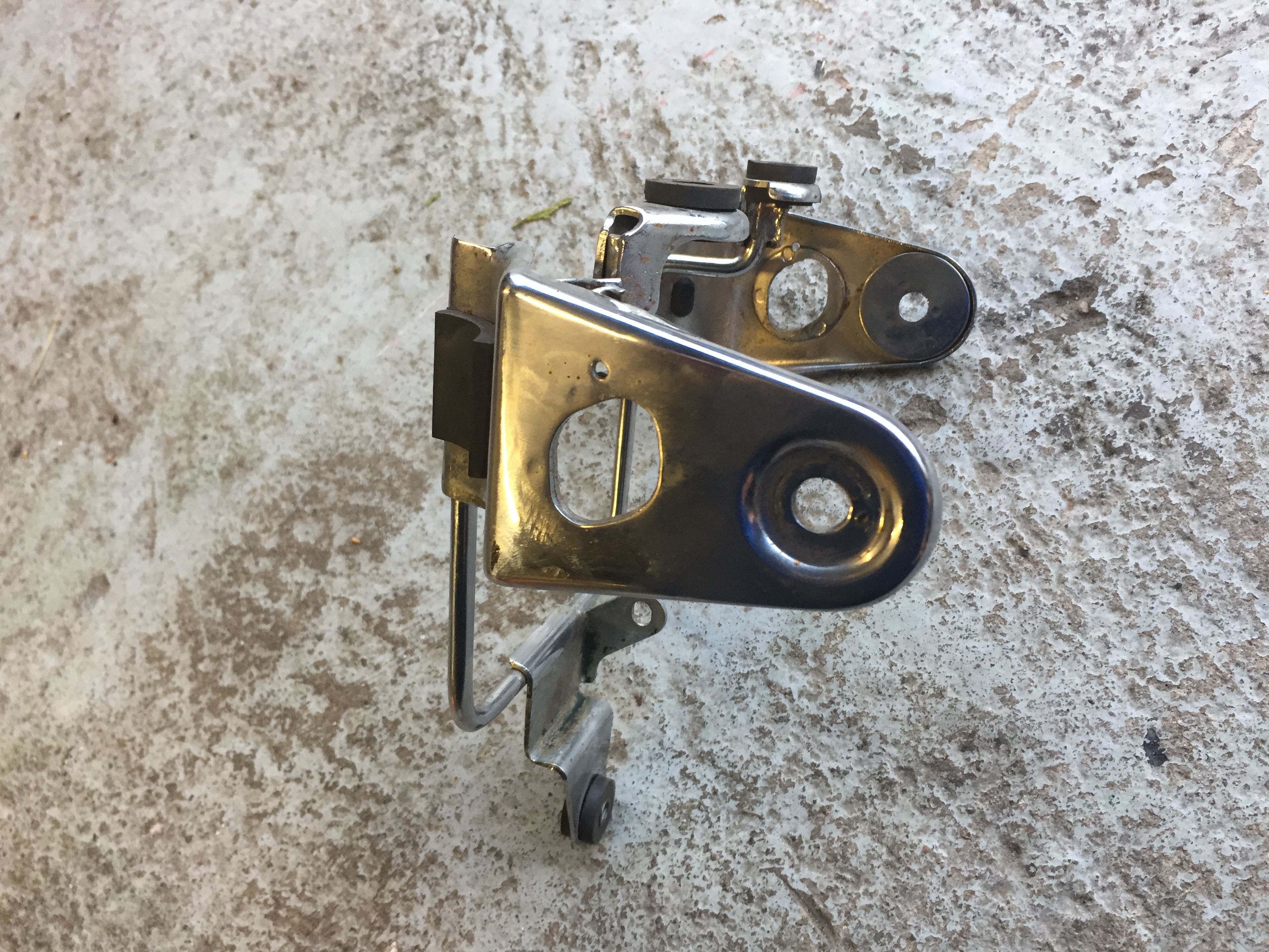

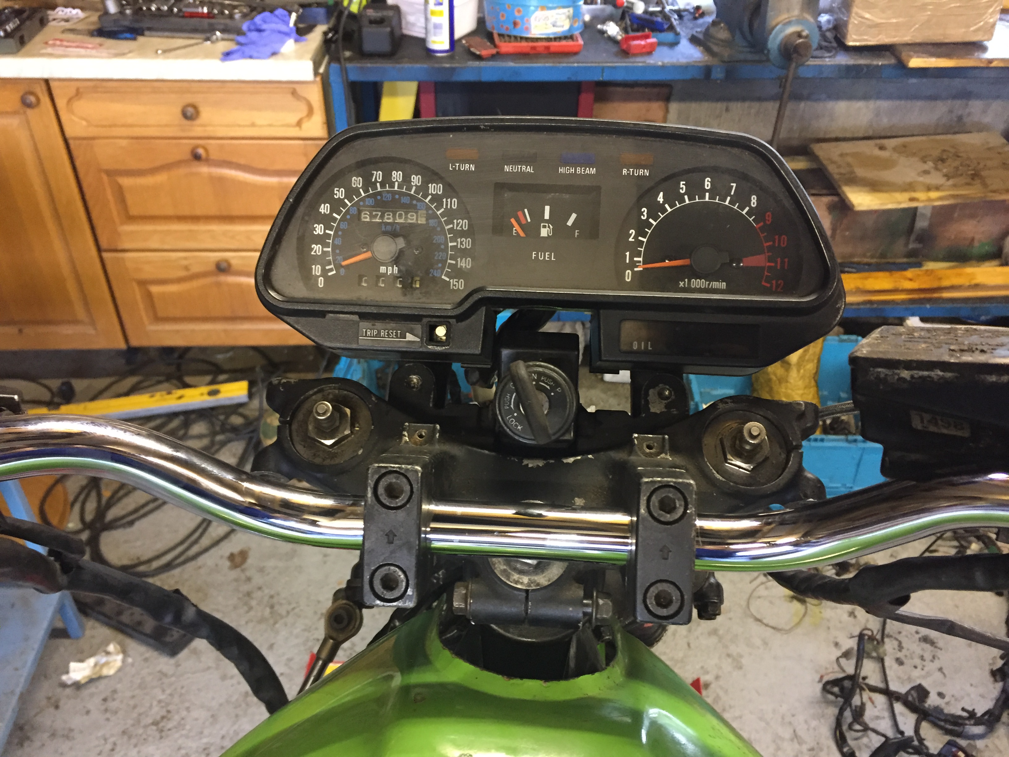

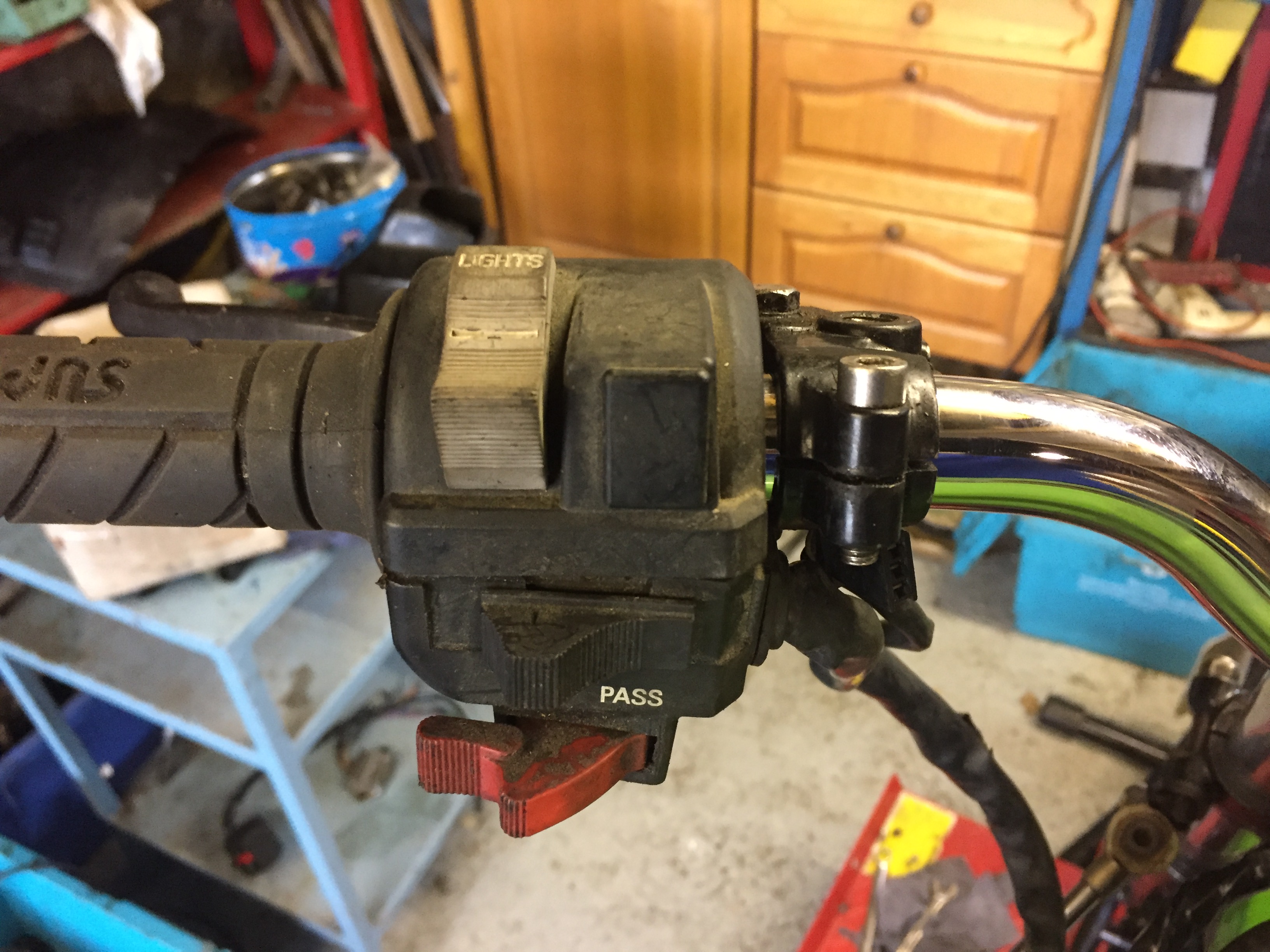

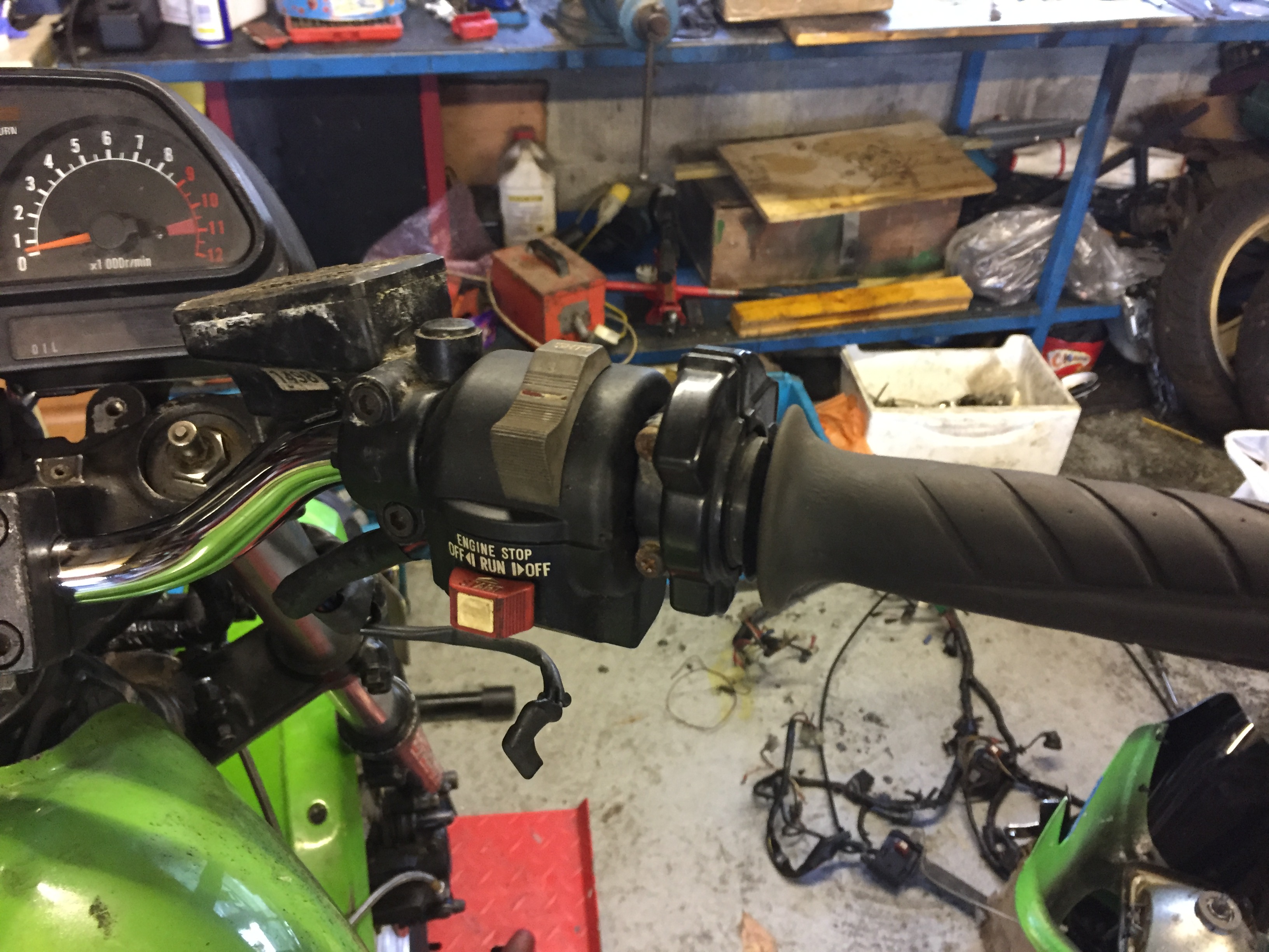

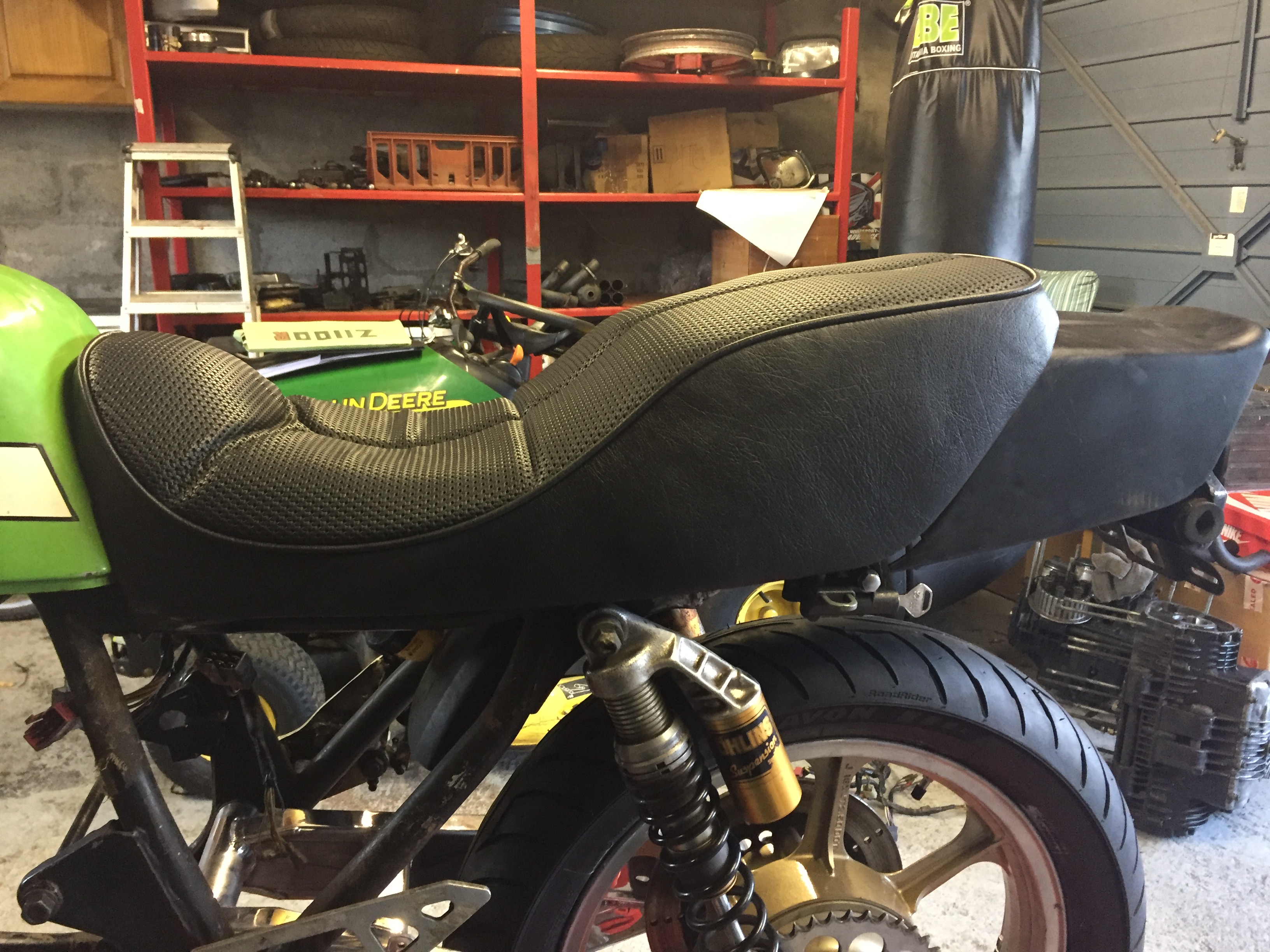

I loosely fitted up a few more parts ...
Correct loom & clocks
Seat brackets , rear light & rear tail piece.
The handle bar switchgear seems to correspond to the loom block connectors & they look like the pics I have.
Found out the head light bracket doesn't seem to be correct, I have 2 one chrome & one painted
Zed til Dead
