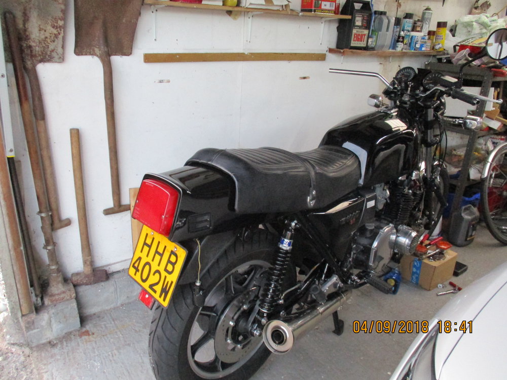

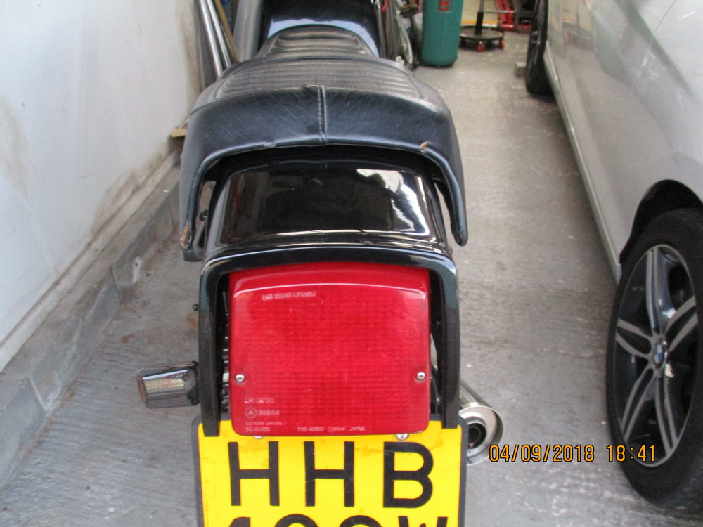

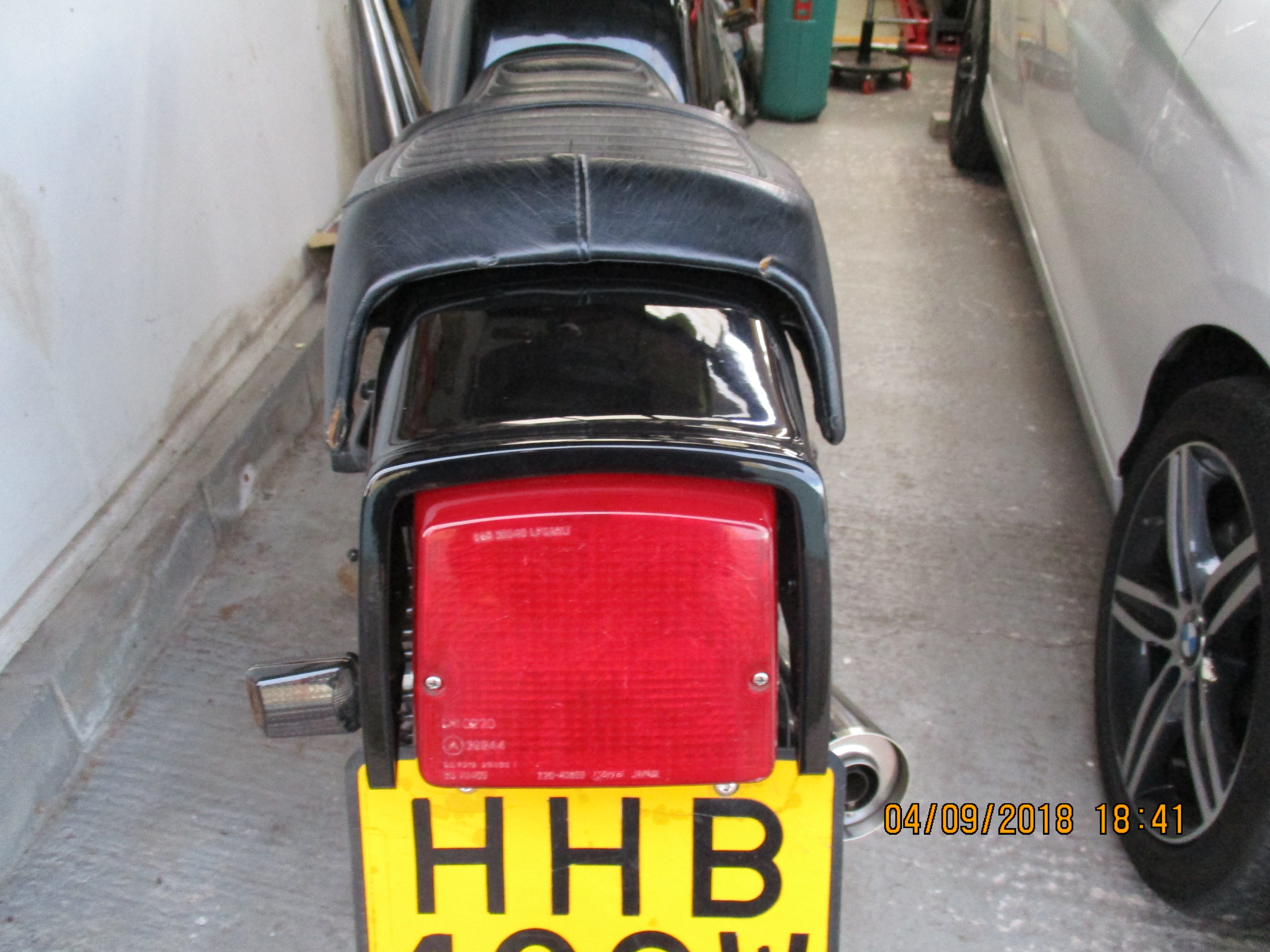

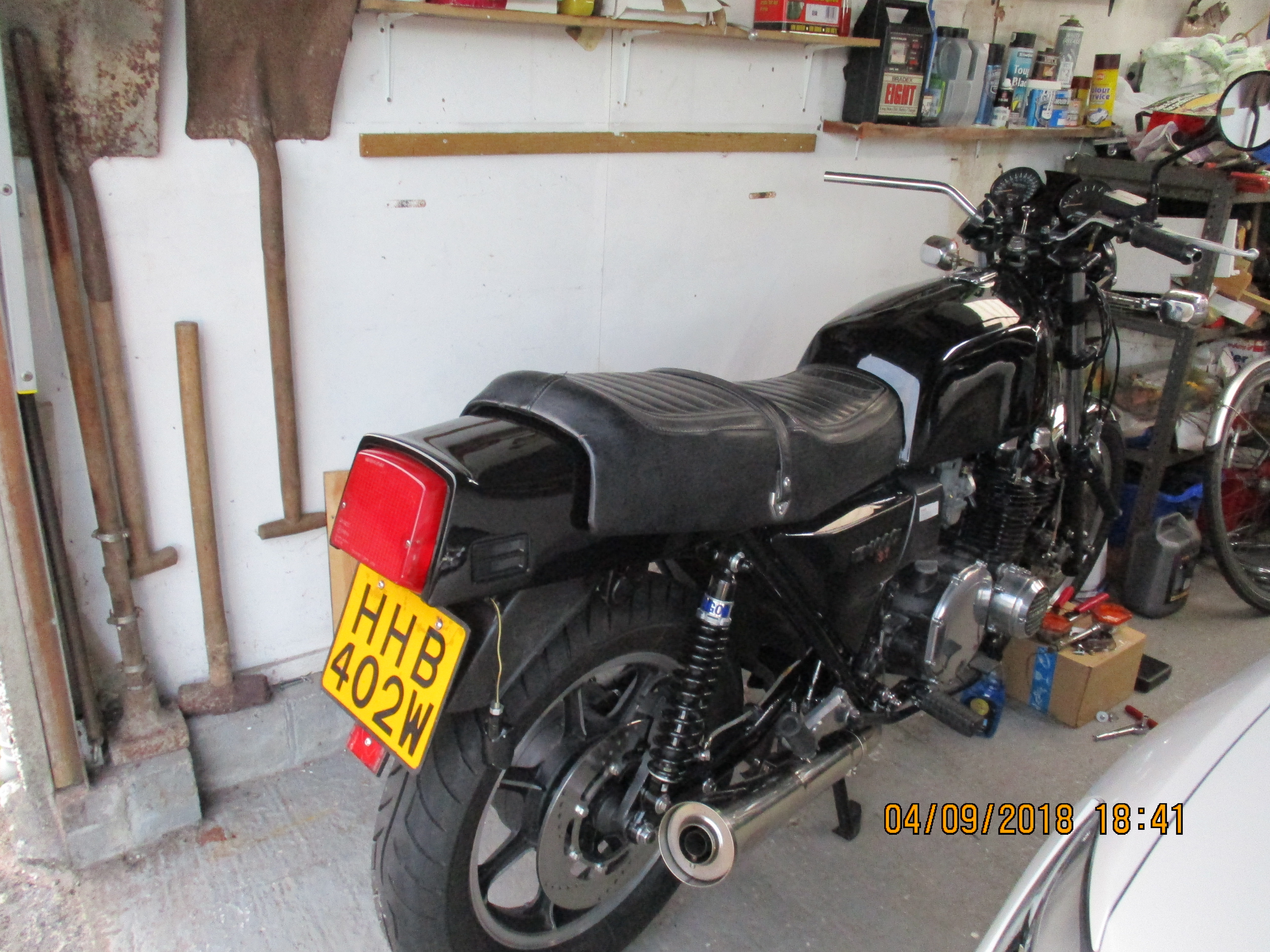

Purchased a seat off ebay, it is a good fit except around the tail piece.
The tail piece does not seem wide enough for the seat.
All the locating rubbers line up with the frame rails.

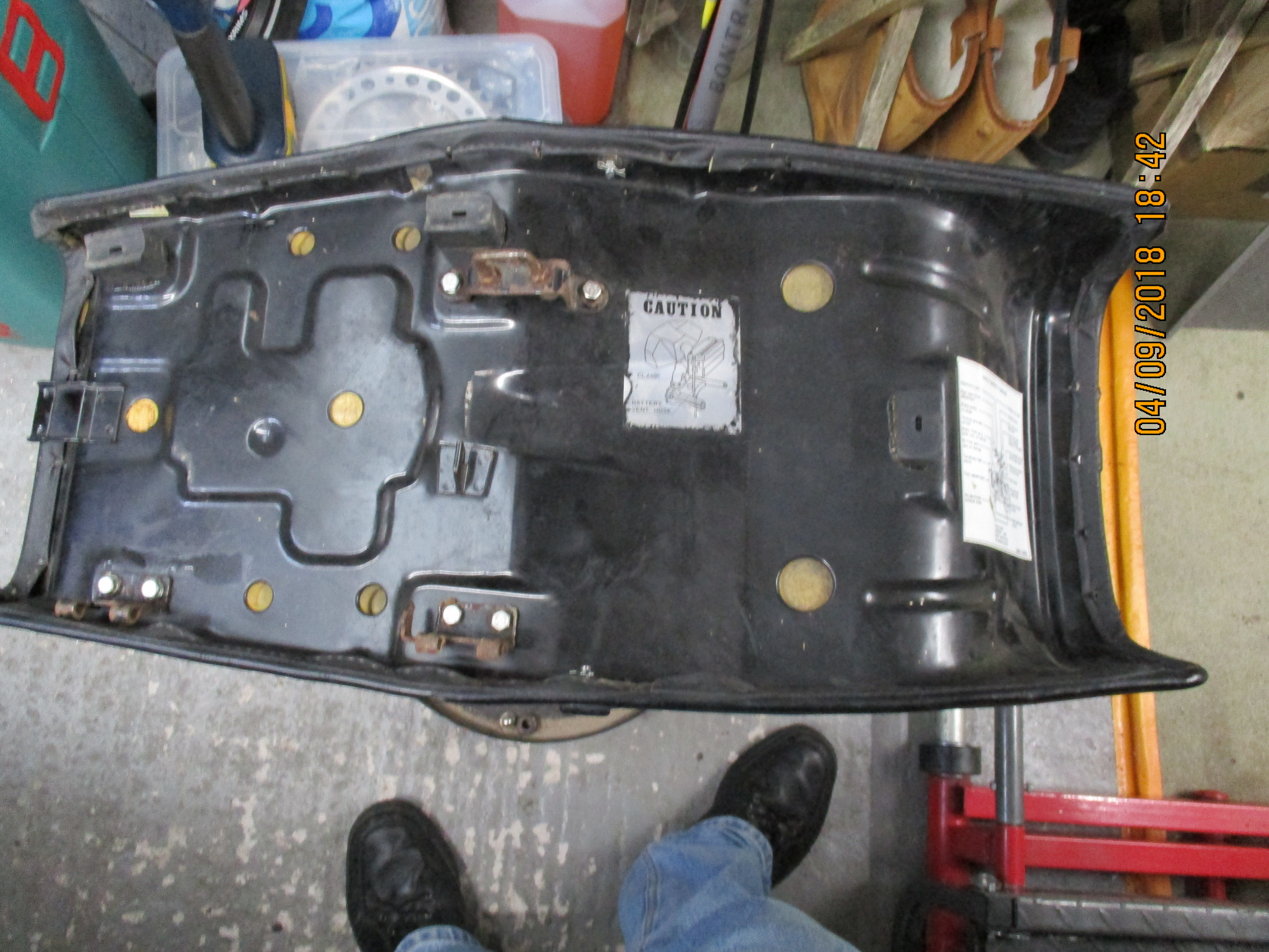

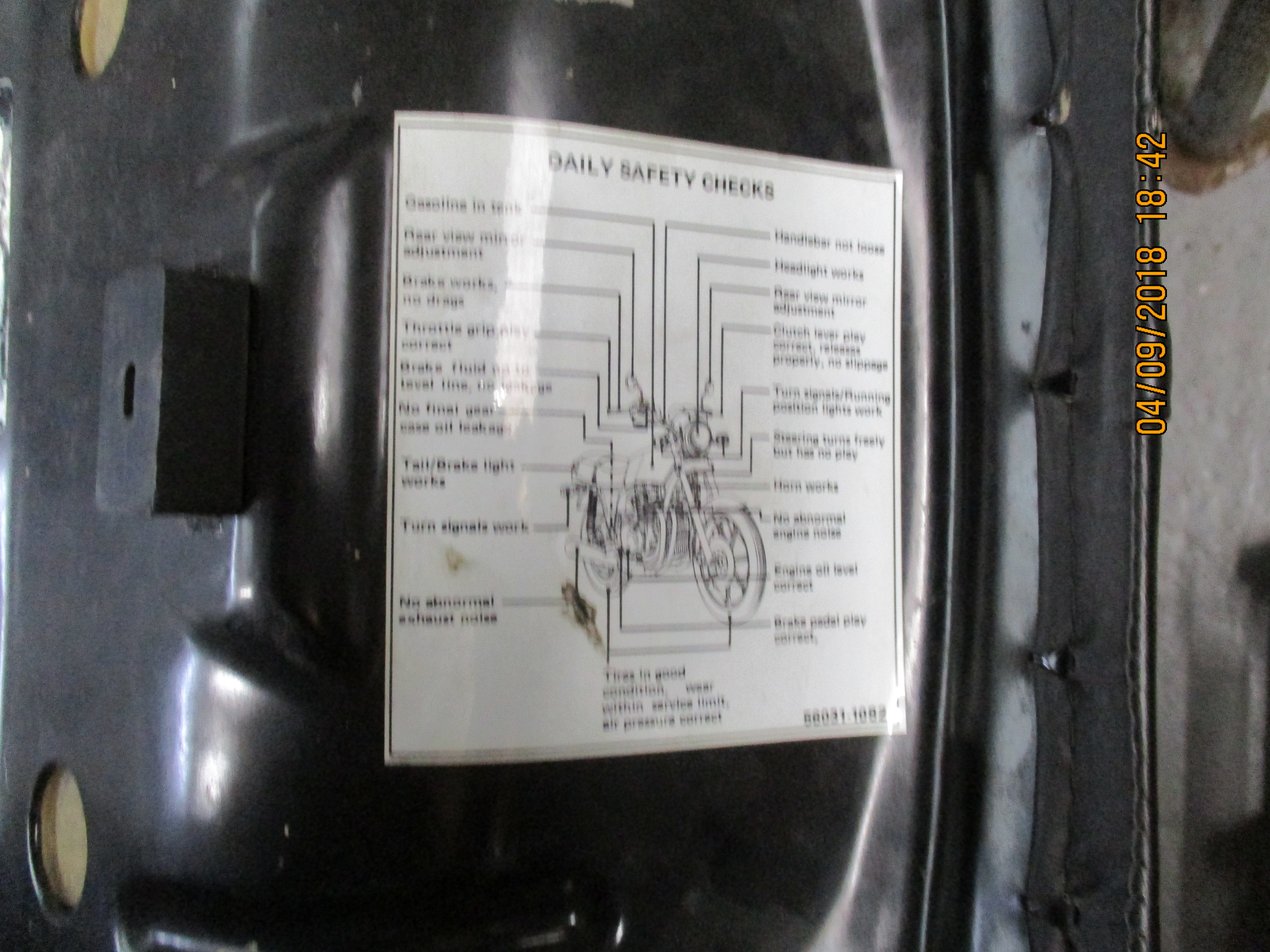

There is also a diagram of the bike on the underside.

Re: Z 1000 St E2
Hi Avon
that's a correct ST seat, a good seat pan, not rotten, the rubbers at the correct place. Don't worry about the fit around the tail piece, it's a normal fit. You can always try to bend the seat pan a bit at the rear so it might get closer to the tail piece if you really want that. I wouldn't do it but it's your bike.
You can buy a new seat cover at "pit replica" on Evilbay...if you want . Google "pit replica Z1000 E1-E2 seat cover" if you want to find a picture of it. Keep in mind that I have no experience with that company.
Re: Z 1000 St E2
As Philippe say's that how there all fit,the one on mine is the same.

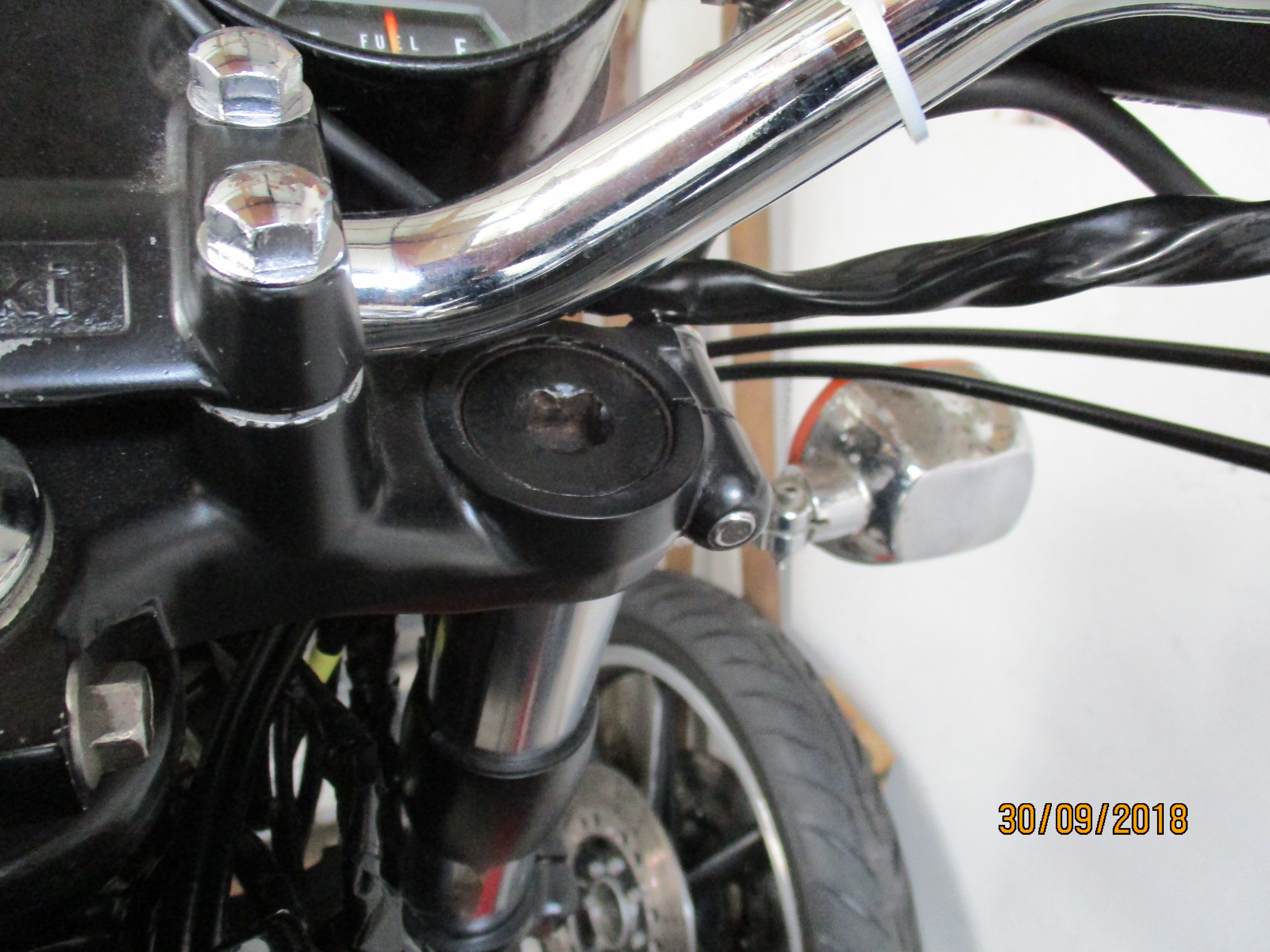

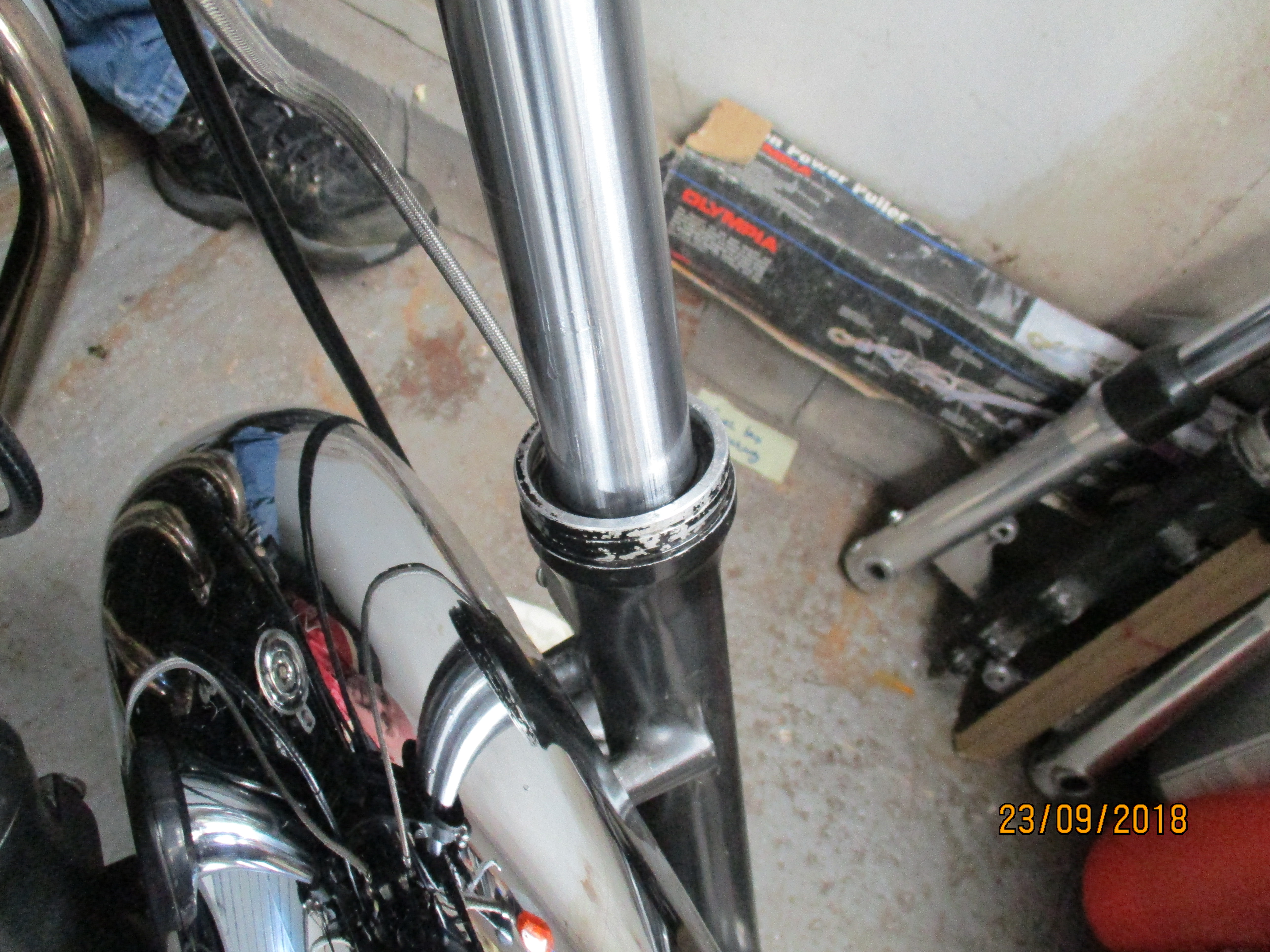

Took it for a run today to try out the different handlebars and seat.
The fork seal has started to leak again.

Hi Dunlop4
if the new oil seal starts to leak again I think there's something wrong. Or the oil seal is not correctly placed or there's pitting on the fork tube. Even a little bit of pitting on the fork tube can cause damage to the lip of the oil seal resulting in oil leaks.
Take a close look. I hope you can solve the problem.
Re: Z 1000 St E2
The fork tube has been replaced, i think it is incorrect fitment of the seal. I have ordered a seal fitting tool to alleviate this, hopefully this will fix this.

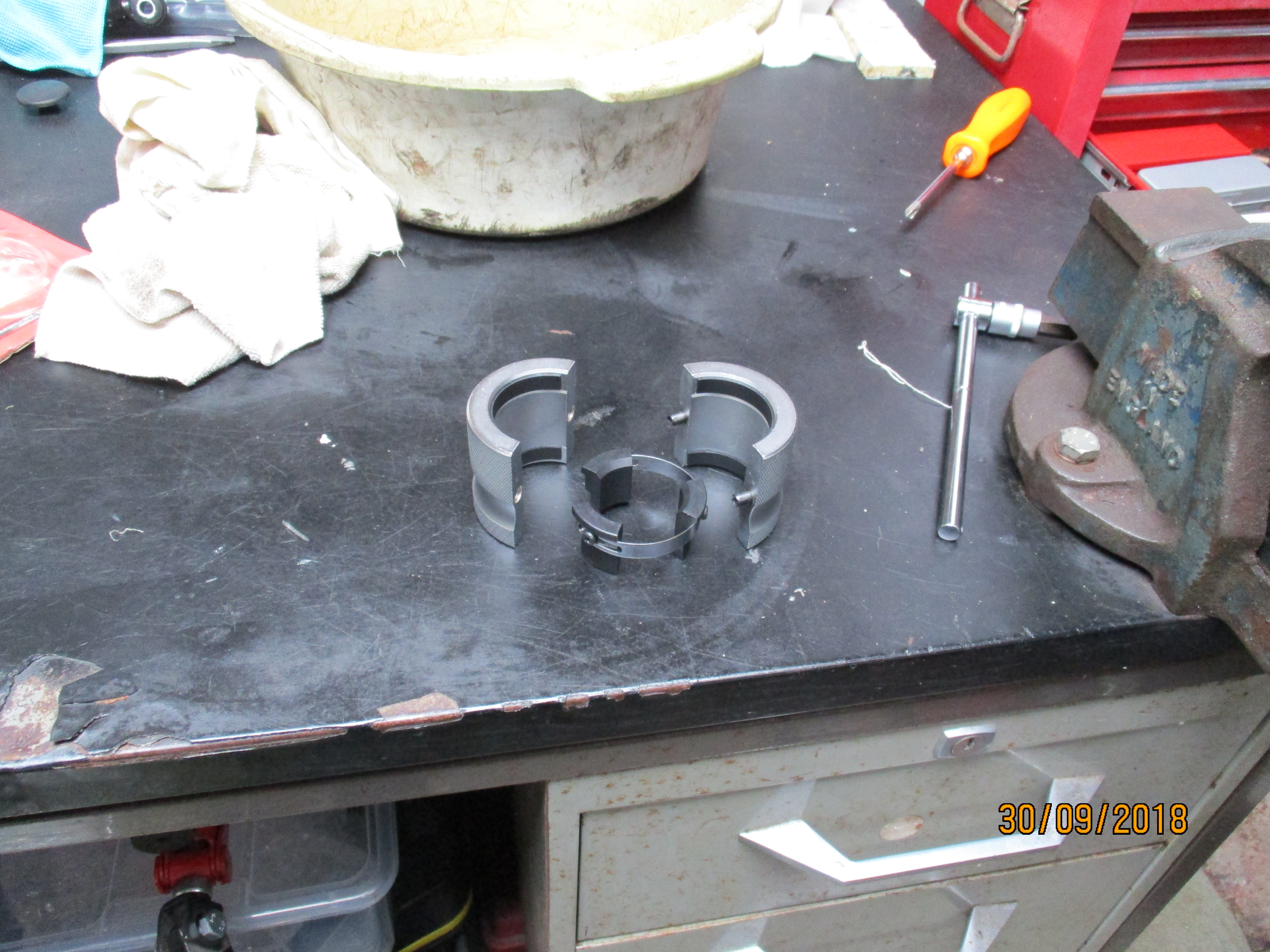

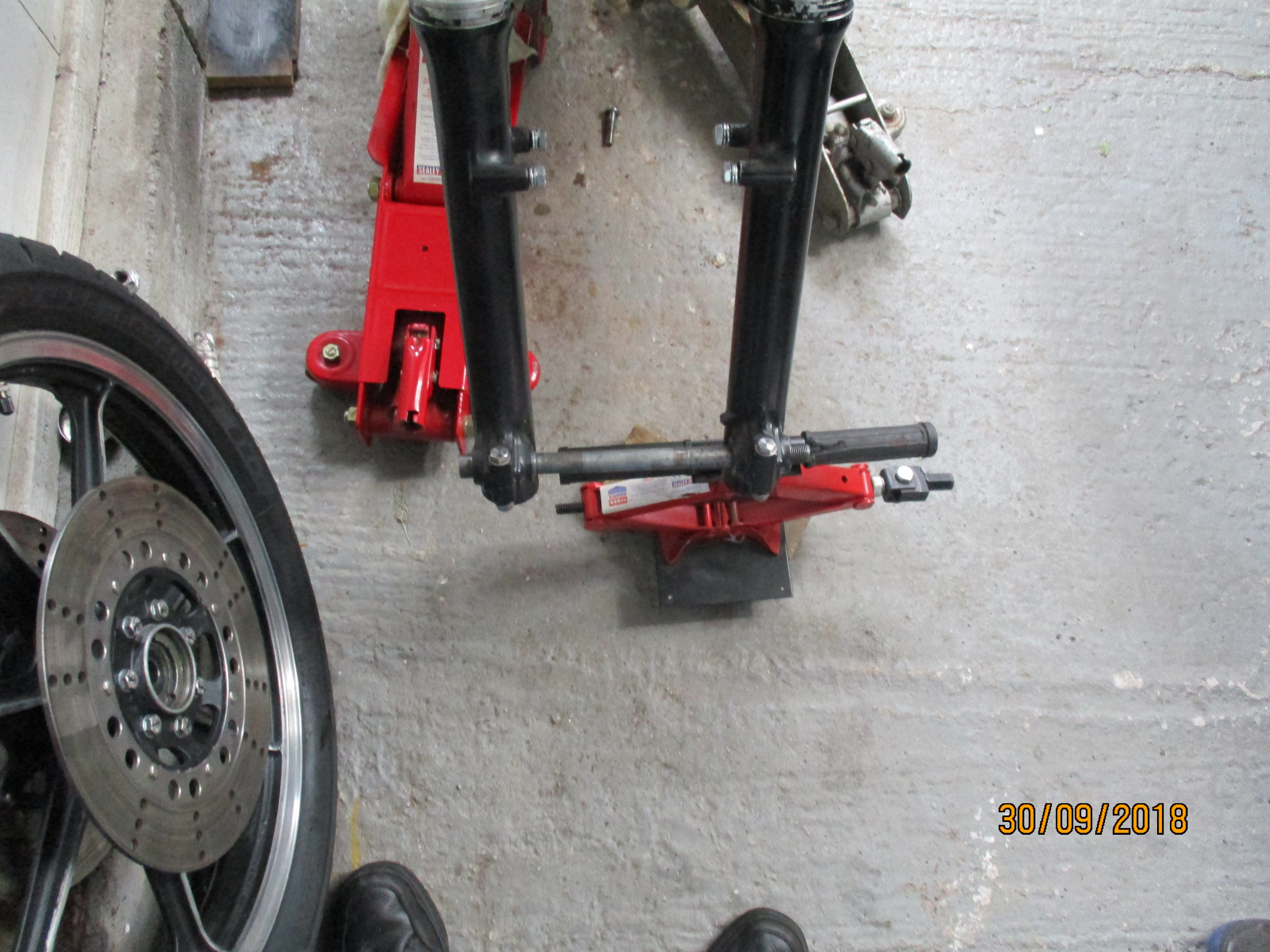

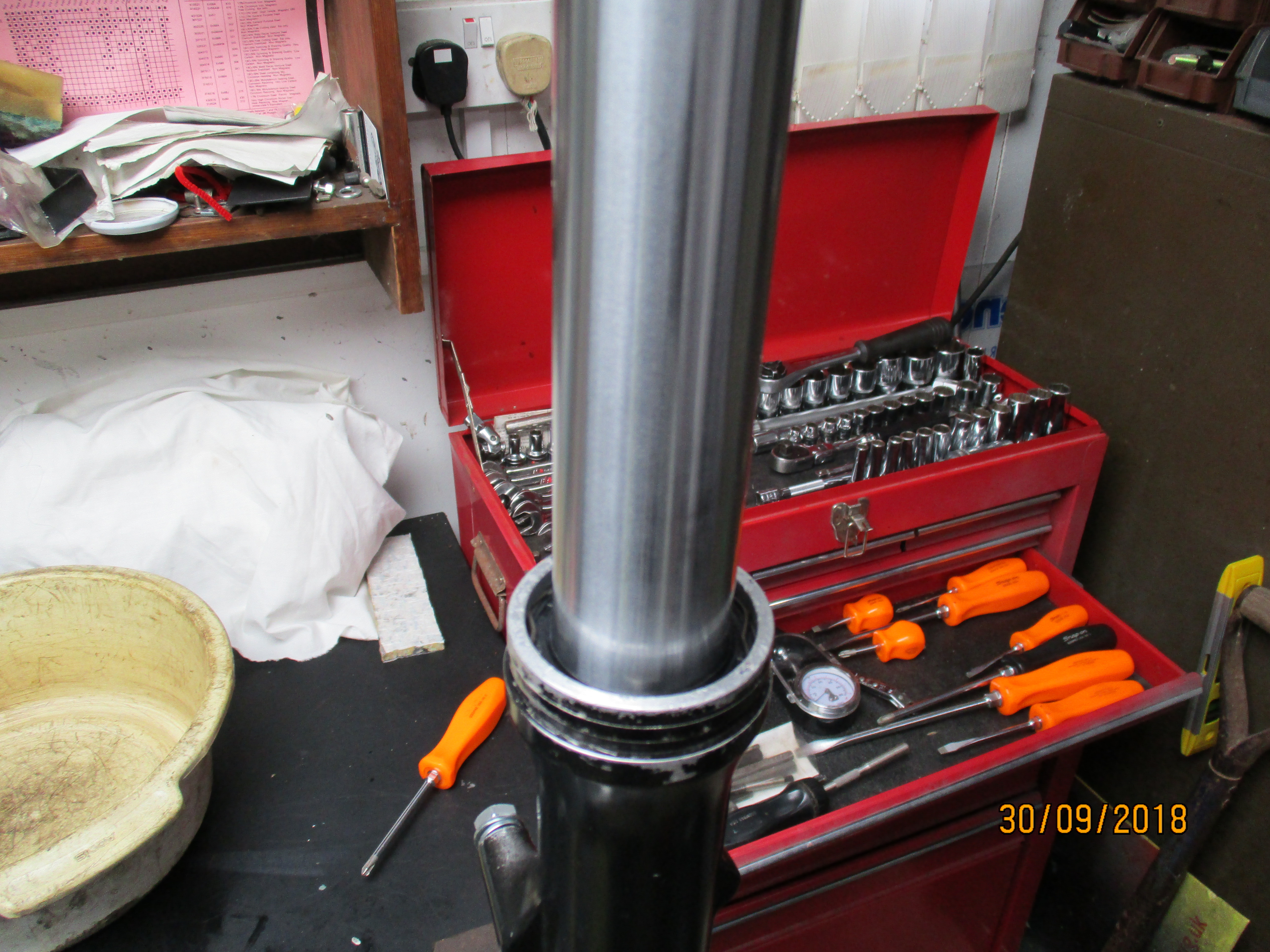

Invested in a fork seal tool.
Fork seal went in square this time.
The front spindle was very stiff and did not line up very well.

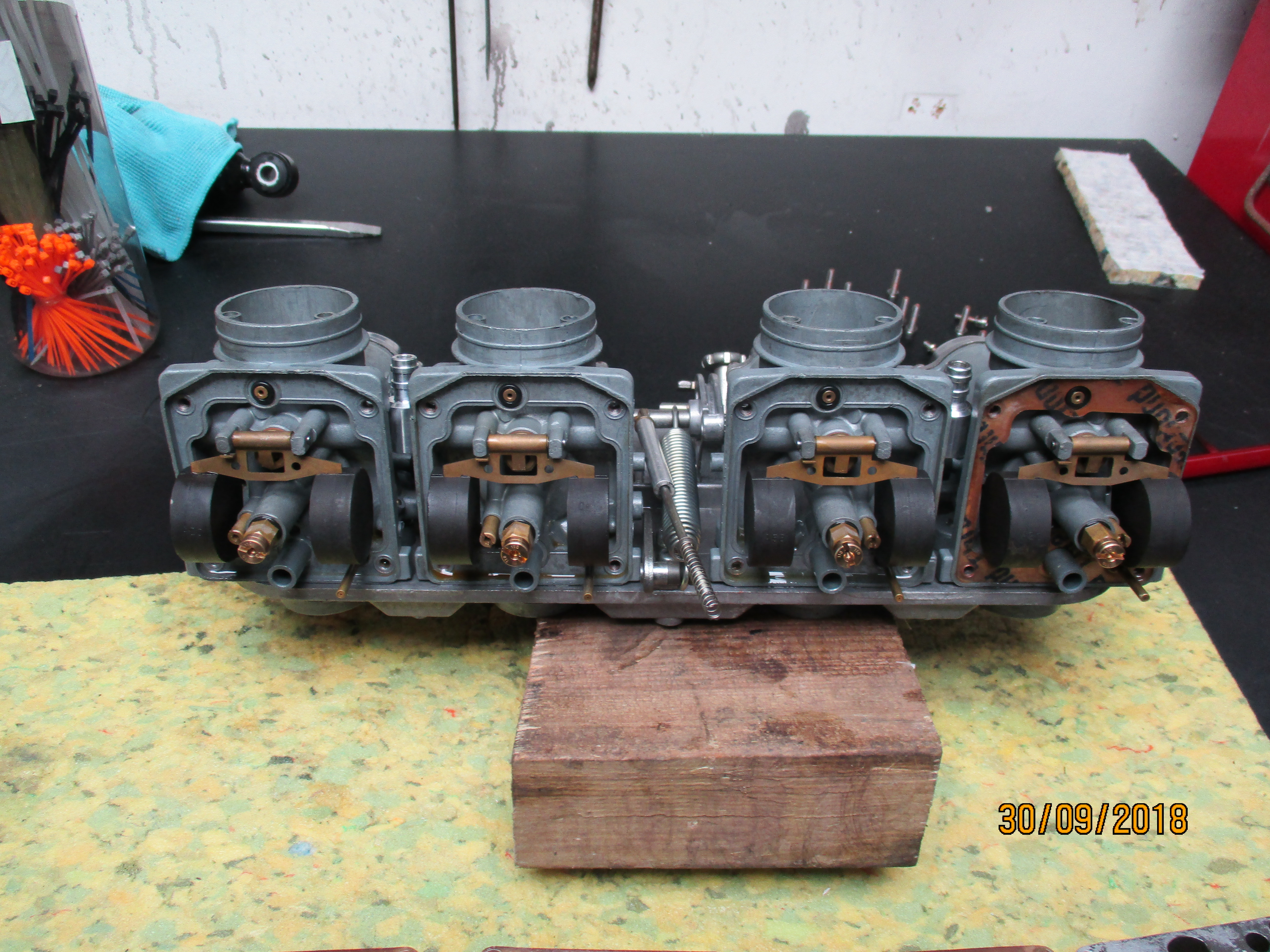

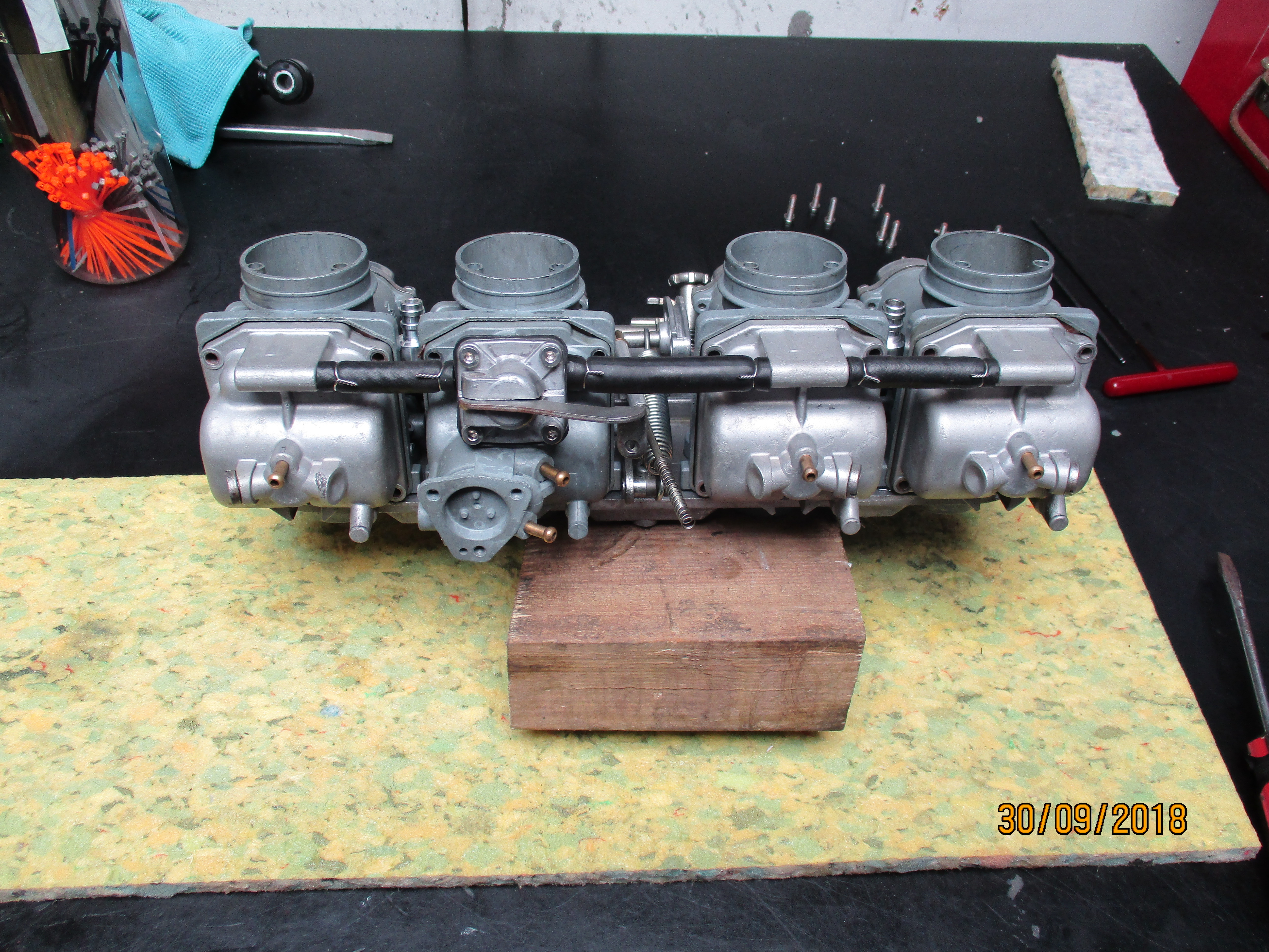

Next i am investigating the carburetors, why they are not returning to idle.
With float bowls removed.

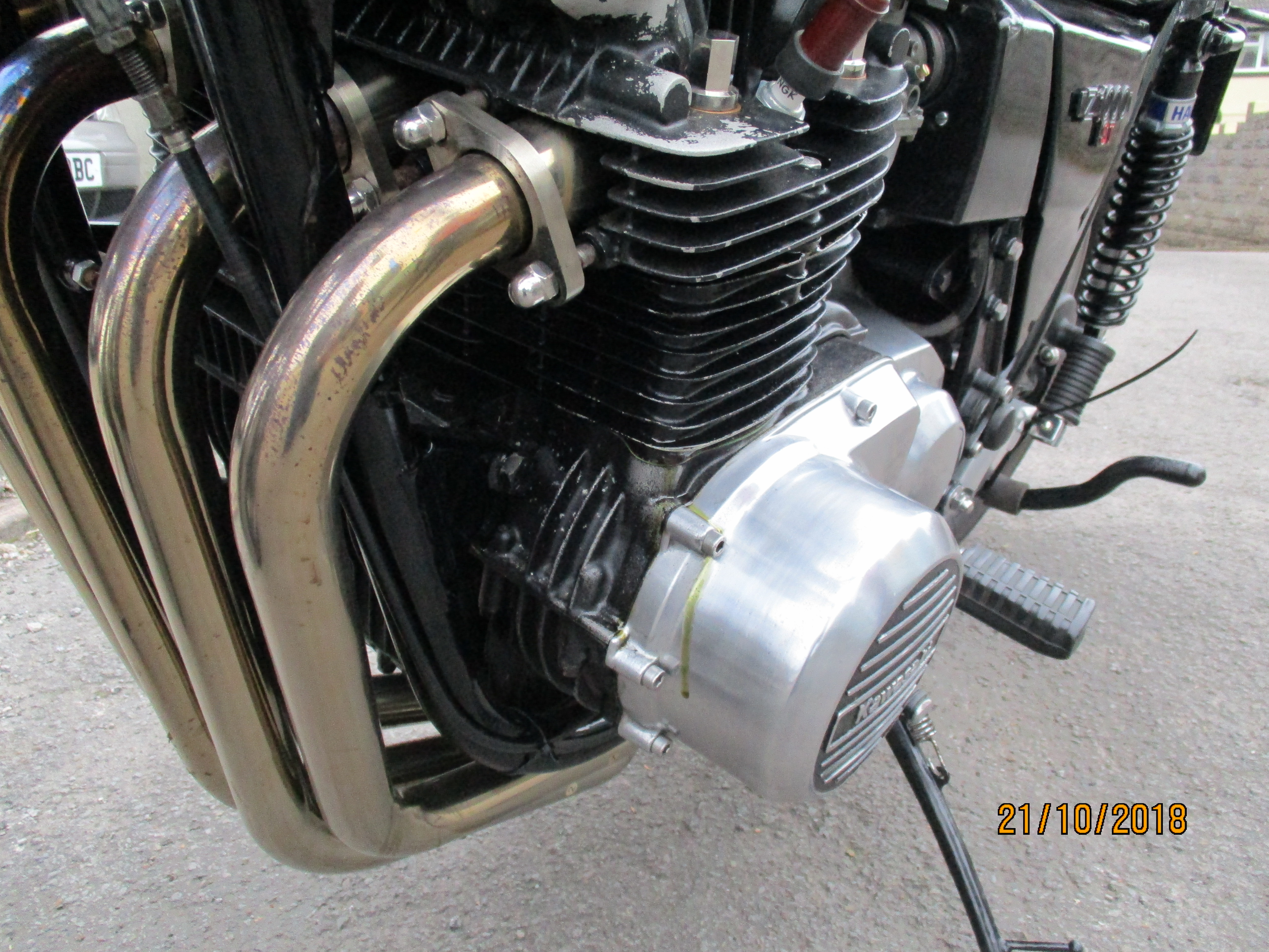

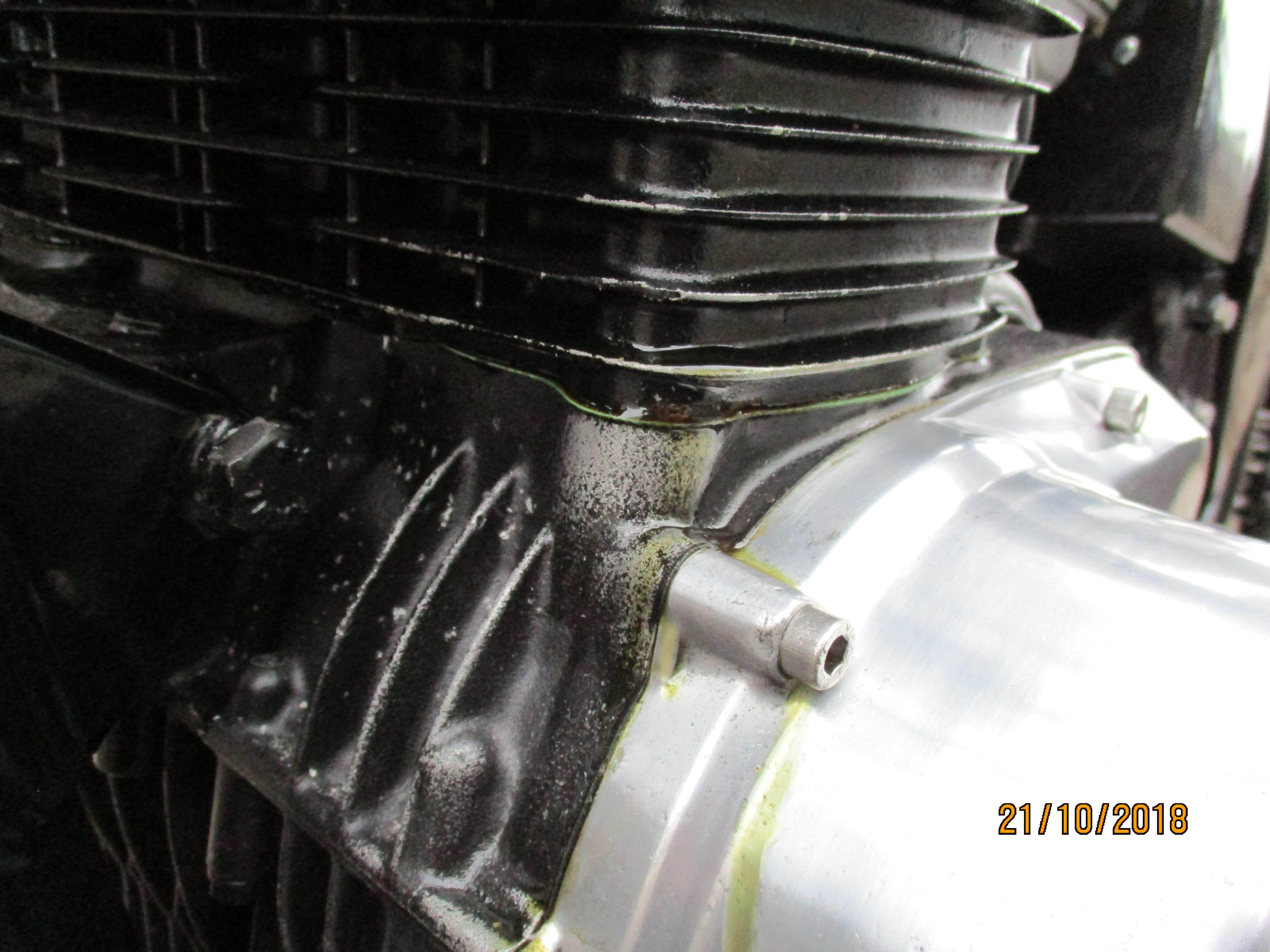

The engine had a top end rebuild 100 miles ago , just been out for a 20 mile run and the base gasket is leaking from the front left corner. I will try and torque it down when the engine cools down.

After re torquing cylinder head, i took the bike out for a run and the base gasket is still leaking.
This is a close up.
Has anyone torqued theses engines more than the specified torque to cure this?
This is a close up.
