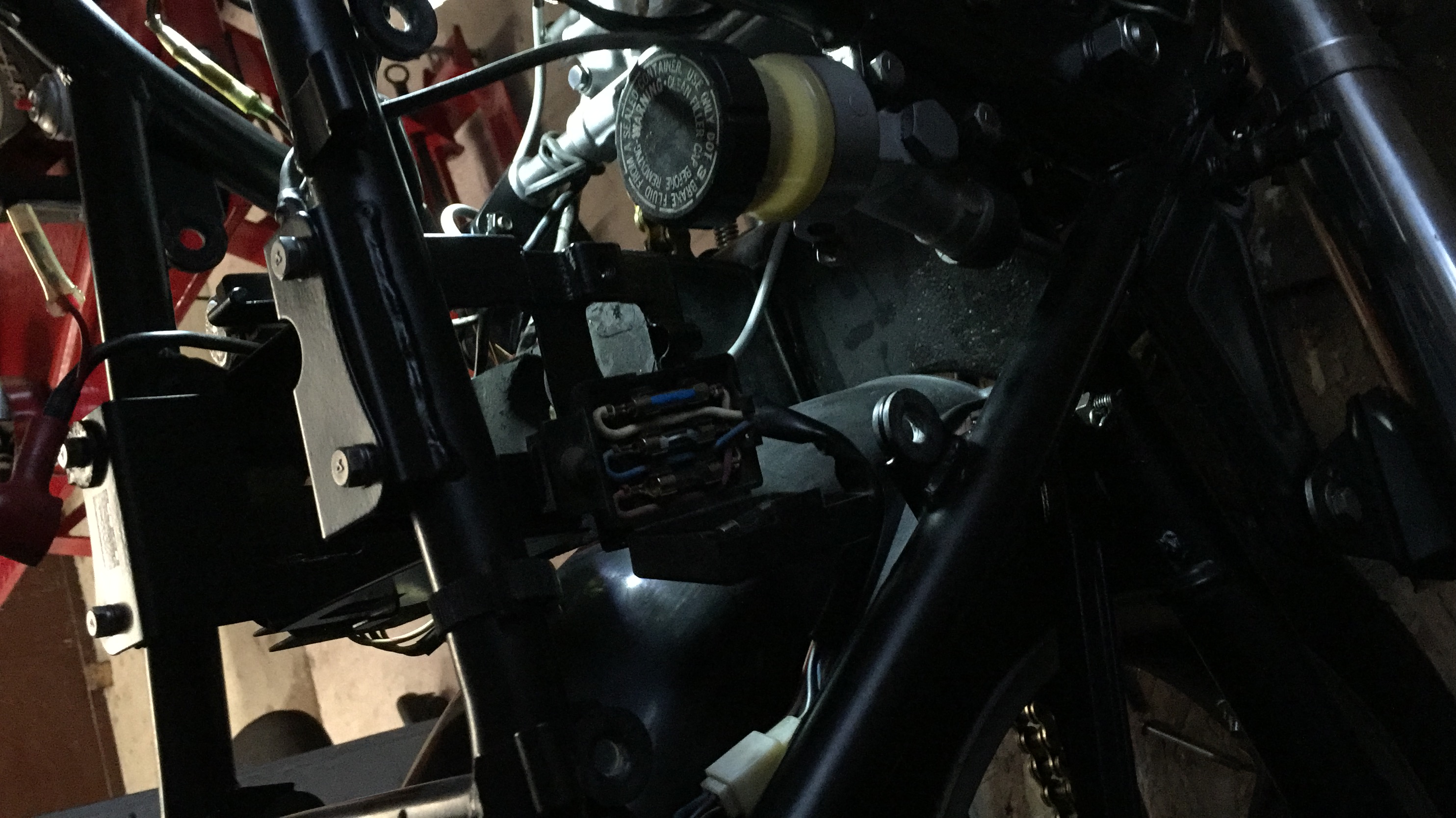

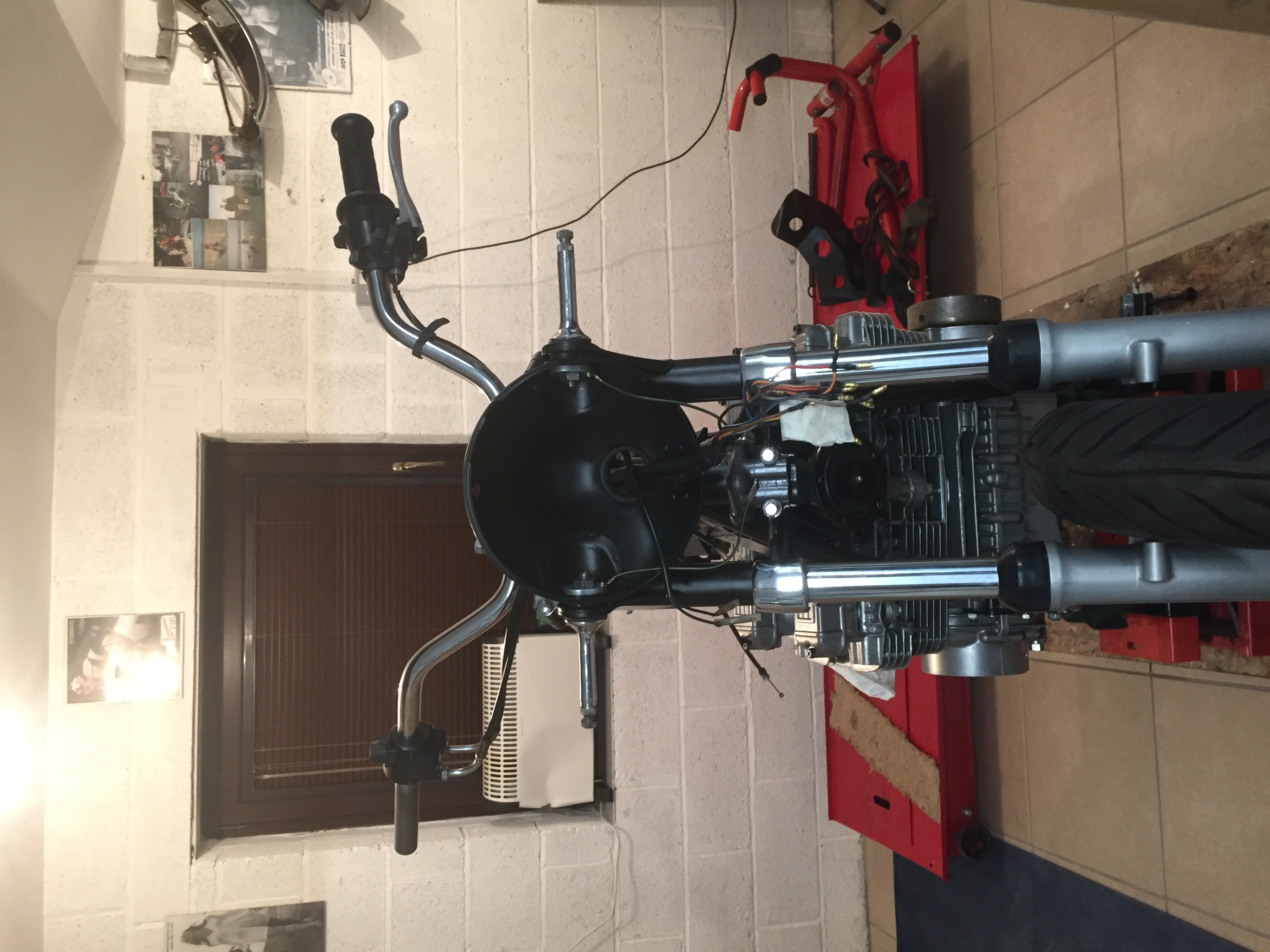

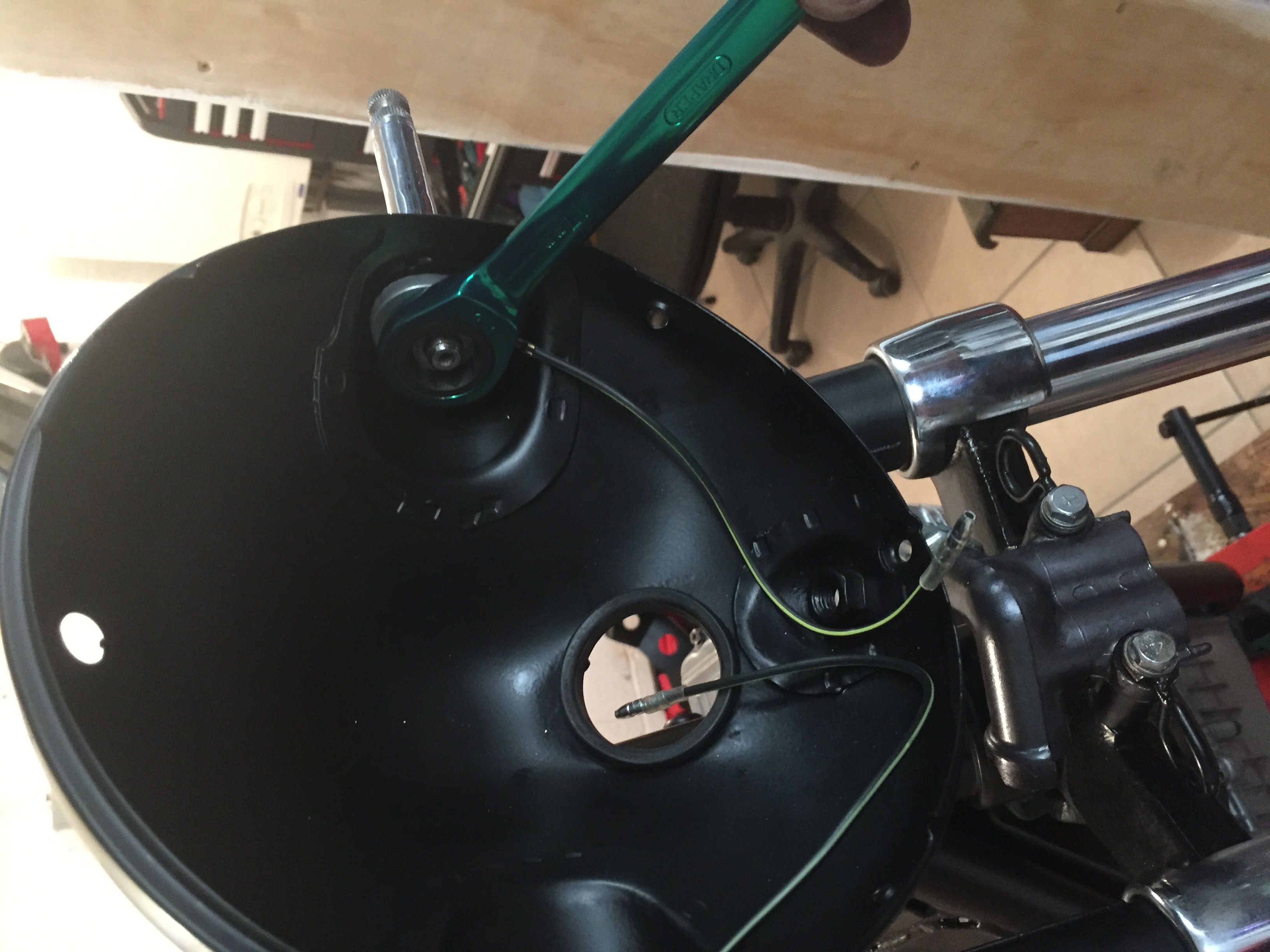

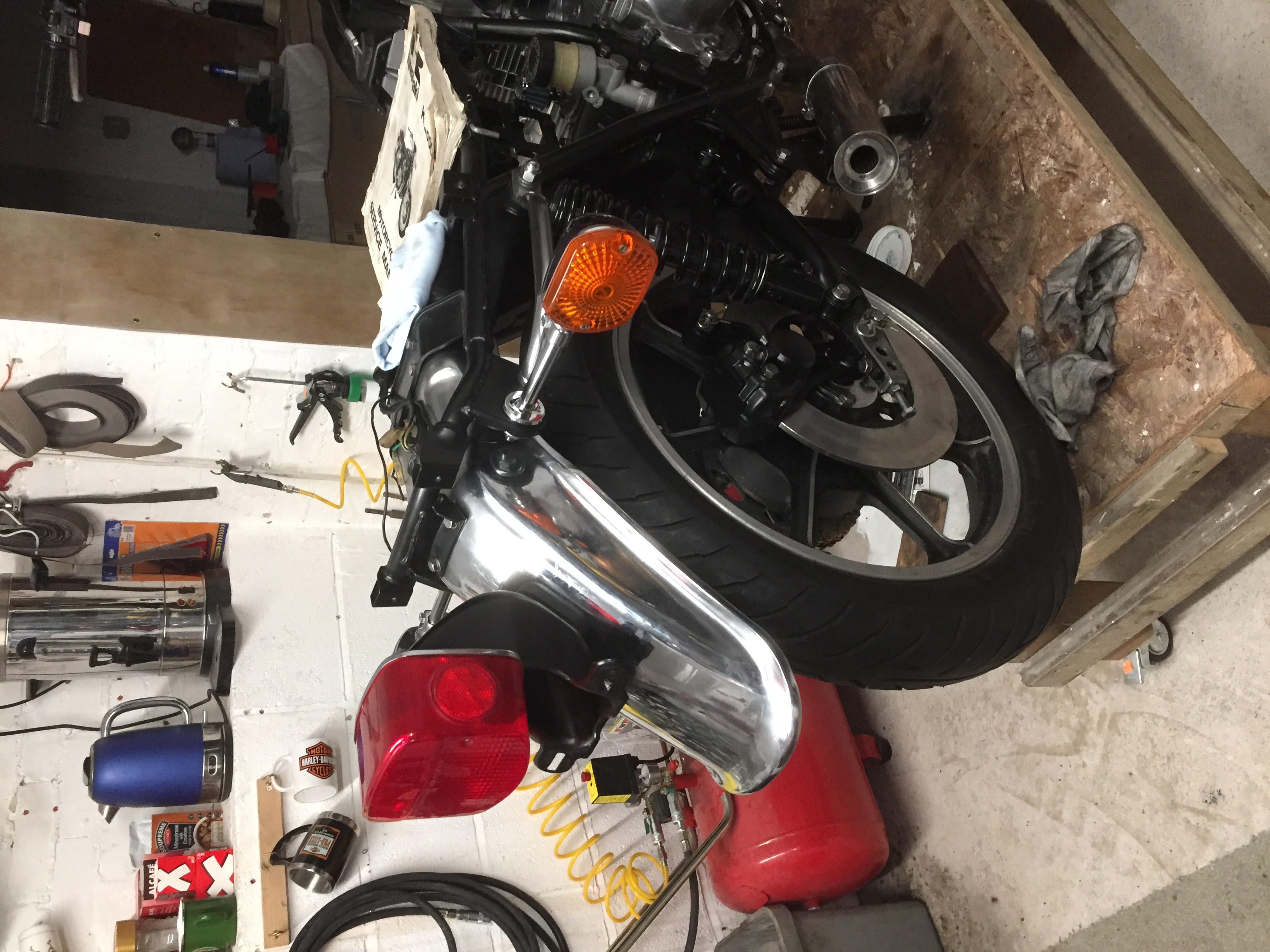

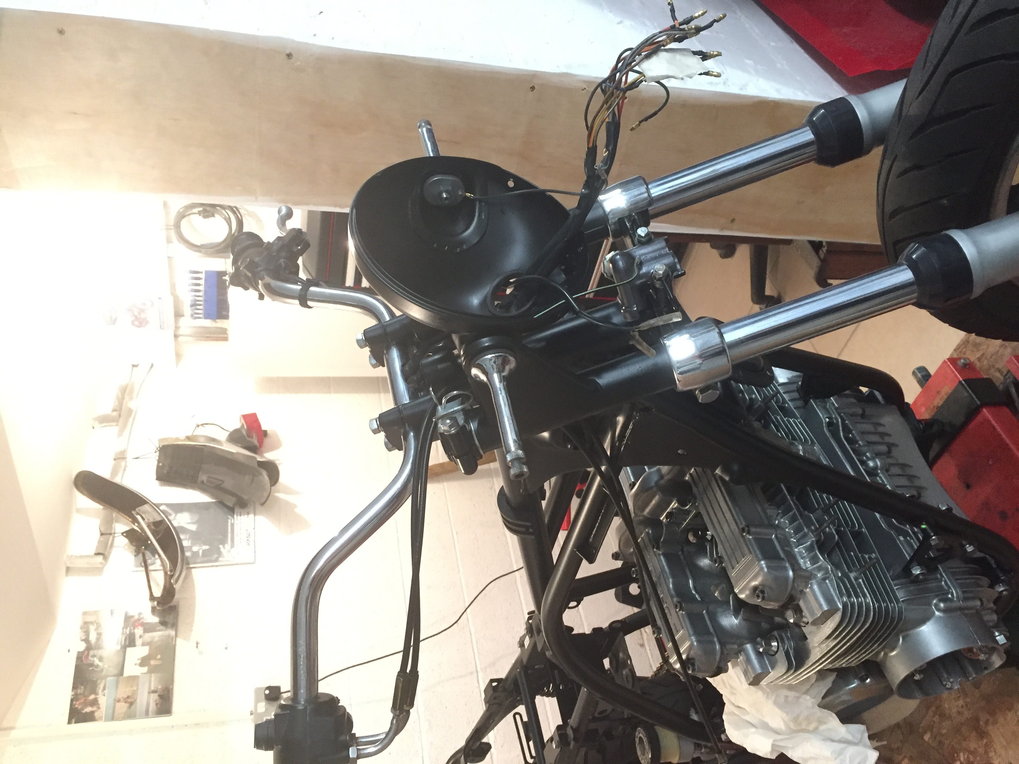

#33 PostAuthor: Bill P » Mon Feb 04, 2019 8:52 pm
Headlight shell fitted and handlebars with switchs and internal wiring ,all checked out ok
so just a clean up as i personally like the used look wherever possible ,sadly not a lot was
saveable on this one but im pleased with how she's going

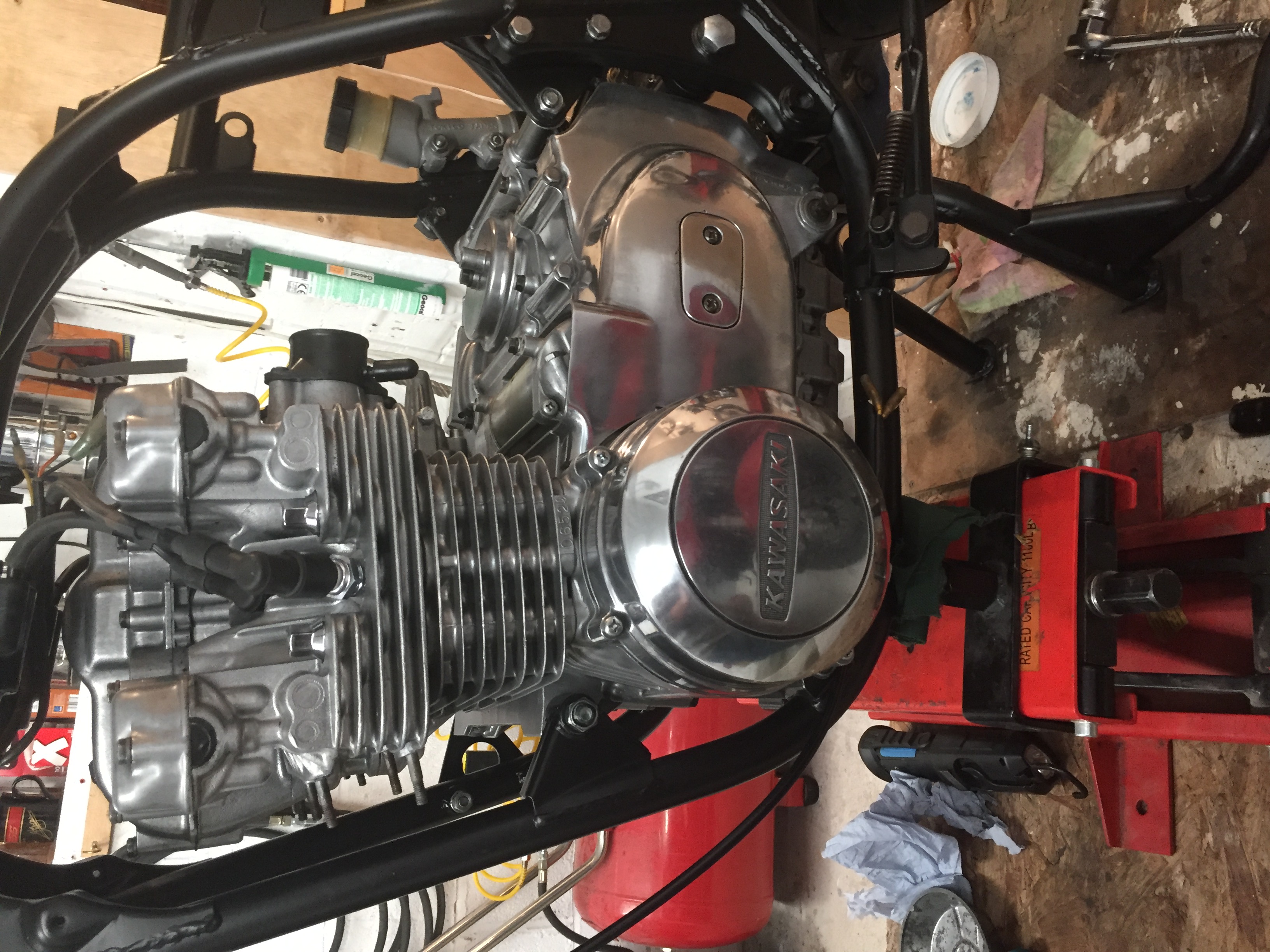

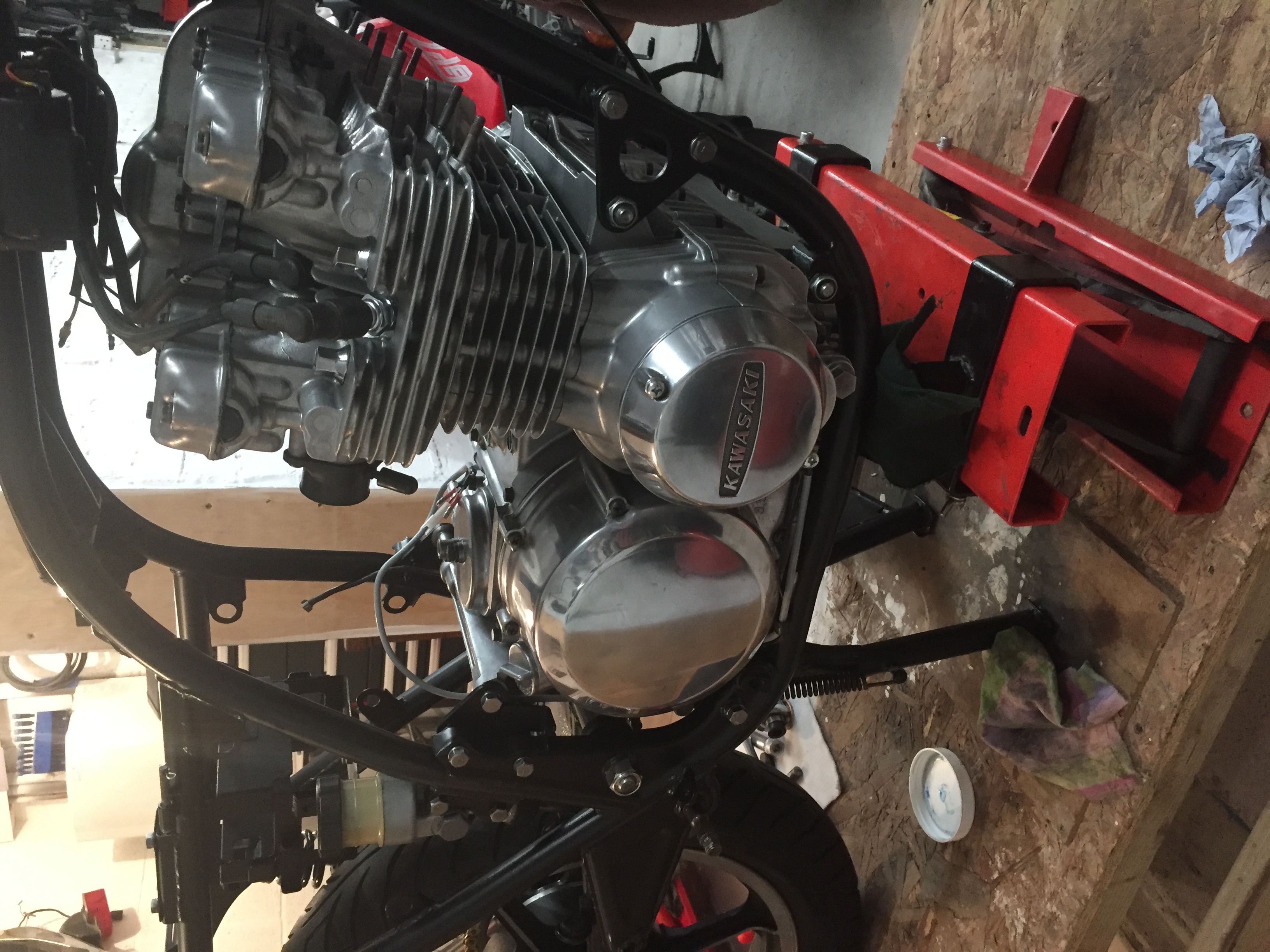

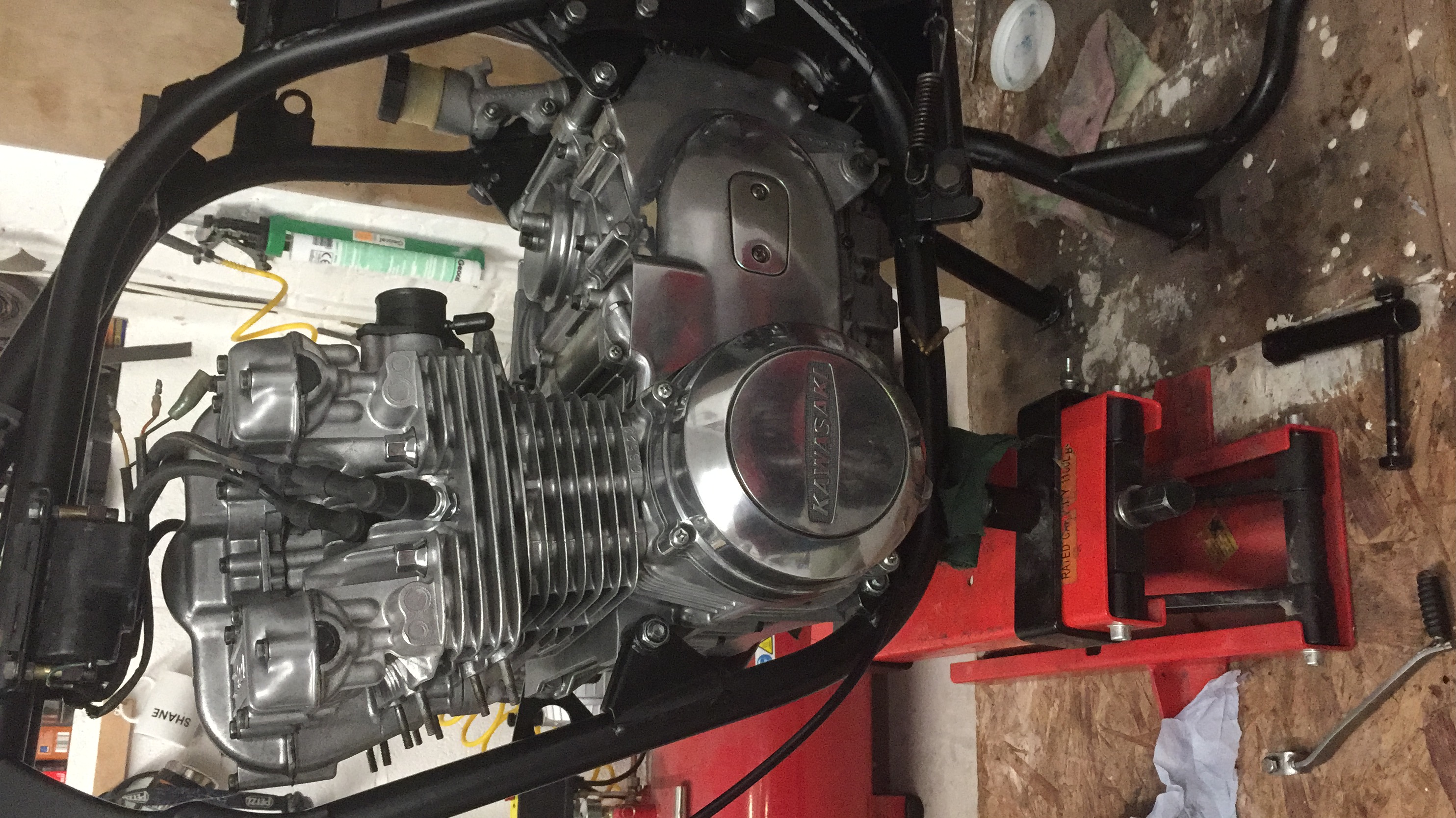

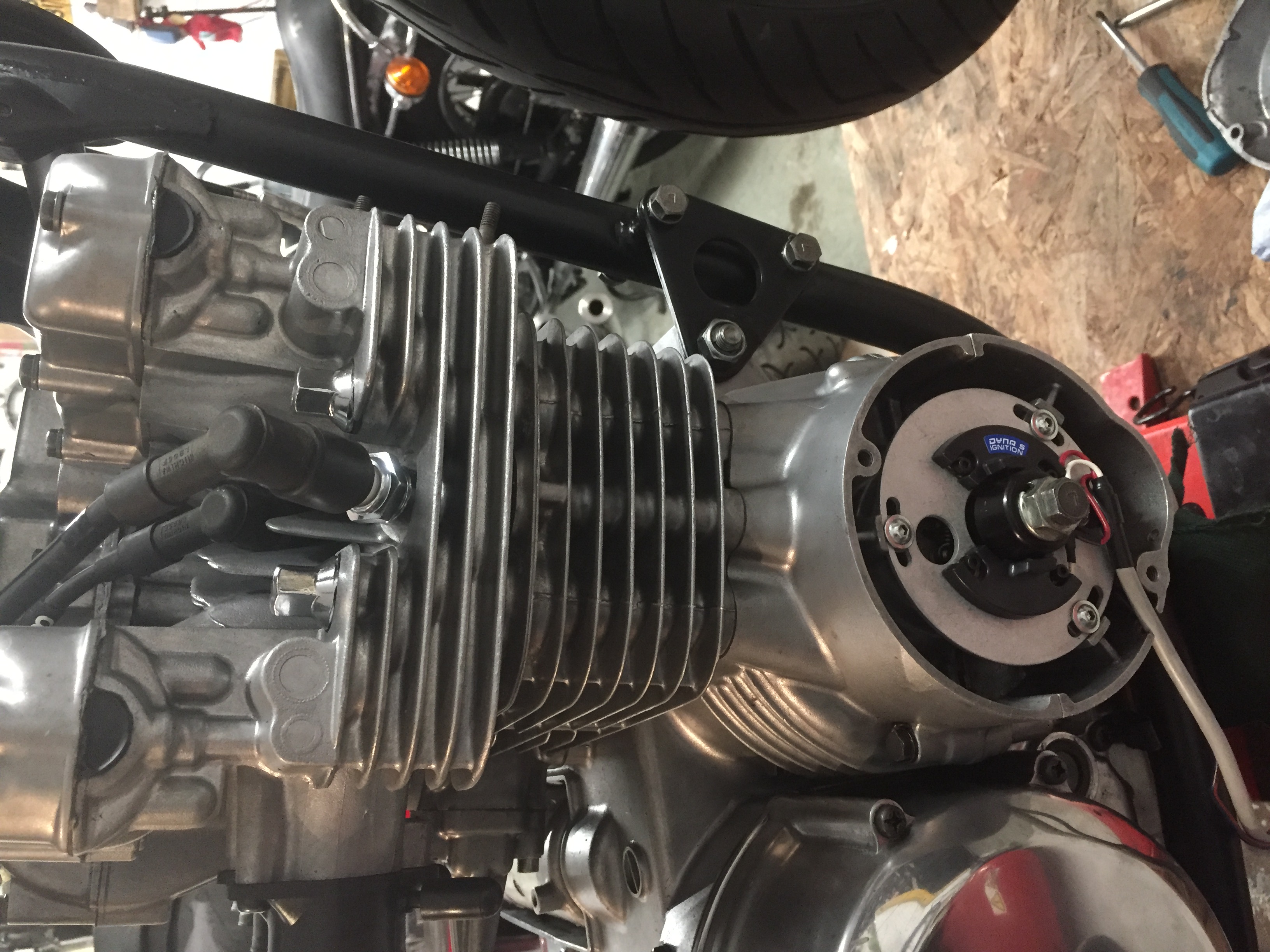

#34 PostAuthor: Bill P » Thu Feb 07, 2019 9:53 pm
Had a bit of tinkering time today so fitted the Dyna S ignition and the outer casings
clutch cables etc rear brake master cylinder and brake pedal shaft , a bit more
cleaning and checking to do on wiring harness but nearly ready

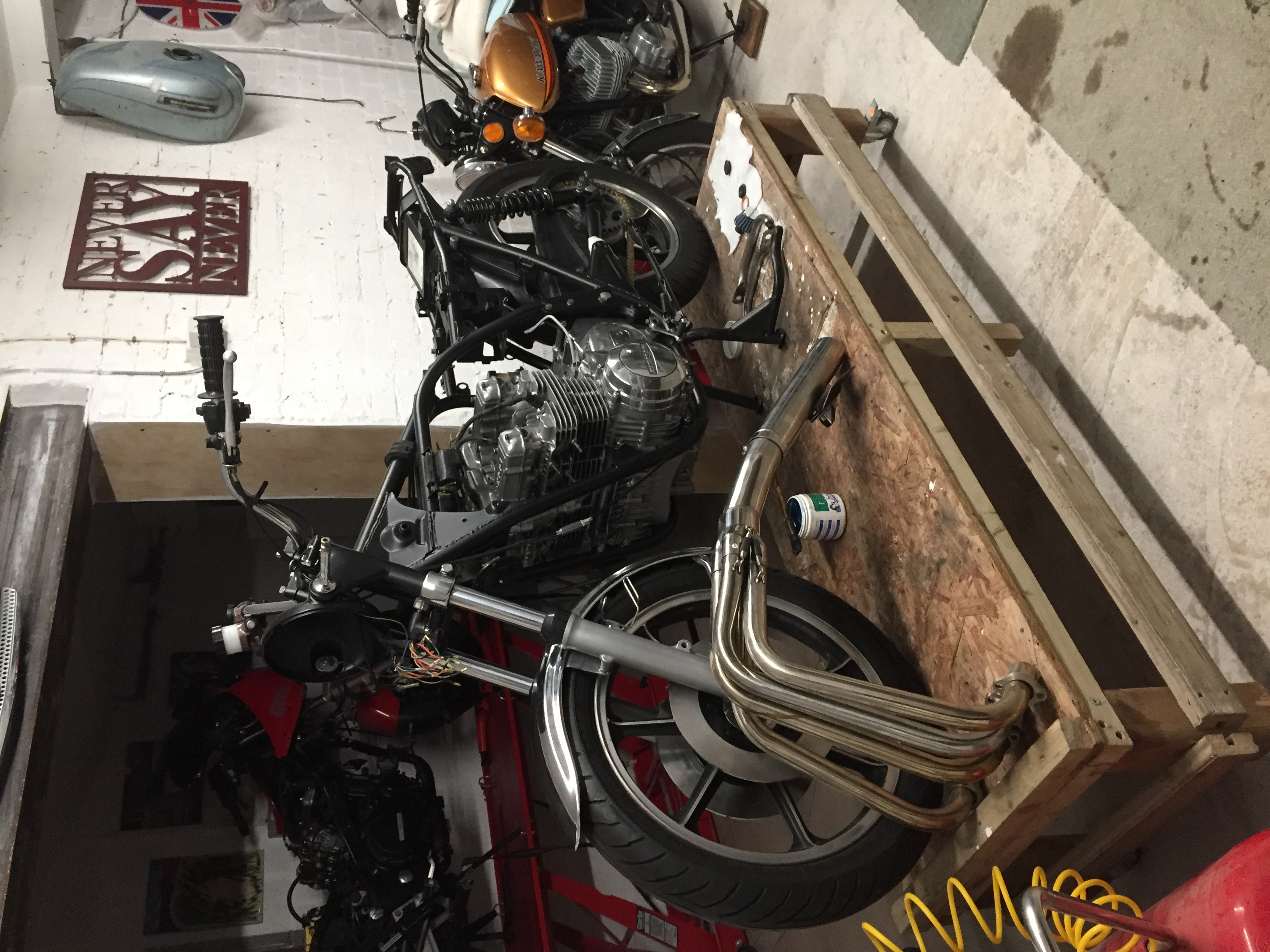

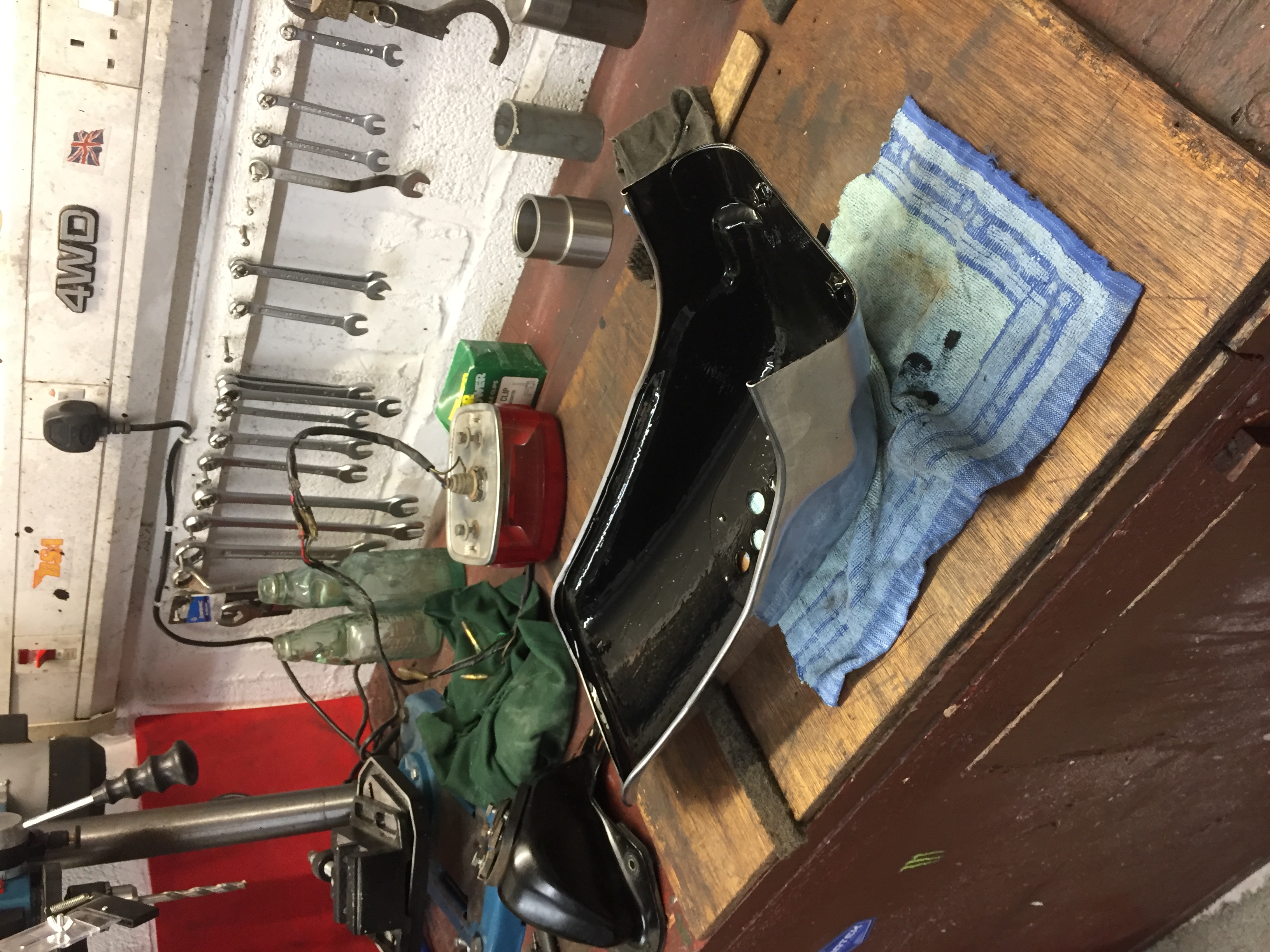

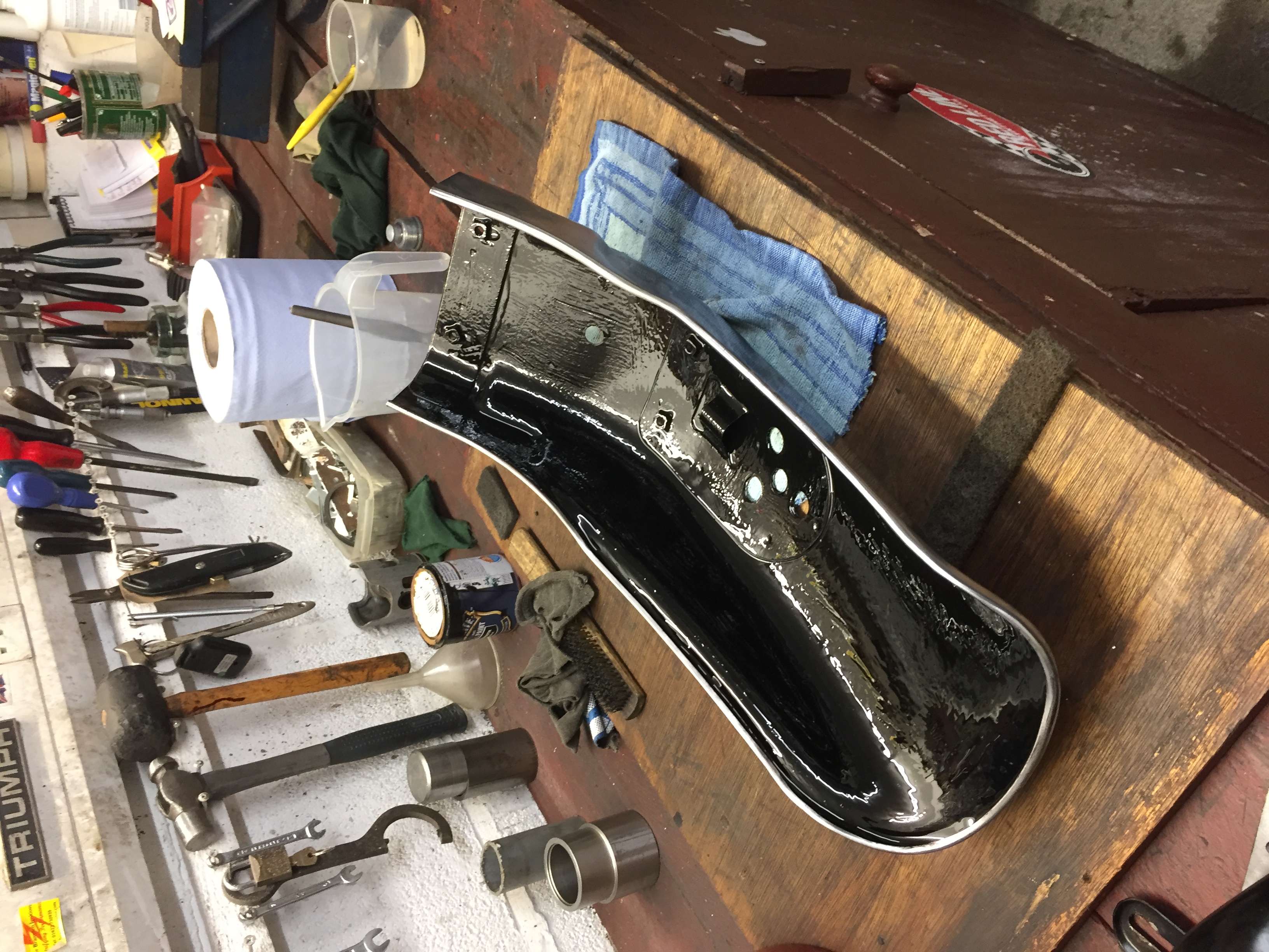

#35 PostAuthor: Bill P » Sat Feb 23, 2019 10:44 am
Couple more bits done in between messing with others and of course riding a bit , found a Delkavic exhaust id forgot
about , mudguards cleaned and treated underneath both very solid .

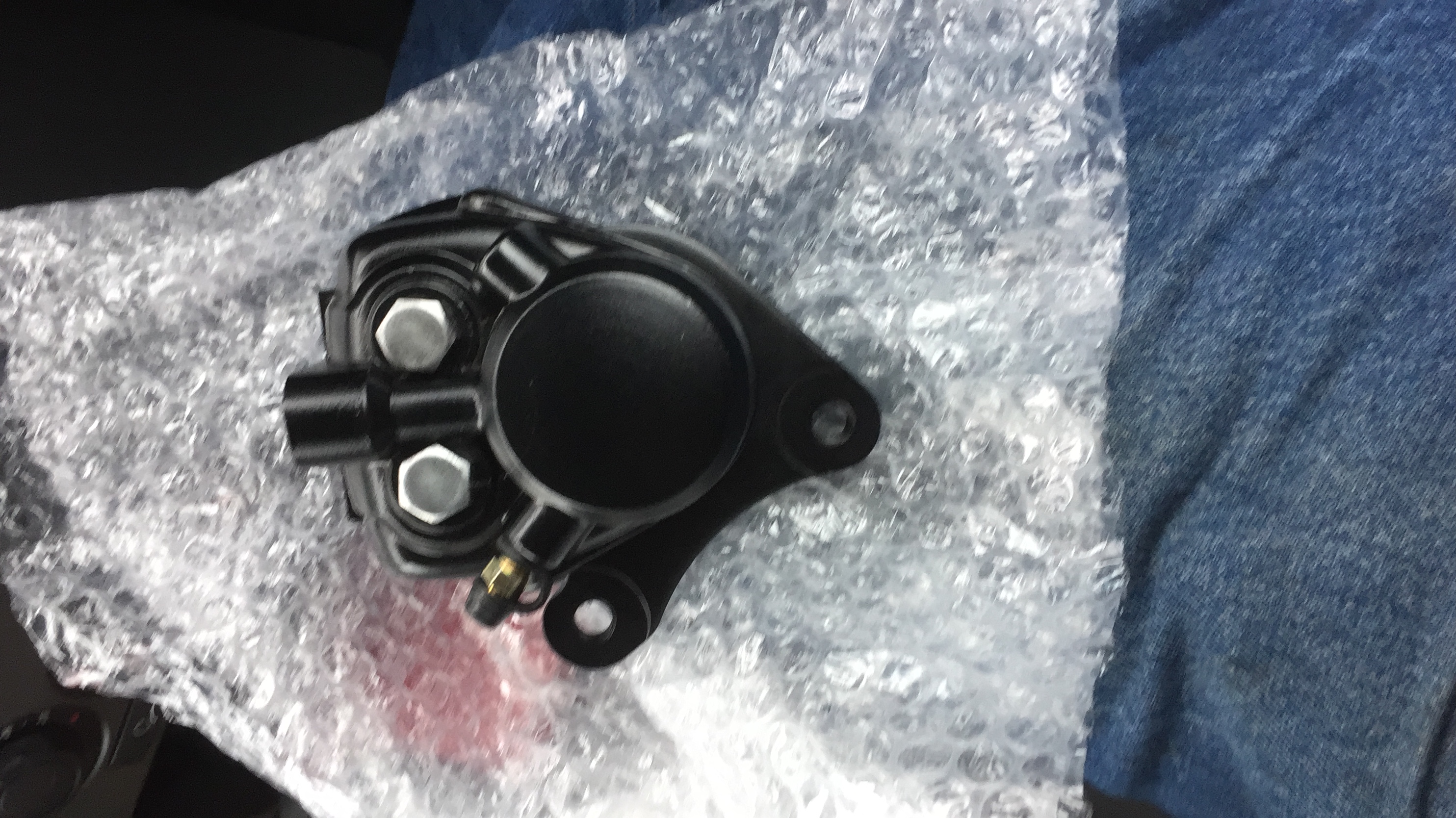

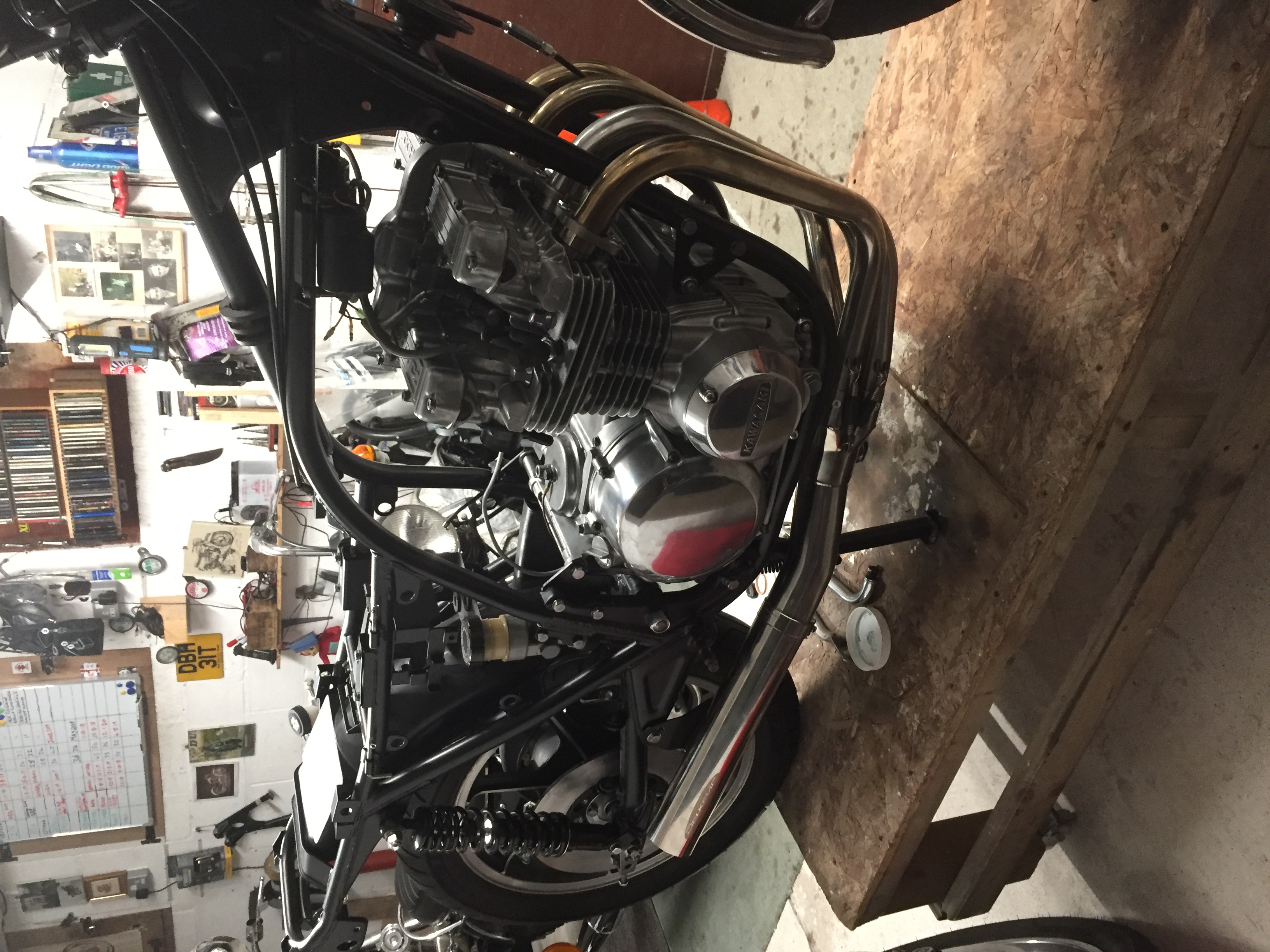

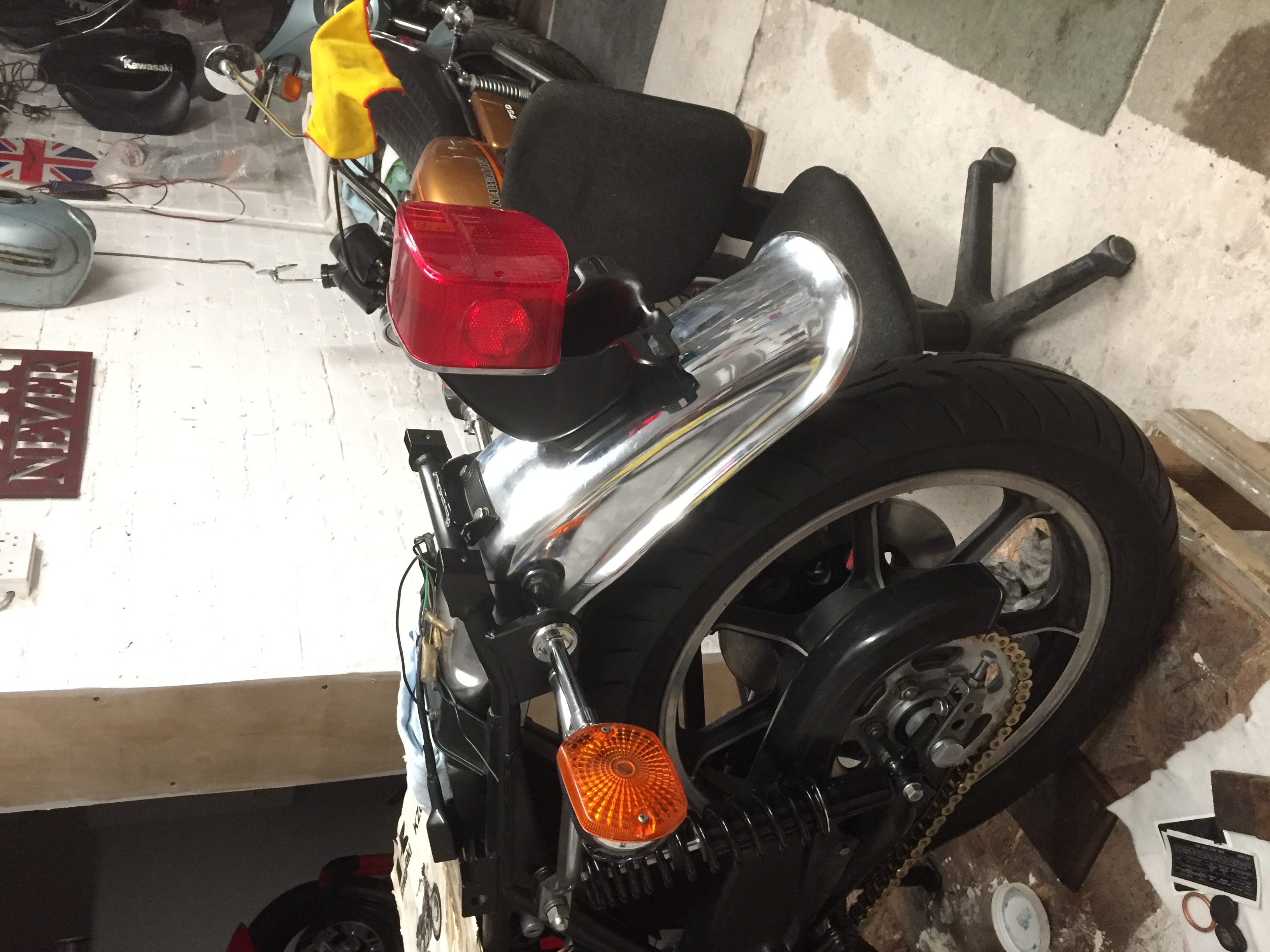

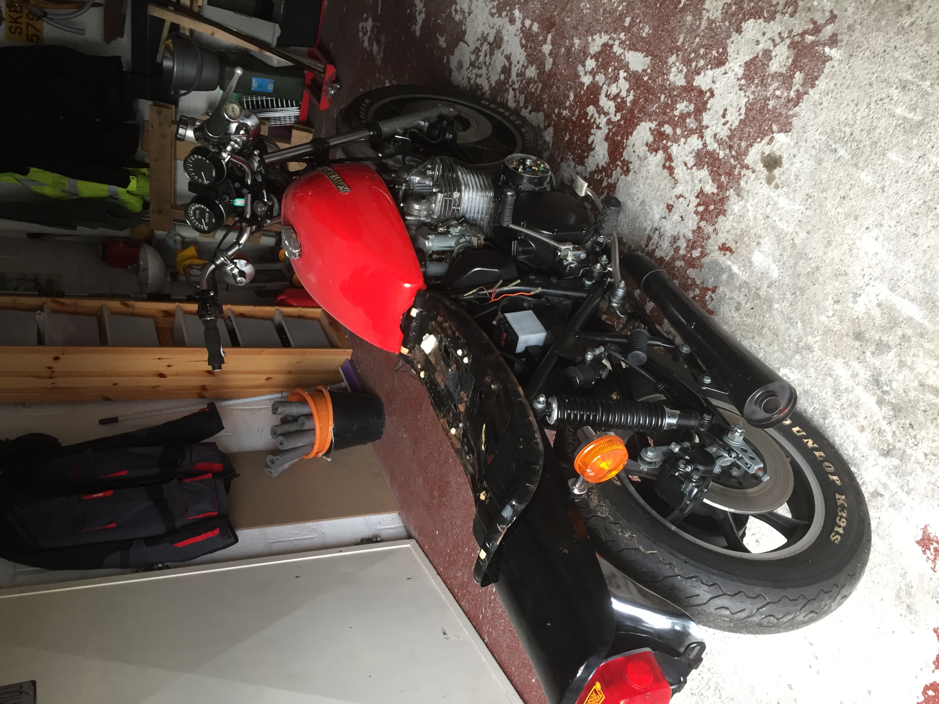

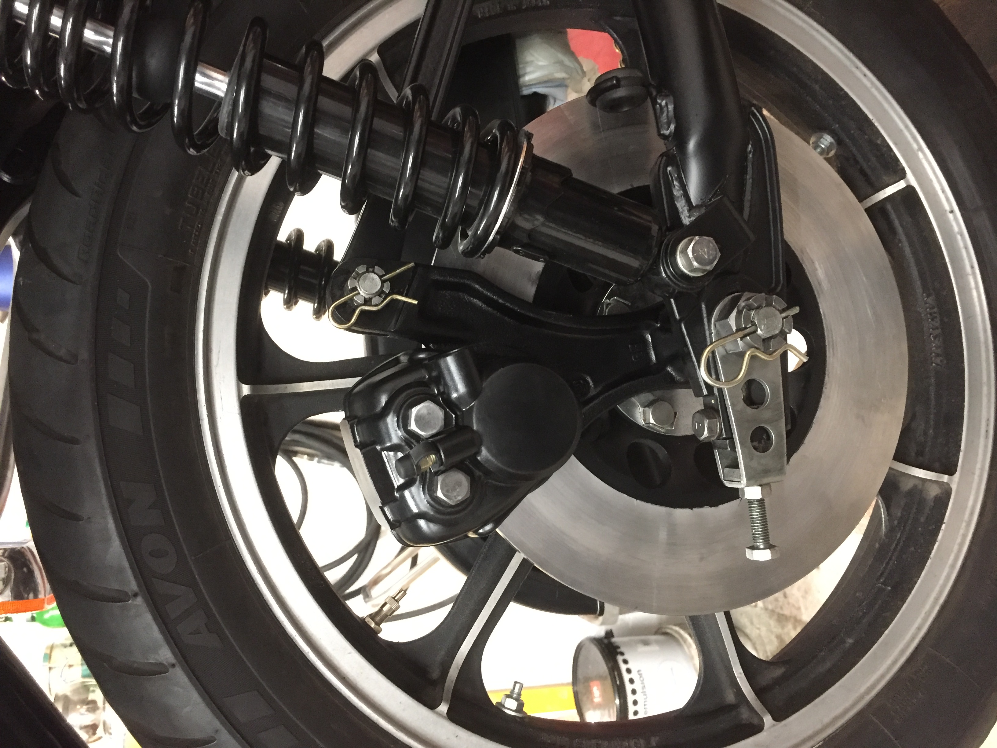

#38 PostAuthor: Bill P » Thu Feb 28, 2019 7:38 pm
Had a bit of z650 time today so fitted the refurbed rear caliper as electrics are on hold waiting for my Z Power delivery
as i decided to treat her to Dyna coils , should get front calipers on tomorrow
I know the wheels mucky been hanging around a while :D

#39 PostAuthor: Gonzo » Thu Feb 28, 2019 7:42 pm
Bill P wrote:mudguards cleaned and treated underneath both very solid .
Bill
What are you using to clean / treat the underside of your mudguards?
Steve
1978 Z1000A2
Previous Zeds:
1975 Z1B
1982 Z650F3
Posts: 1404
Re: Z650c2 restoration
#40 PostAuthor: Bill P » Thu Feb 28, 2019 8:47 pm
Hey up Steve
i blasted them in my cabinet then just Kurust and smoothrite paint as i couldn't think
what else and its lasted well on another one i did a few yrs ago

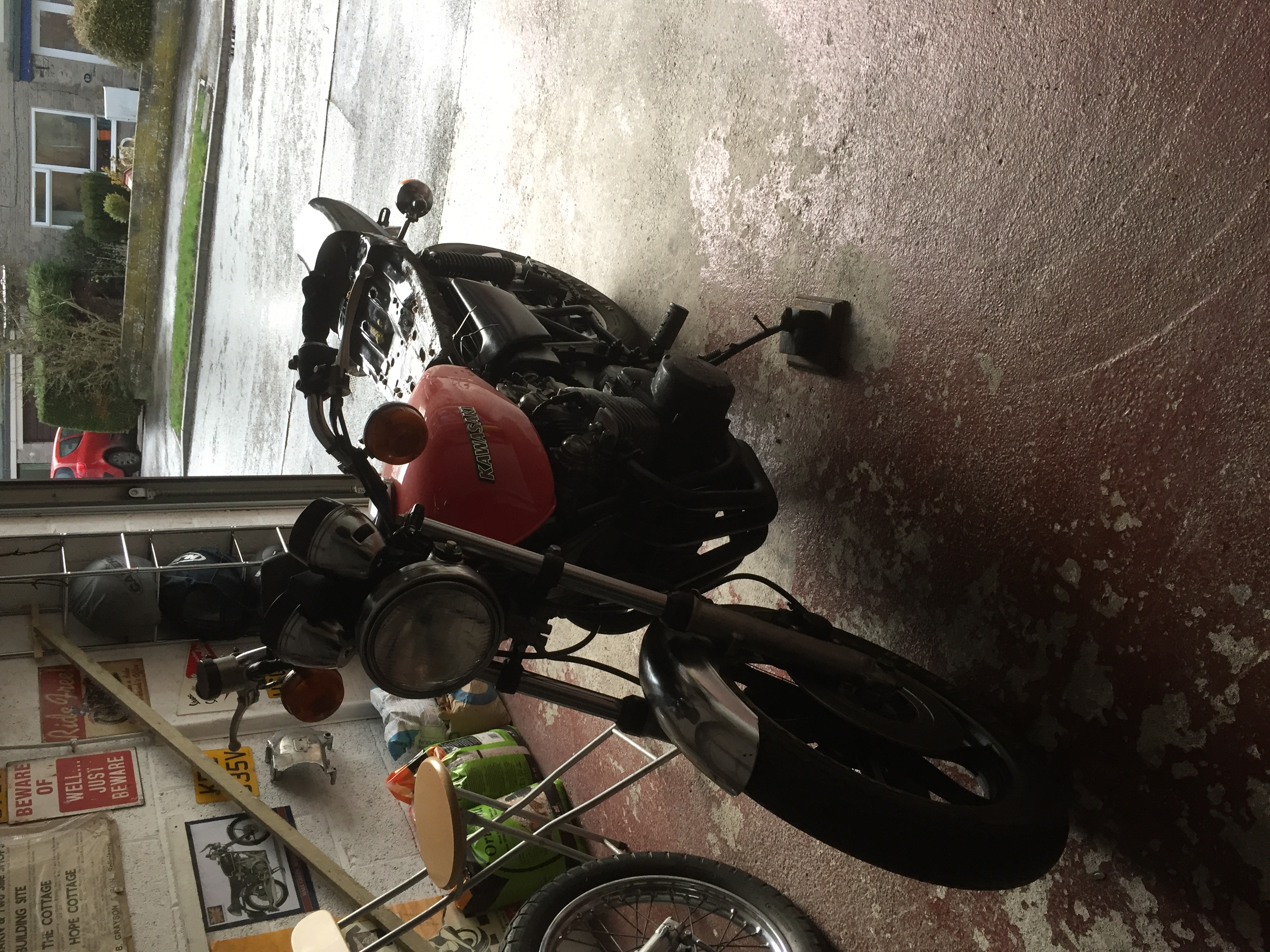

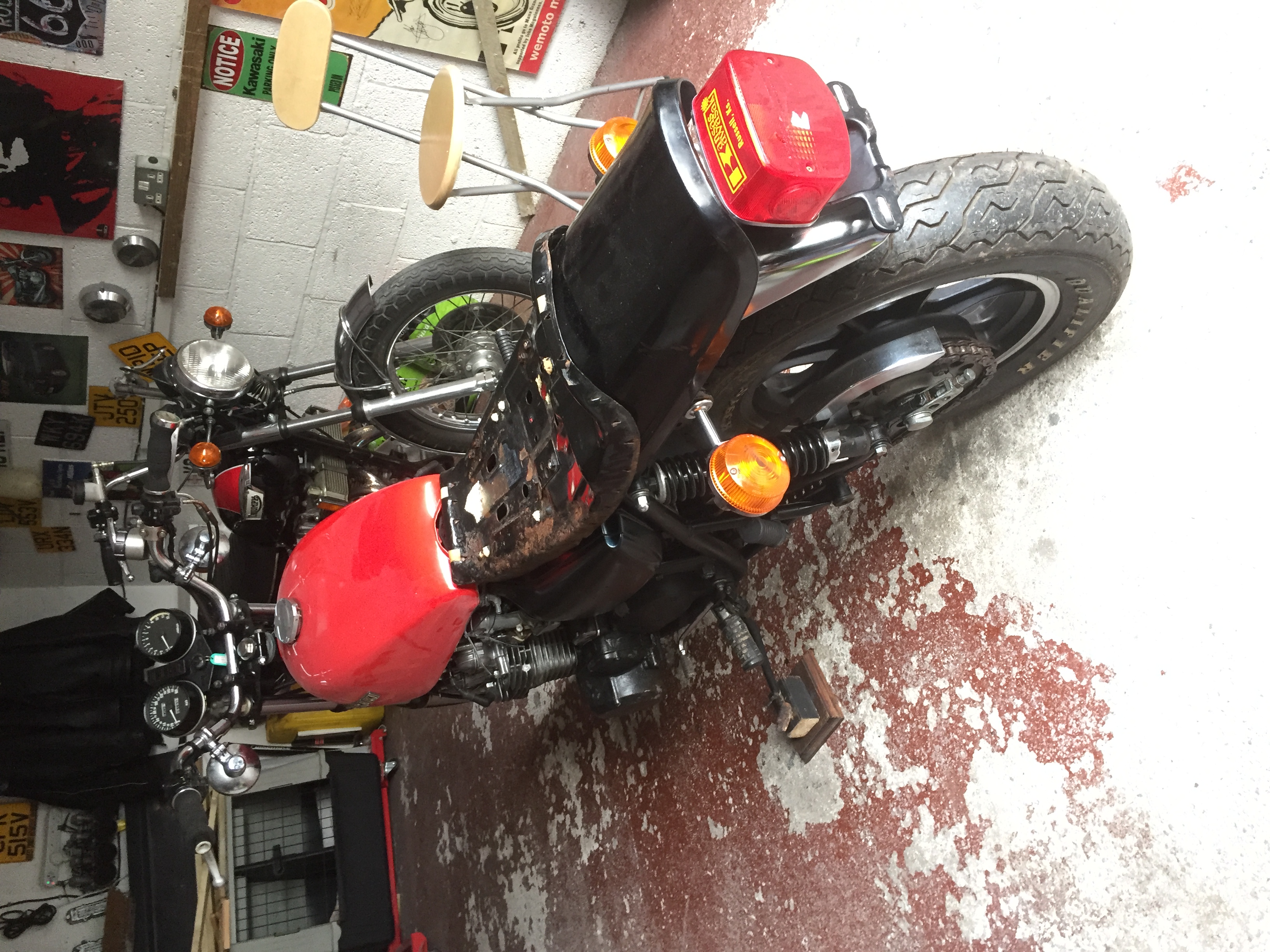

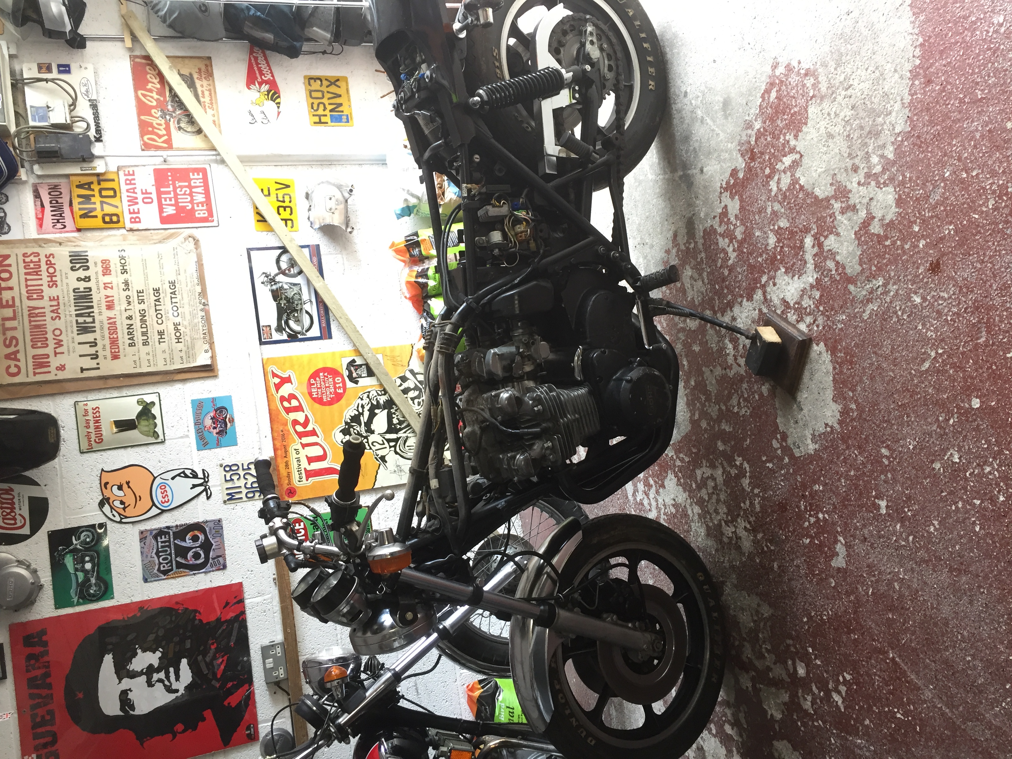

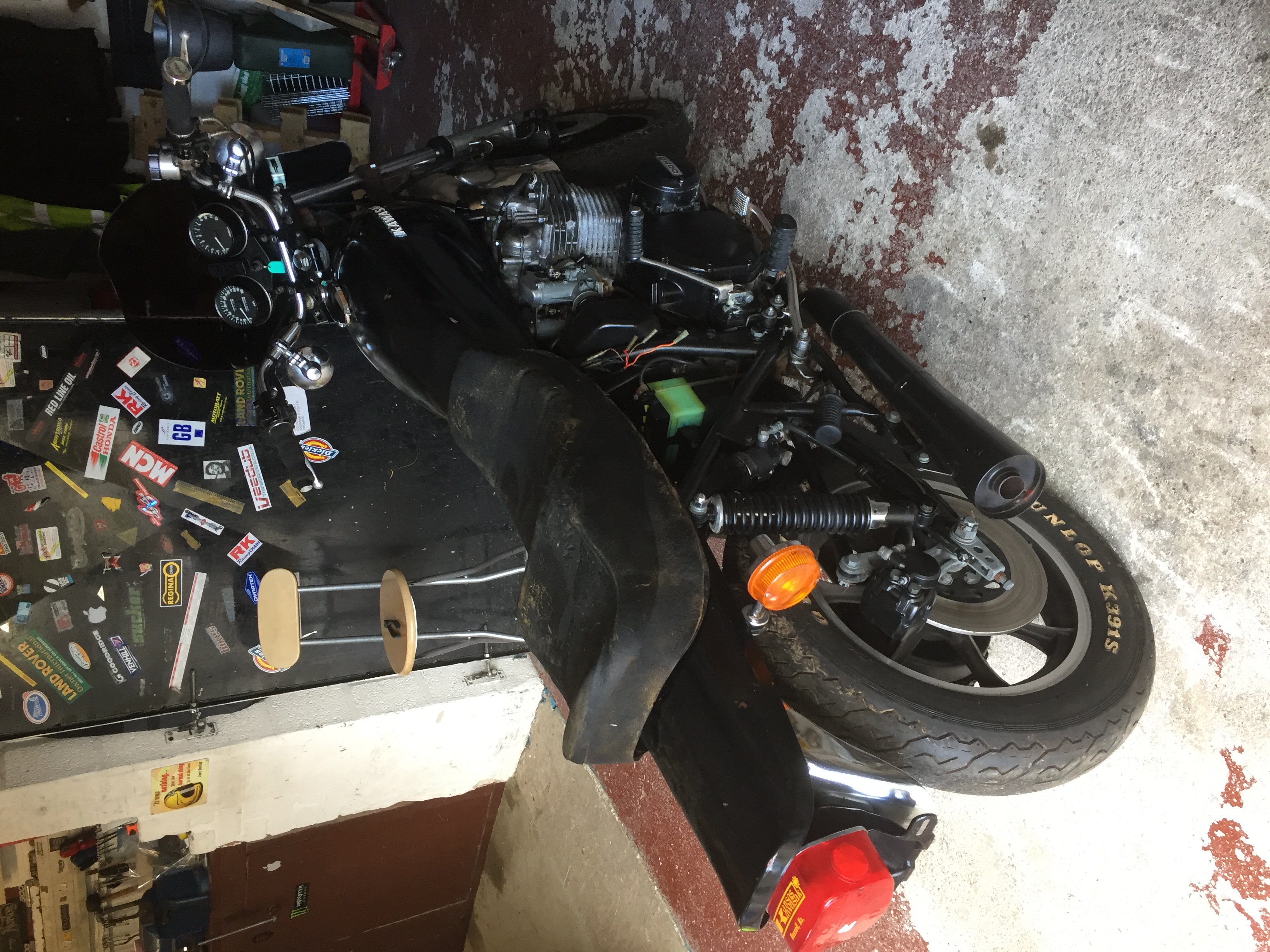

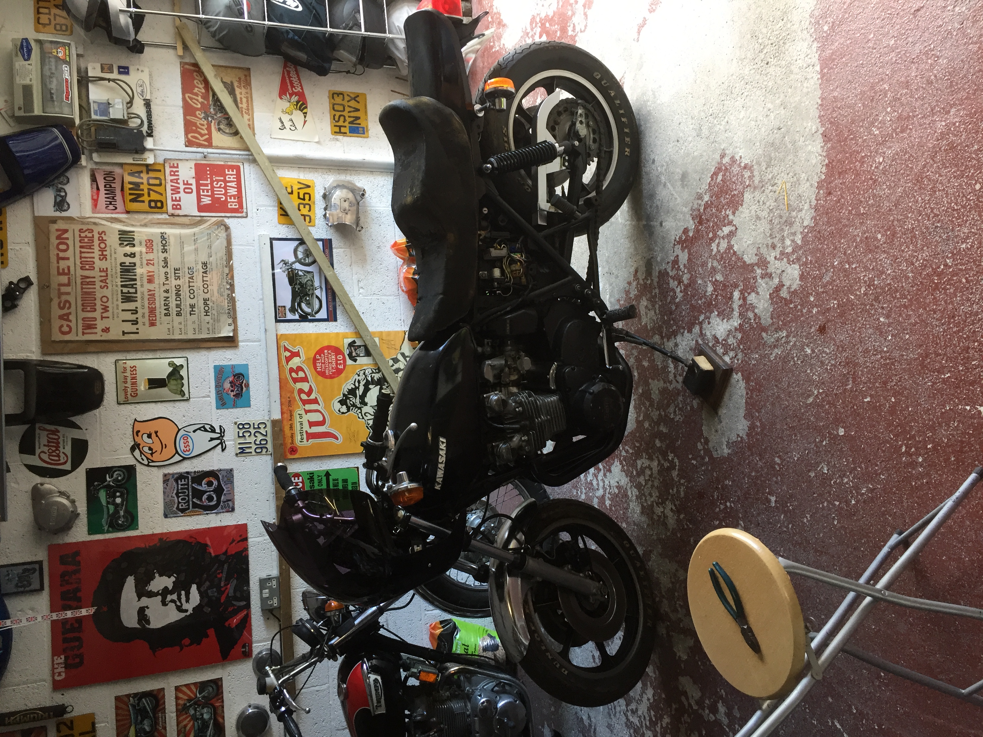

#43 PostAuthor: Bill P » Mon Mar 04, 2019 3:09 pm
Well the deal came of so here it is, seller delivered her this dinner time nice bloke came with
Nova and original receipt from him buy-in it from D&K in 2014

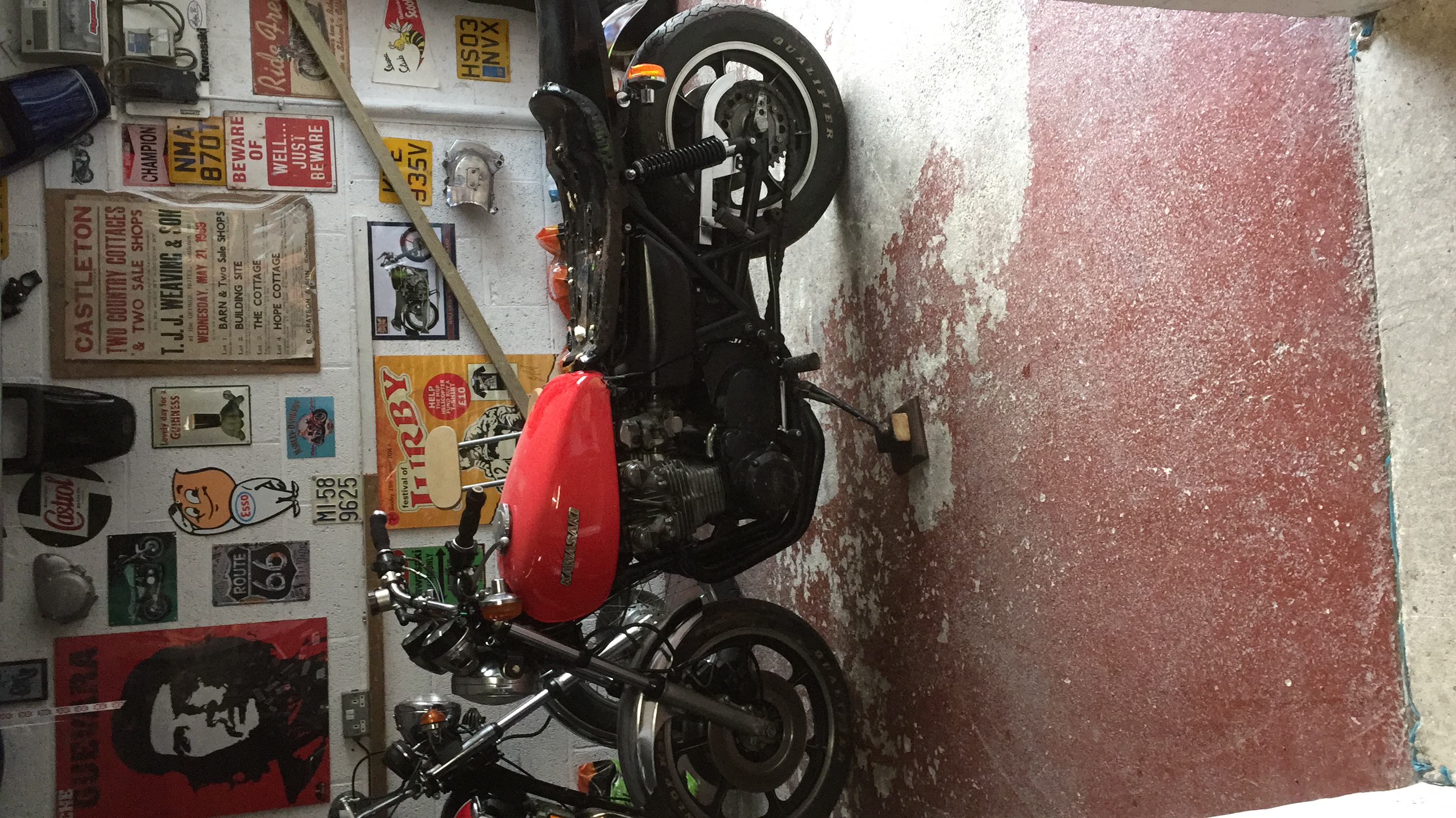

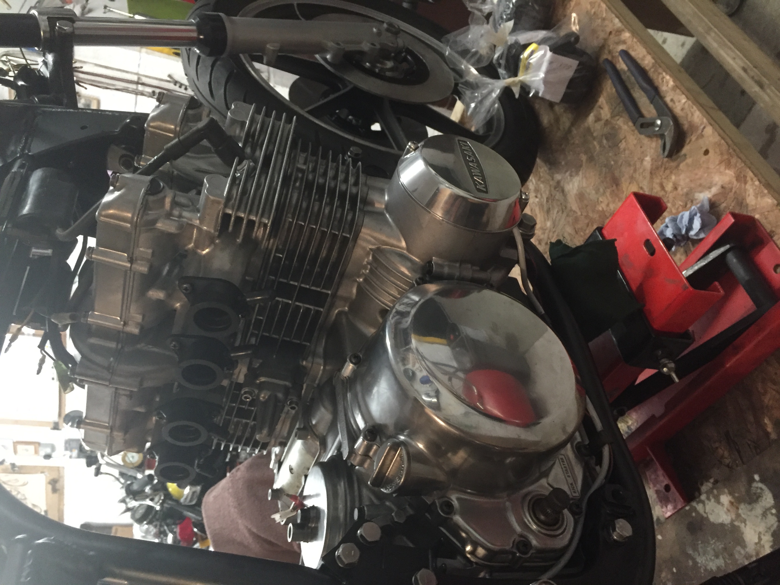

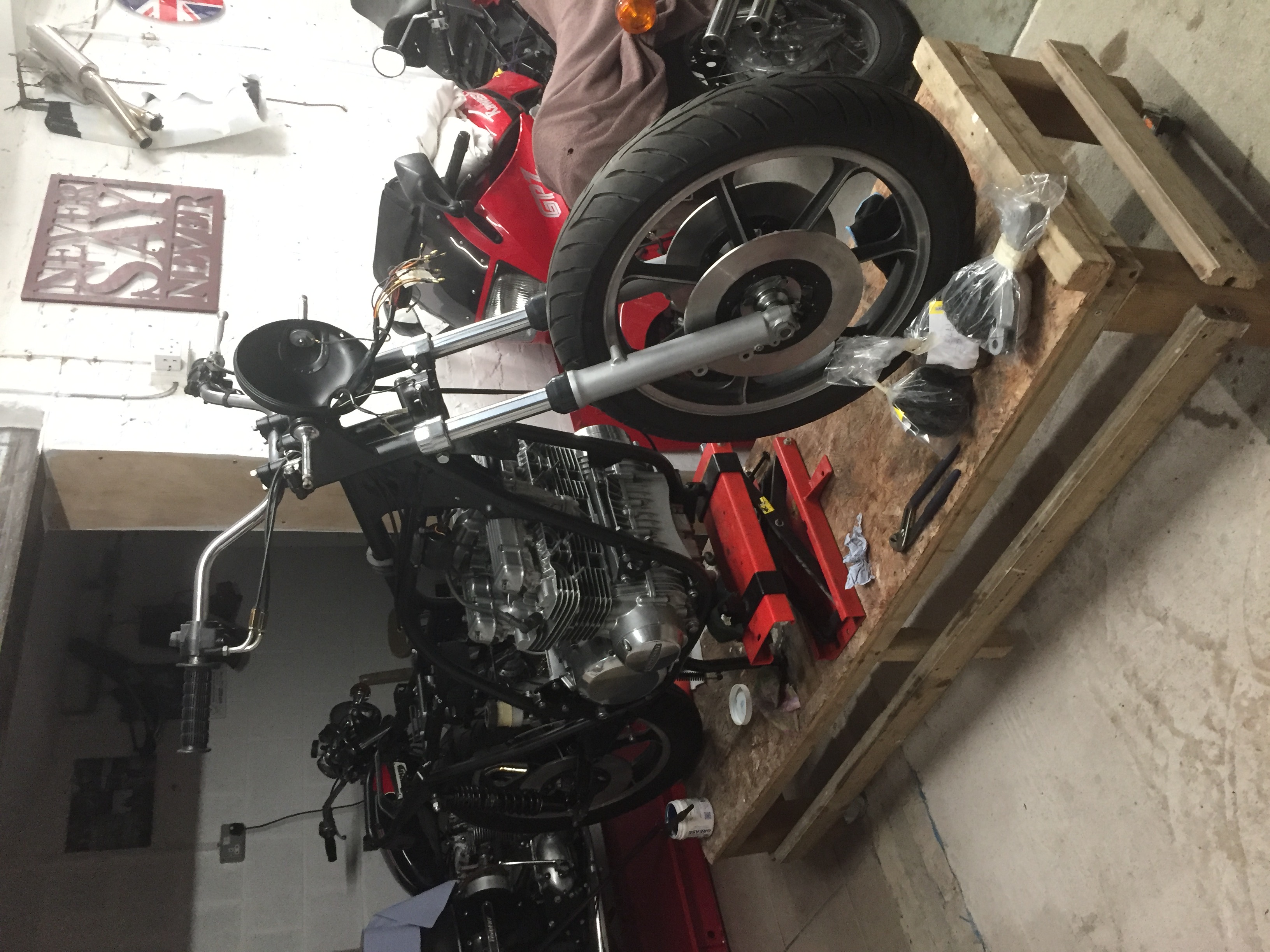

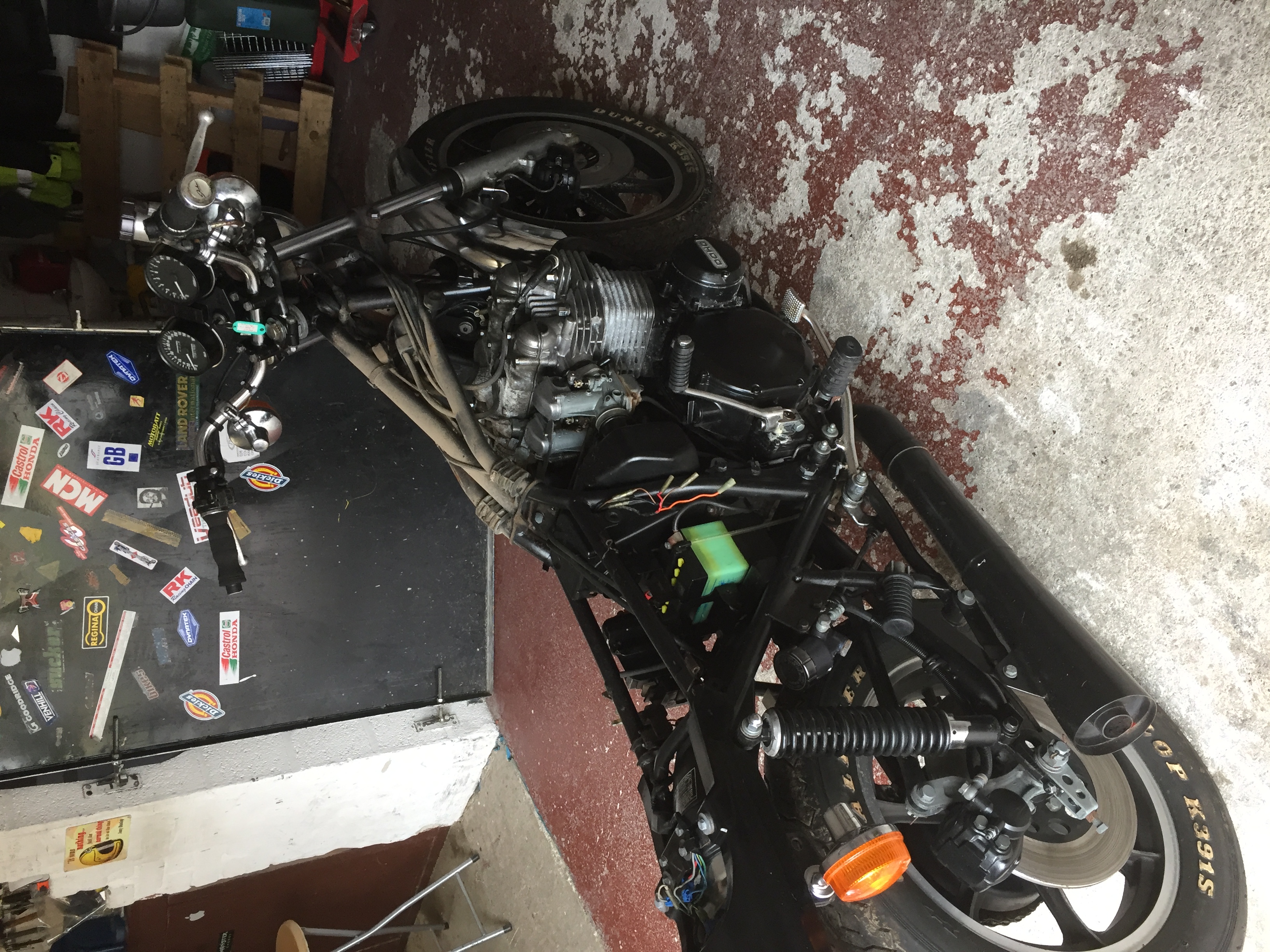

#44 PostAuthor: Bill P » Mon Mar 04, 2019 10:42 pm
Looks a bit better with fairing of and a Z1 tank i think

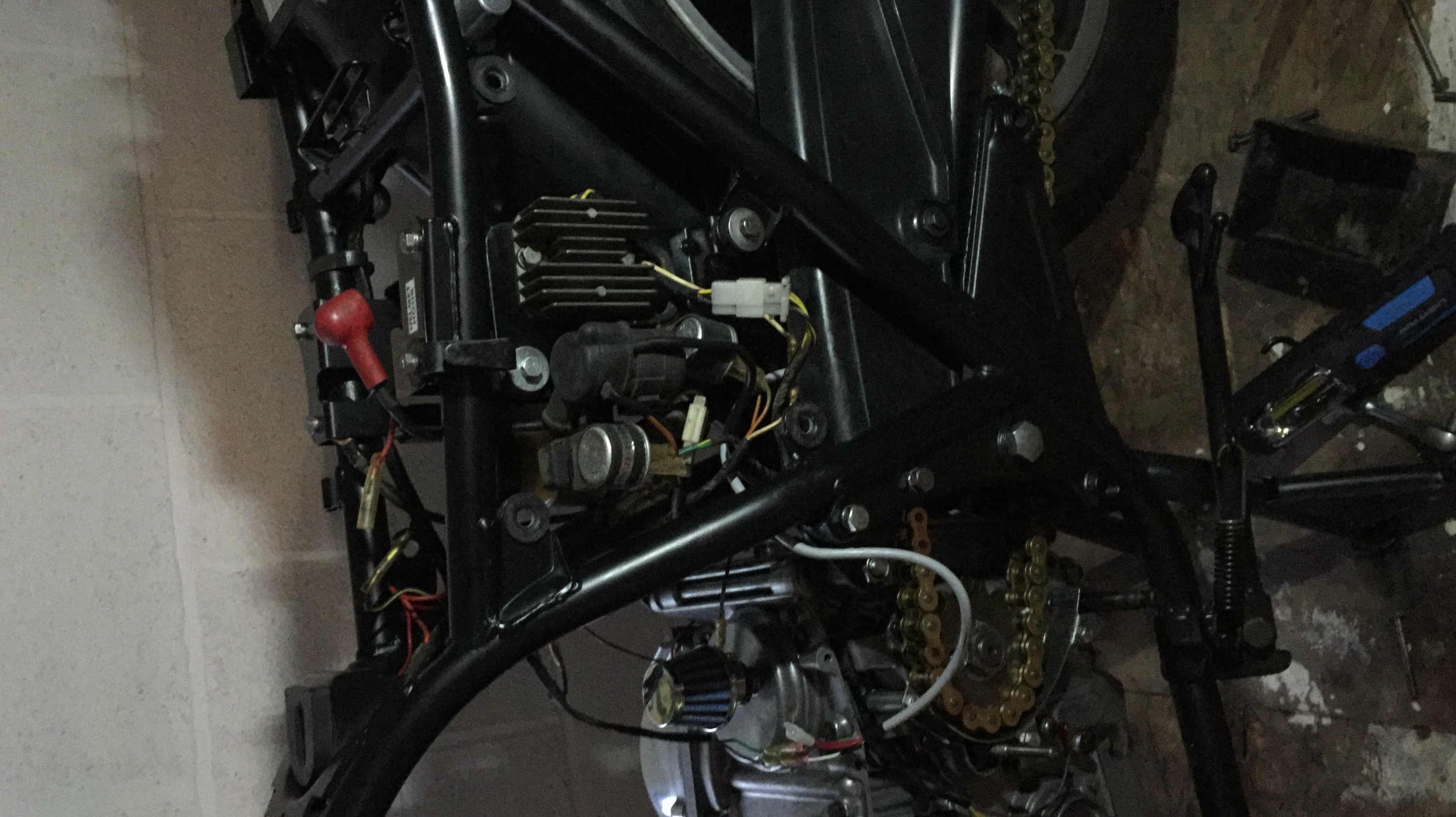

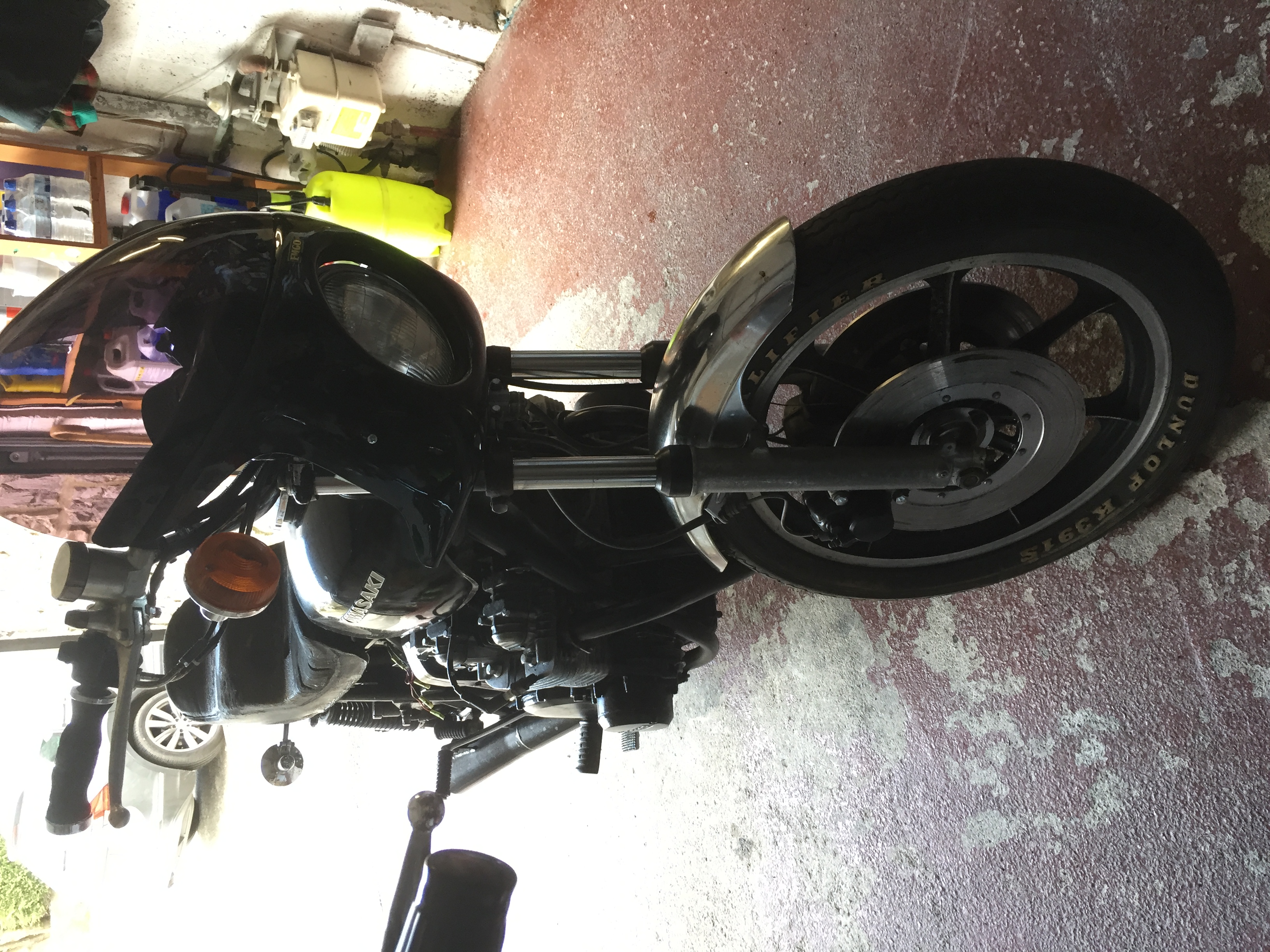

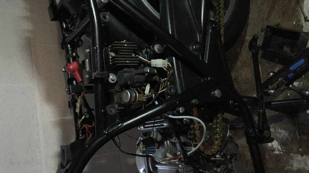

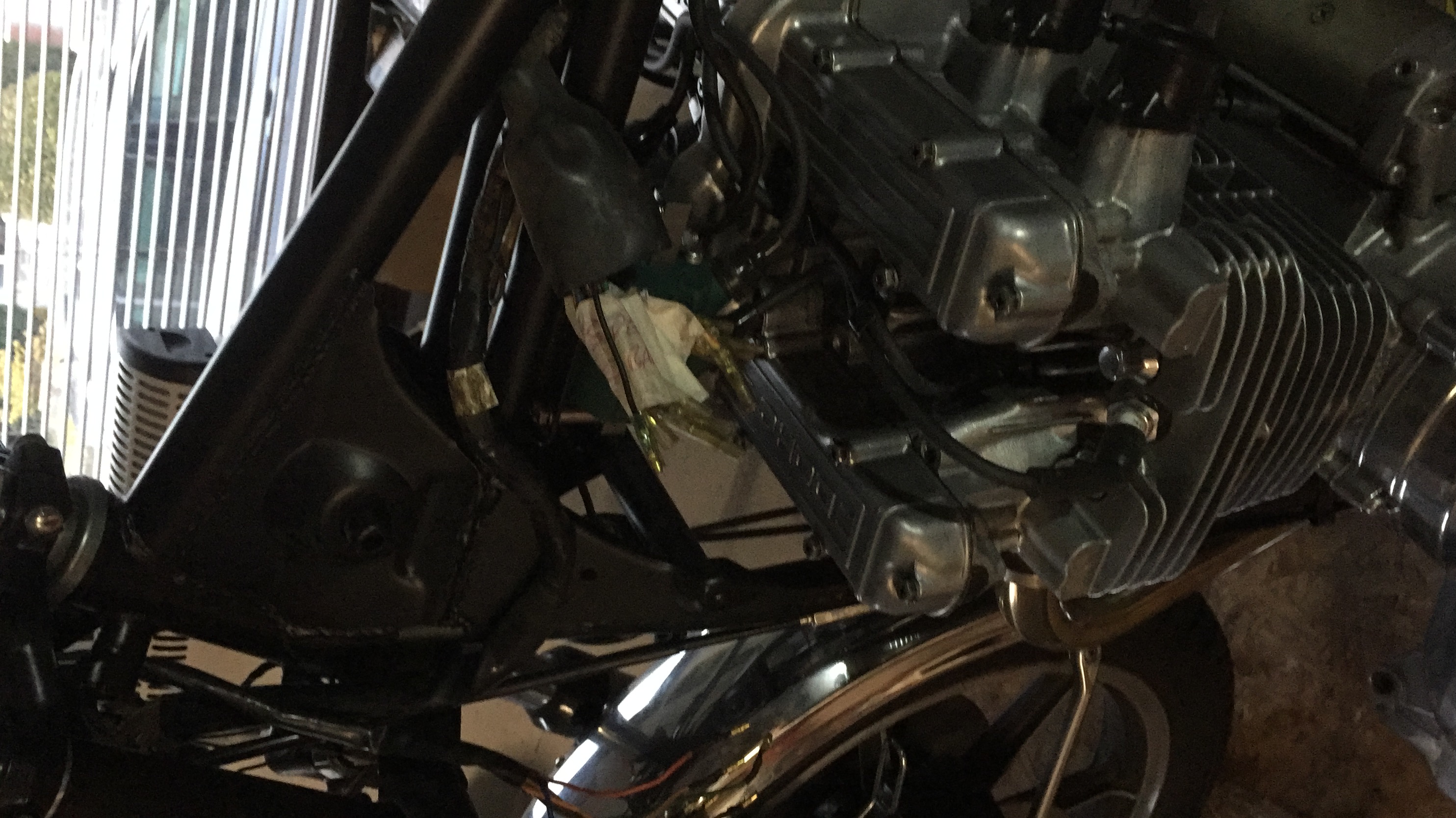

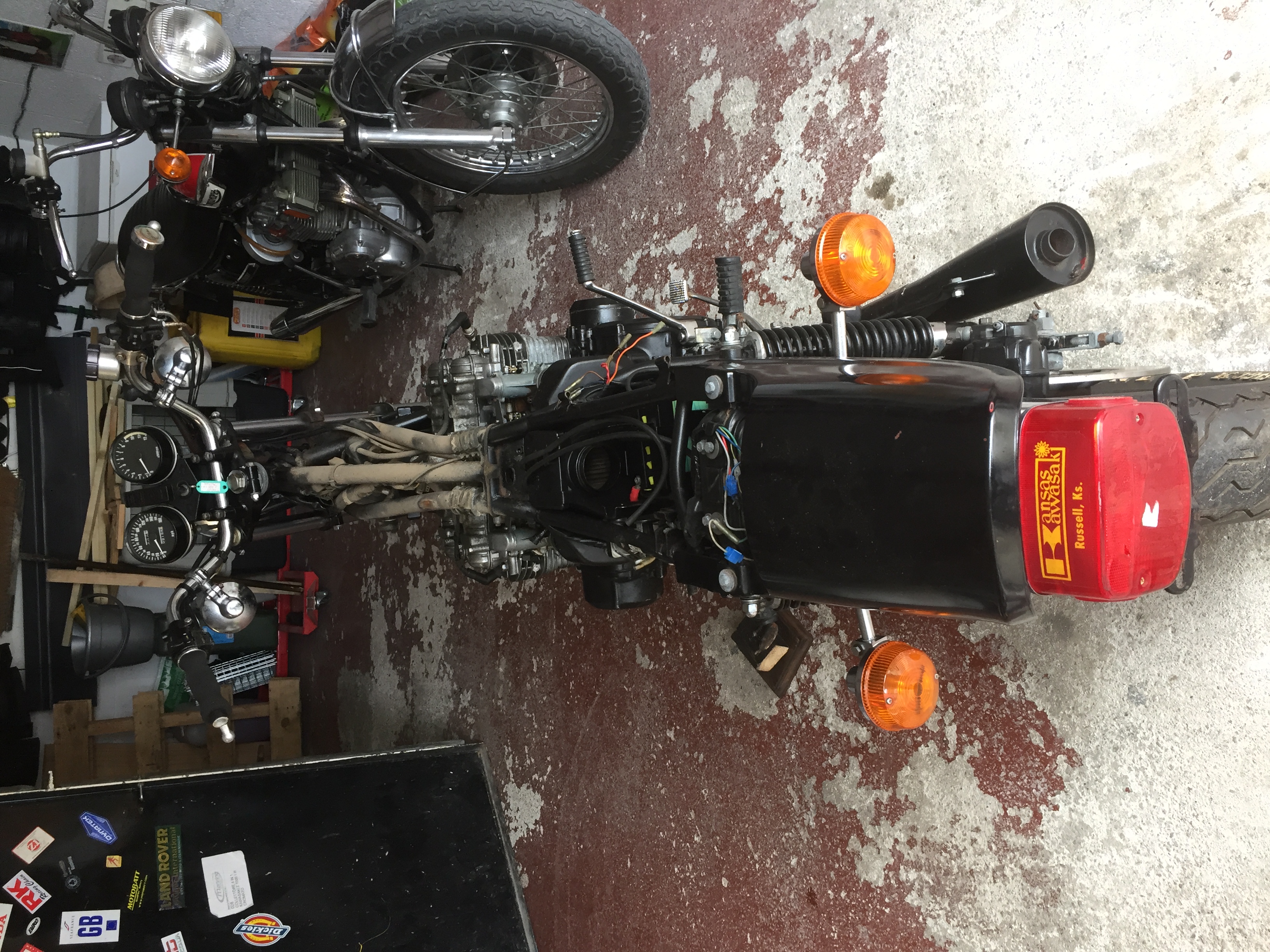

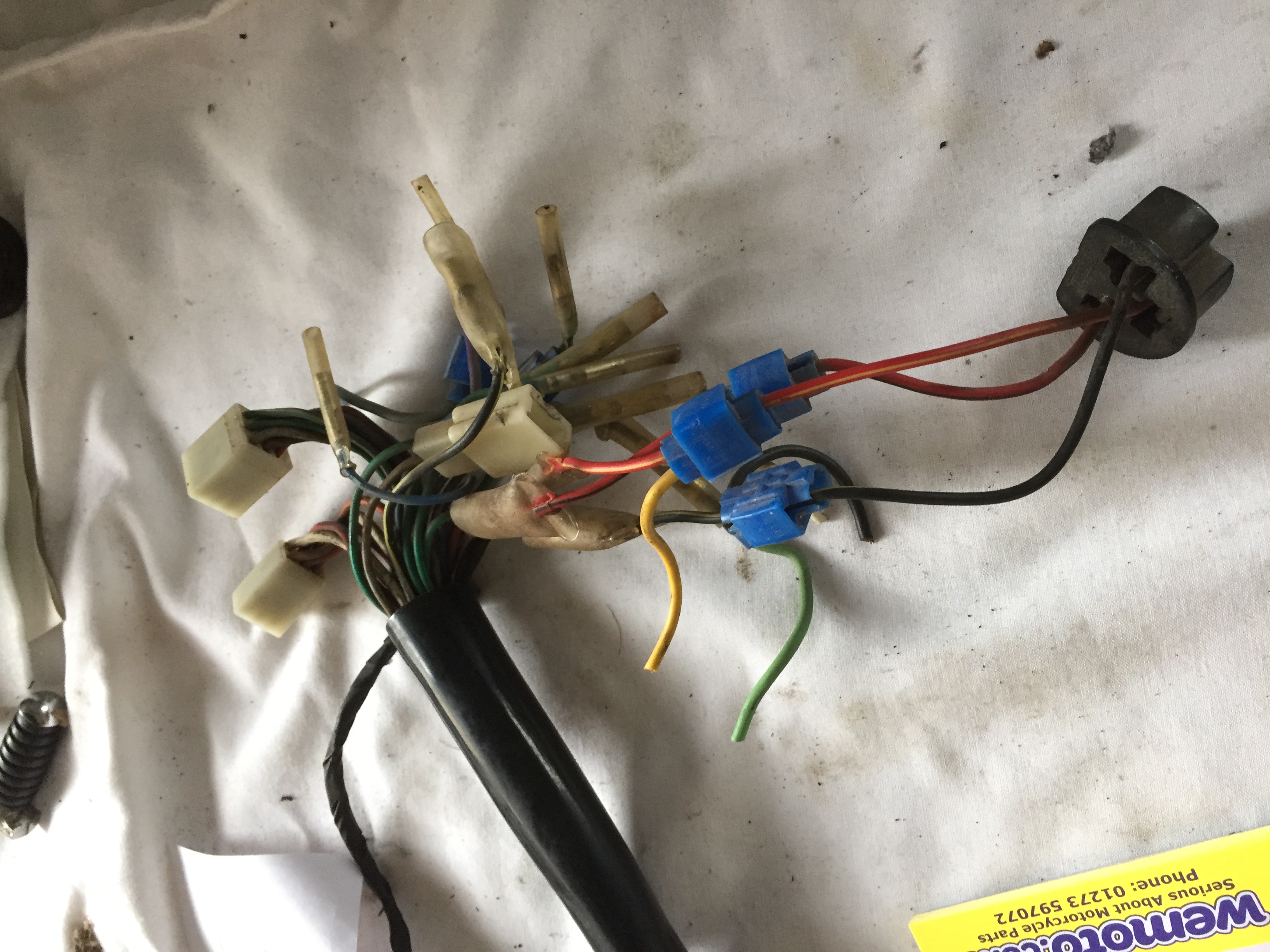

#45 PostAuthor: Bill P » Sun Mar 10, 2019 11:00 am
started to put wiring harness back on now its cleaned up and couple repairs done where
the Yanks had wired in extra front lights with scotch locks
