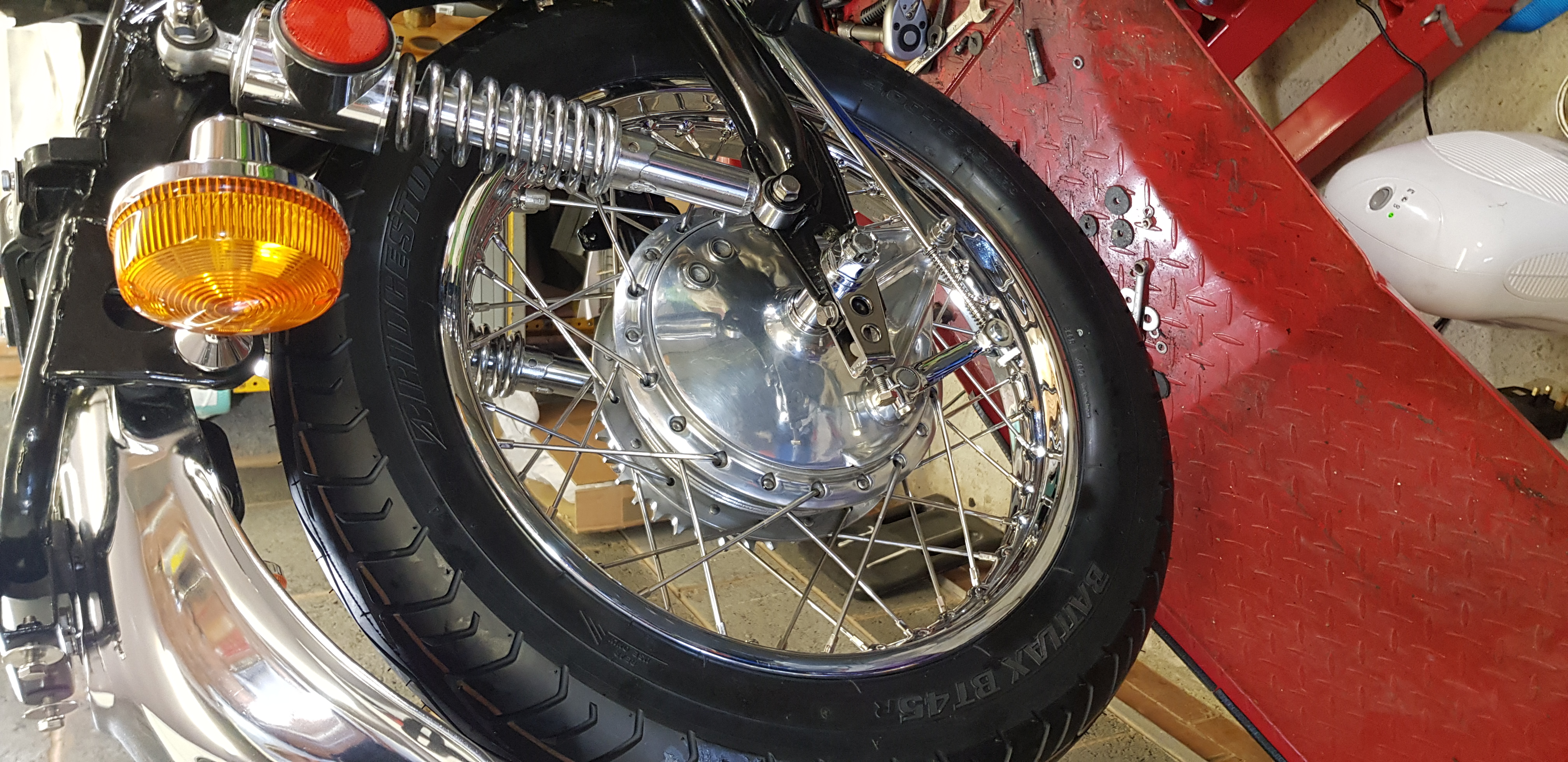

#45 PostAuthor: Adrian90s » Fri Mar 22, 2019 5:06 pm
Well now it's a Z1 according to the jap owners dating letter..progress on the back end and I'm quite pleased.
