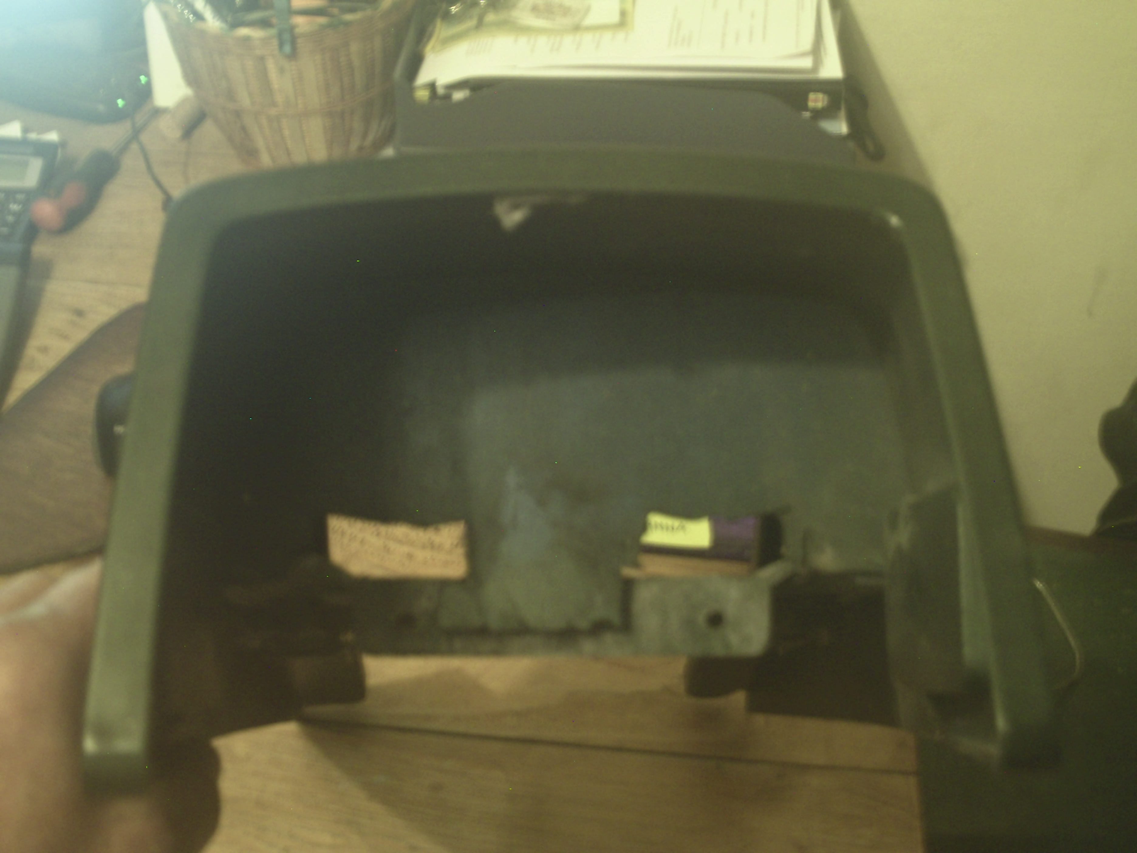

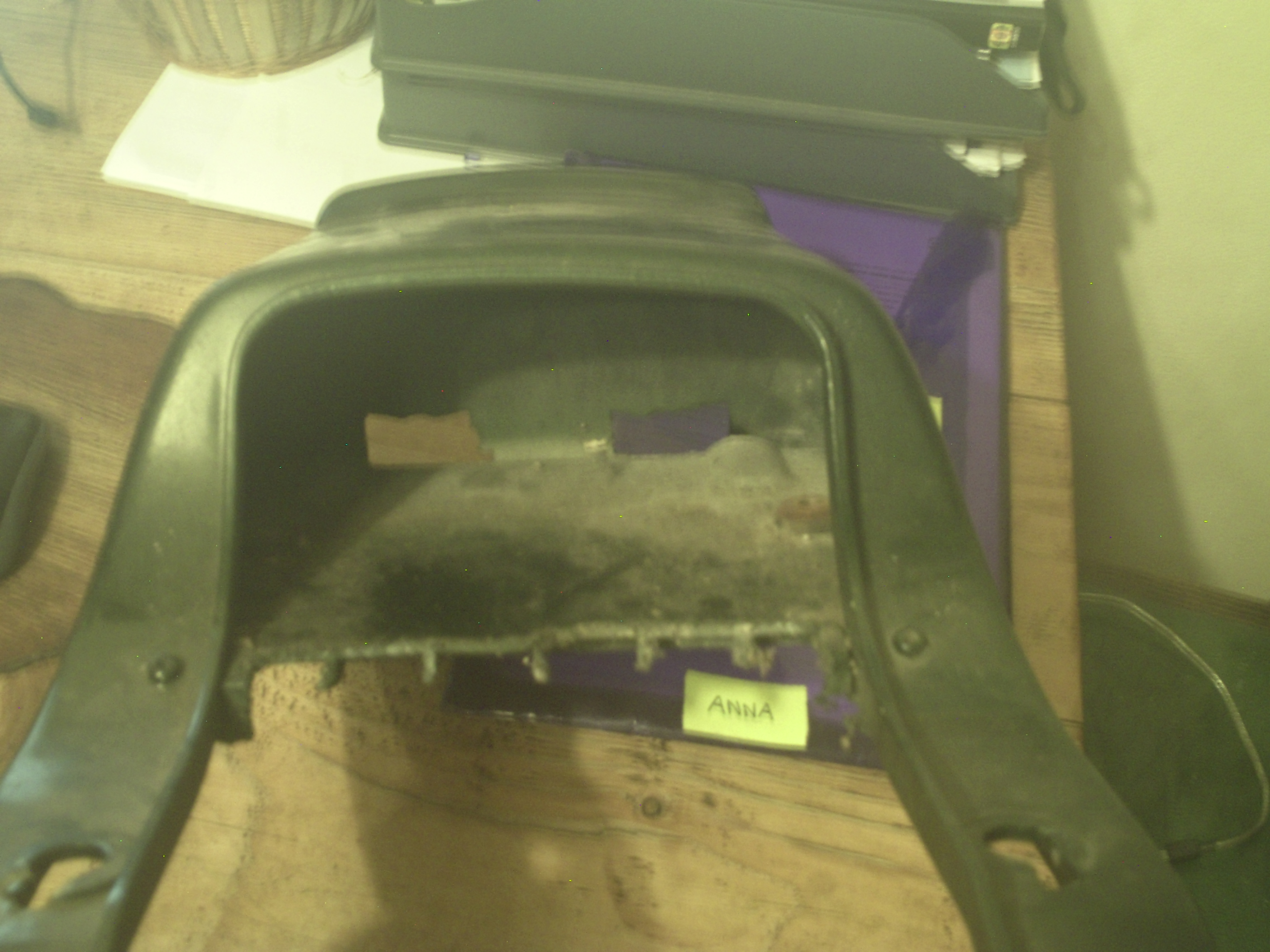

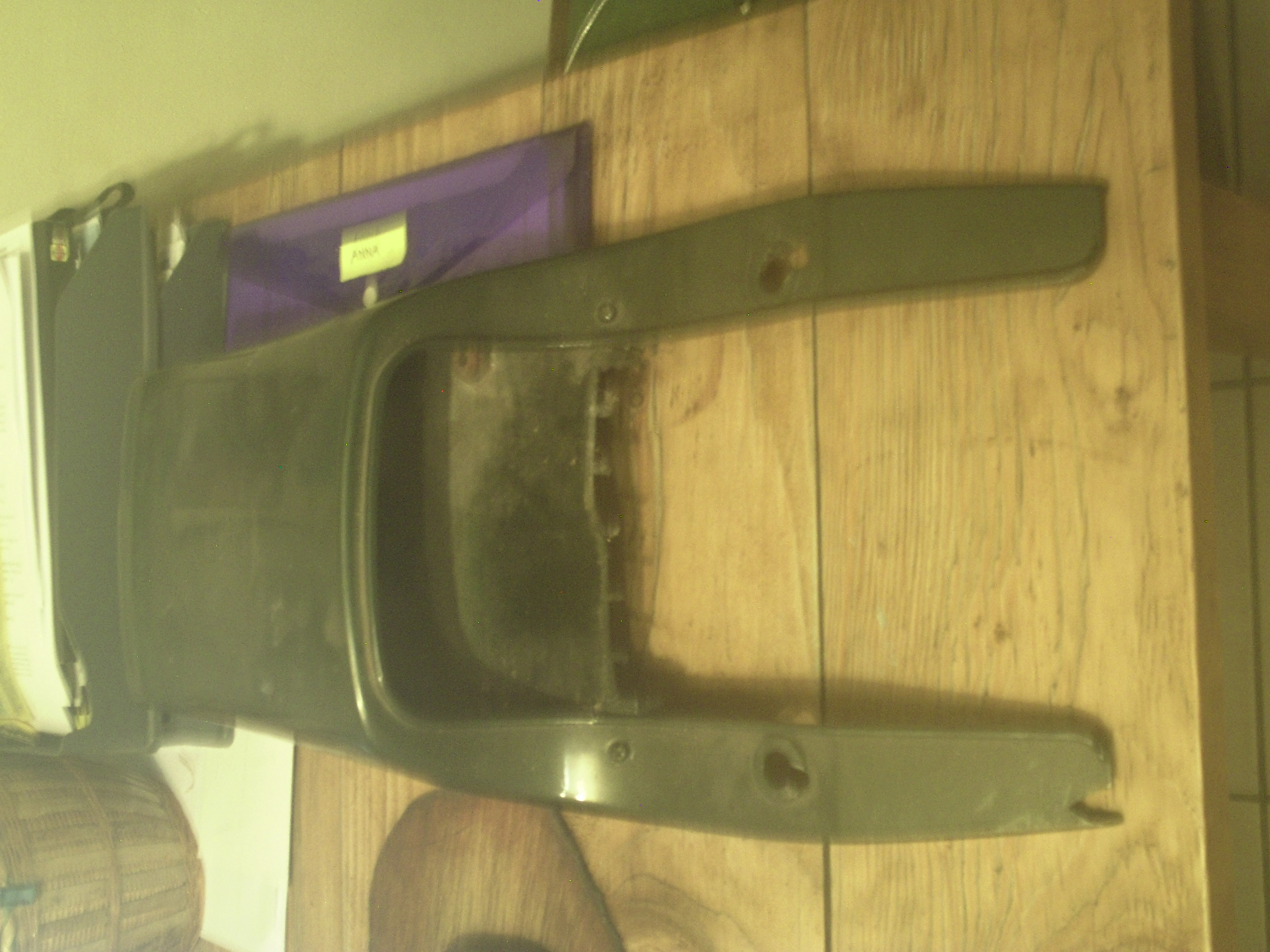

Well I said there'd be a few more surprises, I found one. Presumably after it went sideways, hence the Yam clocks, the rear end was also 'repaired'
So I've got an STmk2 hybrid, wondered why it sat cocked to the rear light. It wasn't even a good bodge. For the time being it will get a good bodge so that it looks straight.

Hi Pete
bad surprise...but you can find other tail pieces for the ST, they're not rare.
