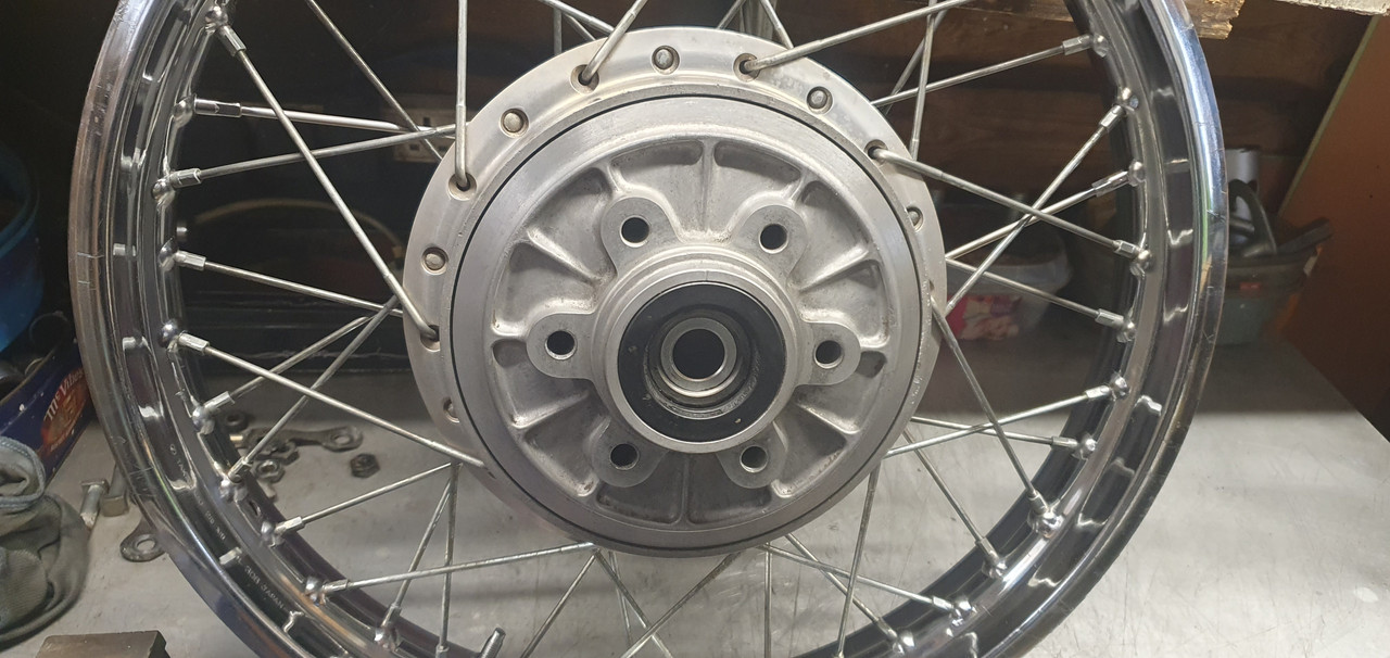

just to update this build thread with the wheels, still waiting on the painter :(

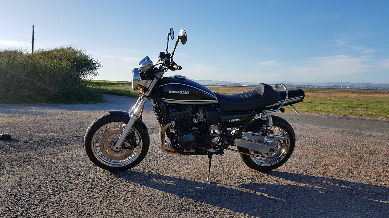

I think this project is going the way of a bike i built about 6 years ago, its one of them bikes I REALLY shouldn't of sold :( so i think this zed 1000 is a replacement for the 1200 :roll: but this is the colour scheme im going for.

Re: Z1000 LTD to standard
#36 PostAuthor: baldrick » Sun Oct 27, 2024 11:56 pm
what bike are the wheels from mate, out of interest? the wires?
are they original z ones, they look like new

#37 PostAuthor: Hard Road » Mon Oct 28, 2024 12:41 am
baldrick wrote:what bike are the wheels from mate, out of interest? the wires?
Their z1000A2 wheels bud. They are used but pretty good condition for their age. Must of come off a clean bike !

#39 PostAuthor: Hard Road » Wed Oct 30, 2024 1:54 pm
cleaned up well
