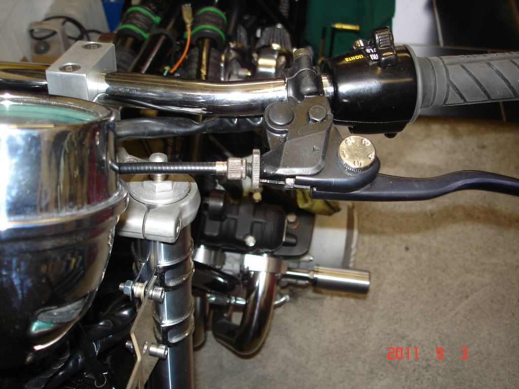

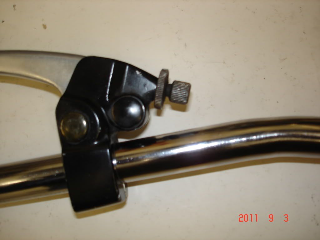

Clutch perch and lever are YZF, put the cable in and - well with 'straights' its a NO No. The cable run is too tight due to the angle the cable exits the lever. High bars or clip ons and its a maybe.
So ive changed to a ZX6 perch & lever, a 2 bolt fixing easier to take off. Also has a span adjuster and is black so it matches the brake lever!
Attach cable at cover end (just to try the clutch as it'll have to come off) bolt up ......1 bolt wont go in (next to neutral switch) cover off, have a look in ....shite.... its been helicoiled..... an its fooked.

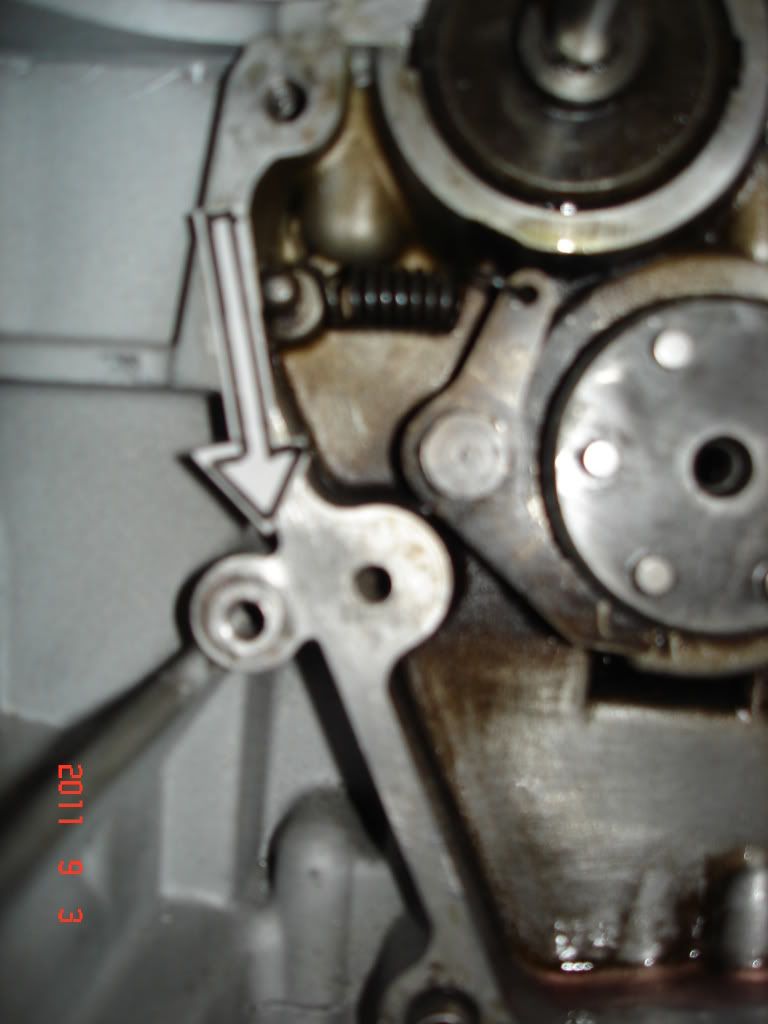

A picture explains more of wot shite i was on about -
Arrow shows where i've had to fettle (bodge?? :roll: )

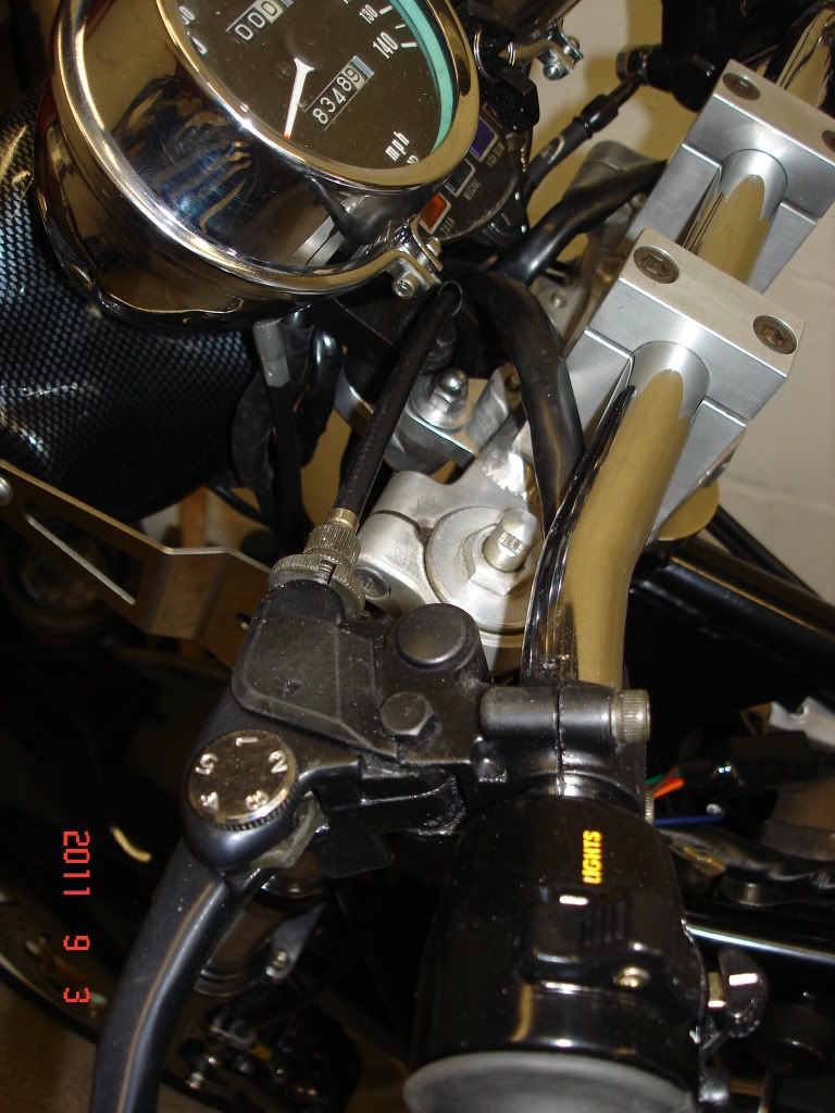

As for the clutch lever 'set up' -
Old YZF one
Replaced now with ZX6 one -
Don't know if this is making sense?

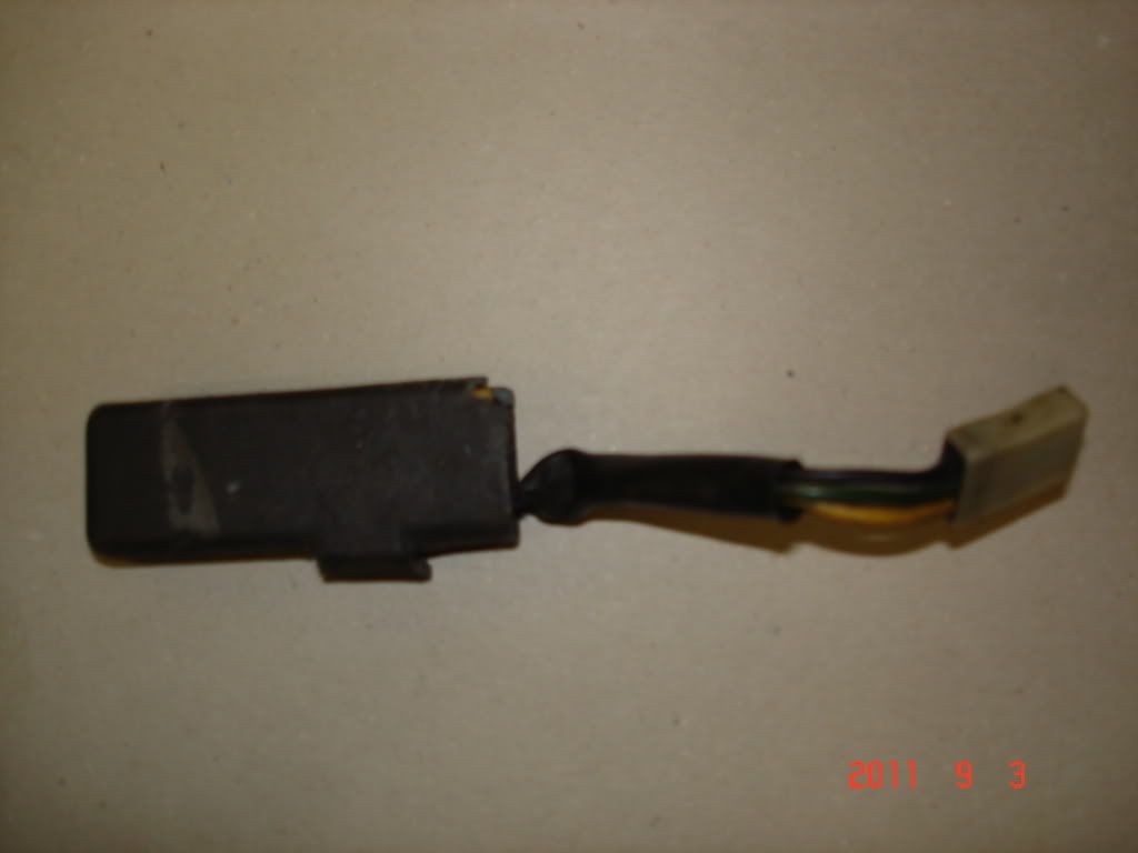

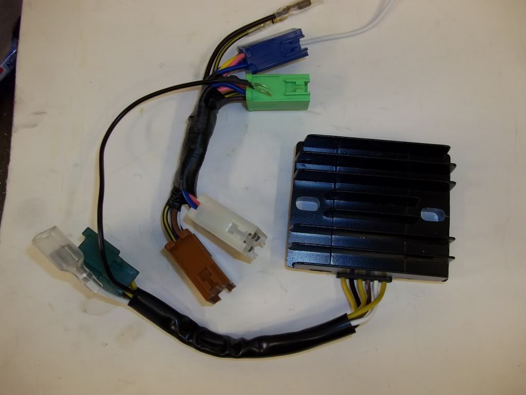

So there we have it, one last thing - can anyone tell me wot this is? Wot its function is? ...can it 'go in the bin?
Referred to as a Switch outage indicator. Plugs into the main loom under the tank by the coils.

Sanderz, that little gizmo in the last pic is what illuminates the brake warning light if the bulb fails, but it's probably knackered anyway.
When selecting gears, you wont be able to go up through the box without the rear wheel spinning & it may be easier to select first with the engine turning over?
Tidy repair on that knackered thread, congrats for carrying on & getting over the 'setbacks'......... I'm sure there'll be a few more yet, but just deal with 'em as & when they turn up & don't let it get you down. :sou

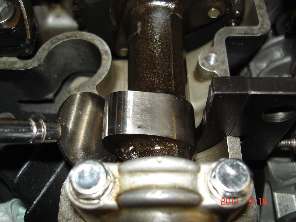

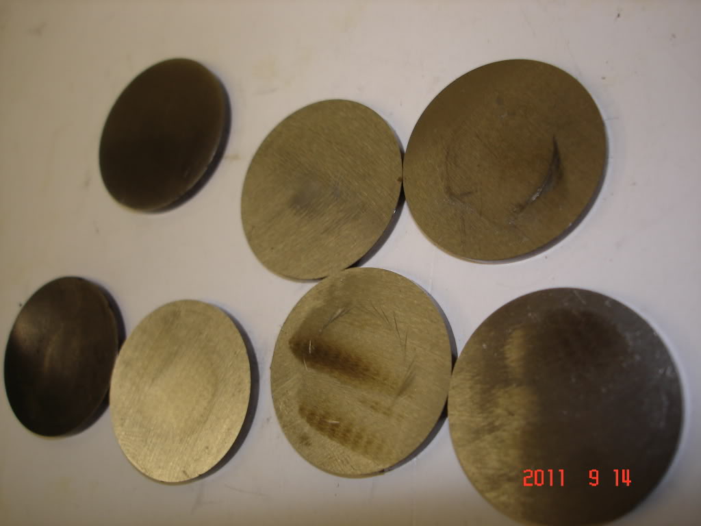

Recently had the idea to 'size up' the shims - just for referance. So following Chrisu's excellent guide http://www.z1ownersclub.co.uk/forum/vie ... ight=shims gave it a go. Thought it would just be an exercise to use the shim tool and mic them up as they were all 4-6 thous clearance (old money.)
First shim out showed signs of being reground underneath - hhmm not good.
Having sized up the 8 shims turned out 7 had been ground!
So a trip over to Z power for new ones. Ah well showbiz Jim, showbiz.
Sorted now and i know whats in there - sizes noted.

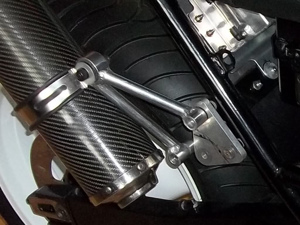

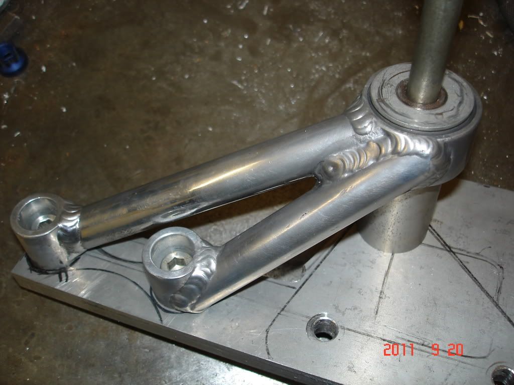

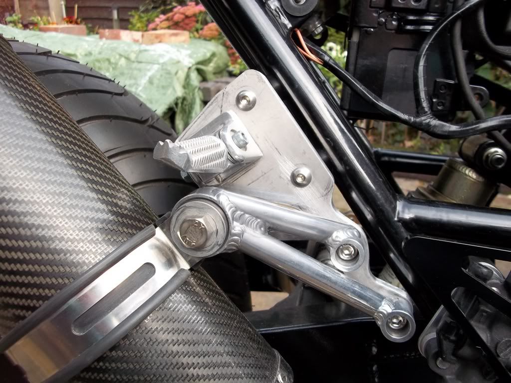

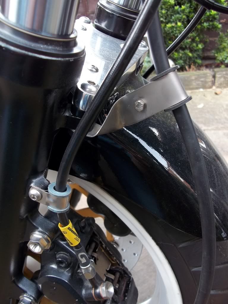

Had a chat with me ol' mucker Smett at M&A sheet metal about welding the exhaust hanger (off a Fazer) Originally looked like this but with the can now shortened and the rear pegs needing to go on, well it wasnt going to work.
So with it jigged up after cutting it about it came back from welding like this -
Nice one mate :bow (dirty deeds done dirt cheap) there'll be more odds n sods needing welding soon :roll:

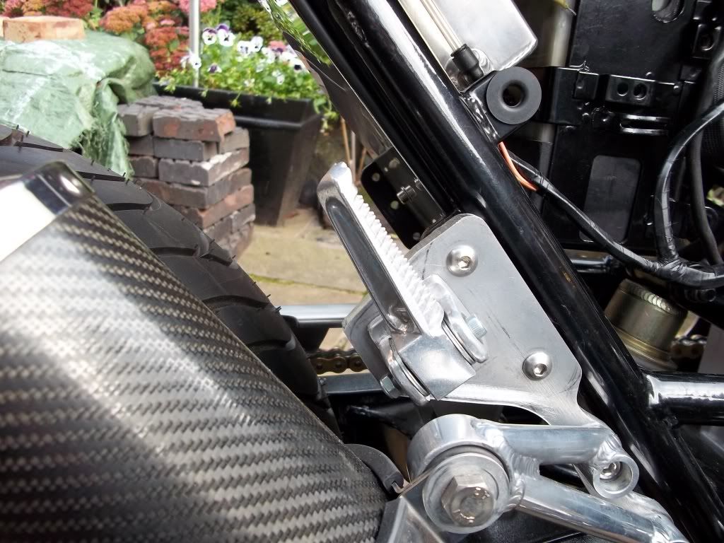

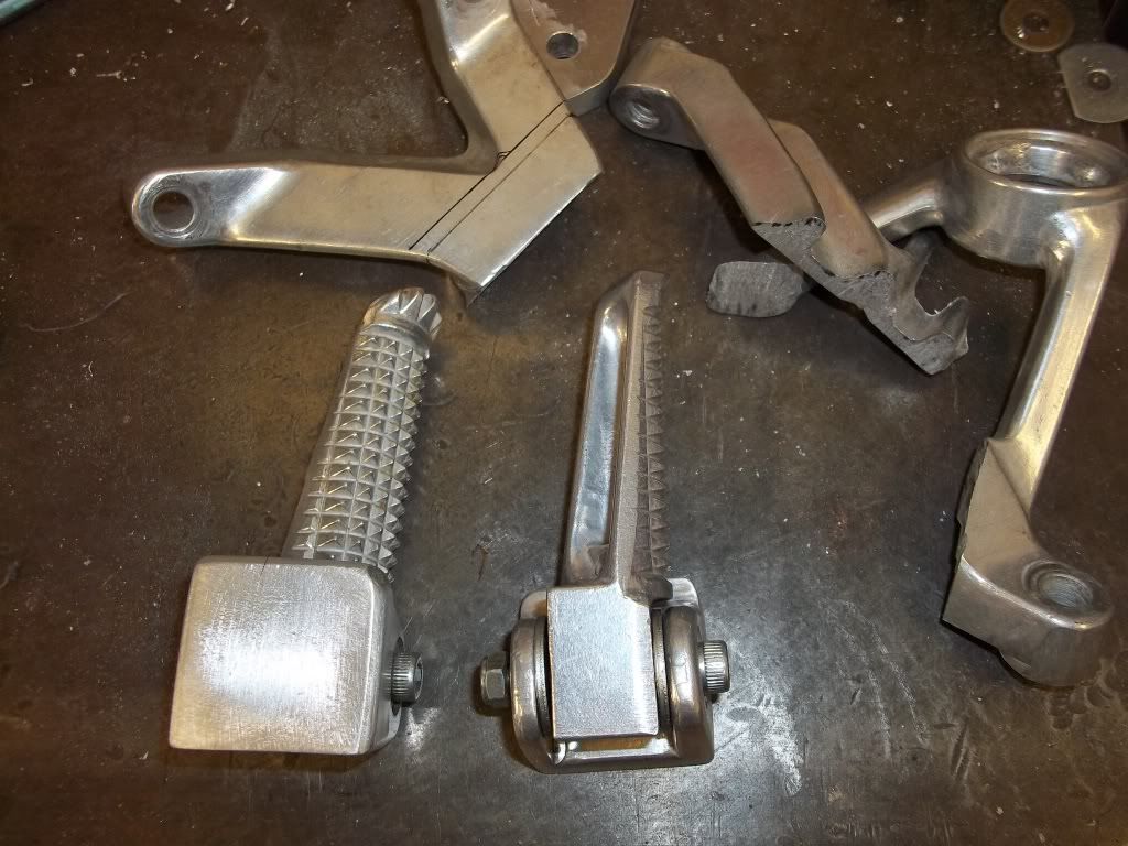

.....the rear pegs being one.
The YZF ones ive cut up as i only want the pegs and bracket.
The idea being when its folded up its 'in line' with the frame rails.

The rear footpeg mounts will be 'trimmed' after welding so some of the bulkyness will go. Could even paint em black...
Other than that, a few little brackets for the speedo cable an the brake lines.

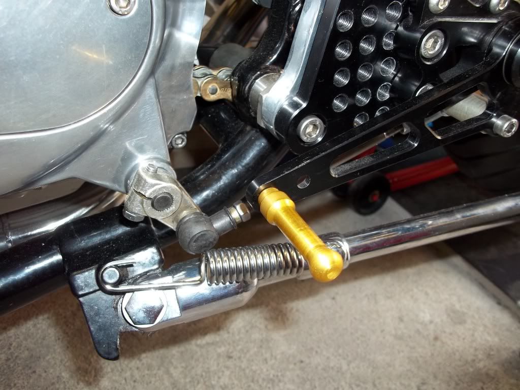

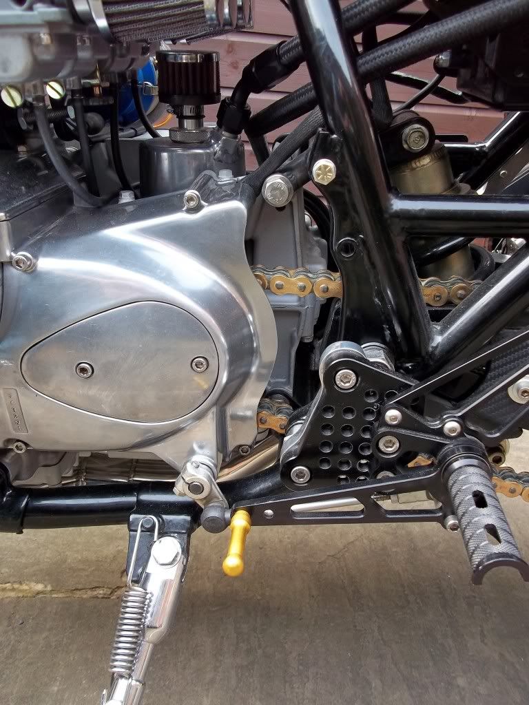

The gearchange 'set up' is touching the sidestand spring at the moment, not a lot but its there. May have to juggle around with it.

Gear change/spring issue could probably be sorted by rotating the splined thingy clockwise & extending the link rod.
If I remember rightly & used a fitting to fit the gearchange shaft from Harris, I also had to fit a stop to the back of the rearset, so the stand wouldn't foul the gear change linkage.
That's about the best pic I can find, my thingy attached to the splined shaft doesn't look any shorter than yours, perhaps it was just fitting the side stand stop that gave it the clearance...... It was a while ago. :gom
Looking at it again, I remember turning the thingy round, so the joint faced inwards, missing the spring. :sou

GB an' Piggy Thanks for the input - pics really do help. Its a minor issue at the moment but one that'll need addressing at some point (that growing snag list ha ha) Im sure with some 'tinkering' and thought it can be resolved.
I have thought of 'losing' the adjustable plates as at the moment im using a 30mm spacer off the gear lever to align the rod - doesn't look that good but works... I'll try reversing the rod end on the linkage and take it from there - when? err ... one day....

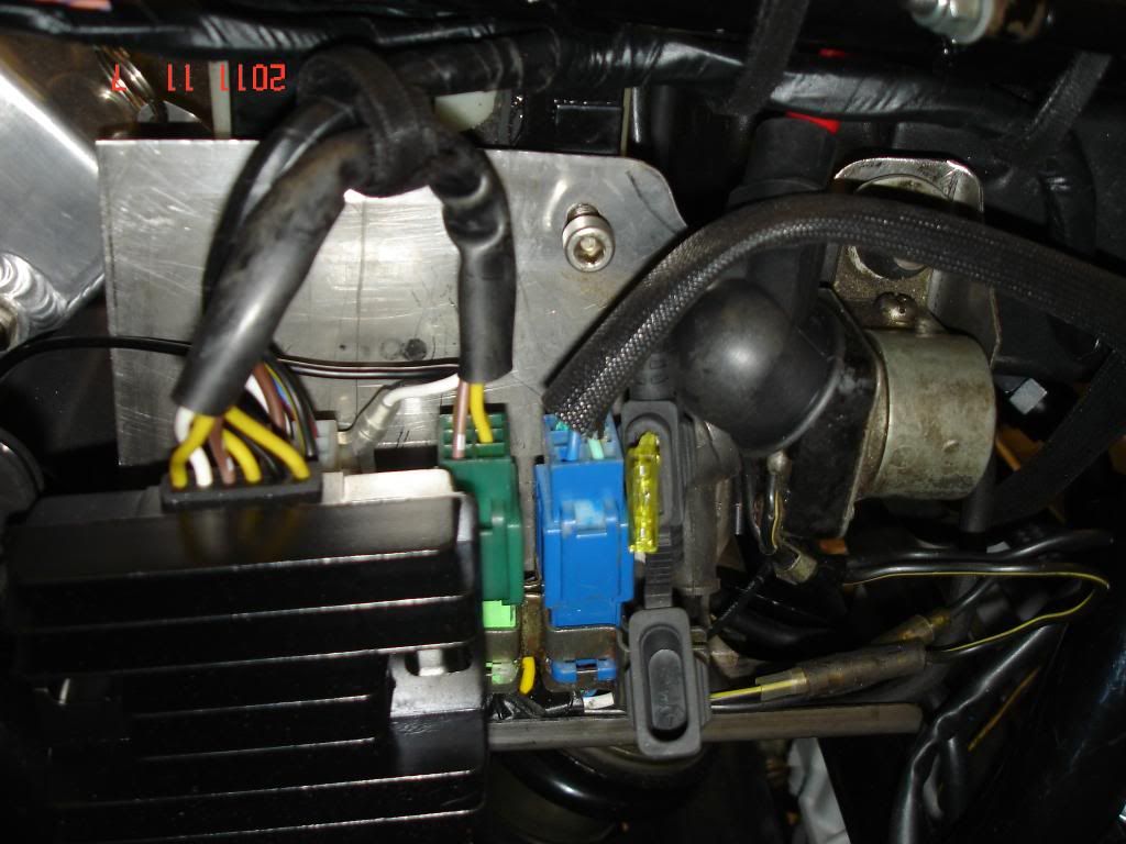

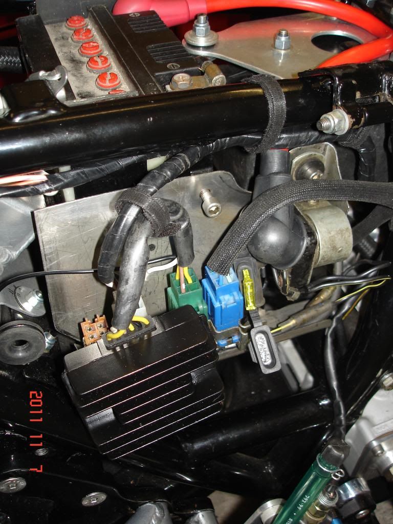

Well after a few promts with a big stick or rather a few calls to say "owz that bike comin' along?" Read that as a kick up the arse to get me doin' summat!!

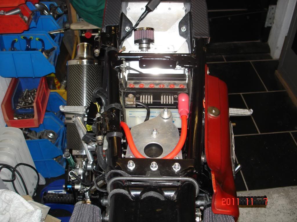

Well ive made a start on the 'panel mount' Mk 1 on the go...
Still need to 'tidy' it all up but as this was the trial piece (Mk 1 of many prob) to mount it as i needed to see if it'll all fit behind the side panel.
It'll be rubber mounted and all being well (yeh right) still have clearance on the panel.
We'll see ...no doubt Mk 2 / 3 will be on the cards.
