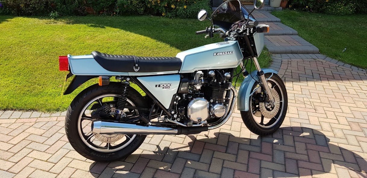

Very nice job, well done :up

That's lovely, well done. I completed a Z1R this summer and it's identical to yours. Only thing I've got to sort is the self cancelling indicators.....maybe !

Looks the bollox mate and is a real credit to you - well done to you too! :up :up :clap

congratulations! Very nice bike, she looks like new!
If all the retorations were done that way the good times would roll again!

That is stunning! What a machine, a true thing of beauty! Well done!

stunning well done,which engine paint did you use in the end? Any thoughts tips?

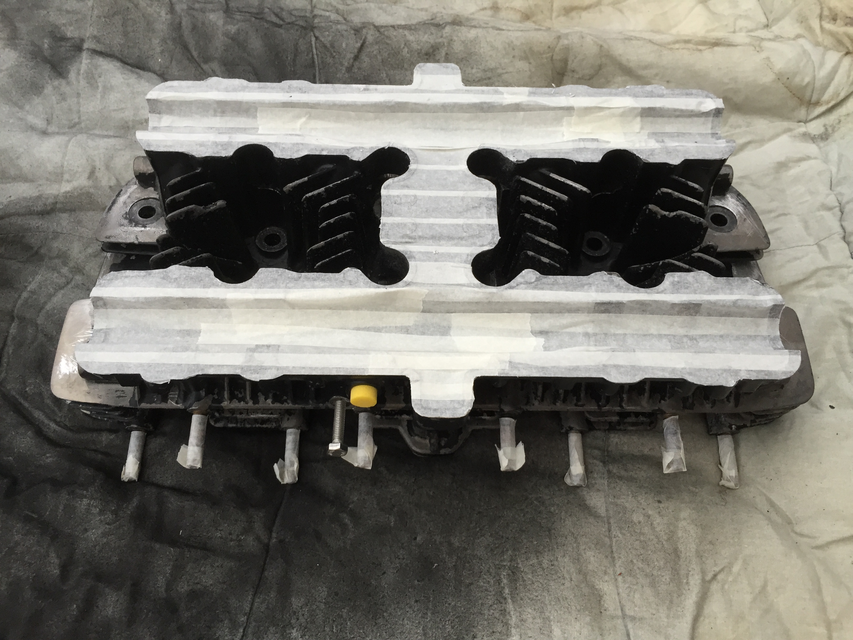

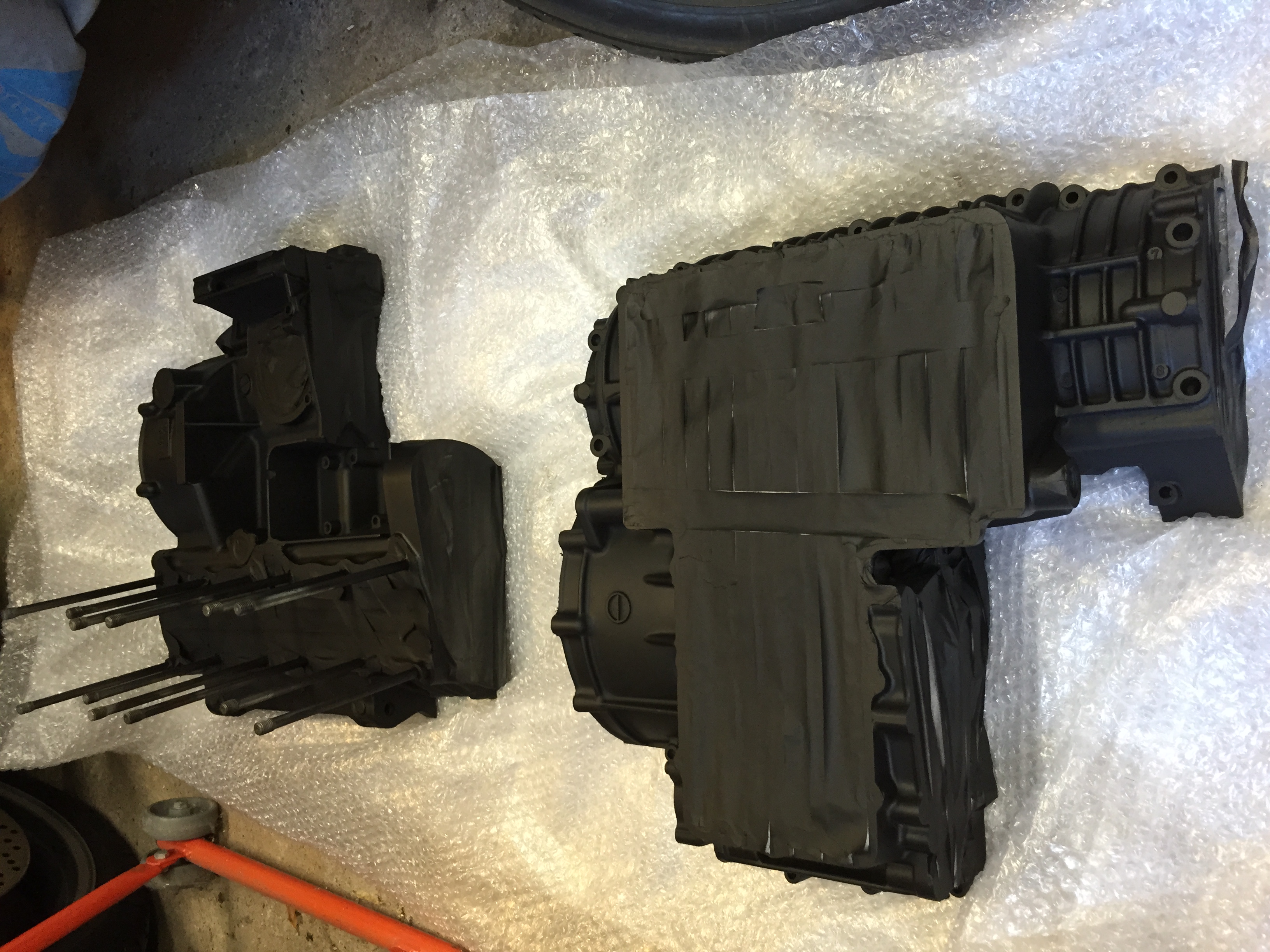

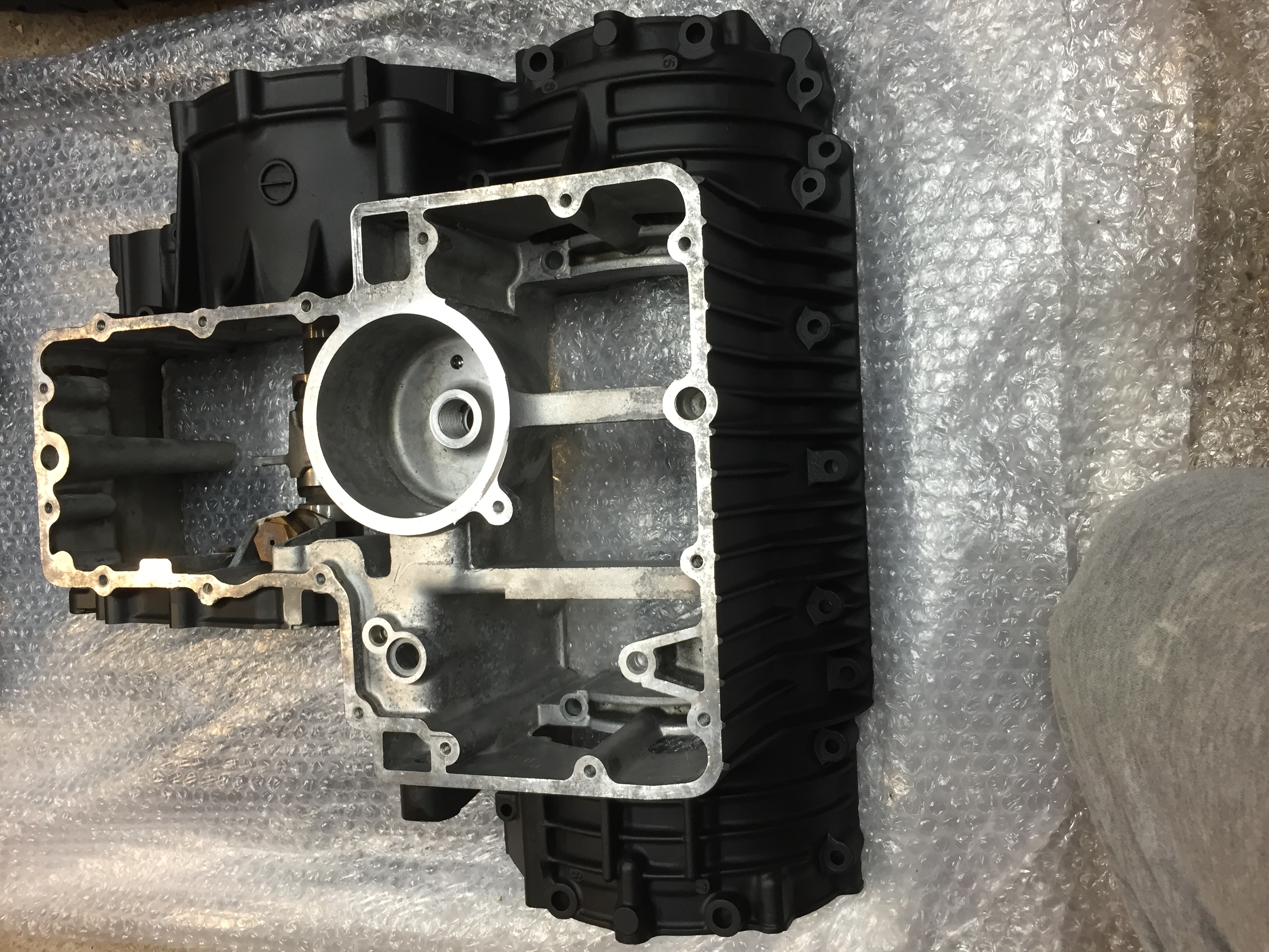

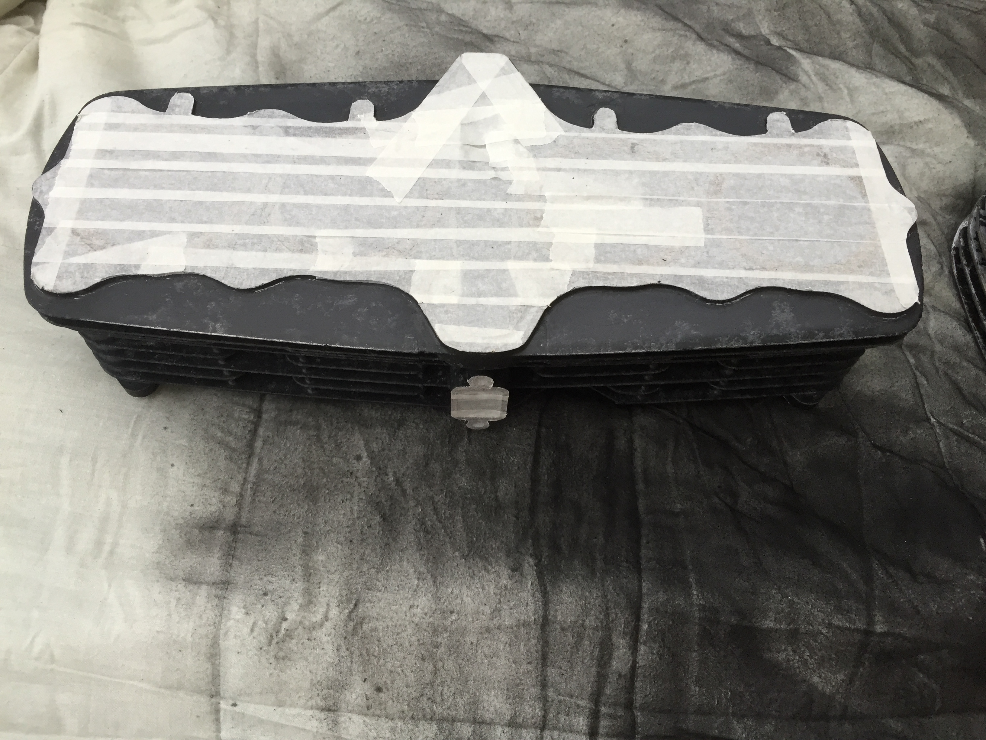

weaver wrote:stunning well done, which engine paint did you use in the end? Any thoughts tips?
Thanks all the comments :up
Weaver - I used SIMONIZ Motorcycle Heat Dispersant Paint but I don't think they make it any more? (HO-SIMVHT145C). Think it's been replaced with Enamel paint (SIMVHT32C)
I cleaned everything THOROUGHLY using a combination of degreasers and an ultrasonic bath then just followed the manufacturers instructions - the only real tip I'd give regarding painting is to spend time on the prep and to make sure you wait until the missus is out before you use the oven to bake the paint............... :D

That's one lovely looking Z1R you've built - great job, well done :up :up
