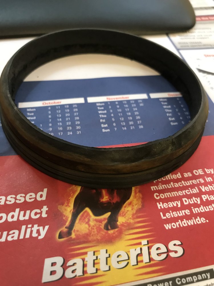

I have though started to look at some components and solutions. One such problem is the clocks. A recent advert made me aware of some new mounting rubbers for the clock pods. From Australia they have good reviews so I bought a pair.

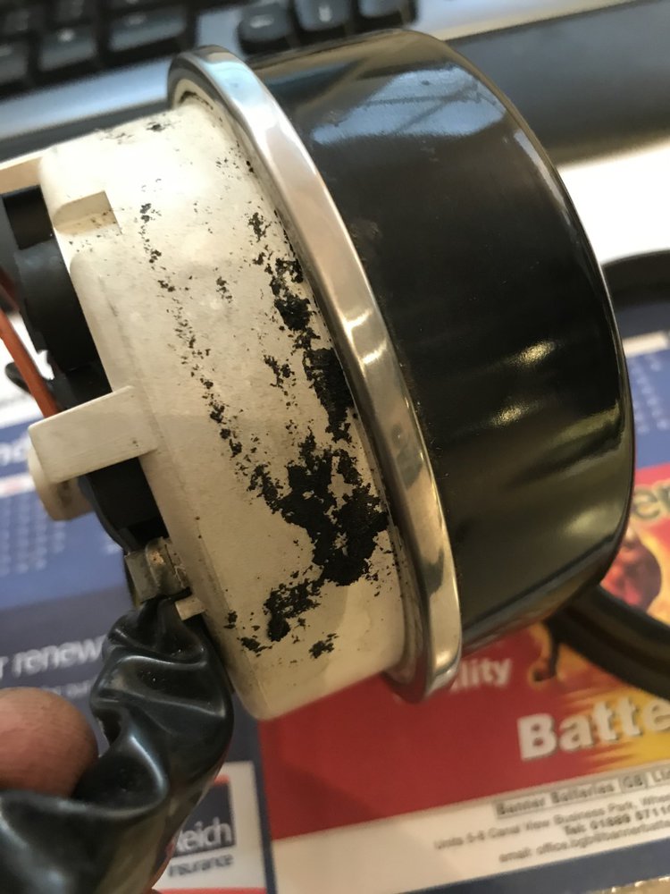

The originals seem to be made from foam ?
When removed from the pod you can see how they have degraded over time.

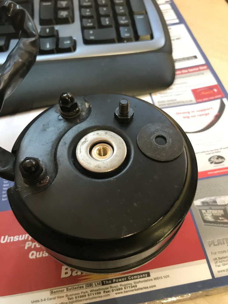

To overcome the loose fit in the past I packed it out with a washer.
Whilst okay as a temporary fix it never really stopped the vibration getting through.

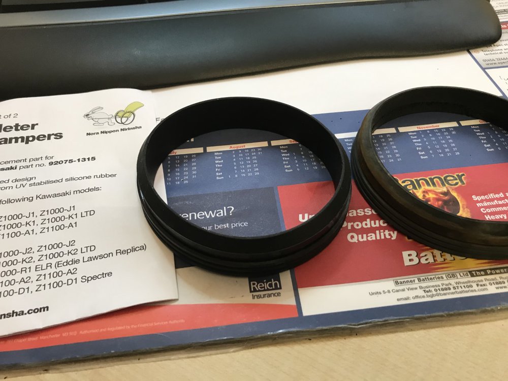

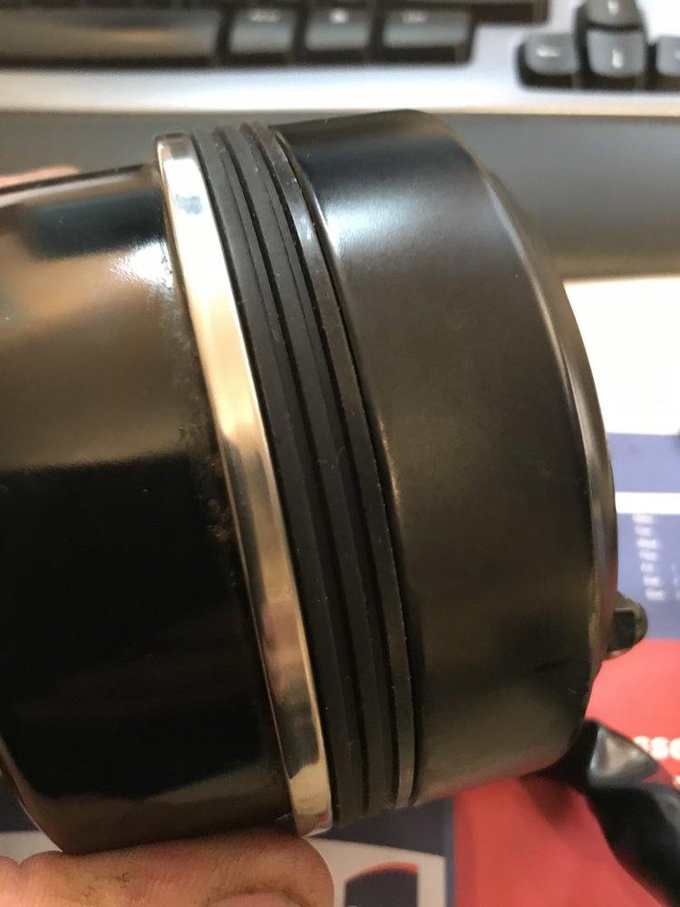

Compare the old with the new.
They really are very good quality and an exact replica of the original.
A happy bunny

I put the delivery note in one of the pictures.
Nippon Nirinsha.
Nippon Nirinsha.

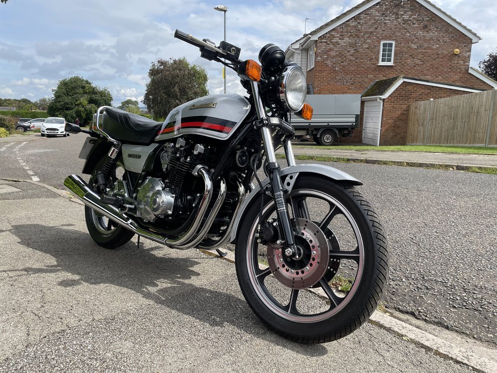

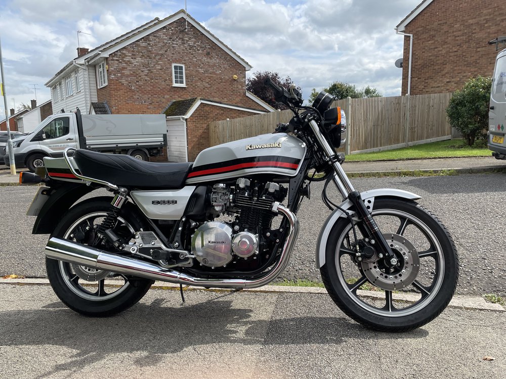

Here is the finished bike. I am now unlikely to use it so will be exploring options to sell.
I tentatively offered the bike to visitors at £12k and did discuss including it in the Silverstone Auctions sale next spring.
