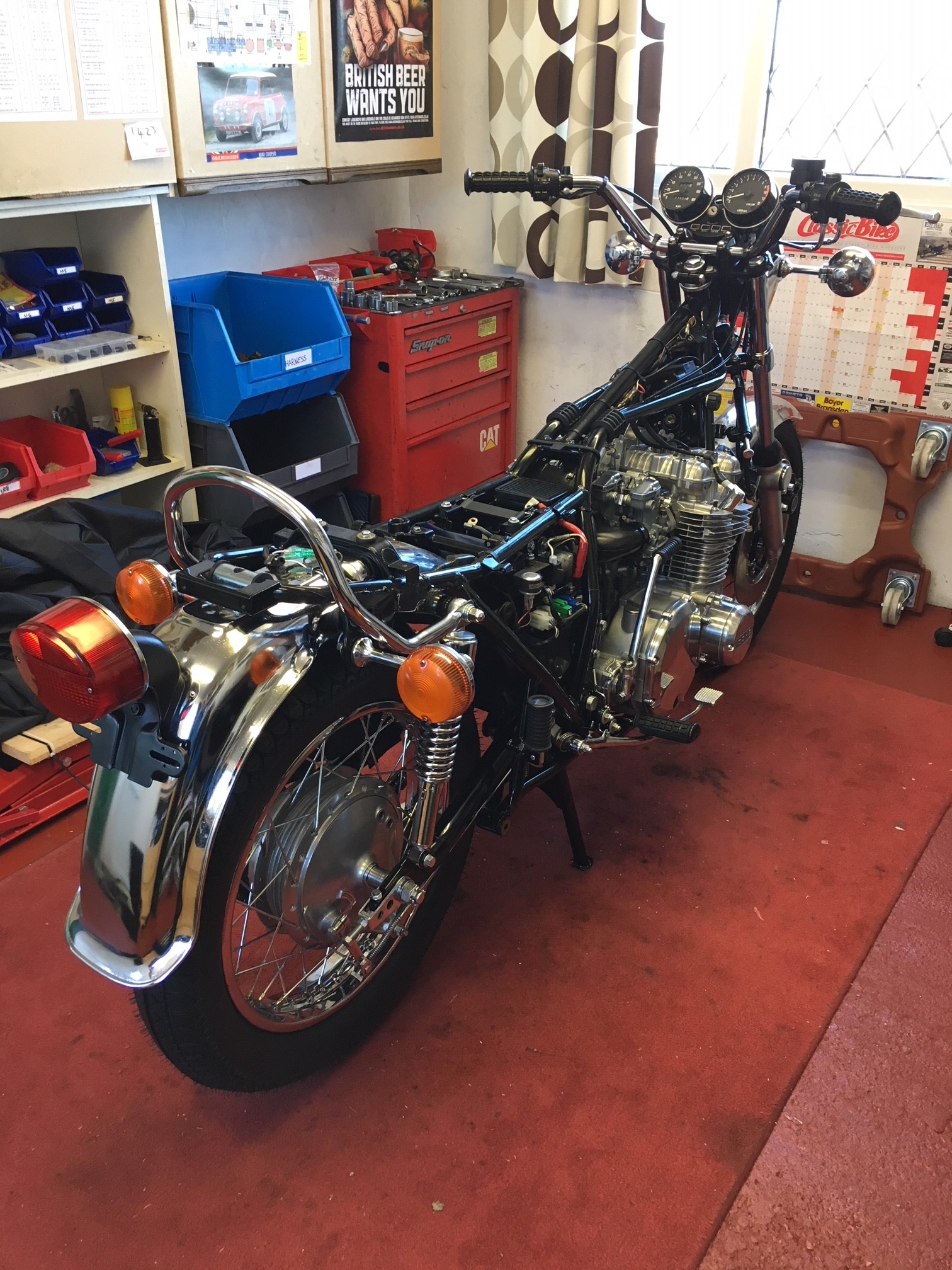

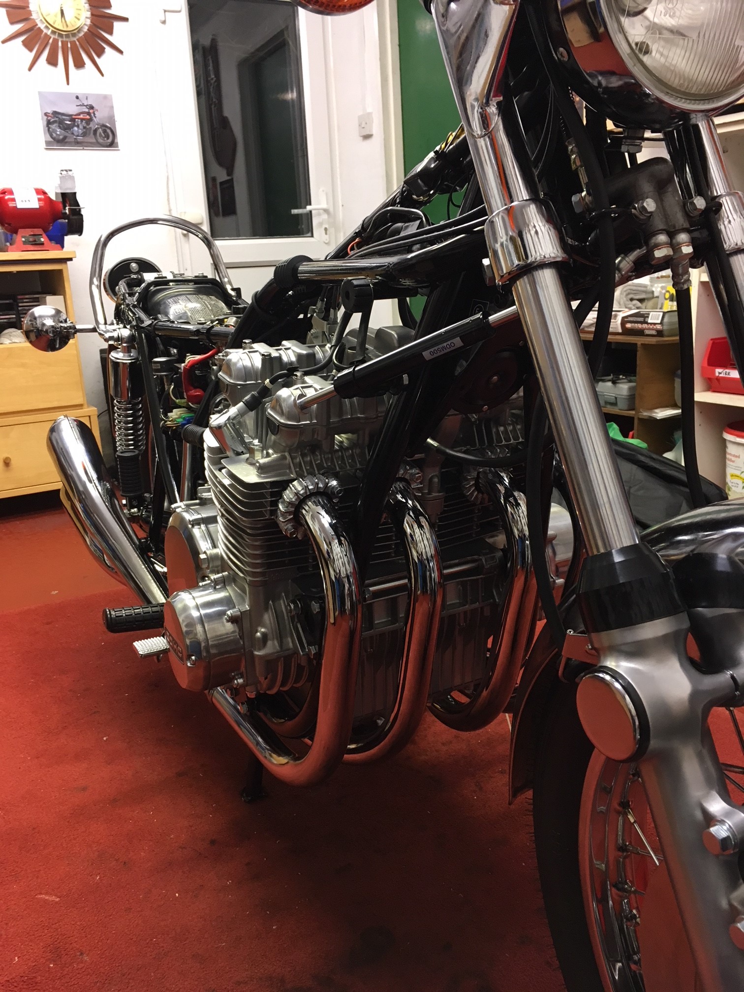

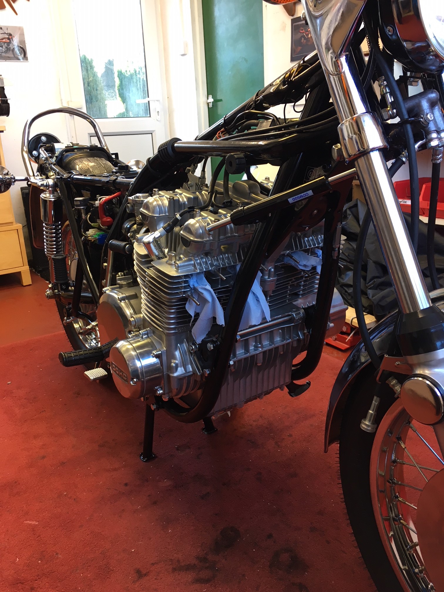

Carbs are now fitted, all went well
Spent a little time neatening the cable routings.
Plan to spend some time in the evening during the next week fitting the exhaust and hopefully ready for first start up next weekend

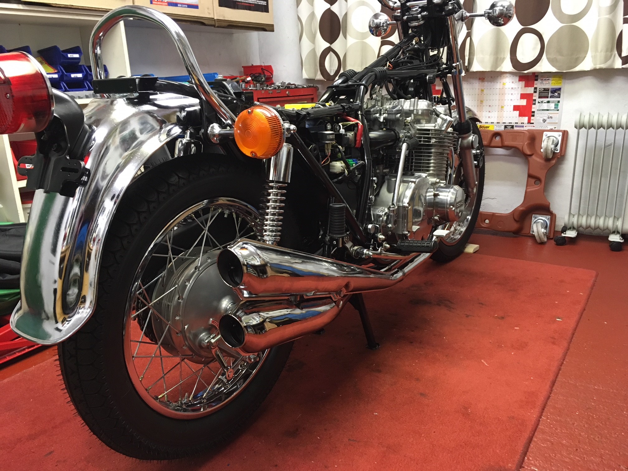

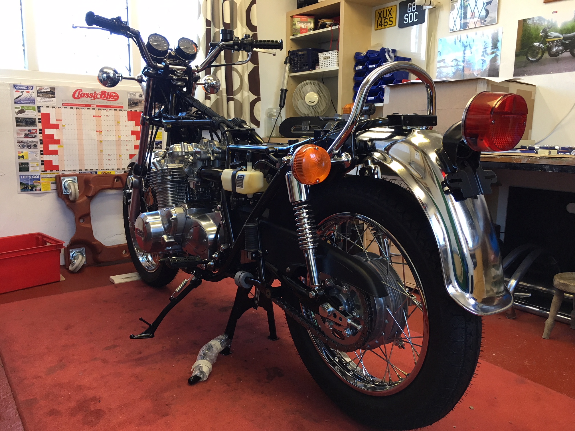

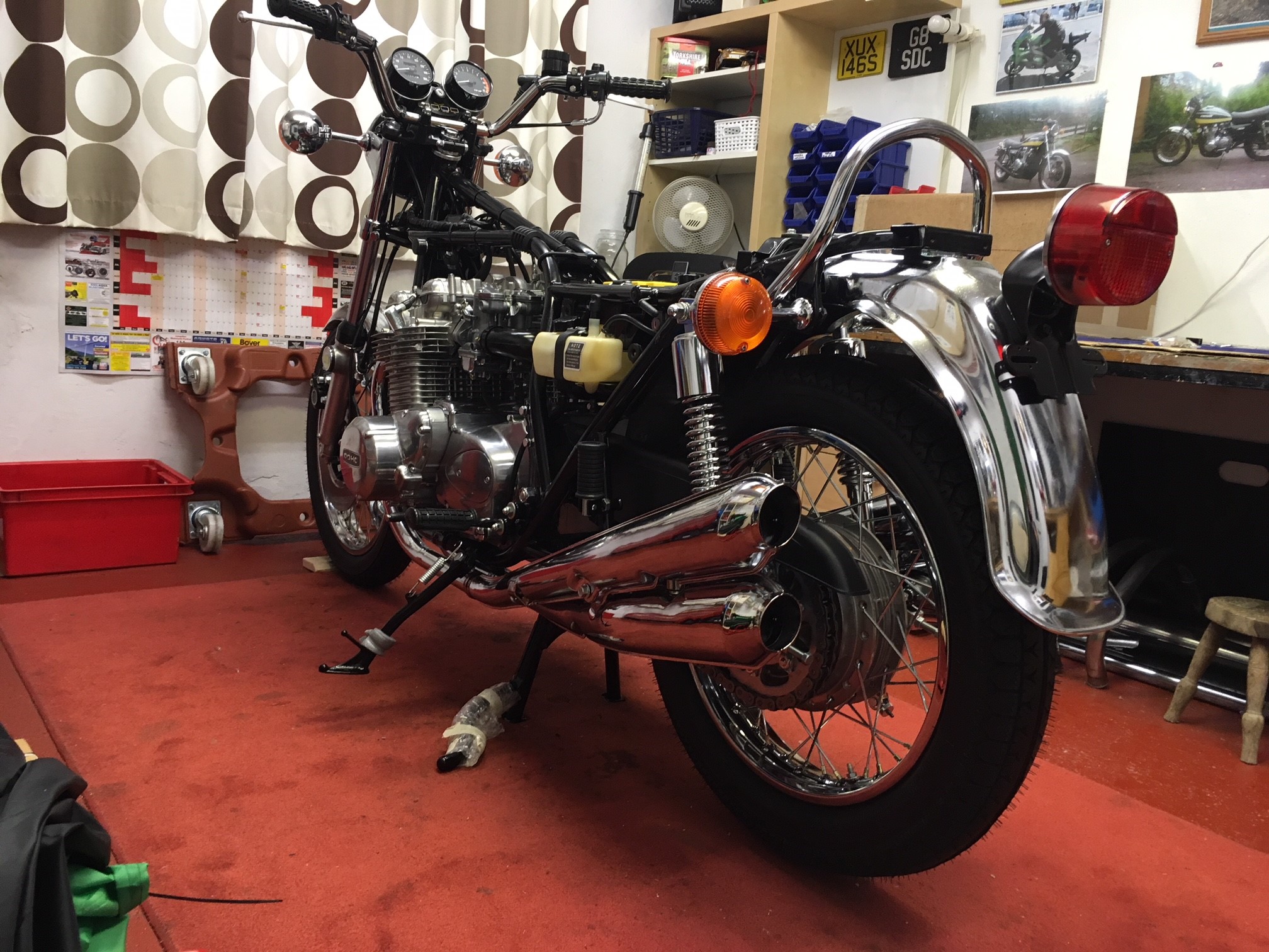

Fitted the exhaust tonight.
The method I used was to ask Julie for a hand
Bit of grease on the copper washers to hold them in place.
Placed the connecting rubber on the inside (bottom) Exhaust.
Whilst I lifted the front of the inside pipe into place Julie lifted the rear and put a screwdriver through the mounting bracket on the exhaust and through the exhaust hanger,I then loosely fitted the clamp.
Outside exhaust exactly the same, I lifted the manifold end into place whilst julie held the rear of both exhausts removed the screwdriver made sure both exhaust were in the connecting rubber and then inserted the screwdriver back through both exhaust and the hanger.
WHAT A GAL
Again I loosely fitted the exhaust clamp.
I then removed the screwdriver and inserted the bolt.
Tightened up the clamps, tightened the connecting rubber, tightened the bolt.
Otherside repeat.

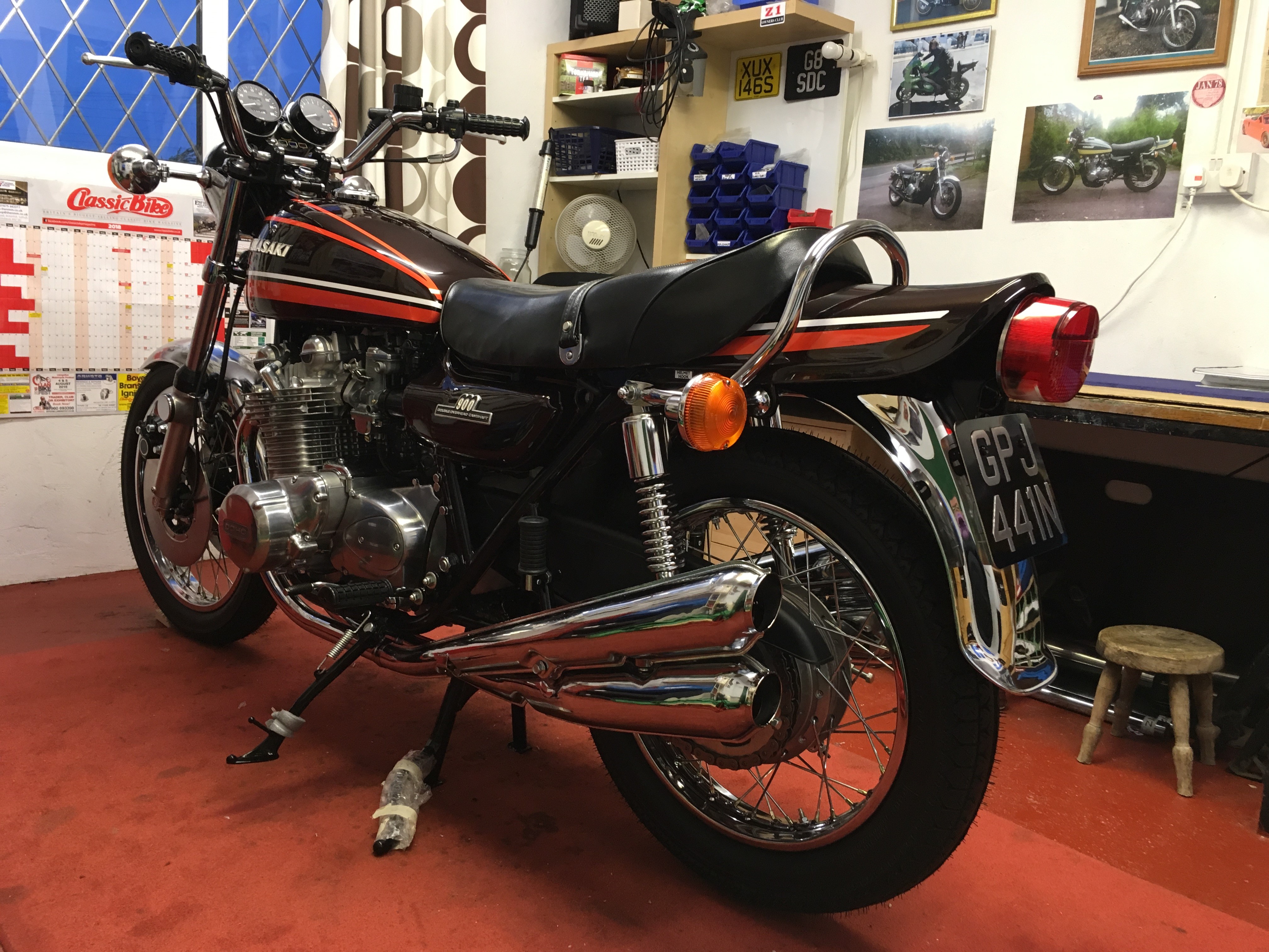

Well it seems my first restoration is coming to an end ....
Hopefully I can get out tomorrow and get some fuel for start up.
Fit Mirrors.
Clean the ACF50 off all the Chrome and Polishing.
Start up
If all goes well I will get it outside and take some proper photo's
Fit Mirrors.
Start up

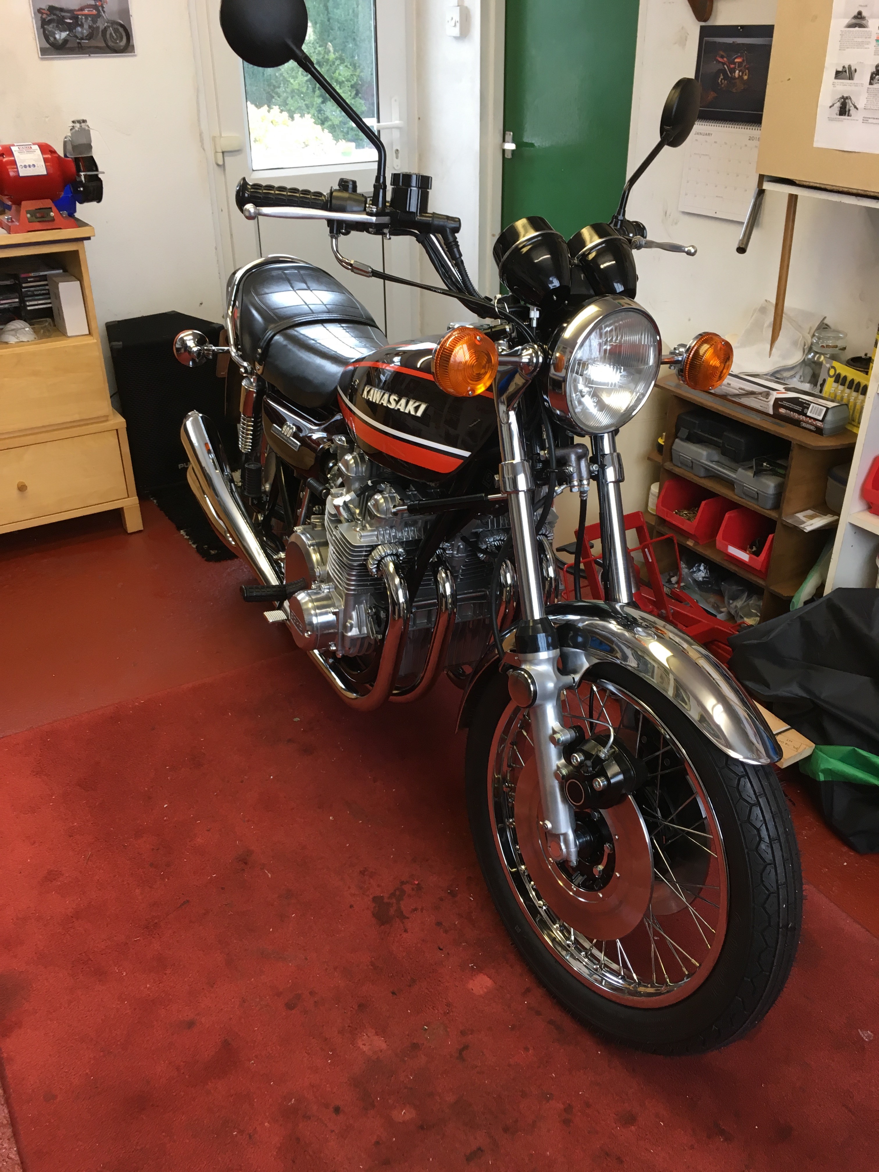

Started first press
Turned it over a few times on the starter without petrol.
Re-checked oil and topped up as oil pump and filter had now been filled from engine turnover.
Added petrol, checked for leaks, pressed the button.......
AND SHE'S AWAY
Would like to thank members -
Zedhead, Dave at Saisei for all his advise and contacts. (And Parts
Buzzard at Buzzworkz for Engine Restoration.
DaveZ1 for the Carb Restoration
Zedman for Switches Restoration.
Al Marshall for Clocks Restoration.
And loads of other members on here who helped greatly along the way, could never have done it without the club.
No ride out today as weather sh*t, but will post pictures on a new thread once we get out
AND SHE'S AWAY
