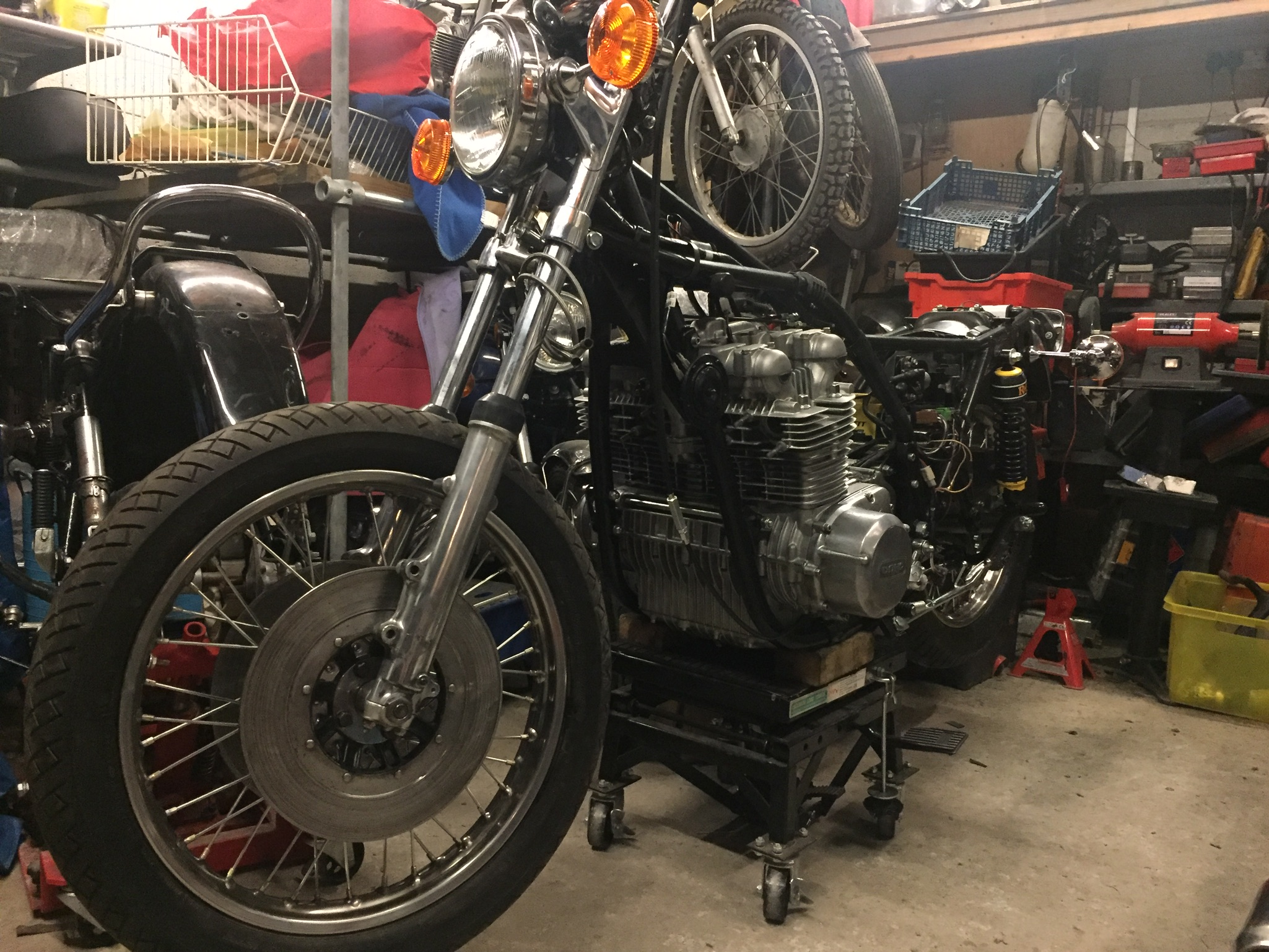

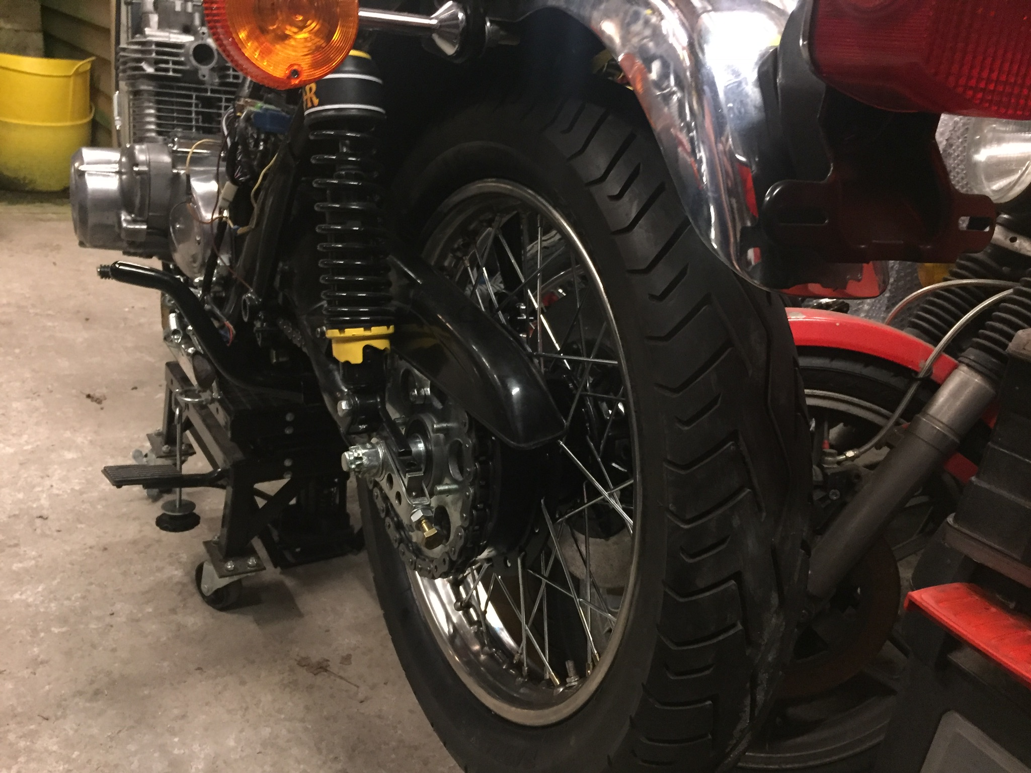

Got the tyres on today - discs tidied up and fitted along with a new chain and sprocket set and wheels in.
Hoped to get the carbs on as well but Grandparent babysitting duties encroached somewhat. And you can't argue with that!

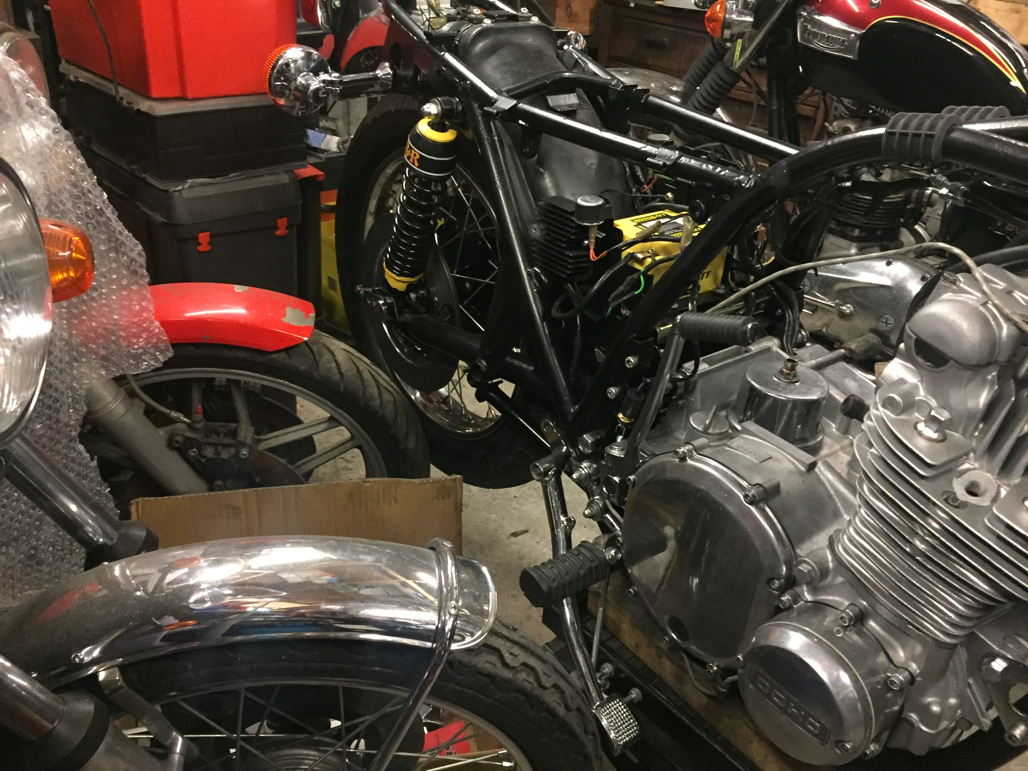

Today has been a good day - like really good! Finished up with the carbs and fitted them, even managed to rescue the original intake mounts. It's not that I'm tight, I just think for my builds I would rather refurbish and use as much of the original bike as possible even if the end result shows it's stretchmarks! After all these bikes are 40 years old.
I got the wiring to the coils straight and then with the help of this guy https://www.youtube.com/watch?v=GhB5Ncn3DAs and a Heath Robinson timing-test light did the static timing for the Dyna S ignition. I wasn't sure how good my coils were but as I was on a roll I thought bollox why not? Lets get the throttle cables fitted - you can see where this is going can't you? I struggled a bit with the shut off cable - still don't think it's spot on but already had my sights set on the old Harris exhaust that came with the bike. This was going to be fun as the bike was still on the Enduro stand resting on blocks of 4x2!!
I threw a few ratchet straps over the rafters in the garage and jacked the bike up as high as the 135kg stand would go. It wasn't far, lock off the straps around the frame tubes - drop the jack - and kick the stand out from the bike. Carefully let the straps off and there we are, the first time in 20 odd years that SME60SS (It's me boss) has stood on her own two feet.
Quick polish on the Harris and WOW how good does that look. Fit it - then fit it again only this time with the copper header sealing washers DOH!
And I thought
"I wonder?"
Rig up the auxiliary fuel tank - fill the motor with 3.7 litres of the finest melted down dinosaurs - fill the pot with half a litre of fresh lawn mower fuel. and turned on the tap. No overflow from the carbs that has to be a good omen. I spanked the throttle a couple of times - held the choke lever up turned the key and . . . . . pressed the button. She span over and coughed in a good way that made me think
"you're mine now precious'"
One more prod on the starter and she started like she had been run every day. Amazing - sweet, smooth and steady. Resist resist resist - oh fuck it Blip Blip Blip - Im in Z heaven. It sounds amazing even without an airbox and filter - whhoopps. Huge upwelling of smug. Such a shame I cant load videos - so I did the next best thing and sent a video text of her running - dressed up with tank and panels - to the guy that had her when I first saw the bike almost 20 years ago in his back garden alongside the BMW R80. Didn't say too much just the video and two words

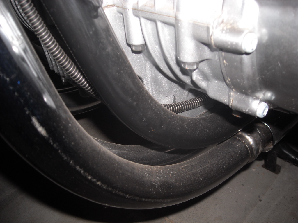

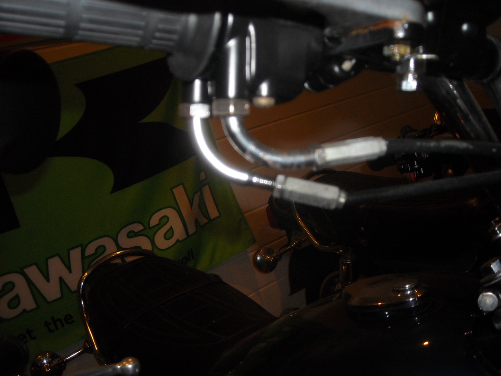

some pictures to help you
Throttle cables: start by the one with the shortest elbow, this is the "opening" cable, screw it in the switch housing at the front. Make sure you have enough thread left over to turn the nut on.
Turn the cable with the longer elbow in the rear opening of the switch housing. This is the "closing" cable.
Run both the cables through the opening of the cable guide and lead them between the right suspension and the steering stem tube of the frame.
(notice the hook after which the upper brake line runs)
Guide the cables along the upper central frame tube to the carbs. Guide the cable between the right and the central frame tubes. Attach them to the carbs, starting with the decellerator (closing) cable.

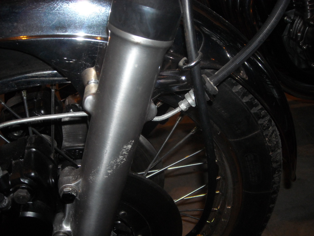

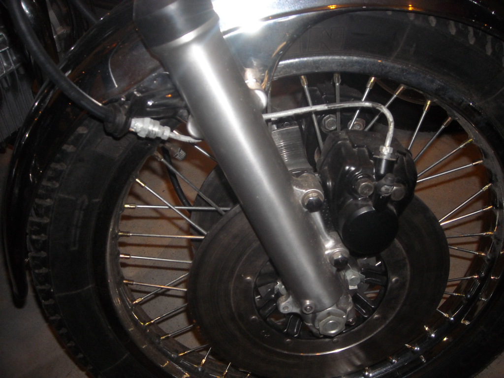

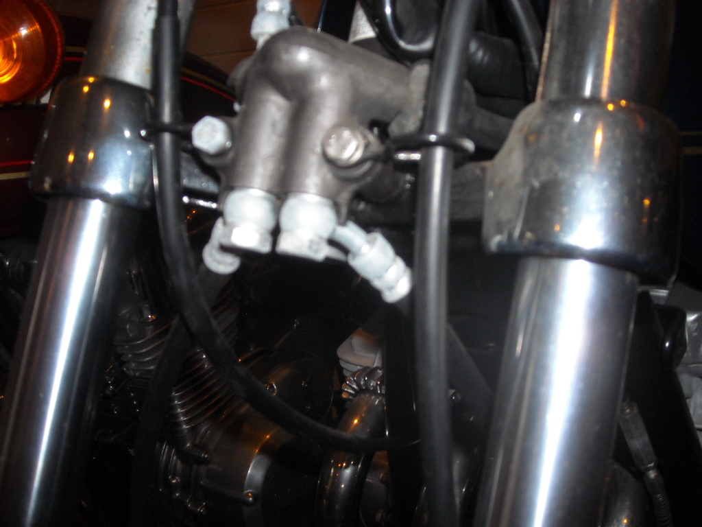

Brake lines:
guide the upper brake line after the hook of the cable guide and attach it to the brake splitter
each lower brake line runs through the guide on both sides of the front fork where its attached to the brake pipe, this one passes between the front fork and the front mudguard to be screwed in the brake caliper.
notice the speedometer cable on the left hand side.

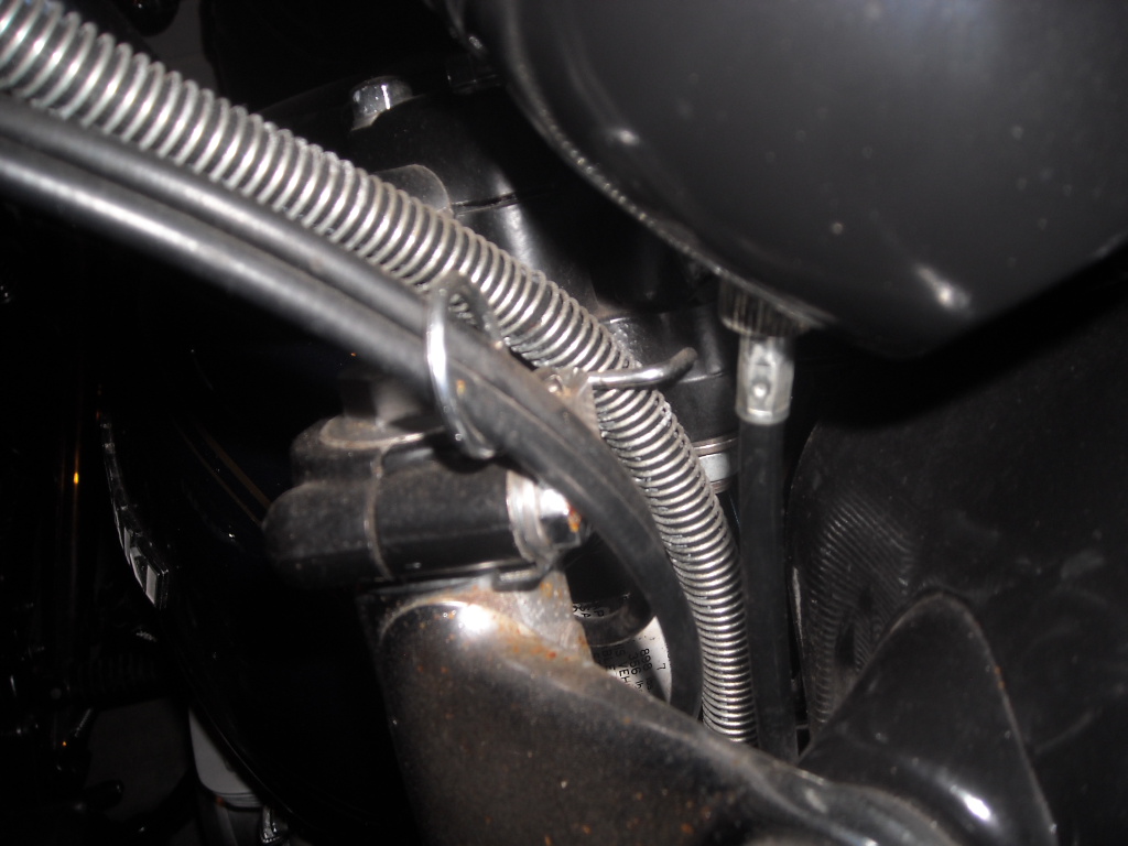

Clutch cable
start at the handlebar and run the cable through the cable guide

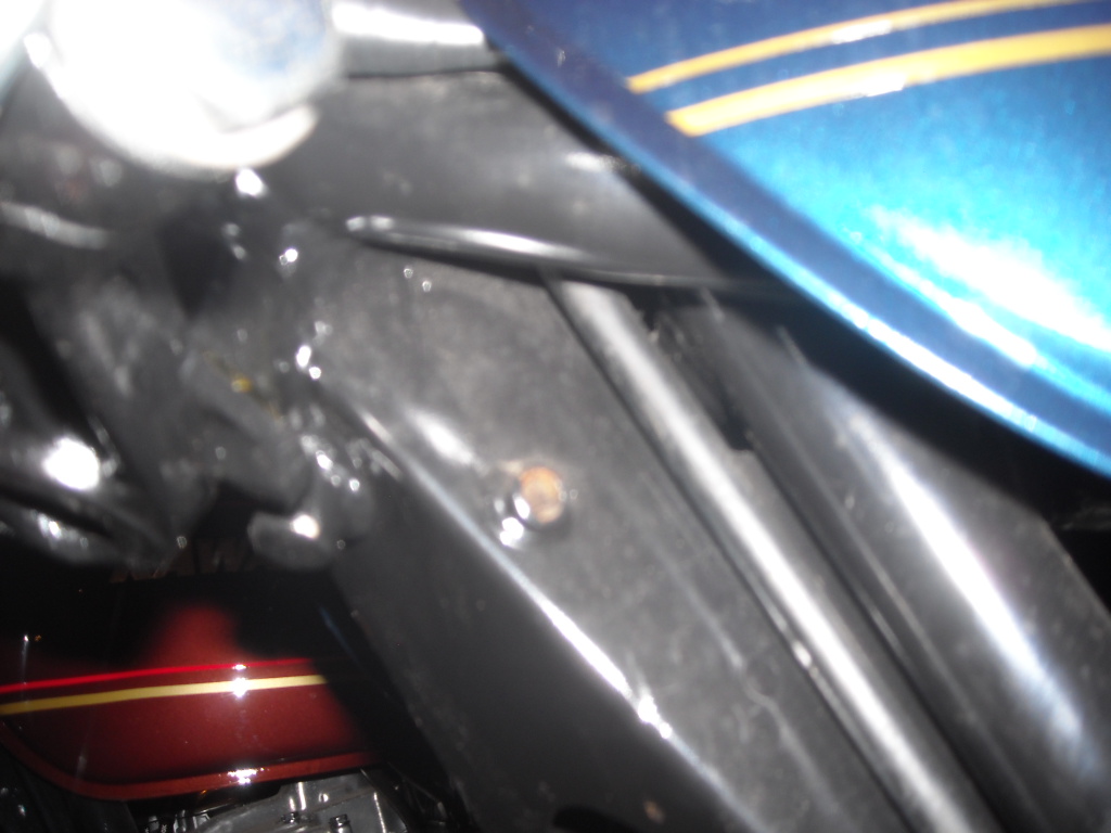

run the cable through the opening between the steering stem tube and the left upper frame tube, make sure the clutch cable runs behind the main loom
Guide the cable along the left hand downtube of the frame.
Guide it between the tube and the cranckase
Attach the cable to the clutch release mechanism, make sure the cable goes through the opening in the sprocket cover and sits right. Don't forget the spring between the sprocket cover and the clutch release mechanism.

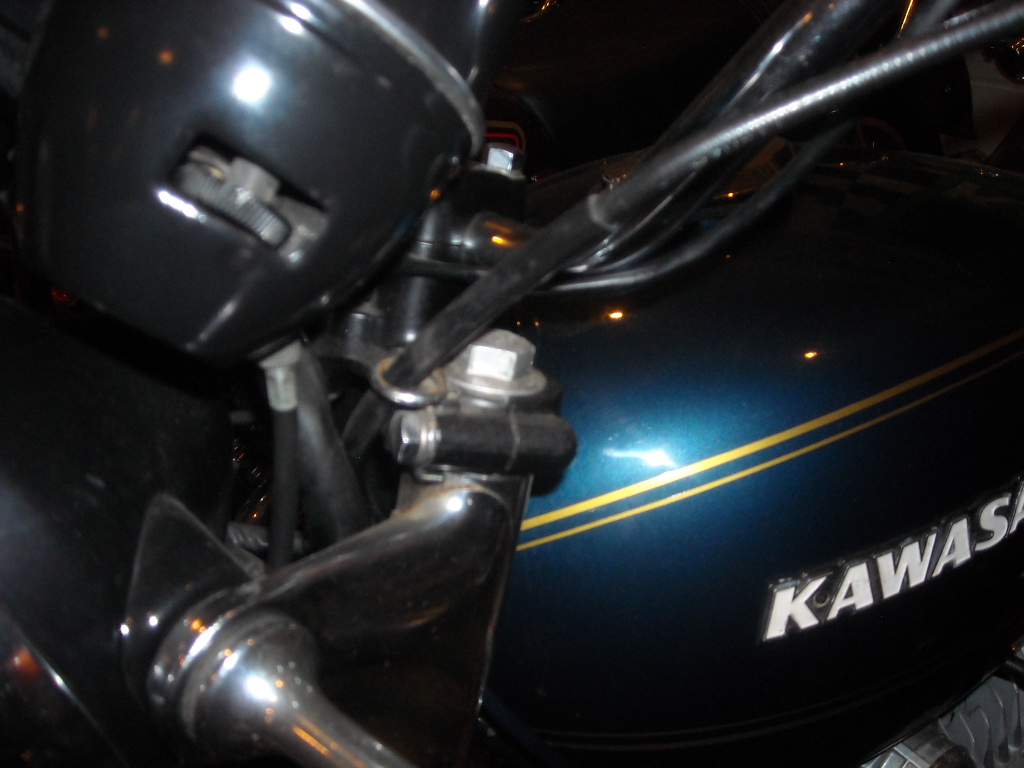

Rev counter cable and speedometer cable
they both run under the lower steering stem, through little cable guides and are attached to the meters

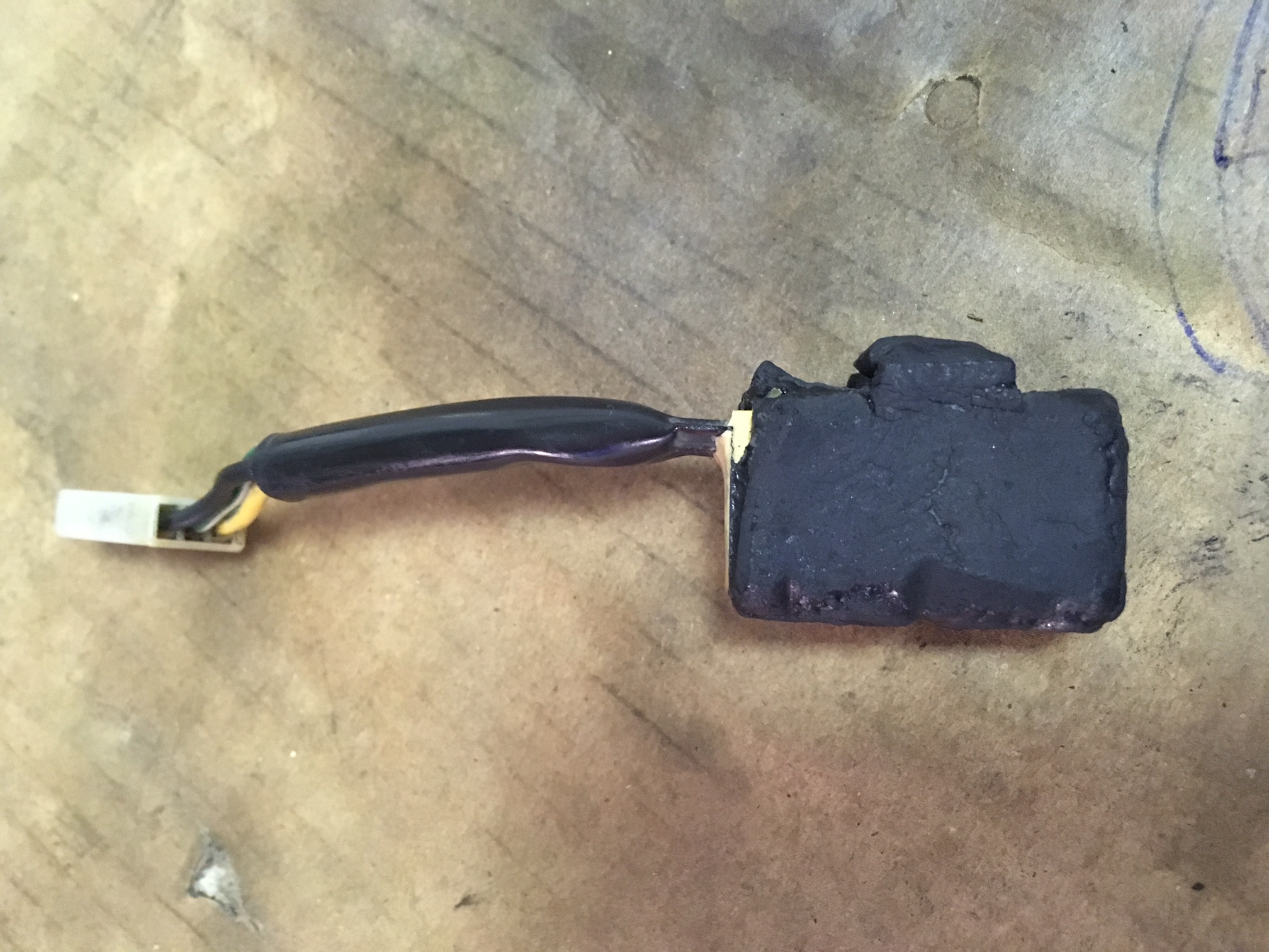

Flashing Brake Idiot Light.
I had this problem with my Z1 and with the Z1000a2 and on both occasions it turned out to be a duff Brake Outage Switch.
Located under the tank, once replace all was ok

when one of my brake outage switches failed there was no idiot light flashing. Maybe it depends on which internal part of it failed, I don't know a lot of electronics...
Re: Z1000A1 - Basket Case Build
Hello Philippe,
When I got my Z1000a2 the idiot light did not work and so I changed the bulb, on doing so it flashed permanently as soon as the ignition was switched on.
This stopped when I unplugged the outage switch, I replaced the switch and when plugged back in all was well.
I thought maybe the bulb had blown due to the permanent flashing.
With the Z1 the idiot light did not light at all until the switch was changed.
Think that you are right and there is more than one way the switch can become defective, I was lucky with the Z1 as I tried the one off the Z1000a2 first to prove before buying.
