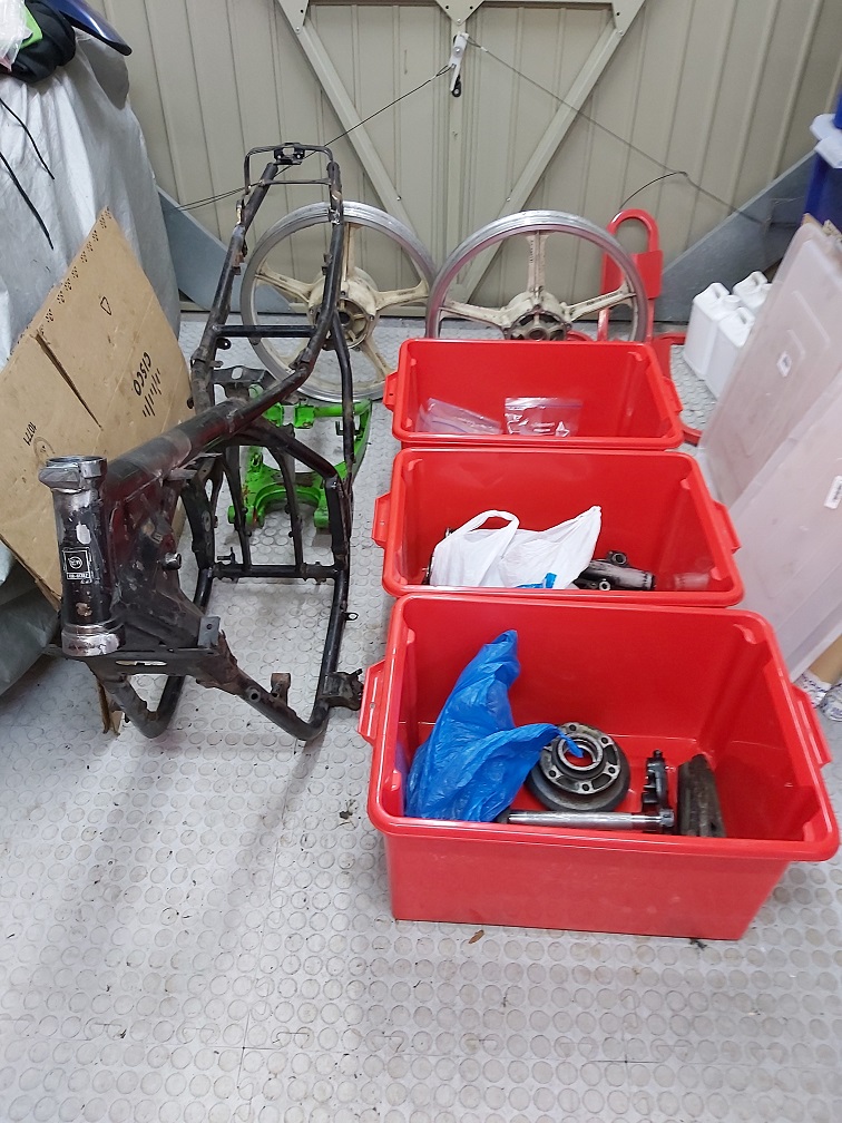

After another weekend in the garage, I've finally finished cleaning and checking the frame and running gear. Thankfully, I didn't find any horrors and with everything sorted into various containers, it's time for a trip to the Powdercoaters :-)
