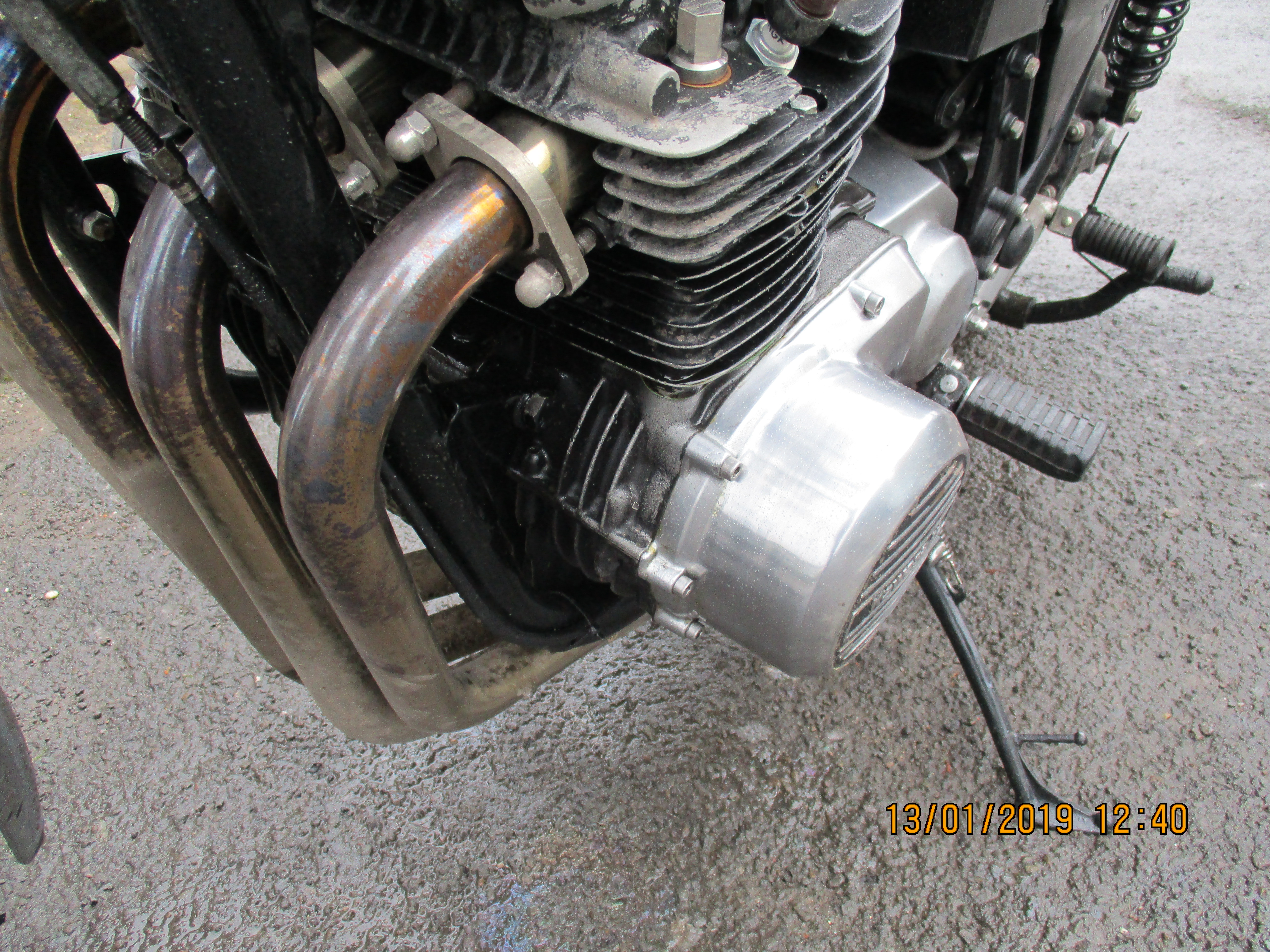

If it's leaking at correct torque - more probably won't cure it
Re: Z 1000 St E2
It looks like i will have to do a top end strip to replace the base gasket and establish why it leaked in the first place.
What are the best base gaskets to use, the one on there now is an athena. Are cometic base gaskets ok or are genuine
kawasaki best to use.

Hi Dunlop 4
I'm afraid you'll have to replace the base gasket. I think something went wrong when replacing it, maybe it was torn or a piece of the old gasket is still sitting on the cylinderbase thus preventing the new gasket to seal.
When you decide to replace it, you don't have to take the engine out , the cylinderhead and the cylinders come off while the engine is in the frame.
You'll have to use new gakets. I prefer to use Kawasaki gaskets or Vesrah gaskets.
Good luck with it.
Good luck with it.

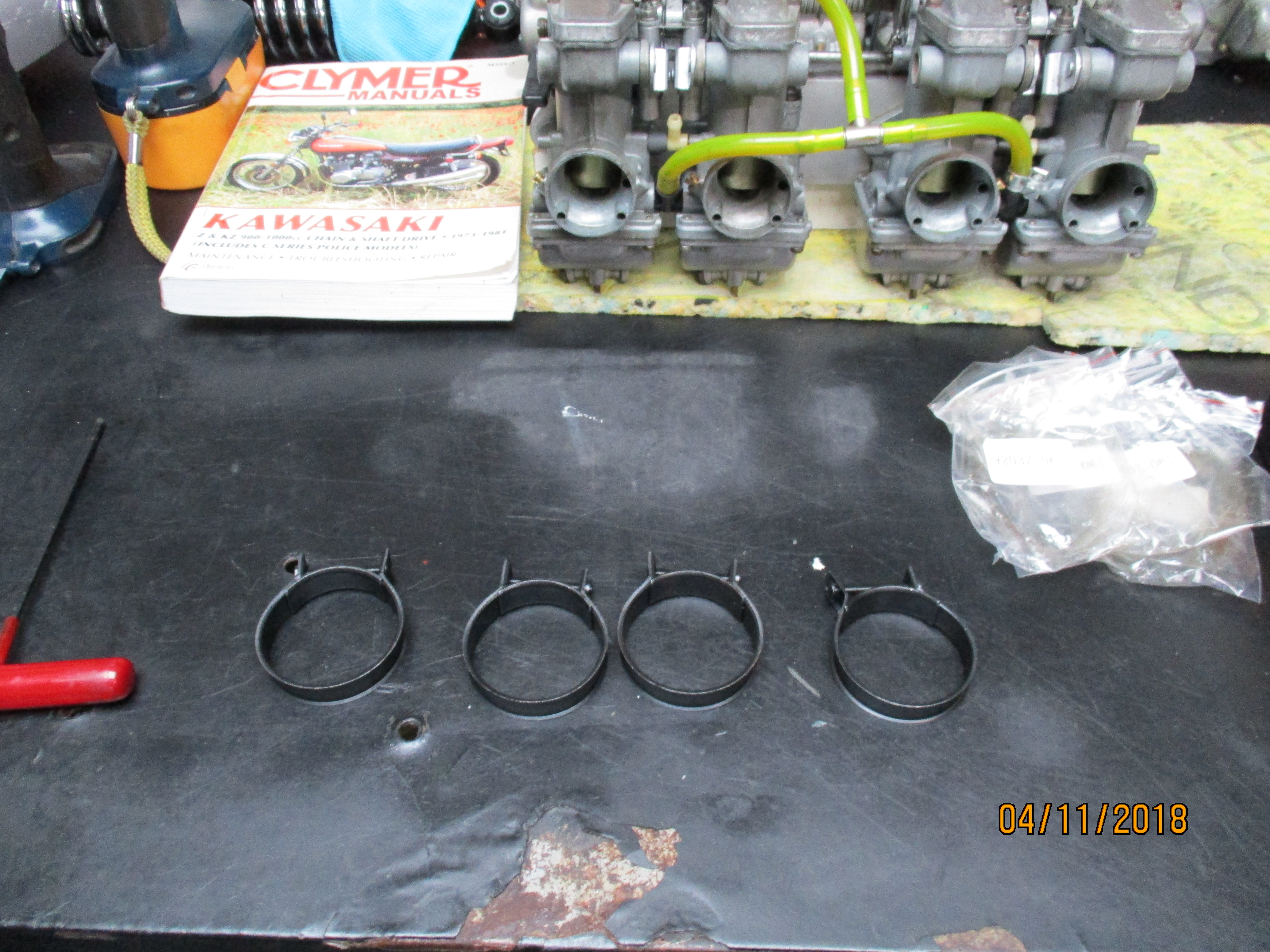

Fitted accelerator pump carbs today I took the slides and jets from a standard set of carbs and swapped them
Re: Z 1000 St E2
When i fitted these carbs, there is an improvement but there is delay to return to idle
Re: Z 1000 St E2
Hi Avon
the carbs I see on your work bench are not from an ST but from a late Z1A or from a Z1B.
These carbs are 28 mm but difficult to adjust! Are you sure you're going to put these on your ST ?
Re: Z 1000 St E2
Yes you are quite correct. What he is trying to say is that he had a problem with a set of carbs not returning to idle. These were bought off a another club member, advertised as being from an american KZ 1000 ST. It turns out they were off a KZ 1000LTD B4 accelerator pump type.
What we did to fix the problem was to swap the slides and needles as well as the main jets to the accelerator pump carbs. He refitted these to the bike and the is a big improvement, he did not road test it today as it was raining. There is still slight delay to return to idle.

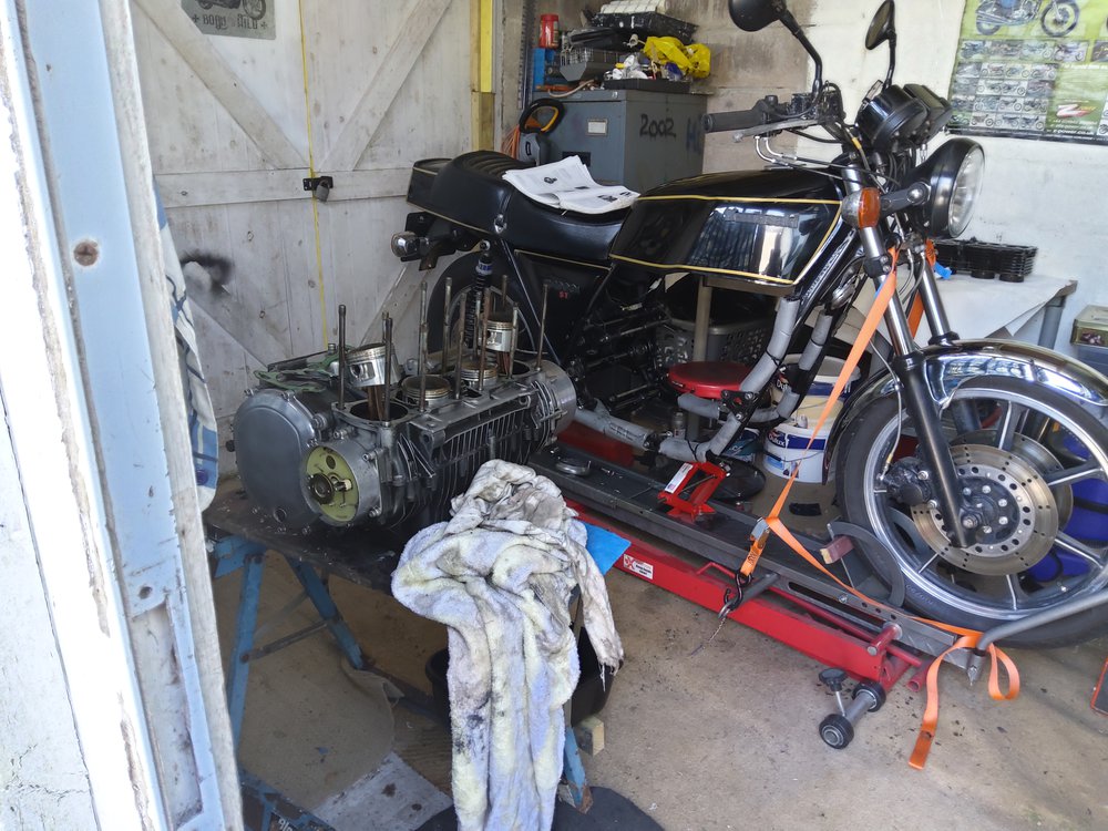

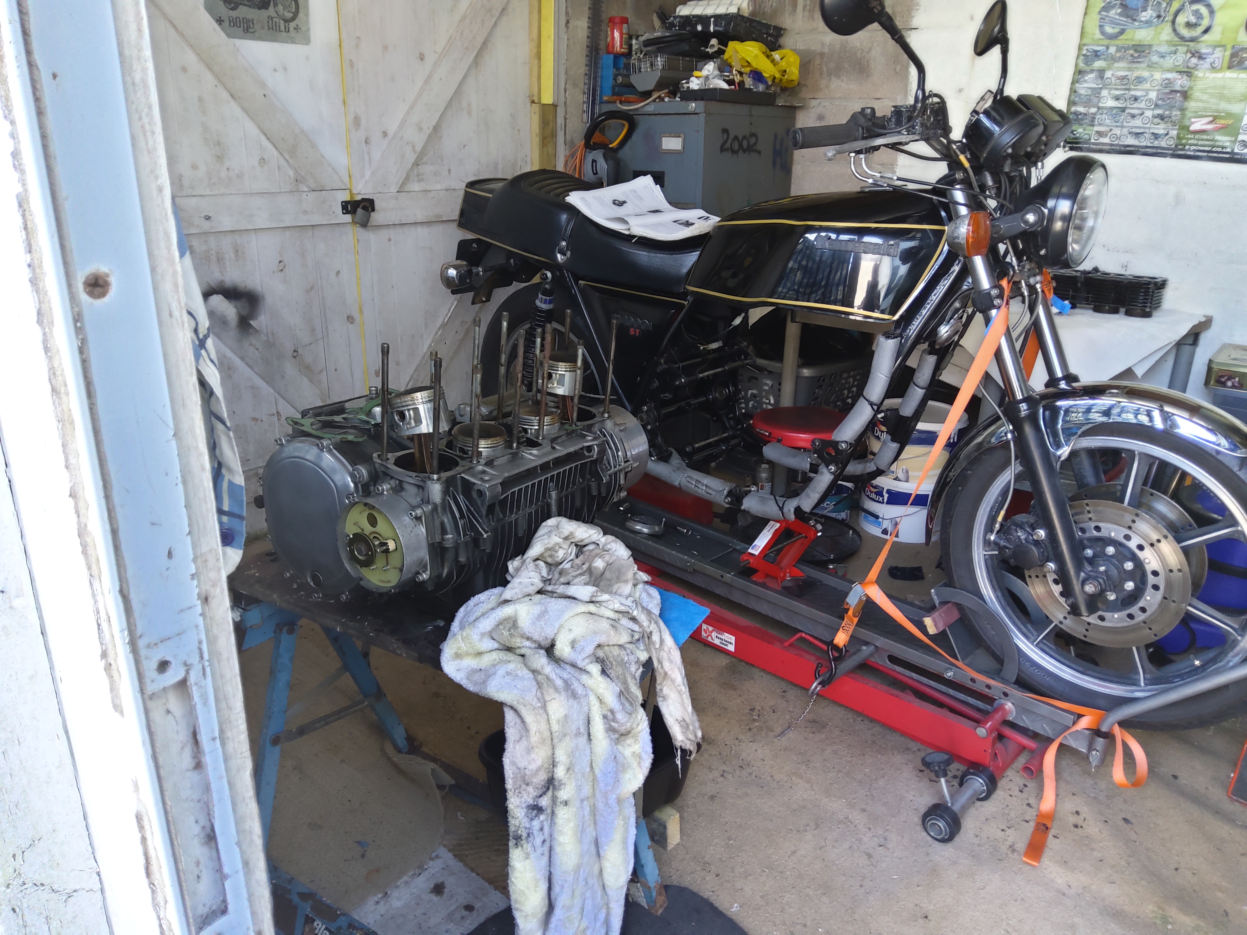

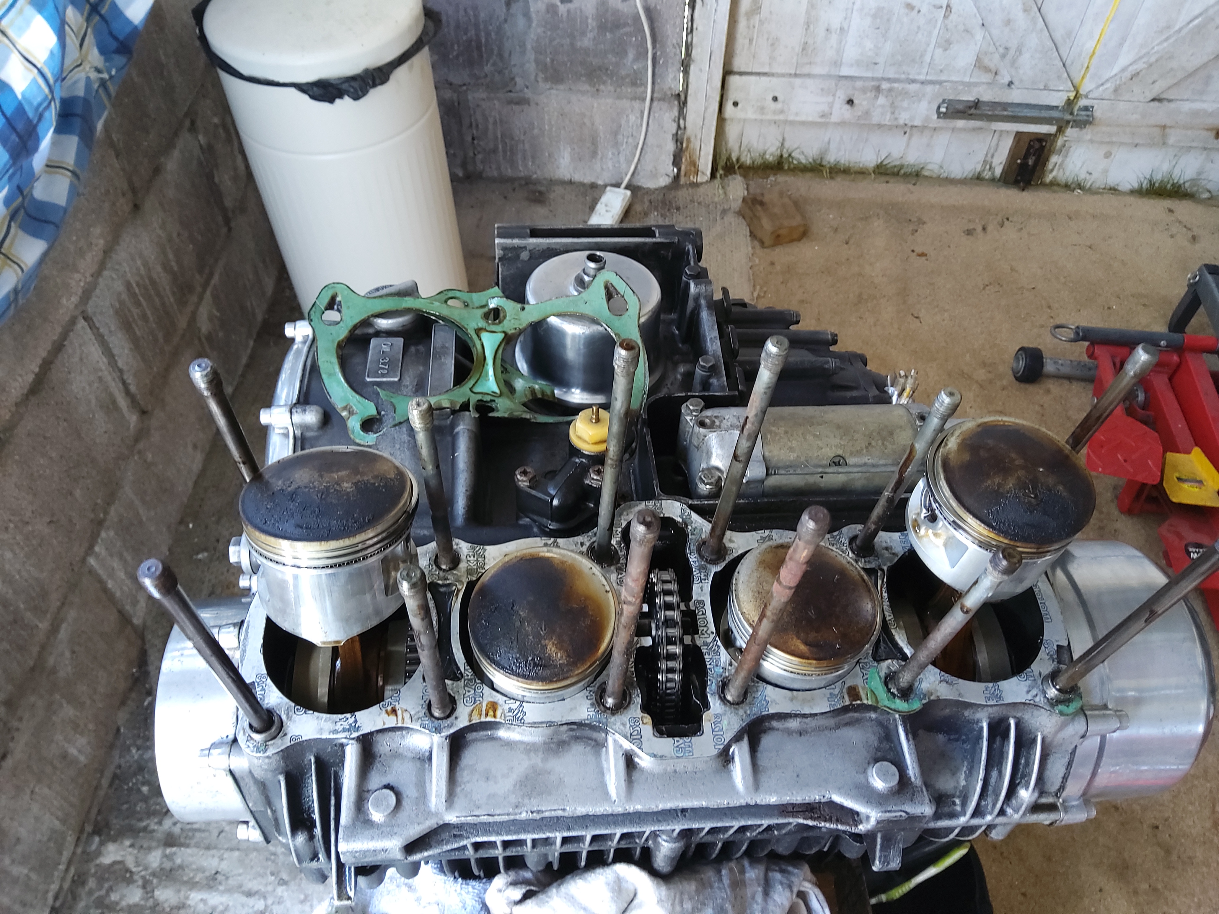

Decided to fix the leaking base gasket permanently, removed engine to repaint casings at same time.
Seems to be running a bit rich as only covered 1750 miles since rebuild, will have a rebore to cure lack of compression sending barrels off to IMD pistons.
